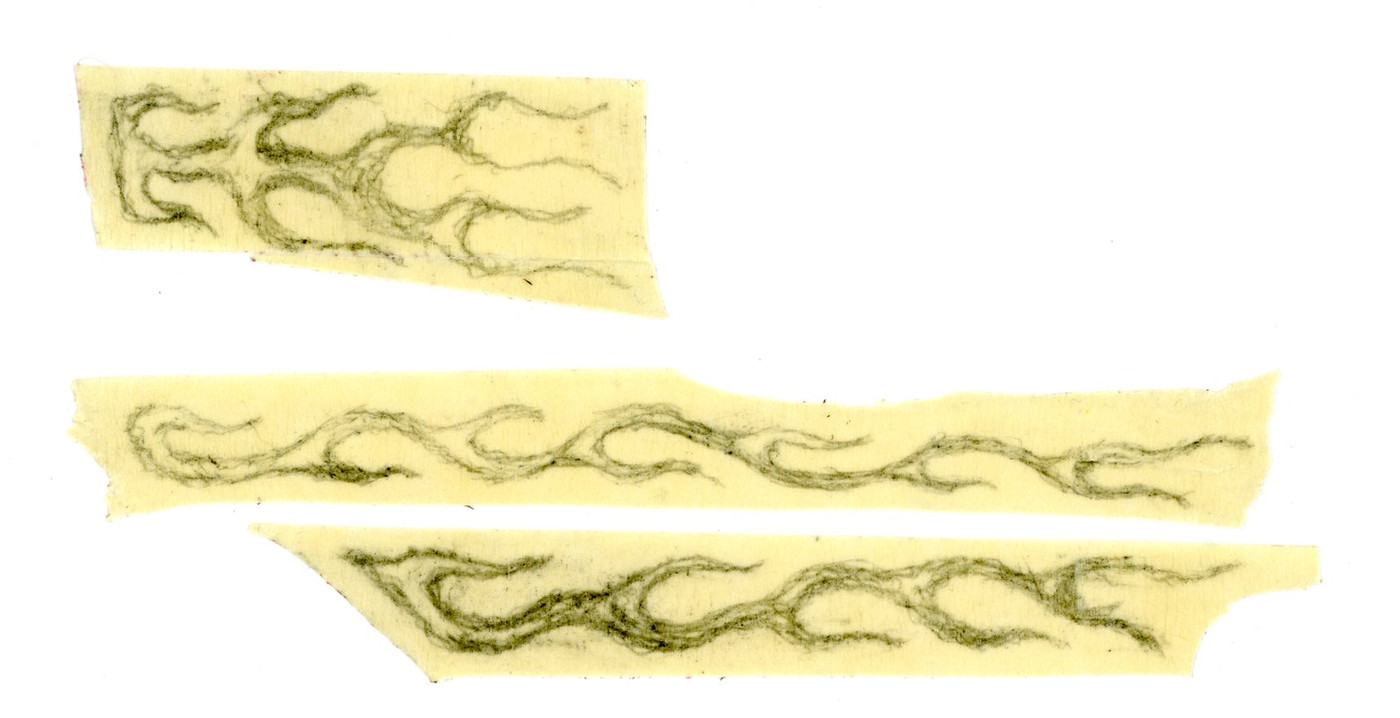

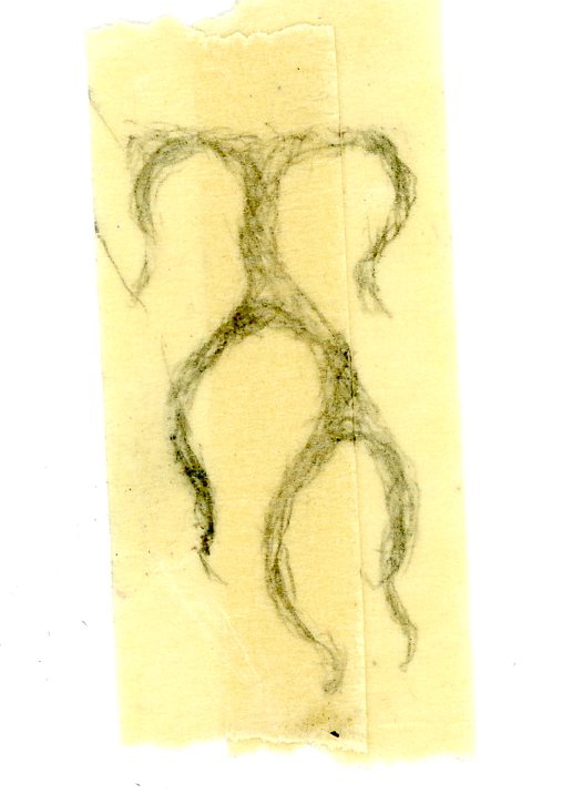

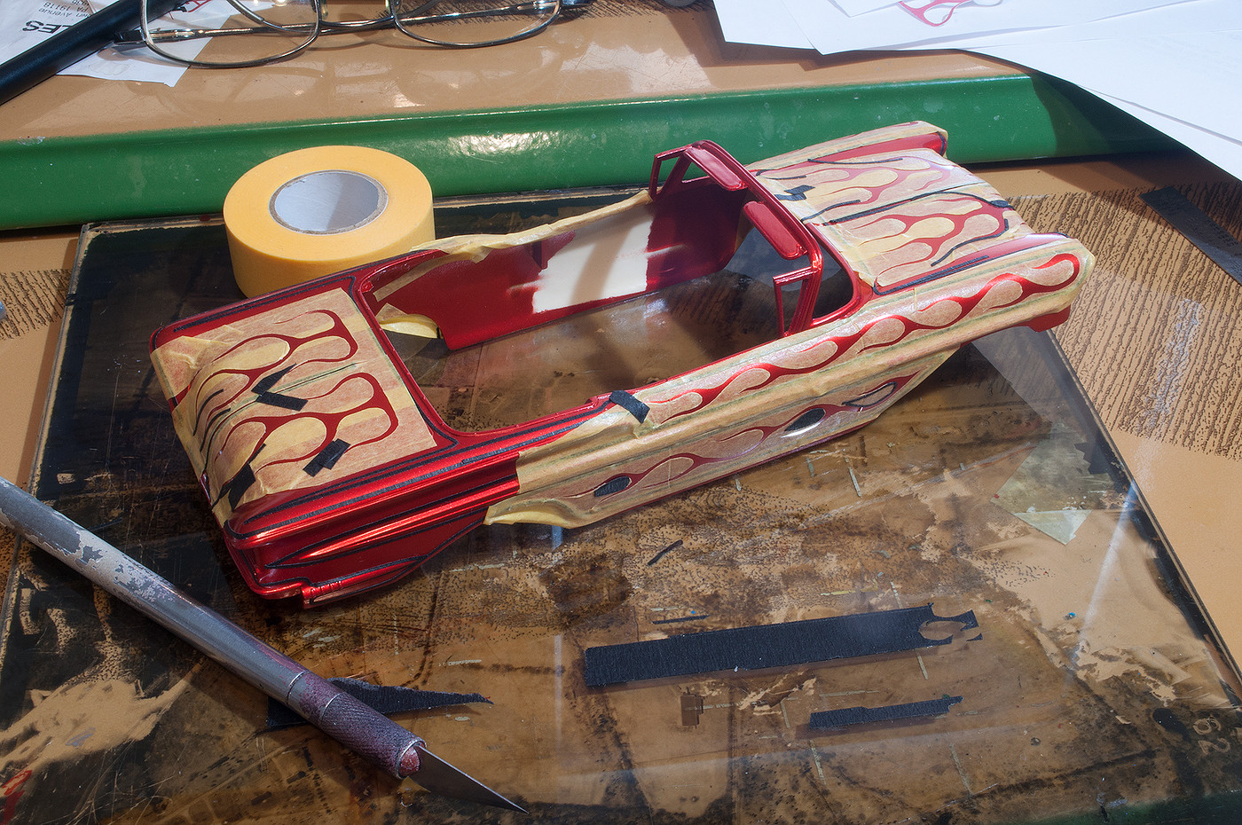

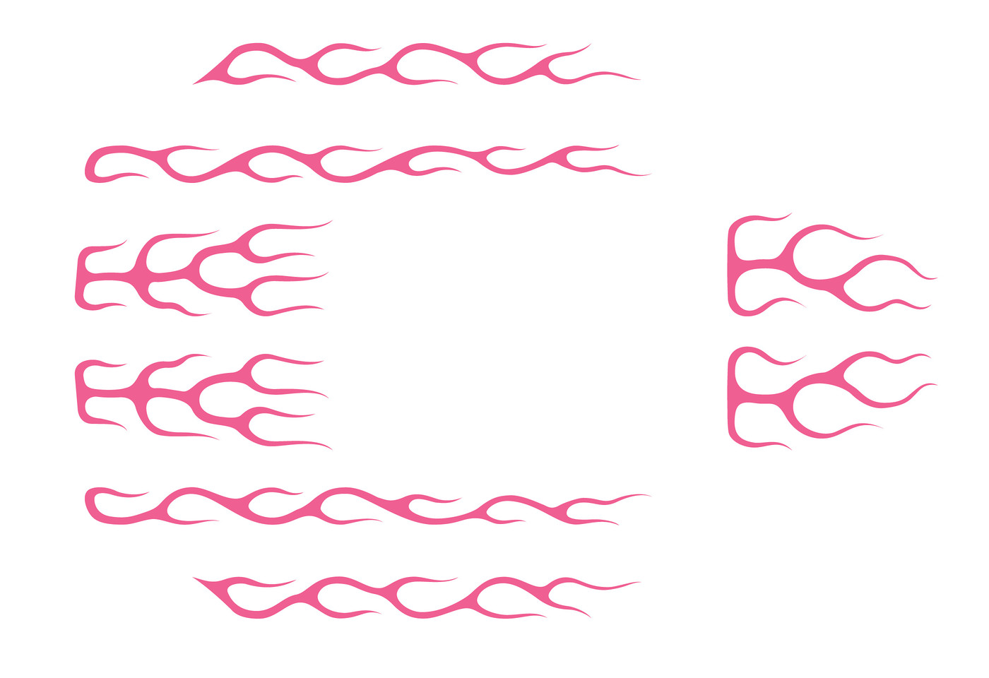

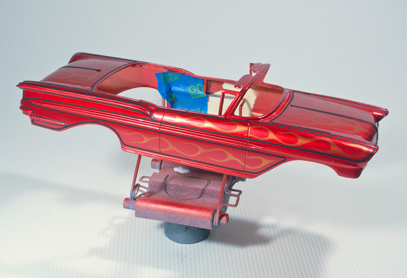

John Goschke Posted February 9, 2017 Author Posted February 9, 2017 (edited) The fun continues... to avoid creating just another Watson-style outline job, I decided to try adding some tendril ( aka "seaweed") flames, another technique that Larry employed more than once. Originally was going to do only the lower body between the wheel wells but took it a bit further. I drew the design on masking tape on another Impala body, then scanned that design to use as a template to refine and redraw in Adobe Illustrator as vector-based art that could be copied as a mirror-image for the other side of the car. These patterns were printed out and laid on top of Tamiya tape to cut masks to apply to the body. The real challenge came in trying to lay the ones on the hood and decklid symmetrically. We'll see how well I did when the tape comes off! These were airbrushed with thin coats of Tamiya's Metallic Orange, which is nearly the same value as the red for a somewhat subtle effect. I'll just need to knock down the little bit of edge buildup. Then... MORE tape! Edited February 9, 2017 by John Goschke

gtx6970 Posted February 9, 2017 Posted February 9, 2017 OH MY .!!!!!!!!!! So,,,,,,,,,,,,,,,, whats going over top of this ? I'm taking the pinstripes will remain the clear red, then something else to be a top coat over top of the red and the flames . I'm not a huge fan of customs per say,,but I love this one so far

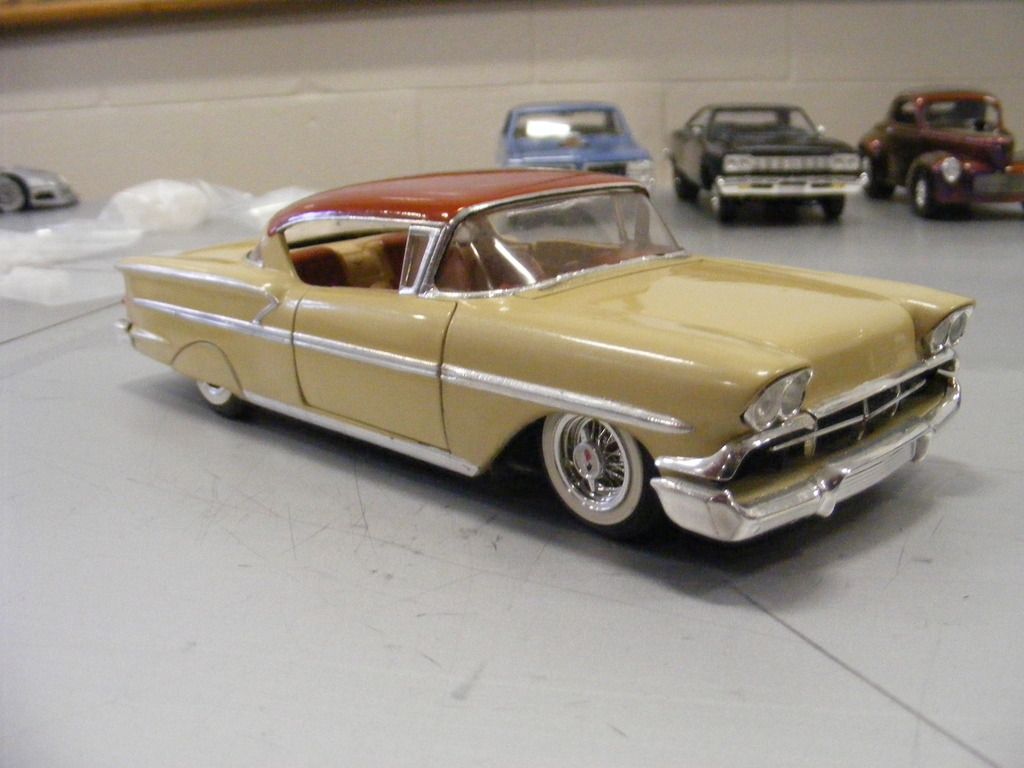

John Goschke Posted February 10, 2017 Author Posted February 10, 2017 OH MY .!!!!!!!!!! So,,,,,,,,,,,,,,,, whats going over top of this ? I'm taking the pinstripes will remain the clear red, then something else to be a top coat over top of the red and the flames . I'm not a huge fan of customs per say,,but I love this one so far Thanks, guys! Bill, I'll actually be masking the areas within the black tape to create a classic Watson-style outline paint job in gold. This model was inspired by three 58 Impalas Larry painted, the green/gold Jim Doss semi-custom, Dennis Morgan's green/gold hardtop, and a red/gold semi-custom Impala convertible (can't find photos of that one anymore.) Anybody know how to do a 1/8" pinstripe in 1/25th scale?

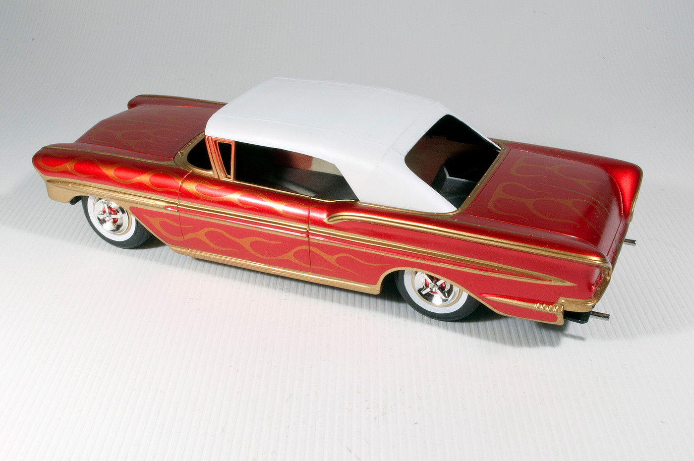

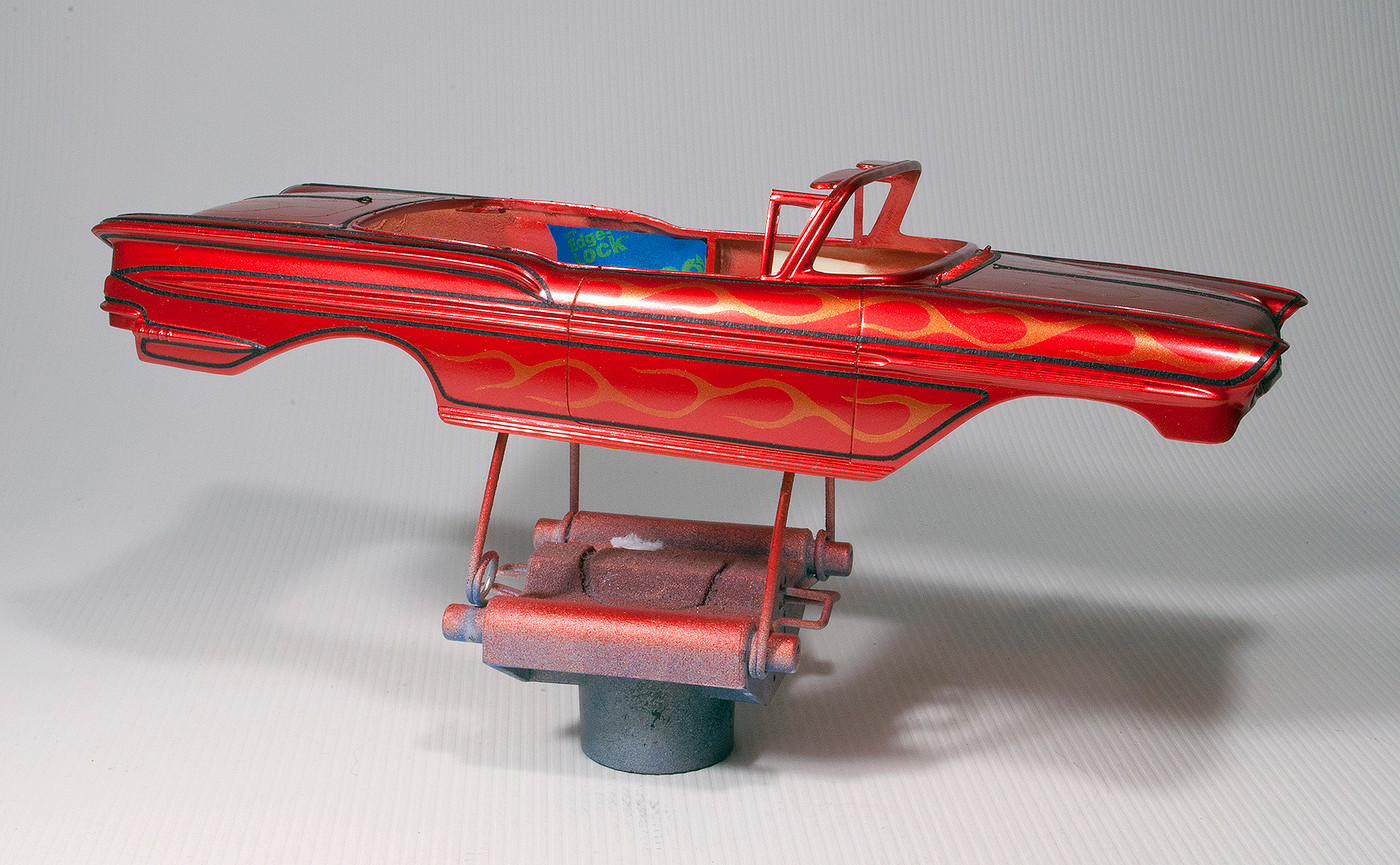

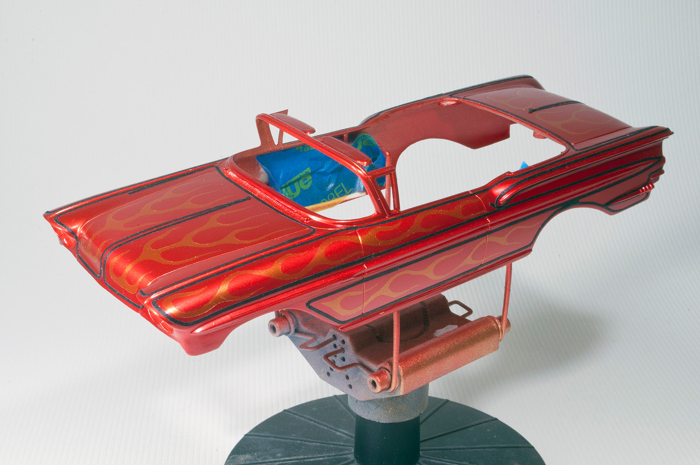

John Goschke Posted February 11, 2017 Author Posted February 11, 2017 Thanks for the comments, guys! Sharp Impalas, Ron! Here she is for a roll-out with the gold outlining done and all the freakin' tape removed!
