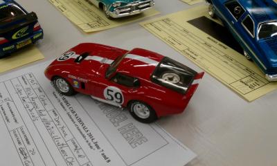

I just finished the Gunze kit in Ragoon Red
Very nice job Len! I like it in red, but I think to paint mine in blue.
