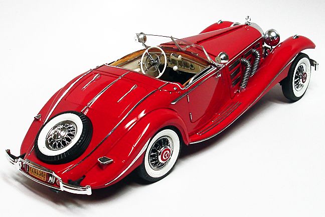

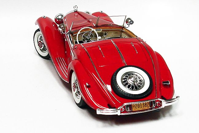

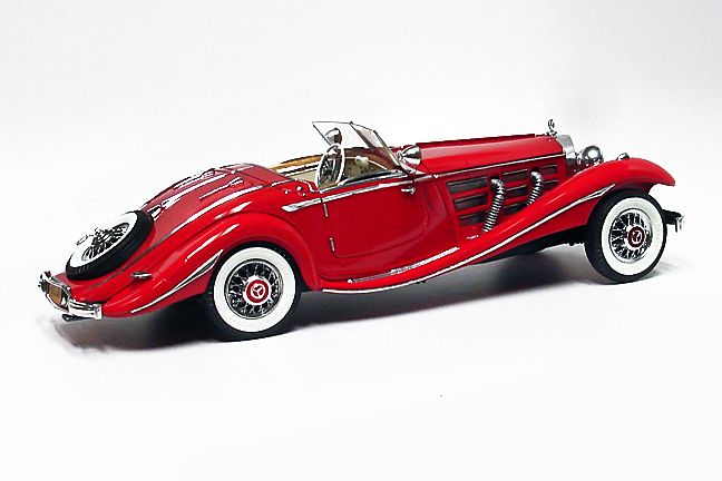

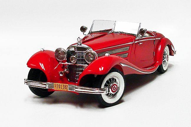

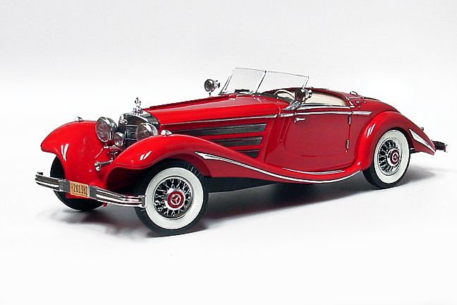

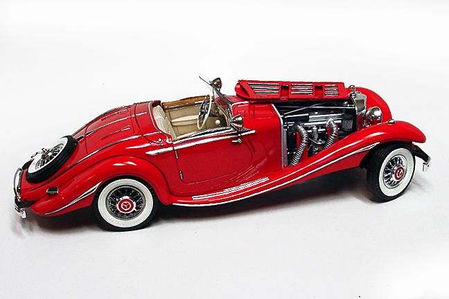

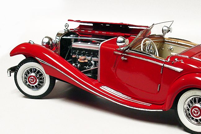

This is the 1/16 Minicraft (or should I say "miniCRAP") version of the 1936 Mercedes 540K. A bad kit with tons of flash, sink marks, mold misalignment, etc. This one was tough to build, even tougher to make look halfway decent.
I drilled out the gauges and made my own by photoreducing gauge faces I found online, made bezels out of aluminum tube, added real wood trim to the door panels and dash, "chromed" the wheels with Spaz Stix "Mirror Chrome," added the whitewalls with acrylic craft paint, replaced the kit's out-of-scale thick glass with Lexan, added a bunch of missing underhood detail, added photoreduced license plates, and just generally tried to finesse this kit to make it look good.
Paint is Krylon "Short Cuts" Red Pepper and Future clear.

Another masterpiece of gorgeous gleaming red and chrome
Your work puts the box art to shame!

Yet another incredible build from Harry! Great work! I like how you clean up the small details like thinner glass, better gauges, etc. Those little things add up to a big improvement. Nice work!
