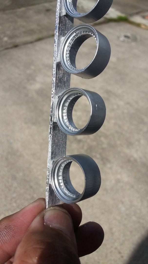

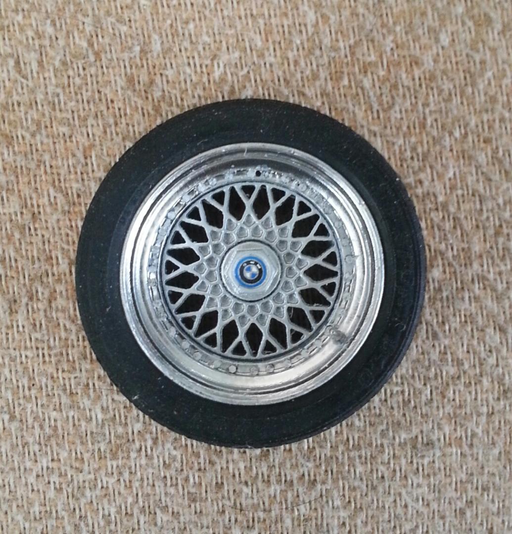

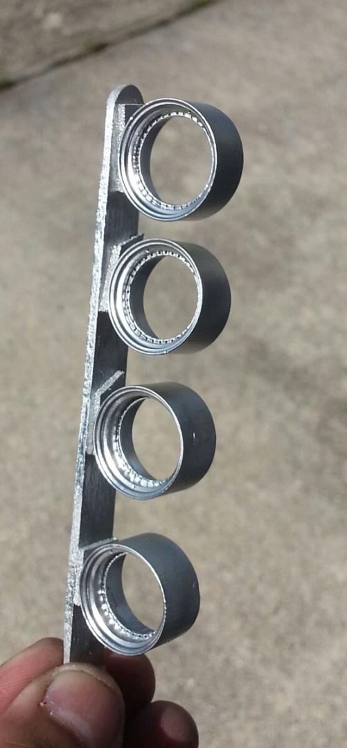

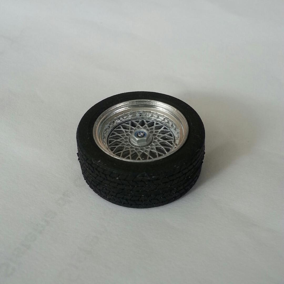

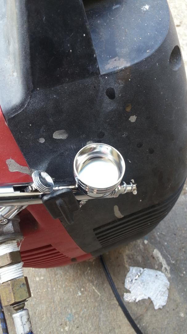

simonr Posted September 9, 2017 Share Posted September 9, 2017 A coupke of days ago I tried for the first time the use of these pens through the airbrush and the results are incredible. In the airbruah cup, it actually looked like a melted chrome bar...As in a YouTube video of a Chinese modeler, I just added a little bit of 90% alcohol and shooted it under the hot sun of my Puerto Rico...It turned out great and cleaning for my surprise was more easy than with paint... Simón P. Rivera Torres Quote Link to comment Share on other sites More sharing options...
simonr Posted September 9, 2017 Share Posted September 9, 2017 The results of my experiment... Simón P. Rivera Torres Quote Link to comment Share on other sites More sharing options...
Arjay 396 Posted September 9, 2017 Share Posted September 9, 2017 Your results look incredible, Simon!A very convincing set of alloys. Quote Link to comment Share on other sites More sharing options...
simonr Posted September 9, 2017 Share Posted September 9, 2017 Your results look incredible, Simon!A very convincing set of alloys.Thanks a lot my friend...If I should take the final picture it would look much better. I just added a little bit of 90% alcohol and flowed real nice... Quote Link to comment Share on other sites More sharing options...
