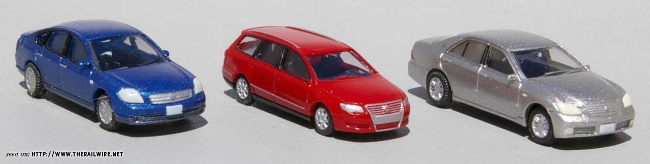

unclescott58 Posted August 21, 2020 Posted August 21, 2020 I'm disappointed. No working lights? ? In all seriousness that is impressive. And way beyond my skills, or patience for that matter. The one thing I do question from this video is the scale. I play with N scale trains. N scale is 1/160th. Compared to my N scale automobiles, this remote car looks to me to be a little bit bigger that 1/150th. Even still, if it is slightly bigger than 1/150th, it's still darn impressive.
peteski Posted August 24, 2020 Posted August 24, 2020 (edited) On 8/21/2020 at 4:47 AM, unclescott58 said: I'm disappointed. No working lights? ? In all seriousness that is impressive. And way beyond my skills, or patience for that matter. The one thing I do question from this video is the scale. I play with N scale trains. N scale is 1/160th. Compared to my N scale automobiles, this remote car looks to me to be a little bit bigger that 1/150th. Even still, if it is slightly bigger than 1/150th, it's still darn impressive. Expand I believe the model is a standard 1:150 Japanese passenger car, probably from Tomix (Tomytec). Person in the video might just have small hands. If I did some Google searches I could likely find that exact model, but I don't feel it is that important. Edited August 24, 2020 by peteski
peteski Posted August 25, 2020 Posted August 25, 2020 Ok, here is the scoop on that model. It is the 2003-08 Toyota Crown from TomyTec Car Collection 10. I think the builder probably picked that car because it is larger than most of the TomyTec 1:150 scale automobiles. Here a comparison photo of the TomyTec Nissan Teana (blue) from Car Collection 10, a 1:160 Wiking VW Passat (red), and the TomyTec Toyota Crown from Car Collection 10. So yes, that model is quite bit larger than a typical 1:160 passenger car, but I believe it is still correctly scaled model, in 1:150 scale.
