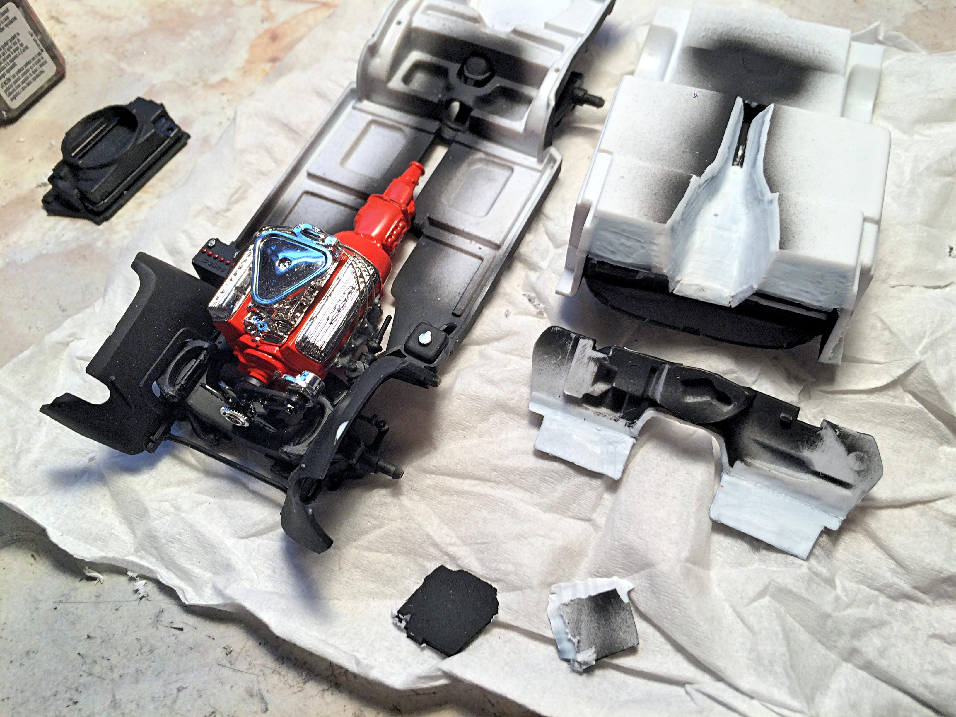

Tom Geiger Posted October 15, 2020 Posted October 15, 2020 (edited) As said a lot of times it comes down to “the look”.. does it look right? There are always sacrifices made in scale due to thickness of materials or getting it all to fit together. Sometimes it’s done for the look, there are times that dead accurate in scale doesn’t look right! Here’s 1/24 and 1/25 across from each other, you can see the difference. We designed this off the center Edited October 15, 2020 by Tom Geiger

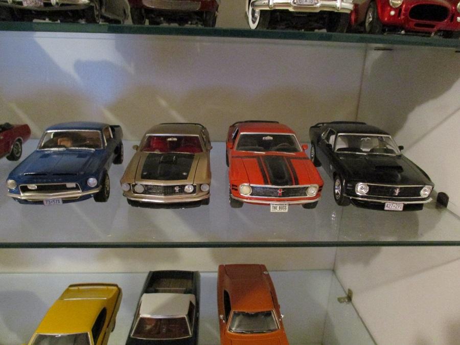

landman Posted October 17, 2020 Posted October 17, 2020 (edited) This is roughly what the difference is. As mentioned above it varies. the '70 is 1/24 while the '69 is 1/25, the same between the '66 & '67. Hope this helps. Edited October 17, 2020 by landman

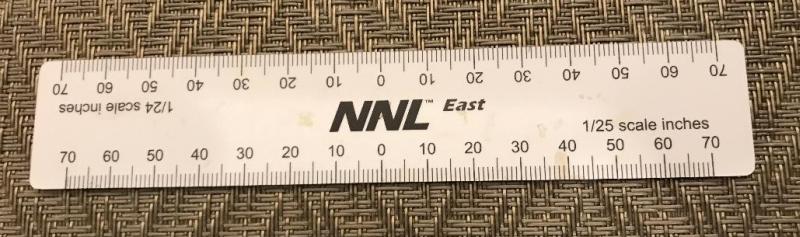

Tom Geiger Posted October 17, 2020 Posted October 17, 2020 On 10/15/2020 at 10:04 AM, Straightliner59 said: I've always had an easier time with multiplication than division! ? Plus, it's easy to remember that .040" strip stock is 1", in 1/25 scale, therefore, .005"=1/8", .020"=1/2", etc. I've gotten to where I just think that way, when I'm building. But, you're right. It doesn't matter how you get there! Which is why you need a scale ruler. No math at all. Measure 18 inches on your 1:1 car, then measure off 18 inches using this ruler against your model. We also kept it all in inches to avoid the inches to feet math. Several industries do this in real life.. for instance office furniture. Scale rulers are extensively in industry. Coming from a drafting and design background, when I got into model cars, immediately I sought out a scale ruler. I couldn’t do scratch building without it!

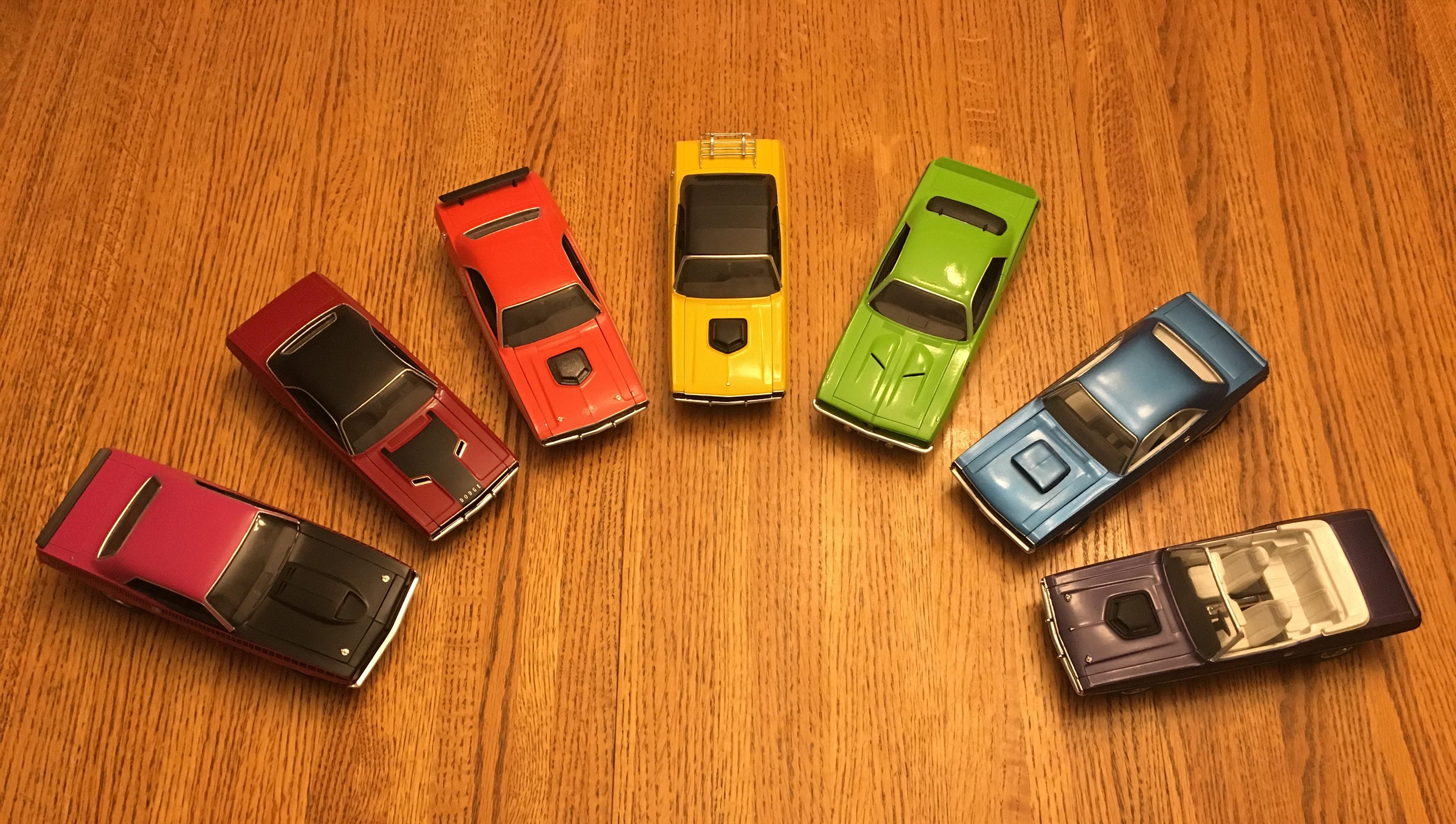

Bills72sj Posted October 17, 2020 Posted October 17, 2020 Here is a pic of my Mopar E-body "Rainbow" Pink 1:24 Revell AAR 70 Cuda Red 1:25 AMT 70 Challenger R/T SE Orange 1:25 71 Challenger conversion from an AMT 70 Challenger Yellow 1:25 AMT 70 Challenger convertible Green 1:24 Revell 71 Hemi Cuda Blue 1:25 Lindburg 72 Challenger Purple 1:25 AMT 70 Challenger R/T convertible You can see the two Revell's are ever so slightly bigger in spite of the real world shorter wheel base of a Cuda vs. a Challenger.

Straightliner59 Posted October 18, 2020 Posted October 18, 2020 13 hours ago, Tom Geiger said: Which is why you need a scale ruler. No math at all. Measure 18 inches on your 1:1 car, then measure off 18 inches using this ruler against your model. We also kept it all in inches to avoid the inches to feet math. Several industries do this in real life.. for instance office furniture. Scale rulers are extensively in industry. Coming from a drafting and design background, when I got into model cars, immediately I sought out a scale ruler. I couldn’t do scratch building without it! I have three of them! An aluminum Murphy's Rule, a clear, flexible Ivarule, and one similar to yours, but, without the logo. They are definitely handy!
Tom Geiger Posted October 18, 2020 Posted October 18, 2020 11 hours ago, Straightliner59 said: I have three of them! An aluminum Murphy's Rule, a clear, flexible Ivarule, and one similar to yours, but, without the logo. They are definitely handy! Model car guys fall into three camps.. First are the guys who are into math and are pleased that they can calculate out every dimension. Second are the guys who don’t build to scale and approximate because they think scaling is too complicated. And third, the camp that includes you and I using scale rulers. This comes naturally to me as a former draftsman, where we used scale rulers daily. We designed and produced this scale ruler as a free show give away in the hope that more people would discover just how easy it is to build in scale by using a scale ruler. We made it all inches to eliminate the math in converting inches to feet, as done in several industries. Also we built in a nifty centering device I find very handy.

Can-Con Posted October 19, 2020 Posted October 19, 2020 10 hours ago, Tom Geiger said: Model car guys fall into three camps.. First are the guys who are into math and are pleased that they can calculate out every dimension. Second are the guys who don’t build to scale and approximate because they think scaling is too complicated. And third, the camp that includes you and I using scale rulers. This comes naturally to me as a former draftsman, where we used scale rulers daily. We designed and produced this scale ruler as a free show give away in the hope that more people would discover just how easy it is to build in scale by using a scale ruler. We made it all inches to eliminate the math in converting inches to feet, as done in several industries. Also we built in a nifty centering device I find very handy. I fall into the 4th Tom. I don't worry too much about scale and don't measure or do the math because there's no point. Even if something I'm working on measures out correctly, some other part of it won't. If something looks "right", then it looks right. No amount of measuring will change that. I'd rather build something that looks right than worry about fractions of inches and never get anything finished. Not for everyone, I know and that's all right. It's how I do it. Other people do things differently and that's all right too.
