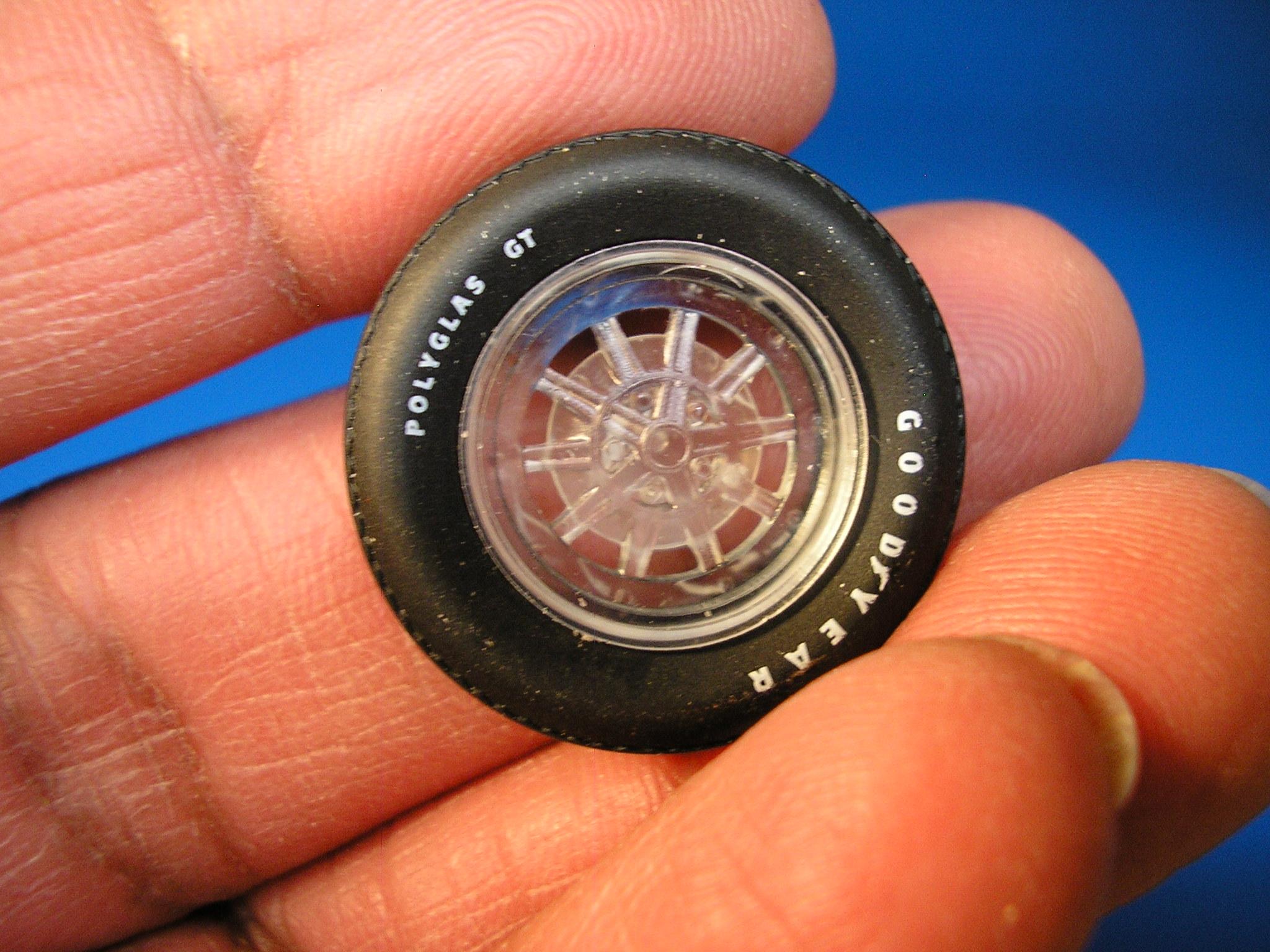

MrObsessive Posted February 5 Share Posted February 5 To buttress what Chris said, there's no 3D printing of clear parts. Every 3D printer I've seen (I now have one), prints parts in some type of colored resin, whether it be gray, black, tan, etc. More than likely, you'd get a part that was first 3D printed, then cast in a clear resin such as these Shelby 10 spoke wheels I got from Mickey Gerace (aka @Superbird McMonte). That's pretty much the best that can be done at the moment. Quote Link to comment Share on other sites More sharing options...

MrObsessive Posted February 5 Share Posted February 5 7 minutes ago, Sandboarder said: https://3dprinterly.com/how-to-print-cure-clear-resin-3d-prints-stop-yellowing/ It can be done. Most like will end up looking like frosted glass but I have seen some good results. I do not 3D print but have seen my friends using clear resins and google comes up with lots of results on the subject. Very interesting! Thanks for the link........I saved it for future reference. 5 minutes ago, Classicgas said: The process of 3d printing would not lend itself to being completely clear. A 3d printed piece is made up of layers of resin, which result in tiny lines across the surface. To eliminate those will require some level of sanding, both things together eliminate any hope of a completely clear part. Yes...........I believe in the case of the wheels I posted, it looks like Mickey cleaned up the wheel, and then later on cast them. I see very little if any of the resolution layers. Quote Link to comment Share on other sites More sharing options...
Classicgas Posted February 5 Share Posted February 5 Yes sir, I completely agree. Those wheels are stunning, if not a bit hard to see lol. 1 Quote Link to comment Share on other sites More sharing options...

Superbird McMonte Posted February 9 Share Posted February 9 On 2/5/2022 at 7:18 AM, MrObsessive said: To buttress what Chris said, there's no 3D printing of clear parts. Every 3D printer I've seen (I now have one), prints parts in some type of colored resin, whether it be gray, black, tan, etc. More than likely, you'd get a part that was first 3D printed, then cast in a clear resin such as these Shelby 10 spoke wheels I got from Mickey Gerace (aka @Superbird McMonte). Hi Bill. The wheels I sent to you were printed with clear resin. I also have clear red for taillights. Although it’s not red enough, I’ve heard a little pigment can be added. 1 Quote Link to comment Share on other sites More sharing options...
