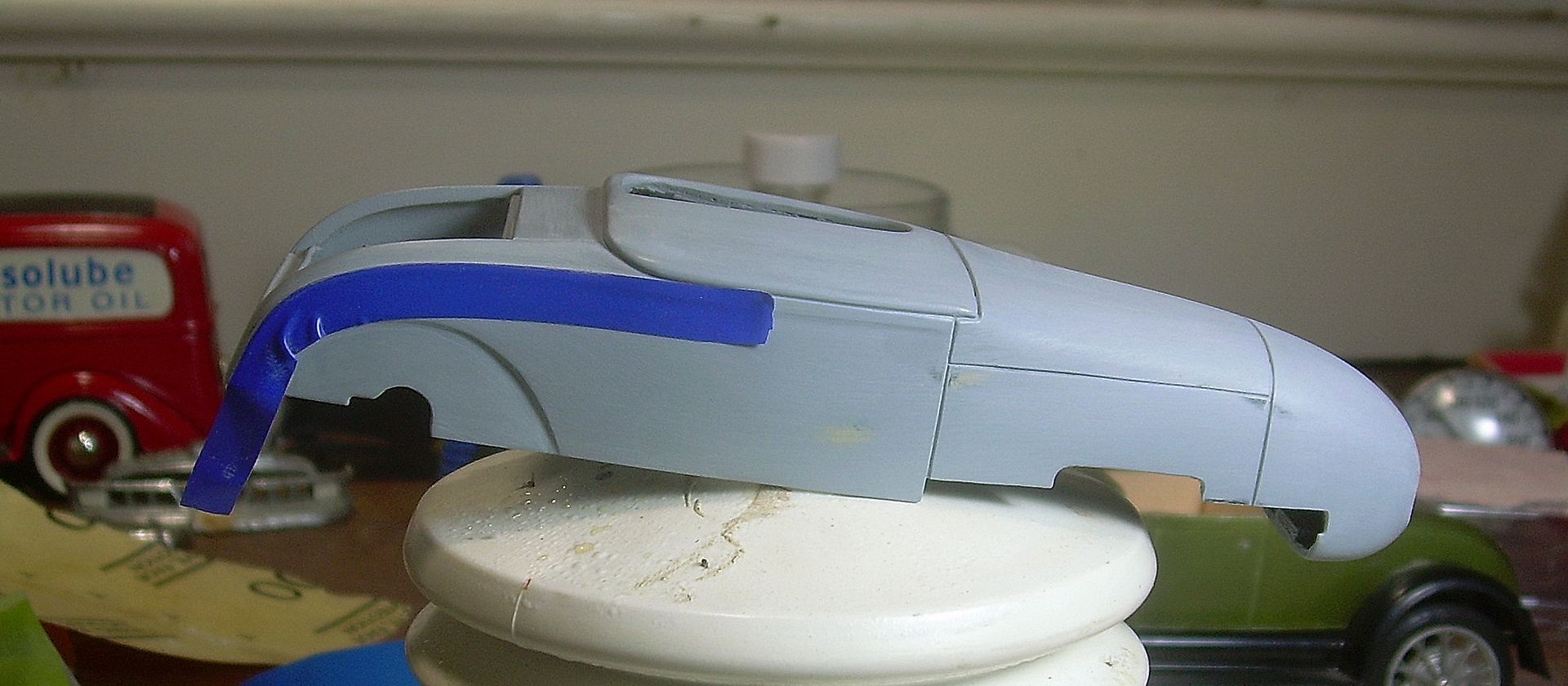

Ace-Garageguy Posted May 22, 2015 Author Share Posted May 22, 2015 Thanks for the link, Joe. I love stuff like that. Thanks to everyone else for the interest, too. I've shot and sanded more than 8 double coats of primer since the last update, and she's getting pretty close. Quote Link to comment Share on other sites More sharing options...

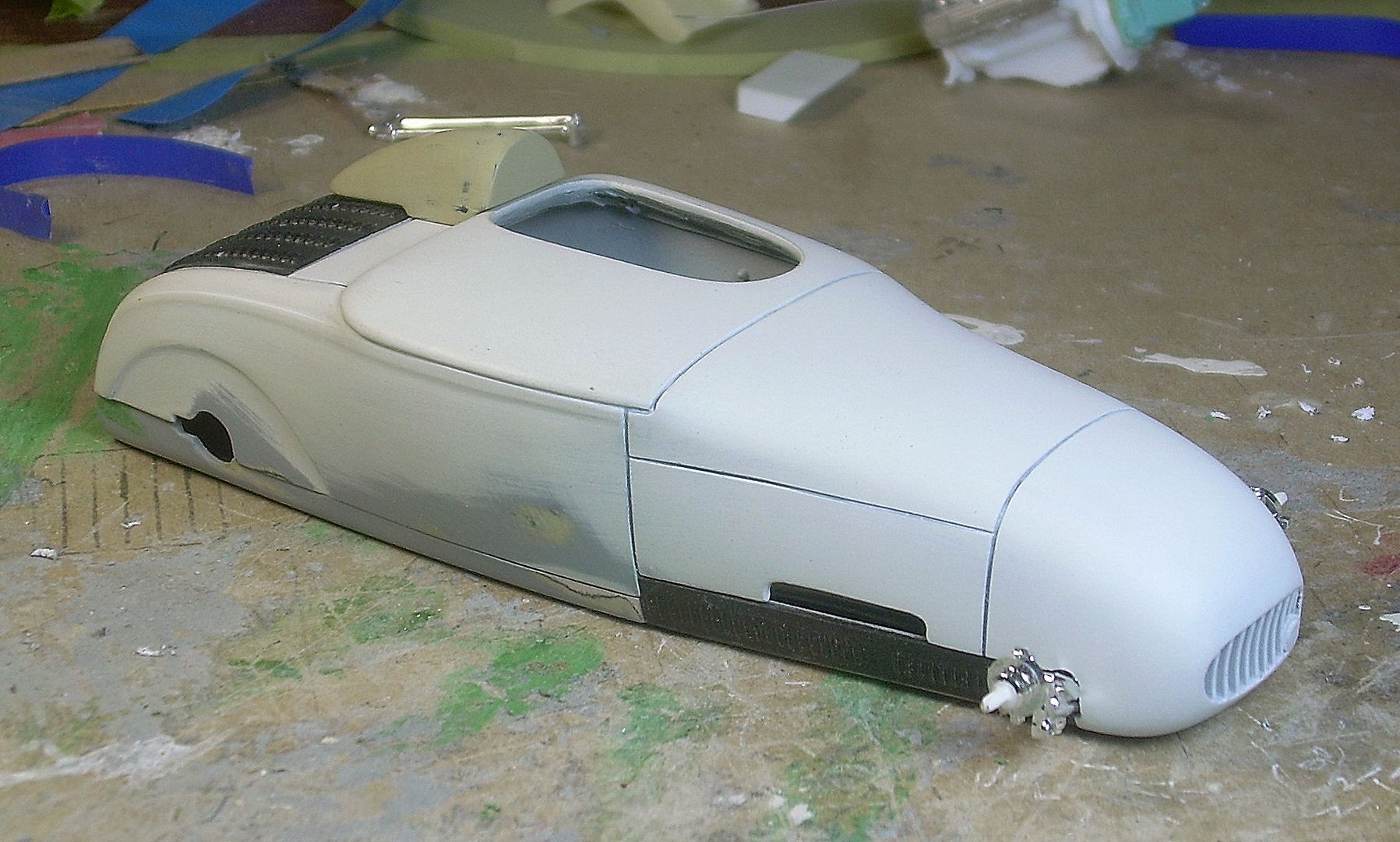

Ace-Garageguy Posted August 30, 2015 Author Share Posted August 30, 2015 (edited) Had some Nikon photo-editor compatibility issues with my new hard-drive in the Win7 machine that weren't there with the old drive, and that took a while to work around...but it works just like it worked in XP now, even better than when I had the old 7 drive. Finally got enough real-life fires put out to grab some bench time these last few evenings. Listening to the local PBS affiliate doing their classic jazz Saturday night program. Life's pretty OK for the moment. I lost a lot of detail due to primer buildup, particularly the (should-be) sharply-sculpted body lines on the rear quarters, and I had to correct them. Also had a devil of a time getting the scribed panel lines straight enough, learned a thing of two in the process. Now she's in Duplicolor white primer, getting very close. I still have to make the center panel for the forward bellypan, and finalize the header openings, then just a little more 600-800 grit sanding of some areas. The body lines on the quarters are still a little too fat and vague, but I have a method worked out to slim them down and sharpen them a bit more. Edited August 30, 2015 by Ace-Garageguy Quote Link to comment Share on other sites More sharing options...

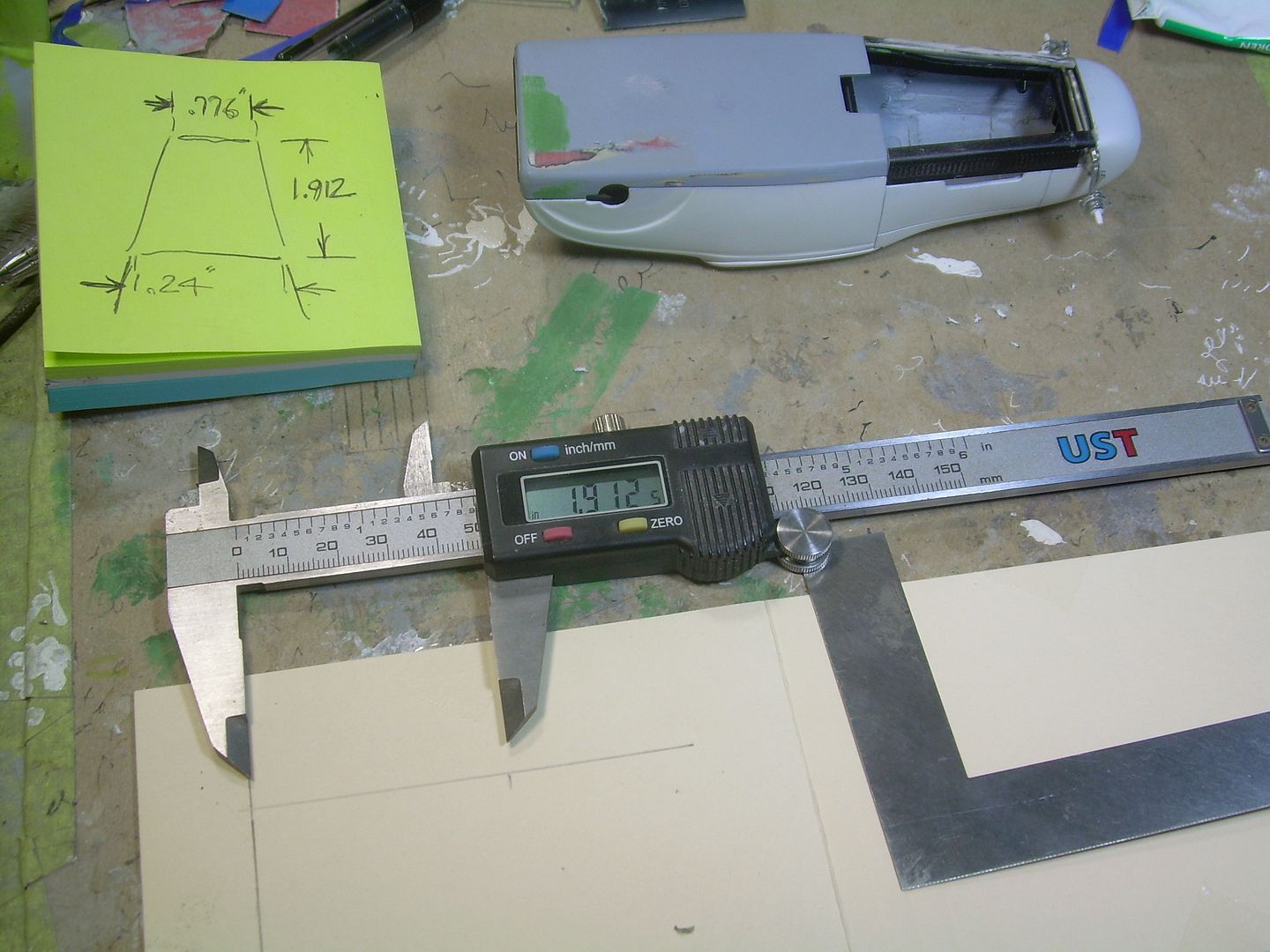

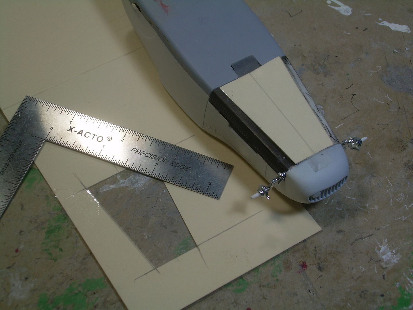

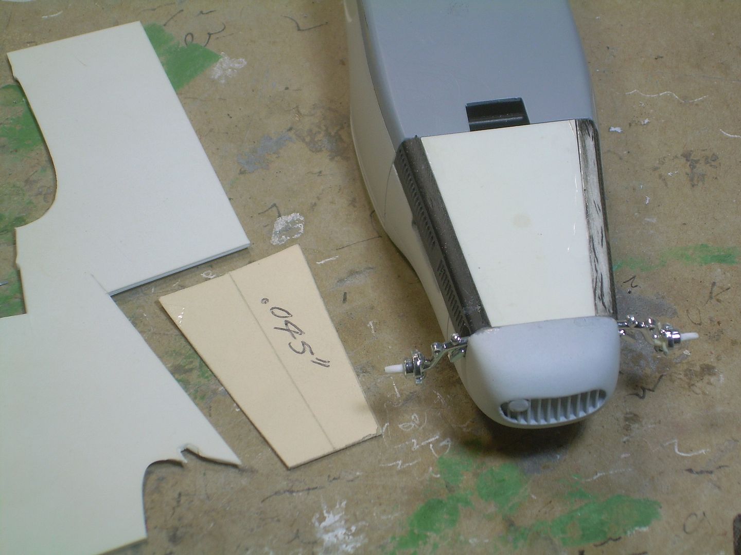

Ace-Garageguy Posted August 30, 2015 Author Share Posted August 30, 2015 Got the filler panel for the front bellypan made. Measured, laid it out on cardstock, cut a pattern. Checked the pattern for fit in the hole. Transferred the pattern to .045" styrene, glued in place. Won't be primering today...need to let this get fully set up. Quote Link to comment Share on other sites More sharing options...
