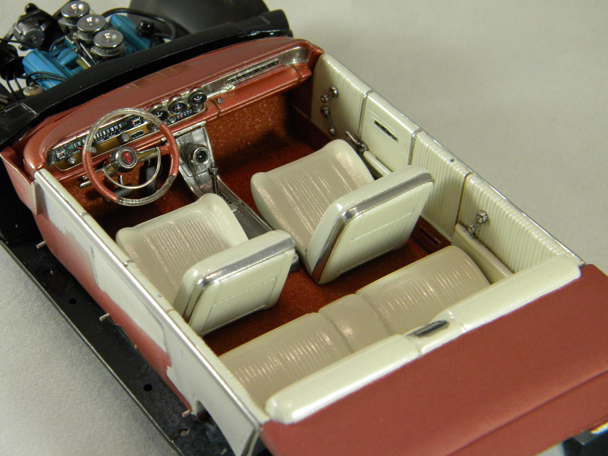

Actually it usually looks better in my opinion to apply a colored embossing powder that is close to the interior color over the painted floor rather than paint it the exact same color as everything else. Carpet is rarely exactly the same color as the rest of the interior, so it looks great to have a little contrast. Steve
