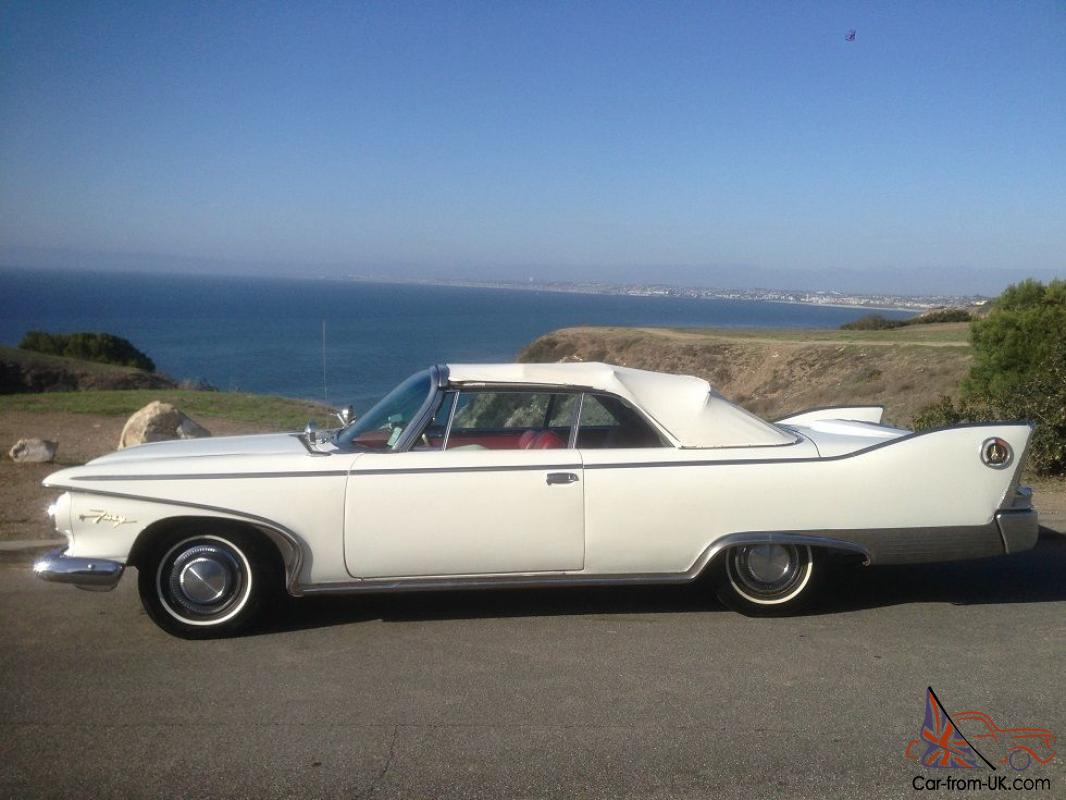

Actually Joe, that "bulge" at the top of the glass is not entirely incorrect. While it is overly pronounced, many of the '60 Mopars had this bulge in the glass. The Plymouths and Dodges had them & it appears that at least some of the Desotos did as well. It appears that at least with the Desotos, it depended upon the model, although I have seen photos of Adventurers with either one. Possibly an option? Steve -
