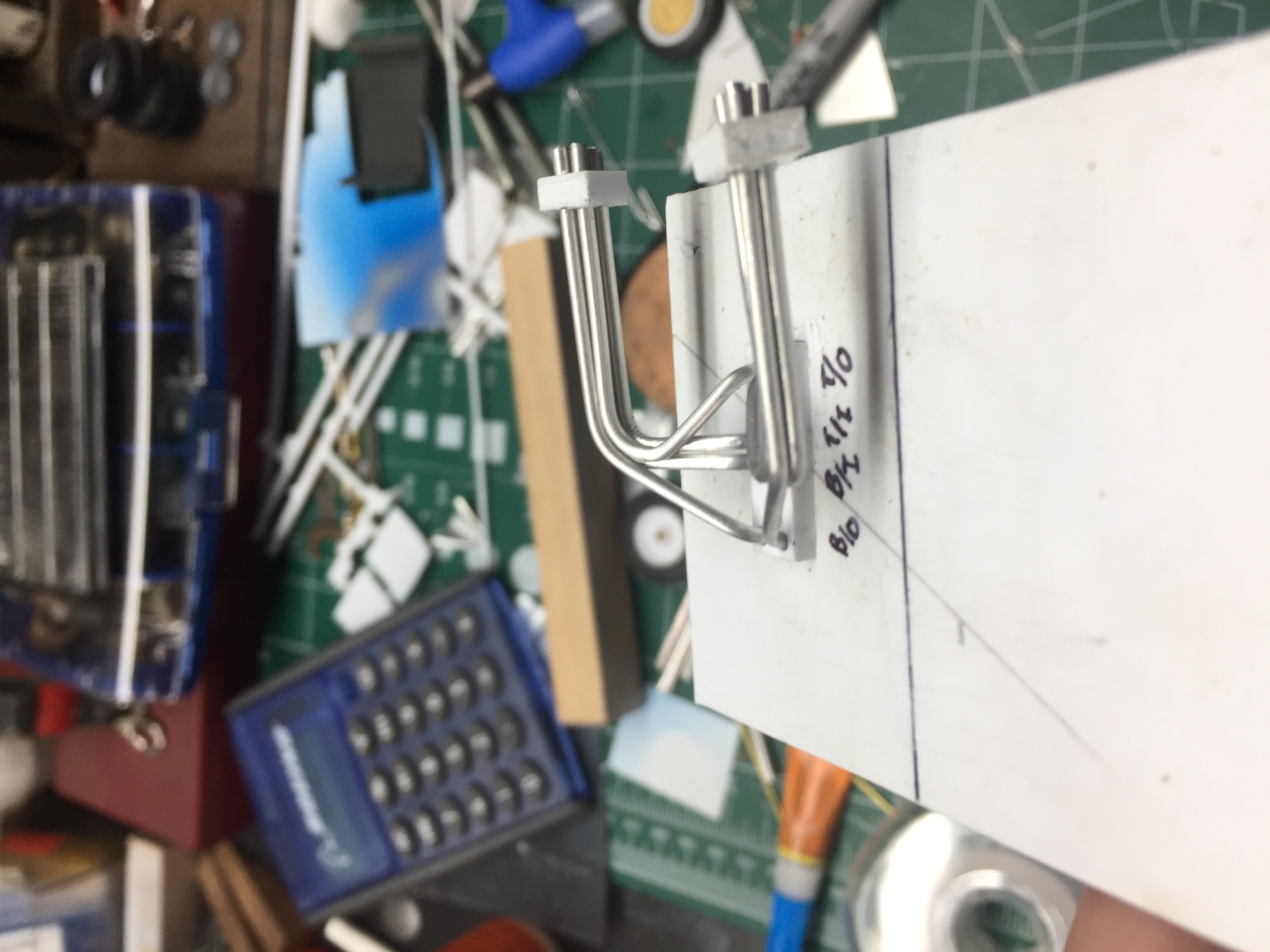

  2. Now I just measured 1/16 rod two inches long cut four of them and go by eye to what looks good, except for the first bend which is 120 degrees back.

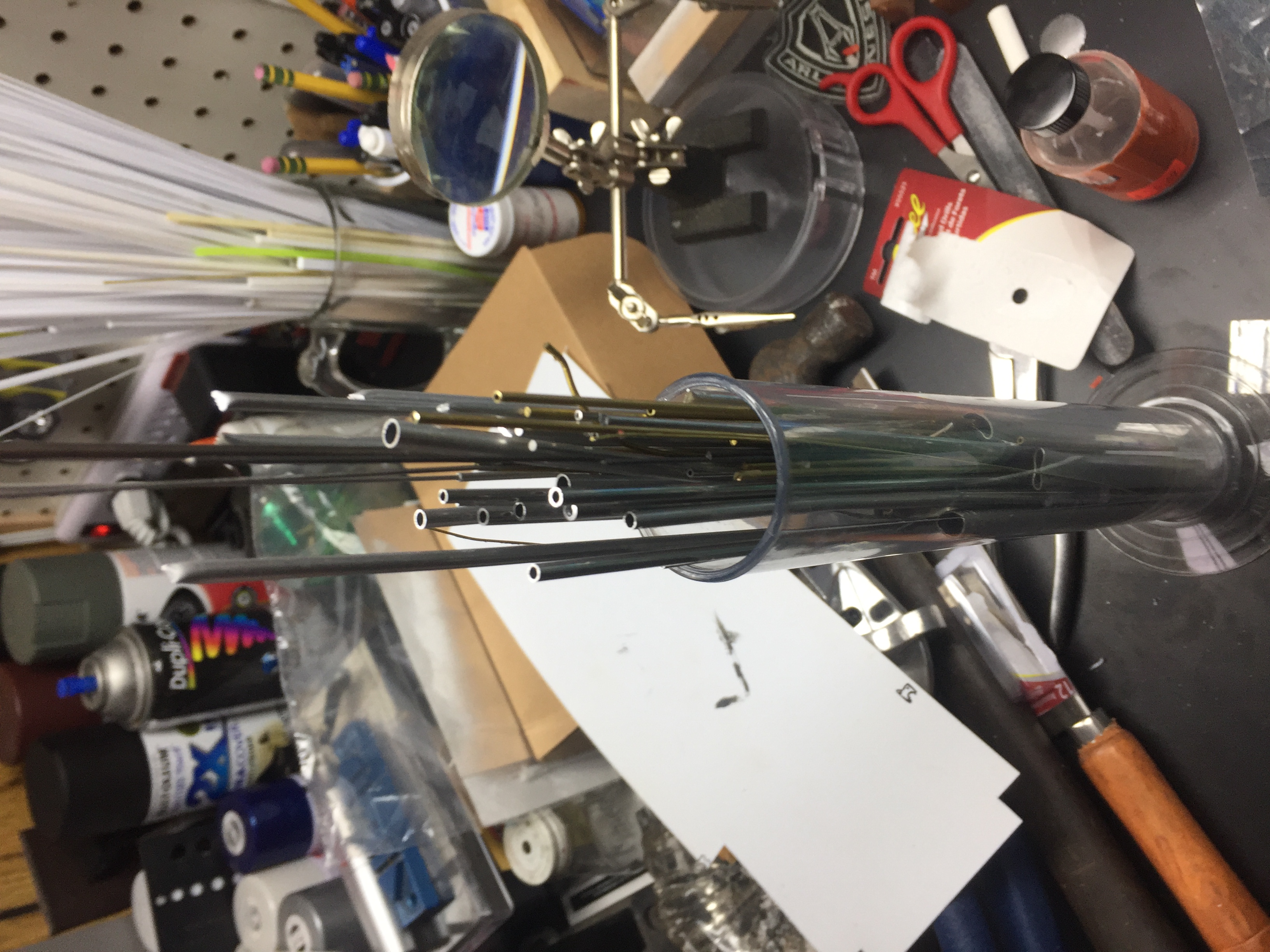

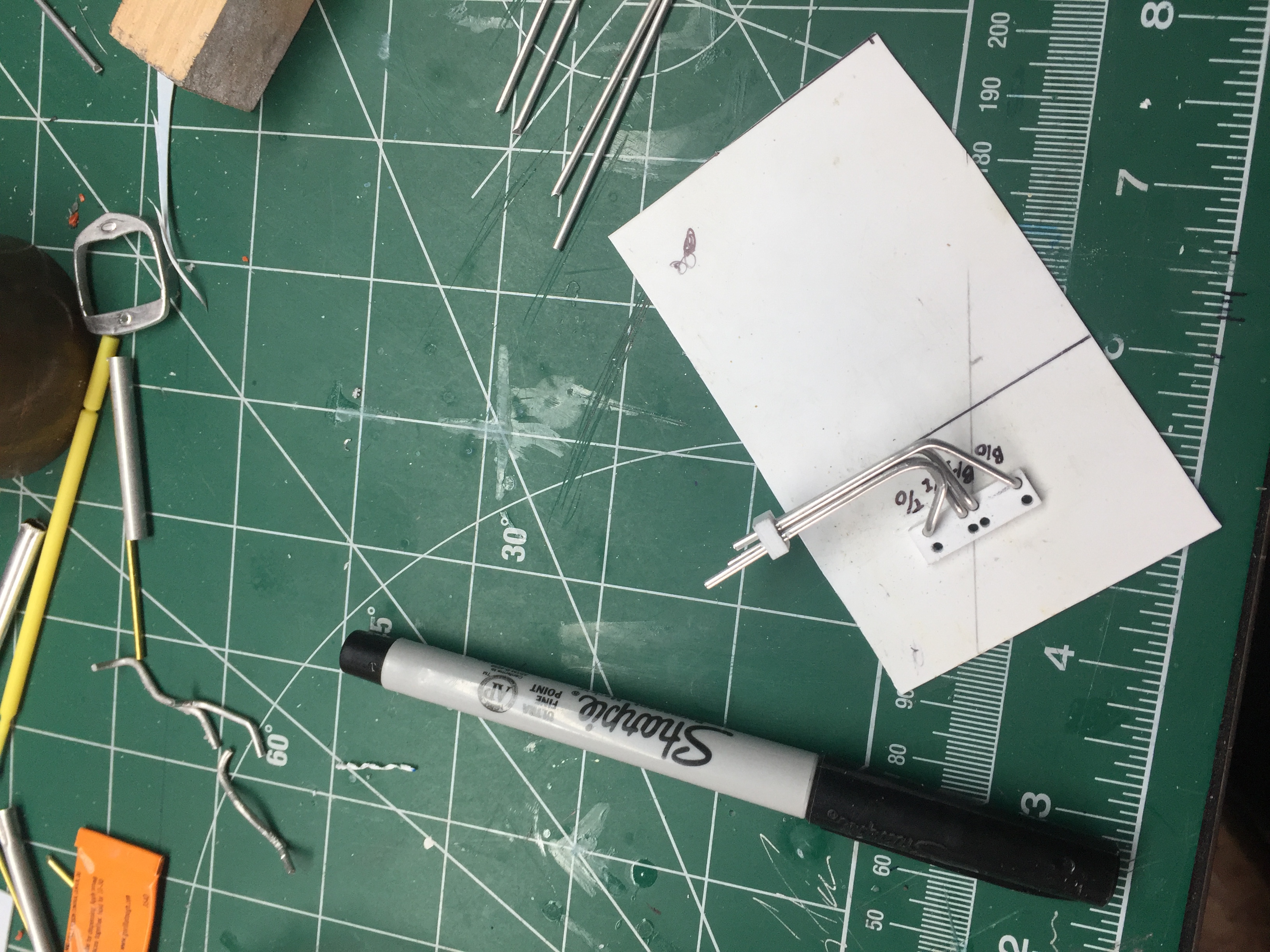

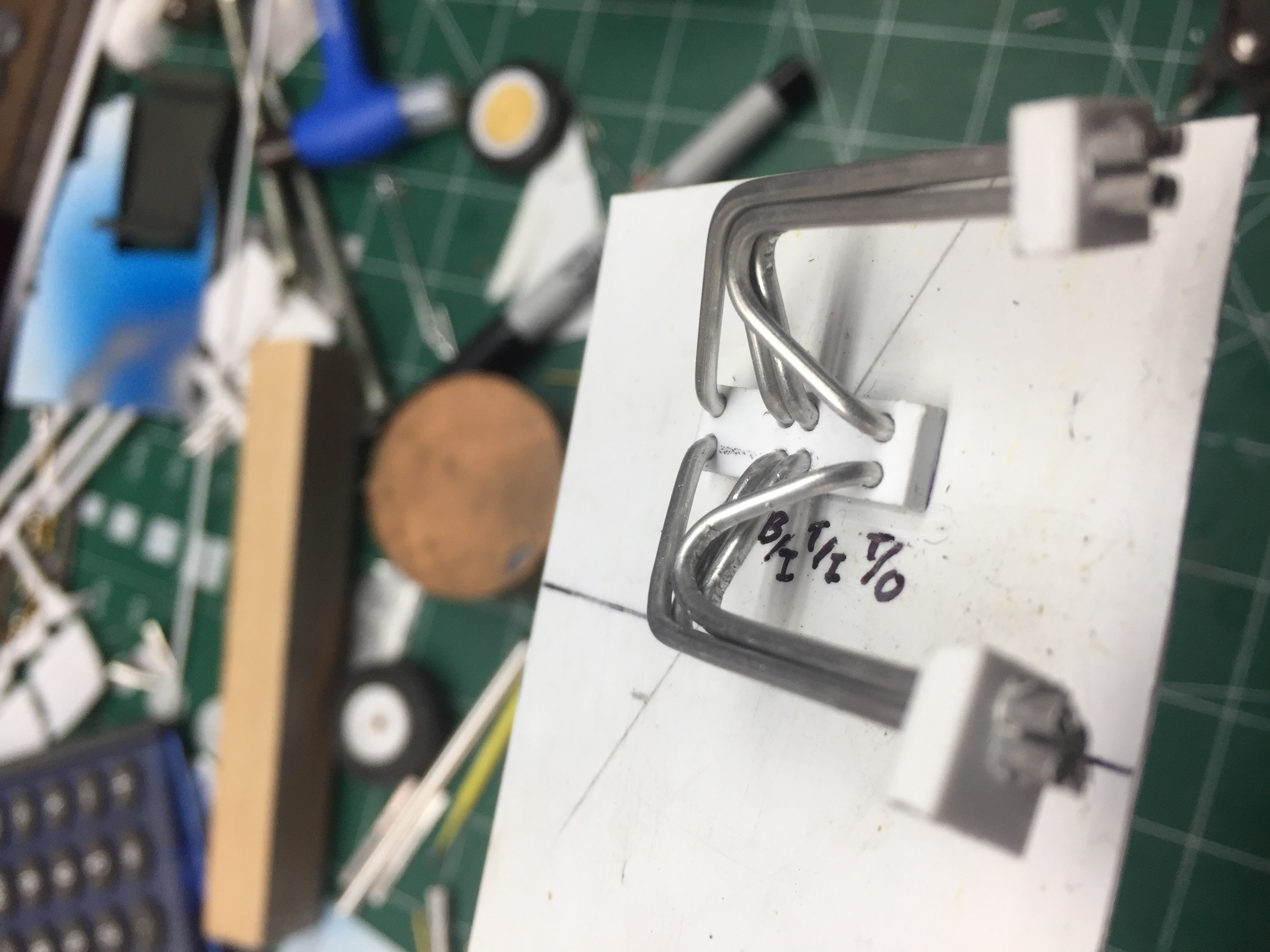

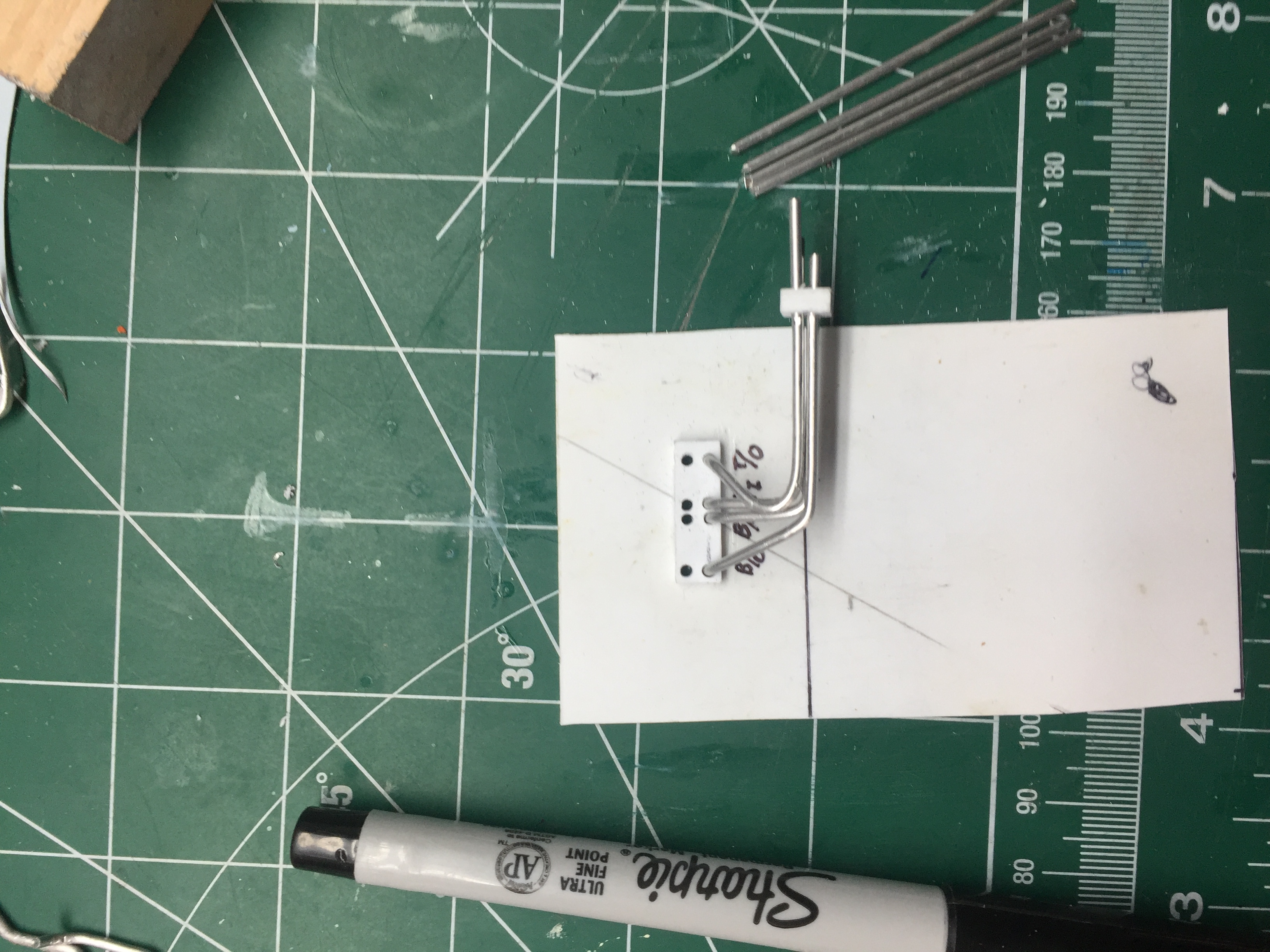

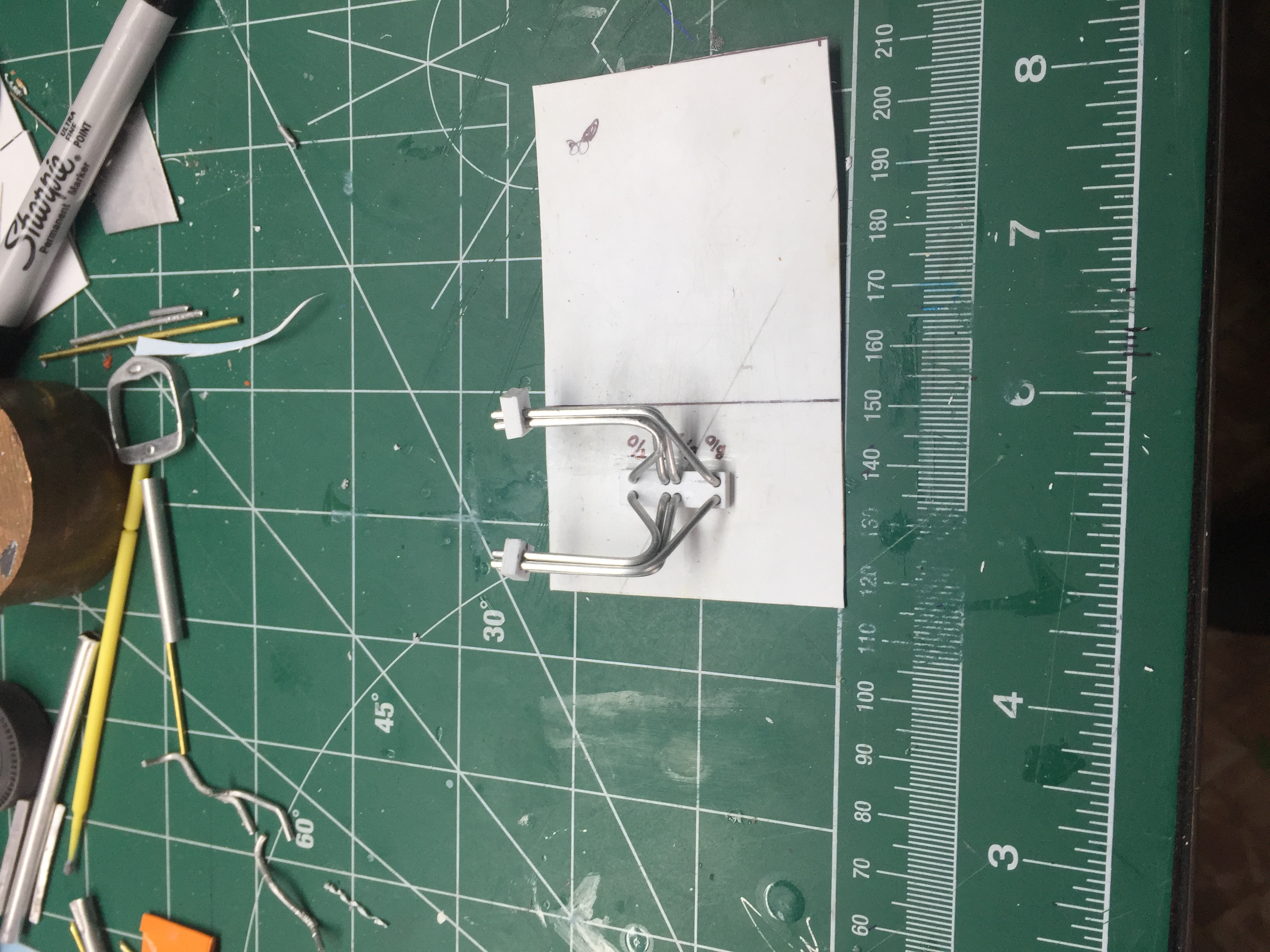

  3. Well been awhile sense I could work on the rod. It came to mind that I need some exhaust for the rod, and I just love sprint car exhaust. None come in any kits that will fit so naturally I must make them. I fiddled around and wasted 1/16, till l thought make a jig. I'm sure I'll make more than one set . So I started with my hydrometer tube full of K S material.

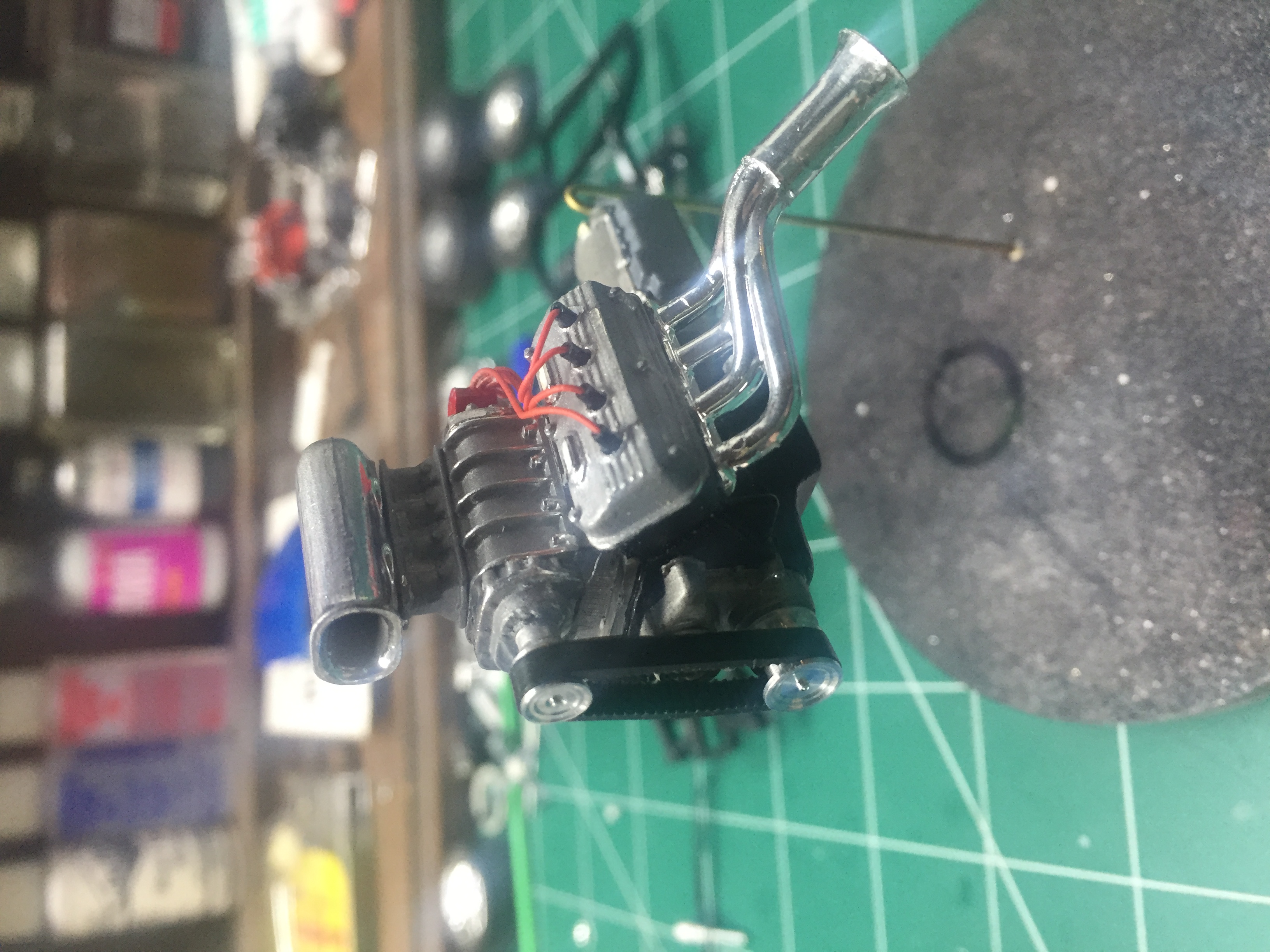

  5. That LS looks awesome.

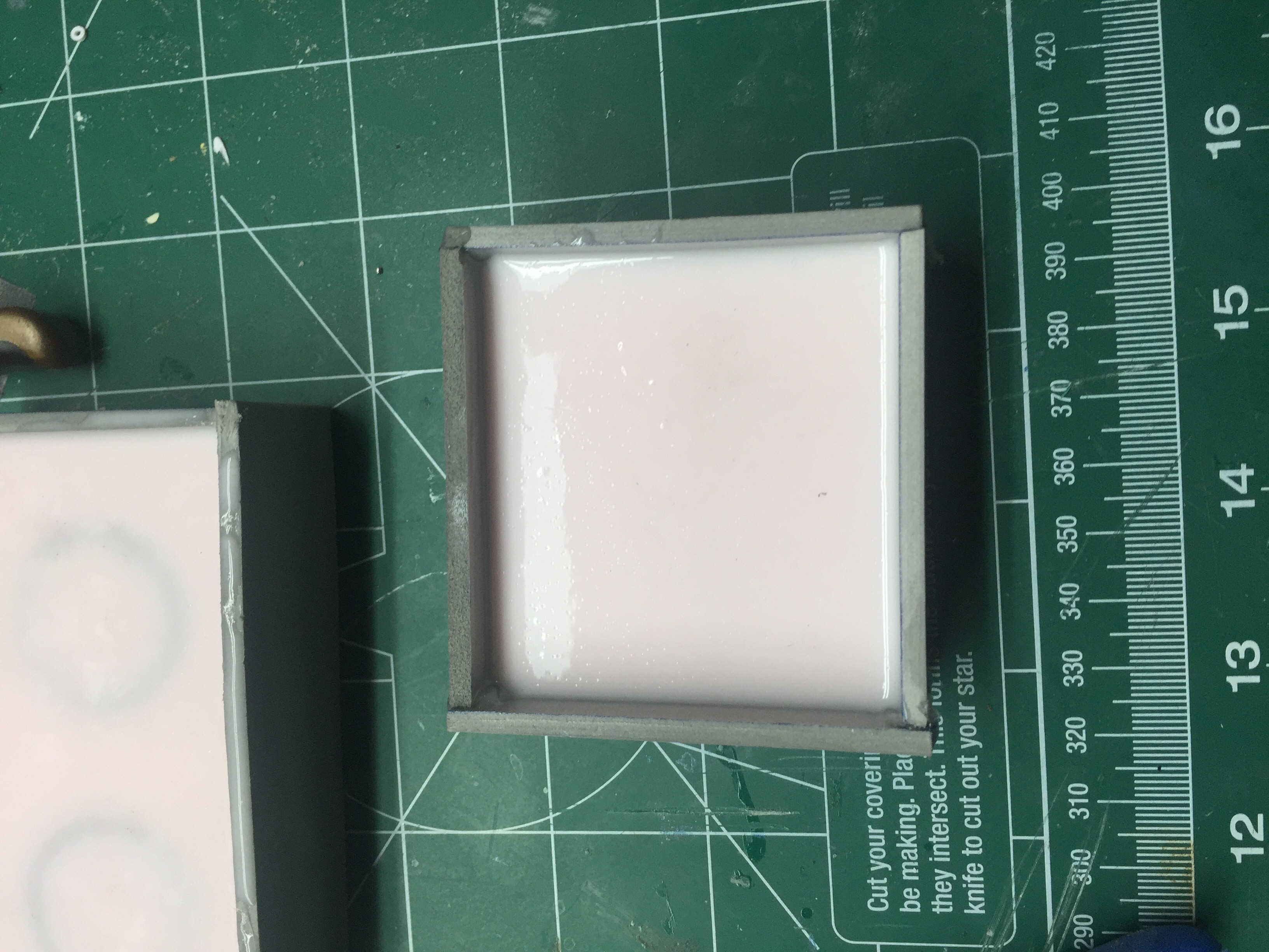

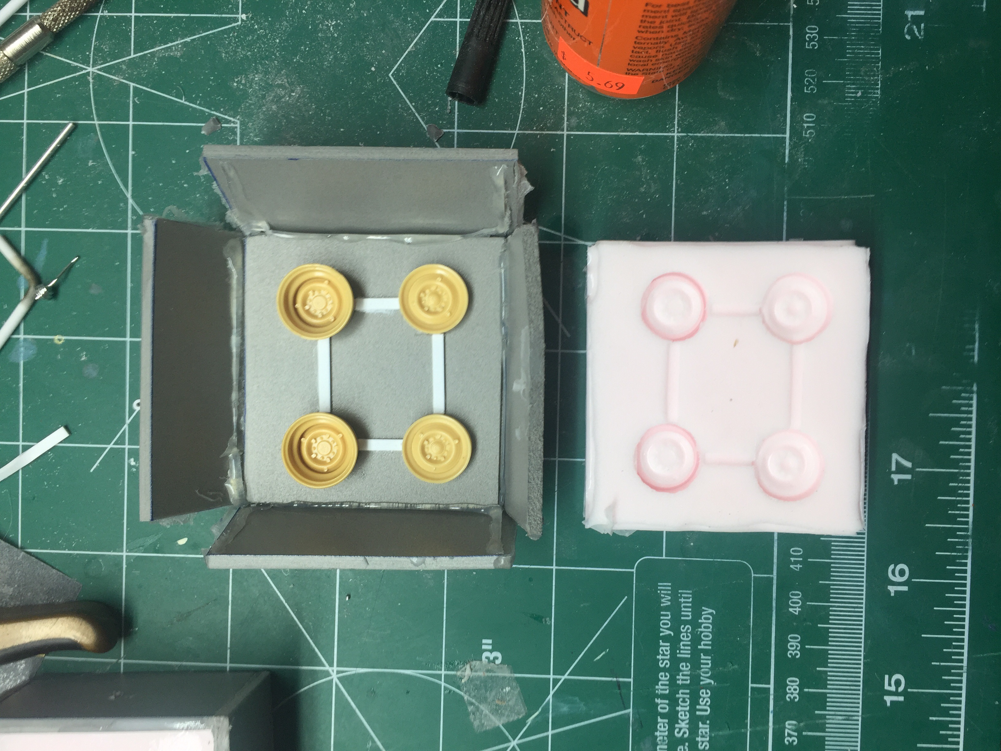

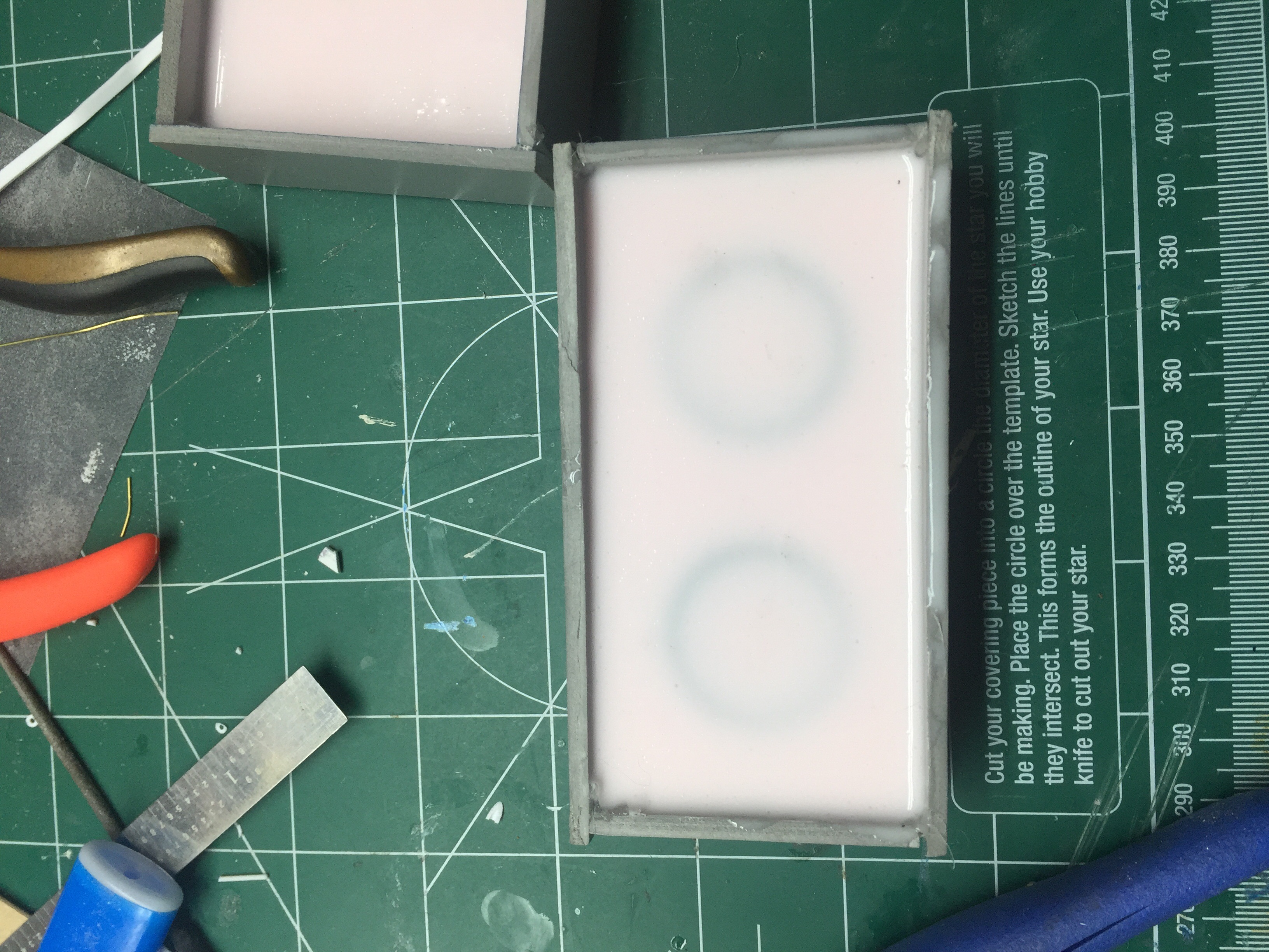

  6. I have my wheels and tires in the mold.

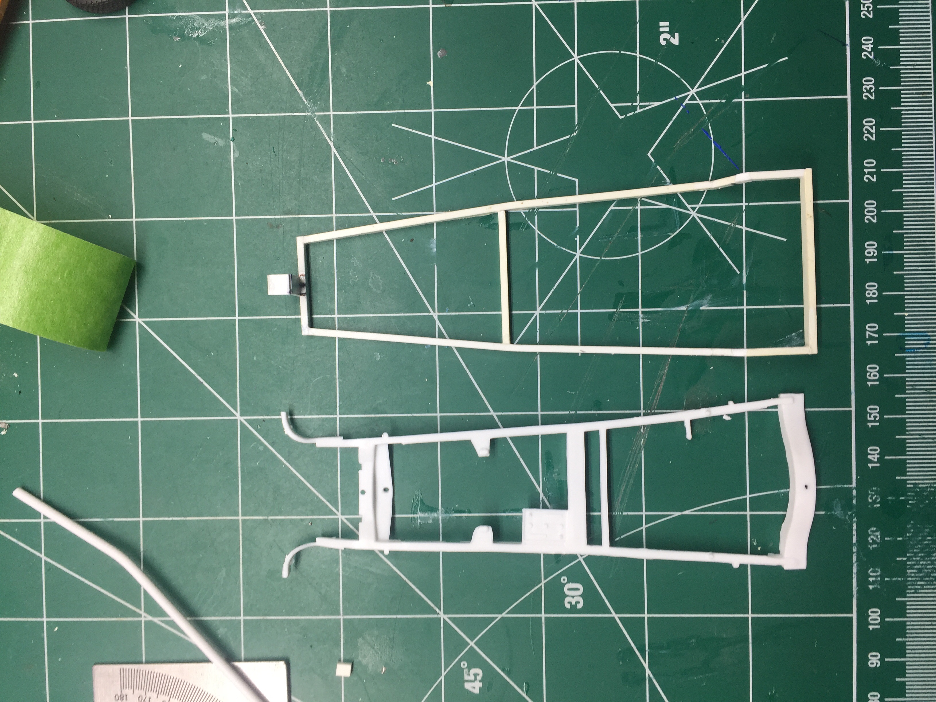

  7. Got more done on the frame. This has really turned out to be fun.

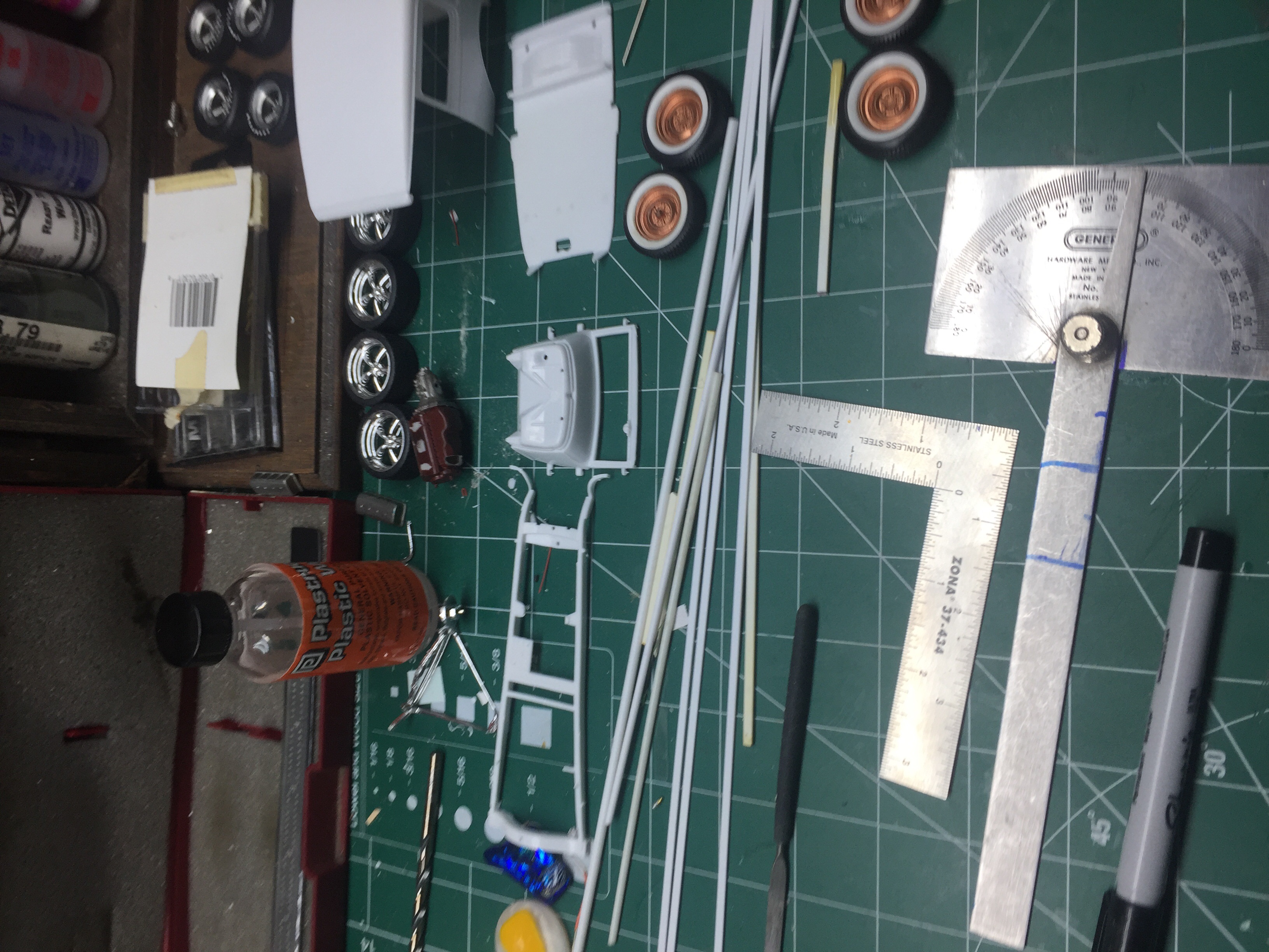

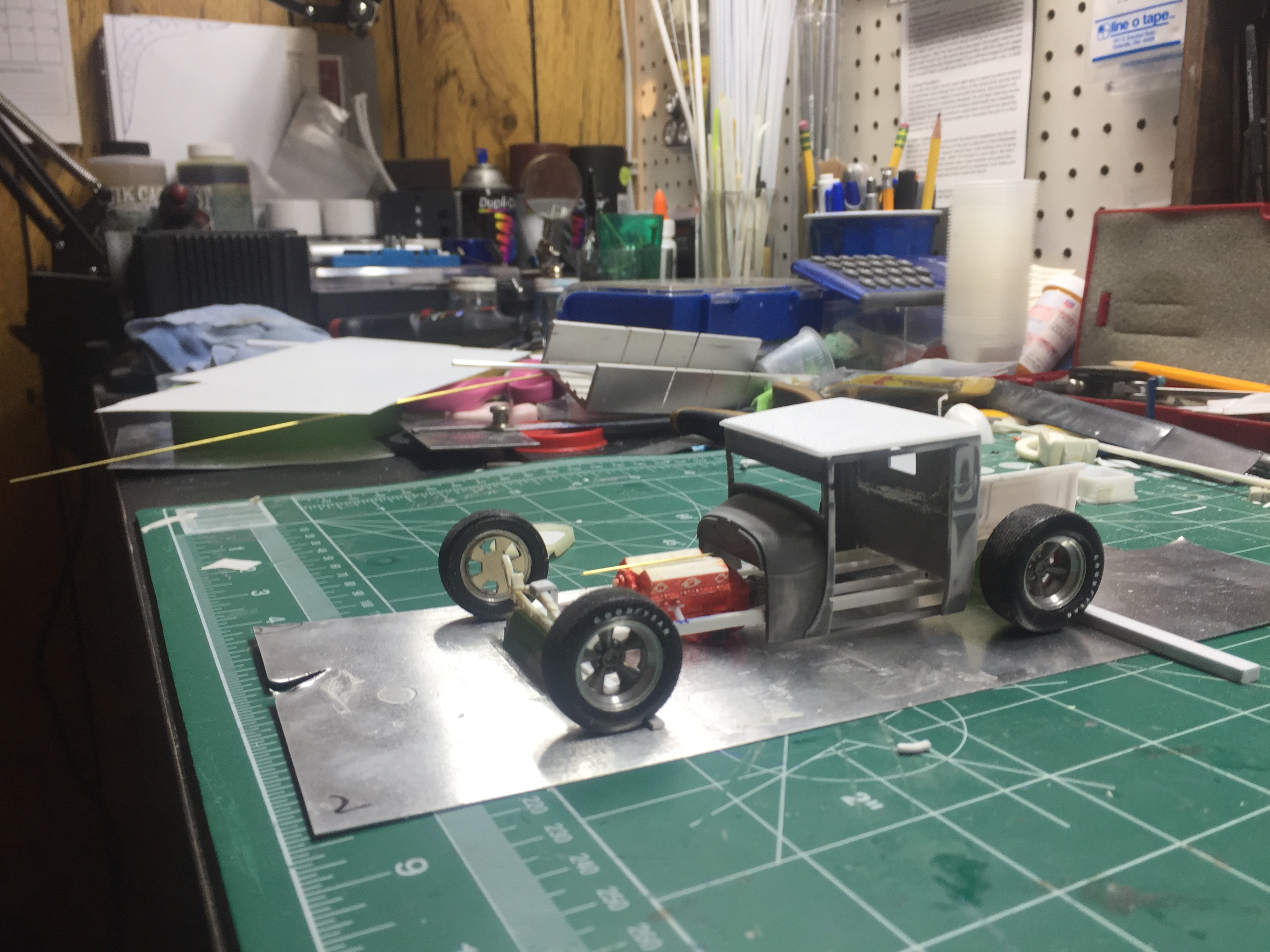

  11. Well working on the rat. Figured I'd do a 29 truck.

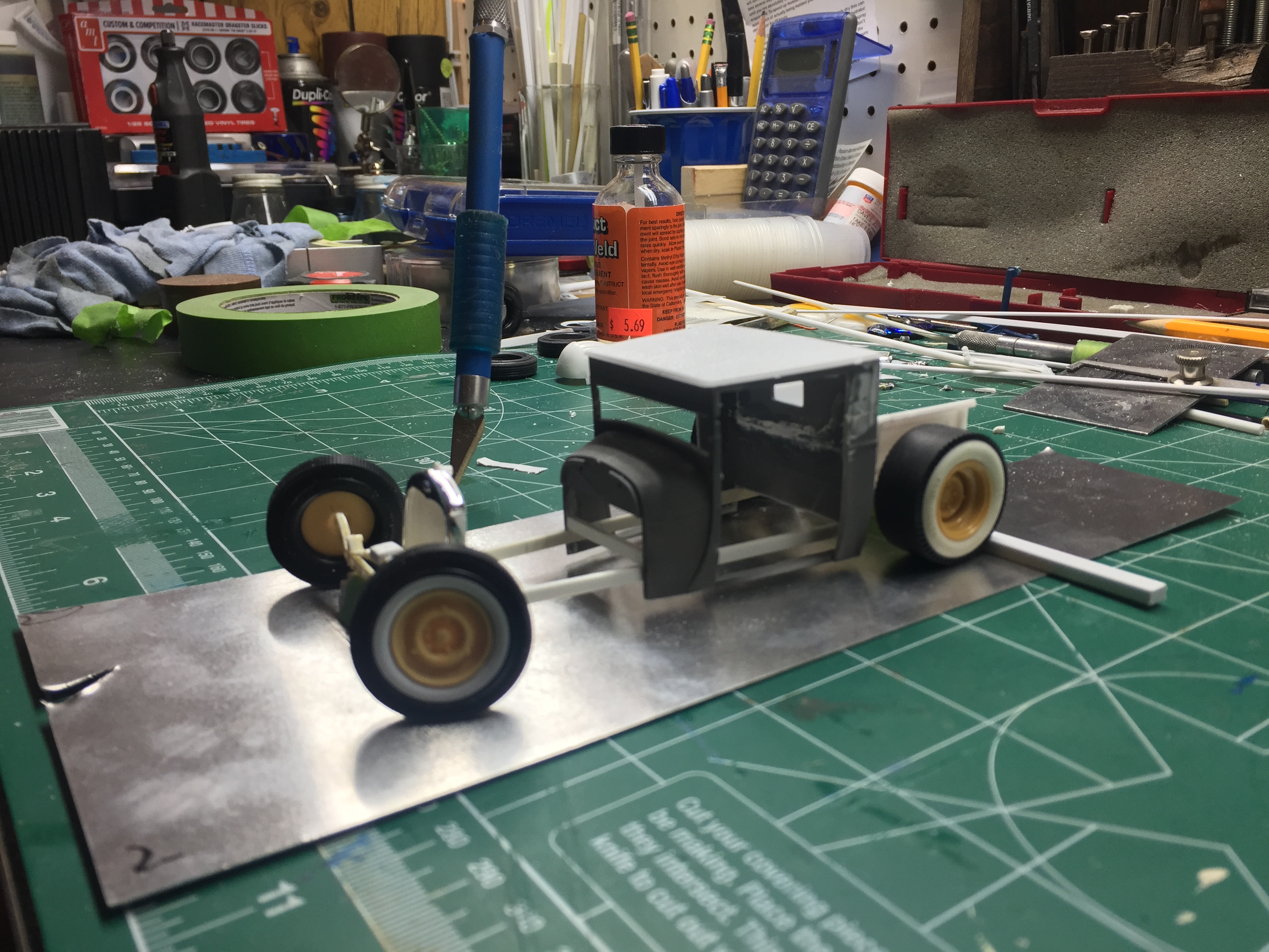

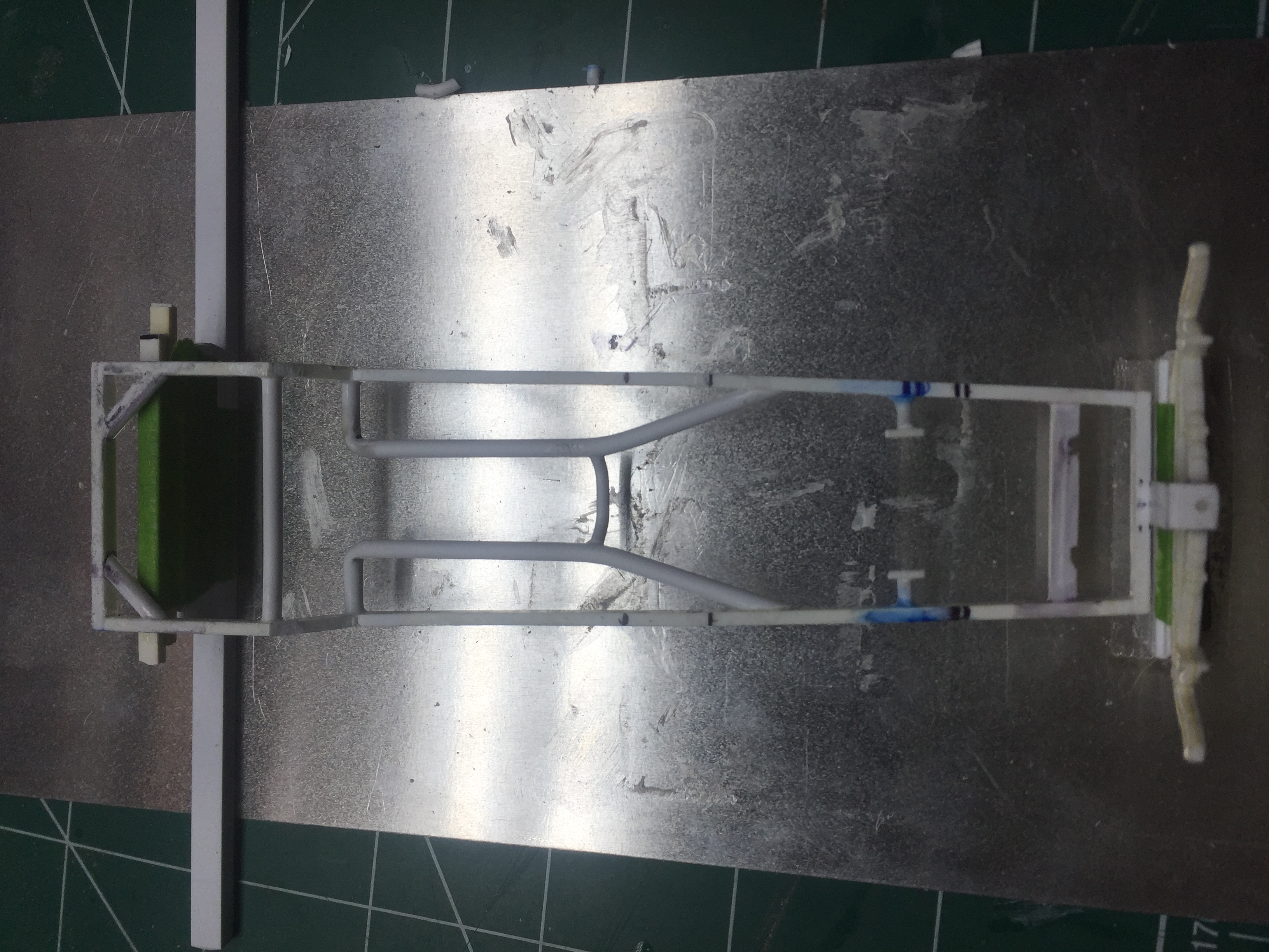

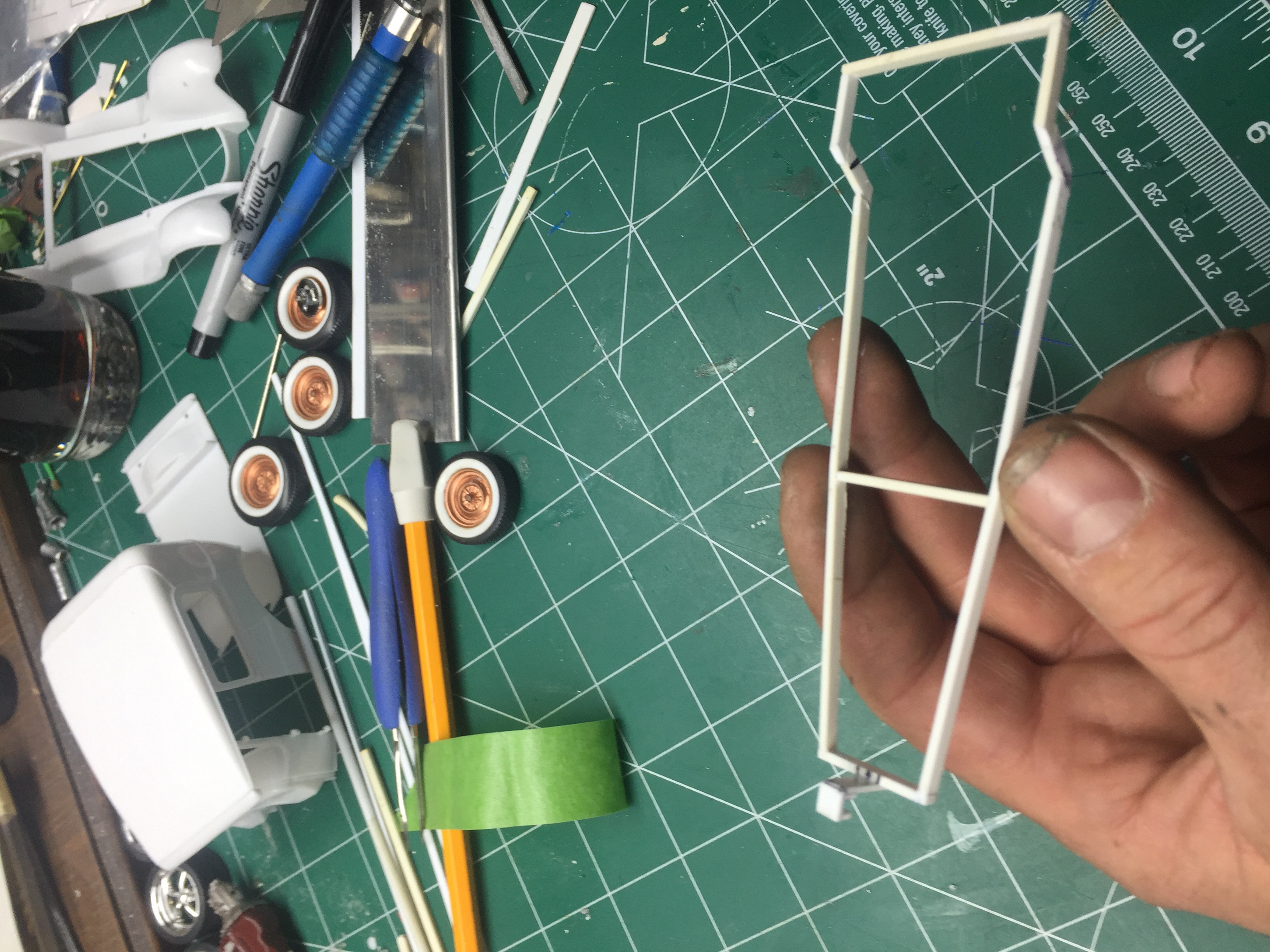

  12. Cool biuld Brad. Let's have some up dates. I'm scratch building a frame for a sedan in the topic Bored.

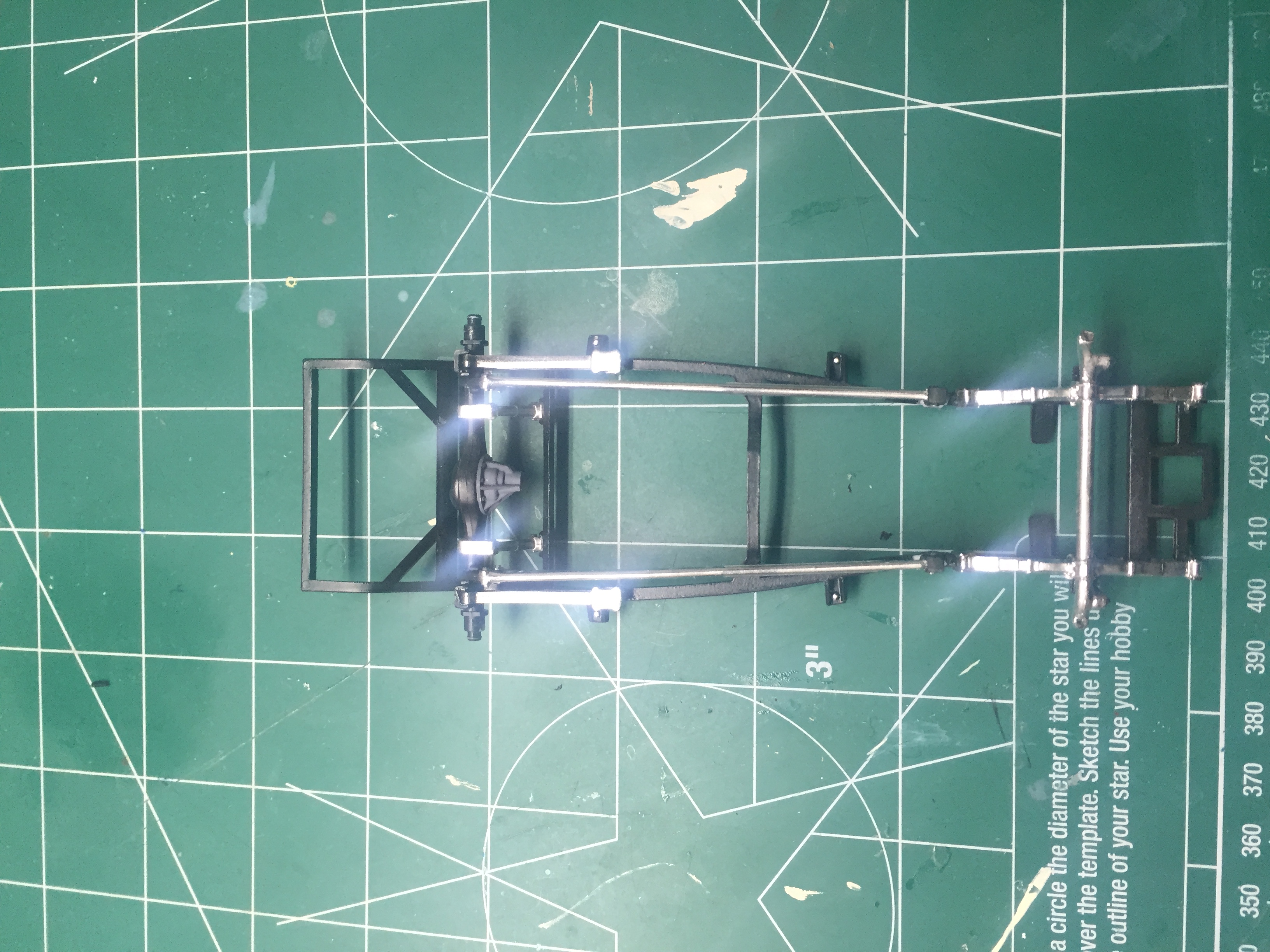

  13. Thanks Bernard, I just realized you're in Seattle! I'm just getting my feet wet with this. I try to imagine doing it in 1/1, and use the math to translate. There are so many ways to make a frame that you can't possibly see them all in a lifetime. Thanks to you Patrick. I'm just going on necessities and then using my imagination to cool it up. I'm just getting started and that's half the battle. Thx to both cheers.

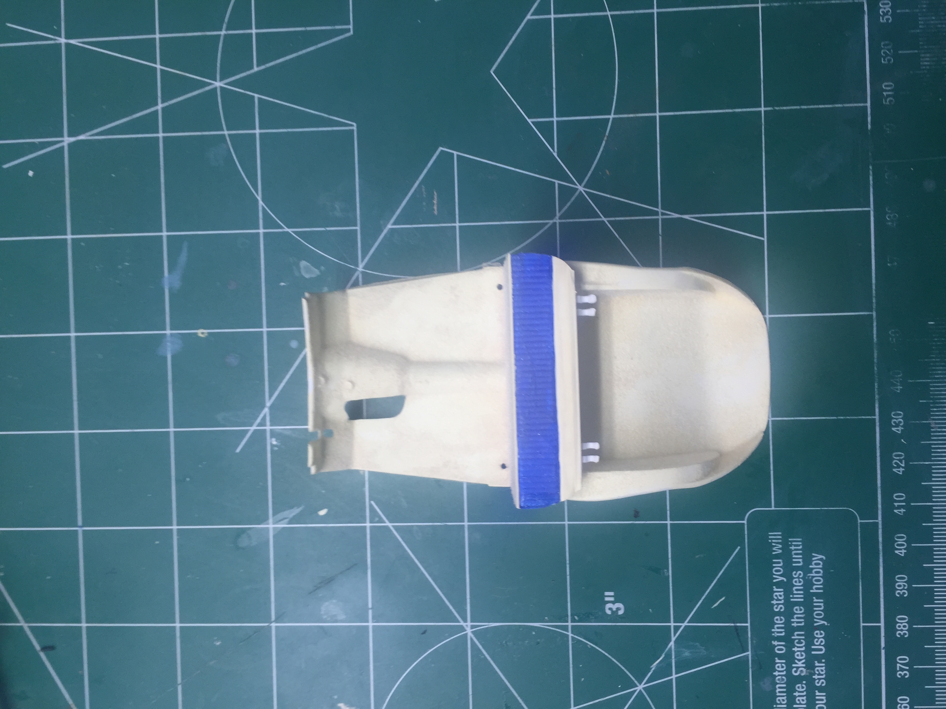

  15. jaftygas
    Bored

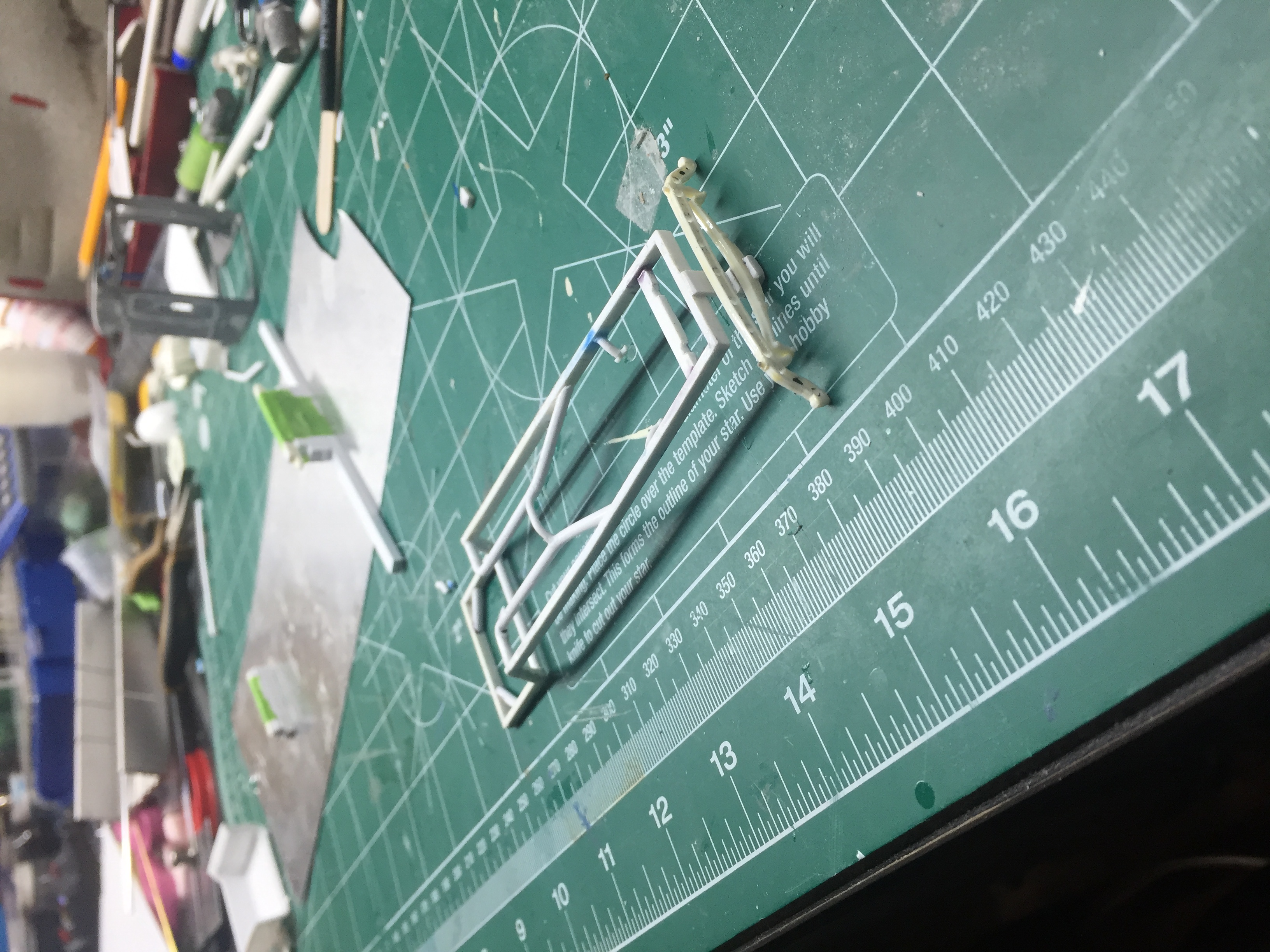

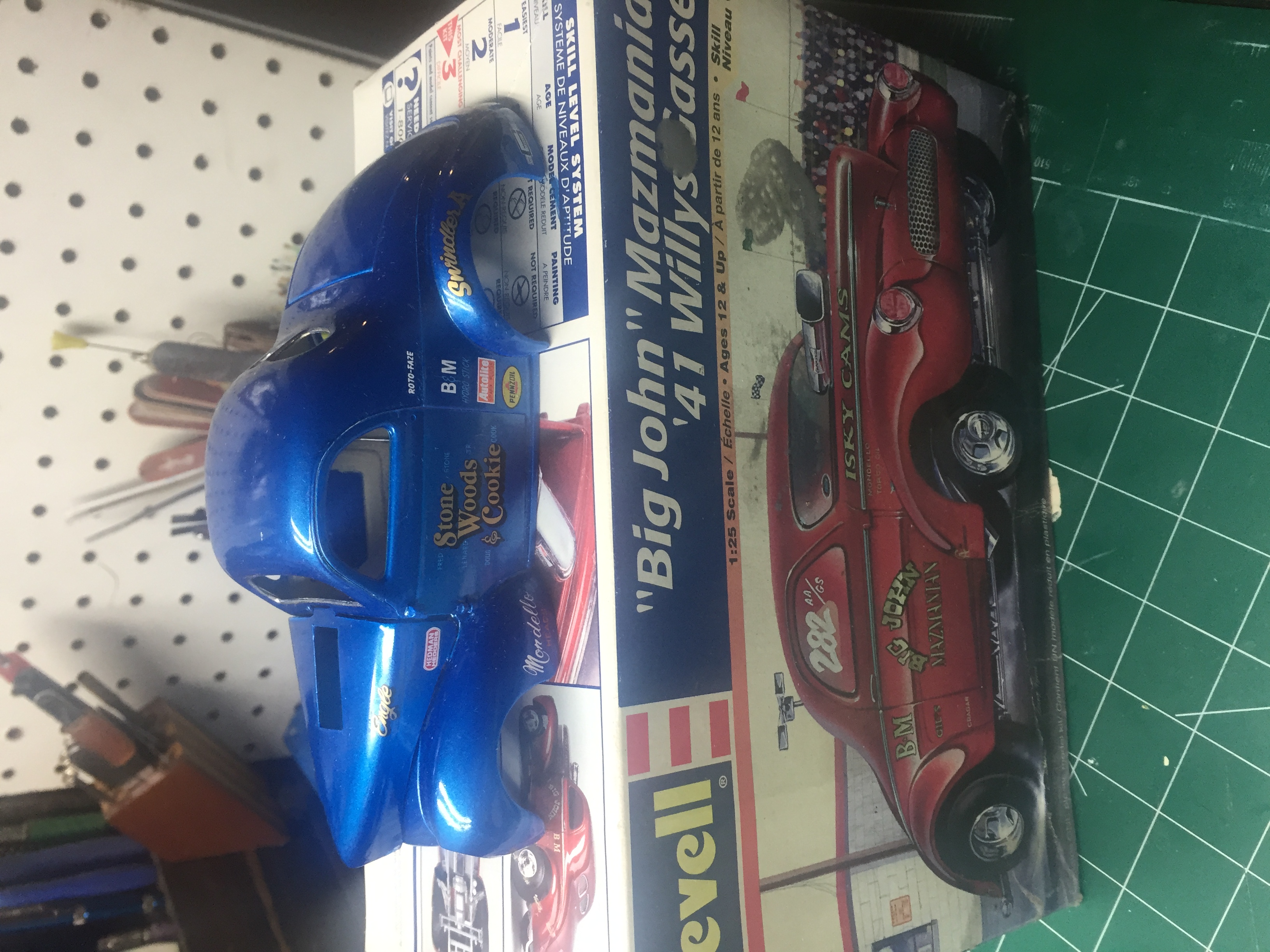

    well what to do? The stone woods and cook is on hold, so with the inspiration from Bernard, you know who you are! I'm going to try scratch building a rat rod chassis. Wish me luck.

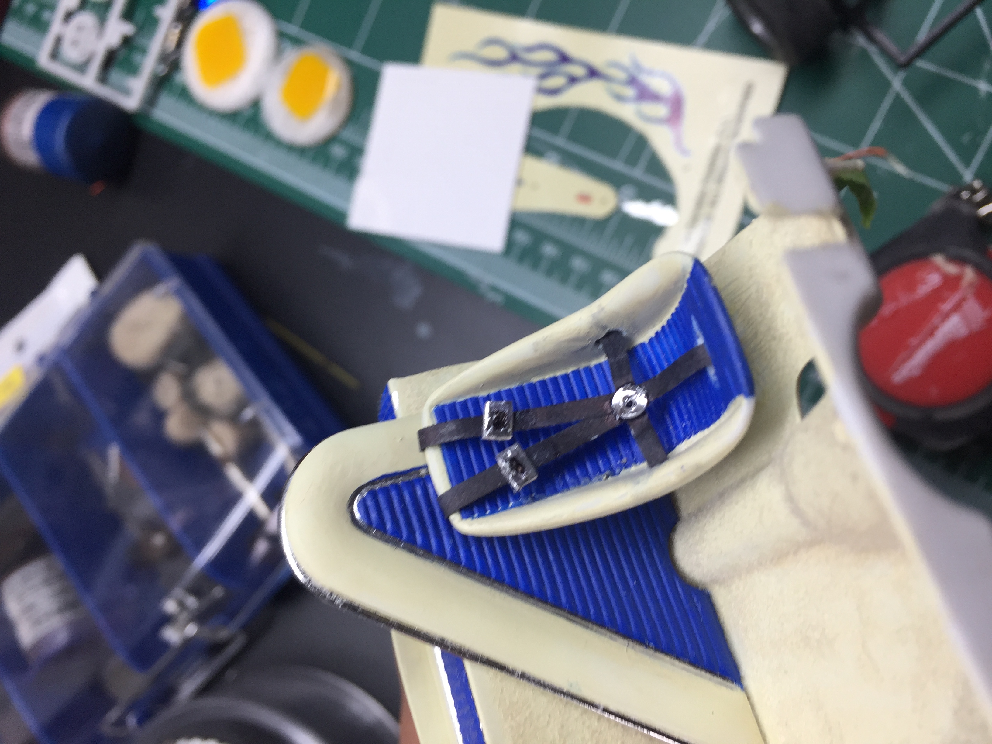

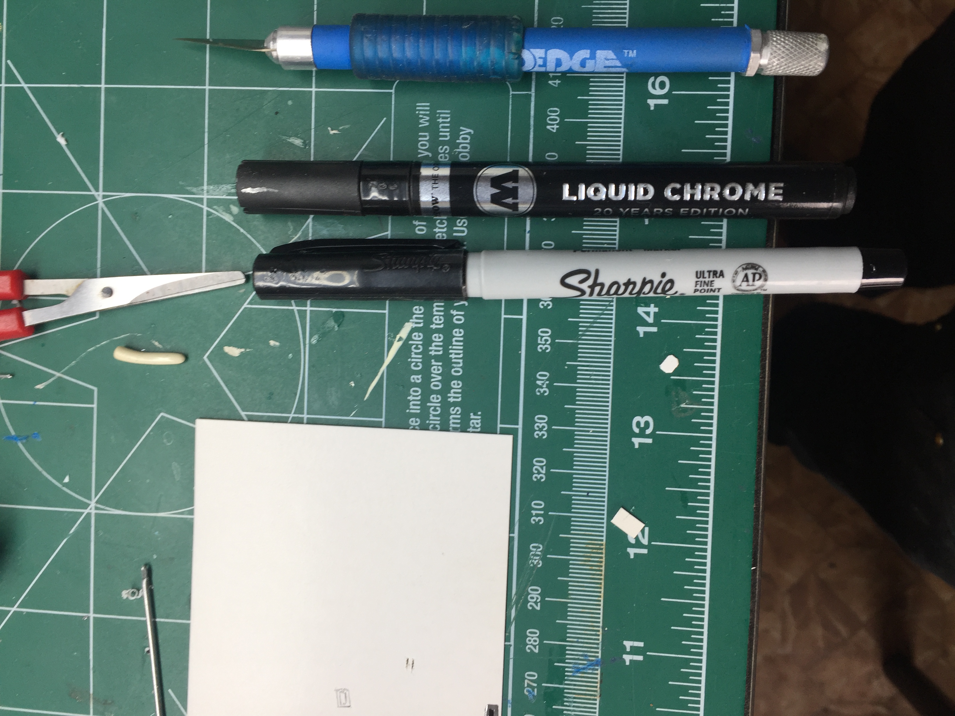

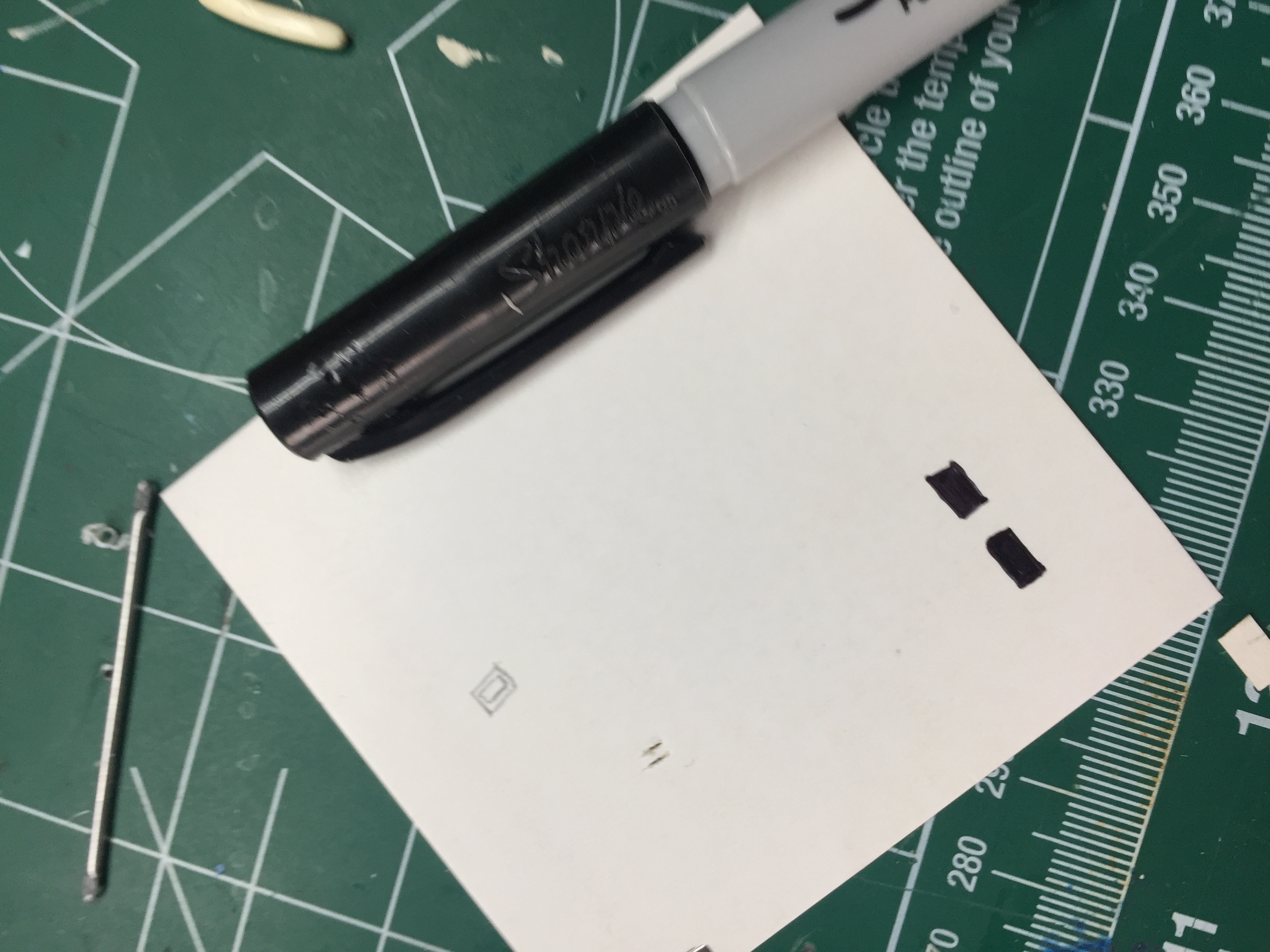

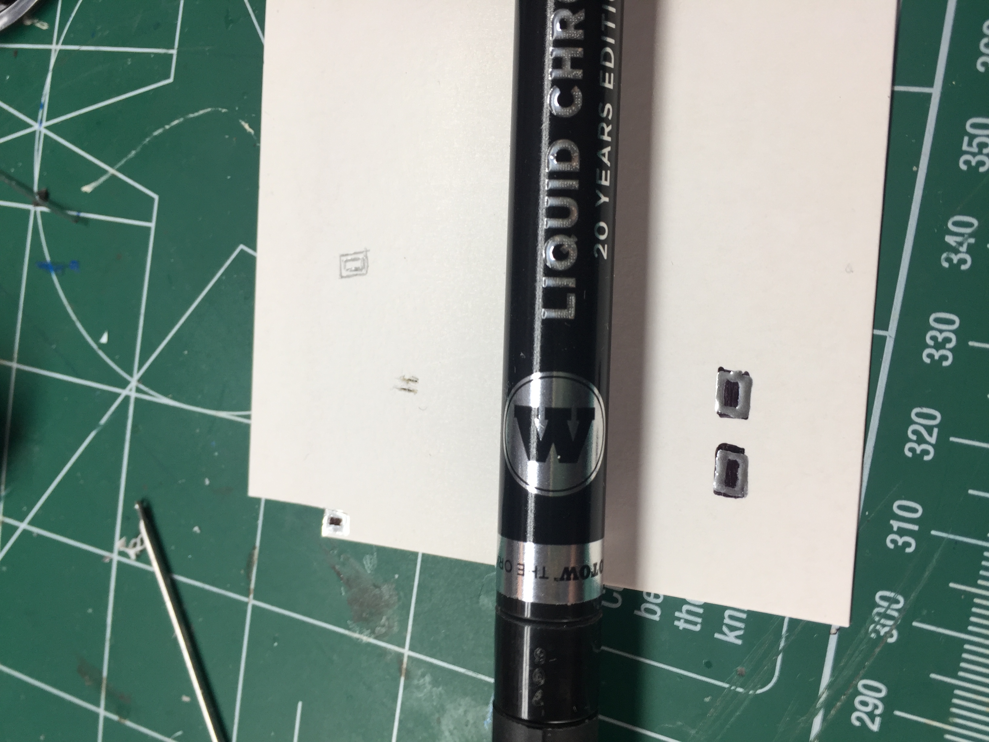

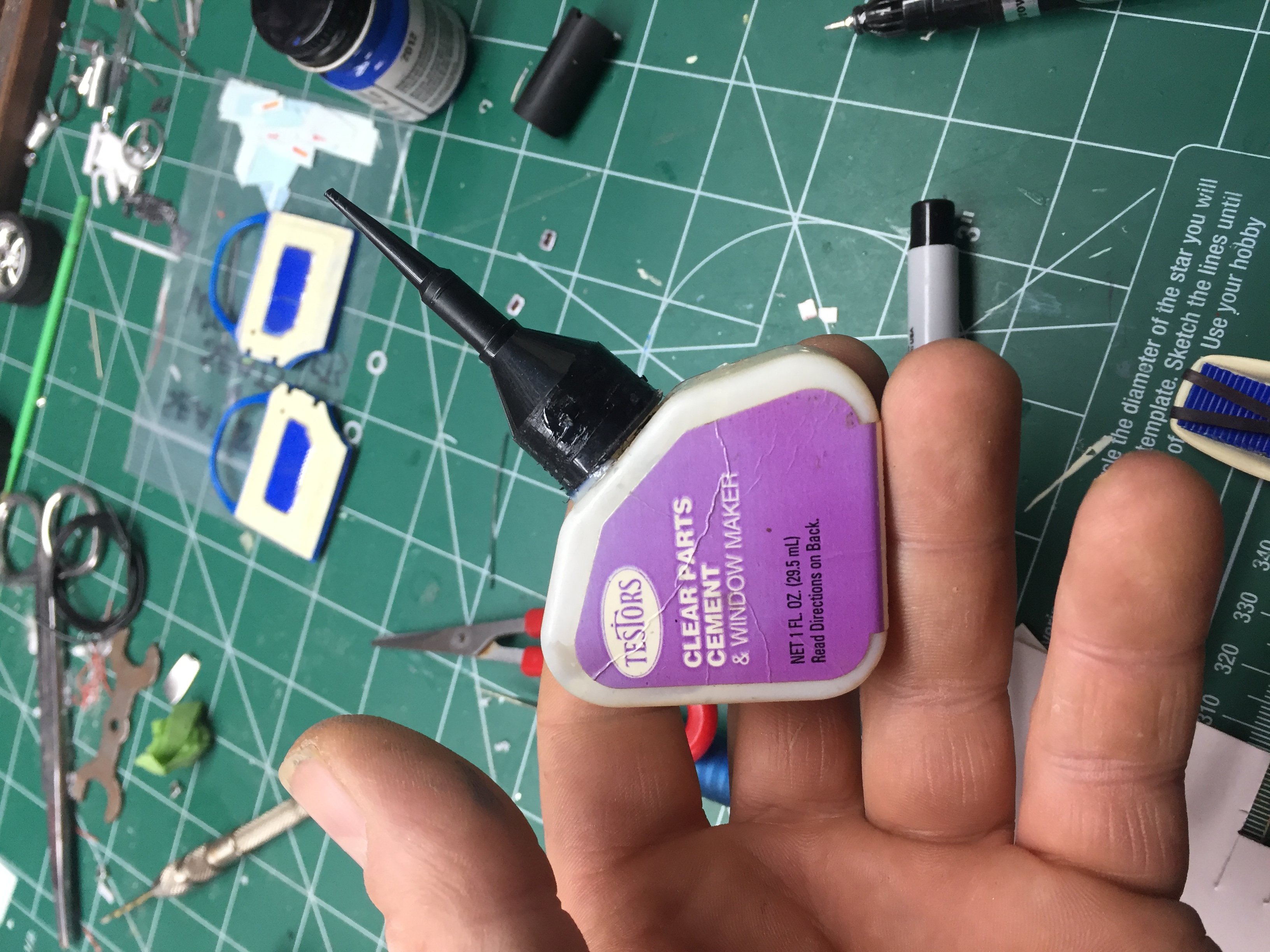

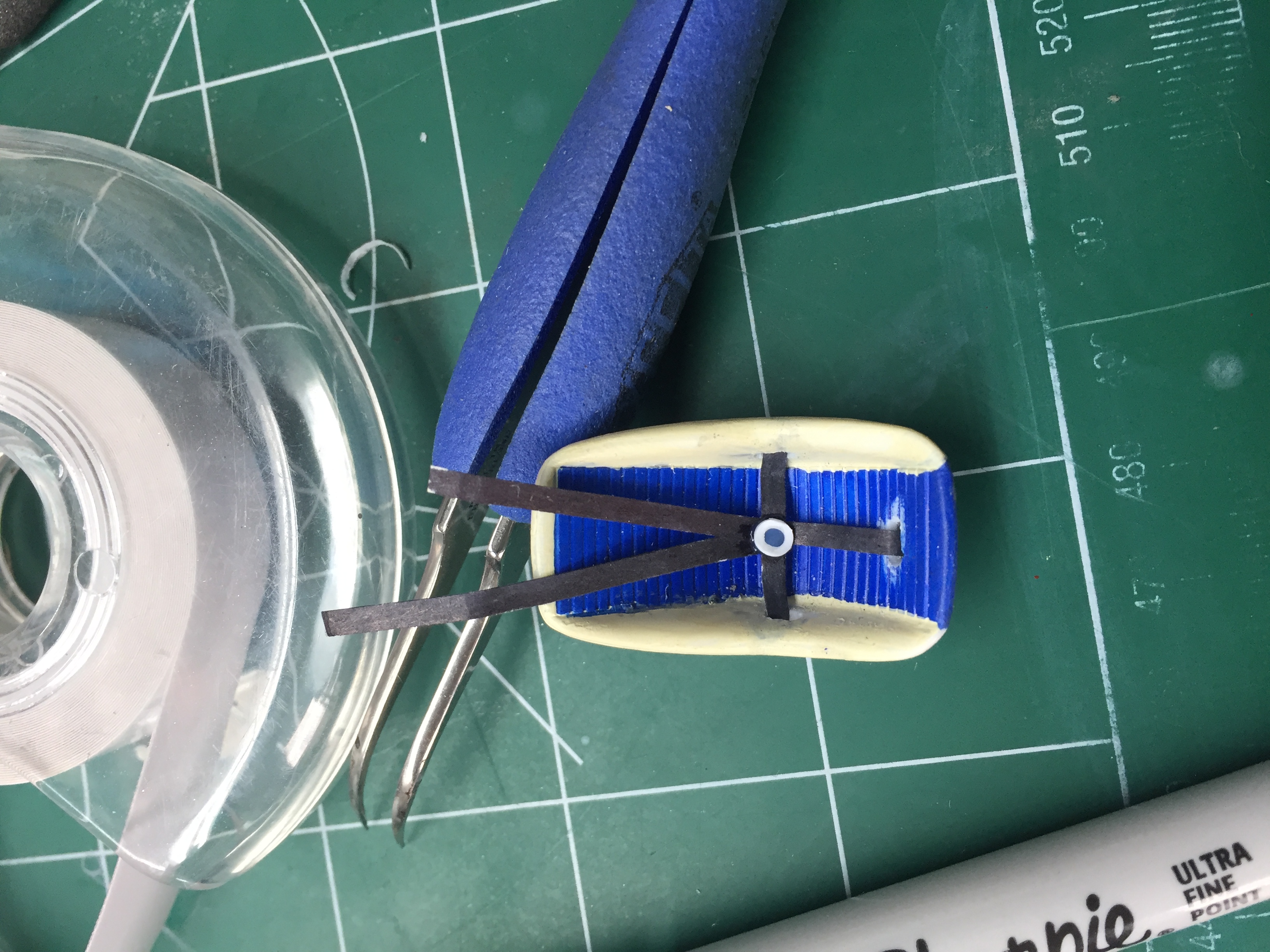

  18. I made the seat belt from paper and a sharpie. The buckles are thin styrene and a molotow pen. I drew black rectangles and use the molotow pen to outline the black. Then cut them out and glued them on the belts with testors window maker. The round five point buckle, is a small slice of 1/8 inch styrene tube and I used the pen for the chrome.

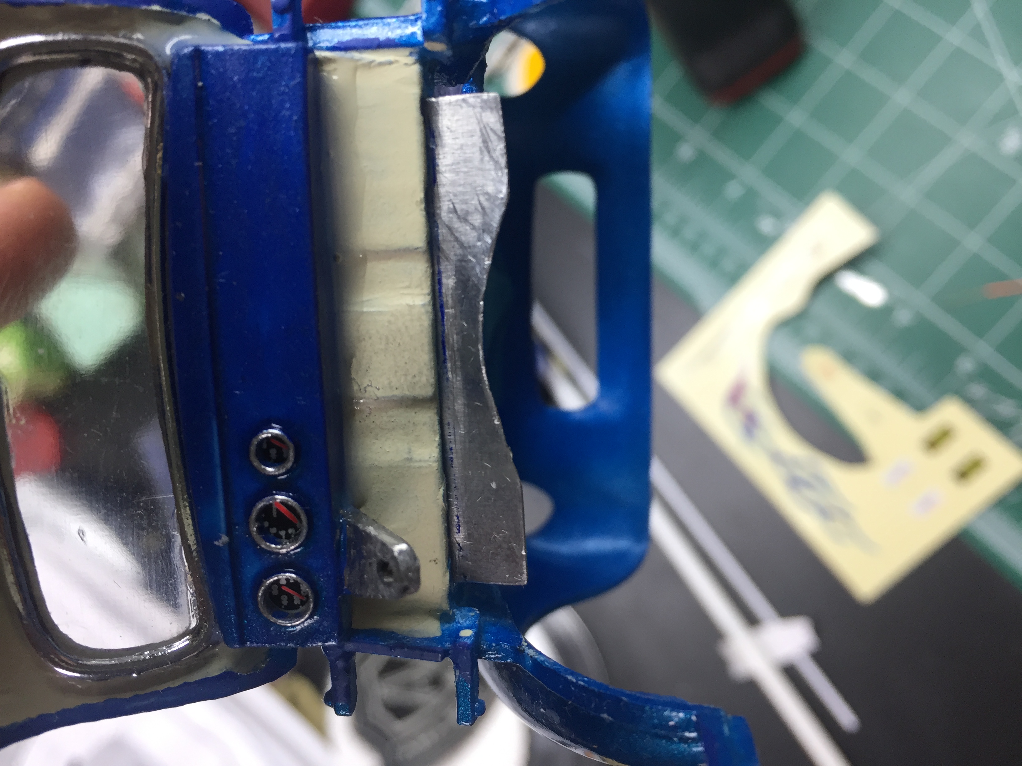

  19. Well I got to the bench today. I wanted to get some interior done on the Willys. So I mounted the windows, and flaucked the carpets. This color is not white, which would be correct. However, I just wanted the car to look like the restored version, and there are no good pictures of the interior. All the pictures that I've seen is the old car or some other reproductions. So I went with an off cream and cobalt blue. I like it.

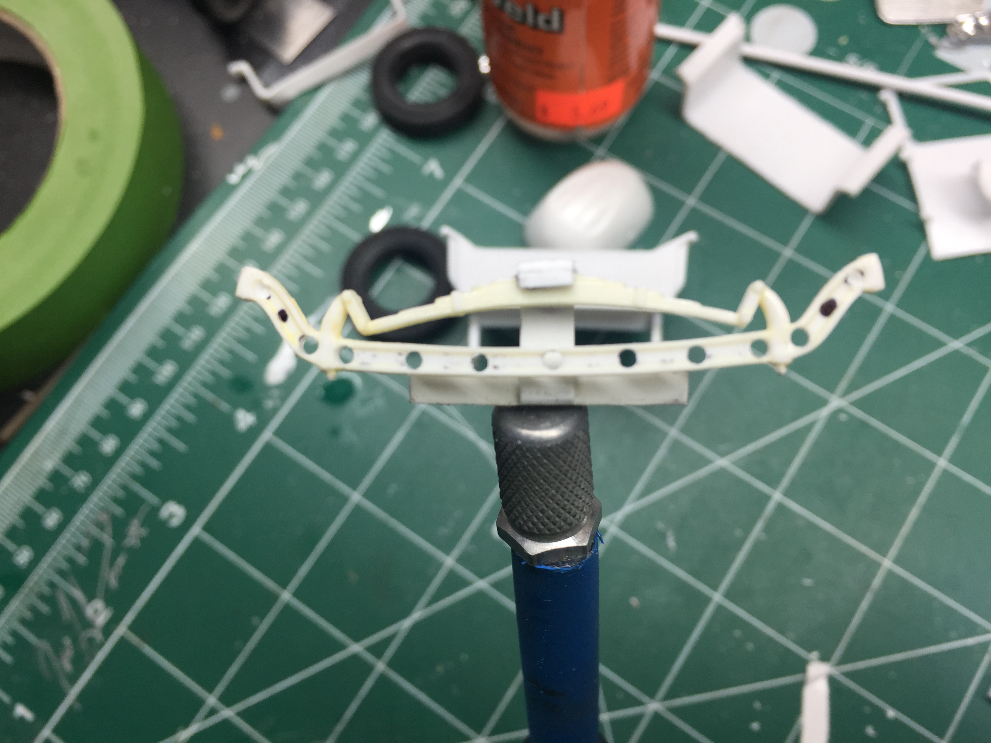

  22. Michael, Great to hear from you! Thanks so much. How are you doing? I'm getting better all the time. Well I'll keep in touch thanks again. BTW, all the chrome on that frame and headers are thous new moloflo pens. They are unbelievable.

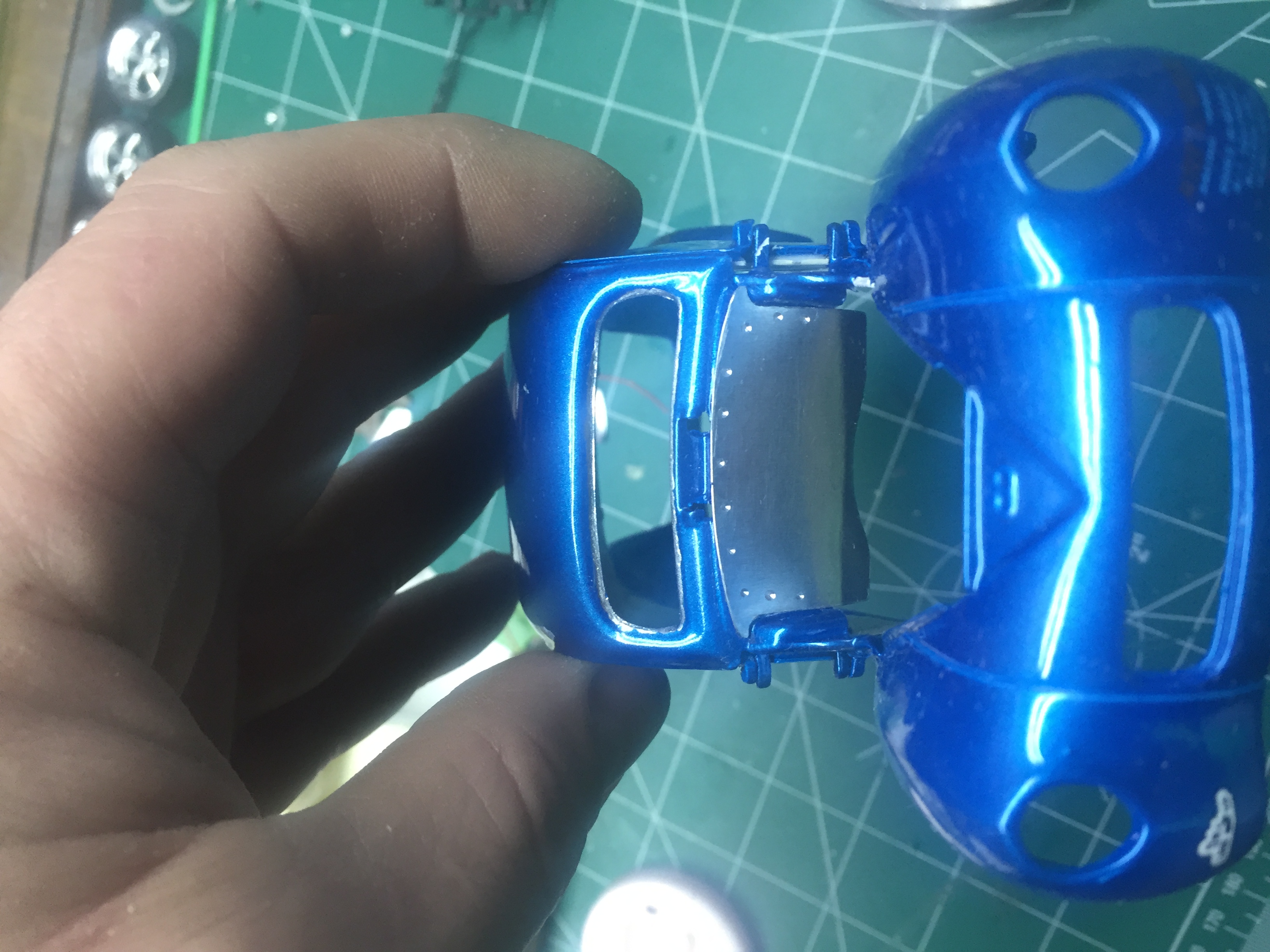

  24. Here's some of the progress of the famed Willys. I wanted to do the restored one, because that blue is so awesome.
