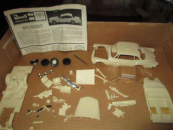

That, and the ever popular disclaimer, "Looks complete but not sure, check photos" remark with an instruction sheet in full view in the first pic. How about using the instructions to inventory the parts before listing your junk? There was one seller who sold Johan kits for around $80-$100 a pop containing nothing but completely stripped and bare parts trees. His disclaimer was that the kit was missing body & tub, engine, chassis, etc. Caveat Sucker. -

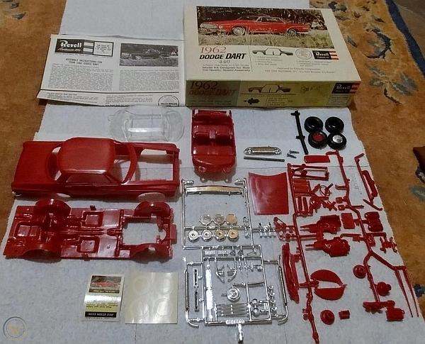

Atlantis won't divulge what toolings they obtained. Nobody, except Atlantis, bought the toolings from the Revell liquidation sale. They have most, if not all, of the U.S.-stored Aurora/Revell/Monogram car toolings which in all probability include the '62 Mopars. The only one which would require reverse engineering is the Dodge Dart. The body was hacked up to create the Dodge Revellion funny car. -
