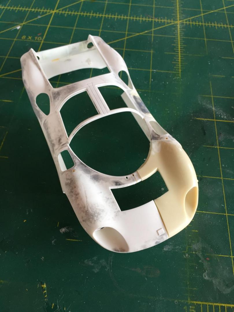

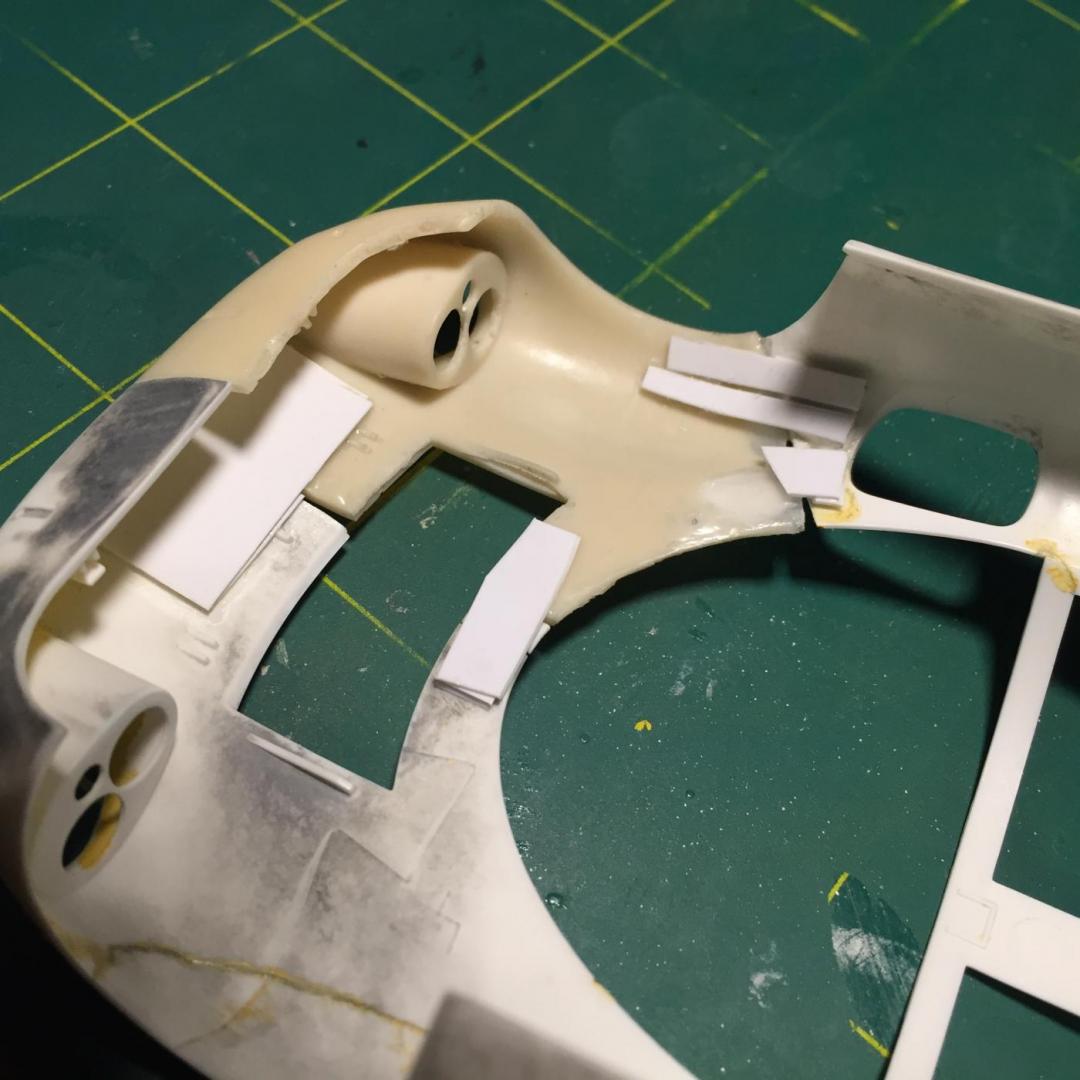

	Thanks dude. I just aligned and glued on the cast quarter to the body using supports placed underneath. I did this so the surface is level with the rest of the car as my cast part is a little thicker then the plastic. It was a hack cast, and I built my mold box from clay and did other things to cut corners and speed the casting process.

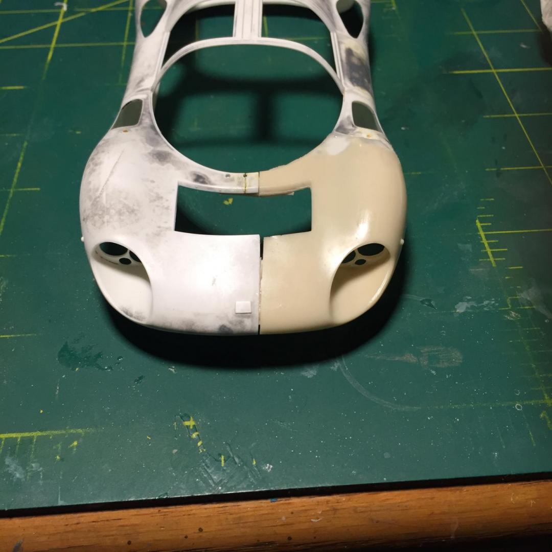

	And so the saga continues. What started out as a simple model almost ended as a melt down due to impatience. The recast front quater went well enough and gave me a base albeit serious body work is still needed. But at least I have a full body now. The proper way would have been to replace the entire front end evenly but I only wanted to cast a small amount keeping as much of the original body as possible. I'm looking to complete this one very soon and move on to a amore simple model.

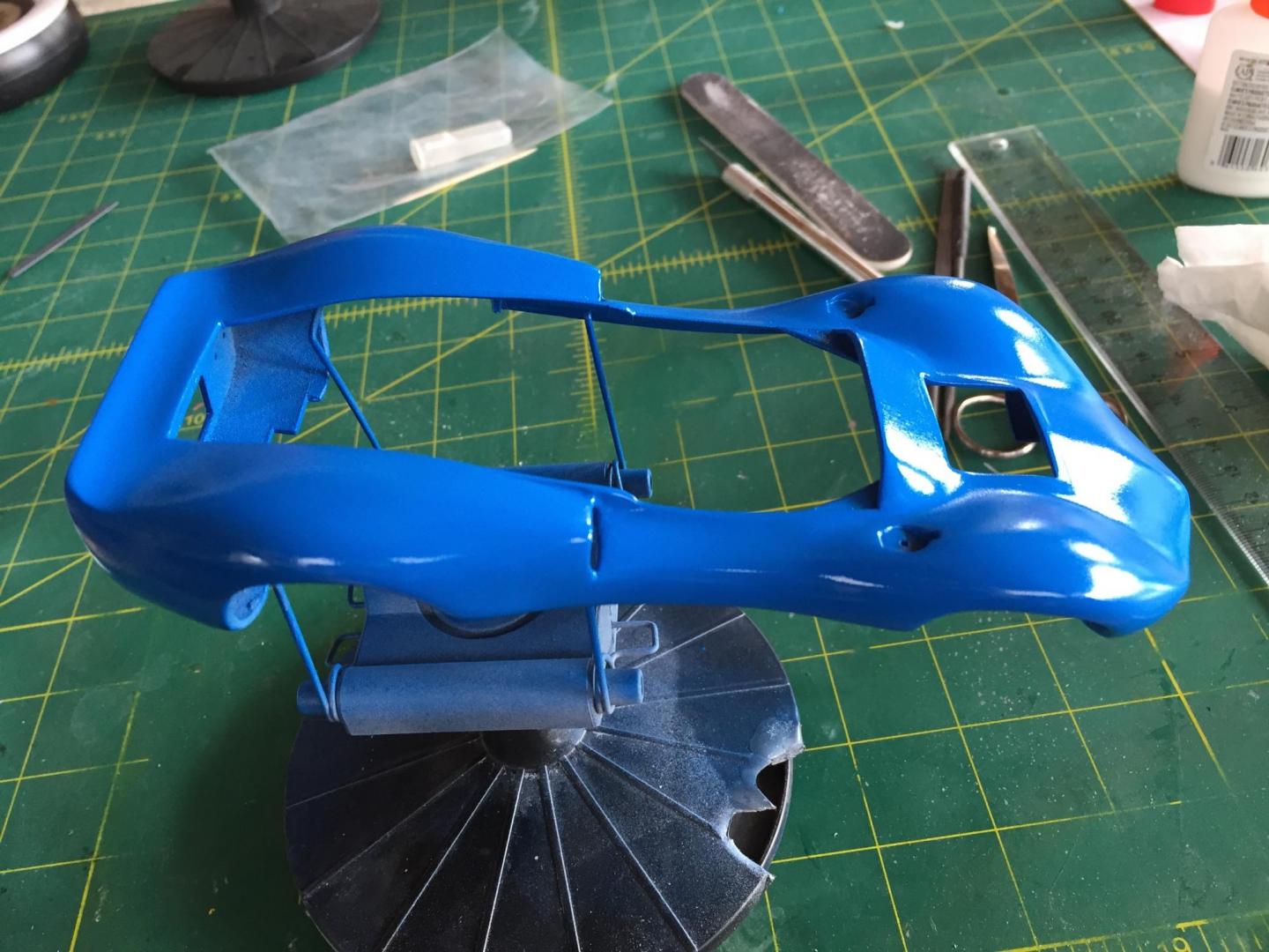

	Had to re-shoot the sides. The Bondo spot putty dried a bit more causing some ghosting of the rear brake vents to come through. I had to mask off the frame/lower body as I already put everything together. I simply didn't wait long enough for the putty to dry, nor did I use a primer/sealer which could have preventid this. Oh well now I know.

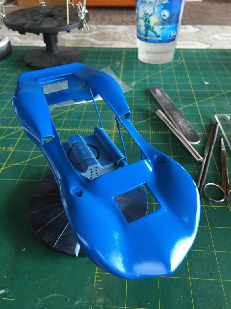

	After a ton more body work involving lots of wet/dry sanding and re priming, I have a final paint. Its been drying since last night, did; - 1 initial mist coat. - 2 regular coats. - 1 final wet coat. - Placed in large covered tin over night. All about 2 minutes apart. Planning to polish with some Novus etc then perhaps spray clear gloss depending how I feel. Its pretty shiny already though. For now it will go back in the tin for a few more days.
