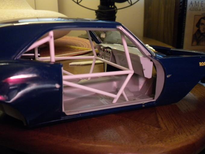

  8. Hello... The cage is barely discerned for being painted and coaxed into the '67 Camaro. The exhaust dumps w/straps flesh out the exterior, although the engine is still out. Happily the steering column rests comfortably across the roll cage cross bar forward of it, while no interference is noted between the main hoop and the side quarter windows. Thanks... Mike K./Swede70

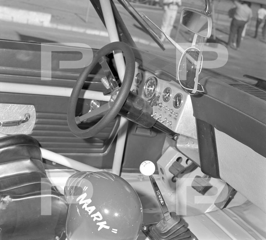

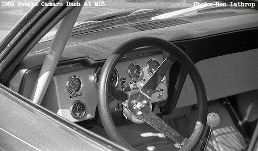

  9. ...while this would be the well-known '69 Mission Bell 250 Trans-Am poster and program image. The photo was captured at the first race of the season held at Michigan International Speedway for the inaugural Wolverine Trans-Am, while note Mark's #6 is fitted out with red interior trim panels complete with the dash pad so-colored. Mike K./Swede70

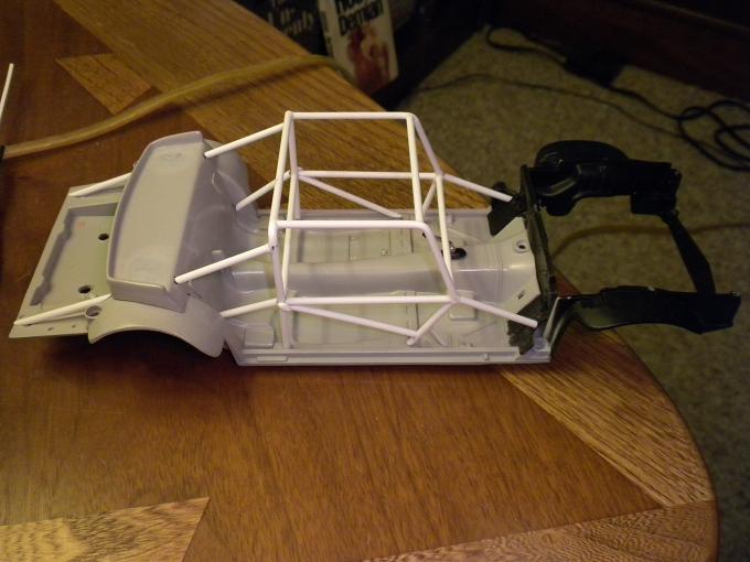

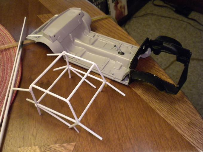

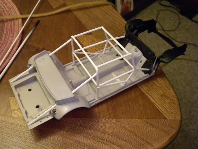

  11. Just some further revisions with the bars to the front subframe now equal length and angle, while a pair of bars stretch back from the main hoop and terminate at the top of the rear shock mounts. Pretty much ready to paint then. Thanks... ...while it comes out as a single piece. I only tack glued the main hoop and built things out from there. Mike K./Swede70

  14. Greetings... Just an update of the 1:18 GMP '67 Penske Trans-Am Camaro project given it's sprouted a roll cage. Hollow plastic tube with a brass wire core to help retain the shape and lends strength too. Happily no 1:18th scale drivers have thus far been hurt operating my conversions both minor and major. Thanks... ...with rear quarter windows recently added, some chrome trim for leading edge of the same, plus new front wheel bearing dust caps and rear axle ends pressed home into the center of the ARE/TT wheels. Without an engine at this point, hence no exhaust dumps are seen. ...interior mock up with a spare shell (thank you so much ijb40!) in combination with a '69 dashboard, although now I have a '67-'68 dash to use on my model. Bars to otherwise tie the roll cage to the front subframe are absent. A strange design - almost as though it's missing two points from an otherwise sound four or maybe six-point cage. ...more of the same. ...while the passenger's side A-pillar to main hoop bar needs to be refabricated consistent with shortening it a bit. Note that it stretches further forward than it should forward of the cross bar/brace. With some additional bars added, albeit it's not complete. Mostly I'm going with period photos, while avoiding some diecast structural elements restricts what I can do. Pretty much the state of things now. The chassis is just a bare '69 model with inner fenders trimmed to allow for a top of the subframe mounted sway bar installation. Kind thanks for your review of this project update. Mike K./Swede 70
