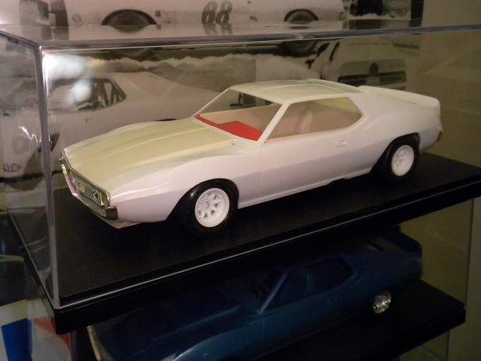

  1. Thanks... Looking largely consistent, the '72 RWR Javelin is also up on wheels w/cage after filing and fitting the red plastic late dashboard seen further up this thread. Forward one-third then... ...the wheel arch contour is different, while this example wears a '71-'72 grille/front bumper assembly less bumper guards if nothing more. At least it looks pretty honest. Thanks... Mike K./Swede70

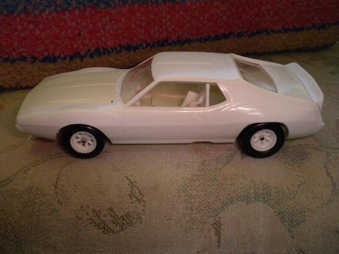

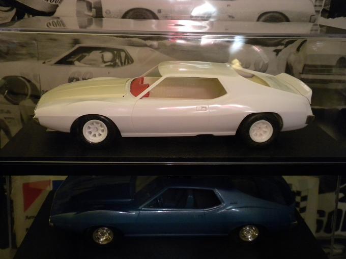

  3. ...while in short, this would be my '72 Roy Woods Racing Javelin Trans-Am taking shape to the extent that I've removed select trim and have recontoured the wheel arch openings to match period photos. Subtle stuff, not particularly exciting in sum, while sobering it is to notice where kit part prices have gone in recent times. Finding another '71- '74 dashboard (or much of anything Jo-Han Javelin related) isn't work for the timid. Thanks... ...a fuzzy press kit image communicating the basics. ...and looking a bit pallid given the bumpers (across projects really) are being prepped for chrome plating. The bottom surfaces are a bit rough, while the ends of each 'stamping' front and rear needed light work lest they stand out for all the wrong reasons. Another front spoiler has been fabricated to situate here, although it's literally out of sight when this image was captured. Mike K./Swede70

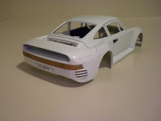

  6. Greetings, Not wholly impressed with my first go at refinishing the amber tail light panel/insert on my Tonka/Polistil 959, here I've redone it after breaking the first attempt when I tried to remove the part from my build - ouch! Thought was given as to whether a Molotow paint pen could be used to bright up the back of the amber sections along the ends, while for mulling things it seemed worth a try to grind off the mounting pins (sort of an 'L' section when viewed head on) and generally clean up things from behind. ...as delivered then. ...first attempt with the sloppy reversing lamp effort on woeful view. The wheels look odd sans aerodynamic overlays later worked up and added, while the amber-color plastic retained for the turn indicators along the back seem pretty lifeless. Very much Kay-Bee Hobby toy aisle... Moving along, I painted the ends of the turn indicator segments/elements with Tamiya translucent orange aerosol, while a better white was chosen for the reversing lamp sections to aid matters. Enhanced control is witnessed in relation to the division of colors and tones used, and this helps on the quality front. Not so obviously toy-like now, and pretty much the work of a day. Thanks... Mike K./Swede70

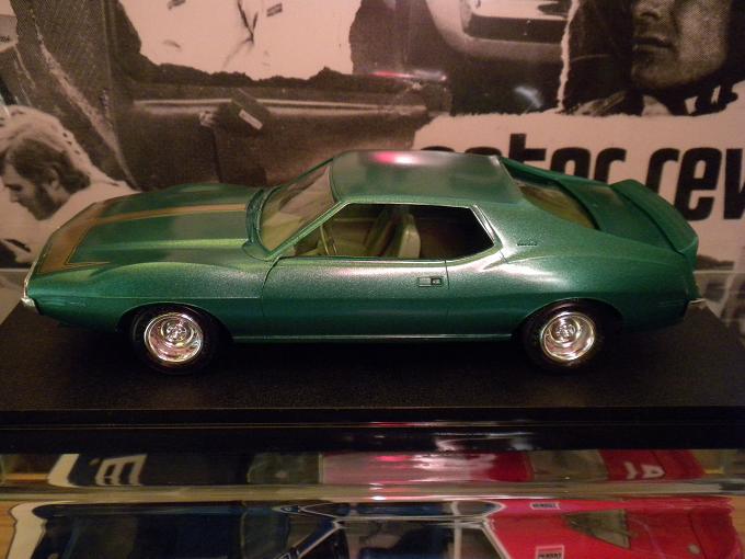

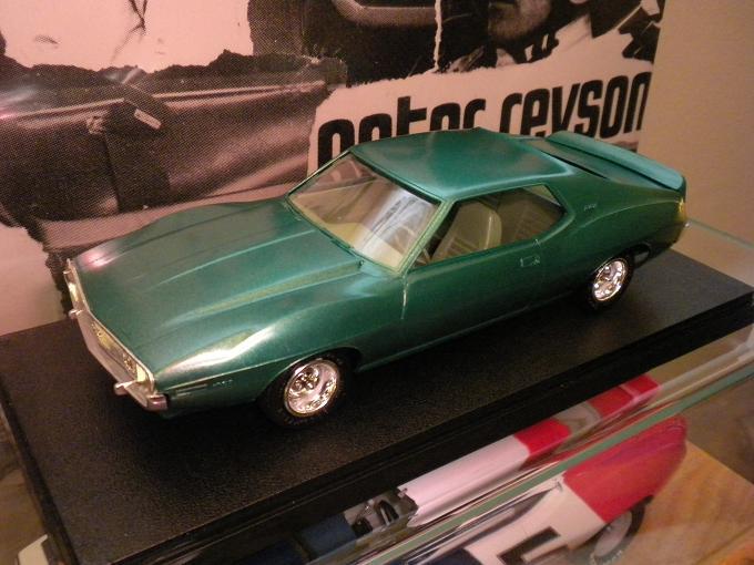

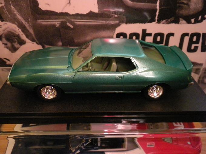

  15. Greetings... I always wondered what a factory promo of the '73-'74 American Motors Javelin AMX would have looked liked had it been afforded to us, pondering what could have been made of parts tooled for the AMT release as well as the knocked down snap together Jo-Han release of old. Witnessed below would be a starting point... The 'Volcano' styled stamped steel wheels would appear within AMT's Gremlin (and likely stock Matador) unassembled kits, while maybe the MPC hard vinyl Goodyear Polyglas GT tires could have been used even as they were likely sized to suit the Vega GT promos first and foremost. Modern eBay kit breakers were turned to, while the availability of things sold separately helped knock down costs... For gathering a nicely built up snap together release and collecting suitable scale footwear, I finally decided to do something about a certain urge. Another set of wheels is in the mail, hence I'll hopefully have four well-plated and reasonably crisp examples to choose from. This would Fairway Green Metallic on a '73 Javelin versus the expected Javelin AMX model, with the neat 'Volcano' stamped steel wheels also on view... ...while this would be a very typical (albeit in terrific restored condition) American Motors interior hue of the period. My interior paint choice isn't the closest, although it's typical of period Jo-Han practice. I feared that if I simply painted the interior basic black, it would appear more 'messed with' versus something that might be mistaken for an actual promo. A later Gremlin kit might be tapped to come up with a steering wheel akin to what is pictured here, given the rim blow option was no more after the '72 model year... Seen would be a respray for use of Tamiya TS-20 Green Metallic which approximates '73 American Motors Fairway Green Metallic, a weird interior refinish in Rust-oleum Stalin Leafy Green with a quick semigloss clear coat applied over it. Some clean up work was performed to the body shell casting, although only enough to ensure it would look about equal to a pair of '71 and '72 true promos that I have in terms of finish quality. Jo-Han plastic kit axle locators were modified for adding a bit of plastic tubing to widen the track both front and rear prior to painting each ACE hardware Garden Green to match the color of the plastic used for the aforementioned snap together release, the results being generally clean and discreet for so fitting. Music wire was used for new, wider axles matched to the track of the old Hurst mags typical of these models. I had a spare plastic 'glass' panel/insert on hand, hence such was polished with NOVUS 2 and switched in. The tires are a bit small, but I'll live with such... The tail panel plus bumper top cove black out denoting that the 'GO' package was added after masking out the bumper guards. Locating tabs otherwise intended to square things up for assembly of the top tail panel insert relative to the red-tinted tail light panel were ground away to level things out, while the aforementioned lense insert was stripped with Easy Off and reshot with Tamiya TS-74 Clear Red to ensure it was colored evenly versus the usual Jo-Han blotchiness. Watch out for clumsily built up examples which often evidence glue burns to the tail panel insert top corners extended along the back of the insert. Damage such as I describe is something commonly discovered only after one returns from a show with a messed up example in hand. Both tail light lenses I had to choose from were damaged in this fashion, although one was within the realm of saving for use here. Fred Cady decals are coming - hence a gold 'T'-stripe hood graphic will be added soon enough, being as weird and as typical of anything AMC ever did in period. Mostly I'm happy. Thanks for your review of this more or less finished mini-project... Mike K./Swede70
