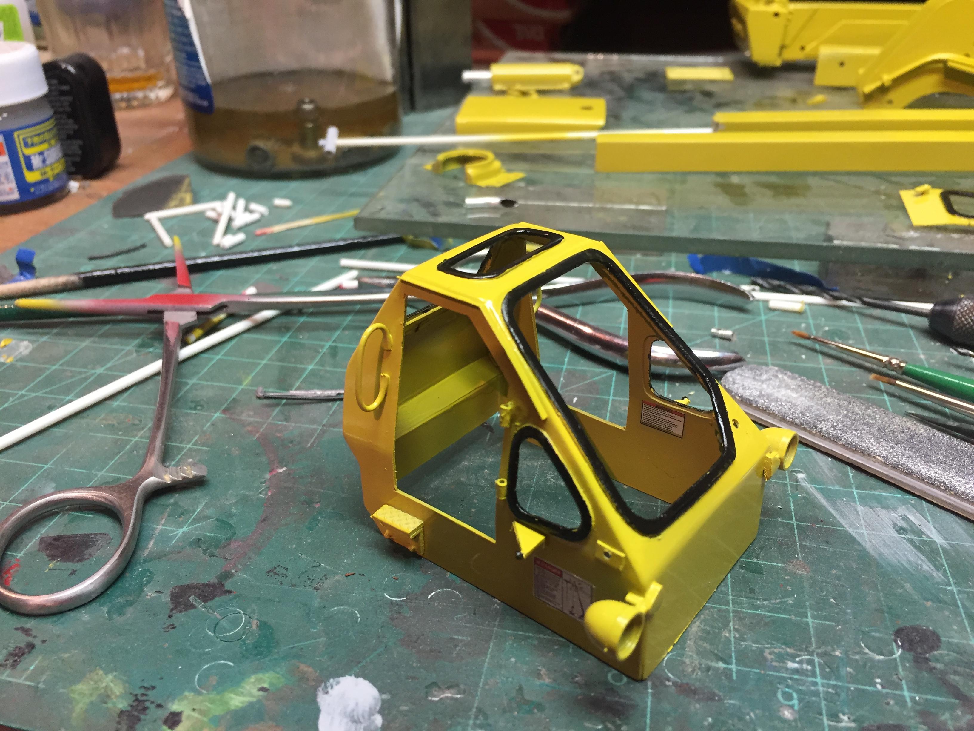

  1. Enough for today........gas tank, hydraulic tank, battery box and operator’s platform deck supports and side sheet metal framework installed. One day of building and work bench looks like it had a bomb dropped on it! Next step is make and install the hopper hydraulic cylinders and make the decking, engine side covers, screed decking, hopper shields, tamper drive guards, feed and discharge gates, feeder drag bars, seats, controls, etc., etc., etc.!

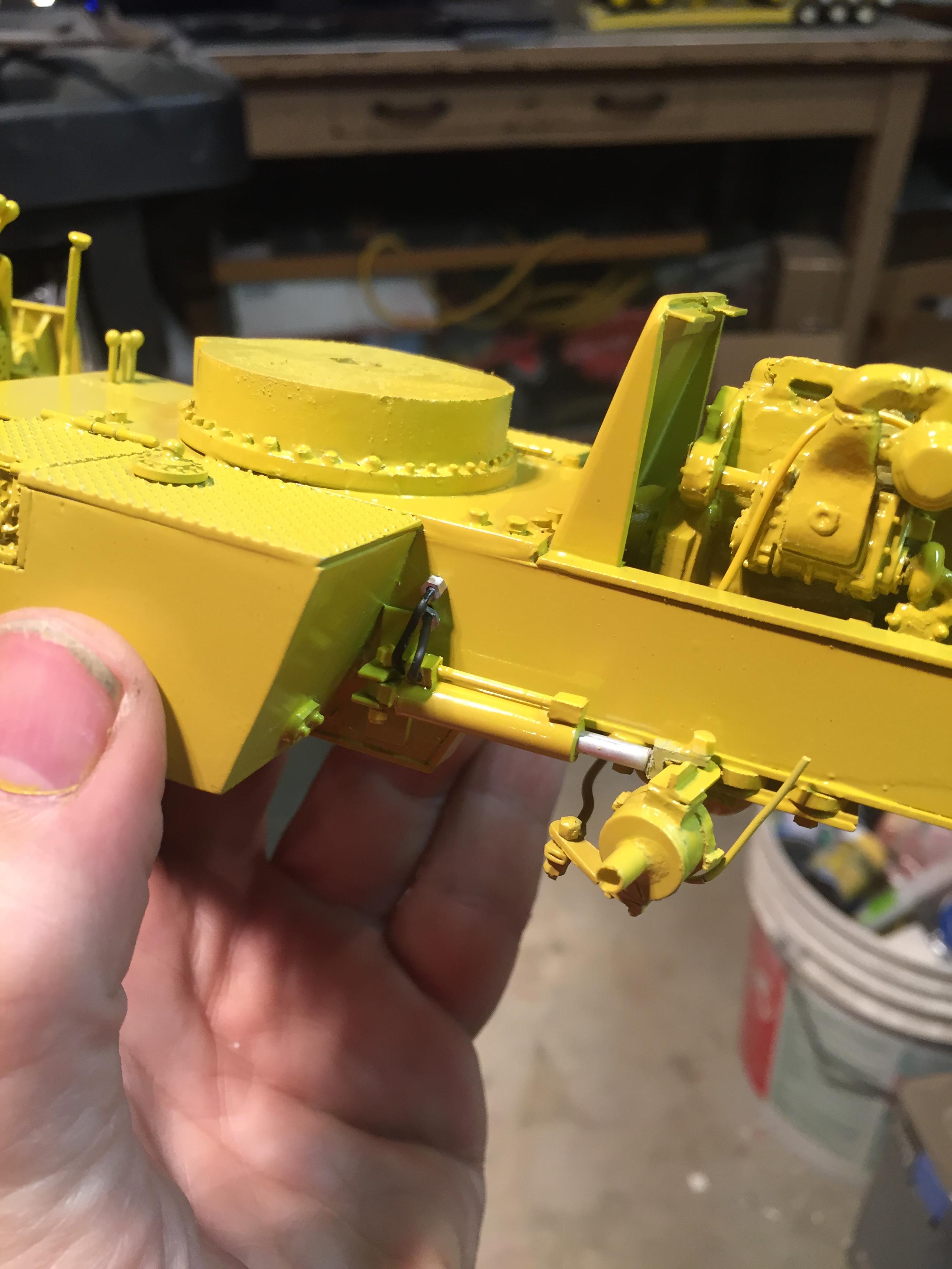

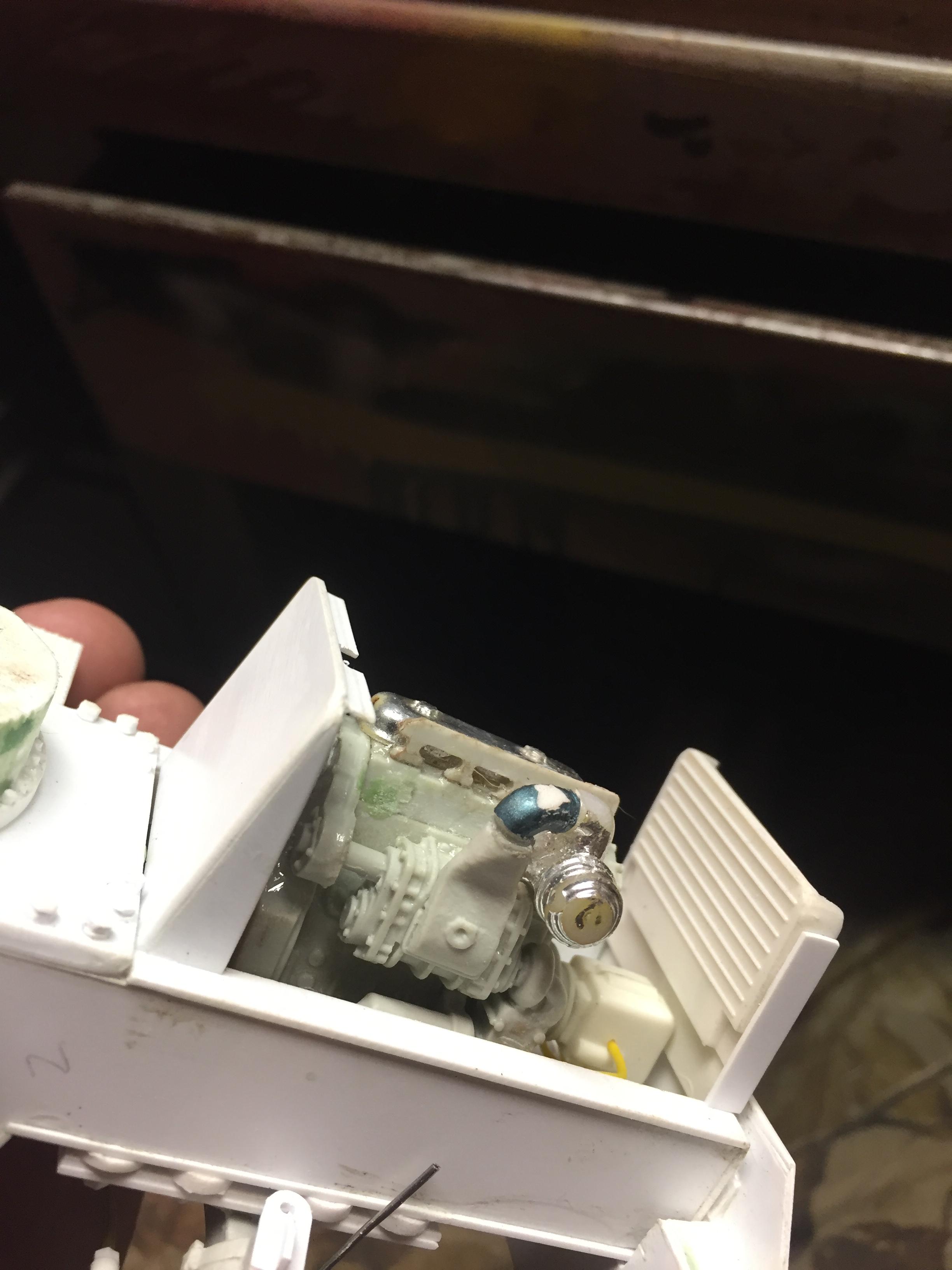

  2. Working on the engine enclosure, the engine, and the belt drive to the main gearbox and hydraulic pump. Added the flywheel and drive pulley to the engine and got the radiator and hood made up. Made the driven belt pulley and still have to mount it all. Just got back to the bench, one of my Labs had a spinal stroke a week ago and that took a lot of my time but she is recovering. They are family and family always comes first! But the build is on track again one step at a time!
