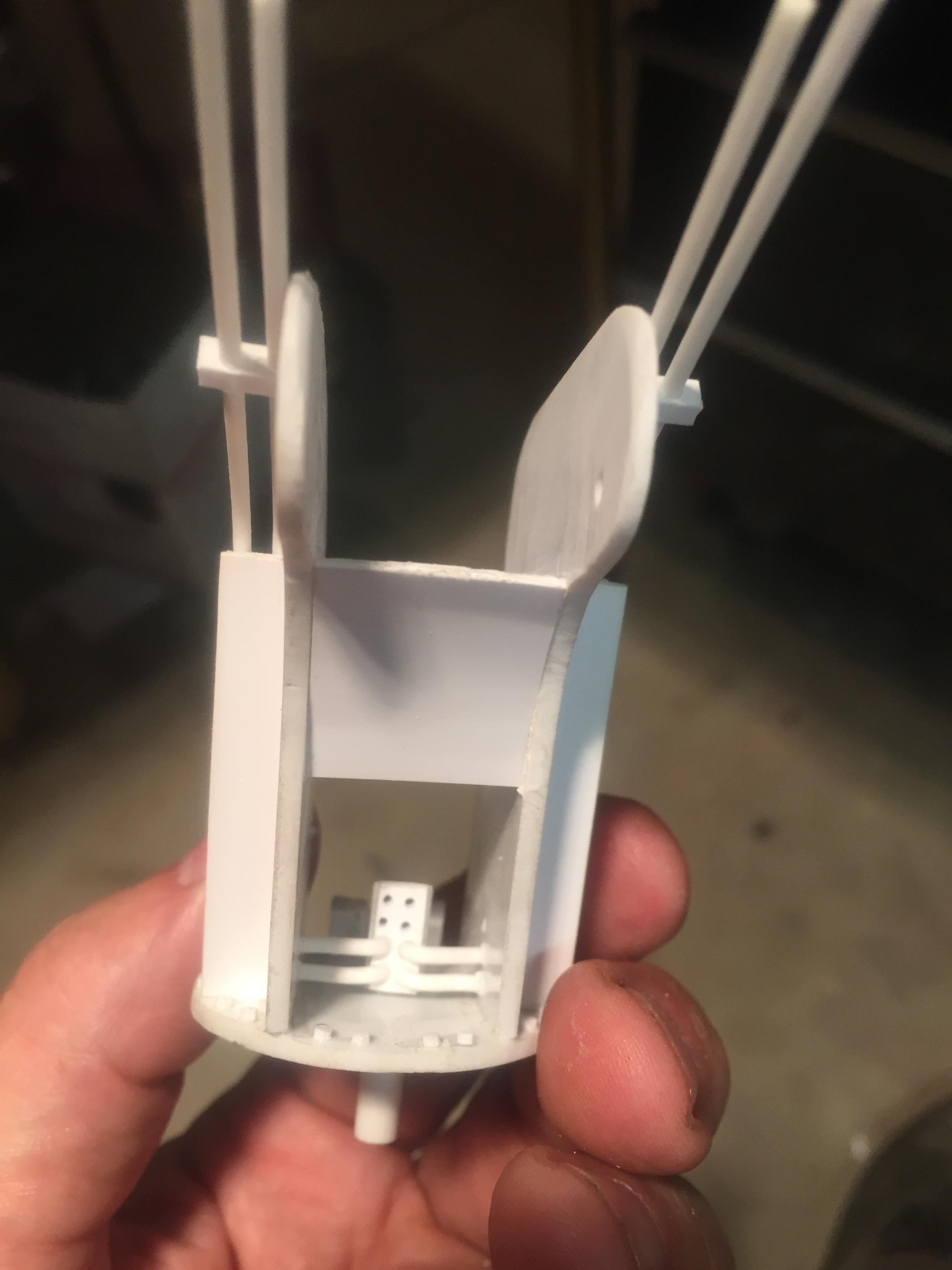

  4. The auger was actually not hard to make though I had to give it a lot of thought and look at real 1:1 augers. I made the discs as noted and used a proper sized tube for assembling the discs onto. I slit the discs as shown. Then giving them a proper twist either left hand or right hand, I put them on the tube. I tacked the first one in place at the very beginning with CA cement and accelerator. Then I twisted it out to the pitch I wanted and attached that end. The next piece was overlapped on the first one about 1/16" and a drop of CA was applied between the two disc edges and clamped with a pair of tiny pliers and accelerator was applied. I proceeded on to the end of the auger in this manner, rinse and repeat, until I got the length I wanted and then made a mirror image. I then went back and added more CA as needed to make it permanent. Only glued my fingers together once! Pretty happy with the way it came out, and if I make another one for something in the future, it will be all that much easier!

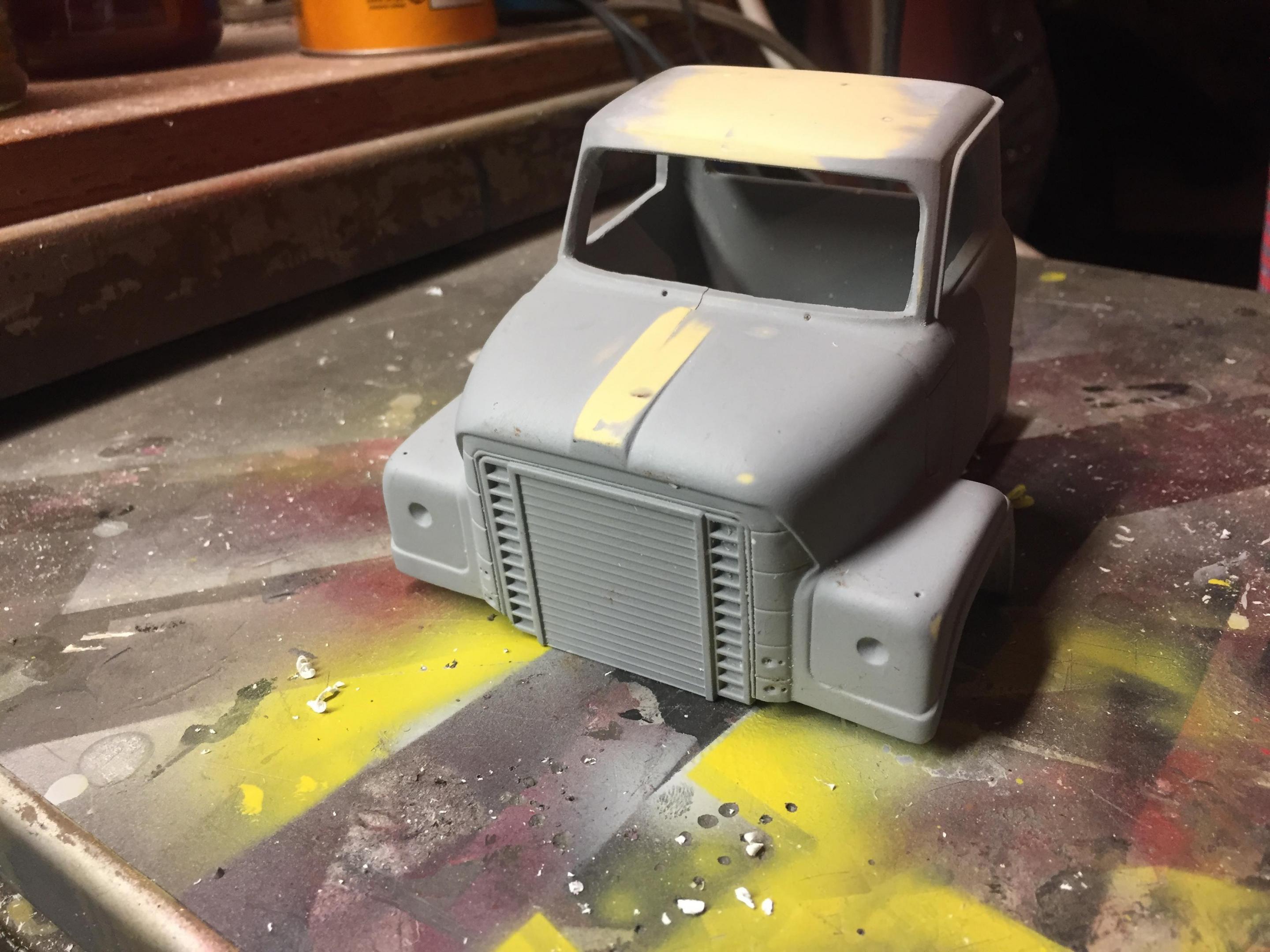

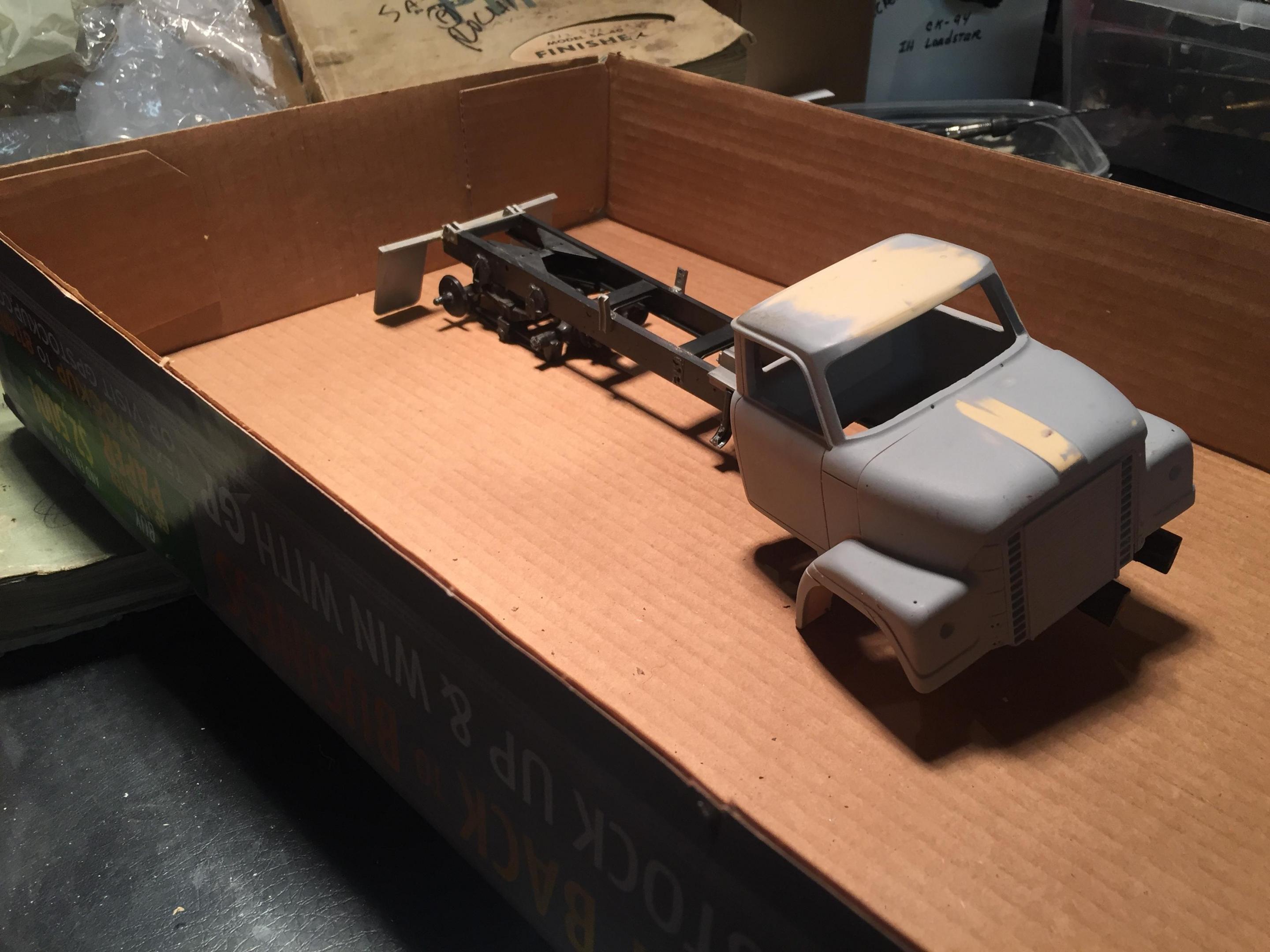

  15. First step, opening the hood. Xacto knife and razor saw got it done. Thinking of a twin screw straight truck flatbed.......so far!
  16. I don't usually take part in builds with a finish line......... because I am almost certain to be a DNF. But, I'll give it a try! IHC Fleetstar 2070B. Cummins powered, not sure of the body yet....that is to be determined. And depending on the body chosen, it may morph into an 2070A. It is a very old resin from Jim Etter. I will be using almost 100% recycled parts and will cut and hinge the hood. Happy New Year!
