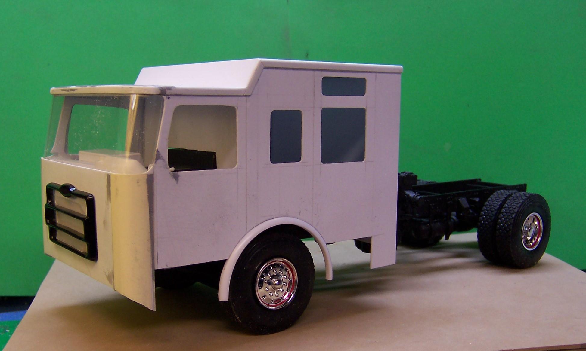

  2. I agree with Brian. Building a model outside of a total kit build is a lot like building the real thing. Start with the frame and make sure it is straight and not warped in any way. And yes check the front axle width. You may have to take a section out of the middle so that the tires fit under the fenders. Are you planning on using the chain drive or the later differential and drive shaft? If it's a logging rig with tandem axles and you use the chain drive remember that there are two sets of chains and sprockets. Keep us posted on your progress. Sounds like an interesting build.

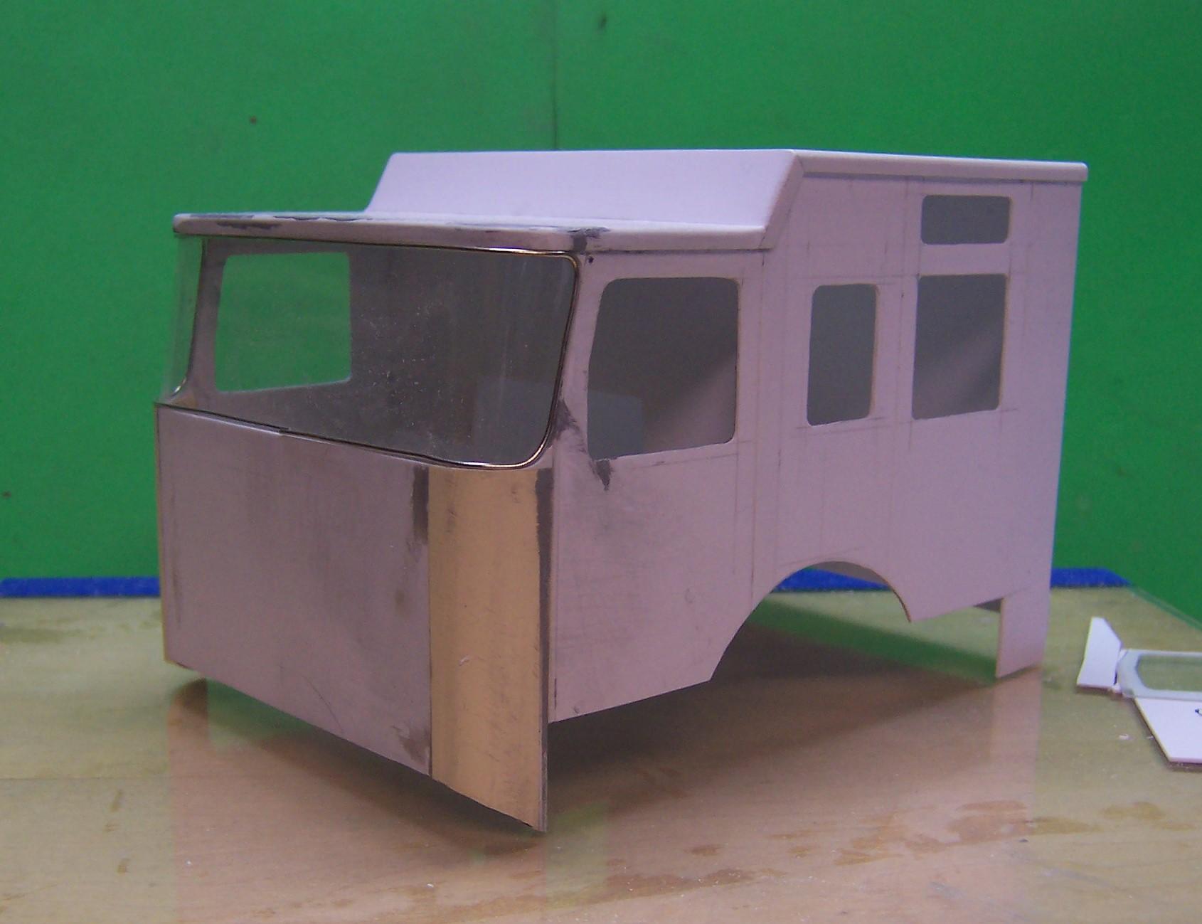

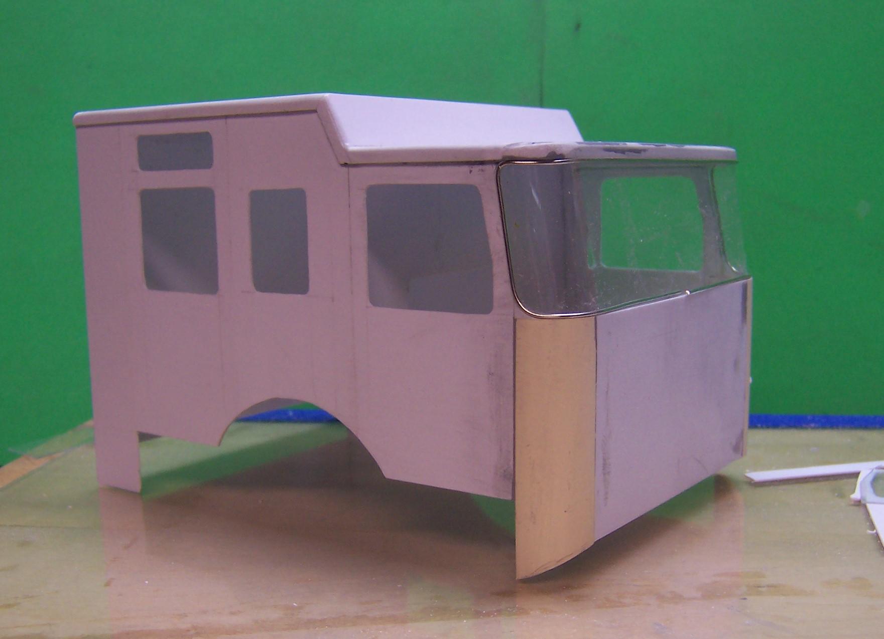

  4. The way I am making this truck body is similar to what I did a number of years ago when I made a City of Miami Haz-Mat rig. This rig has roll up doors on each side a bit like E-27. In this case I made a body inside a body. The inside body was the scribed sheet painted separately with silver with the striping and decals added. The outside body is the red part with certain accommodations made to keep everything alignment. It was painted red. Once all of the external work was done on the red body, the striped inner body was inserted giving it a solid unit look. The Pierce will be the same in that there are inner scribed pieces that will fit behind solid exterior panels. Only this time I made the outer body rigid and will use only individual scribed sheets for the doors. Here the body has been opened up along pre-determined lines. In the photo you can see the vertical sections that hold the body rigid on each side of the wheel well. The corners take care of themselves. In front are each of the scribed panels of 0.020" sheet stock. They fit inside and are snug enough that I can show them in place. Before they are installed permanently, I will add sheet stock to the back side to stiffen them up a bit and keep them flat. Even now they look like they should. Think they will work out just about right.
  5. Got some extra front fenders from an ALF 900 series hanging around? I think they would work.
  6. It's got a body! Sort of like Frankenstein's monster. It's alive! It's alive! Well, not quite. The basics of the body are done. The next step is to cut out the sides along the lines that have been marked. The scribed siding representing the roll up doors will then be put inside. Trim on the outside and the lift bars will be done after painting. Lots of small stuff again required but it's getting there. I went to the local hardware store and found a hub end for PVC pipe that had the right outside diameter for the rear wheel well openings. I cut the hub in half and then sliced it across to get the width I needed. It's a bit on the thick side so I'll sand some away with the dremel and a sanding drum. I also need to check the height just a little. It should set level with the cab so it needs to come down just slightly. The rear view. There is a roll up door there also behind the opening that is cut into the back. That's a piece of aluminum foil on the back of the cab. I embossed the diamond plate pattern in it with a pencil eraser over a piece of plastic treadplate. Most of it will be hidden by the pump panel unit once that is done. The lines on the side of the body indicate where the cuts will be made. Between each one will be a section of the outside sheet left in place. On top will be another piece of treadplate. I checked the measurements of the model now that the body is set in place and it is just over 15 inches from front bumper to rear step. It's off a couple of millimeters from the actual truck length so don't tell anybody!?

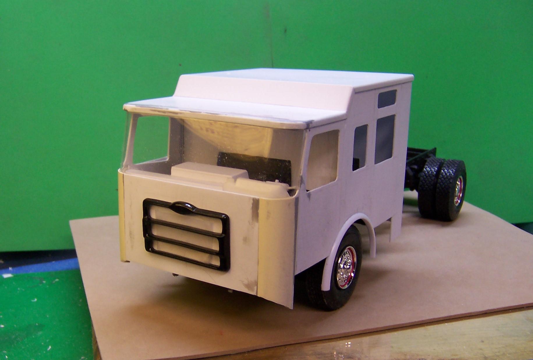

  11. Got the mirrors on using the Trumpeter kit pieces. Getting closer to making up the pump panel unit now. Just a few more little things to add to the cab such as the front discharge plumbing, tow hooks and some lights to go under the steps.
  12. It can see where it's going now. Headlights are finally on after much fiddling and adjustment. I used Alclad over gloss black and then used 5 minute epoxy to set the lenses. Epoxy was also used to attach them to the cab. CA would not have allowed any adjustment and that was critical because of the two sets of lights. I took the rear view mirrors from the Trumpeter ALF but they are not ready for installation yet. The kit has nice chrome mirror backs but they included a piece of clear plastic for the mirror part. BAD idea. I have some polished heavy aluminum foil that has a sticky backing. So the clear plastic was replaced with a strip of Evergeen with the aluminum stuck to the front face. BIG difference! The Federal Q2B siren was mounted on the bumper. Trumpeter again only went half way so I made a "F" face for it as a decal and put it on an aluminum backing.

  14. Well, here we are after a few hours of work. There has been a ton of stuff to add to just the cab. And there is more yet to do including the headlights, two grab bars for the right side of the cab, tow hooks, "chrome" bolt heads for the front bumper, step lights. The list just goes on and on. In the meantime this is where things stopped as of this afternoon. Pierce has used a Great Seal of the United States on its apparatus for a long time. Each piece gets one. This rig has one too.?
