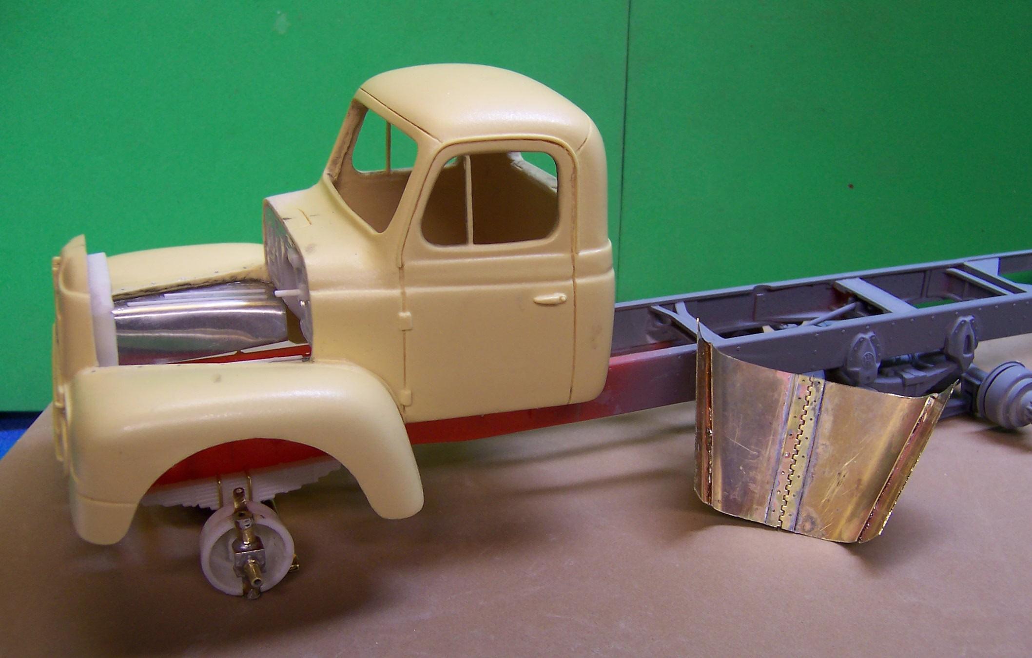

Len: Here is the way I added some trim to a windshield, or in my case trim around a back window. On my example the trim is a bit strong so I would recommend reducing it some but the idea remains. If your windshield is curved this might not work but if it is flat here we go. First find the centerline both vertically and horizontally on the window opening. Mark it as I did above on the body. Next take a piece of sheet stock of 0.020" thickness and place it inside the cab so that you can trace around the opening on the sheet. Get the sheet as close to the inside surface as you can. Then using the lines on the cab find the center vertically and horizontally on the sheet. Now trace around the outline of the window opening the width of what you want the trim to be. Here is where I would have made mine a bit thinner. Carefully trim the sheet to the outside lines being sure that the alignment marks vertically and horizontally are in place. Once it is cut out, bevel the outside edges of the trim blank to give it some roundness and then glue it in position using the marks on the cab and the sheet stock for alignment. Be sure you are spot on with this because it will become critical in the next step which is to cut out the inside of the trim blank to the inner lines you drew earlier. Don't go beyond the lines!! When the cutting is done you should end up with a thin edge that you can see from the inside of the cab. It is against this edge that you can lay the clear stock for the glass. Here' s the glass in position with the trim around it. As I said it could be thinner all around. I made up for that though, when I painted the cab. Instead of painting the entire trim piece black to simulate the rubber gasket I just did the inner part and a thin portion at the edge using a felt marker. That helped keep the black trim to a minimum. Hope this helps. Even if the windshield is curved you might be able to apply some of this to your project.

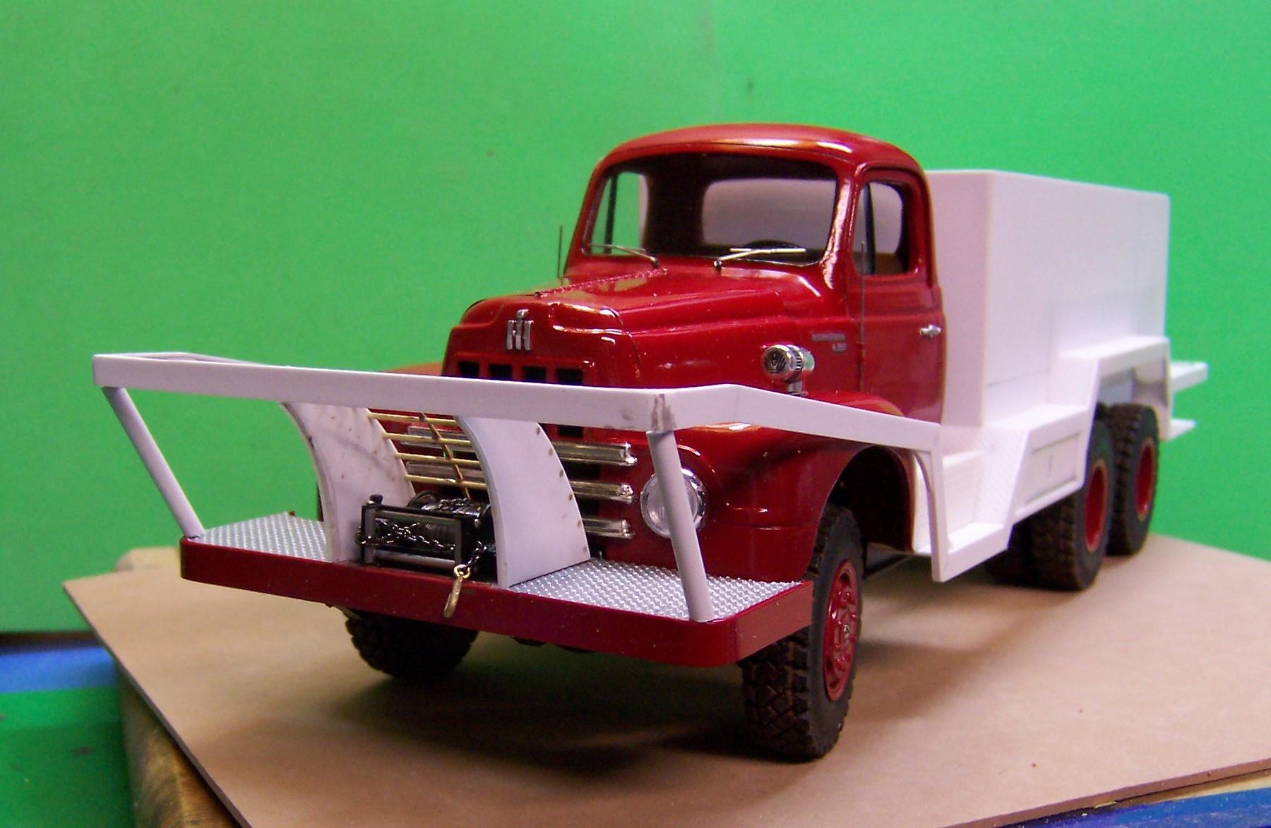

That's the stuff! Great to work with. I see an IH R-190 is part of this rig also! I did one just a short time ago. Here is my latest project using Renshape. The fenders, hood and grill are all made with Renshape. -

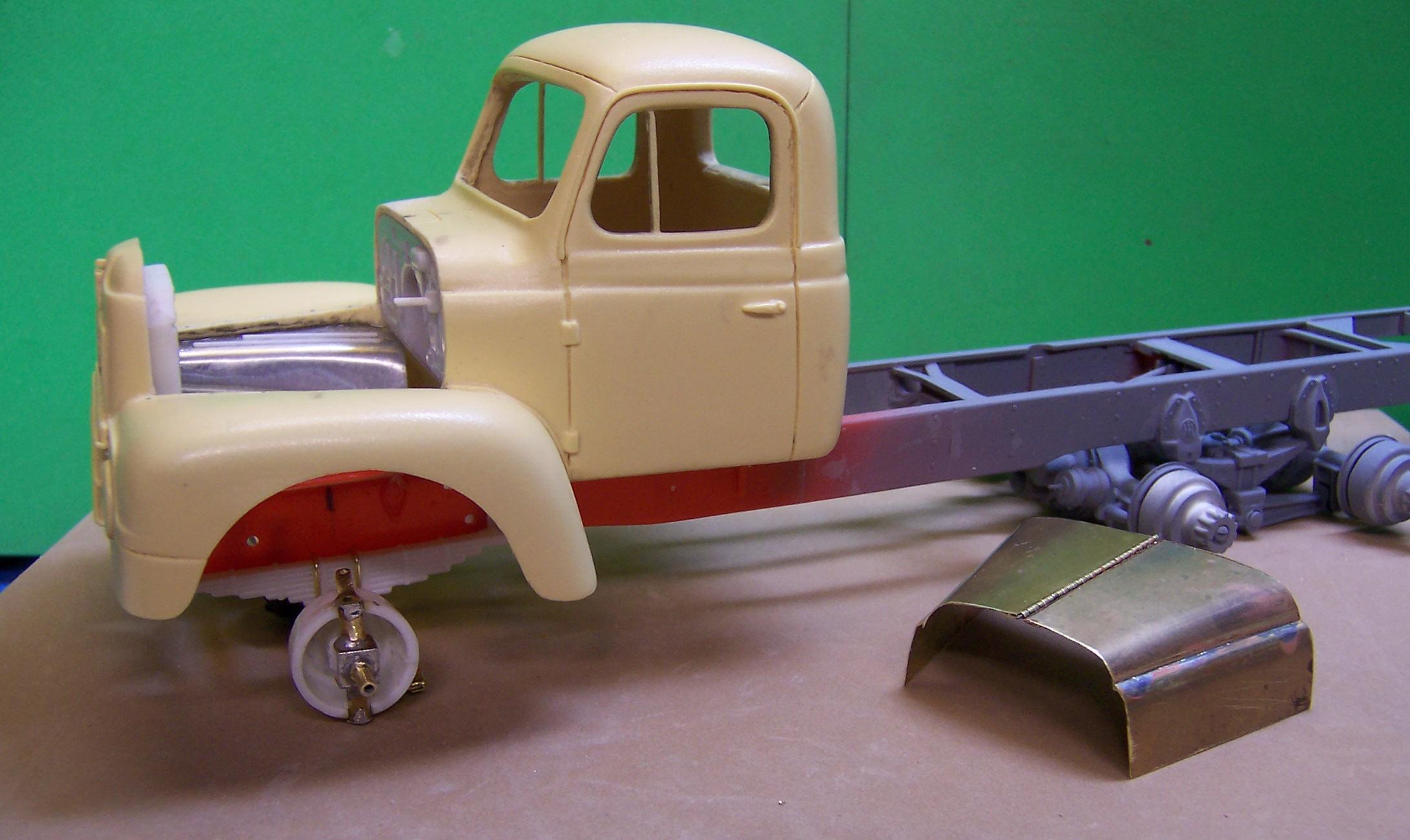

Here's an update on where the work has gone so far. I mocked up a frame and set some tires in place just to get the feel for what it might look like. The cab and fenders are done. I finished the basics of the floorboard today and the dashboard a couple of days ago. Still to go are some running boards. Clear stock has been cut and fitted for the glass. The seat is a resin casting from another project but I think it fits the bill. These are the parts that I am looking to get cast. The bumper is included. I just forgot to put it in the photo. Runing boards will be included as well. Tires and wheels will not. I tried to make the parts to go together as easy as possible. The dash fits snugly just below the windshield line. The floorboards have a positive location point with the vertical firewall and the back of the cab. The bottom of the floorboards fit flush with the bottom of the cab. The fenders have a flange around them that fits against the inside of the hood. The projections on the front of the fenders fit into the notch of the grill. The fender flanges also fit between the sides of the body and the sides of the floorboard so everything can be glued together pretty solid. Very little adjustment will be needed to make sure the fenders are square and level. -

Worked up a dashboard, found a seat and steering wheel that will be the right kind. Last is to do the floor pan, running boards and some inner door panels. Templates made for windshield, vent windows in doors and rear window. As soon as the floor pan, running boards and door panels are done I'm shipping it all out for casting. We'll see what happens. -
1957 Reo Gold Comet
Chariots of Fire replied to Chariots of Fire's topic in WIP: Model Trucks: Big Rigs and Heavy Equipment
It's been a chore to get all of the little things taken care of that would really show up in a finished model. The belt line under the door windows and along the hood has been especially troublesome because I had built the hood and cab separately and then mated them together. Re-sculpturing has been the only way to take care of it. Anyway I think we are getting there. The hood lines are now reasonably uniform and straight. Today I got the door handles made up and installed. Ordinarily I would not put them on a cab before it is finished but in this case I'm pretty sure they can be cast as is. It was done for the IH Loadstar. The fenders most likely will be cast separate from the hood and cab but will be cast with temporary spacers so that they can be evenly mated to the hood and cab as a unit. Then the spacers can be cut away. There is no reason once the casting is done that the hood and doors could not be cut open and made separate either. That will allow for a lot of engine display as the whole hood and grill raise up as one piece. Kind of neat thinking about the possibilities. I still have to add the door hinges, give it another coat of primer and see where the remaining flaws might be. -
