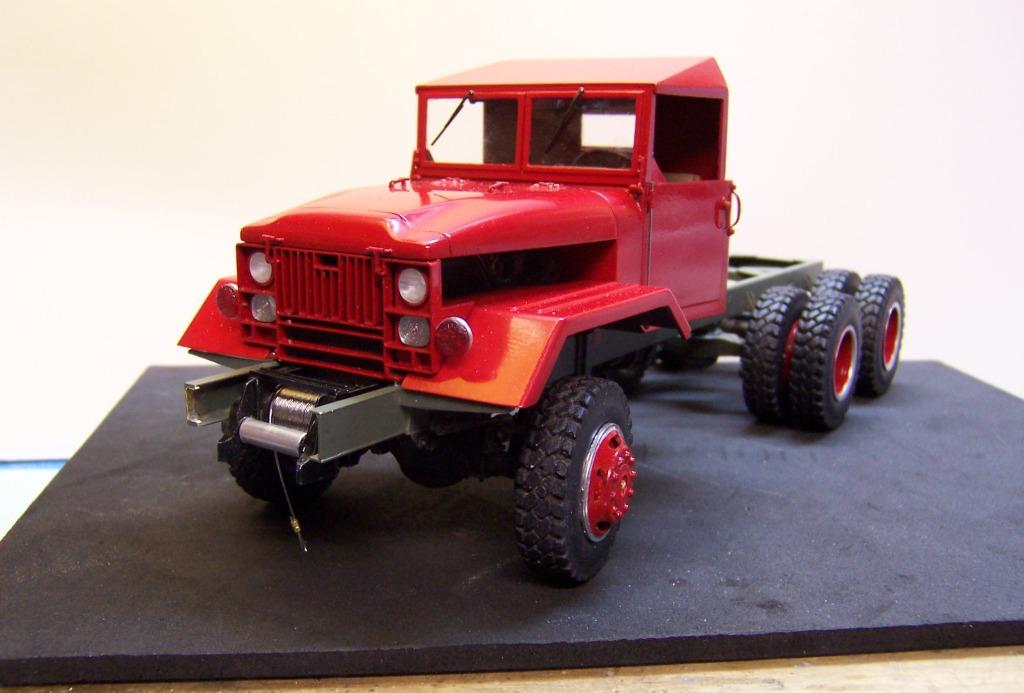

Work began on the brush bars use on this rig. They are made of 3/16" wide channel backed up by small gussets and pieces of sheet stock at the joints. It's pretty flimsy at this point but once all of the bracing gets put in place it will be much stiffer. The smaller bars that go over the top of the cab will be made of brass rod soldered together. They in turn will be joined at the top brush bar. Below the top brush bar will be the extended front bumper. There will be braces between them as well. A front mounted winch will go in between the frame rails so the front bumper treadplate will have to be cut away for it to fit in. I also made up the tread plate pieces that go under the cab and between the front fenders and the body. They form a step for getting in and out of the truck. -

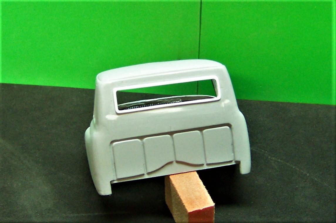

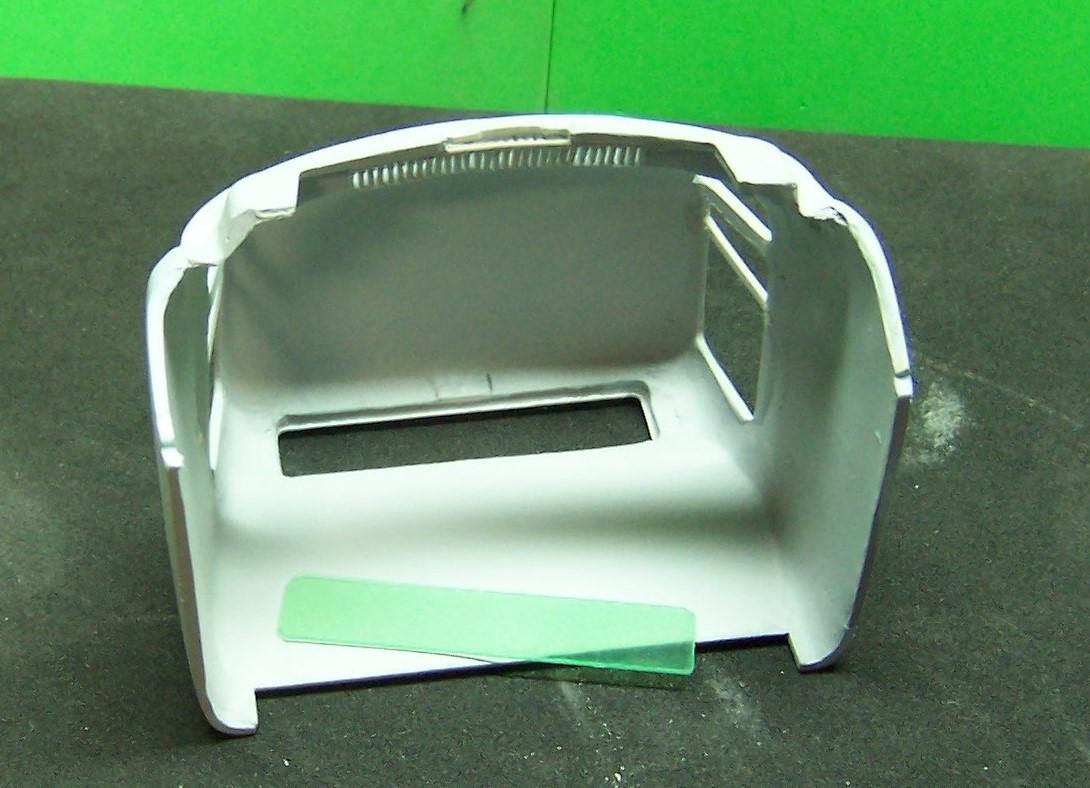

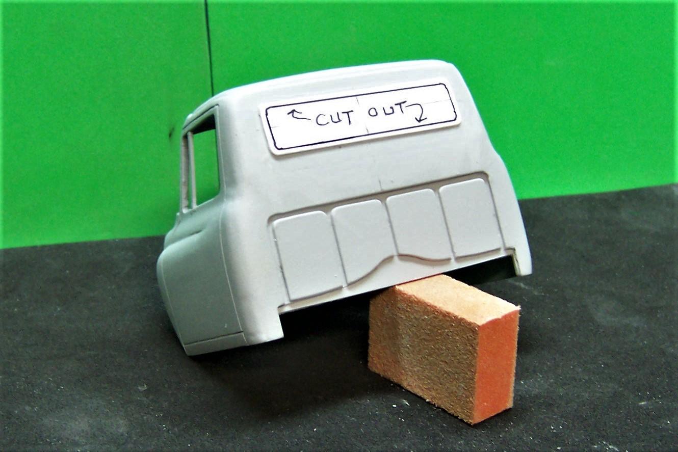

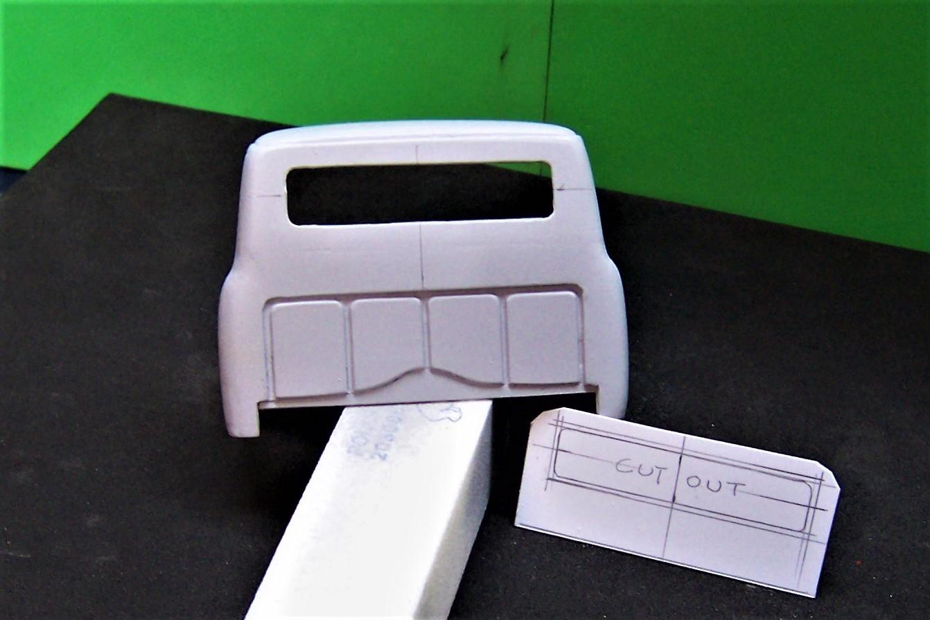

Lots of trimming, scribing and cutting this weekend. Using a Dremel and small bits an inner cut out was made behind the windshield trim. This left just enough material that the windshield plastic could fit against. With that done I used the resin kit template to trace a windshield from clear stock. With a bit of trimming and fitting it now just pops into place without glue. There is a bit of reflection to show that the windshield is actually there. Next the doors were scribed and cut free. Lots of material had to be cut away as the casting is quite thick. It took a while but the back edge of the Xacto knife did most of it. A small razor saw did what the knife could not. Then it was necessary to clean up the edges of the door openings and the doors themselves. In the scribing action quite a bit of material is lost so to close up the openings some 0.010" strip stock was glued in and then trimmed. Some sanding here and there made the doors fit uniformly. Small brass hinges from Micro Mark were glued and pinned in place. A temporary stainless steel pin keeps the hinges in alignment for now. Later on the pins will be cut to length. -
