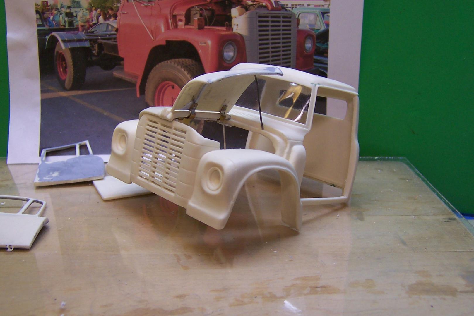

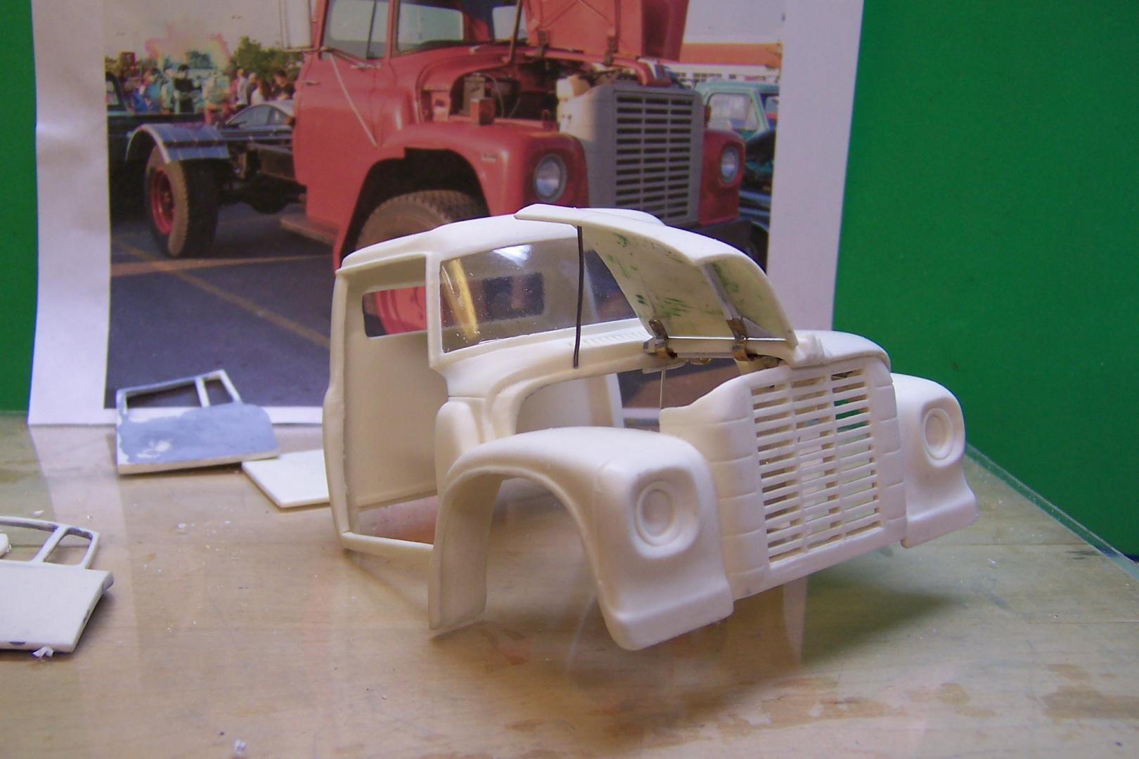

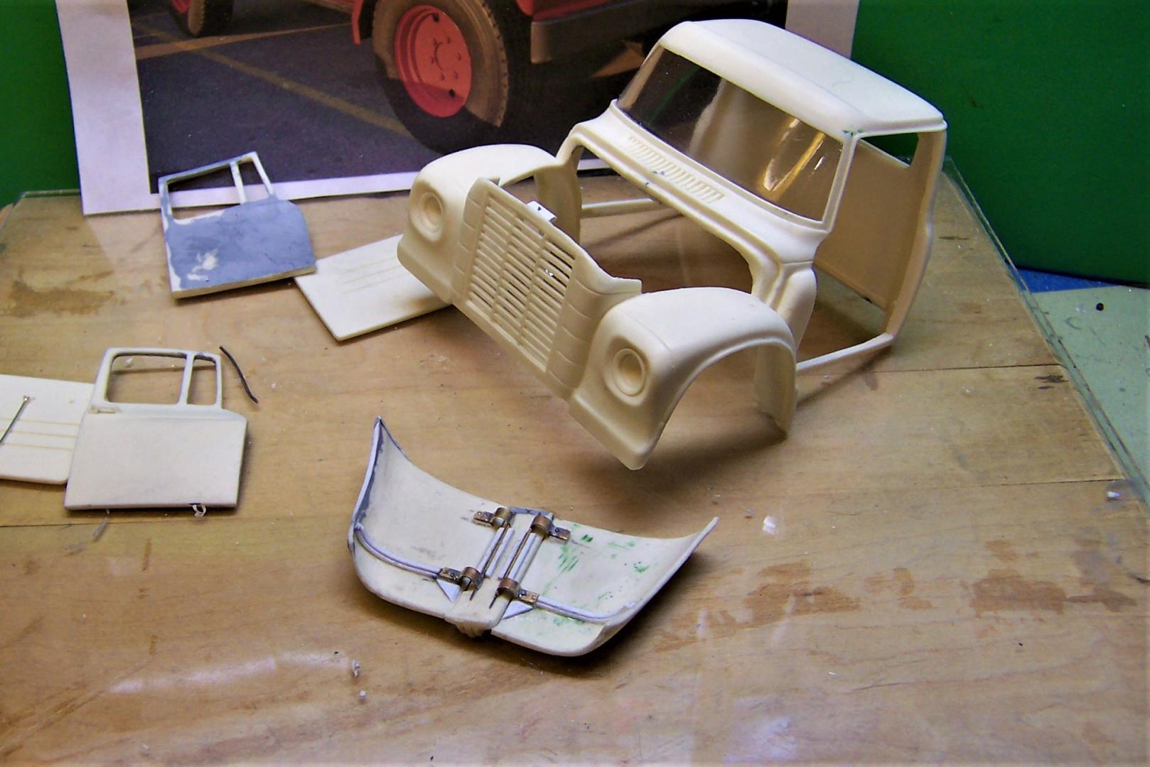

  1. After cutting out the doors and separating the hood sides from the center section it was time to figure out how to best make up the hood hinges. On the real truck they are not very sophisticated and just some curved flat stock that is made to move with the hood when it is opened. At first I tried bending some brass strip stock to make the curve but that meant making four hinges with identical curves. Not easy in this scale. So I sliced some brass tubing and soldered the pieces to some brass flat stock. On the opposite end I soldered some 0.018" dia. brass tubing. Inside the tubing I can insert a piece of stainless steel wire that just fits the tubing and is very stiff. So it is relatively easy to get things to line up properly. If you look close in the photo above of the real truck you can see the hinges that attach to the hood and the center piece. Now comes the fun part; getting the three pieces to fit together and at the same time allow the sides to open. Some thinning of edges and tapering them was necessary to get them to operate but they will open. Here is the hood upside down with the four hinges in place. On each hood side I added a small strip of plastic stock to mount the flat part of the hinge on. I drilled two small holes through the flat hinge part and into the plastic stock and then through the resin casting of the hood. Small pins were inserted in the holes and were superglued in place. The ends of the pins were cut off top and bottom and the ends on the top of the hood were filed smooth. On the center section of the hood I glued pieces of 0.030" x 0.040" strip stock. Against the outer one I laid the middle portion of the brass tubing that just fits between the two hinges. It was superglued in place and another similar strip was laid up against the tubing on the other side. This secured the tubing in place and gave a permanent location for each of the hood sides. The stainless wire slides through the two hinges and the center tubing to hold every thing in alignment. In order to set the hood in place to check the fit I drilled a hole on each end of the center section. On the end next to the windshield I continued the drill down into the cowl and further into a small piece of plastic strip stock below. A pin is temporarily inserted in this hole to hold the back of the center piece in place. At the front I glued a similar piece of strip stock under the center section next to the grill. I drilled another hole up through the strip and into the center section of the hood. A pin was inserted there also. Now I have a stable arrangement for checking to see if the hood side close smoothly and that the bottom of the hood edges fit against the top of each fender. On the driver side I had to adjust the bottom of the hood with some strip stock to get a good fit. Unlike the hood when it is one piece, cutting it apart requires some refitting due to the hinges and the separation of the three sections. Some details will be added to the underside of the hood pieces similar to the actual hood.

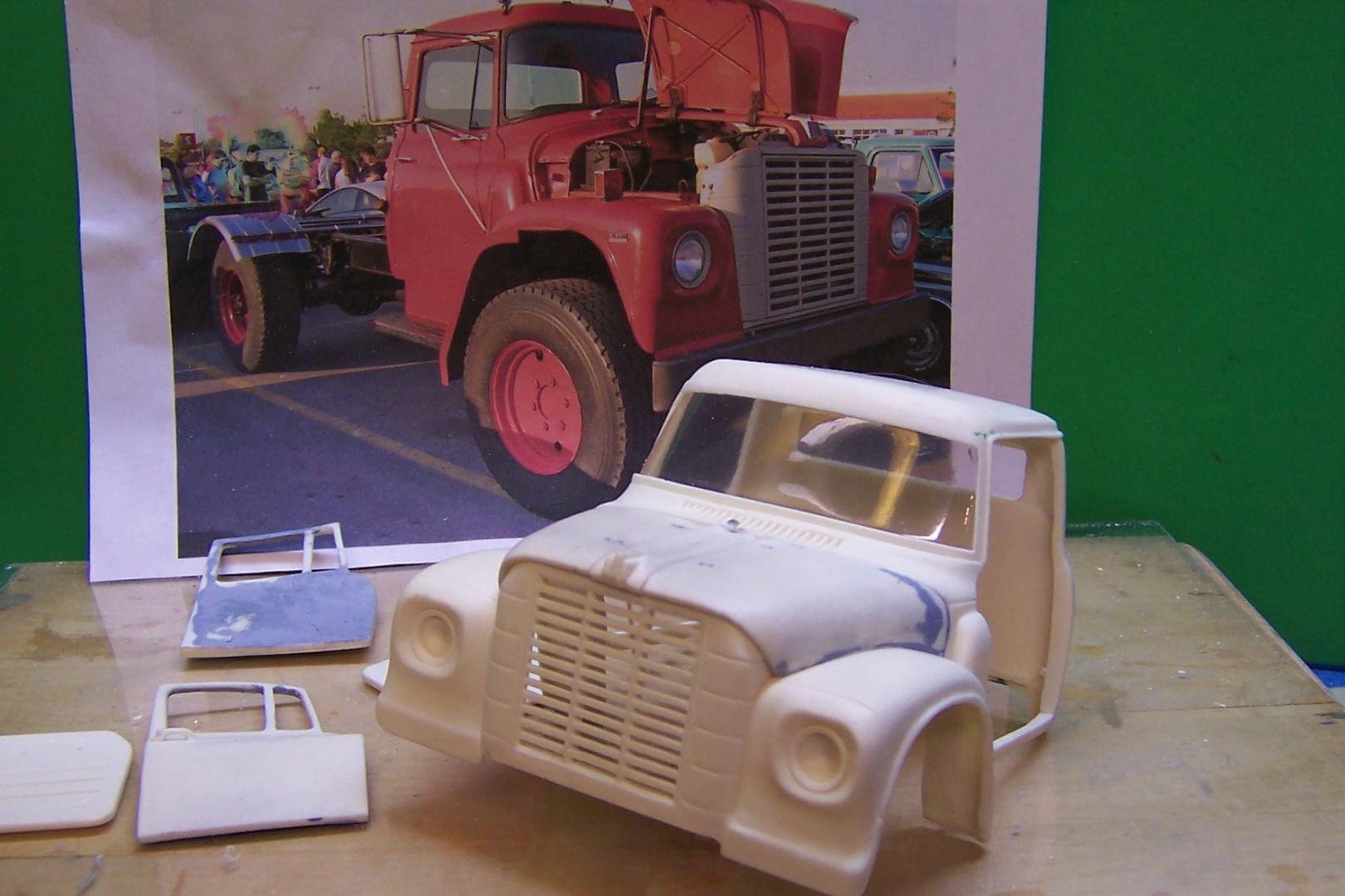

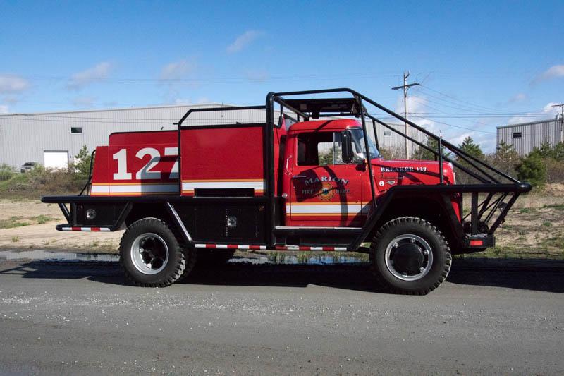

  4. And another build begins. I don't have any specific information yet on the truck itself. That will be forthcoming. However, I do have a photo of the rig to be built. Originally built by the Maxim Motor Company of Middleboro, MA, it was recently upgraded with new body and bar work as well as a new paint job. The upgrade is more in line with current practices of shortening up the rear of the body and making it higher. The reason is to allow the truck to transition from dirt roads to the adjacent woodlands without bottoming out. Gone is the concept of a low rear step where the crew would ride. As with the Loadstar dump I will be posting in progress photos and some how to's along the way. On this model the doors are going to be opened as well as the butterfly hood. In the photo below you will see the right side door has already been separated from the cab and the hood sides have been cut free of the center section. It was a pretty easy thing to do albeit a rather tedious one. The resin casting scribes well with the back of a sharp Xacto knife and a razor saw. Real care had to be taken around the corners of the door and where the door line is rounded near the bottom of the windshield. With the doors free, they will be sanded smooth inside and made more adaptable to the inner door panels. There was a bit of a learning curve with the vacu-form machine to get a nice clear windshield. I found a source for good clear plastic that is pre-cut to fit the machine and the results have been pretty nice. Once trimmed to fit the windshield just pops into place and no gluing is necessary. Dave Natale did a great job of casting the windshield trim without any flaws and that made the fitting of the windshield real easy. The benefit of the vacu-formed windshield is that there is no stress on the plastic and with a good fitting buck for the plastic to form against in the machine, all it needs is trimming around the edges. In the photo below you can also see that the grill was opened up as well. Again Dave Natale did a great job with the casting by leaving just a thin skim coat of resin on the back of the grill. It is easily removed with an Xacto knife and then the opening can be cleaned up with a small flat file. I also set the floorboard/firewall in place as it comes as a separate piece in Dave's kit. The opening between the cab rocker panel and the floorboard will be filled in with plastic stock to stiffen the cab and make for a clean fit for the separate door. Six spoke wheels are used on this truck. The fronts are covered with a full hub that covers the inner workings of the all wheel drive feature of the front axle.

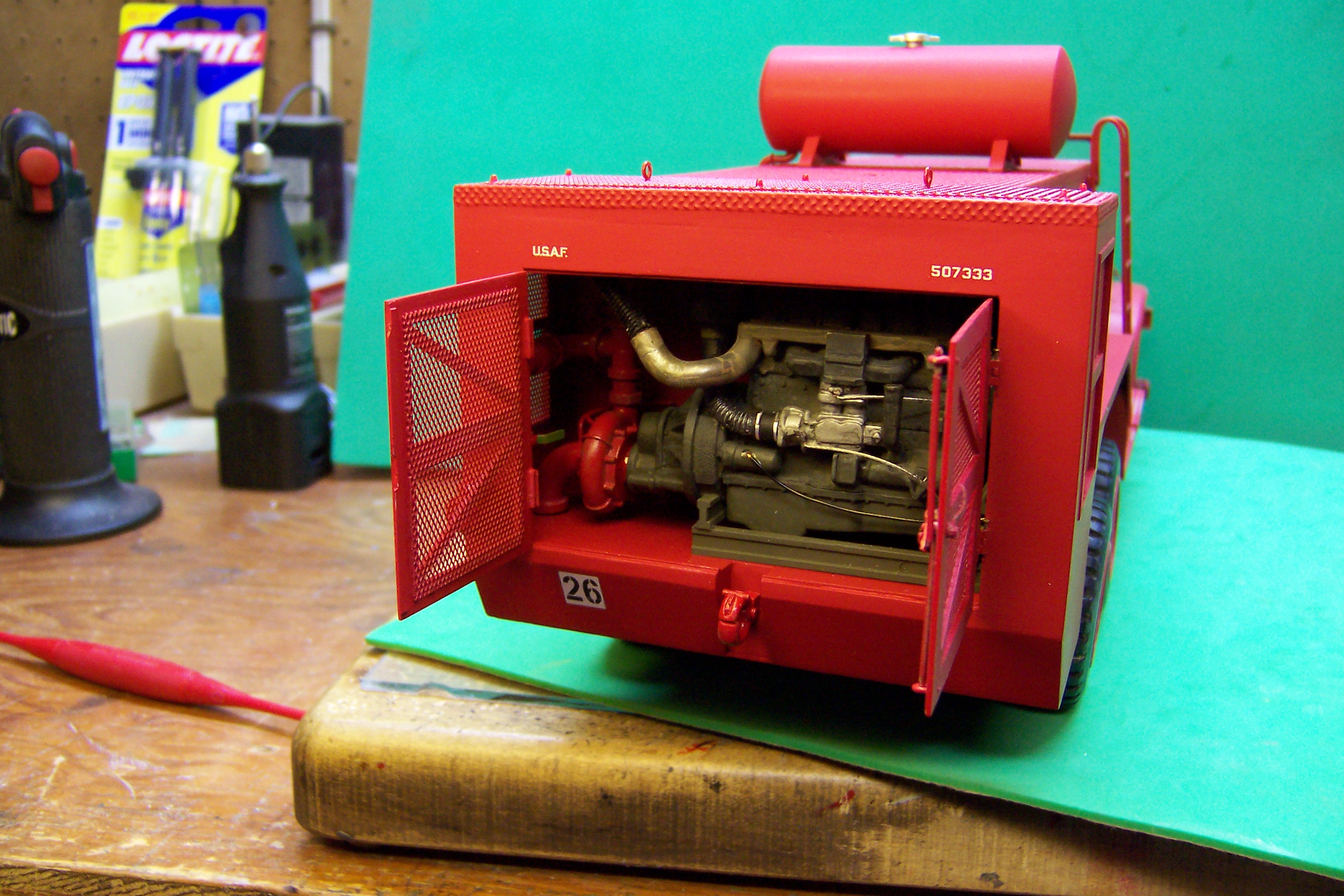

  8. Here you go, Brian. It's a bit tight in there as you can see. I used the IH Scout engine as it is typical of the one IH used in the medium size trucks. The automatic transmission was cut off and was replaced with a standard one that is much smaller. I de-chromed the valve covers in hopes that the "International" would show up better but it didn't. The script is so small it sort of got buried in the paint.

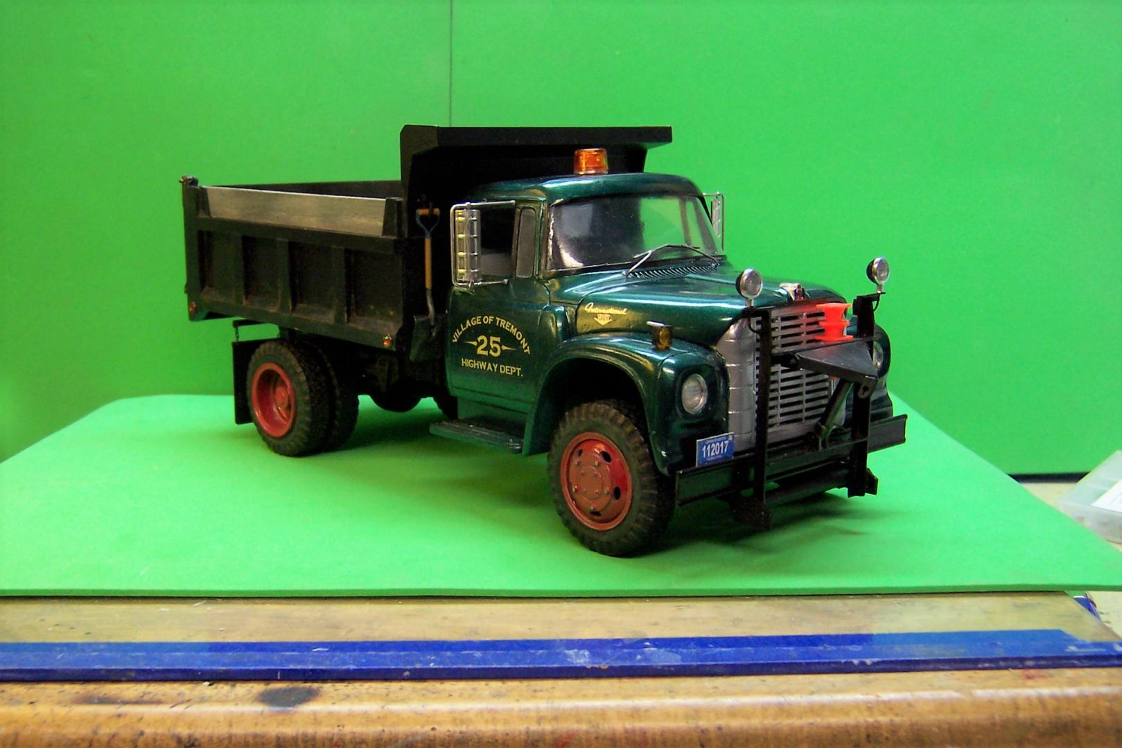

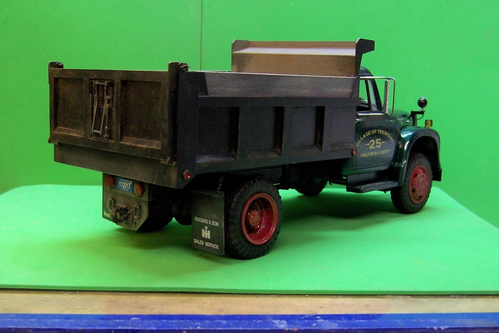

  9. Final touches were put on this build last nite so I'm calling it done. It was a good exercise in working with the resin casting. On the next one I will make a few changes that will enhance the build a bit more. But here it is ready for work!
  10. Ok, We're done. I think this rig is ready to do some road work. Just have to go and get a little cold patch to put in the back and pick up a small roller! The body and its details are now done. Some mud flaps were added to the rear, some license plates and a short square shovel hangs from the front of the body. And we added some traffic cones so that when they actually do some patching, traffic will keep clear!

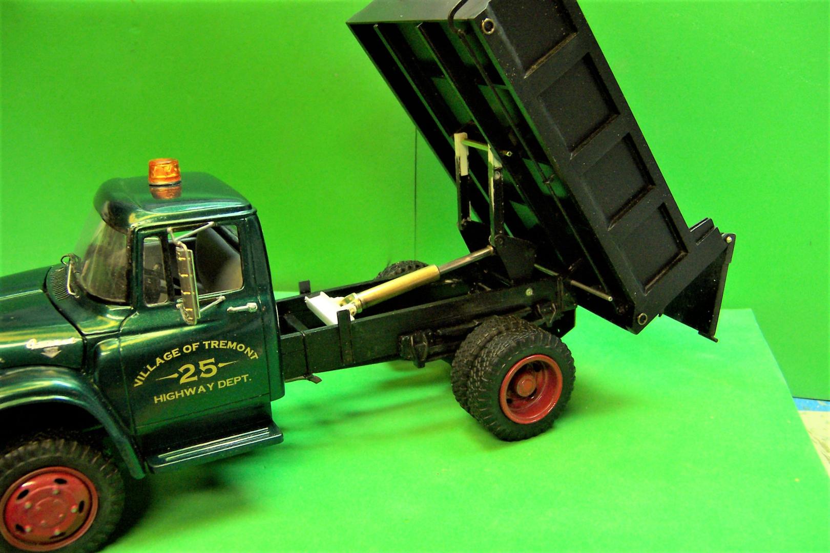

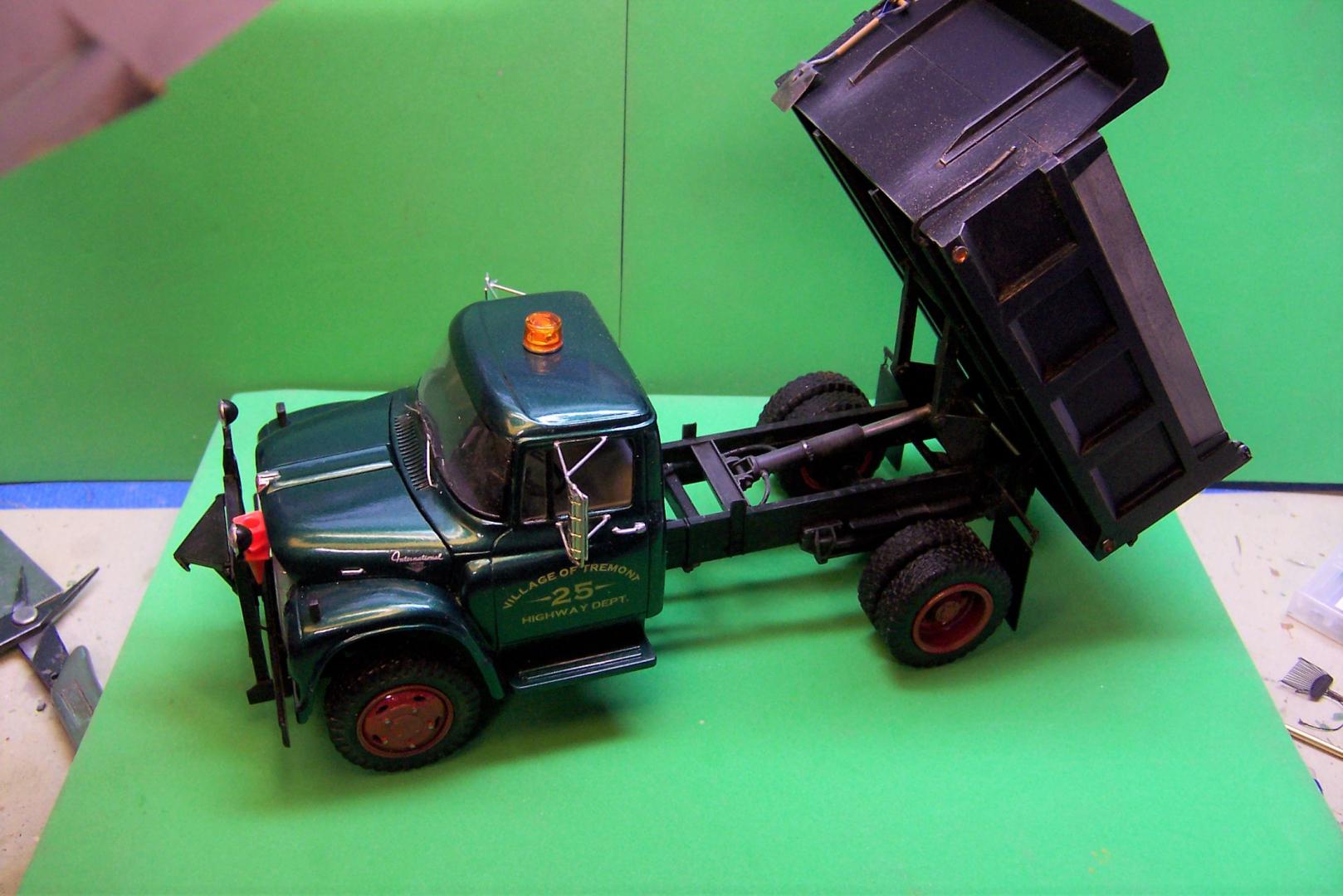

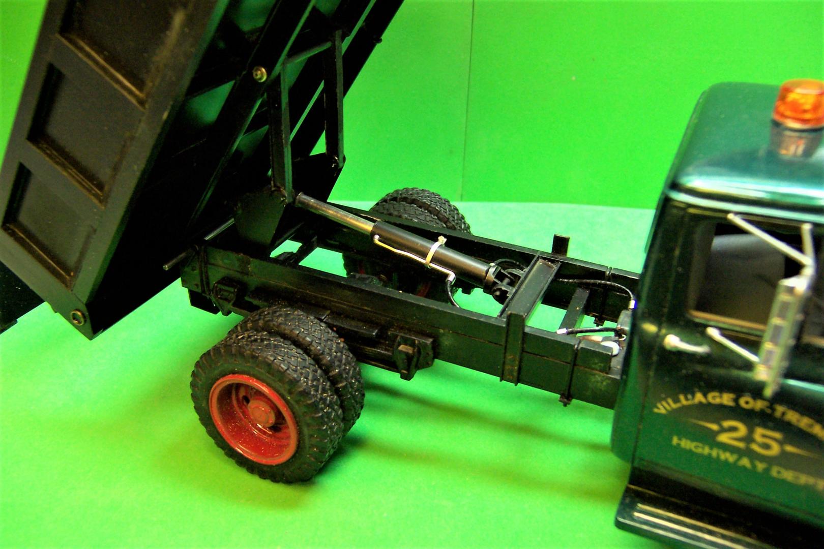

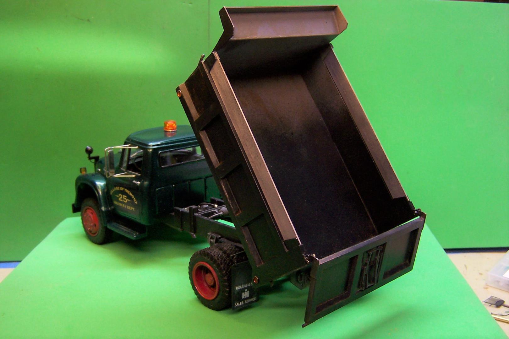

  13. The last couple of days were spent making up the lift mechanism for the body and the hydraulic cylinder to raise it. After much trial and fit the lift mechanism was finished up. It took some adjusting to get the body to raise all the way and at the same time have the lift settle in between the frame rails without cramping. I ended up having to cut away some of the differential to allow one side to drop down. Guess I won't be driving it too far! The cylinder and piston are brass tubing and aluminum tubing. There is a stop on the low end of the piston and one on the upper end of the cylinder that keeps the piston in place. The hydraulic line fittings are bead details from a craft store. The two circles on the ends of the body are for reflectors. They will be painted silver and then topped with clear amber on the front and clear red on the rear. The body has now been painted and the cuts that had to be made for the tailgate locks have been filled in with sheet plastic and sanded smooth. The only thing that shows now are the ends of the locks that keep the tailgate closed. With the body up the tailgate lever can be pulled, the locks raise up and the tailgate opens.

  15. Got the latch areas put back together and covered. Body was re-painted and weathered a bit. Now I'm working on the lift mechanism for the body and the hydraulic piston that pushes it up. Will post some pix as soon as I have all of the parts together.

  17. It's been a while since any progress was posted but I was having a brain f--t as to how to do the tailgate and the locks for it. I wanted a small sliding door in the center of the gate since my truck will be a municipal rig that on occasion would dispense some cold patch to fix pot holes. Going on line I found a couple of images of typical gate mechanisms. The first two pix show the sliding door in the closed position and then in the open position. All the gate parts are made of brass stock; brass angle, sheet, rod and strip. A bit of a pain to get together but there it is. The next issue was how to make up the moving locks that hold the tailgate closed. The solution involved cutting into the completed ends of the body to open up a place for the L shaped locks to sit. Then came how to make them move together. At first I thought of hinging them at the corners of the L but it presented an additional problem of how to make them rotate. After trying unsuccessfully to rotate them about the corner of the L I made an adjustment and now have them rotate from the bottom. The holes at the corners of the L did have a function in the end, however. I was able to temporarily screw the locks in place while the rest of the work was done. You can see the unused holes in the second photo. Here's a better look at it all. There is a piece of 1/16" diameter tubing soldered to the end of each lock. In turn these pieces were inserted into the next size larger tubing that runs across the width of the body. On the larger tubing another small piece of brass stock was soldered that would act as a cam. With both of the 1/16" pieces soldered to the larger tubing they act together and the cam makes them rotate. The rotation moves the L shaped piece up and down which unlocks and unlocks the tailgate. Next to the cab is the lever that operates the locks. A connecting piece of brass rod joins the lever and cam. The lever now moves both of the locks and allows the tailgate to open. Parts will be painted later. Here's the underside showing the brass tubing that extends from side to side connecting the two locks and 1/16" tubing. The cam is located close to the lock in the top of the photo. Now that all of this is in place some small pieces of plastic sheet stock will be used to fill in the open area around the locks. A bit of sanding and repainting and the only thing visible will be the end of each lock where it holds the tailgate closed.
