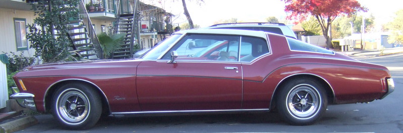

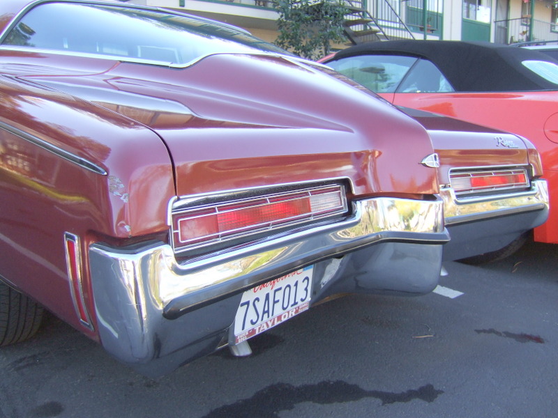

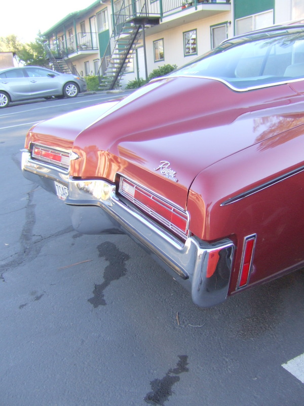

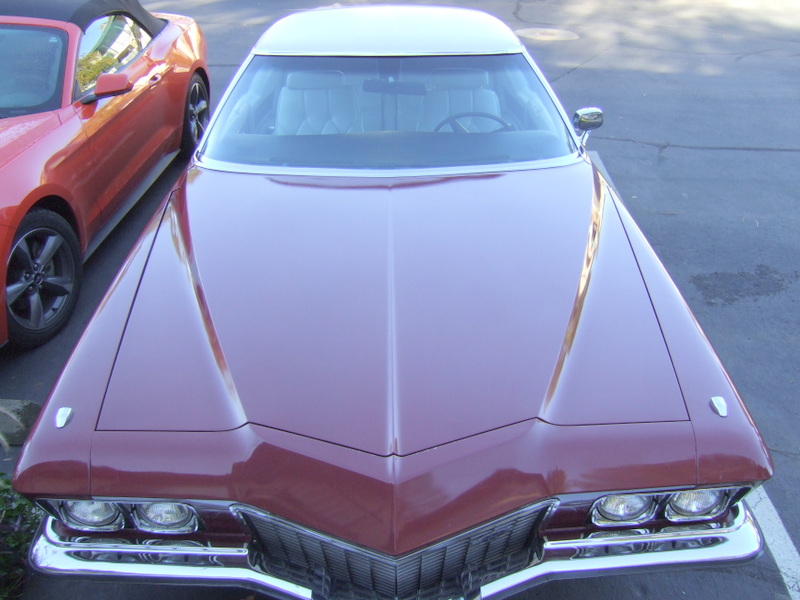

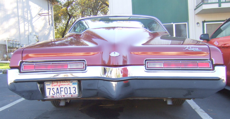

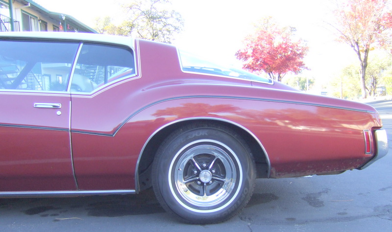

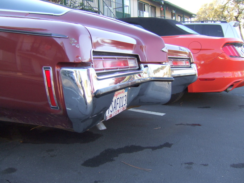

One thing on the resin kit that has always bugged me is that the length of the rear from the rear of the rear wheel opening to the end of the quarter panel is way too long. Get out your saw! I'm guessing .080 to .10 needs to be removed. -

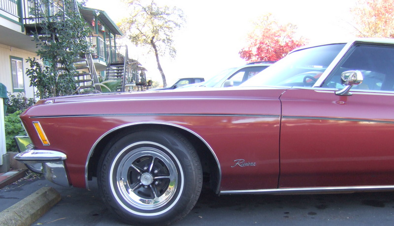

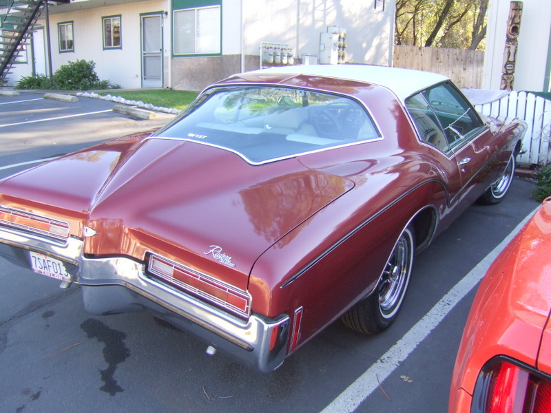

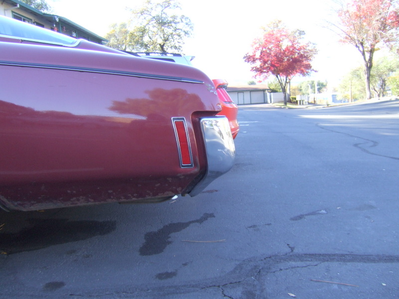

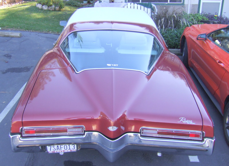

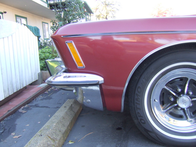

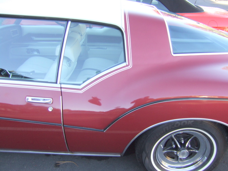

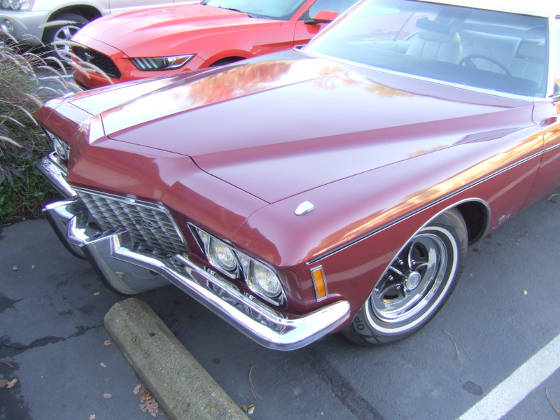

Getting the Riv out of storage and will take photos today. -

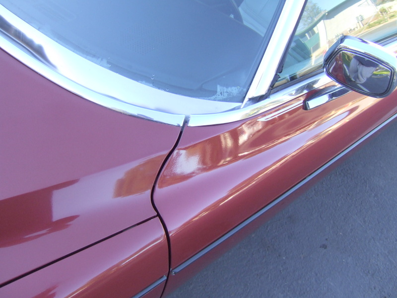

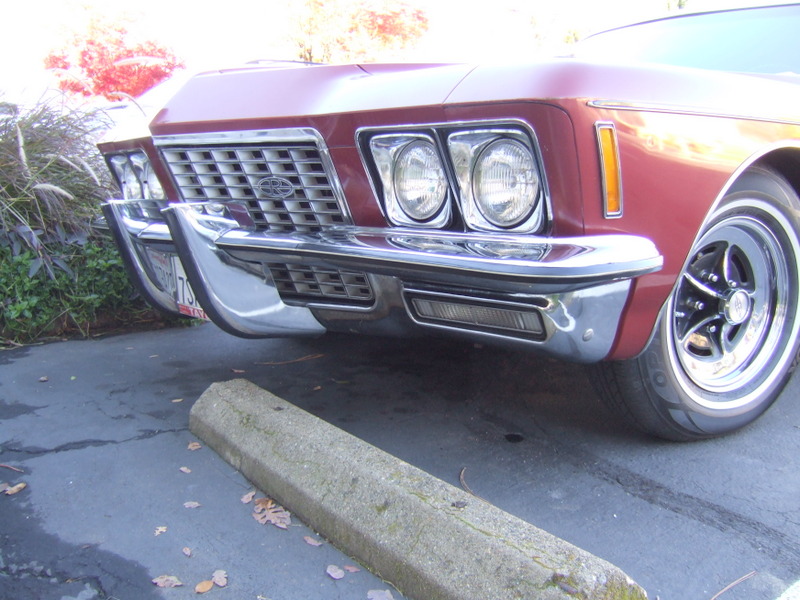

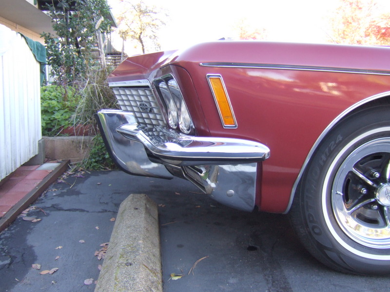

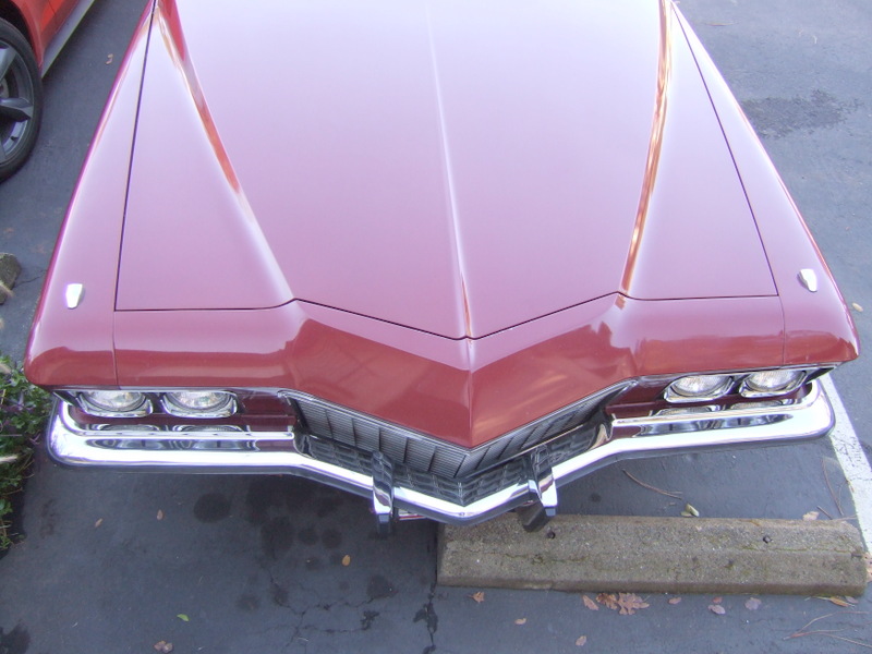

No I am talking about the angle of the front leading edge of the front fenders. they are too blocky, need to be angled back more. do a Google image search of 72 Rivieras, find a straight on side shot, no need to worry about the size, then take the model body and hold it up to the photo to check the angle. -

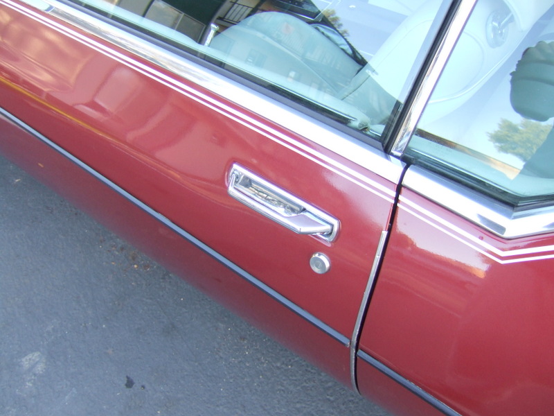

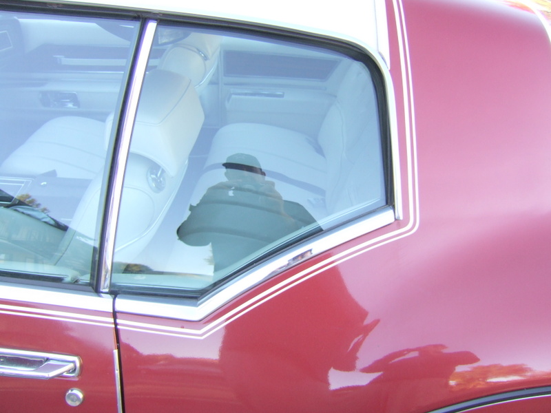

I have a real car if there is any detail photos you need. -

Looking good so far. Also you need to shrink the boat tail protrusion by about 50% and give the leading edge of the front fenders more of a swept back angle. -
