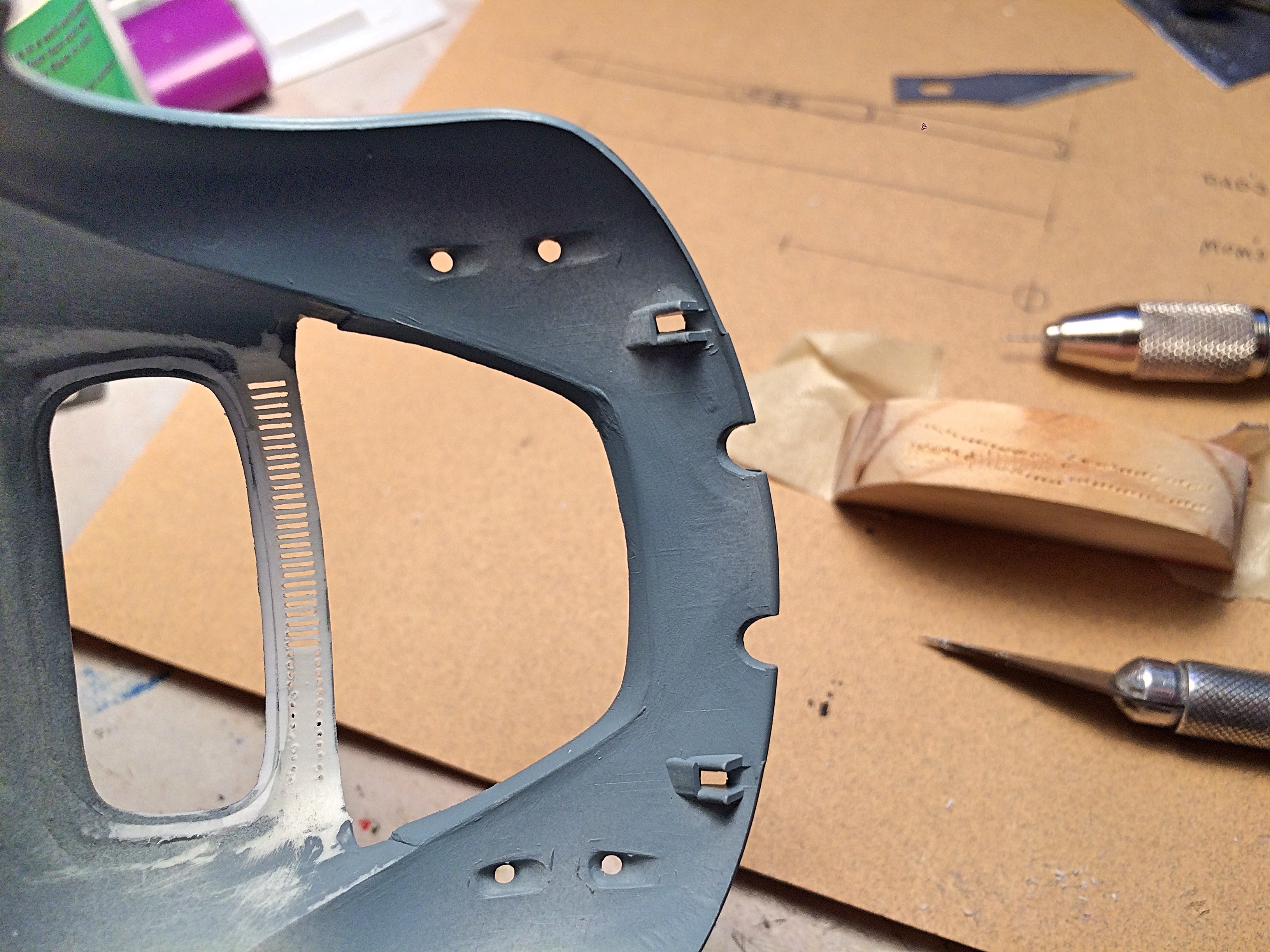

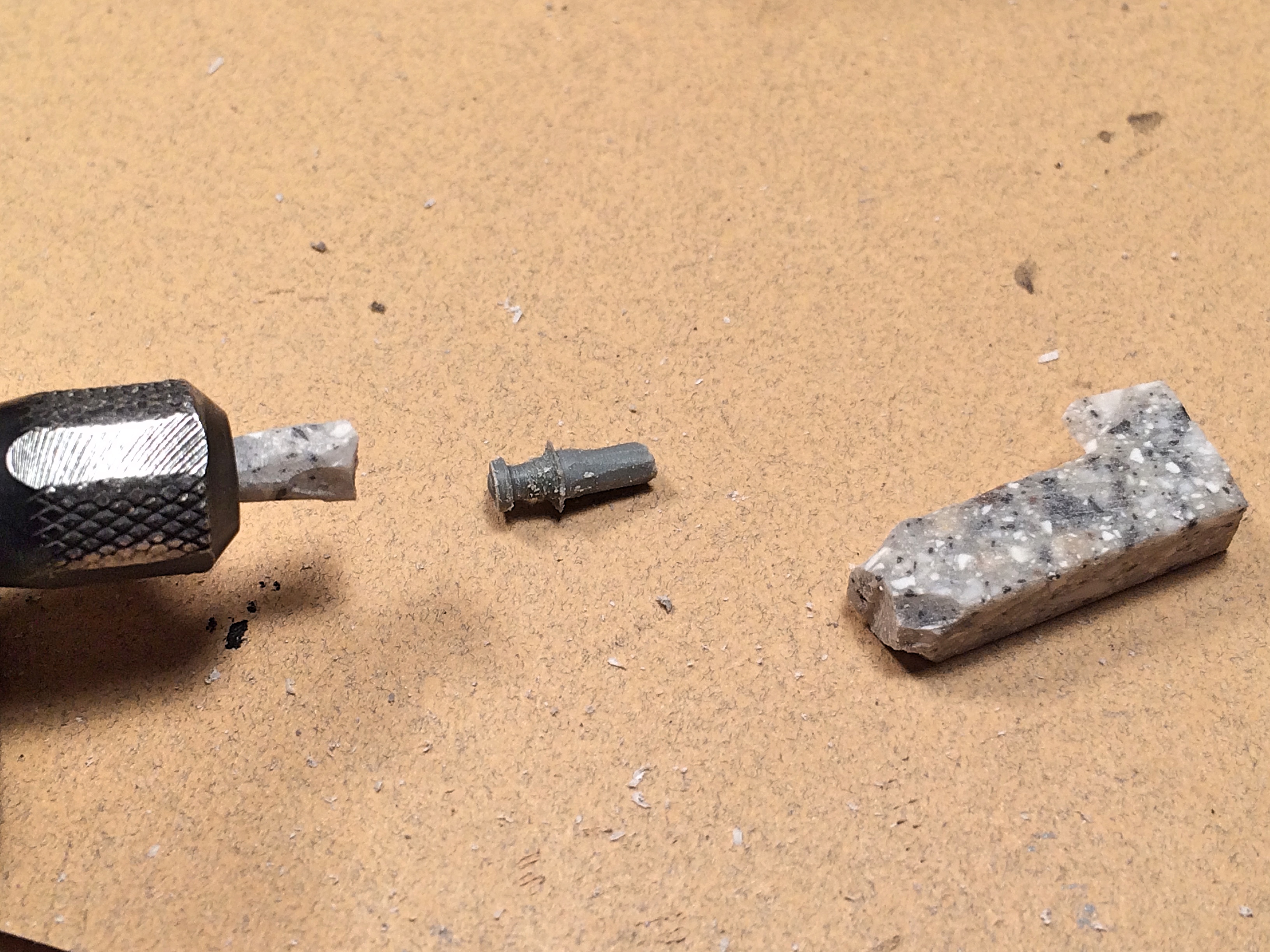

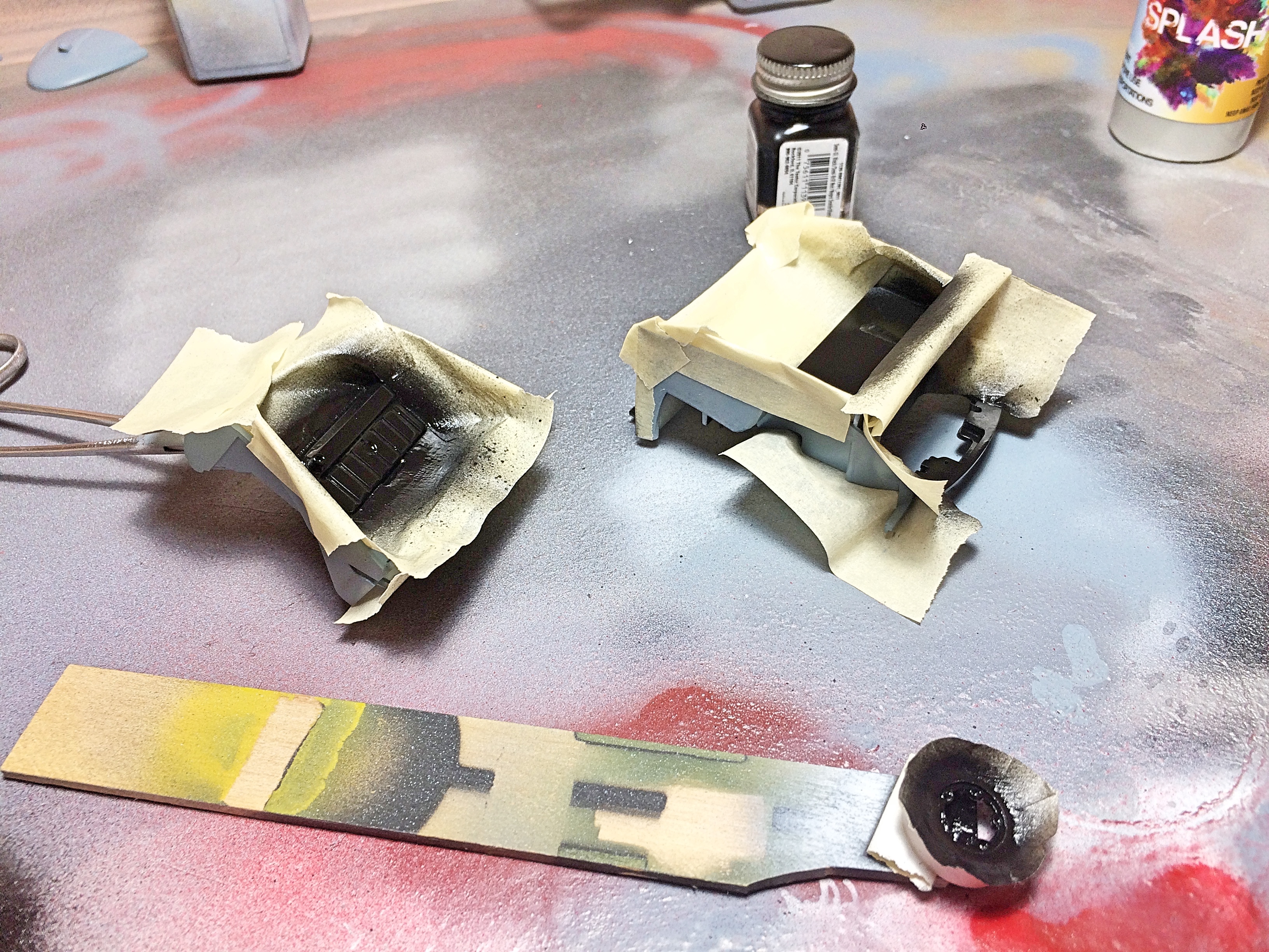

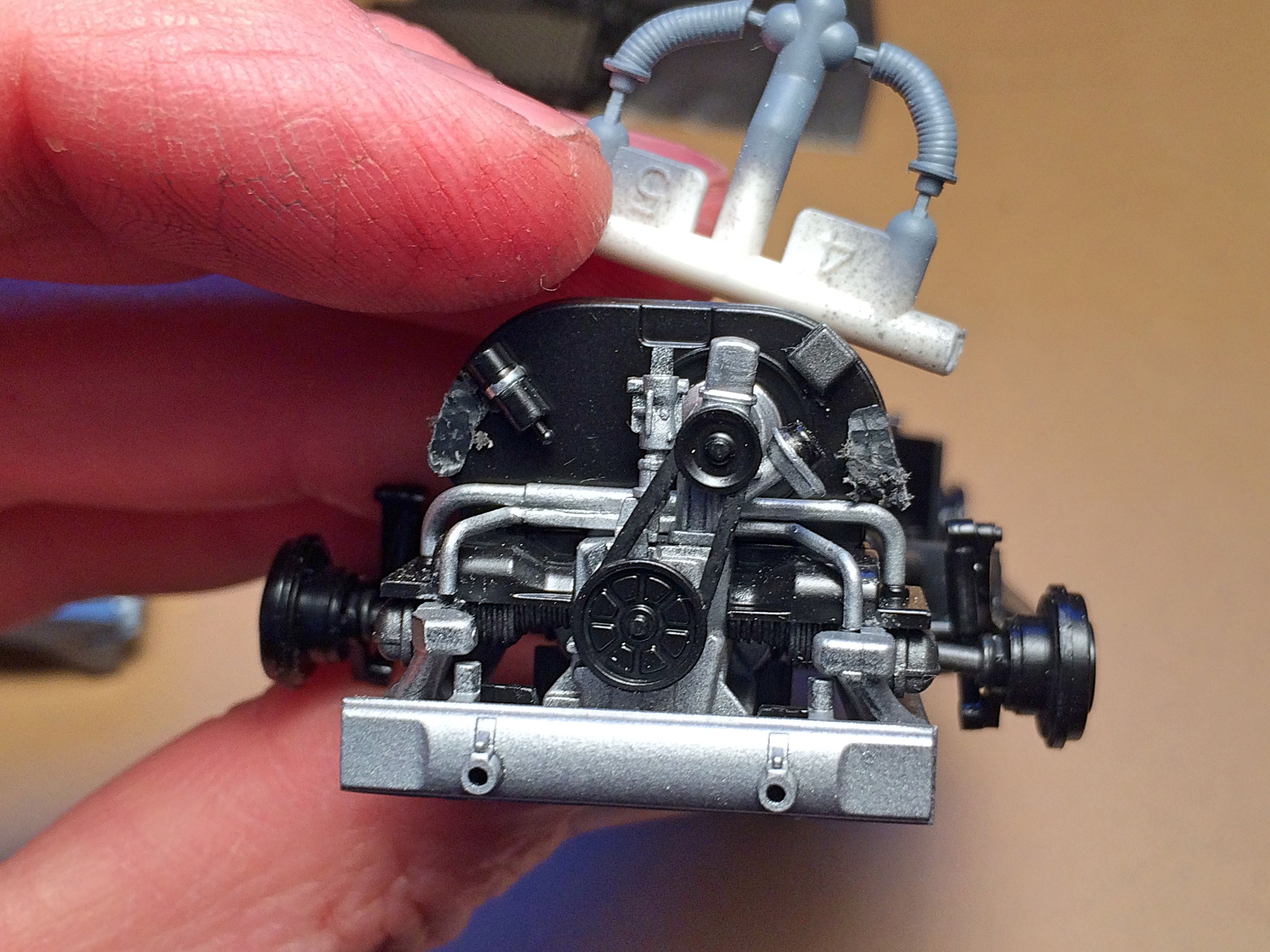

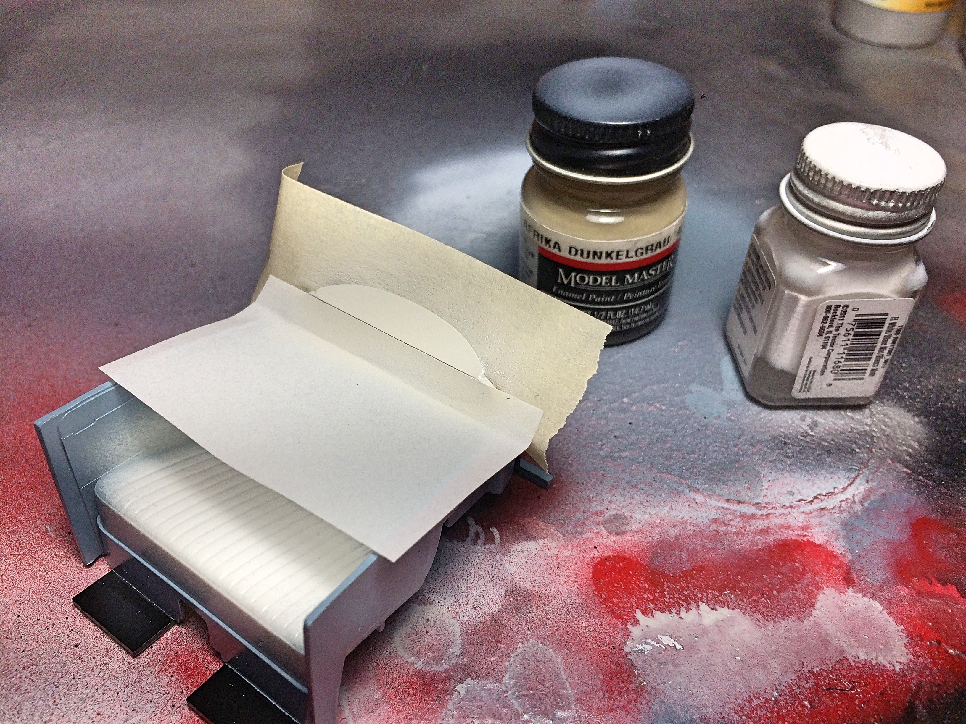

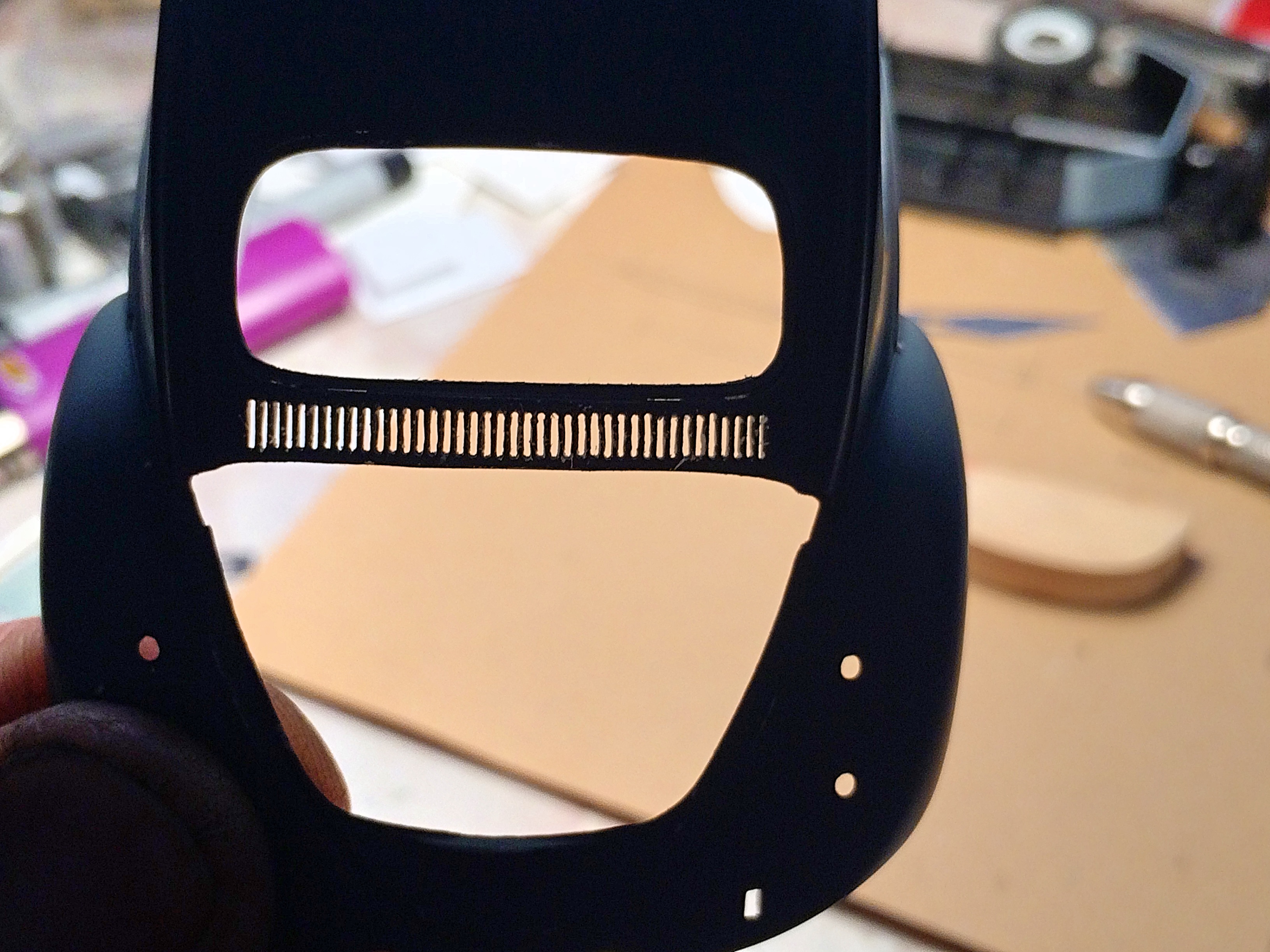

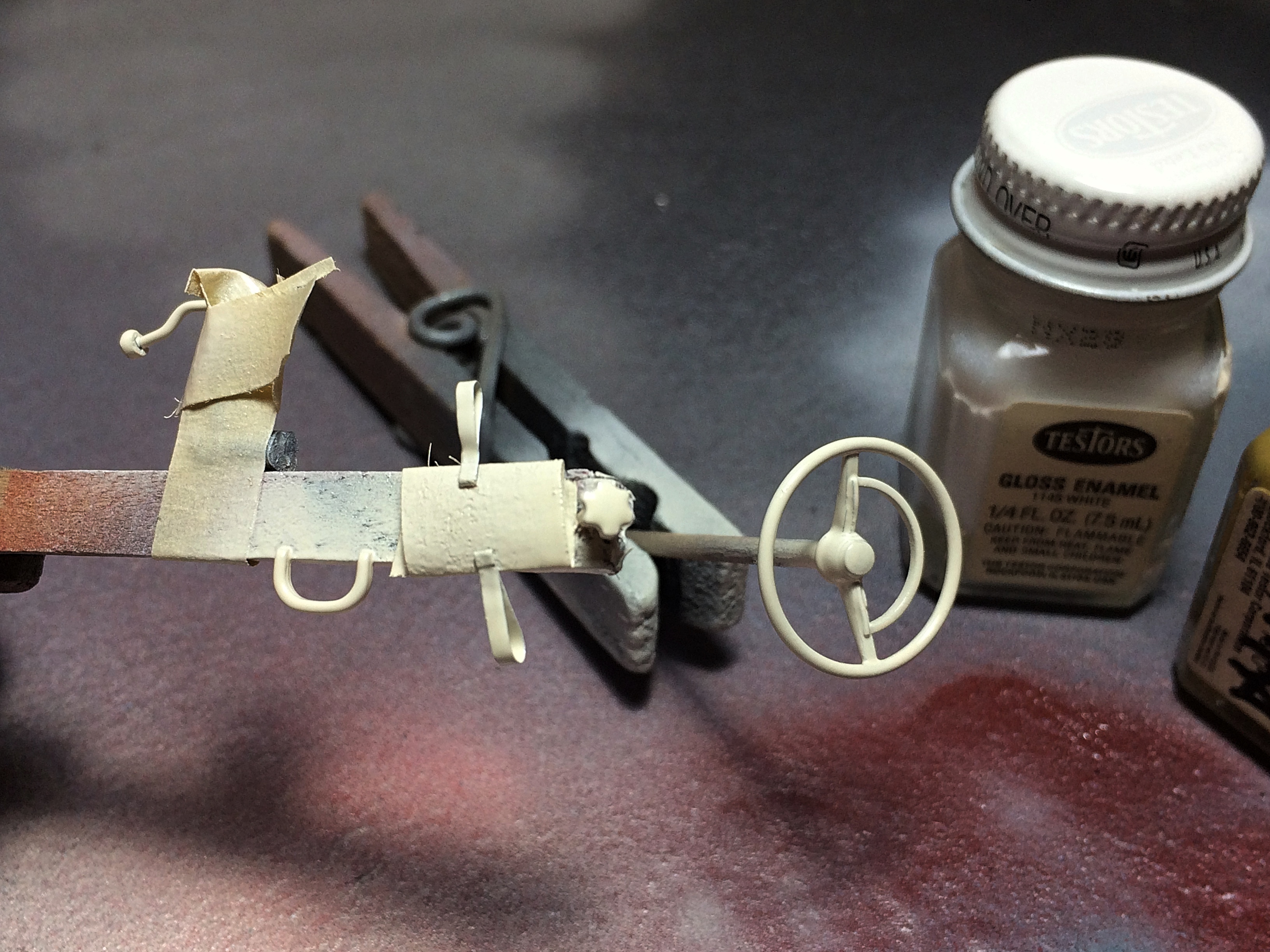

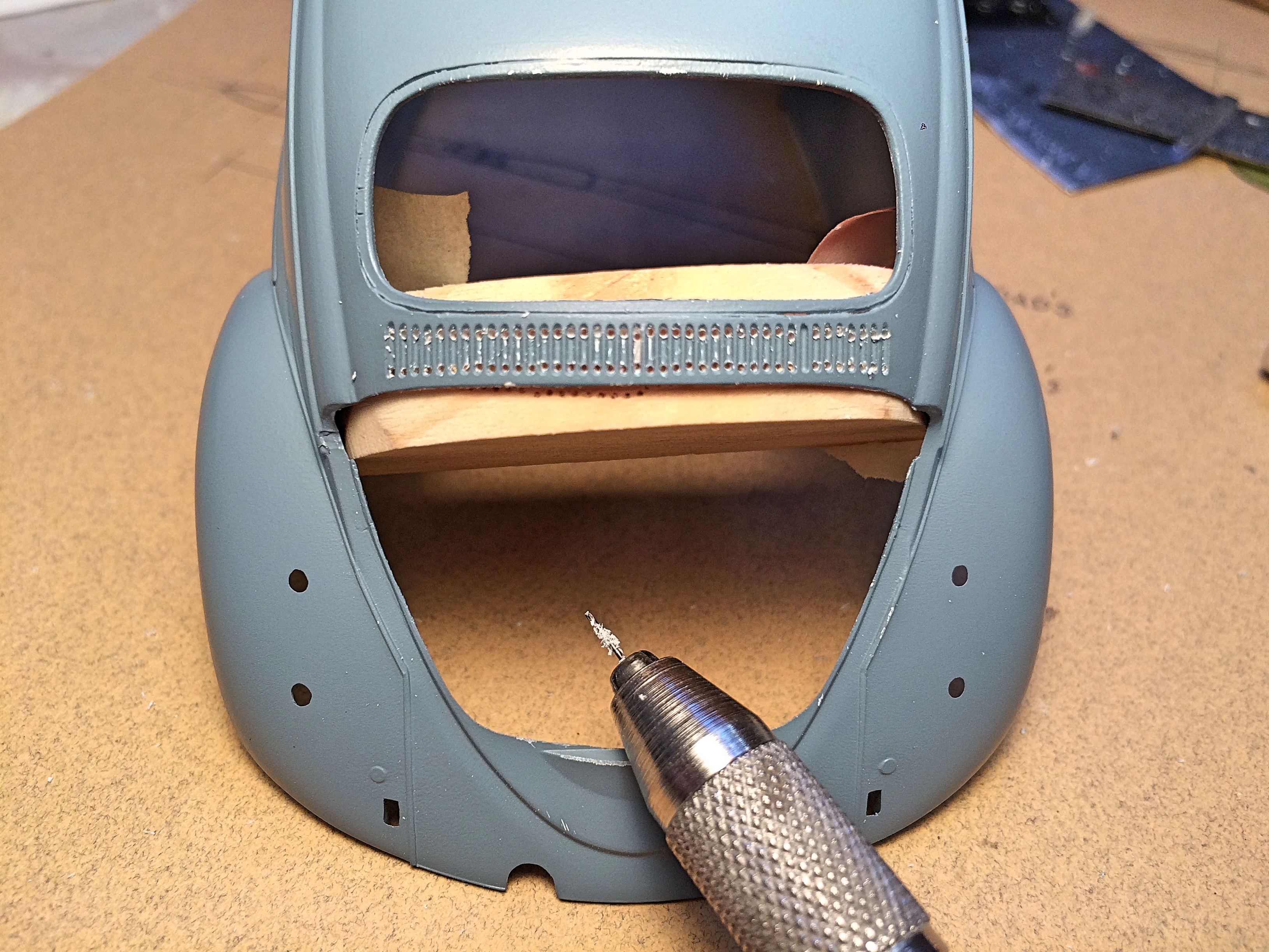

I *had to* modify the engine fan shroud, wish it wasn't assembled. So now it's a "stale air" version. This is after I ruined it with the Dremel. Did I say I hate brush painting? Semi-gloss black. That itty bitty panel, masked with velum so the fresh black would not get tape wrecked. Now for my crazy moment, it's something that bugs me on most models, the grills *need to* be opened up, because again, I hate brush painting flat black in the recesses. I started out with the Dremel, but did not get far, then a sanding stick. Then I took an old #11 blade to the bench grinder, and then scraped dow until I could just see the slots. I had beefed up this area when I modified the window, highly recommend if you do this. Then I drilled each end of the 40 slots. I made a wood block to support, using the bench disk sander to conform to the body. I dragged through each slot to get a little deeper. Then I put in a new #11 blade, and cut through, then flipped over and carved out each slot. I'll go over this one more time, after my eyes reset. It's an air-cooled engine, gotta have open slots man! Heater control knob, have to ditch the two lever part. Tried to use sprue, but it melted when I turned down the shaft, twice, no matter how slow I went. So I roughed out a piece of Corian, and started with a rough file, then used an old #11 to turn it down. Corian has a higher heat tolerance, I love the stuff. Used steel wool to smooth before cutting off. I used a tiny round file to make the notches. Since the grab handles are the same color, I made those from wine bottle foil. I had modified the steering wheel earlier. So now I'm contemplating doing rubber floor mats, I see carpet kits are the rage, but I'm sure my dad would have been good with rubber mats because the Mercedes had them, much easier to clean. I can't tell what color the interior is, have some charts. Then of course the rack, and three more poles, four bindings, two more skis, boots, coats, gloves, maybe a bag with some chains sticking out......

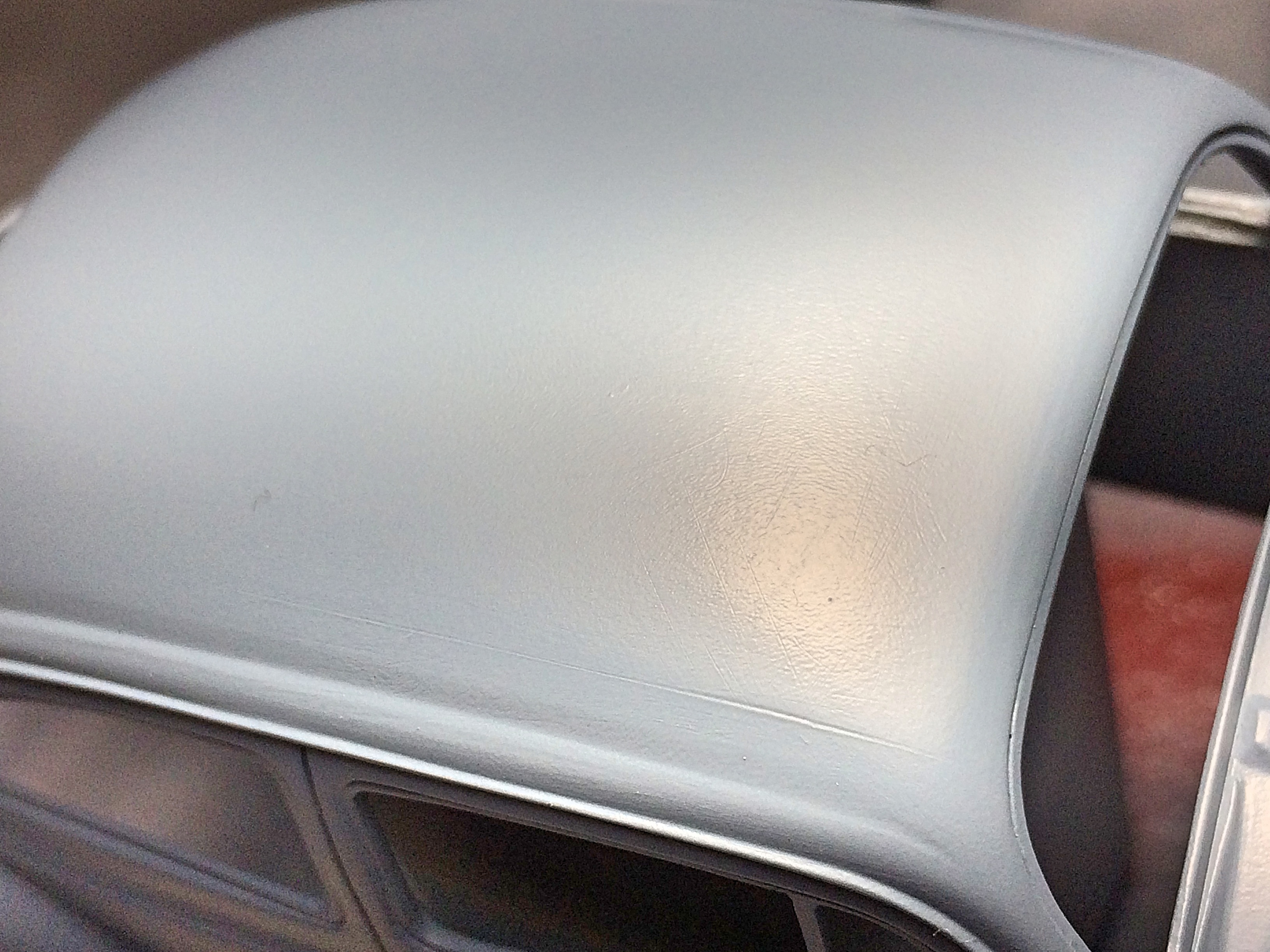

You will never be able to hide that. My two cents, vacuum-form a new window using that as the form. Sorry, I've had that happen too, but not half way across the window!

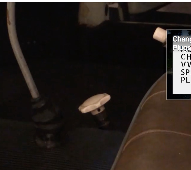

Now I'm entering the what-did-I-get-myself-into stage. The 1960 Bugs did not have the twin levers between the seats, so trying to find pictures of the heater control knob was nearly impossible, so I'm looking at YouTube University. Plenty of pictures of just the knob, but I have found two videos of what it looks like on the floor. But now I find out this would be considered a "stale air" car, which did not have the heat tubes as the kit has, so now I need to decide if I should modify the already painted and mostly assembled engine. Rivet counters would know. I also found the optional gas-fired heaters on eBay, 3 different brands, but not going there! My "oh rats" moment at 9:16 - 9:43.

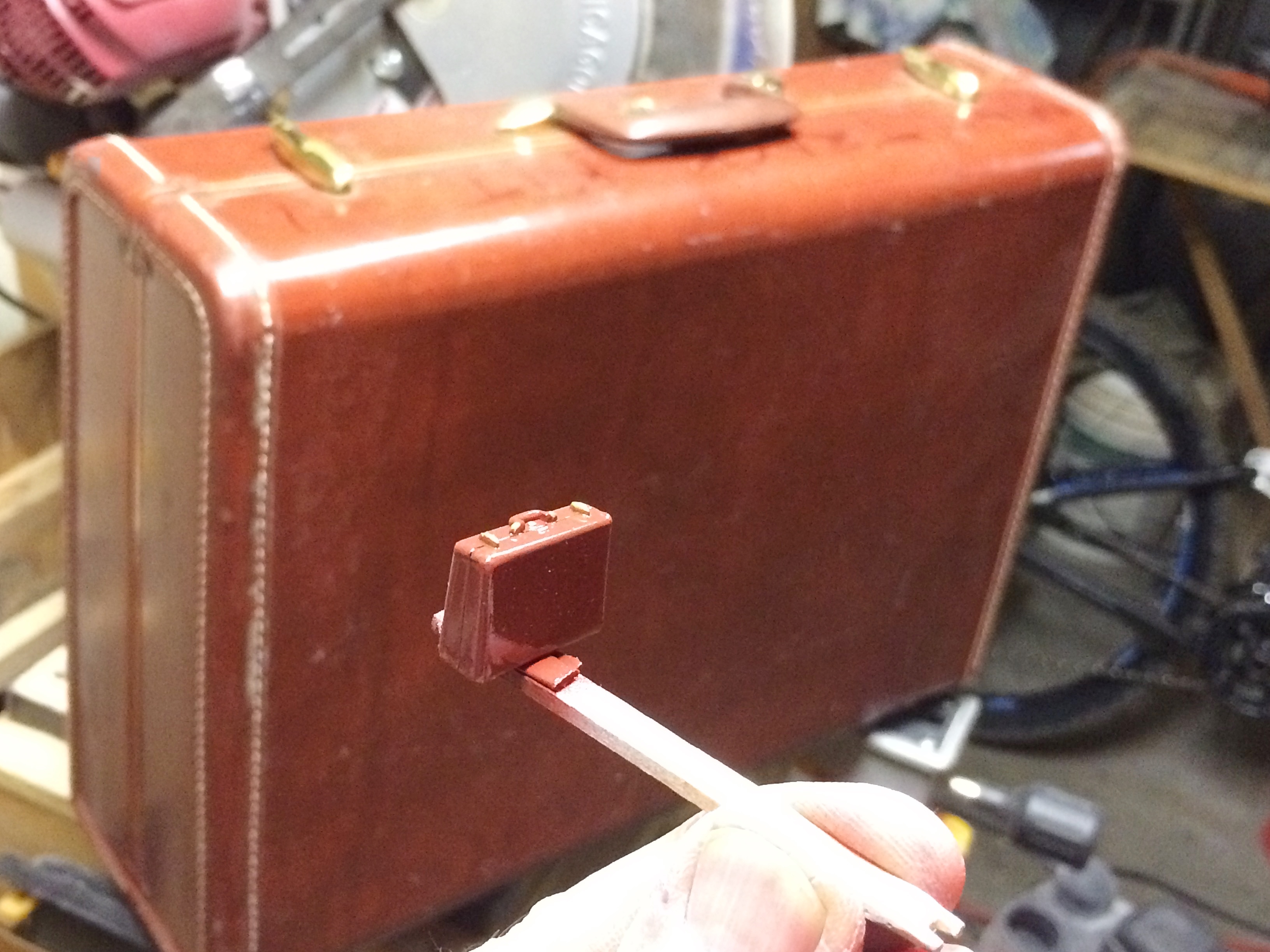

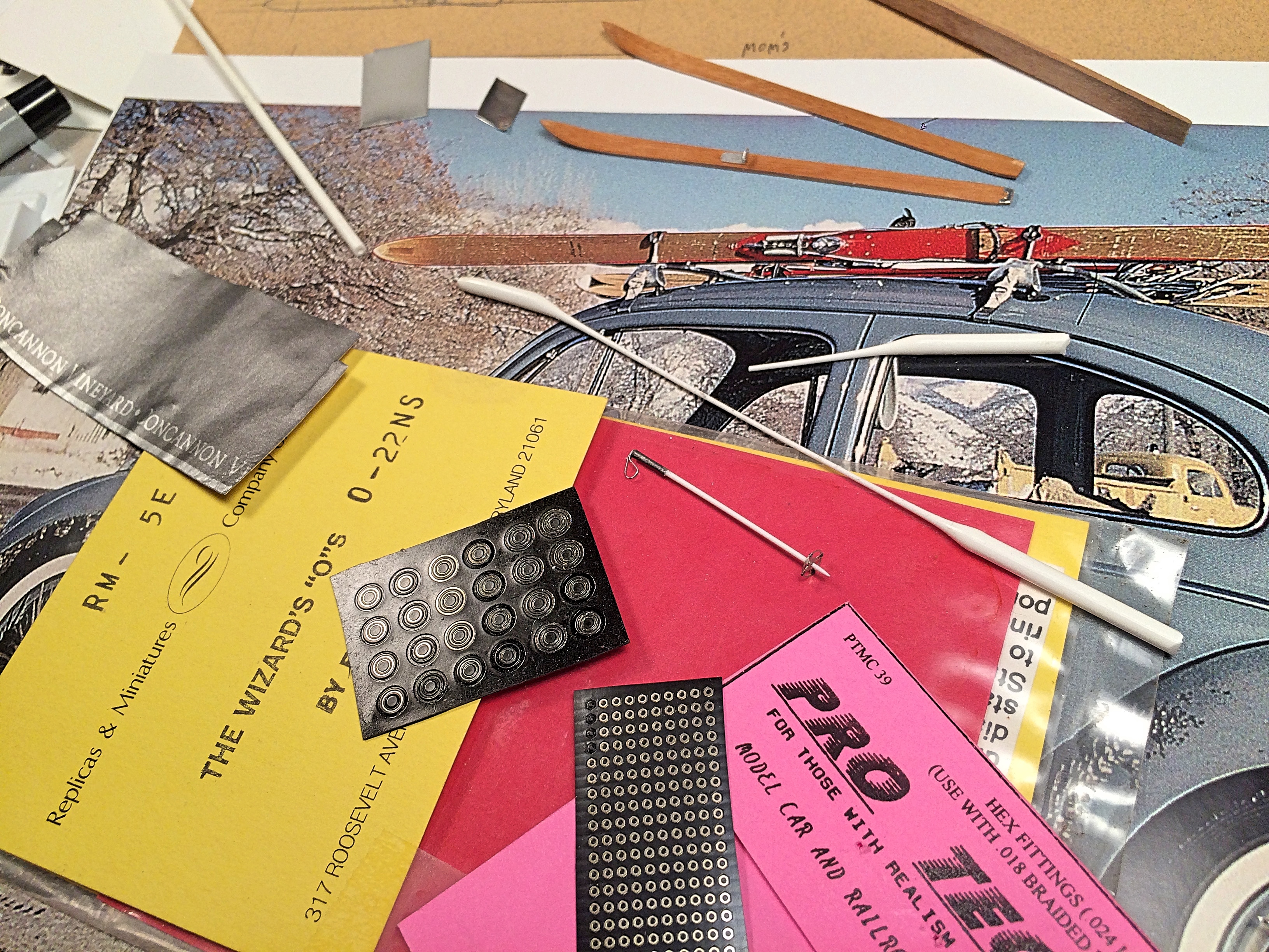

I didn't have the problem with lighter coats. So lots of wet sanding is due! My dad preferred downhill. In the meantime, I started on the ski poles. Painted the Coke cooler, and the one pair of skis has red. The Samsonite suitcase is done!

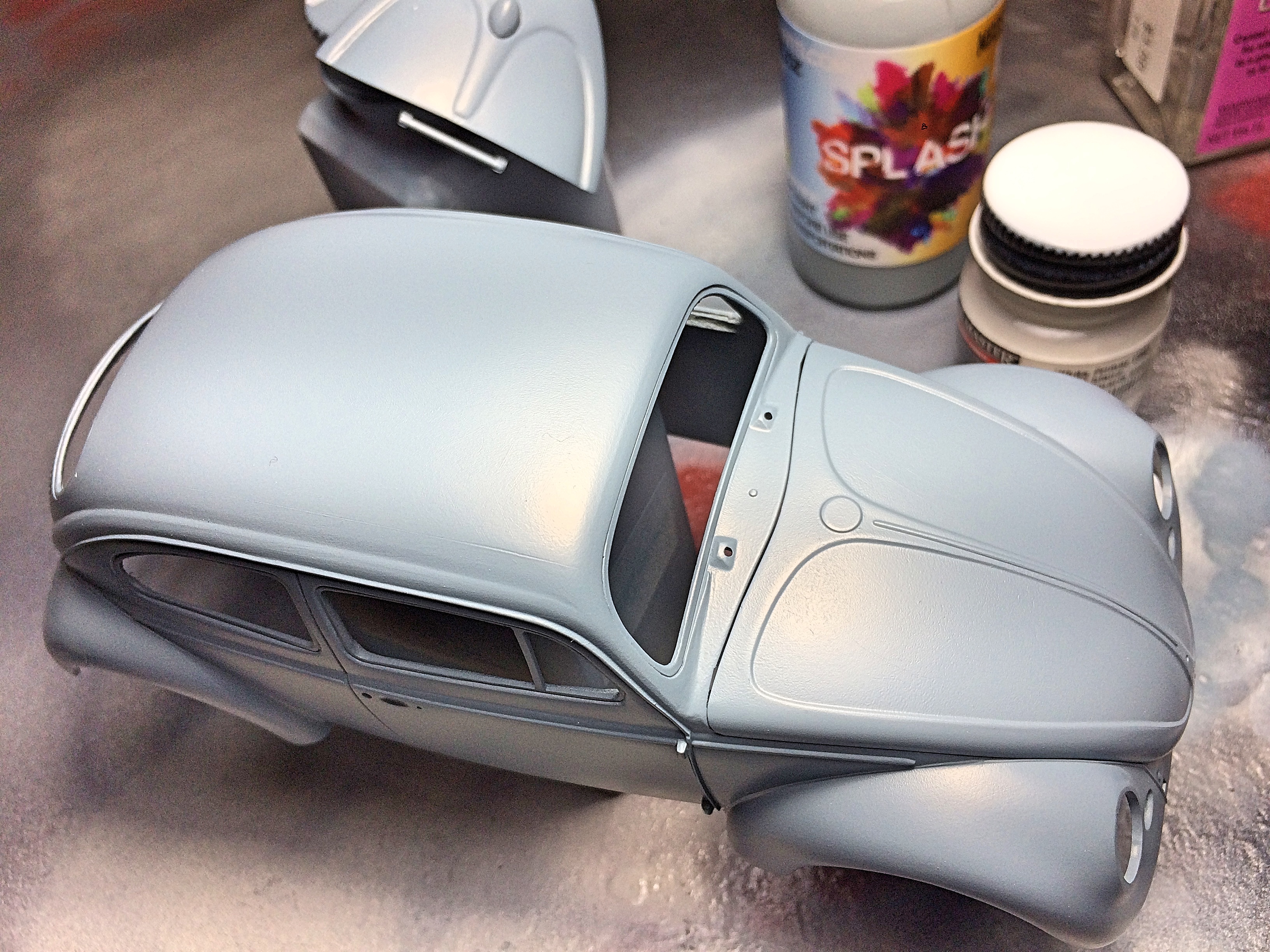

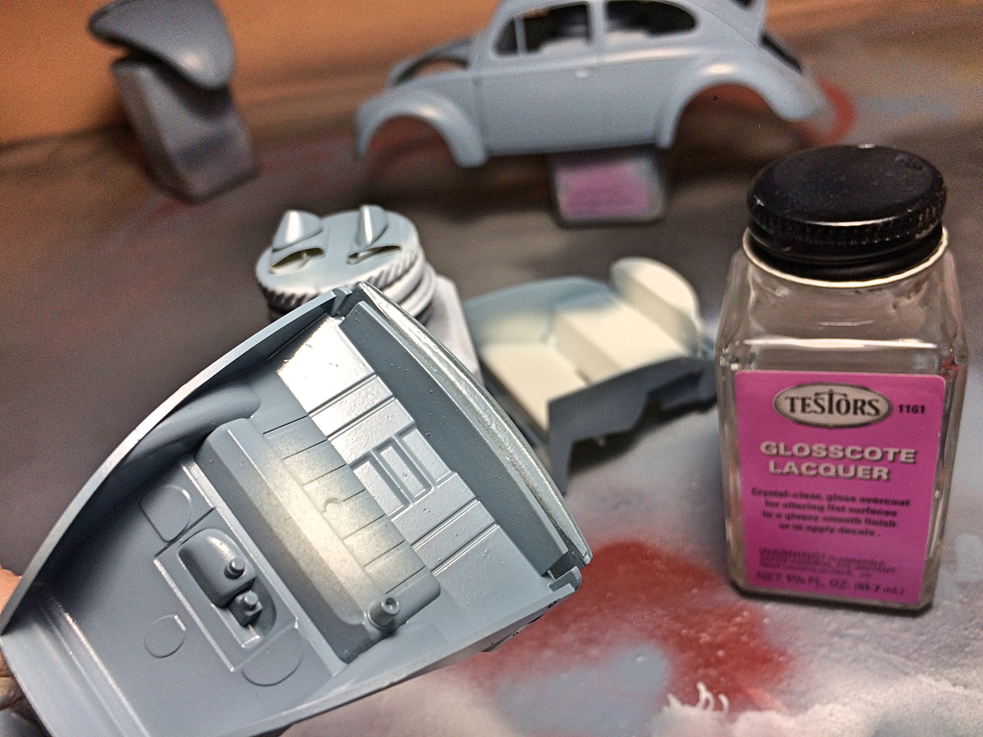

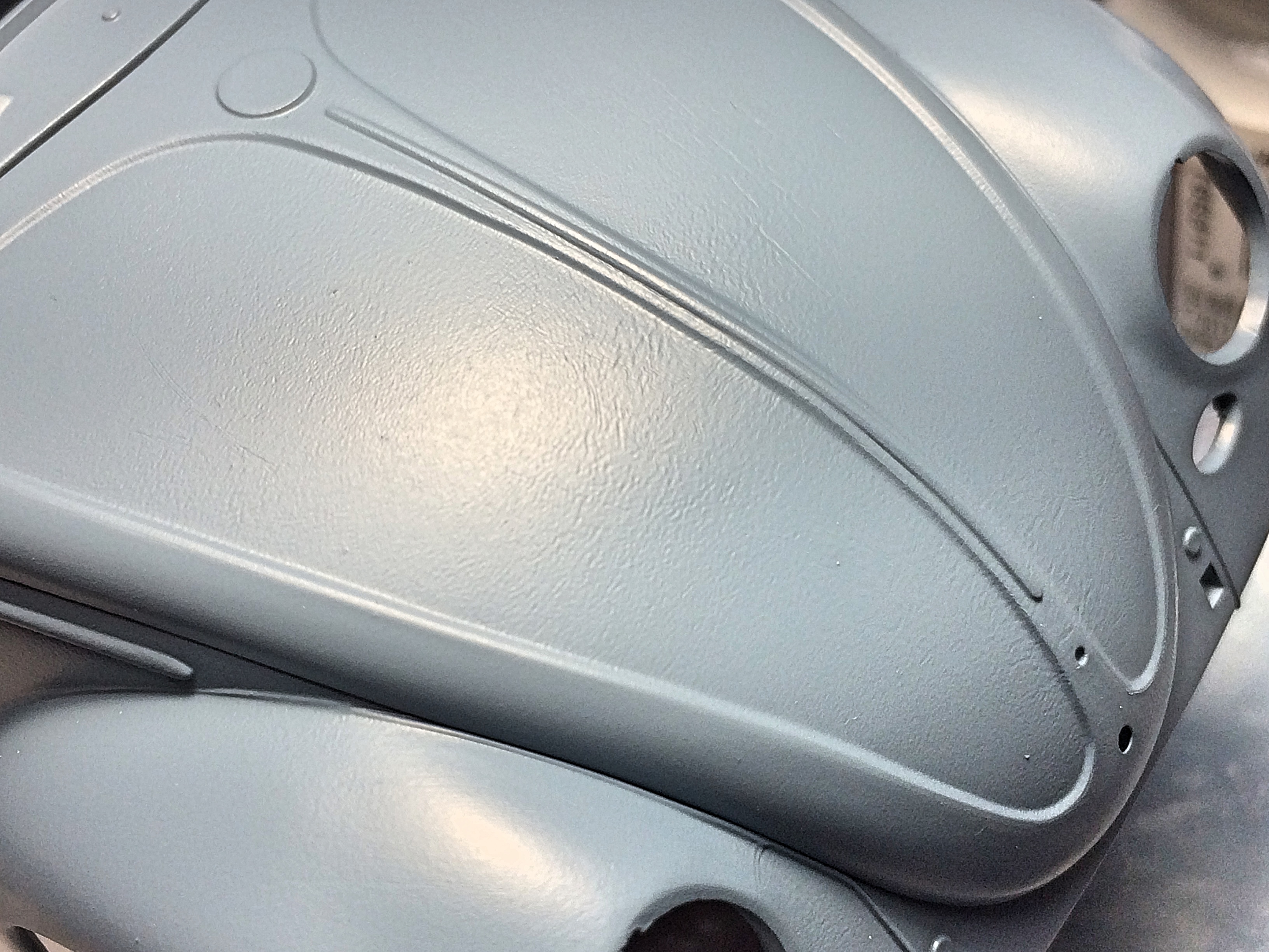

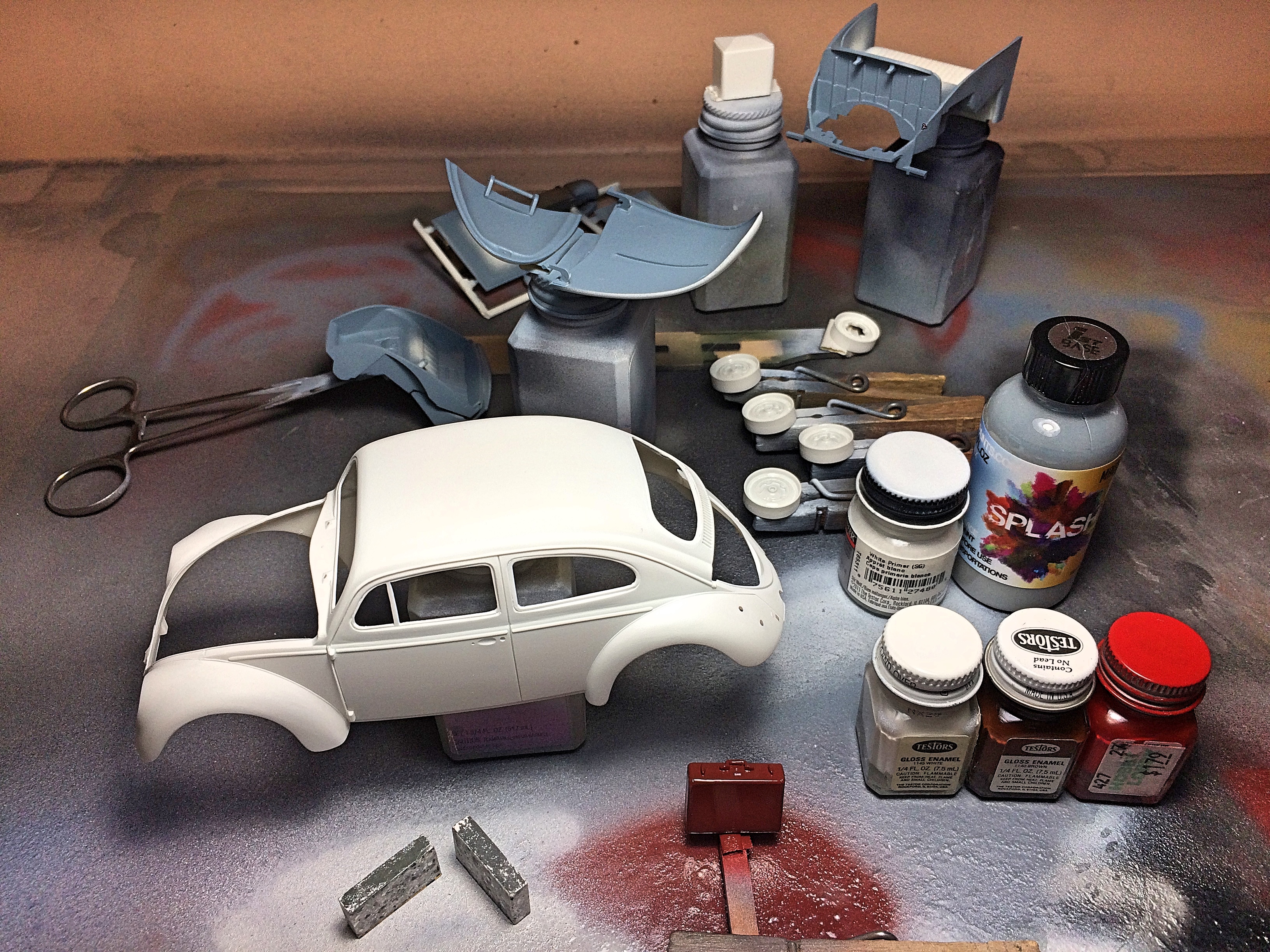

So, I'm now in struggle while you learn stage. I'm using Testors white primer. Then I'm using Splash paint for the first time. I made tiny sanding blocks from Corian scrap, superglued two grits of sandpaper, and managed to get one side about perfect. I mixed paint in the cup for the Samsonite suitcase, so at least I'll have a killer suitcase from this project. I tested the Testors Glosscoat on the blue paint next to the parts, did not craze. I'm doing several steps, painting the underside first. So the first pass with the gloss seemed to work. I hate the dust specks, but I was planning to stuff with gear which should hide it. I then sprayed the Splash on the top side. I did several passes, last one with a higher paint volume. Then disaster, it seemed to have reacted with the primer, and for some reason where the mold lines on the roof were sanded off, it really did something weird! At least the suitcase looks good.
Thank you. What bindings are on those skis? I remember Cubco when I was a kid, but the ones in the picture look different. More memories. Thanks to you also.
