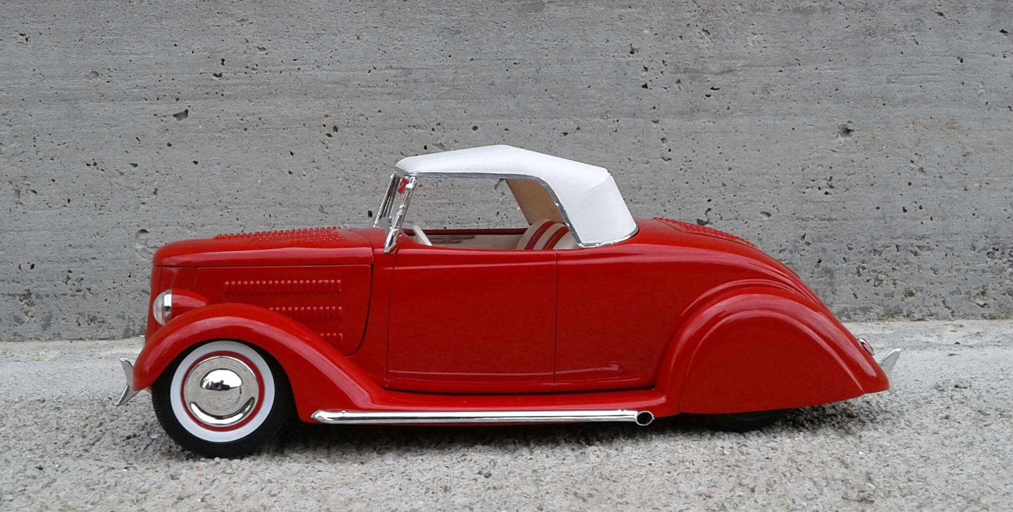

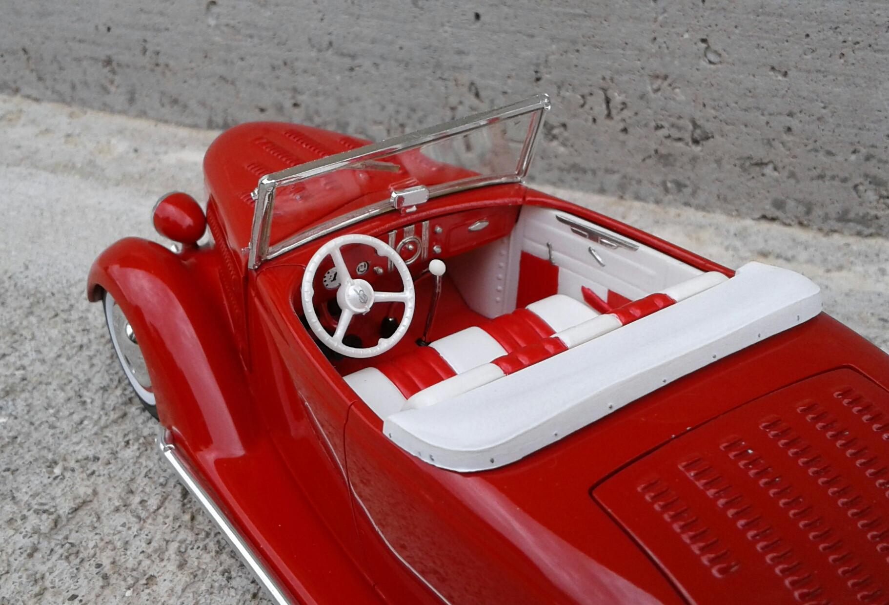

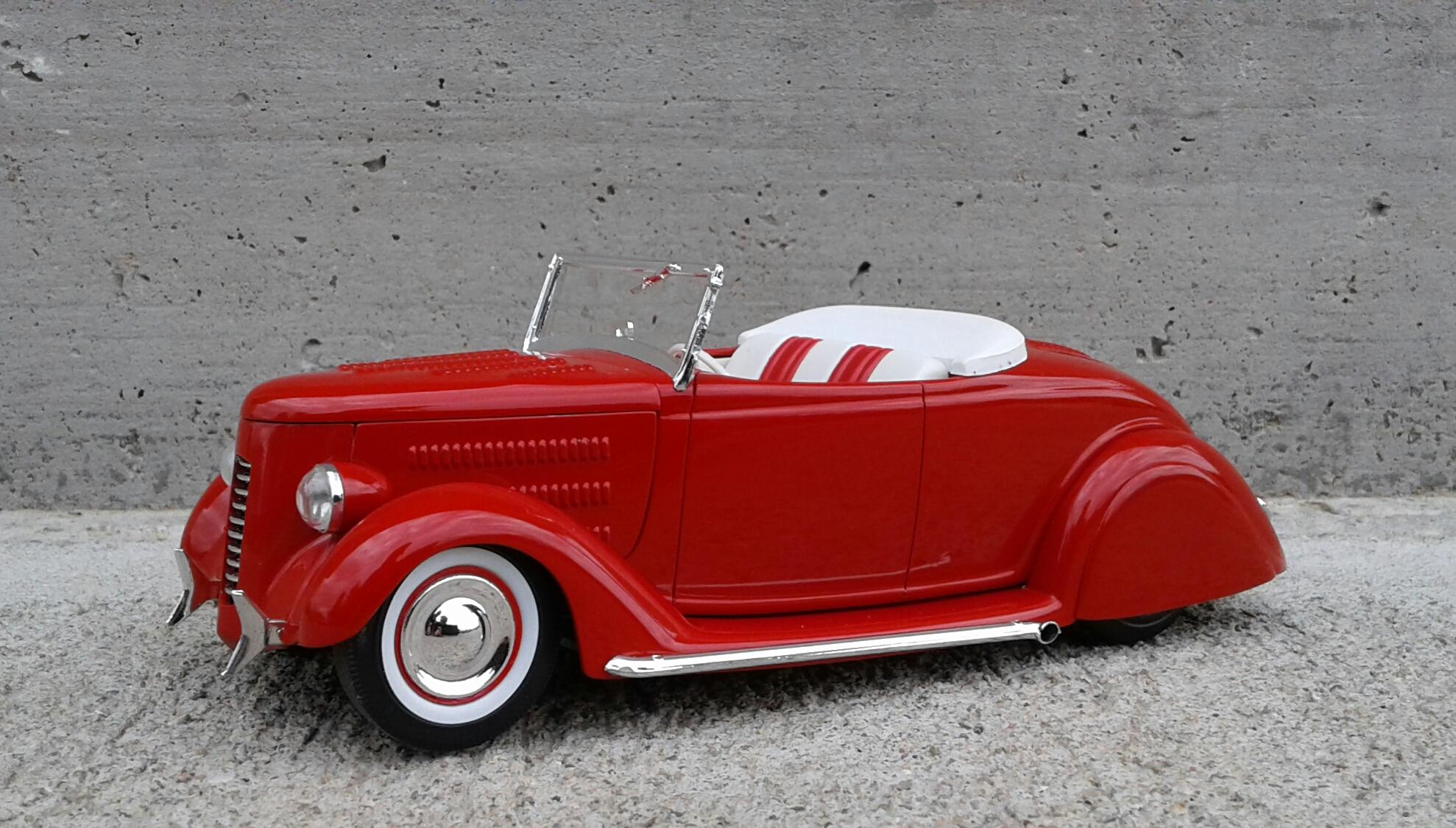

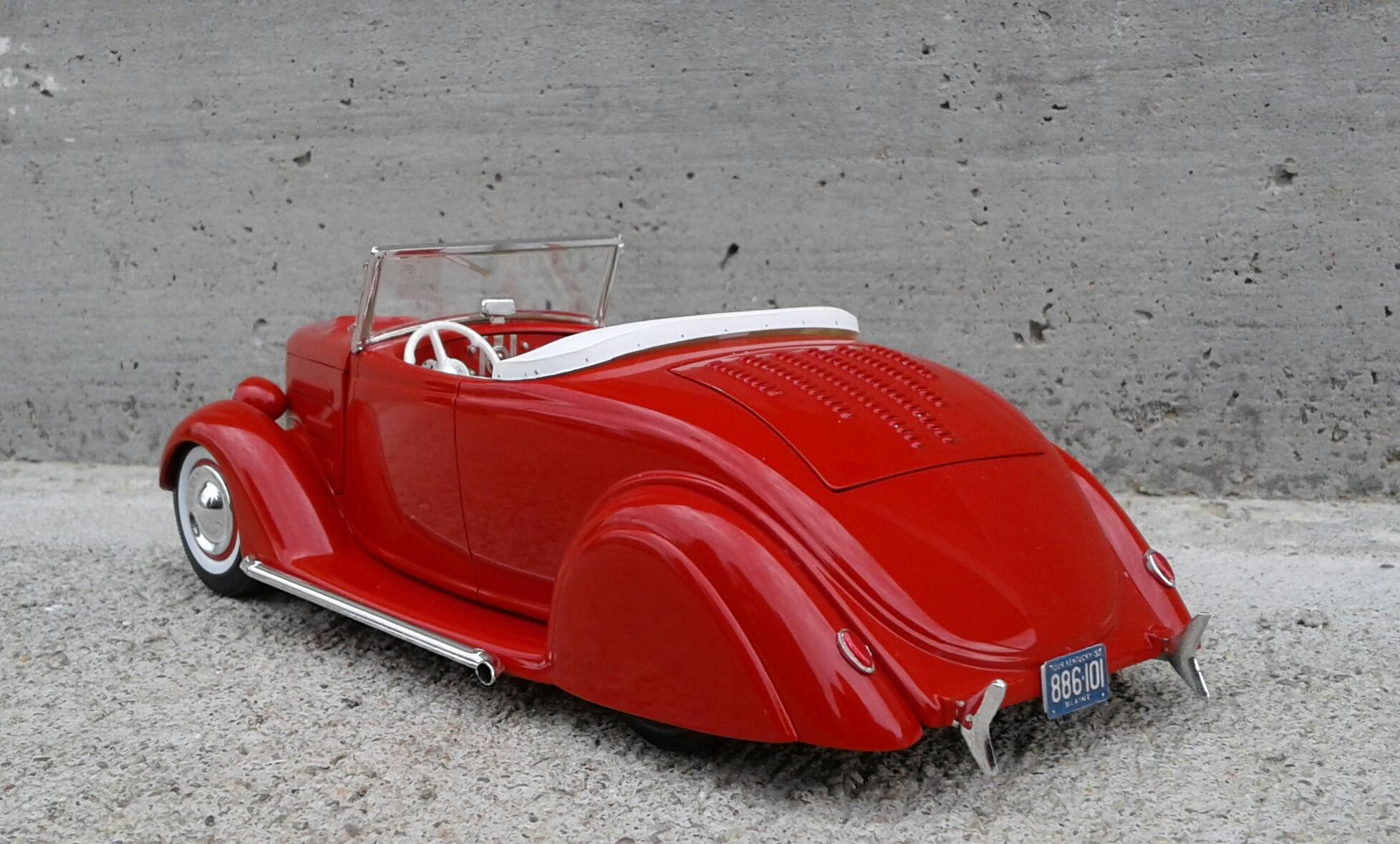

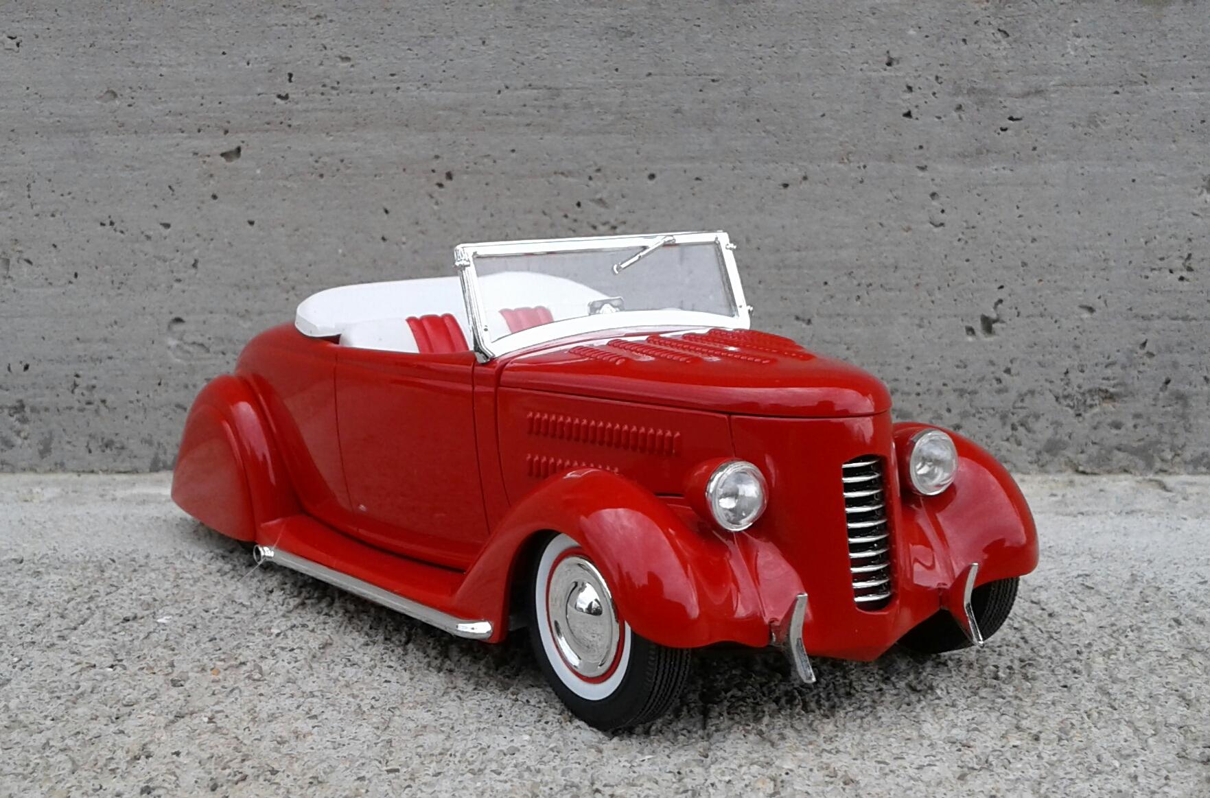

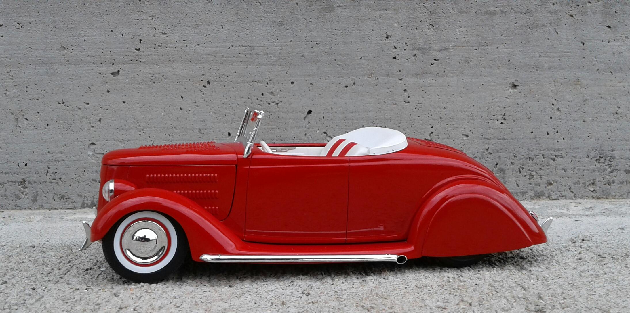

Thanx! I cut right where the rear of the fenders meets the body like a full scale would be done. I had to also narrow the hood slightly to match the cowl. I cut down the middle 3/4 of the length and glued it back together. It's really simple.
Thanx! I did quite a bit of fitment work to the front. The louvers was also quite a bit of work. The sides are simply Revell '32 sides with styrene added to the ends, cut and shaped to fit. On the hood and trunk, I used the same louvers cut into individual strips and grafted them in. These are actually resin copies.

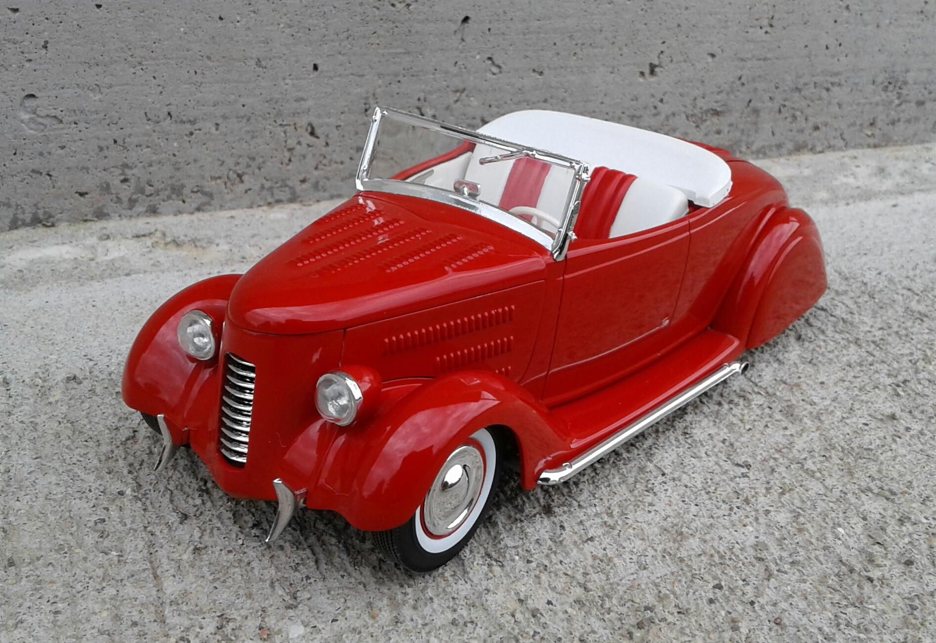

Yeah, I know red seems like a cop out no thought color. But, in my vision of it, nothing else will work. This model is painted with Tamiya Mica Red over gold. It's a beautiful color as are the other Mica colors. I hope Tamiya expands on the Mica line of paints. This photo shows the effect of the side skirts. No frame showing! I may foil the whole piece. I want to see what it looks like with just the half round done and go from there.

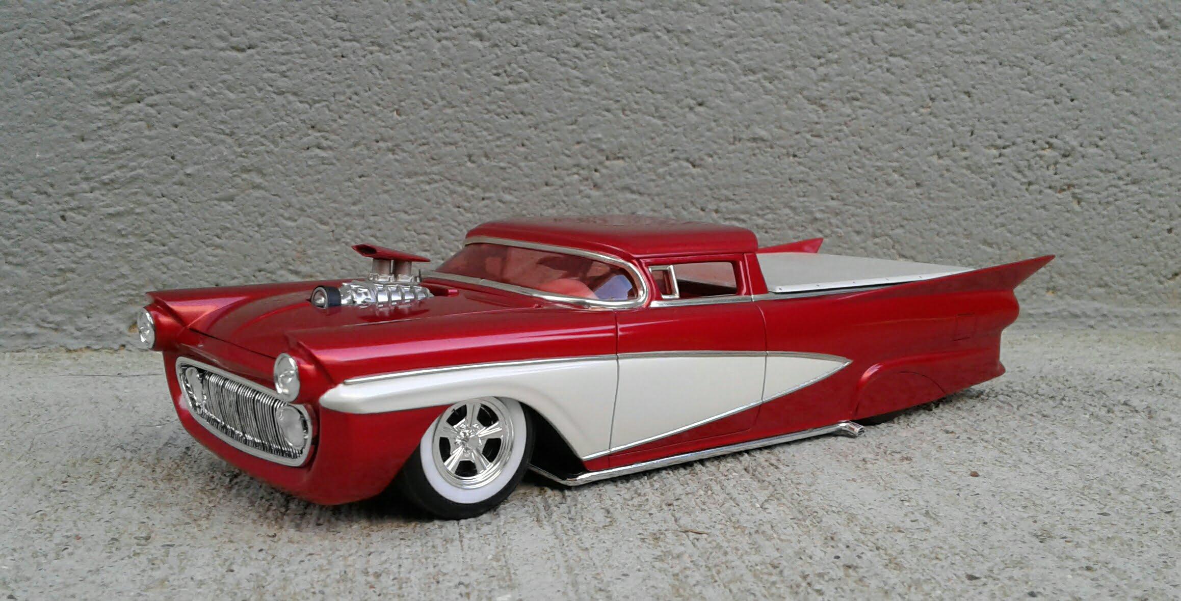

Thanx! To me, the chop on the Revell '48 has more of a hot rod look than it does a kustom. So, it made more sense to build it as a hot rod. I honestly don't know why the vent windows stand out like they do. But, my eye always goes to them for some reason. Weird.

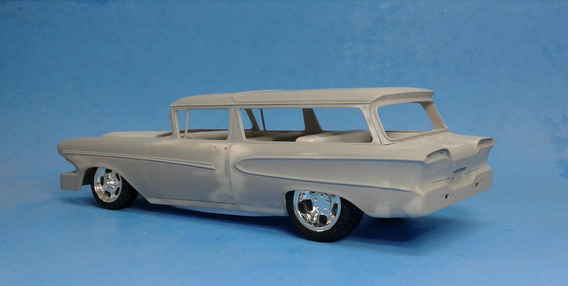

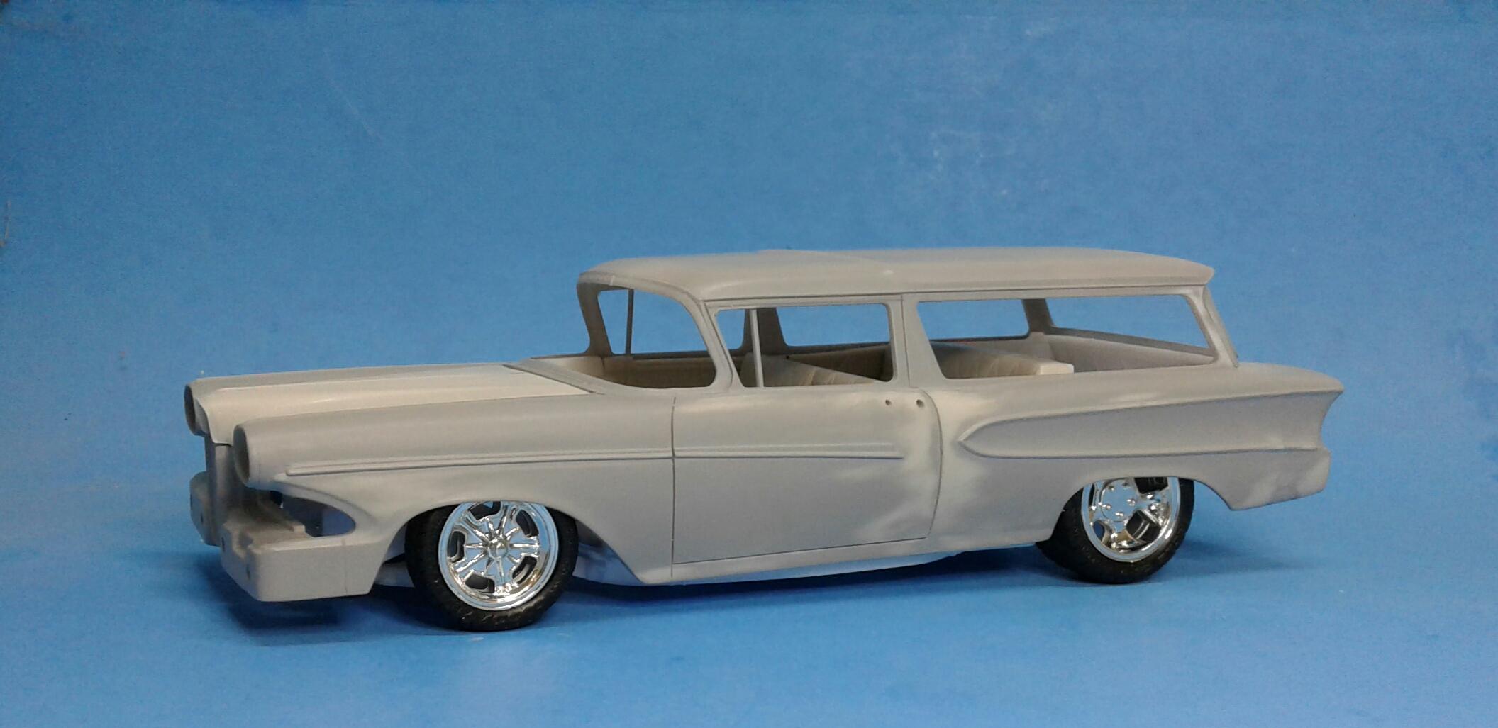

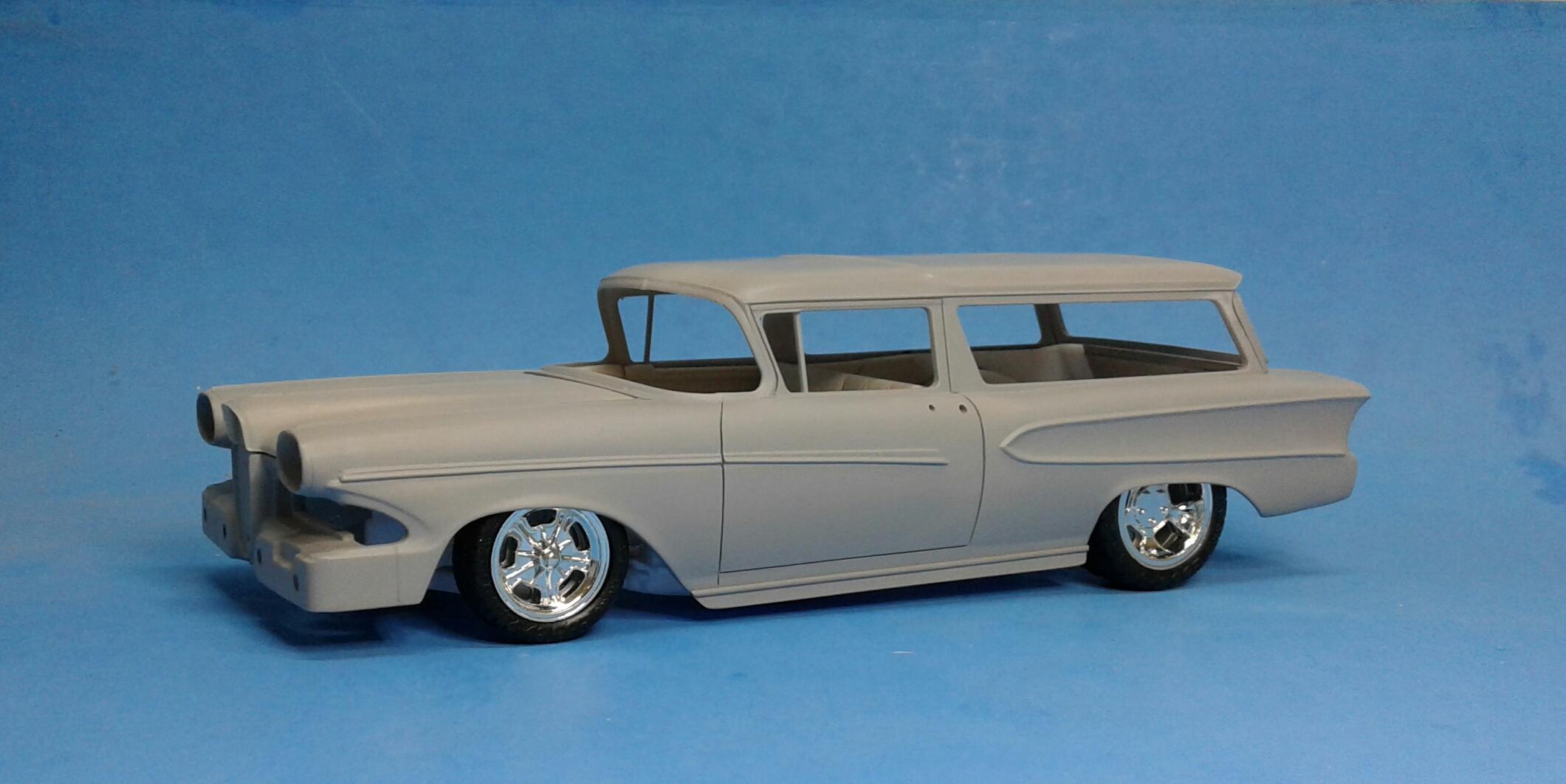

Thanx! I doubt it would be much, if any, heavier than the lift gate on a modern SUV. Especially if it were made from fiberglass. One thing that's really been bugging me with this model is the frame. It hangs down too far and shows too much. Last night, I took care of that issue by installing 2.5 mm skirts to the bottom of the body. I then added a strip of .040 half round over the joint. No body work! The plan is to foil the half round after paint. It made a huge difference in the way it looks! The frame is now hidden and it visually looks lower even though it isn't.
Thanx Sam and David! I got the hatch and body filled in. Still some tweaks left to do. Also have to add the latch details. But, I'm getting close to being able to concentrate on the body only and get it into paint.

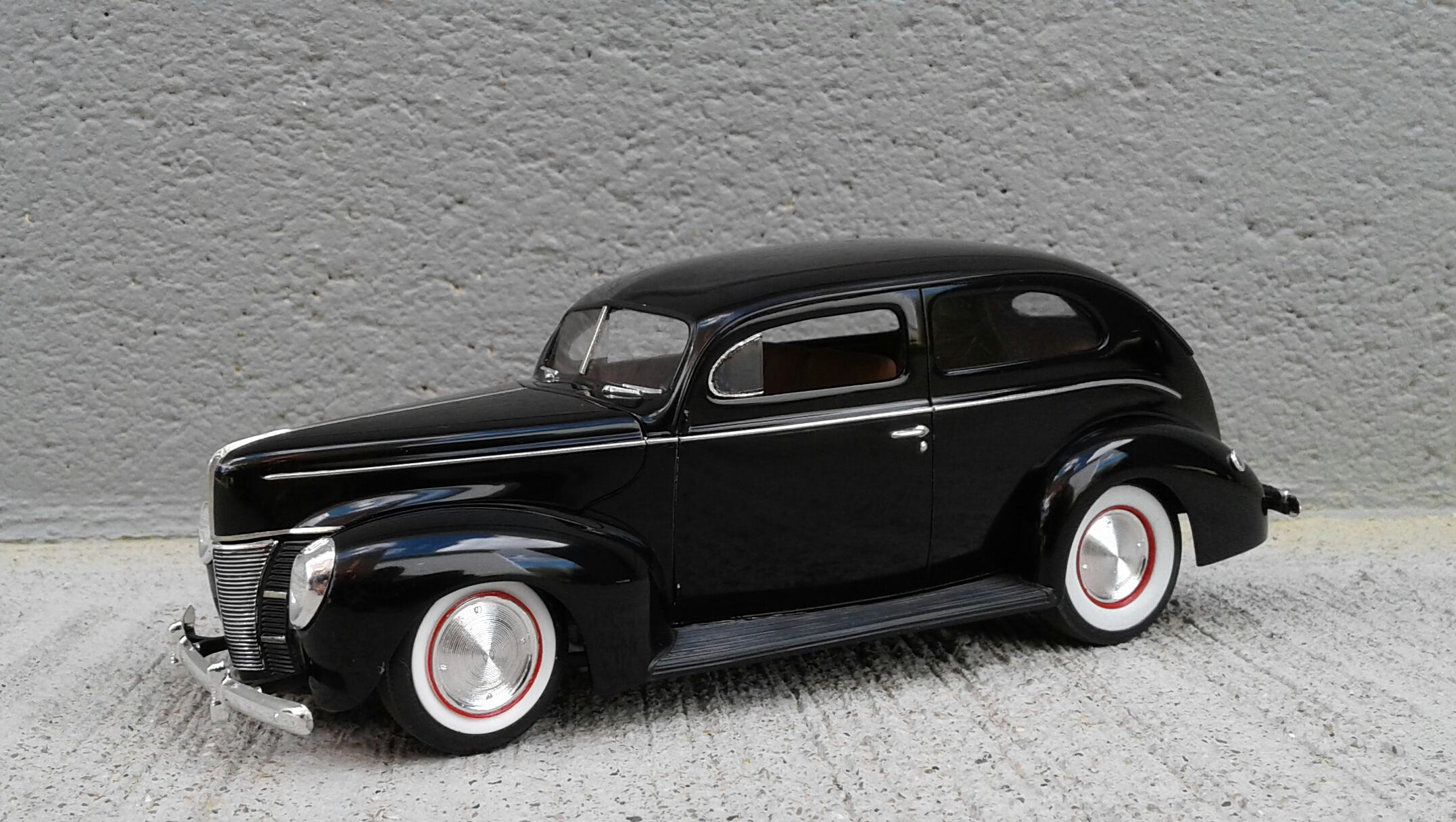

I built this five or six years ago. It's a kitbash of the Revell '48 coupe and the AMT '41 woody. Basically, I just grafted the '41 front clip to the '48 body. I also narrowed the front track 4 mms to tuck the tires in a little better. Inside the interior, I just added the '41 dash and steering wheel to the custom interior and painted it flat white and Krylon Pistachio Green. The engine is from the '48 and was my first flathead. The body was painted with Model Masters Diamond Green with a coat of Testors dull cote. Thanx for checking it out!

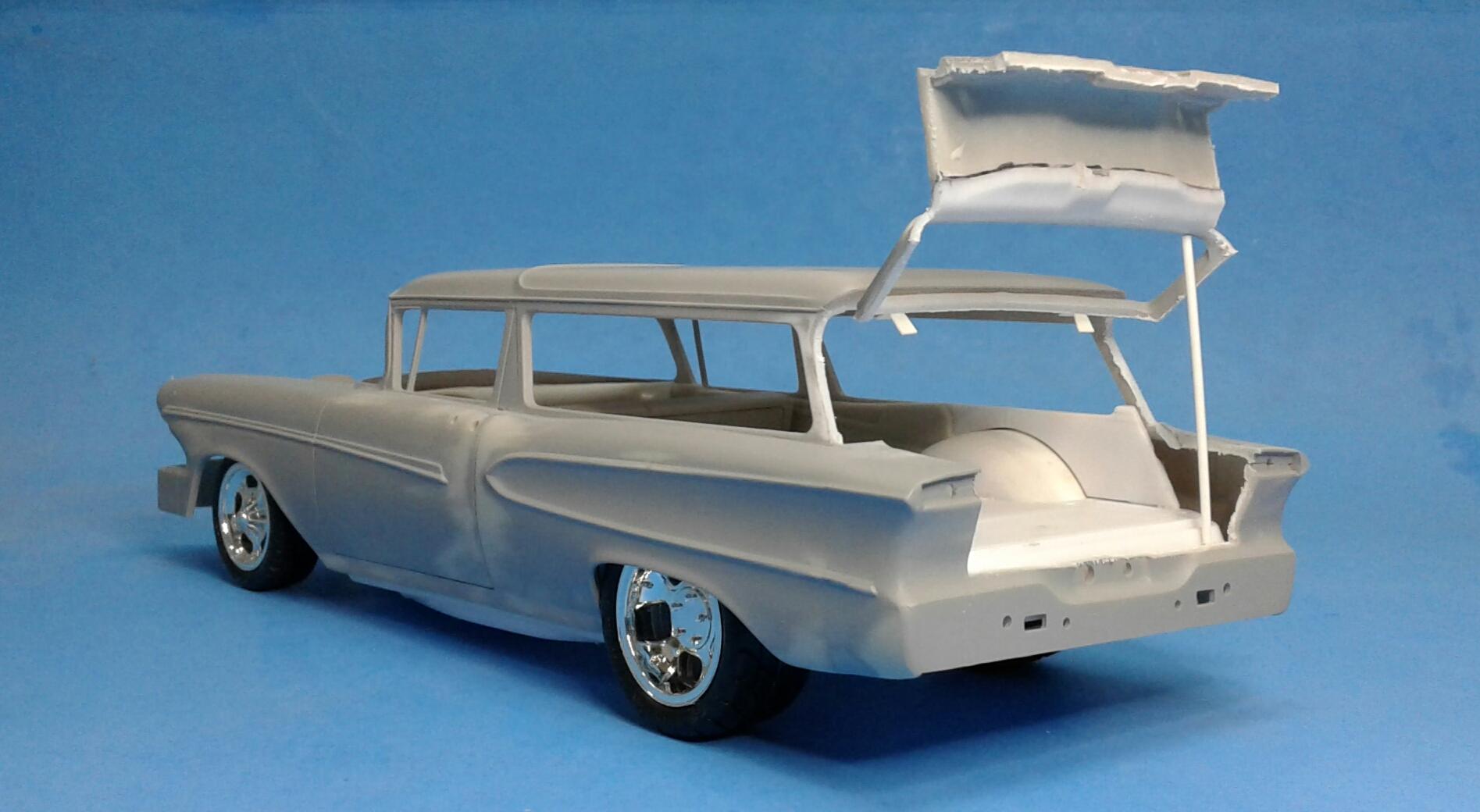

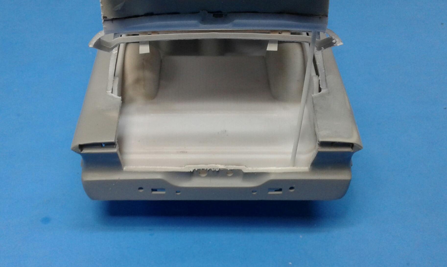

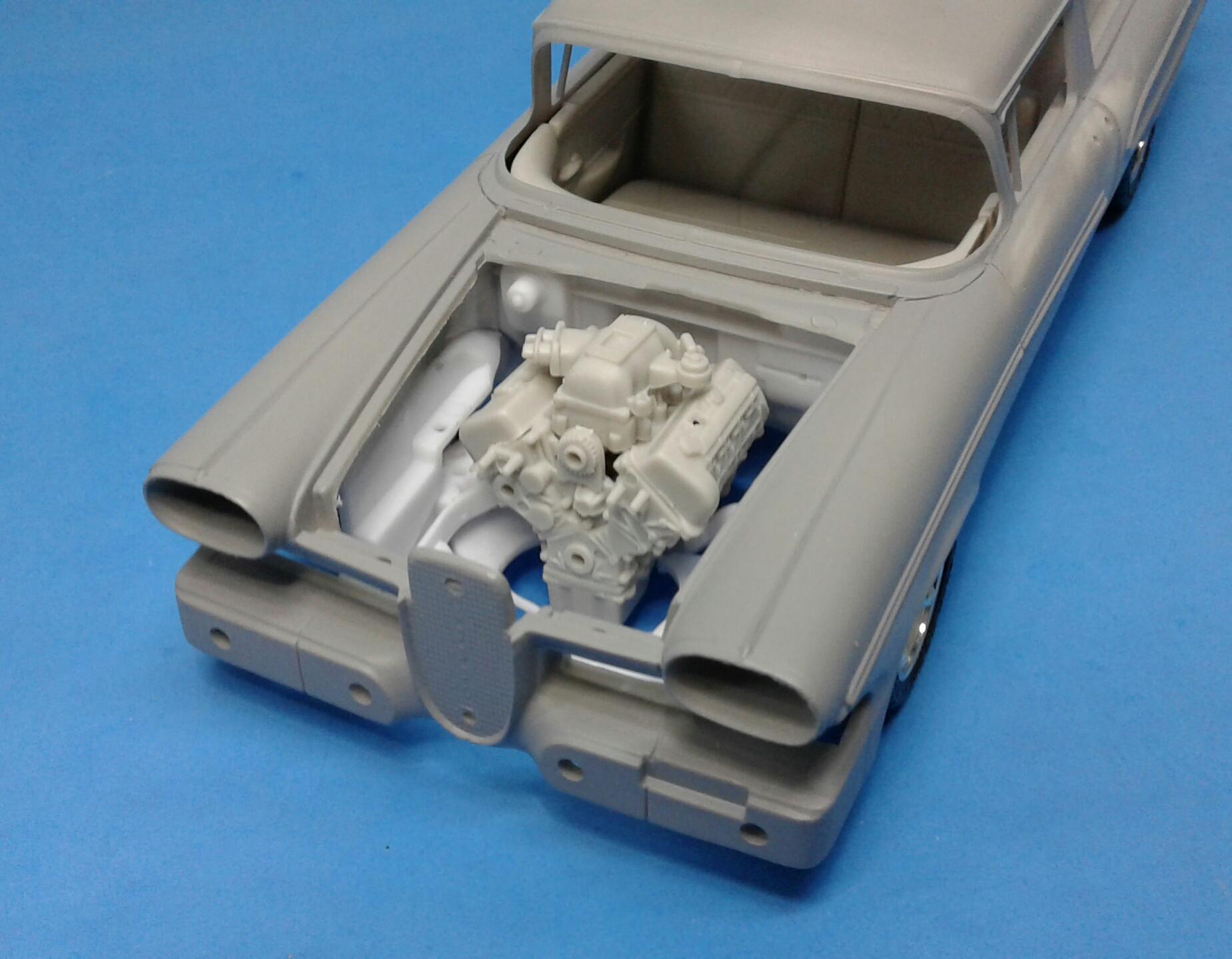

I got the hatch opened and hinged today. I designed the hinges so that the hatch can be removed. I haven't deburred anything yet as I want to wait until everything is dried well before I try to remove it. But, it works! The cargo pan came right where it should be. I got the engine together enough to test fit. I had to flip the oil pan around to make it a front sump and it slid right in. I just have to make motor mounts to be finished with the fitting. I dread making a set of headers for it. I may have to make changes to the frame to make room.
