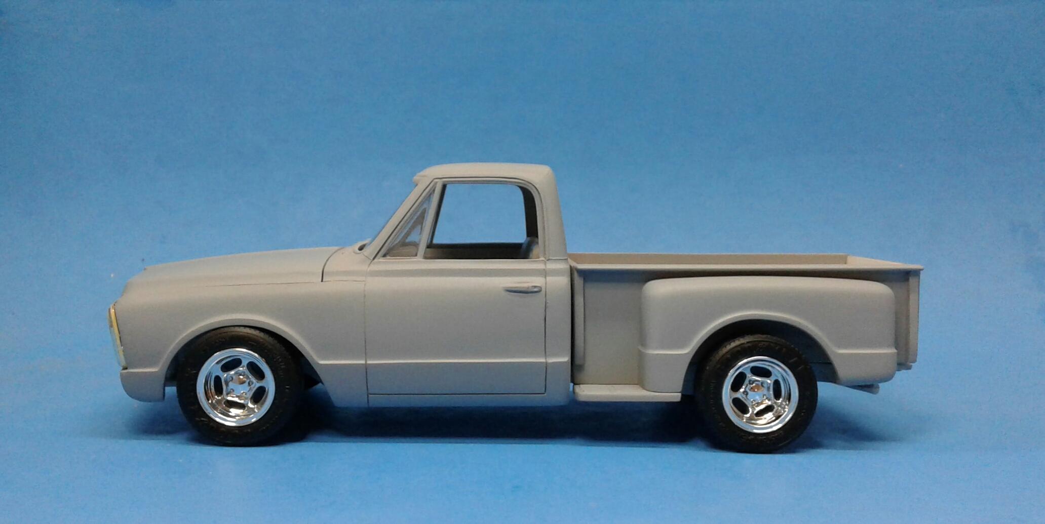

Thanx guys! I got the body in final primer. I changed a couple more things. I got rid of the chrome strip at the base of the roof since it's going to be a single color and got rid of the cargo light. Here's a photo that shows the improvement of shimming the radiator support. I can't decide on the side pipes. The chassis plate has dual exhaust molded in. If I use the side pipes, I'll need to cut the tail pipes off. I may have to mock them up to decide. I'm not a fan of side pipes. But, it's such a styling cue on the boxart. It just about has to have them. -

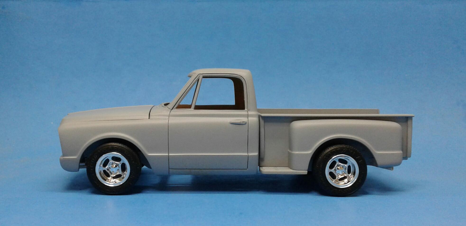

When I read your post, I thought sure that was the issue. But, it wasn't. I checked them with a straight edge and all four cross braces were on the same plane. I then took a piece of scrap styrene around .050 thick and placed it under the radiator support. That was what it needed. It got rid of the bowed look, made the cab wall and bed fit perfect as well as got the fenders up away from the tires. So, I glued the piece to the chassis plate, trimmed and sanded it. -

Thanx Steve and Greg! I got most of it in primer last night. I'll sand most of it away with 600 and shoot three coats of primer and allow it to cure a few days while I work on the rest of it. Stance check. I think the front end needs to come up a touch. I'm going to try adding shims under the radiator support and bumper. It kinda looks like it's bowed in the middle. I checked the chassis plate and it's straight. -

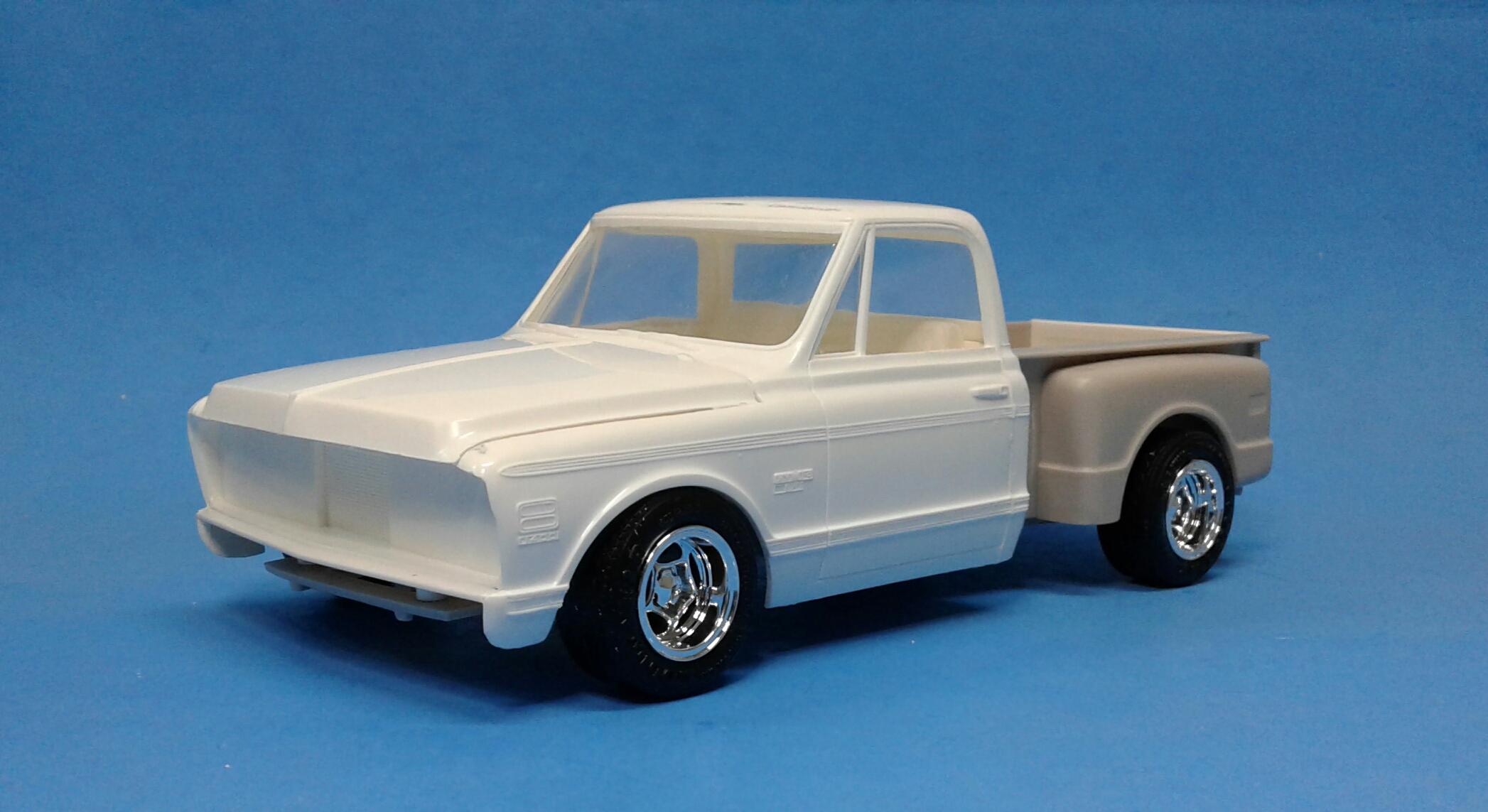

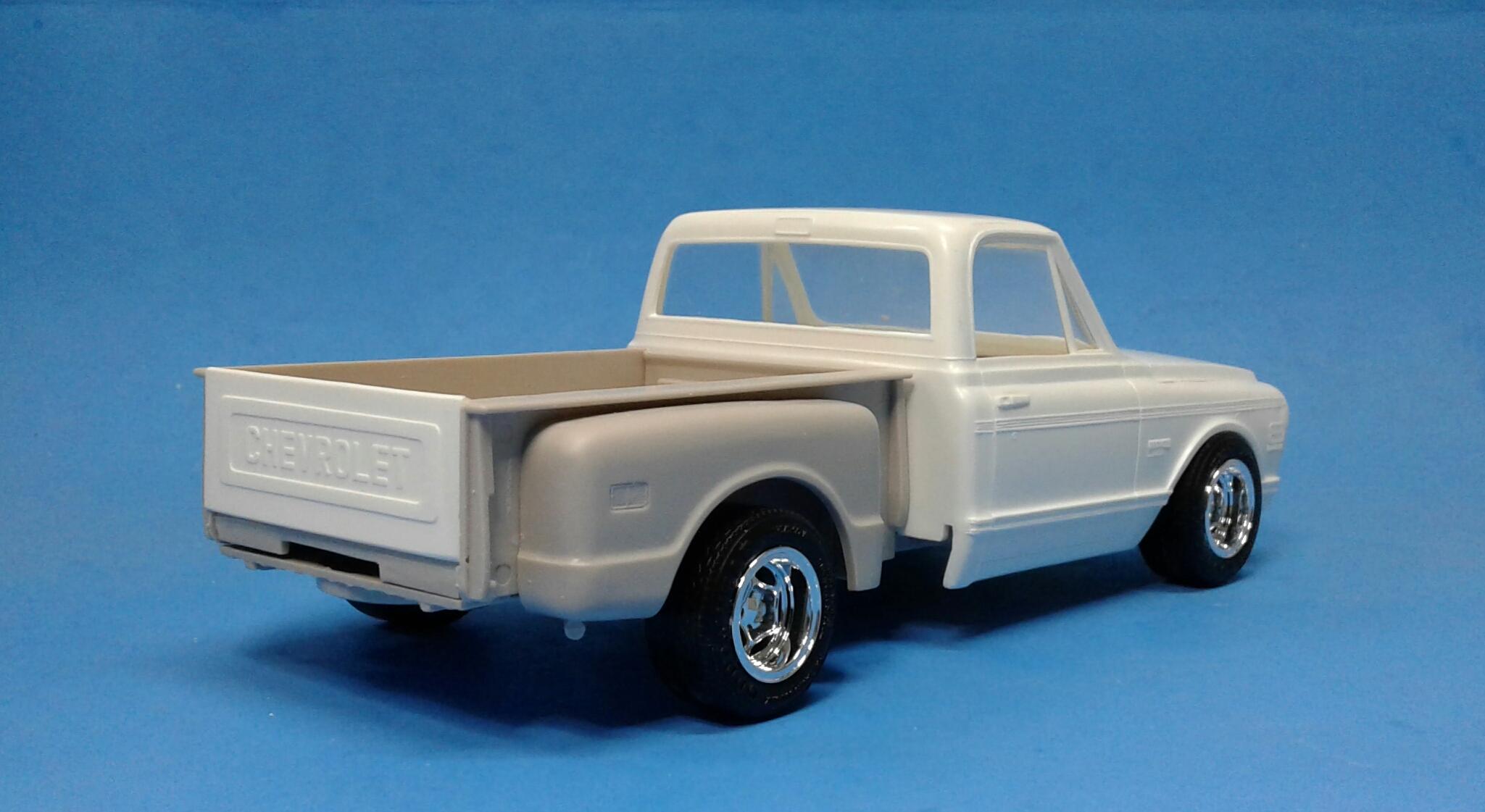

I got this MPC kit from Tom Kendall in a trade. I loved this kit when I was a kid! I thought that boxart was so cool! Of course when I built it then, it looked like garbage. Runny paint, glue smears, crooked decals. It had it all! Now, I have a second chance! This model is going to be just for fun. No detailing, corrections, etc. Just like when I was a kid! It's going to be a tribute build (not a faithful rendition) to the boxart. Only better. No long stepside bed! Ugh! That was one thing I really disliked about this kit. In just a little while and swapping the chassis plate and bed with the AMT '72 GMC, I had a better looking Chevy stepside. The tail gate was just a touch too tall. I removed 1 mm from the bottom. I removed the Cheyenne trim as I couldn't find a stepside with that trim anywhere in my research. Plus, it just looks wrong with a stepside bed. I also decided to get rid of the non matching marker lights. They didn't match on the original fenders either. I filled in the cab corners and the recess on the rear stake pockets. I opened the grille to make it see through. This was the most time consuming and difficult grille I've ever done! I literally wore the chrome off from handling it so much! And I'm still not done! I'm going to also get rid of the molded in headlights. That shouldn't be too difficult. Once they're done, I'll paint the grille, do the blacked in the recesses and do the surround with a Molotow pen. The plan is to paint it gold and if the decals hold together, use them also. I'm going to change the color of the seats/interior to some kind of tan instead of white. Not sure about the side pipes. I may fix them so they can be installed and removed easily. Should be in primer soon.

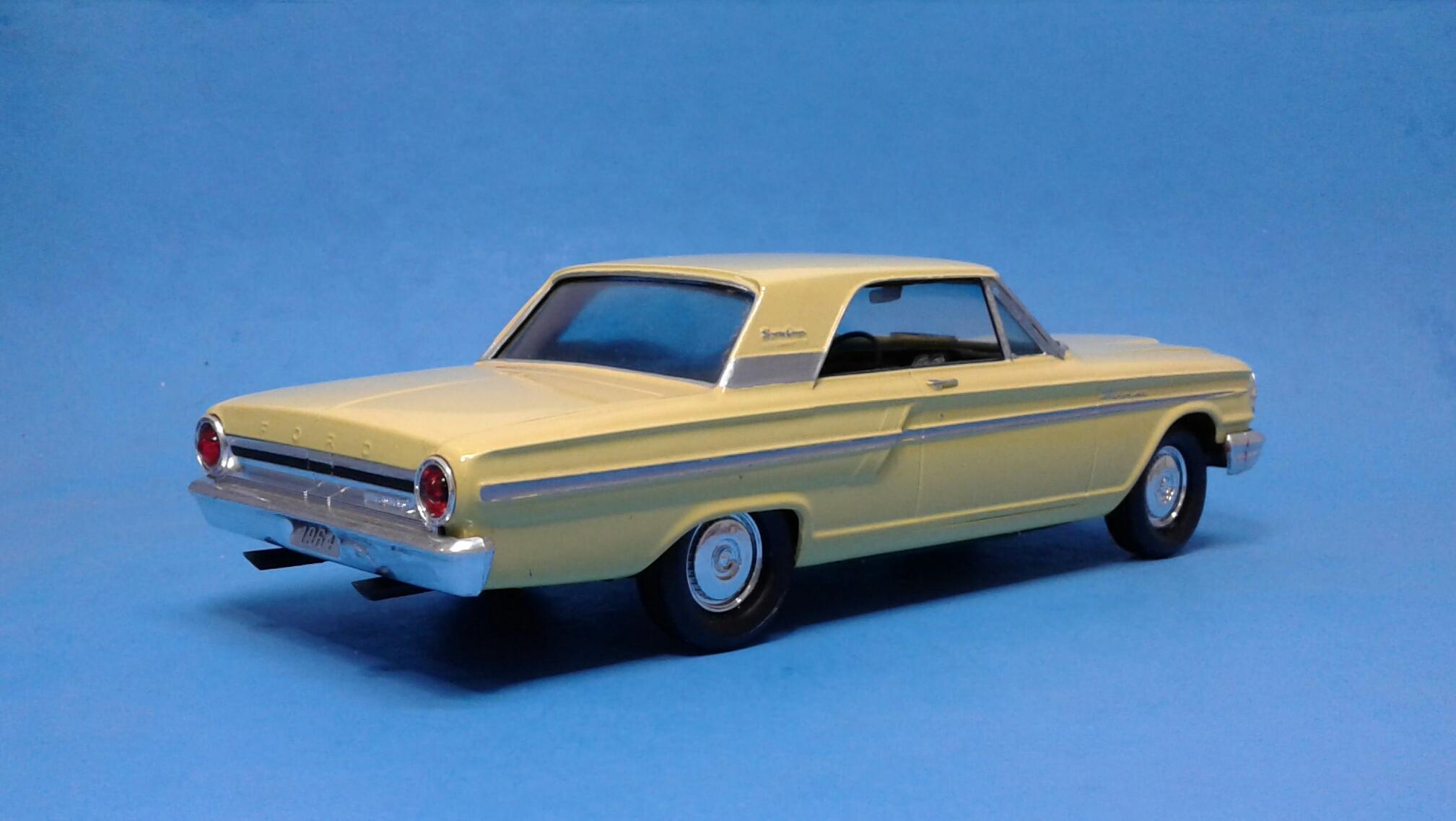

That's a good looking little Comet Carl! I actually like the '62 better than the '60 and '61s. To me, the tail end is much better looking with the four small round tail lights, tail panel and fins.

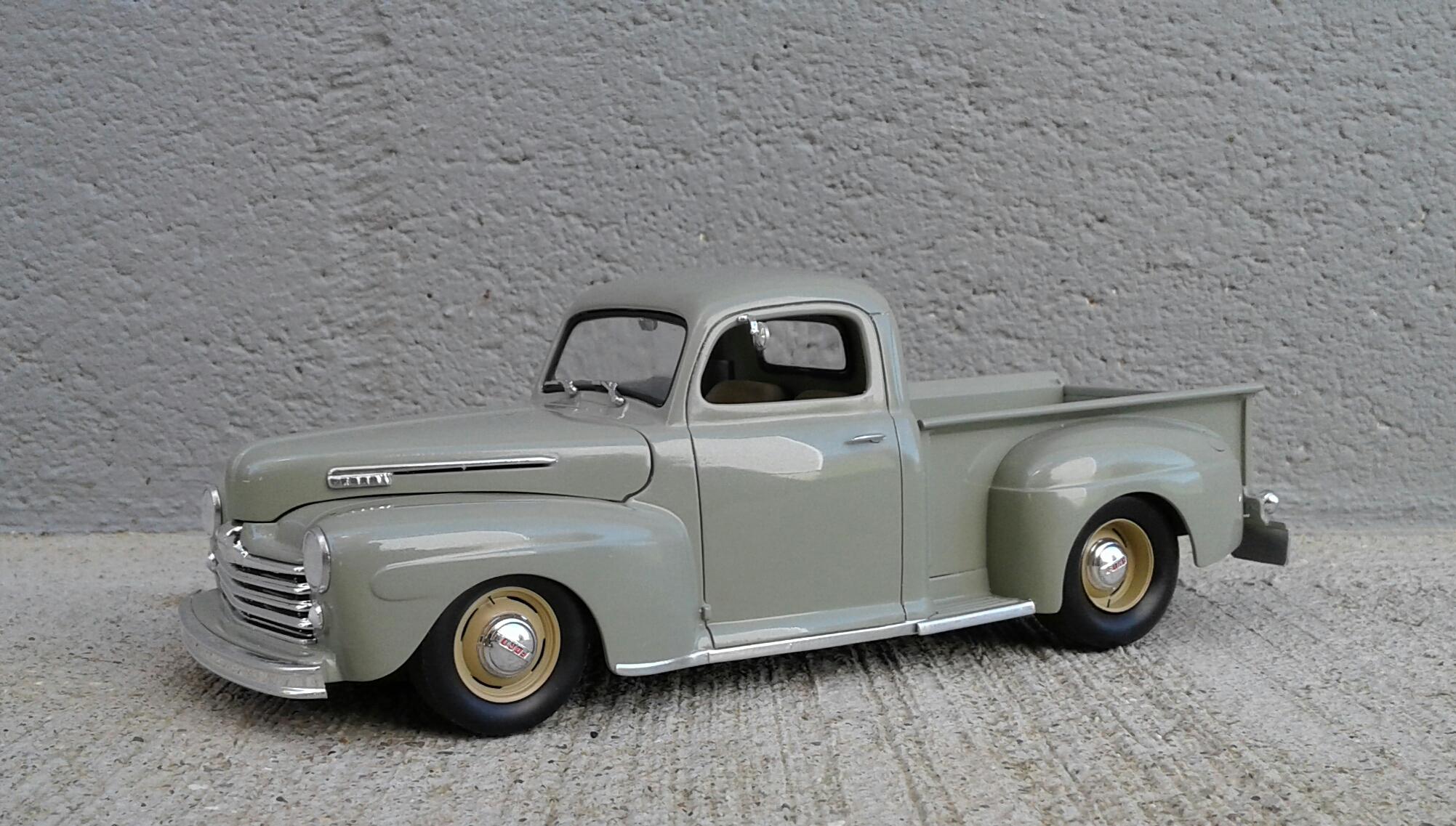

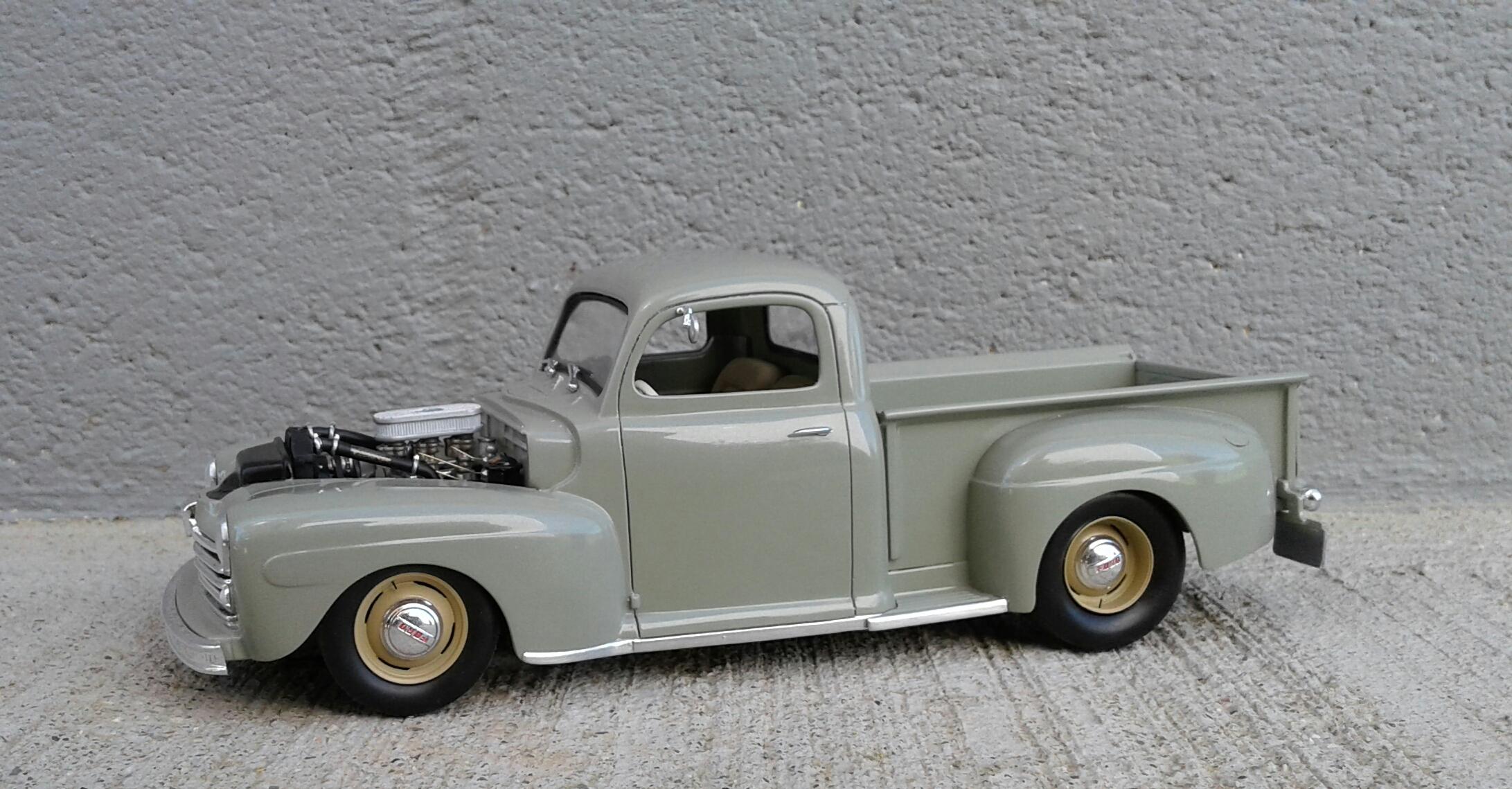

Finished this one up today. Basically a kitbash with a Revell '48 F-1 and convertible. I used the pickup's chassis, engine block with an automatic from an old Revell Ranchero, bed, roof, rear cab wall, floor pan, dash and door panels. The convertible supplied the front clip, bottom section of the doors, rear fenders, engine accessories, wheels, hubcaps, tires and seat. Paint is Tamiya Gray Green with a coat of pearl and clear. Thanx for checking it out! Any questions, just ask.
'48 Ford F-1 Phantom
Plowboy replied to Plowboy's topic in WIP: Model Trucks: Pickups, Vans, SUVs, Light Commercial
I got it finished today! Not able to take decent photos just yet. As soon as I get a chance, I'll take some better photos. This inside photo doesn't capture the actual color.
