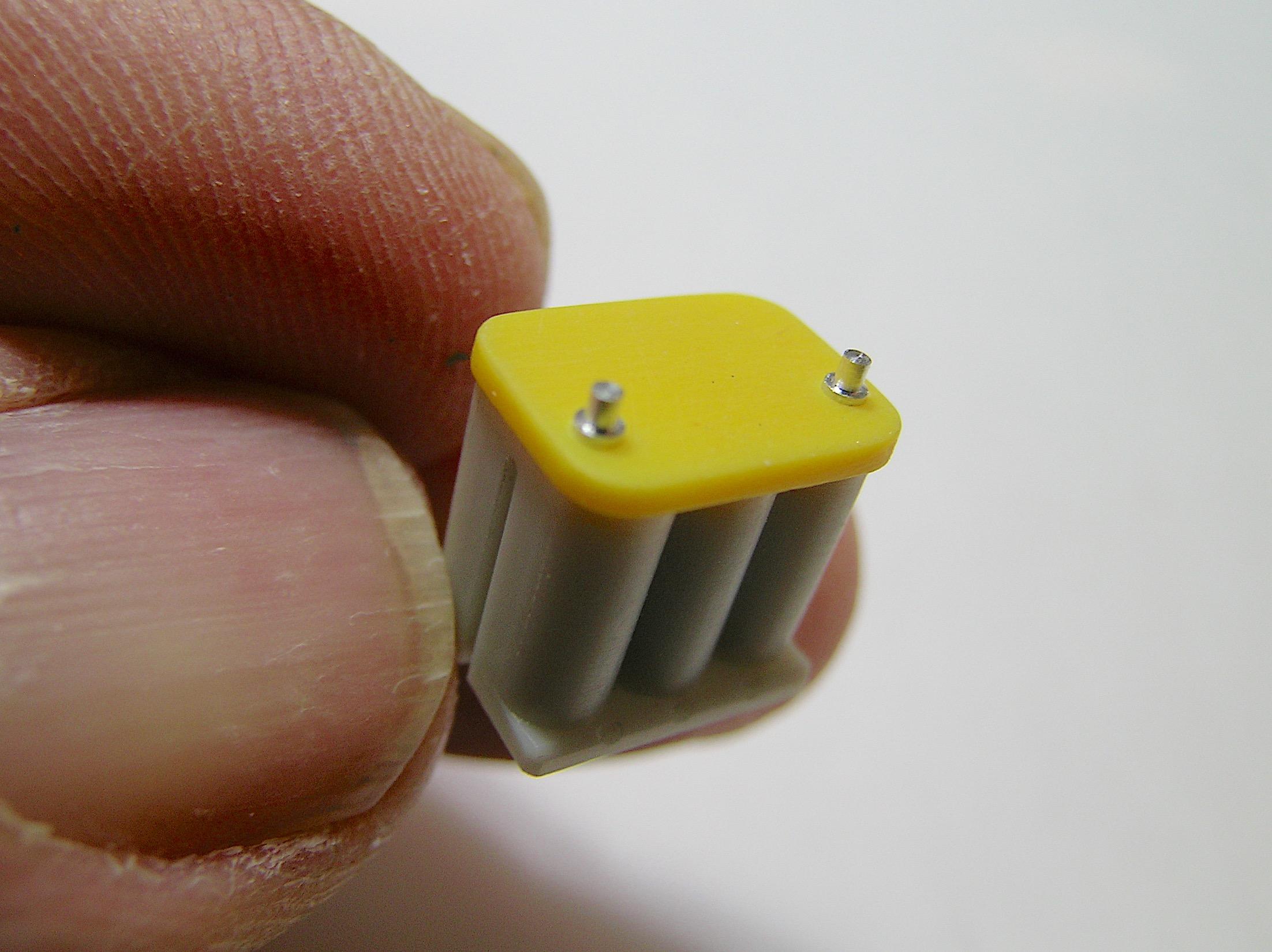

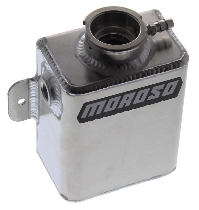

Hello everyone, I haven't had much time at the workbench last weekend, but I was still able to make a few detail parts before venturing into more complex machining parts (the engine). To complete the cooling system I made a small overflow tank, I found this picture of a nice Moroso tank which I thought would make a good companion to the radiator. Also, I made an Optima battery, I used gray styrene from an old MPC kit and a piece of yellow styrene of the perfect color that also came from the leftovers of a kit for the fabrication, it saves me from painting and I think the color is rather realistic. I still have to make the battery tray and female terminals to complete the assembly. See you next week with more fabrication. Francis The target. I started by machining the neck on the lathe and then on the milling machine to machine the tank itself. I drilled holes for the mounting tabs. I made 45 degree bevel cuts on the corners to make them look more rounded. Not the most difficult part to make but I like it! I drilled a hole on the side like the target and on the neck for the hose that connects to the radiator (not visible in the photo, it's on the right side, sorry). The newest addition next to the radiator. I started the Optima battery by gluing together several flat pieces of gray styrene and half-round pieces salvaged from the frame that held parts from an old MPC kit. View from a different angle. The main body after some filing and sanding. You can see that my fingers get less dirty when sanding styrene than aluminum. π In the milling vise to add some details on the base and making vertical grooves on the sides. I machined male terminals from aluminum, I had no lead...π Another fairly simple but rather fun piece to make. -
