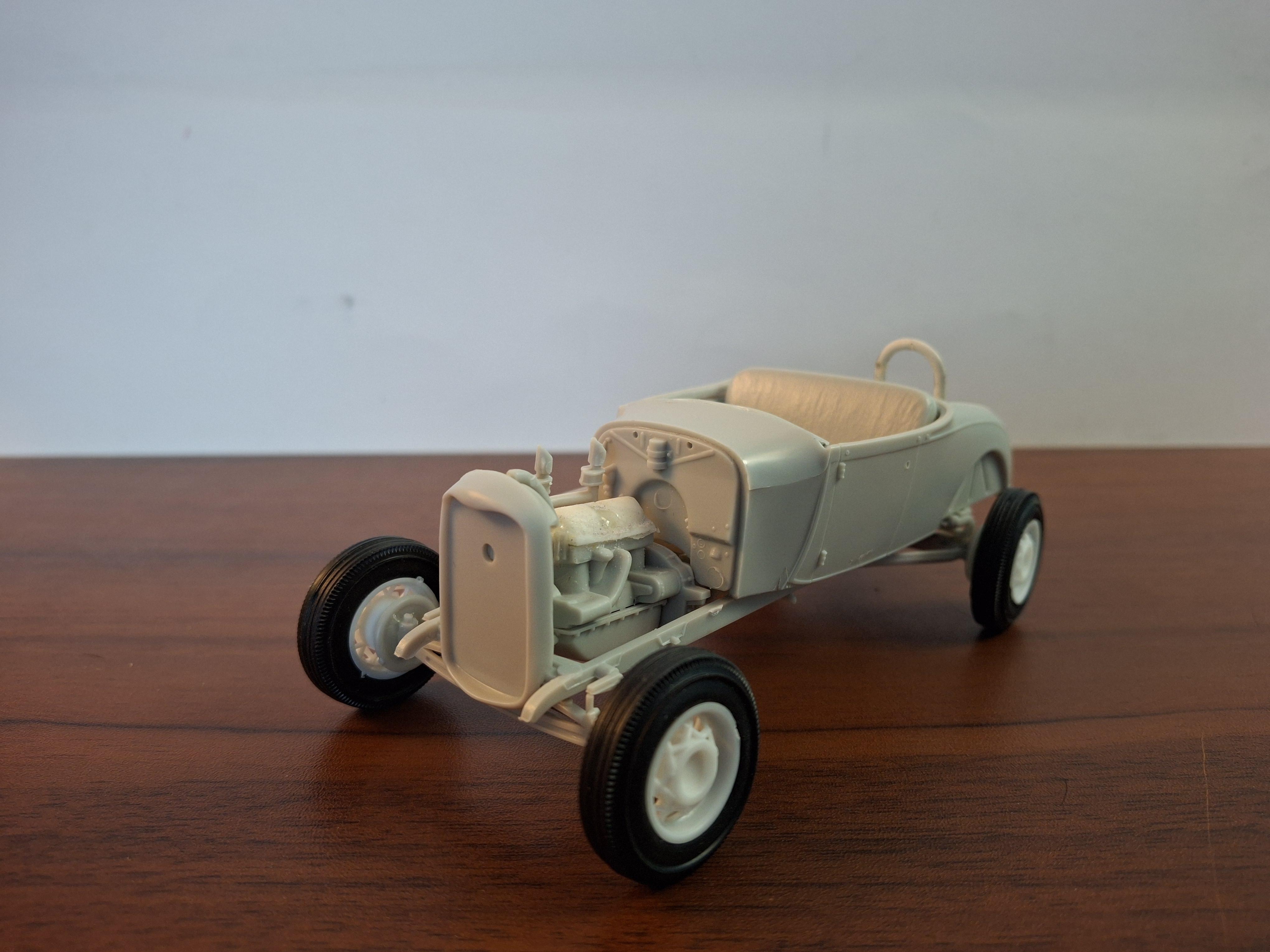

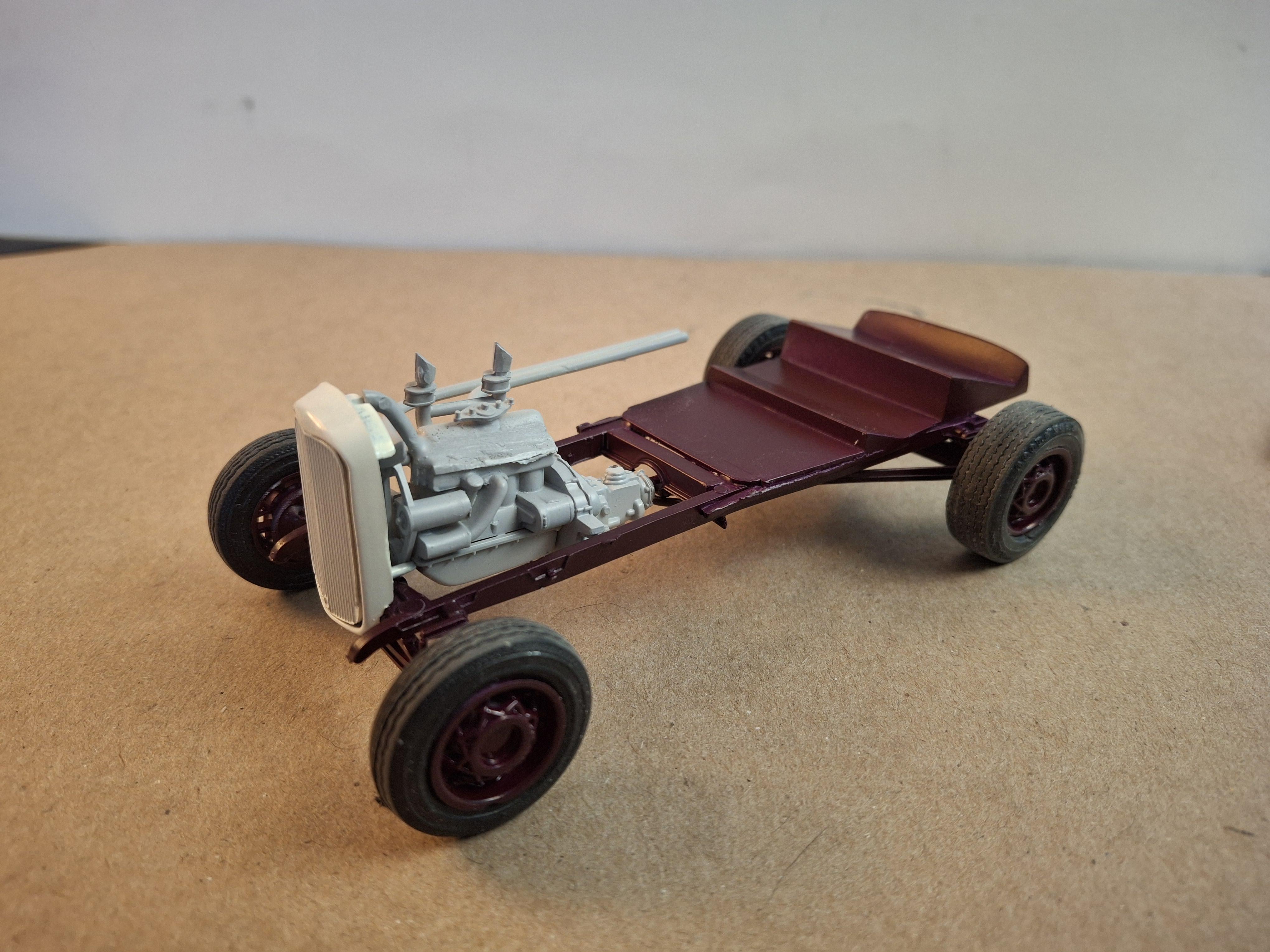

  7. Got everything done except the headers. I also opened up the top. Once I get those headers done and decide on the color / colors I can get this one done.

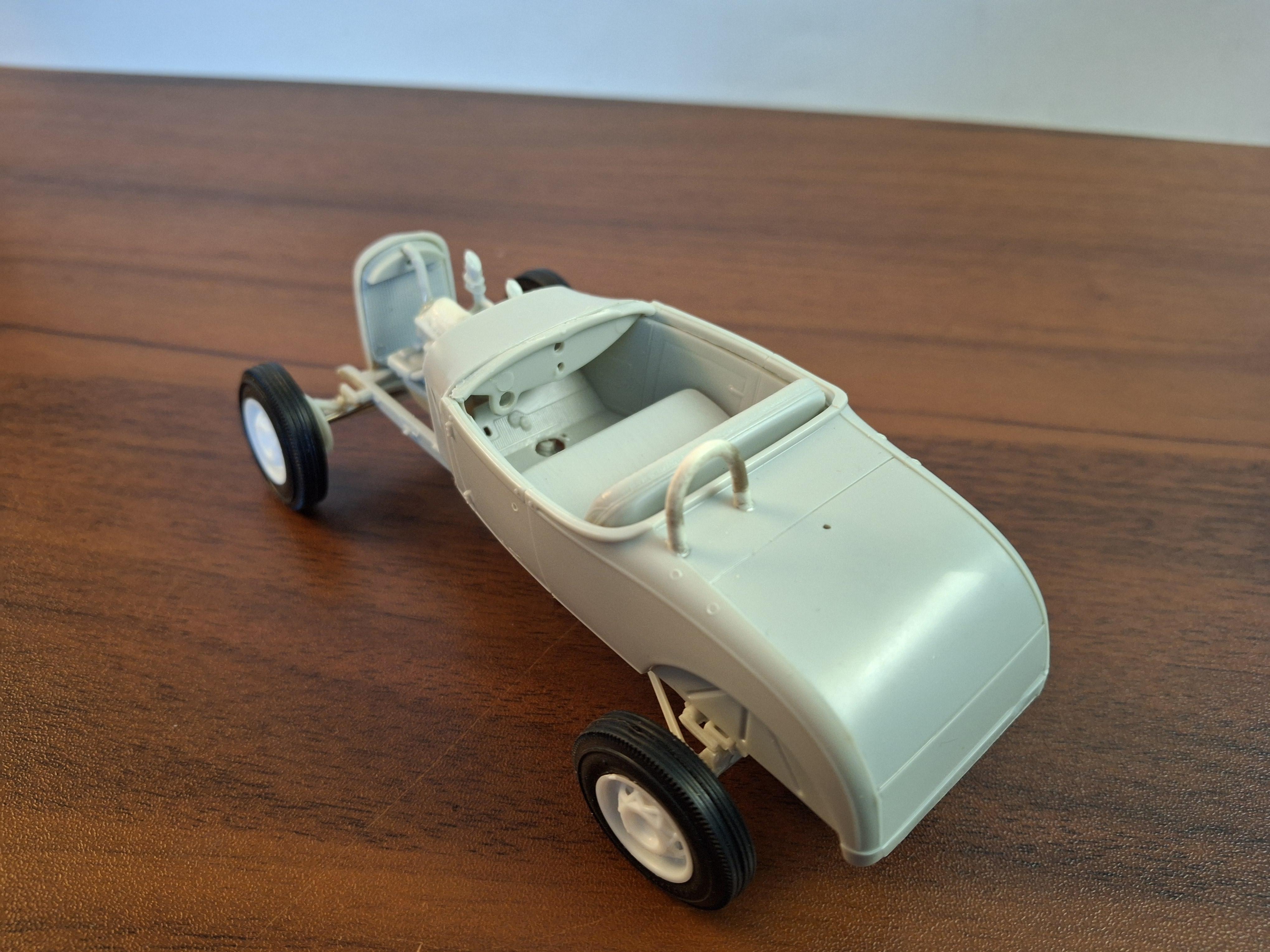

  8. The 32 Ford coupe 4 in 1 and 32 Ford Vicky 3 in 1 came out with dirt track art work on the box in 2006 I got them right away, only to find out the only thing in the box to make a dirt tracker were the decals and some ideas on a supplement sheet. It did list where you could get the parts ,so on the shelf they went for years. This weekend I decided to build one. I had cast some tires awhile back and found some race parts I can use. Drilled out kit wheels and opened up passenger window. Since the interior is not being used this is the perfect time to lower it a little. So it will also need some correct flathead headers, bump bars, side bars ,roll bars ,tires, floor, etc but it does have nice decals and box art.

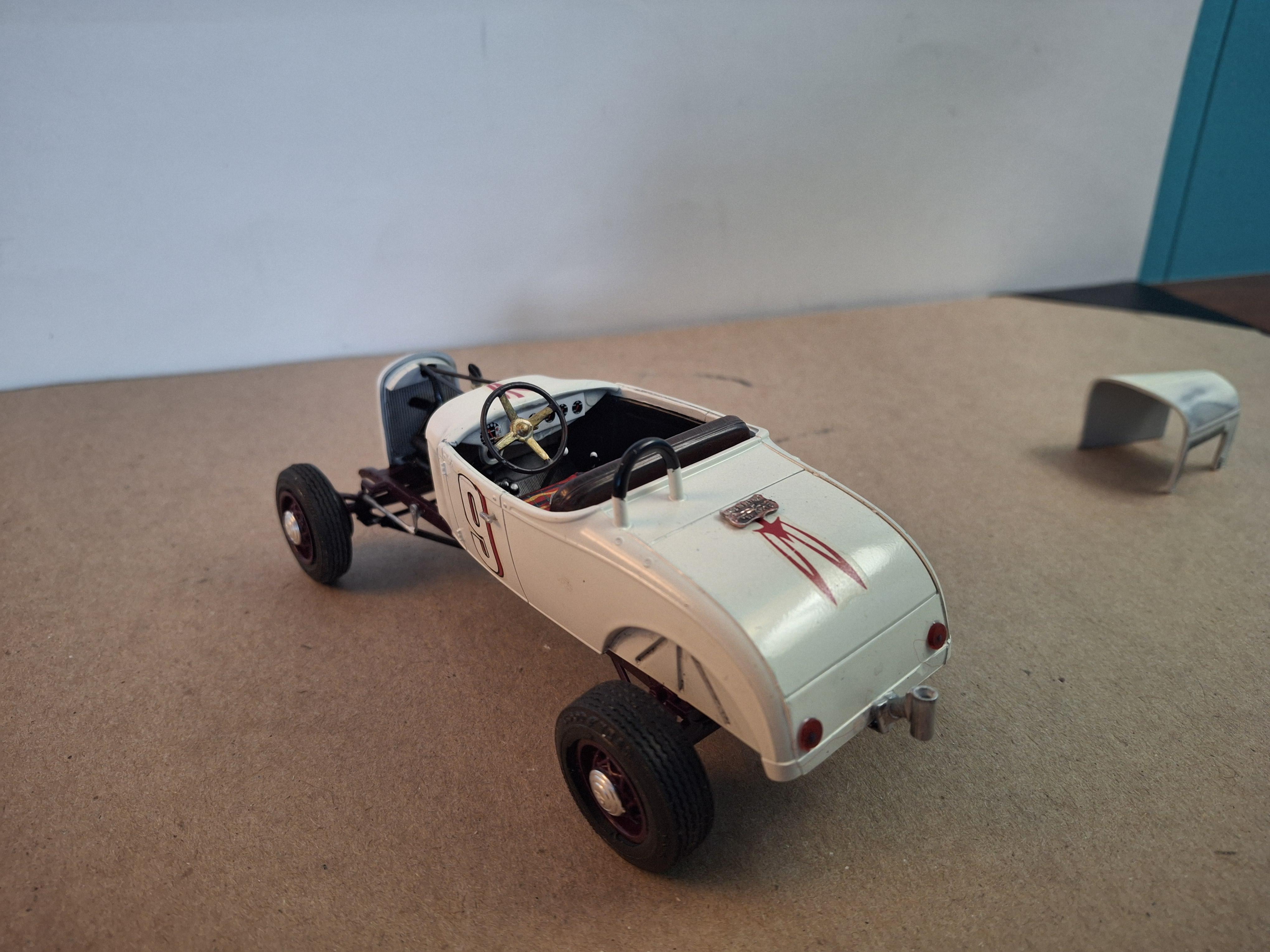

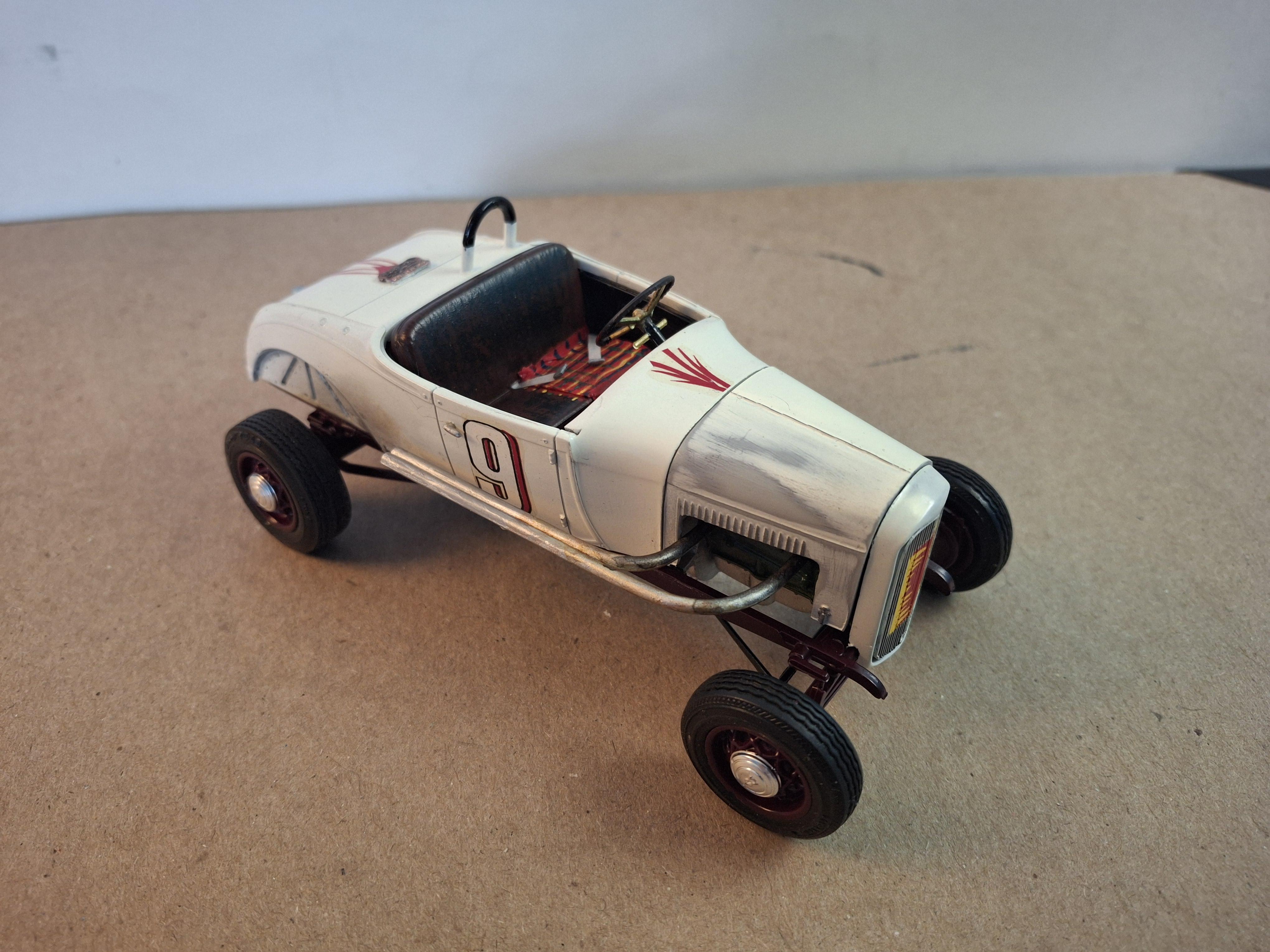

  10. I really enjoyed doing this one , of course it had 3 different tire styles and color combos and interior styles but it was fun. Kit was AMT 29 Ford from 2002 when you never knew what was in the box. I had to source some early speed stuff but all parts were comon. I did a little weathering on the body where the exhaust pipe ends and on the pipes at the engine. I also left the hood with the "still working on it" look. Made a seat cover out of tissue,Elmers glue and warm water for the drivers side seat bottom and gave it a plaid look. Seat belts made from tape. Decals are vintage 60's issue AMT '32 Ford. Grille/radiator housinng is also '32 Ford. Hubcaps and tires are parts box. Entire kit in a satin finish.

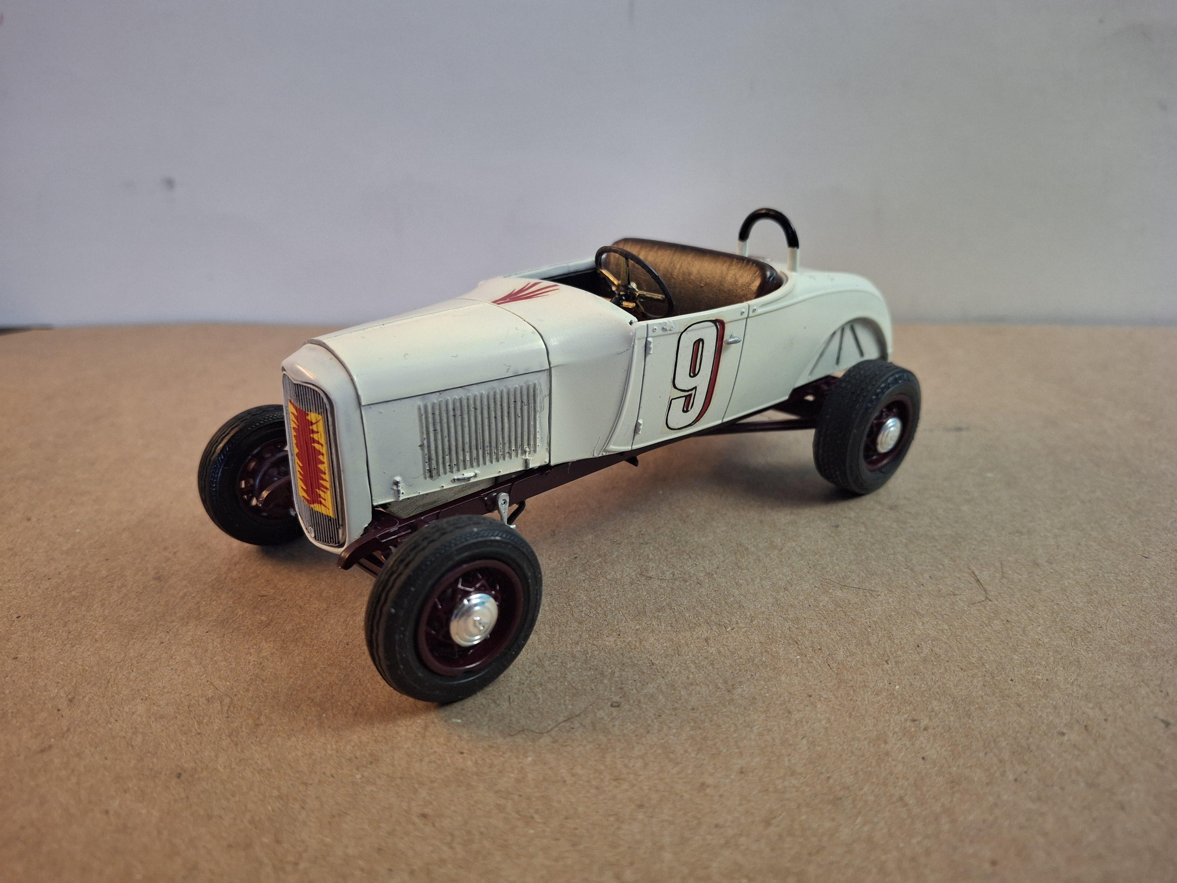

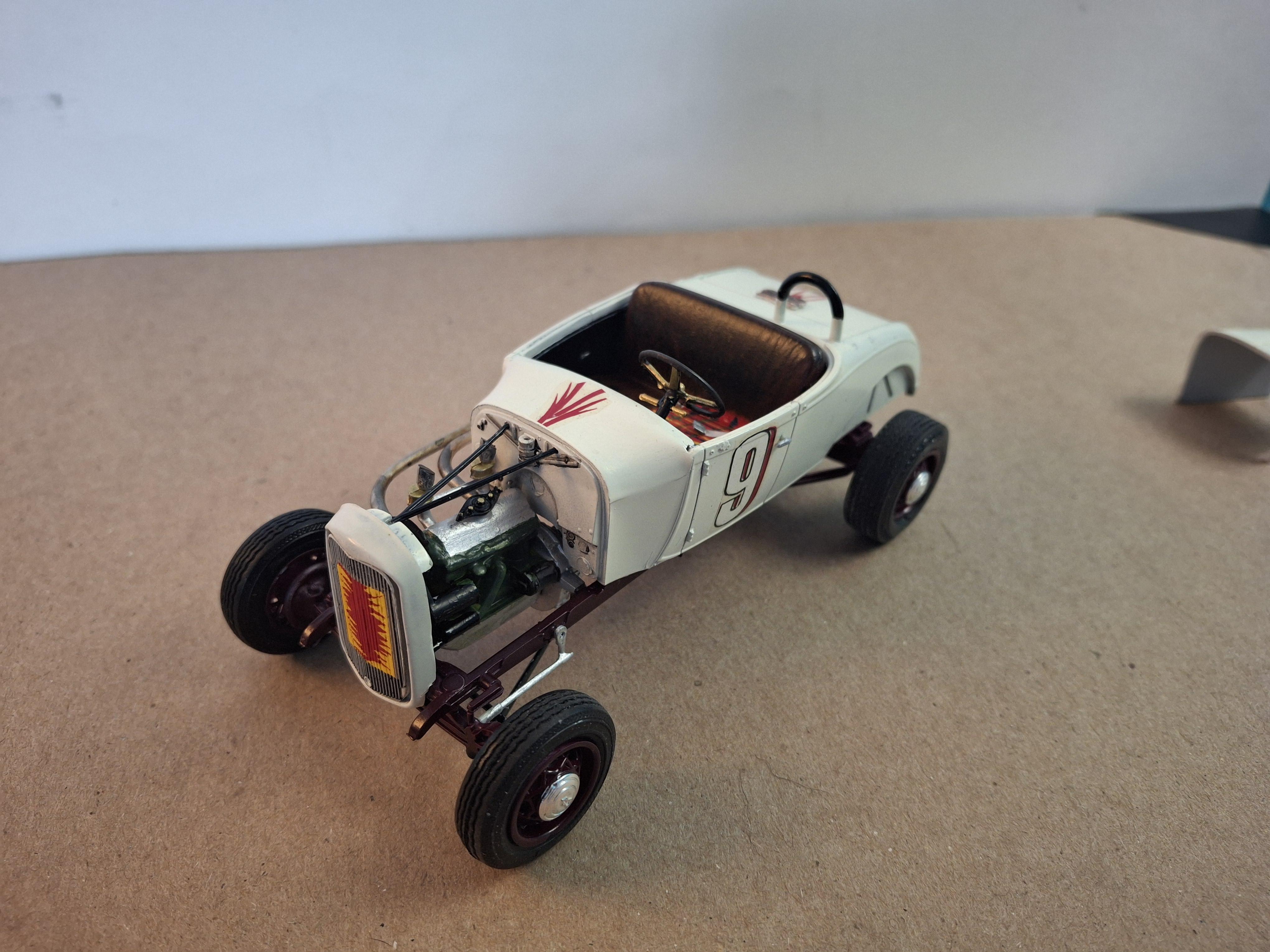

  12. I changed tires for the last time, the rears are slightly taller and wider and both front and rear actually look better to me. I also decided to add the hood so it needed a cut-out for sure. I may paint the hood as a work in progress. Chassis was painted Maroon then hit with dull coat. Body is Racing White that will get a satin coat once the decals are on. I dont usually coat over decals but Im afraid of ghosting like I got once with dull coat, not sure about satin ..

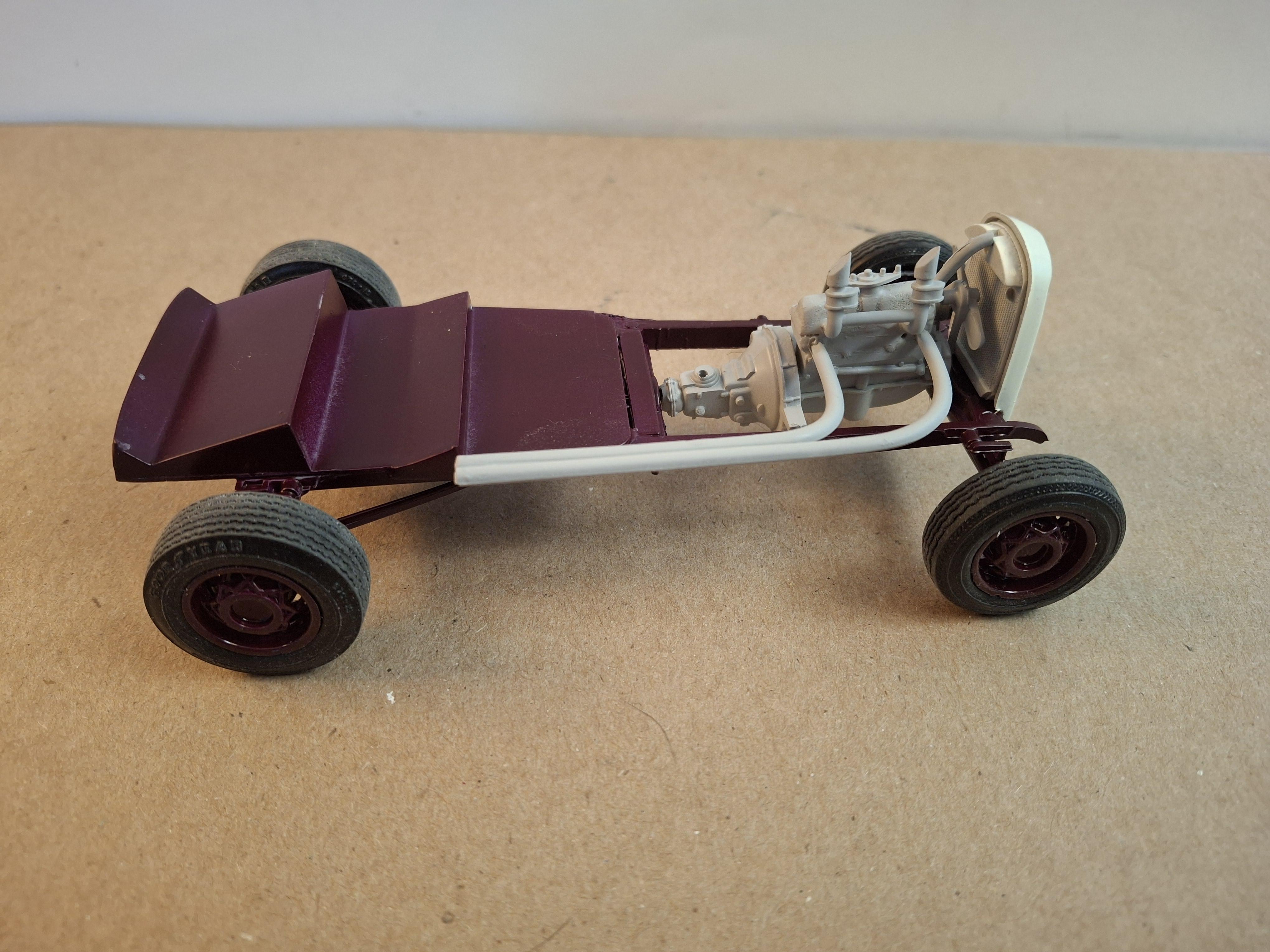

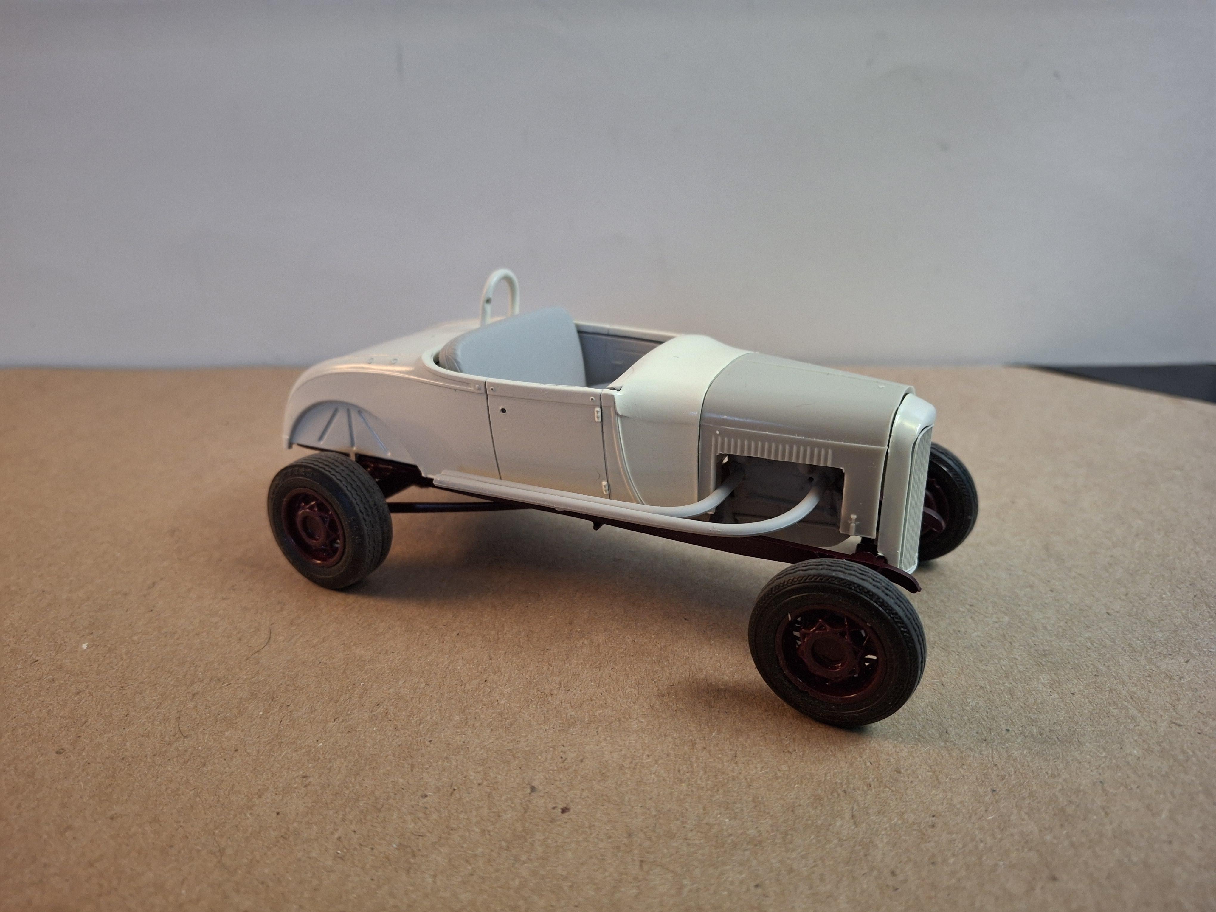

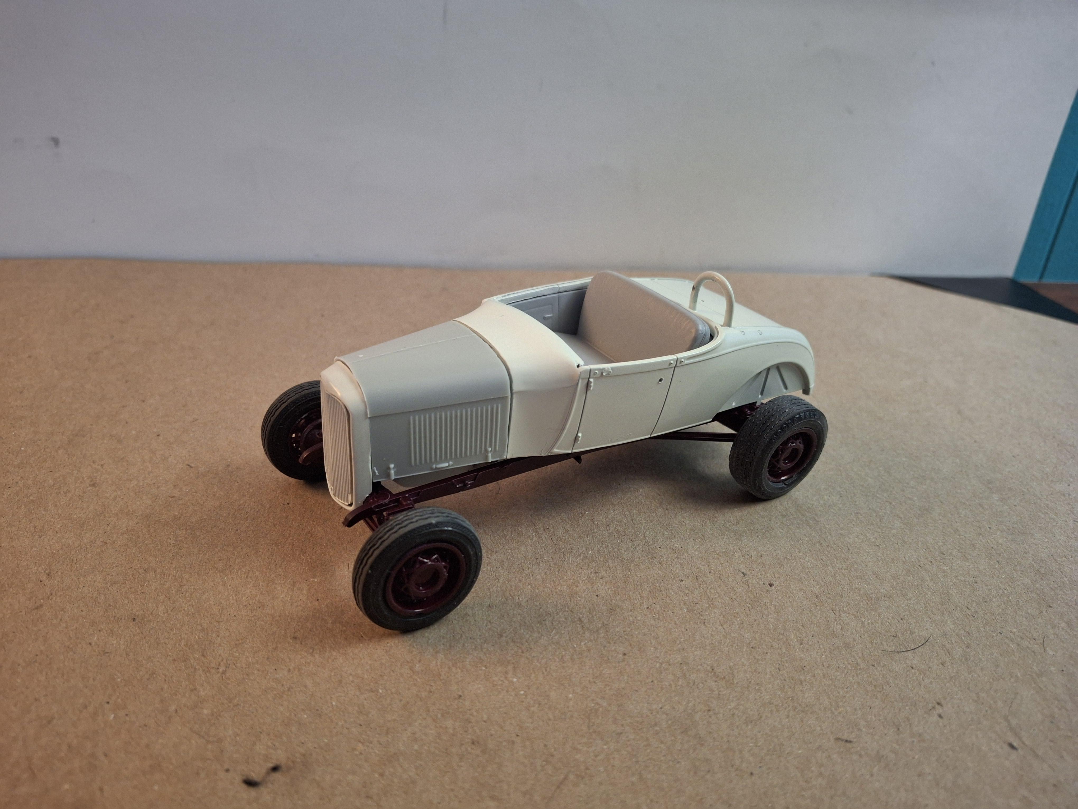

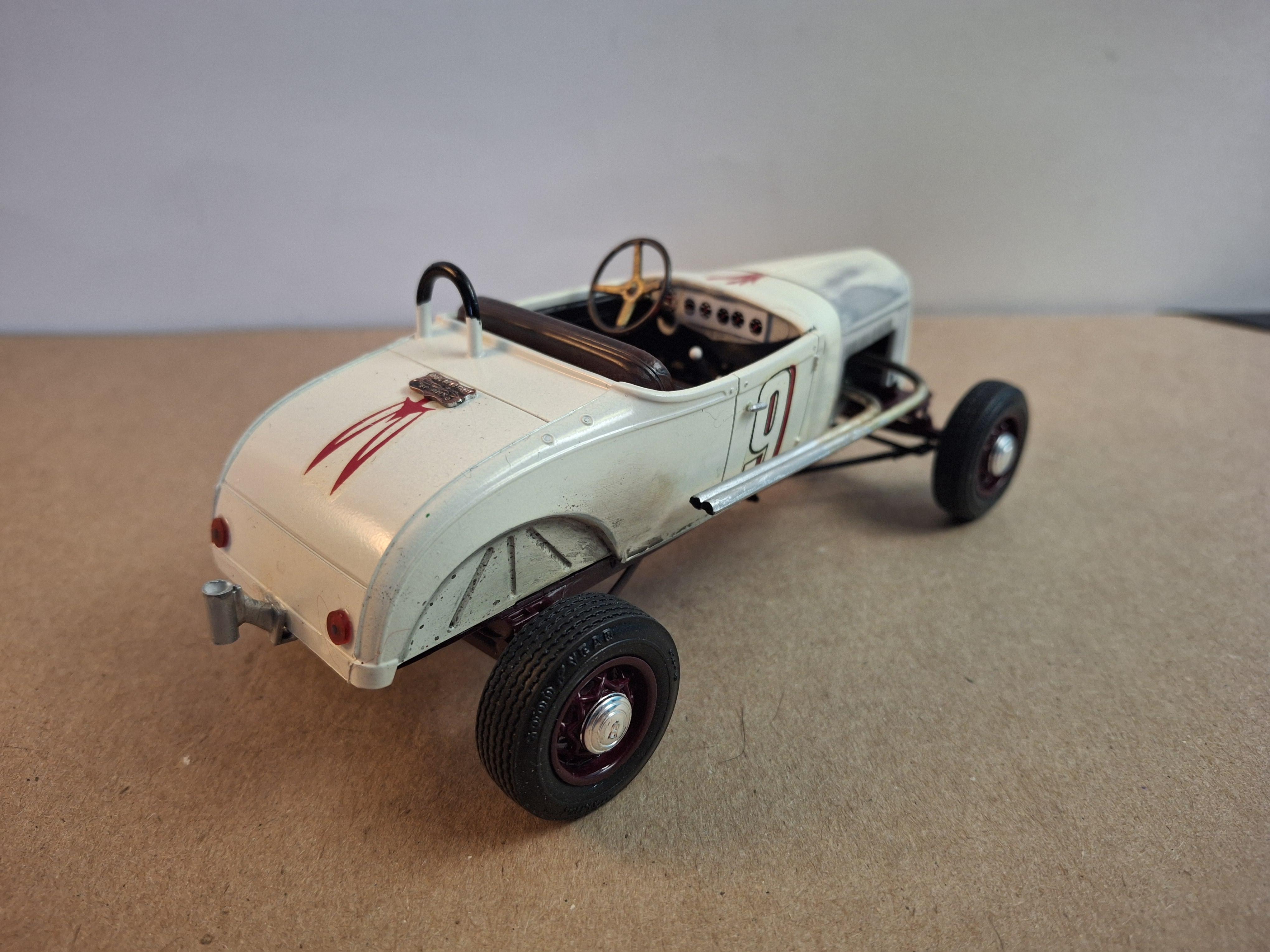

  13. I started up a 1929 Ford like the ones they use for The Race Of Gentlemen in Jersey. I always enjoy seeing the cars and bikes they run out there on the coast. Kit is the AMT 29 Ford ( the issue with some Aka Kart parts in it ) '32 grille frame, some speed part came in the kit but the intake was gone for the 2 carb setup, so I borrowed the one from the original AlaKart kis '29 and made a resin copy. I also opted for '32 wheels and tires as the tall skinny ones from the 29 didnt work for me, but as time goes on I may change back.

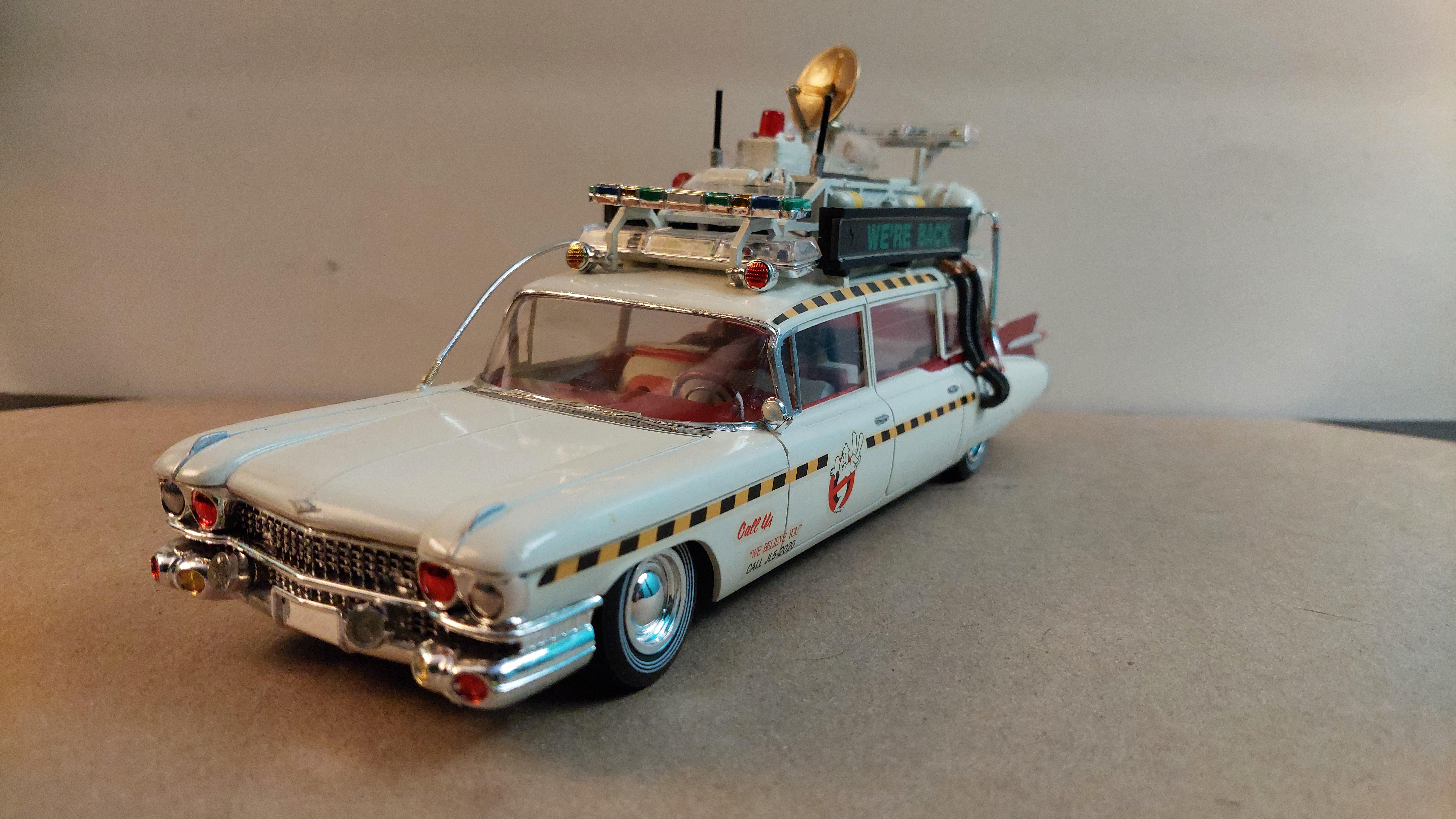

  15. What do you do with a 1989 era Indy car when you've had it for awhile and it never gets a 2nd look, have some fun with it..

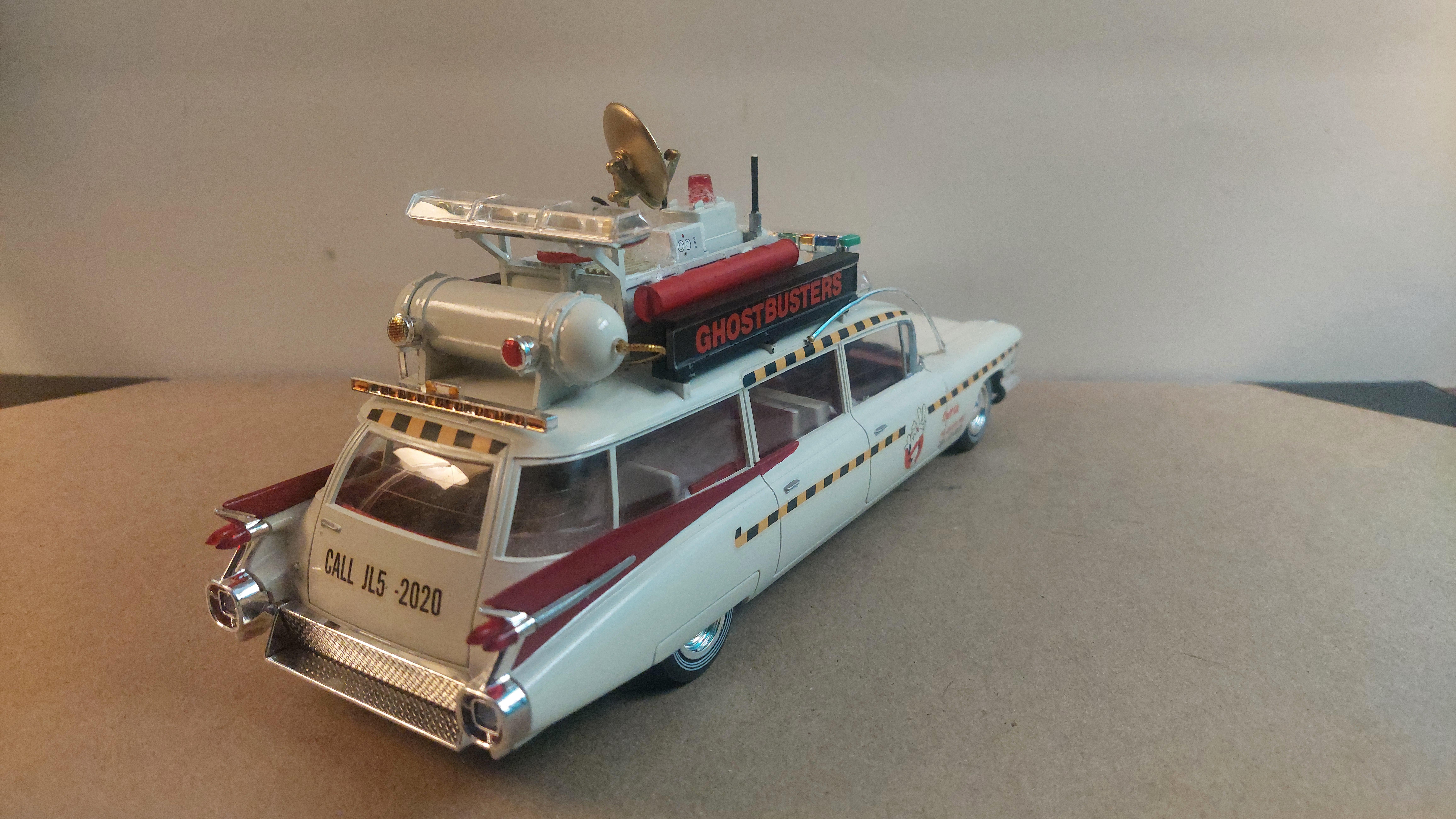

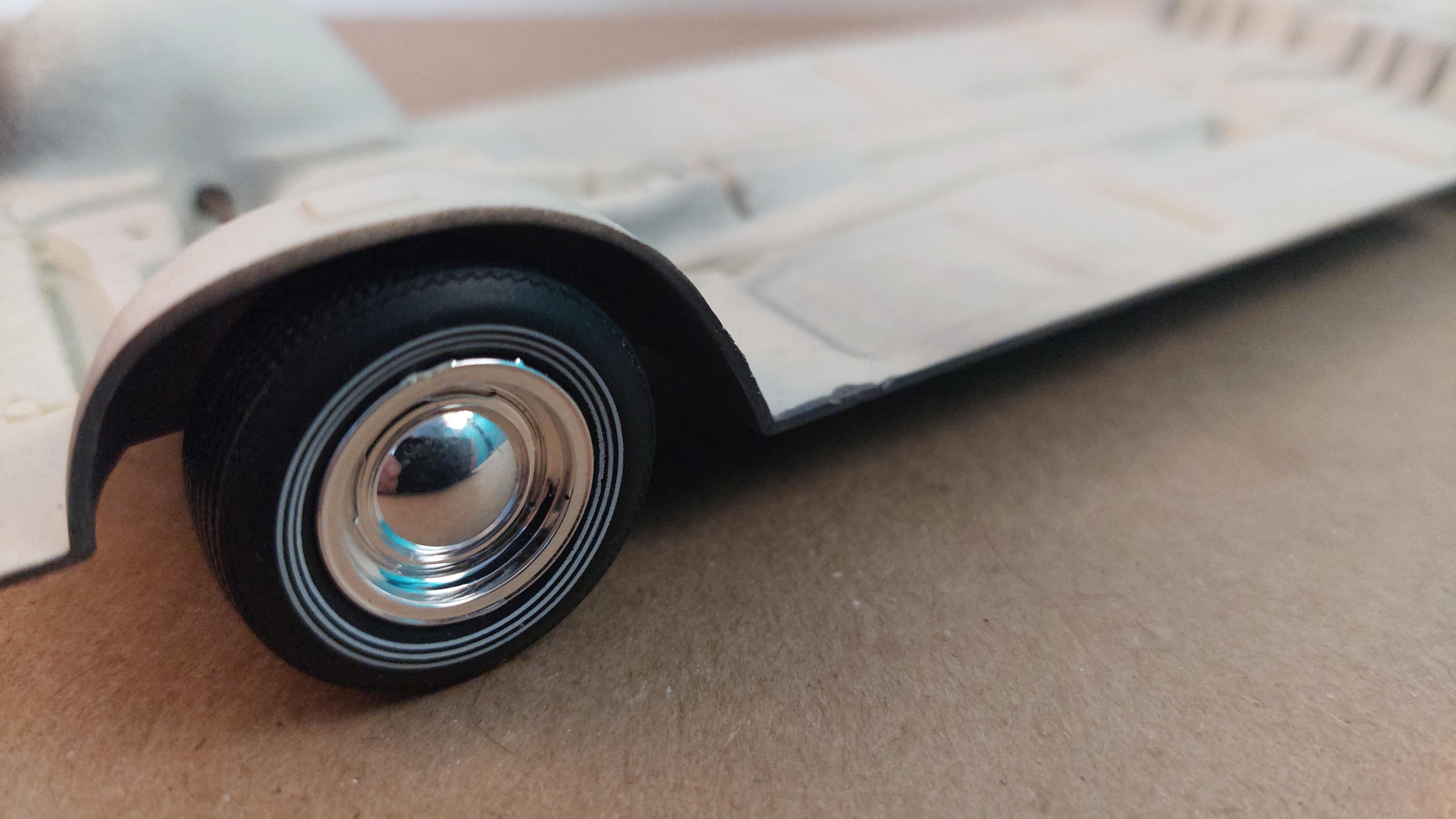

  20. This was the full glue kit by AMT.Pretty straight forward box build with the exception of tires, I used a triple white walls. Loads of detail painting on this kit.

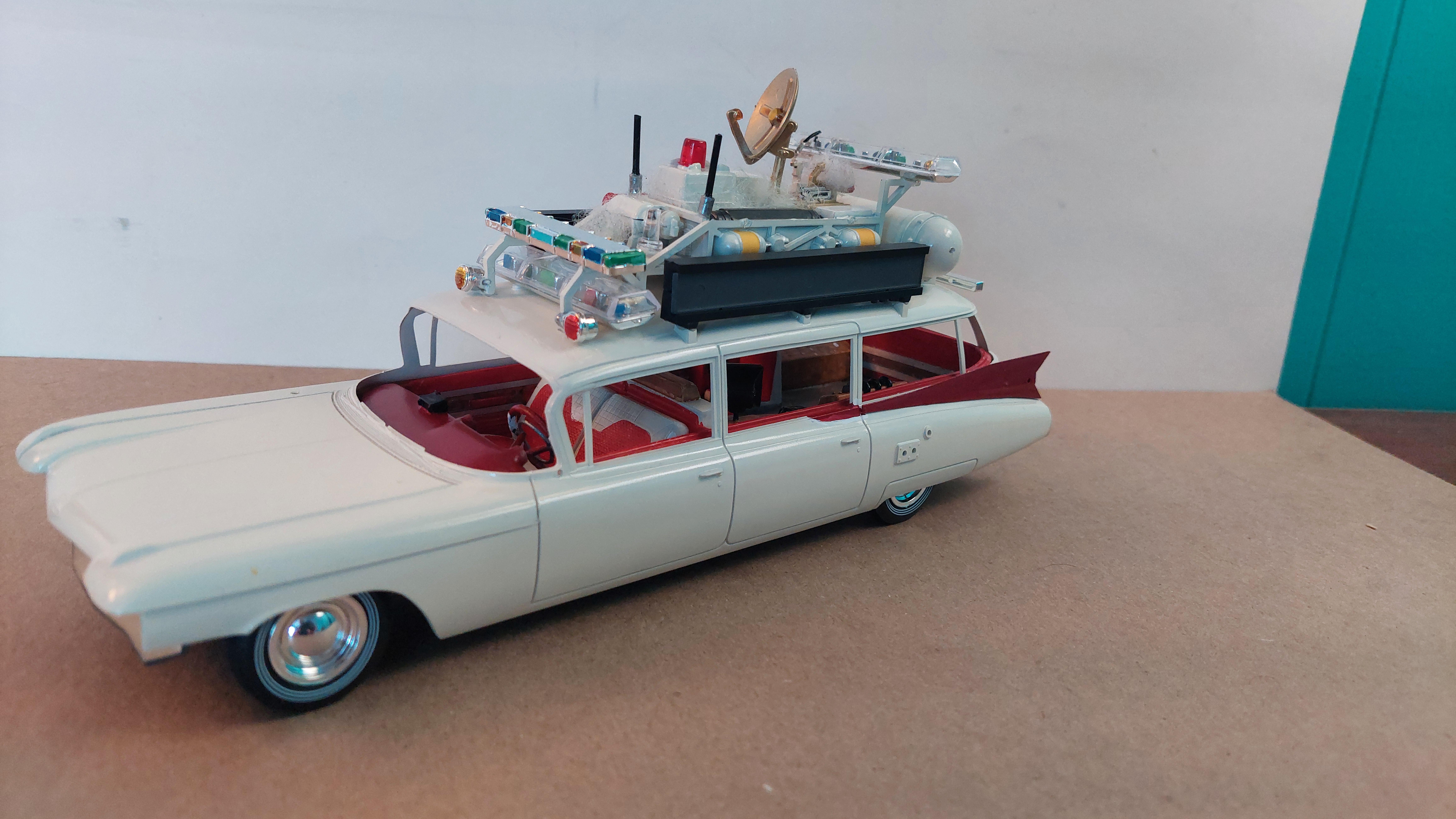

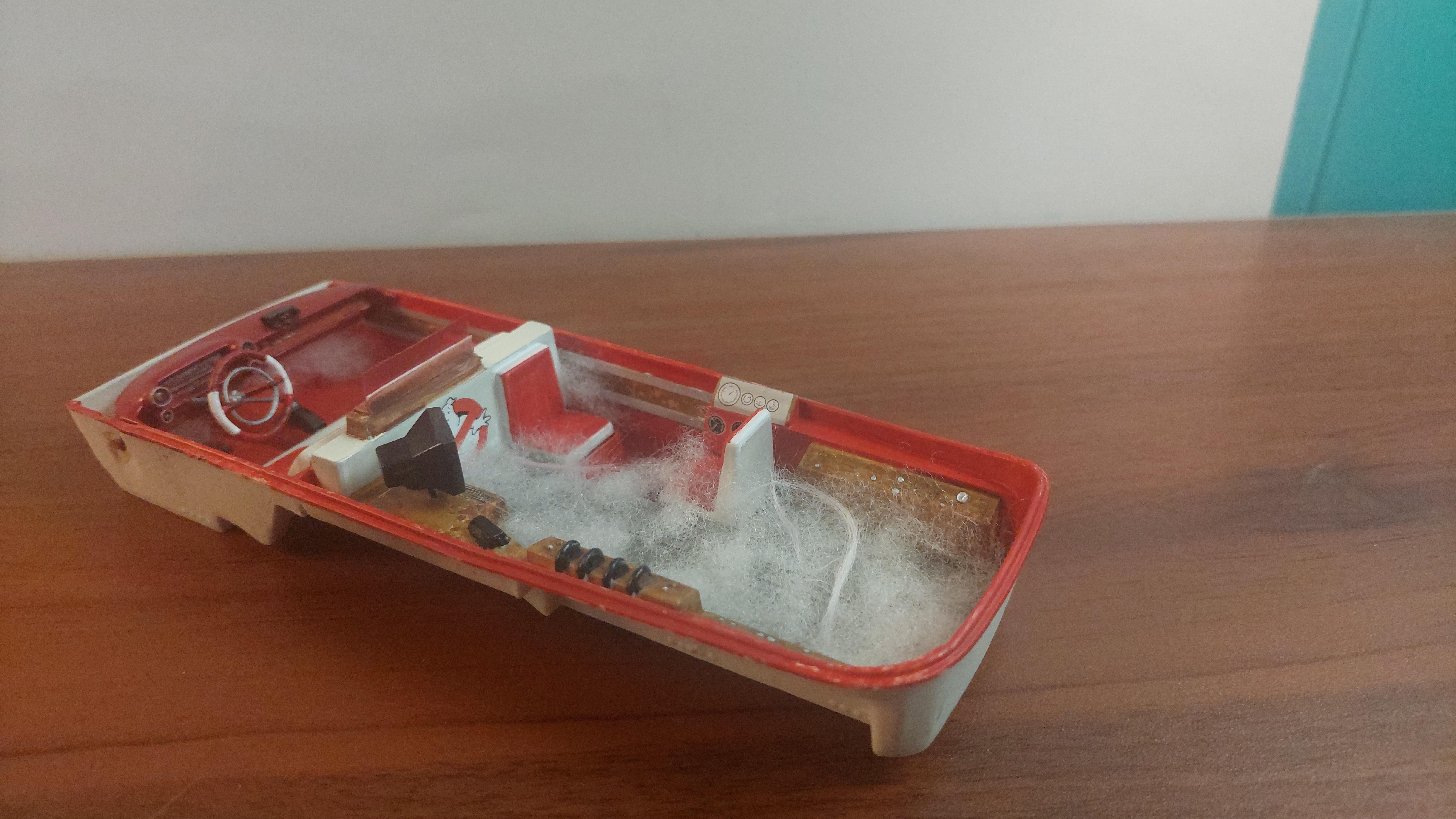

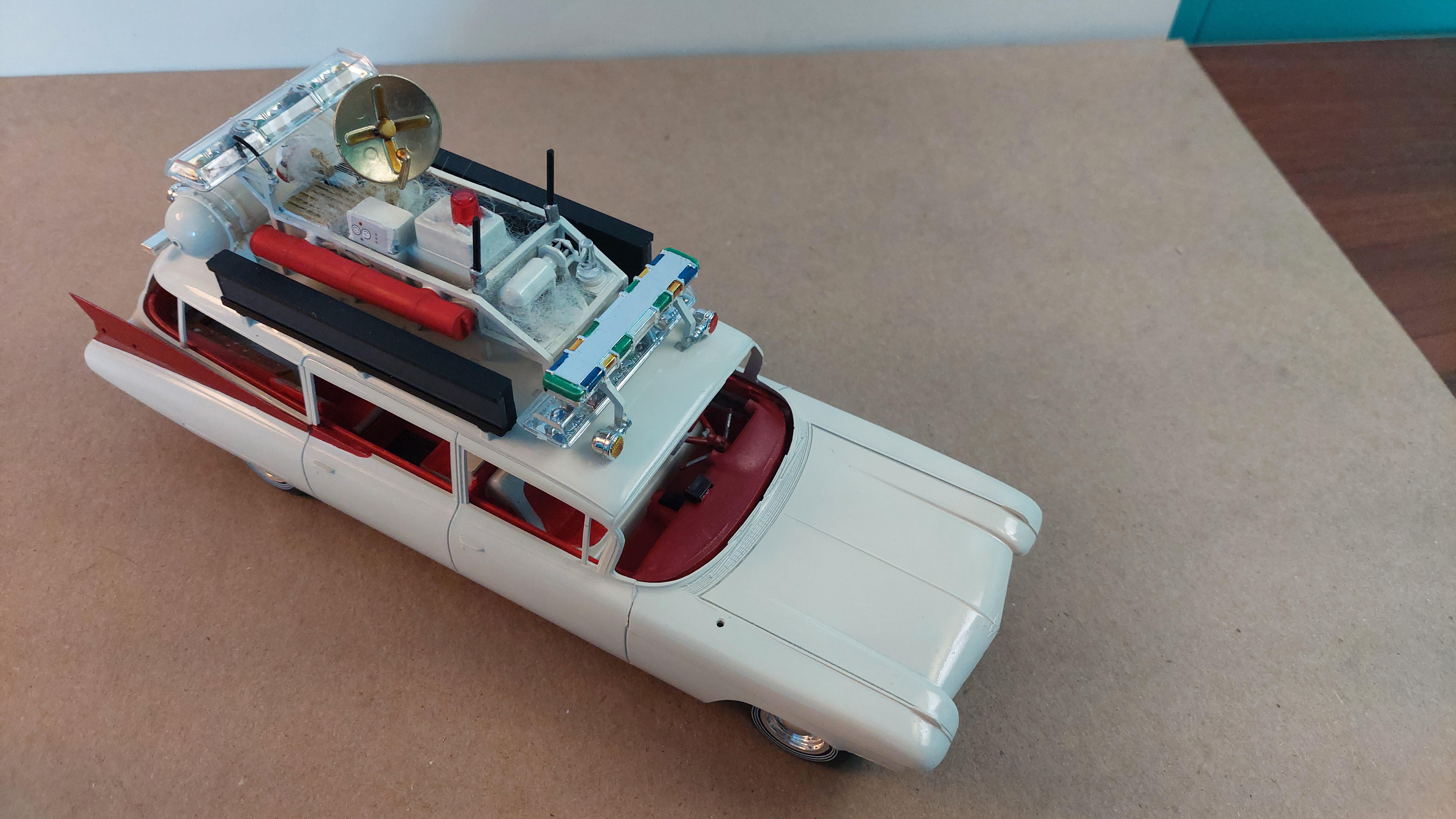

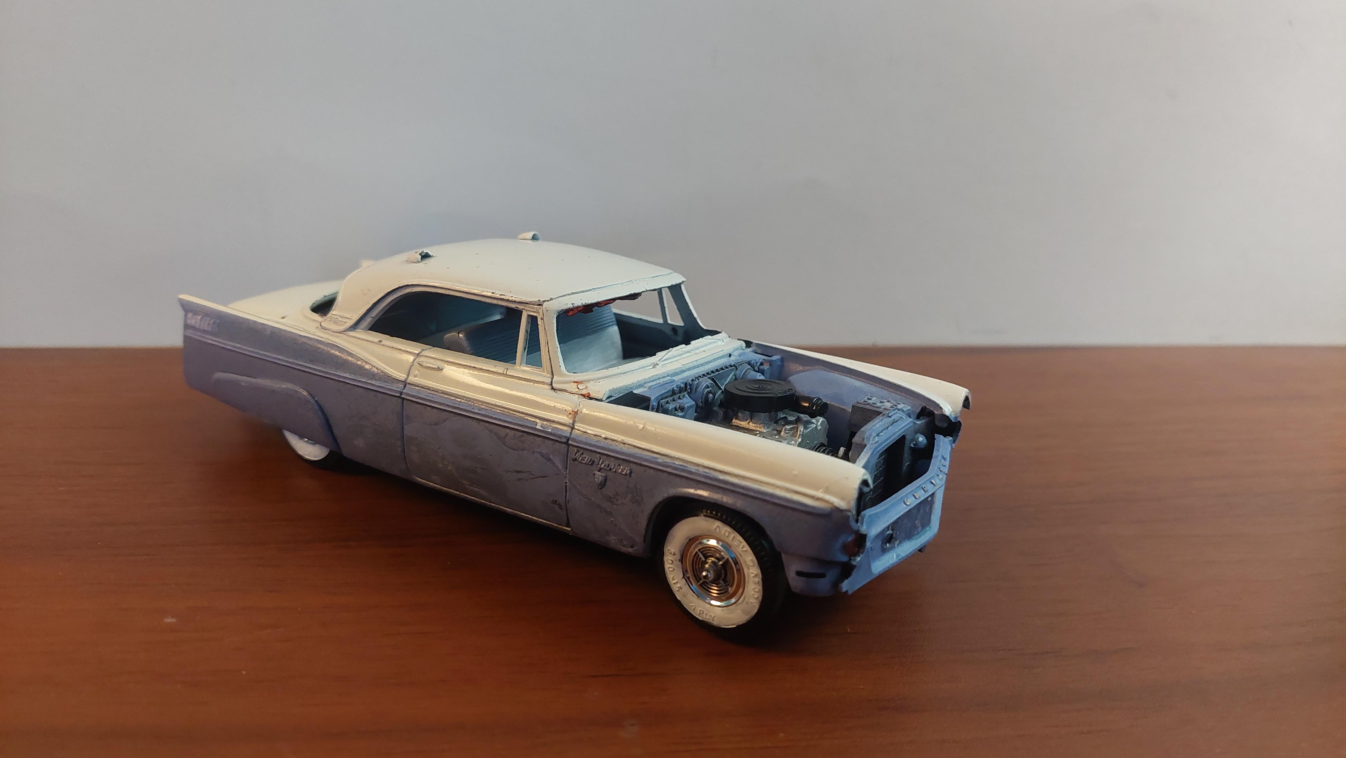

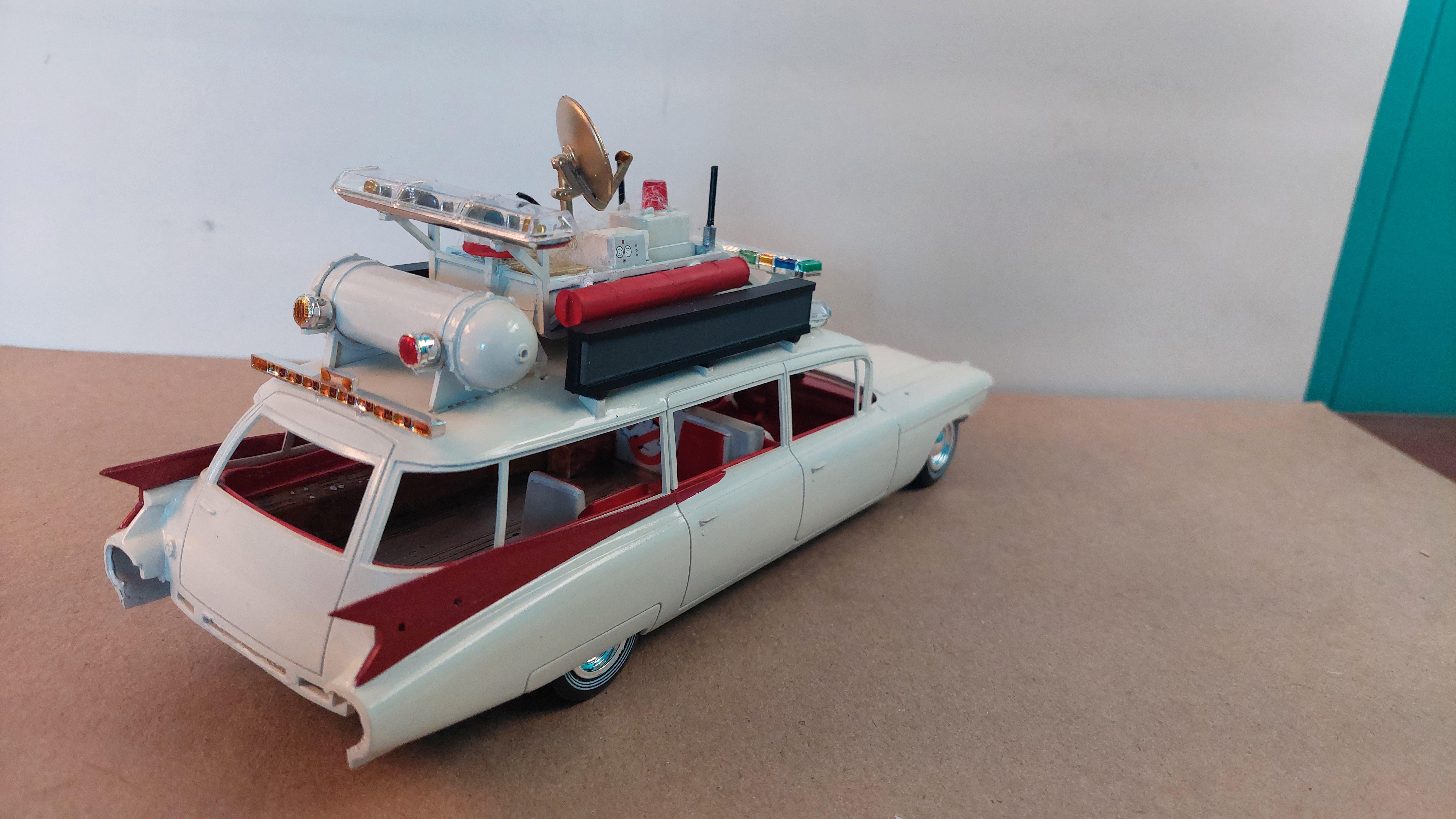

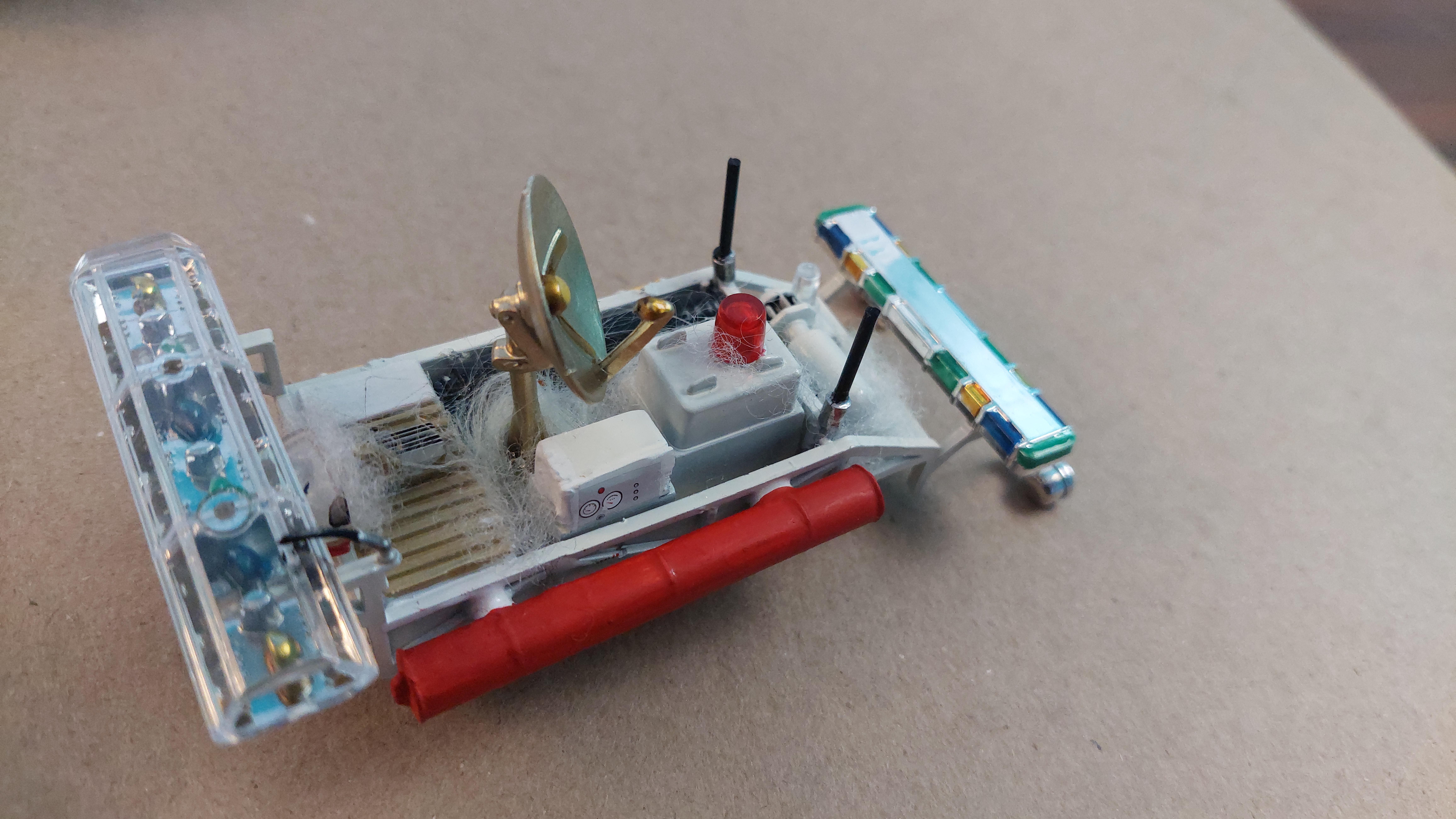

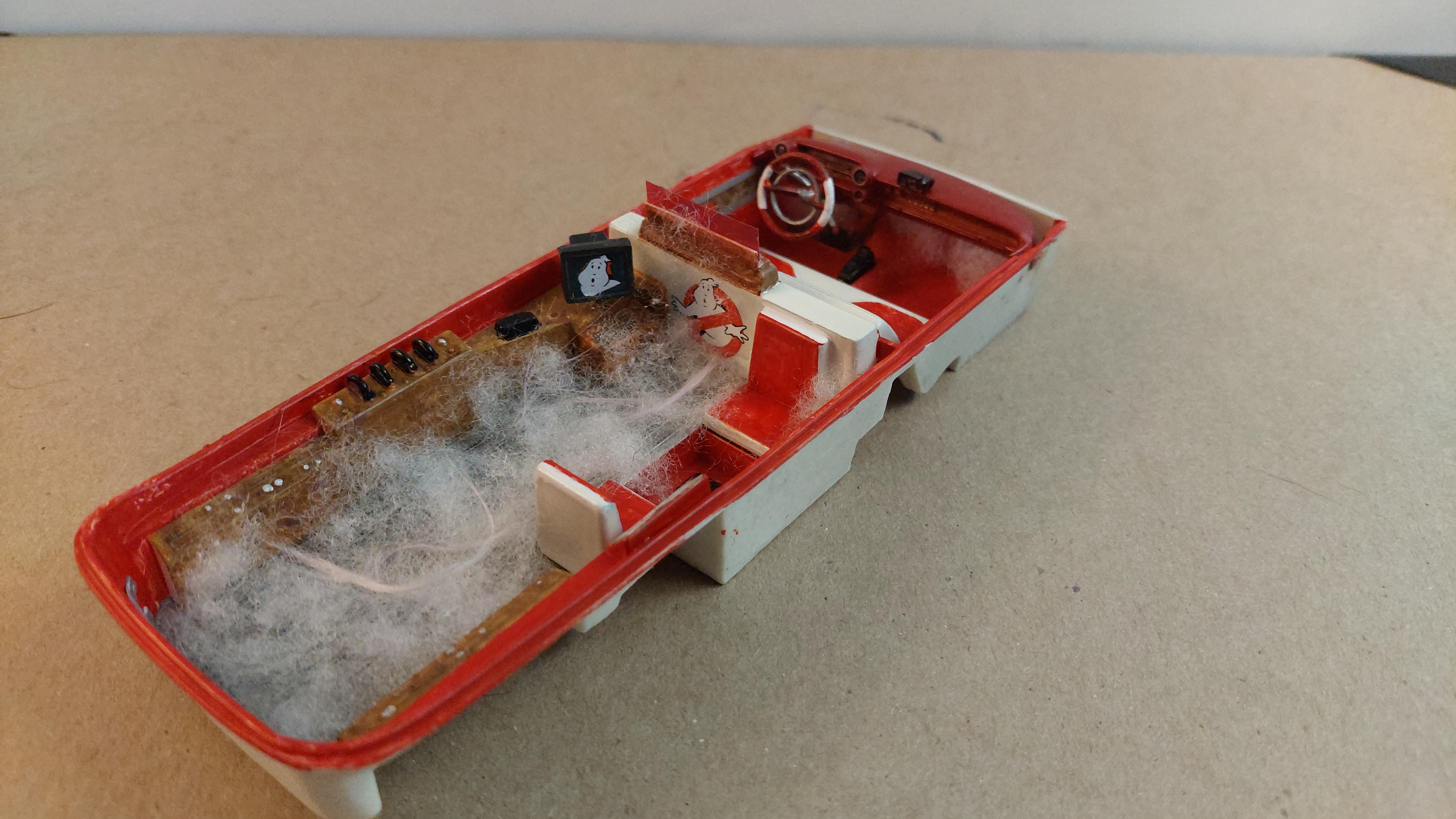

  21. This is the full glue kit from 1989, its still a curbside build but detailing the roof rack and interior was really time consuming. Next is more bare-metal foil on the body. I need to make a chrome side trim piece for the rear fin...I know I had them both and now I cannot find one of them. The only thing I changed out were the tires, I opted for wide ovak multi thin whitewalls , also added (floss fill)smoke /fog to the roof rack and interior for a ghostly look. Just enough to be able to see through. Body painted Racing White.
