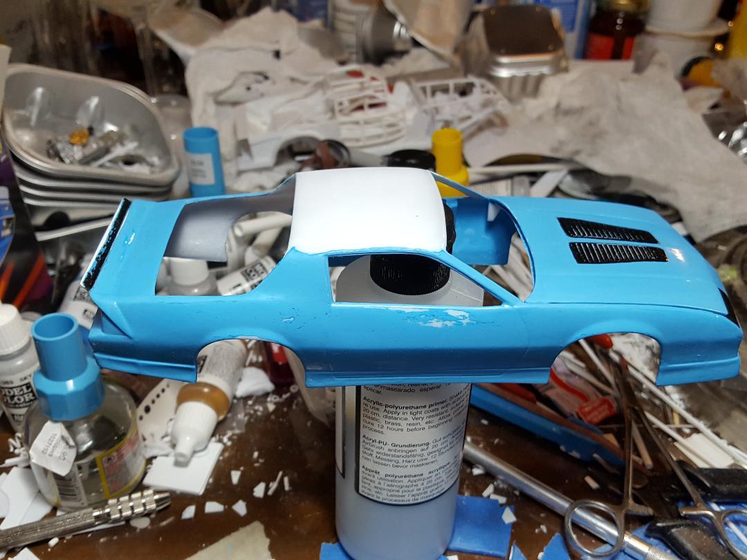

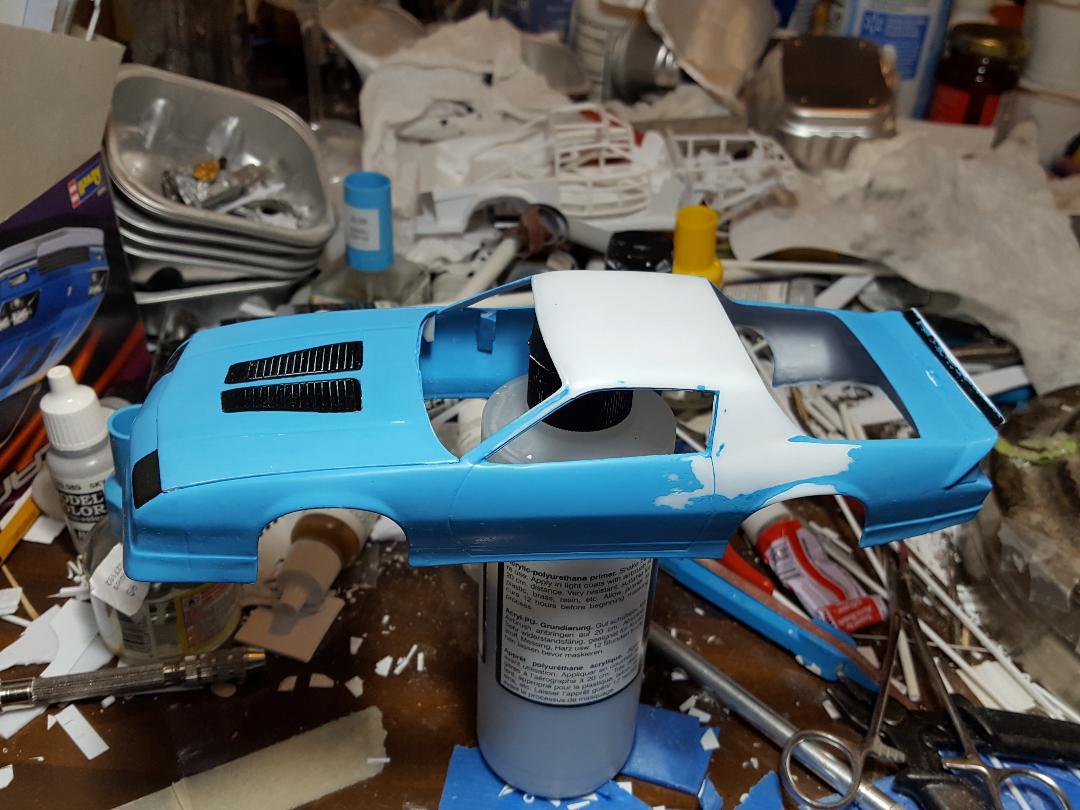

  3. Finally got the park light inserts finished. I will paint them black and install them after I repaint the body just like the door handles. Hopefully it will make for a cleaner look which I'm not that good at doing. Like to do the same thing for the headlight covers and hood louvers but that's just too much work. I don't want to spend another year on this thing.

  7. I had to round up the corners of the park lamp openings before I can make fillers for them. I won't install the fillers till after the body is painted. Just like the door handles.
  8. Yes, chrome would not be a good choice for headers unless you never cranked it up again. Thanks for the clear up.
  9. Had to make the park light openings less wide to get them to look like the openings on the IROC race Camaro. For some reason they are not as wide as the stock Camaro park lamp openings. I used a rate pair to figure out the dimensions from a front photo of the IROC race Camaro. Also finished the left door handle. I just need to add a raised border around each park lamp opening and also add a filler piece in the opening which I may do later since it will be black. IROC Camaros before 1989 had cooling hoses coming from the park lamp openings, I guess for the brakes but not in 1989, the year I'm doing.

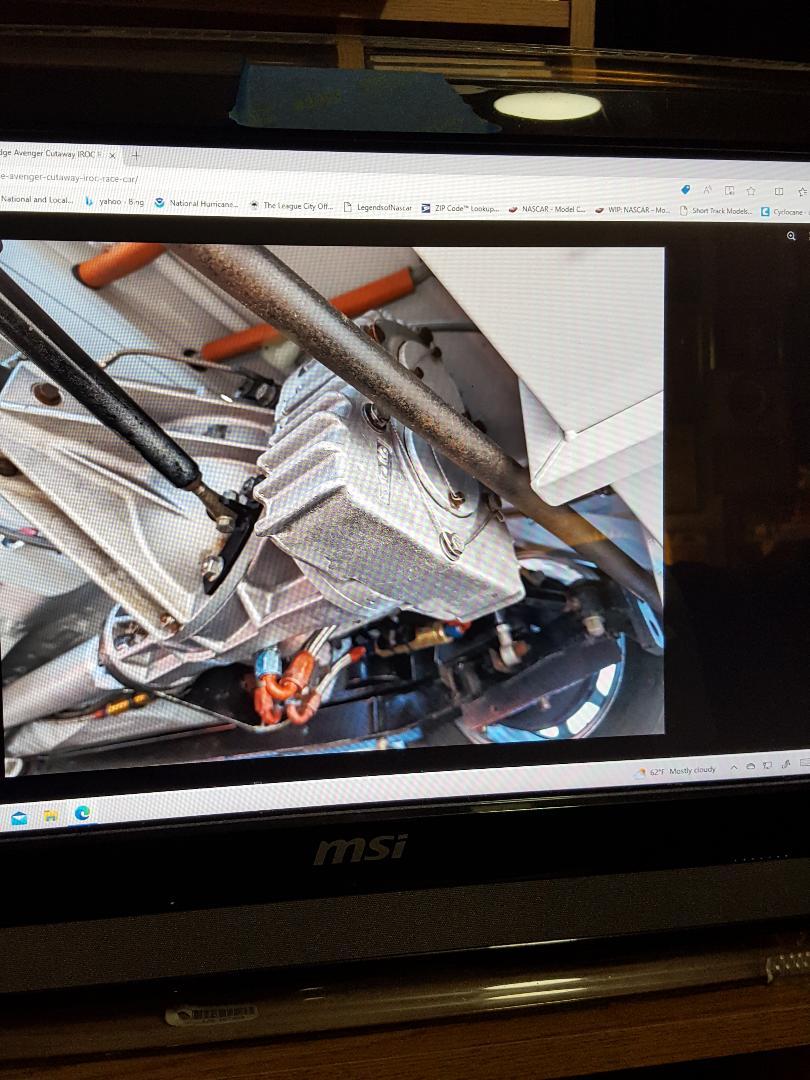

  10. Andrew, thank you for all the ref pictures you provide us. You have the scale modeler in mind when you take your photos, and it is very appreciated. Are those chrome headers?
  11. Thanks, Anton. Yes, I will be brush painting the body, but I want to try the Mr. Surfacer 1000 rattle can primer first to get a much better surface to paint on this time than what I had last time. the Vallejo brush paint primers are not a very good surface primer. They don't sand out very well or like a scriber used on the door and trunk gaps. it just leaves a very rough edge on the gaps. It actually dries too hard for good sanding to take place if you can understand what I'm saying. You would have to experience it yourself to know what I'm talking about.

  17. I will make the handles where I can install them after the body is painted and they are painted. should be a lot cleaner looking. I will also make a lock cylinder that will slide in the hole. that will also be pre painted. Starting the process of cutting out the park lights. I've decided to reprime the whole model before I repaint it. Found that Mr. Surfacer 1000 that Andrew recommended at HobLob and will try that. Hoping it sands out smoother than the Vallejo primers I have had a lot of trouble with.

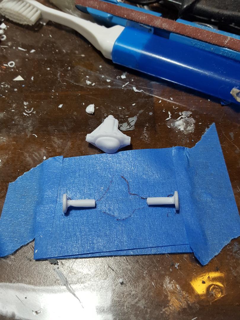

  20. I was going to start on the repainting of the body, and I realized I needed to make some door handles that eventually got removed from all the body prep that kept on happening the first time I painted it. I also need to make some openings where the park lamps usually go. I need to fill the square holes for the handles with a sunk in tiny piece of plastic for the doors. And the park lamp openings will have some aquarium filter mesh put in them. The door handles on this car were nonfunctional, but they were there so I need to make them. So were the park lamp openings. I will make the handles so I can install them after the model is painted. The oob handles are almost an after thought.
