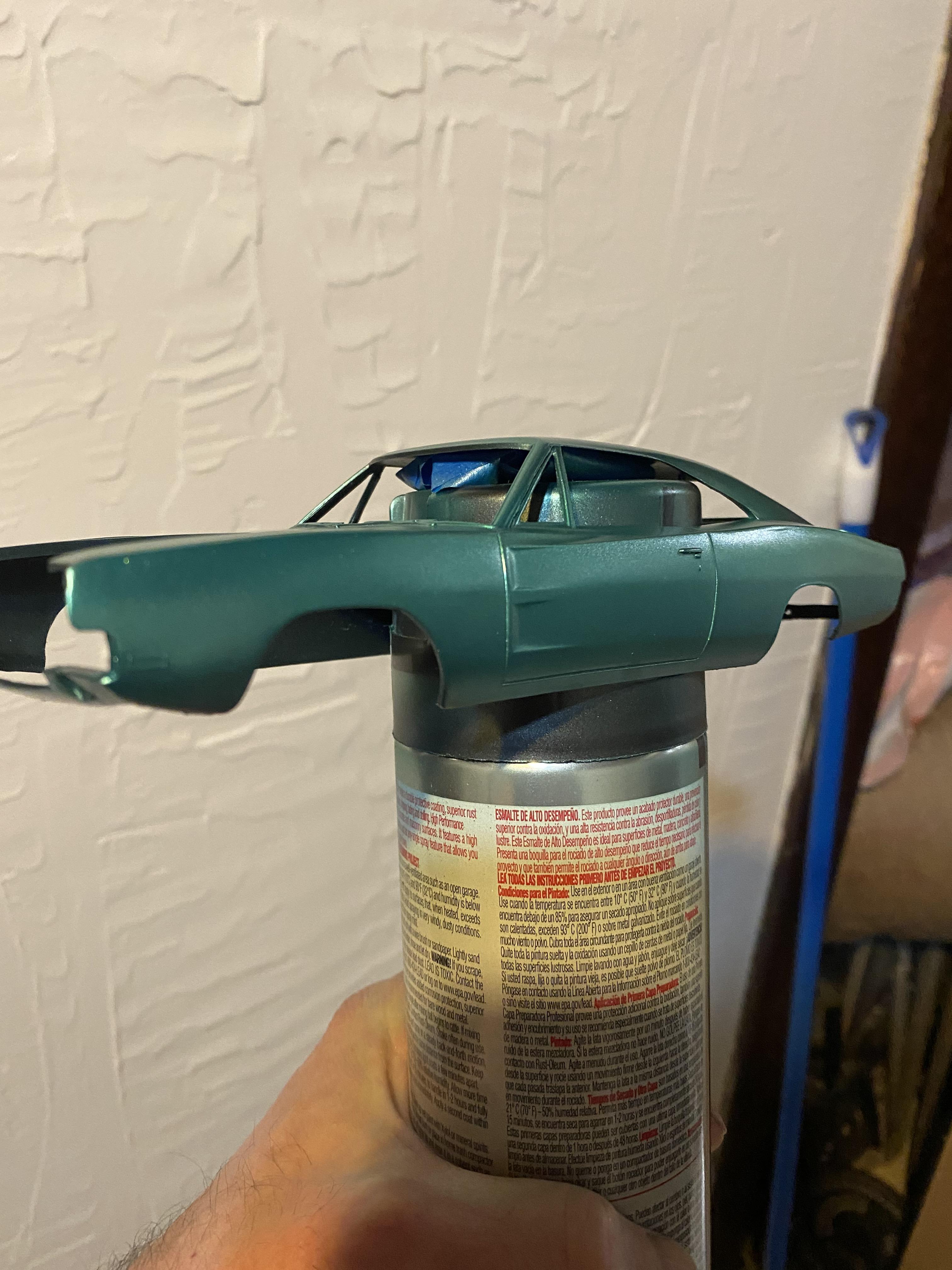

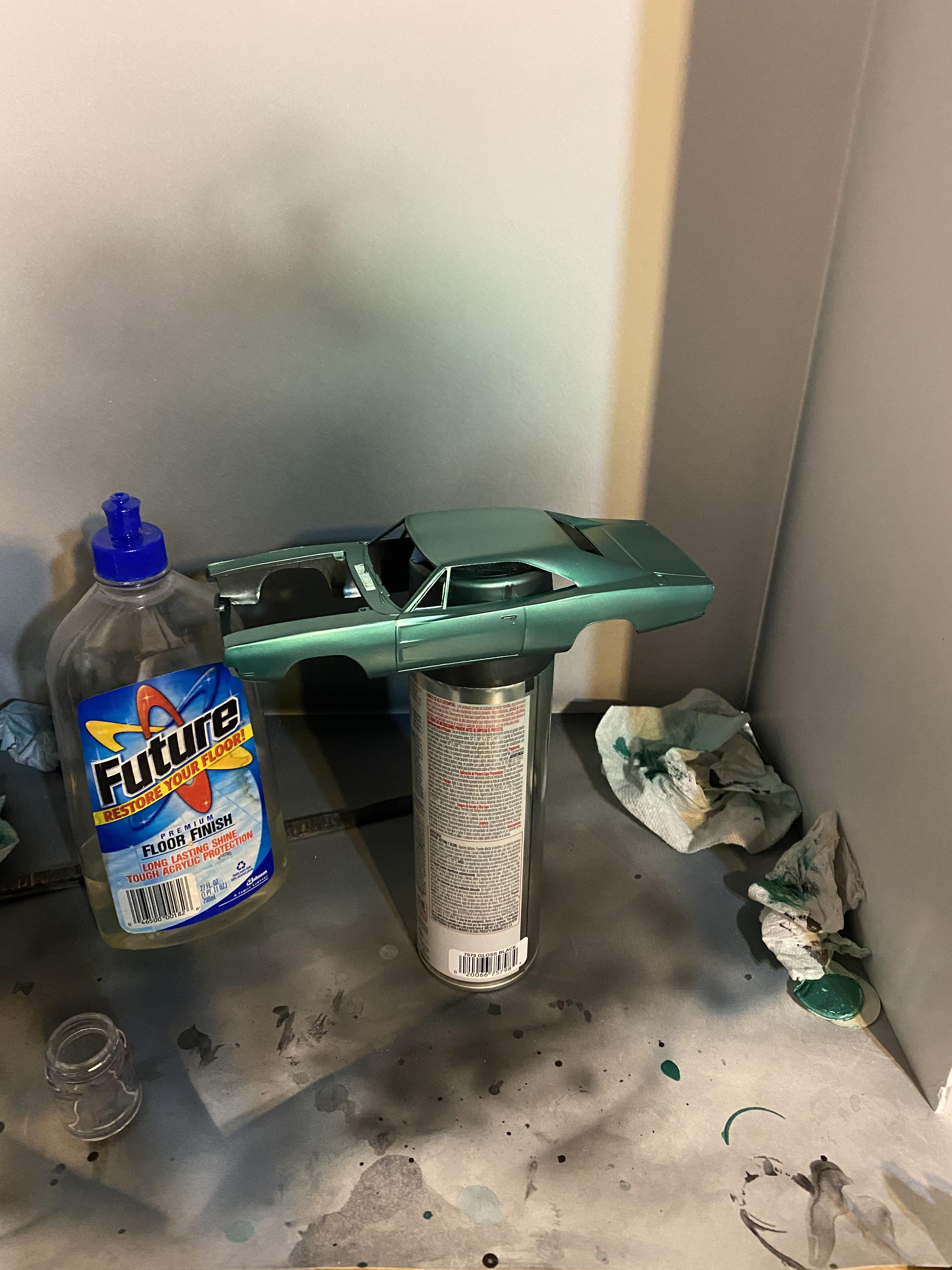

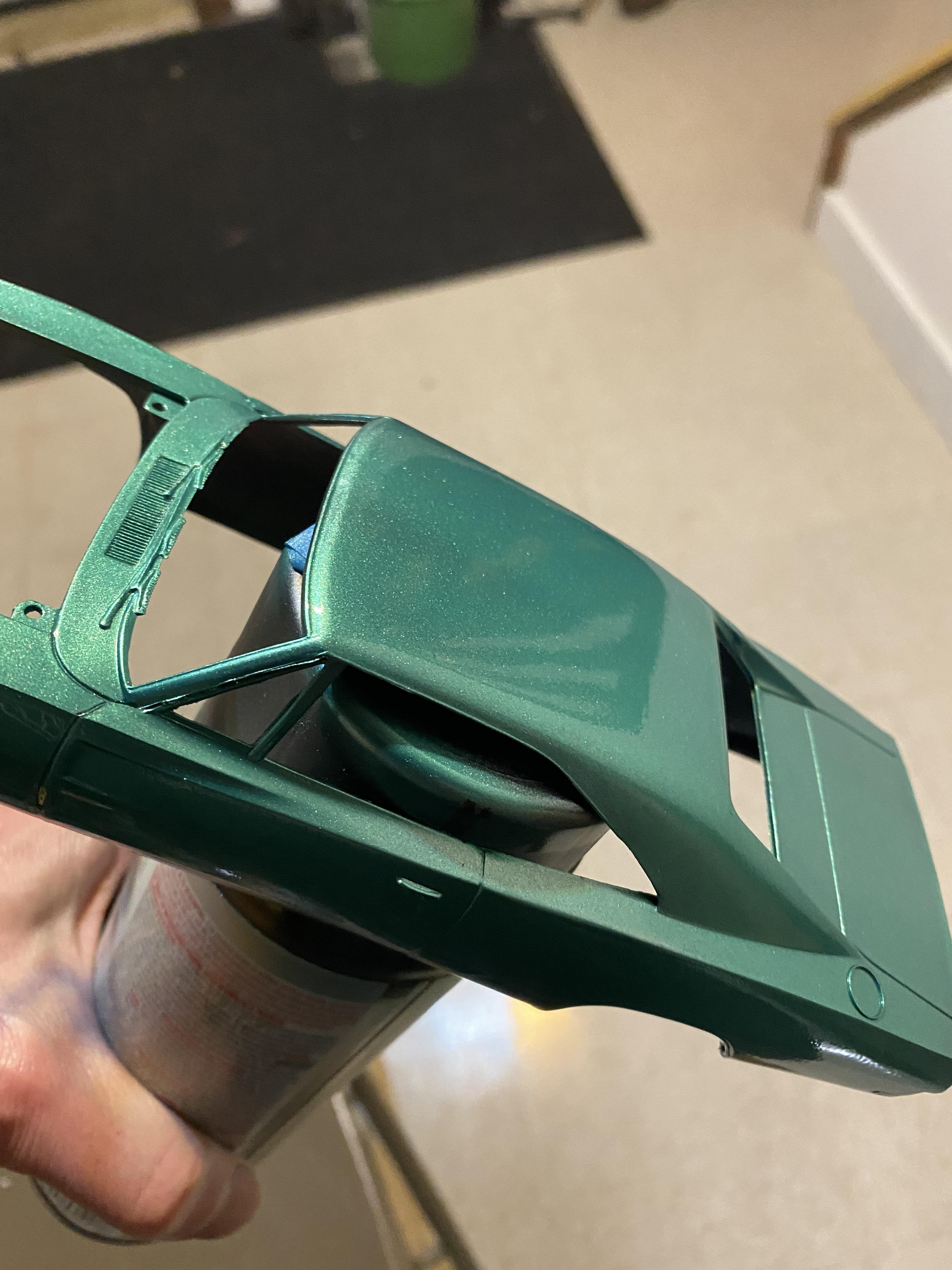

  16. OK. I'm waiting for parts to come in to finish up the '66 Mustang, so I started on the '69 Country Charger This body is pretty bad. Lots of seems to sand out and the fenders are kinda wavy! I wet sanded the the body with 600 grit auto sandpaper to get the seems out and try to straighte the fenders a bit. Here is the paint I bought from Hobby Lobby I mixed it with regular windshield washer fluid and sprayed a light mist coat Then just misted on a couple more coats Third coat- finally starting to cover final coat sprayed pretty wet I dried each coat with a hairdryer until it was dry to the touch. Tthen I started spraying the Future Frst couple coats of Future misted on to act as a tack coat Final and wet coat of Future Here it is dry to the touch but not cured. Total spray time including drying between coats was about 25 minutes. then let sit 15 minutes before I sprayed the Future. I'll let this sit for a few days and wax it. I'll post some more pics I'l also address the flash I missed on the right front fender What do you guys/girls think of this color? I'm going to build this as a regular muscle car.
