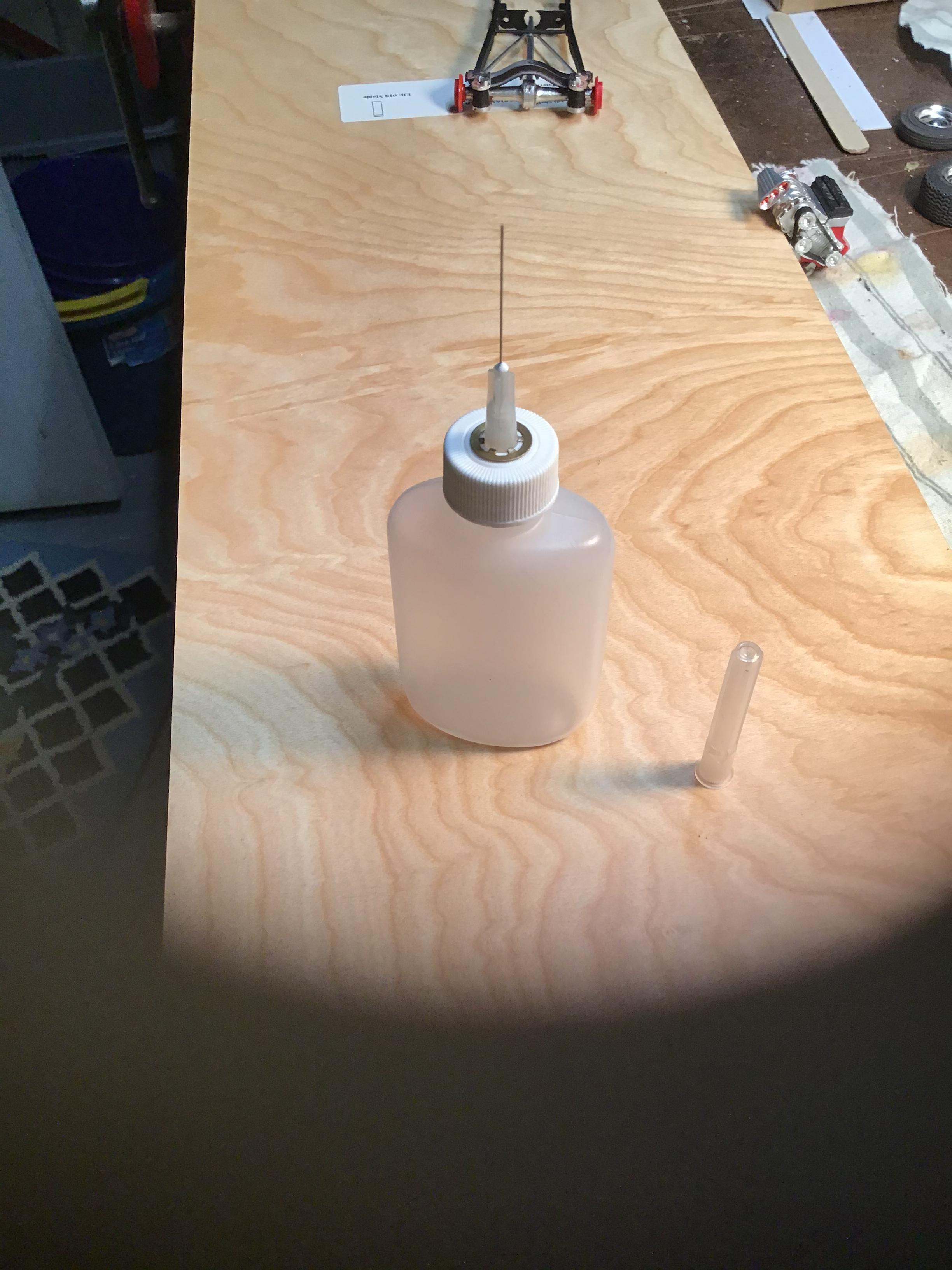

I didn’t say it would eliminate the use of CA, I said it would eliminate it’s use for many aspects. I was answering Rodents dilemma of using CA. I use Tamiya solvent or MEK and can position my part and run a bead of it without making a mess or glue my fingers together. I’ve had your problem with larger needles. If you use a smaller aperture needle (.007), you can squeeze the bottle slightly, turn it upside down and the suction of the tube will retain the liquid. This Very controllable.
That would be a problem LOL, but being able to control the flow of glue would eliminate the need for CA in many aspects.
The best way in my humble opinion is to pour some Tamiya extra thin cement into a precision needle-tip squeeze bottle. These bottles use stainless steel luer lock needles that control the flow of the solvent without getting it all over the place. I prefer the oval shape bottle so it won’t roll off the workbench and a .007 I’d. Aperture. The bottle can be purchased through McMaster Carr for $5.00. and needles can be purchased for $4.00.
