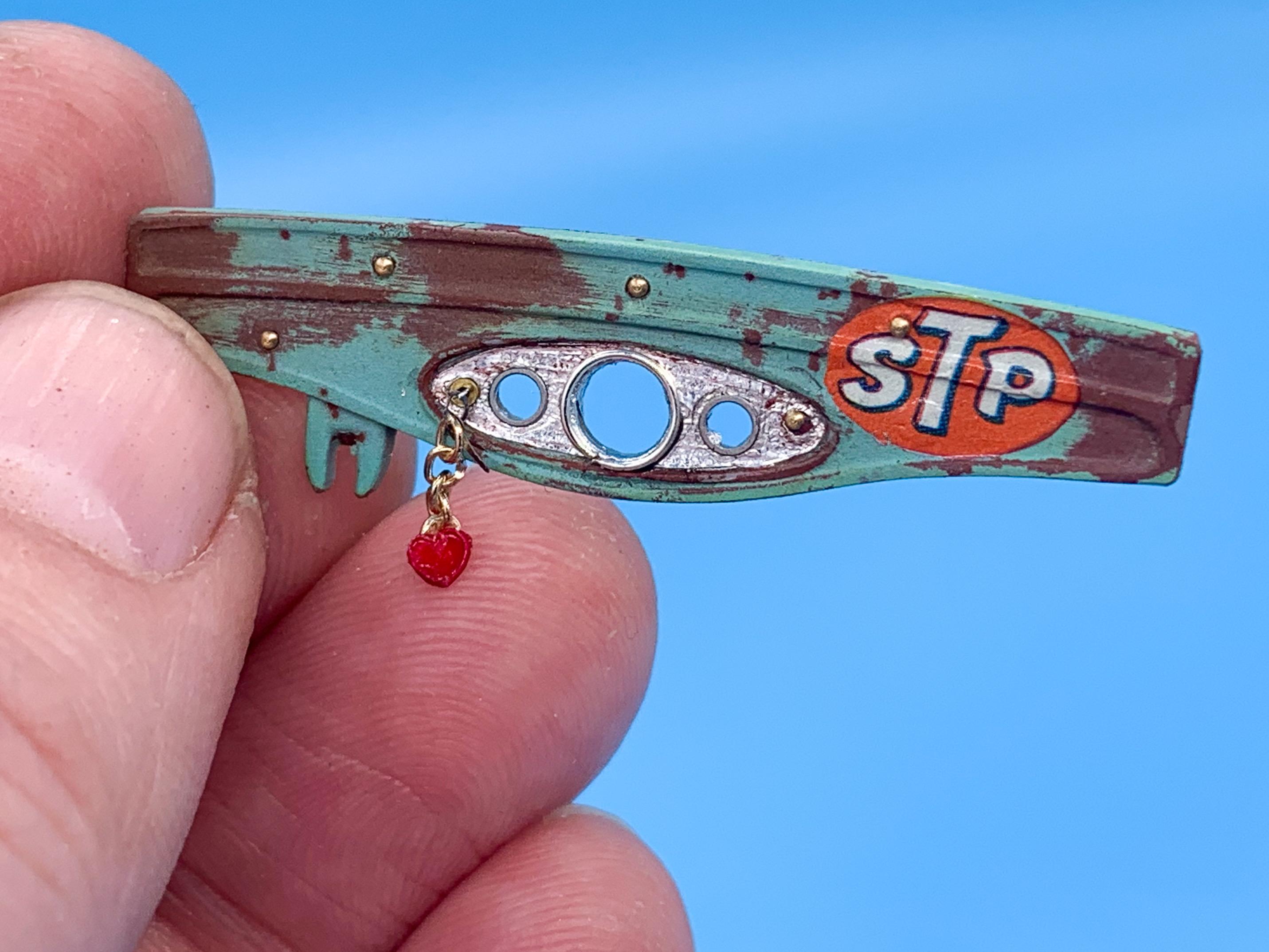

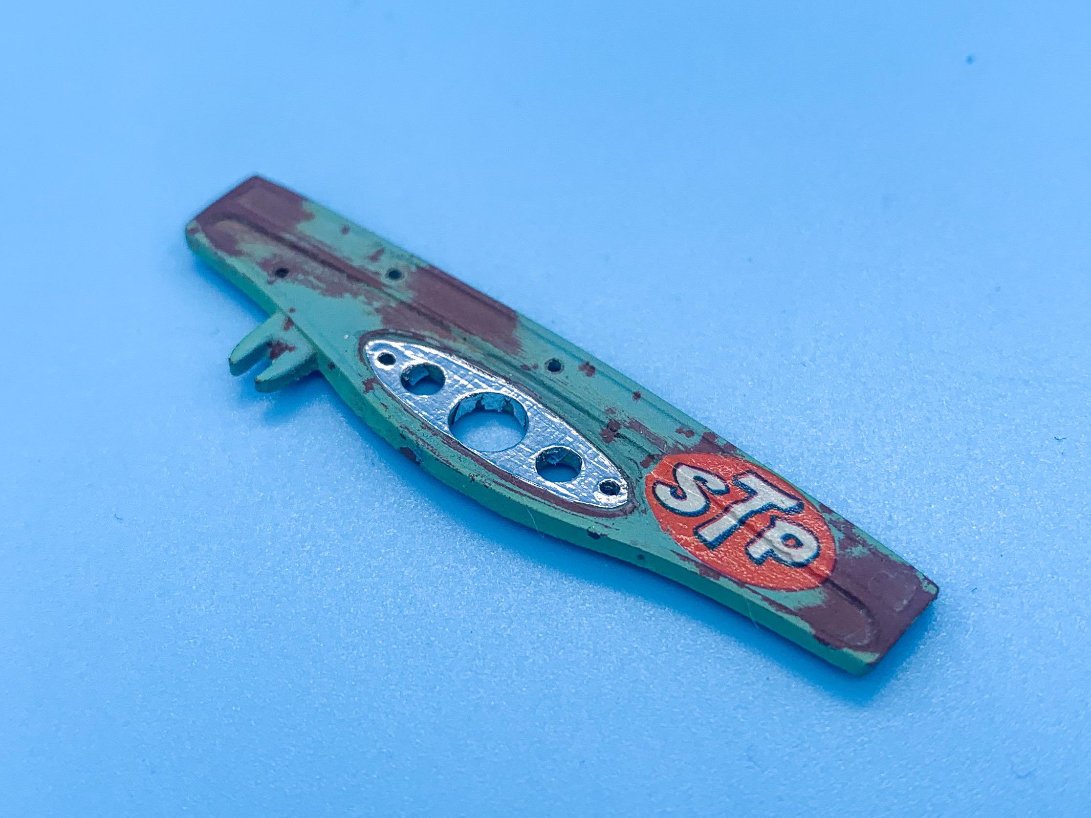

  6. Thanks Steve! I definitely recommend it for a change of pace compared to painting stuff shiny! It’s fun! Thank you!! ❤️ Yes sir - although you could do this with rattle cans too, and plenty of people do it better than me without an airbrush. A lot of the gradients and subtle color changes on this one actually come from cheap artist’s pastels ground up and brushed on rather than the airbrush achieving the same thing, so it’s definitely doable with just rattle cans, yeah! Not a dumb question at all! I just use water - brush it onto the spots where I want the ‘rust’ to show through and sprinkle salt on top! Once it’s dried the crusty salt makes the mask and you’re all set! I’ll typically move the wet salt around with a brush a little to get it to ‘clump’ exactly where I want it to, but nothing fancier than that. Taking a break from the bench - had a solid 4 hours of messing with the dash today ??. Drilled out the moulded-in switches and rivets, primed and then shot with Createx brown: Again, add salt, and shot with a variation of the light blue that I used already on the body: Remove salt: Add a decal, because why not, and some BMF for the gauge cluster: And then I finished it off with some brass rivets, metal rings around the gauges and a little keychain with a NYC tourist “I ❤️ NY” heart shaped keychain and a photoetched key: Hardest part was that stupid keychain - took forever to loop the keys onto the chain ??? A fun little detail tho! More soon, soon as my eyes recover ??

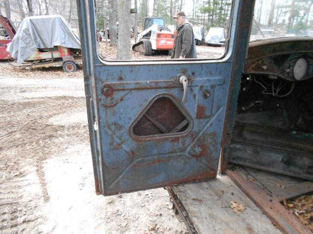

  19. I love it on those Boyd rims! I didn’t know that there were any kits with Boyd wheels aside from the couple of Testors kits...and those few AMT American Hot Rod branded kits with the ENORMOUS 24”s in, or whatever they were. Not sure Boyd had much to do with the look of the wheels in those kits anyway, they weren’t my favorite design Anyhoo, looking great buddy! Enjoying watching this one come together!!
