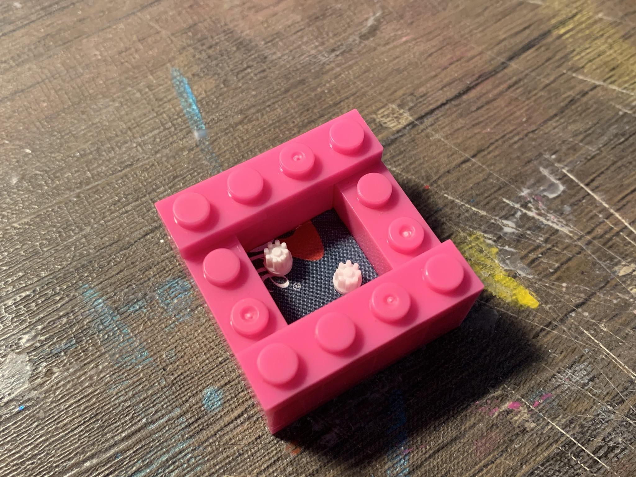

  6. I agree! NONE of our valuables are going with our movers...including my kit collection ??

  9. That’s a GREAT tip! I would’ve thought the resin would plug up the wire...but I guess it doesn’t huh? Cool! Thanks buddy! Will try this tomorrow!

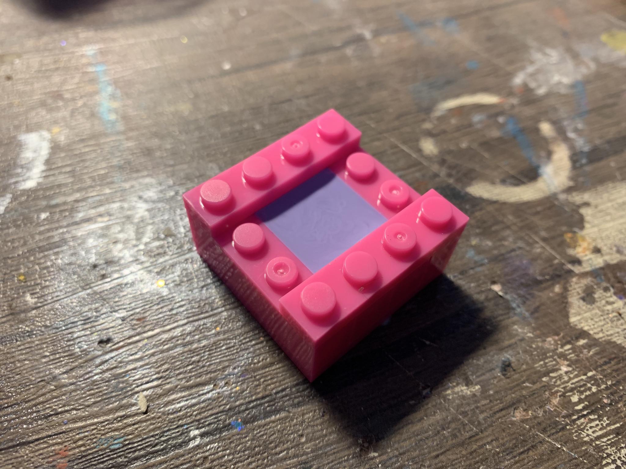

  10. Nice Scratchbuilding Steve! Did some resin casting today - needed some distributors that I can drill and wire, and I had a cool old leaf spring that I wanted a copy of so I could still build the kit it came from...and cast a couple of other bits whilst I was at it. I’m no good at resin casting, but I like magically making the liquid in the bottles into model parts! ??‍♂️
