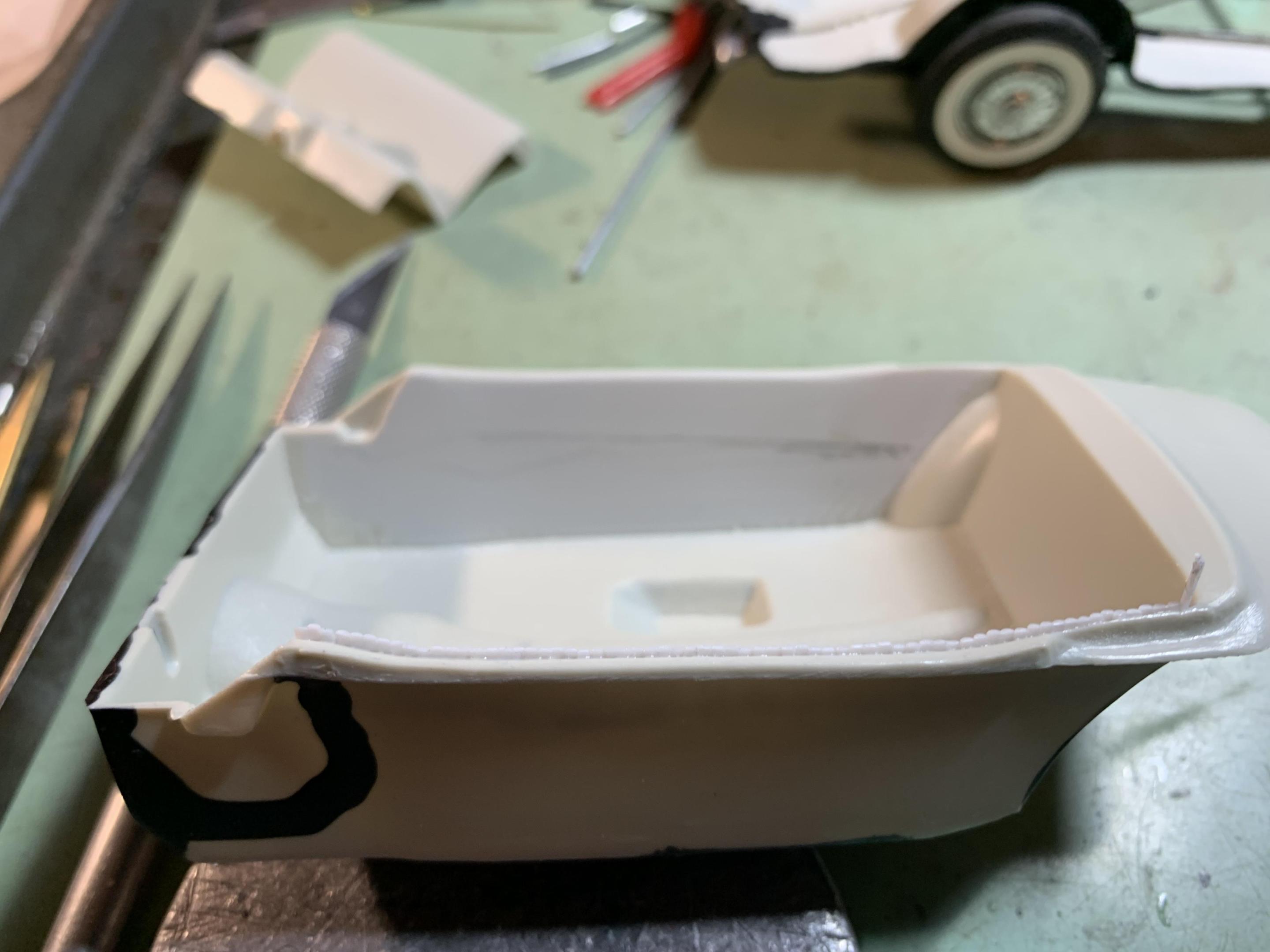

While I am waiting for it warm up enough to primer another project, I decided to start a project I have had in mind for quite awhile. A couple of inspiration photos included. I started by roughing in the various cuts, then wrote down the best order to proceed. Today I got out the saws and removed approximately 3 scale inches from the hood and body. My goal was to keep as much of the body attached before finishing the cuts. The pix show the hood sectioned and glued together and the body pieces set in place. Final sanding will prepare the body for gluing. Next will be the top chop- debating whether to lay the windshield back or keep the same angle. I plan on using the Columbia two speed rear axle, since I want to display this model towing a tear drop trailer.

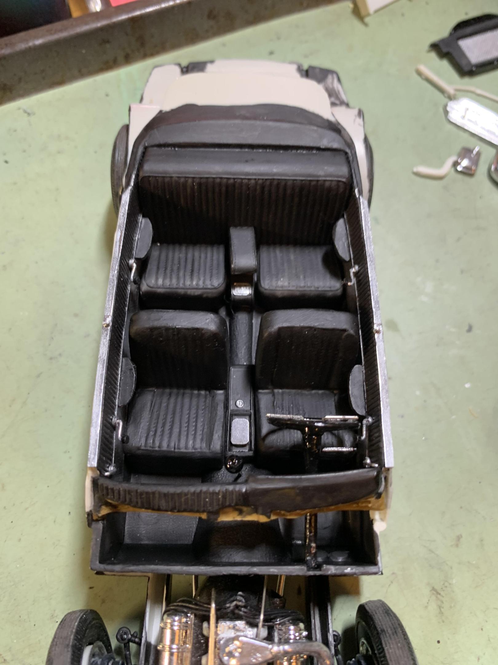

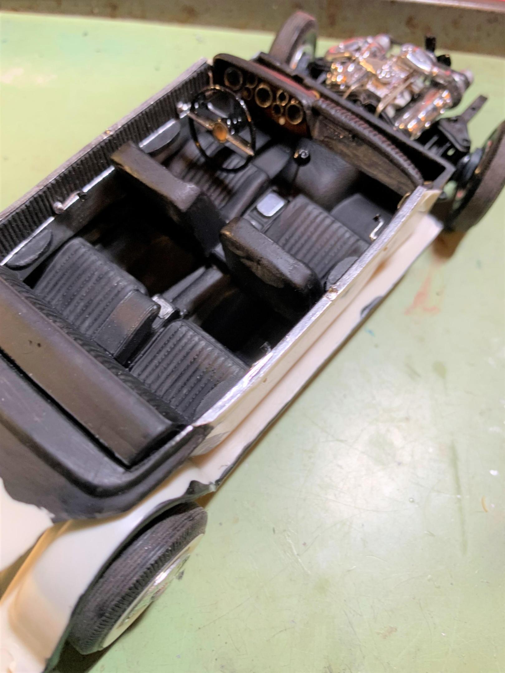

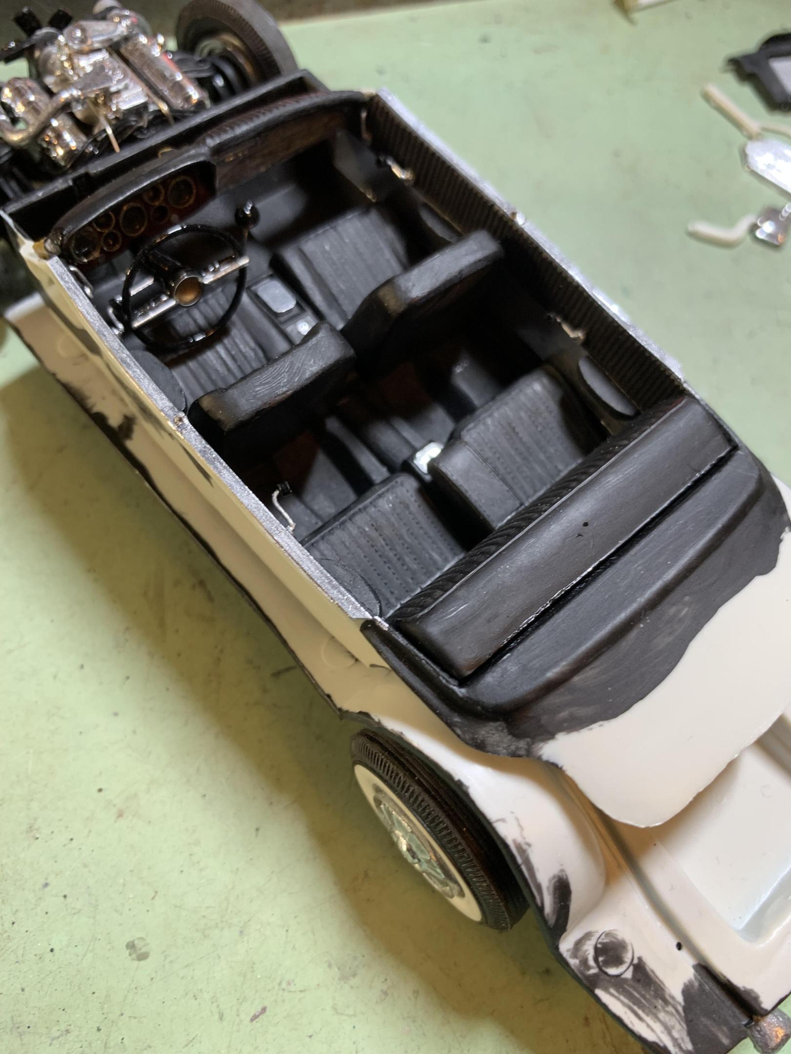

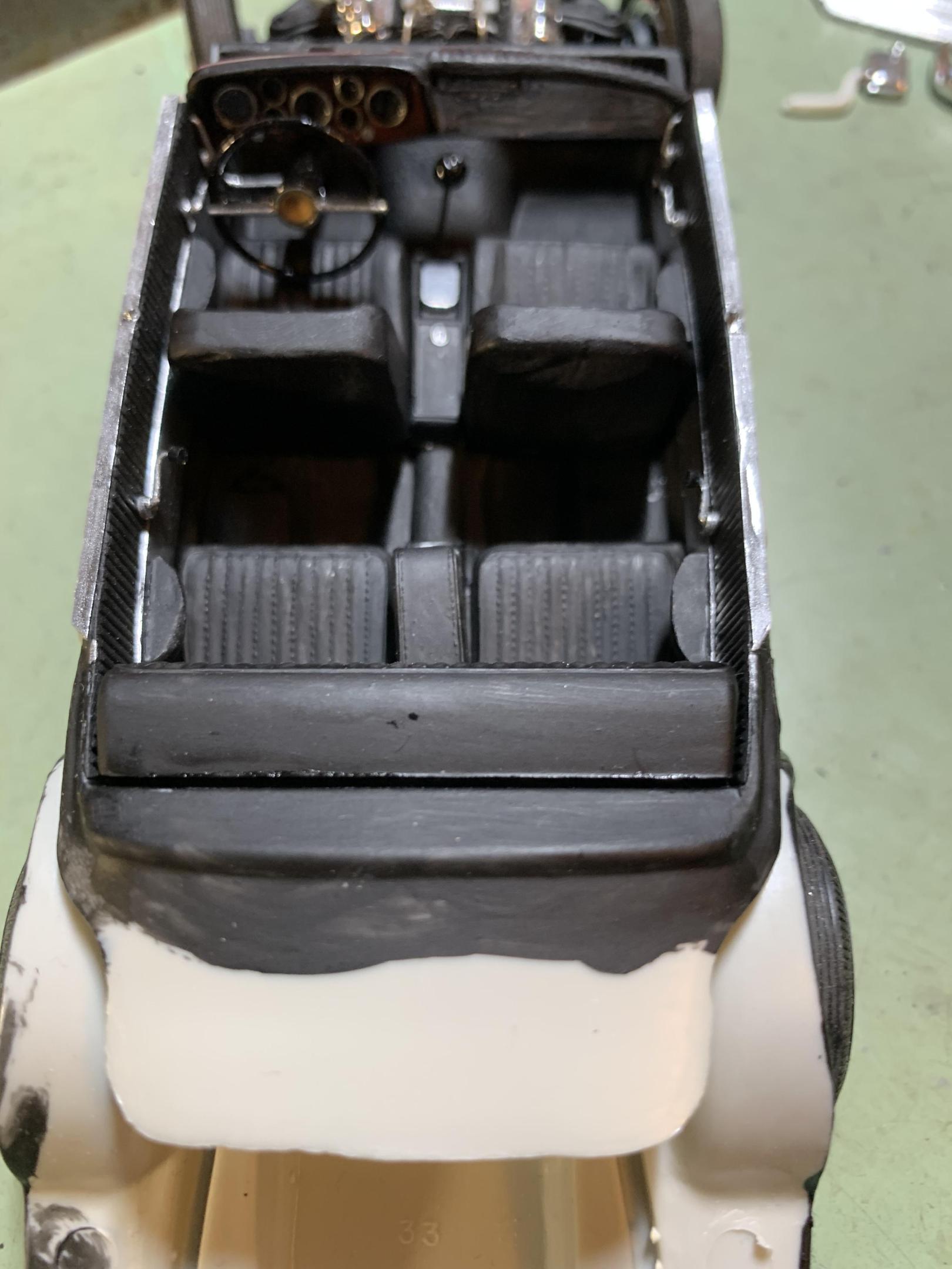

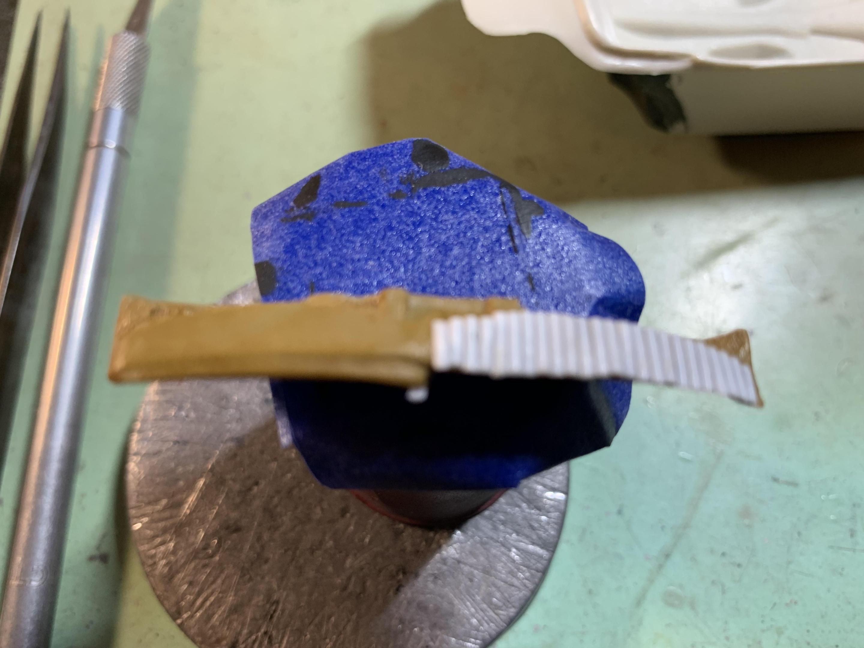

Interior is finished! Door handles and window cranks made from wire and slices of styrene rod, arm rests made from 1/8" quarter round styrene, more work on the seats for a proper fit. Added door locks and a groove on top trim to simulate the door division.

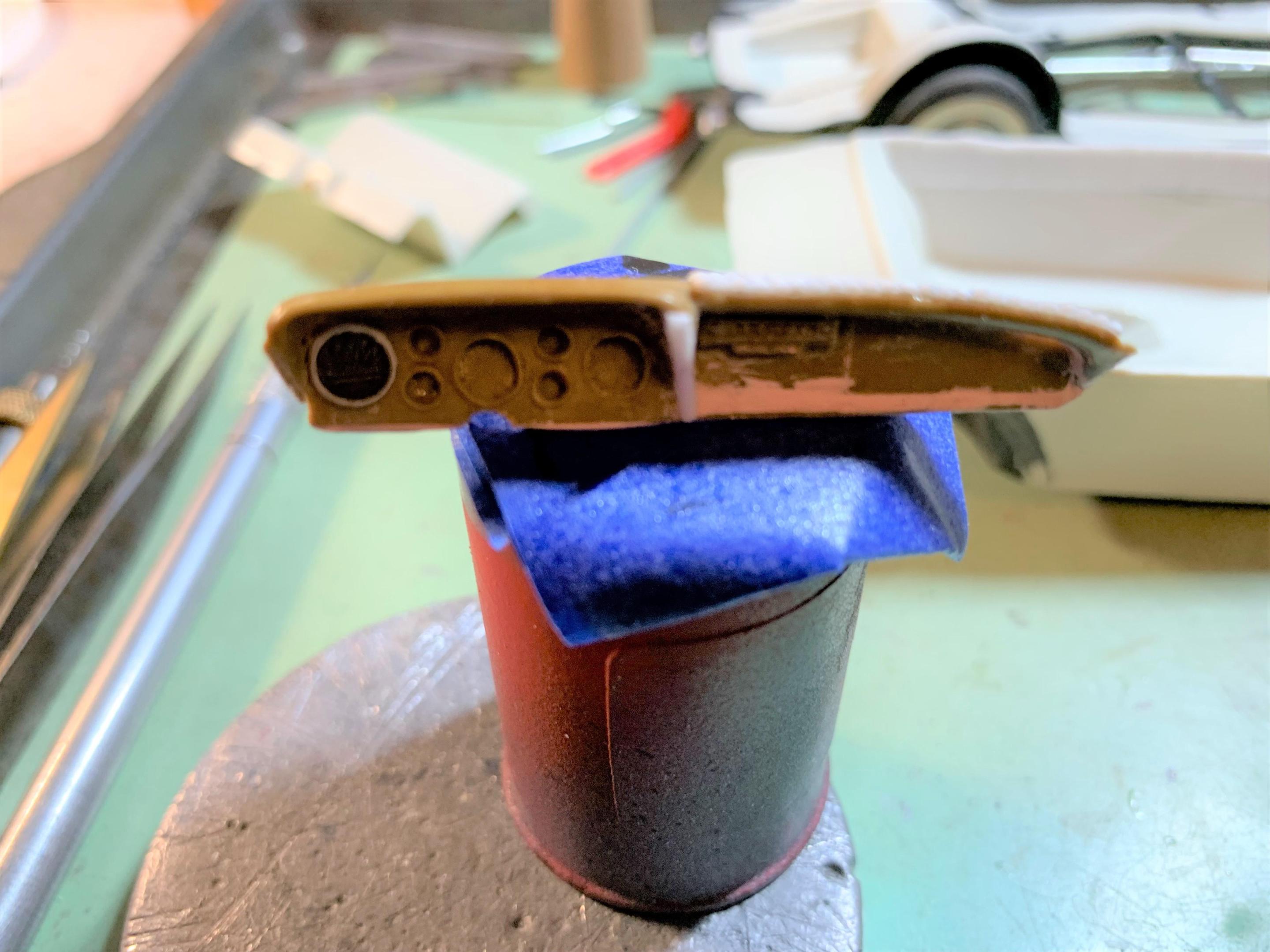

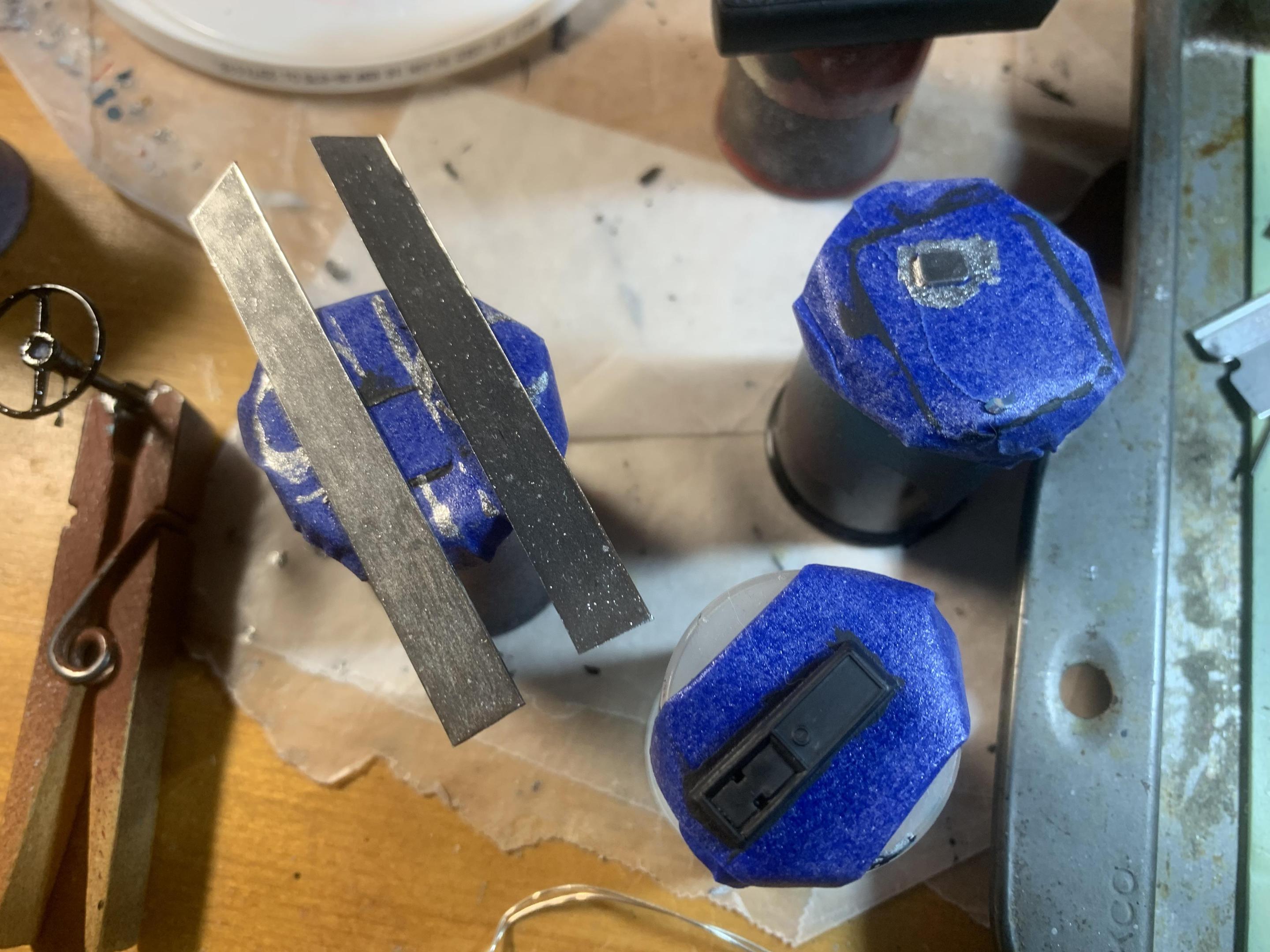

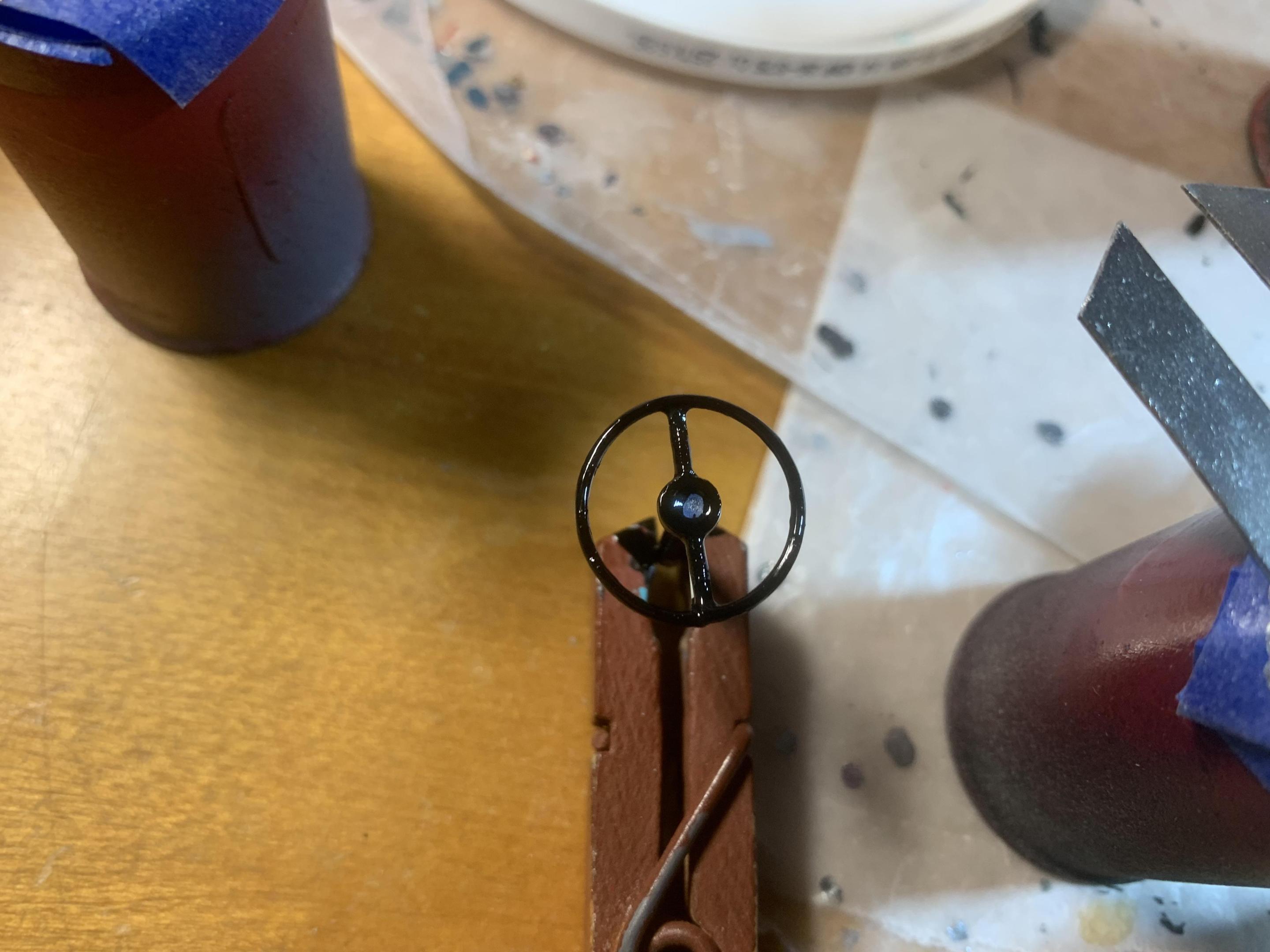

Been working on interior stuff. Dashboard is completed. Steering wheel is in process. Chrome panels are completed. Paint on the rear seats and center console- created an ash tray for the console. Started the first arm rest from quarter round stock- 4 altogether. Second bucket seat still ongoing. Next big project is creating door handles and 4 window cranks from silver wire and slices of rod stock.

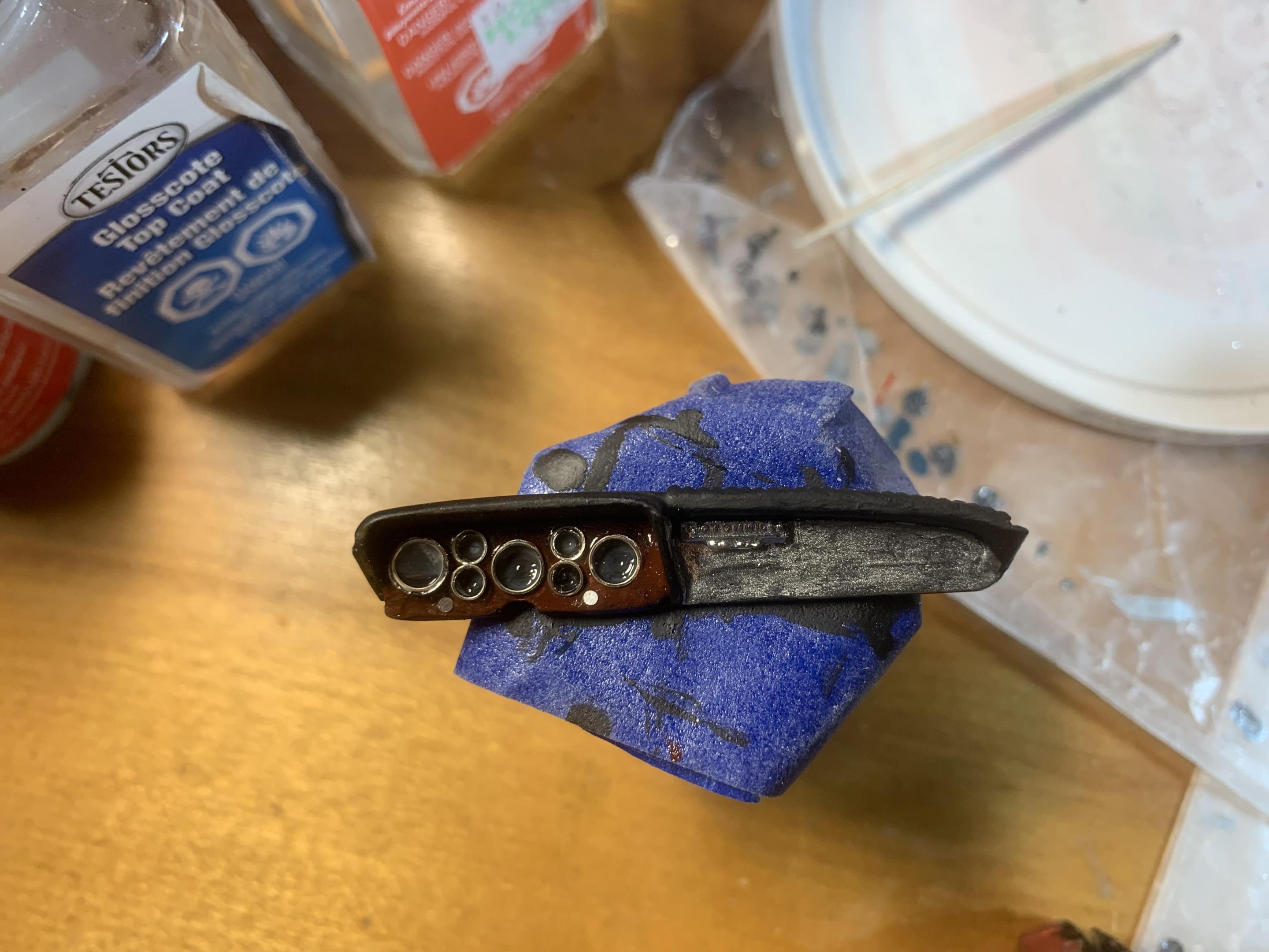

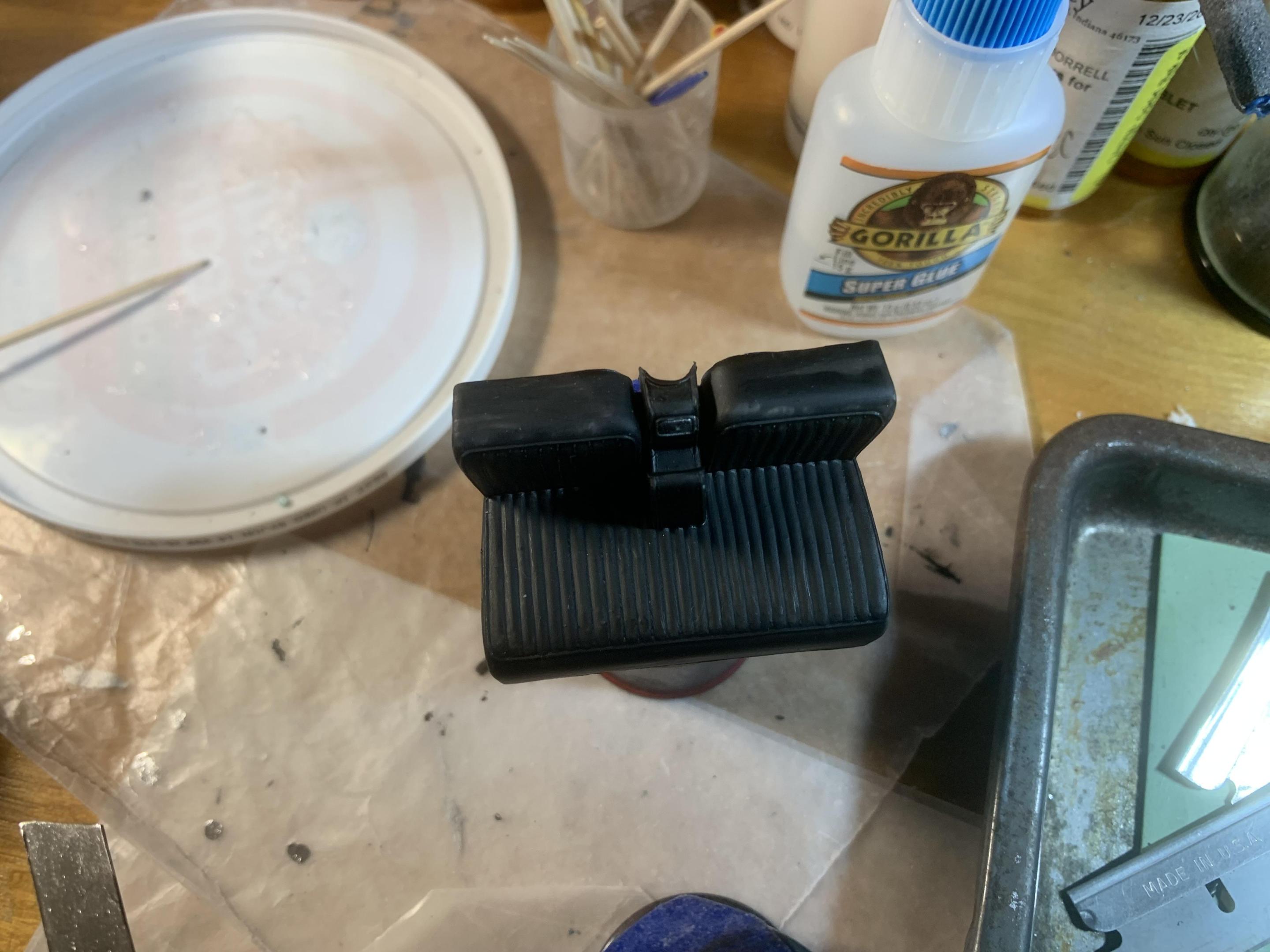

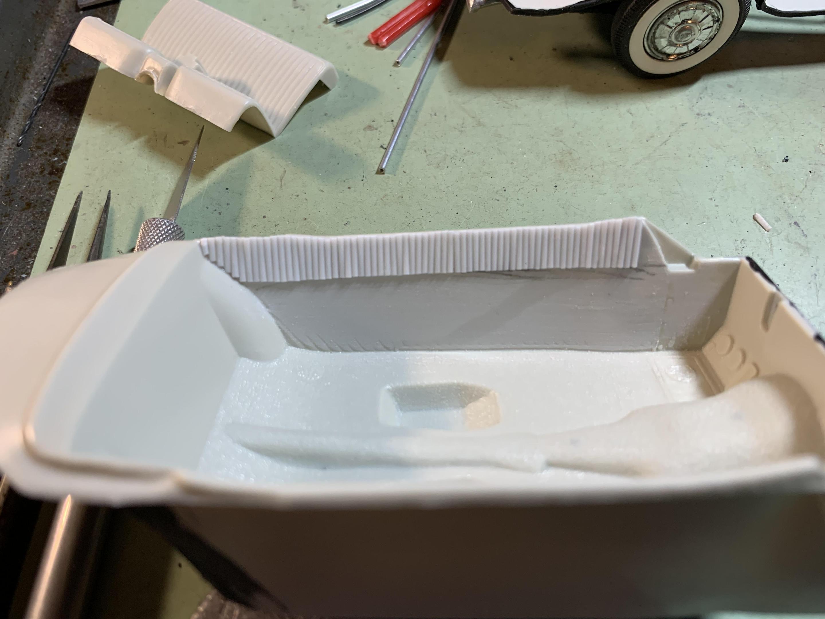

Getting more done- bit by bit! Inside sides have been sanded down and thinned. The vertical tuck and rolls are 0.040" half round and each piece was glued in place using liquid styrene cement-NOT a one day job, and that's only one side! The tuck and roll on the passenger side of the dash was also installed piece by piece using super glue since styrene cement won't work with styrene and resin. Other areas of the dash were also improved with putty, styrene, and super glue, mainly in the right side of the gauge surround. Everything has to be sanded and sculpted to final shape. An actual 1/4" wide panel will be installed just under the tuck and roll. These will be finished as brushed aluminum and will include the arm rests. The door handles and window cranks will be mounted in the tuck and roll areas. More pix and info when I get more done!
