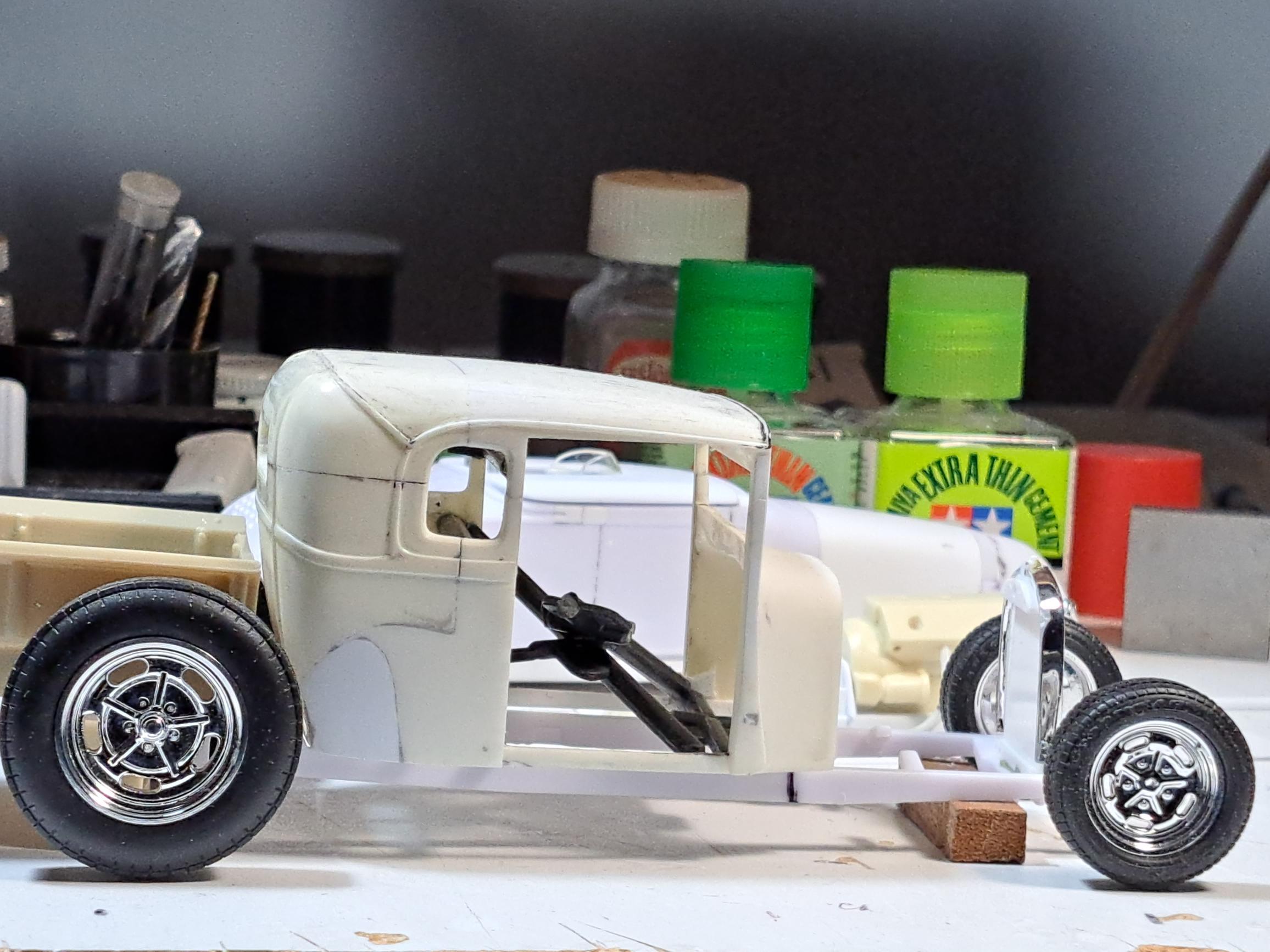

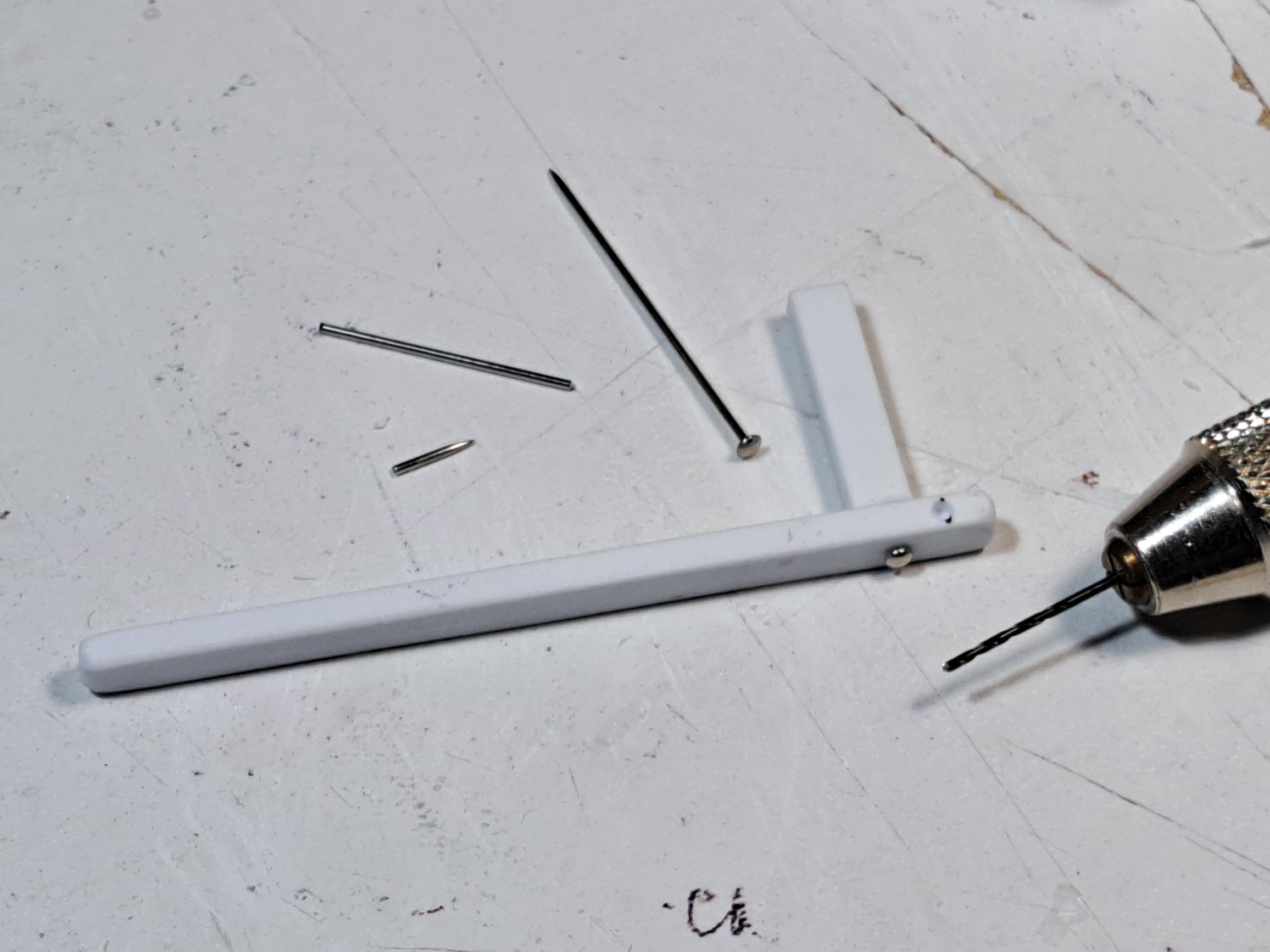

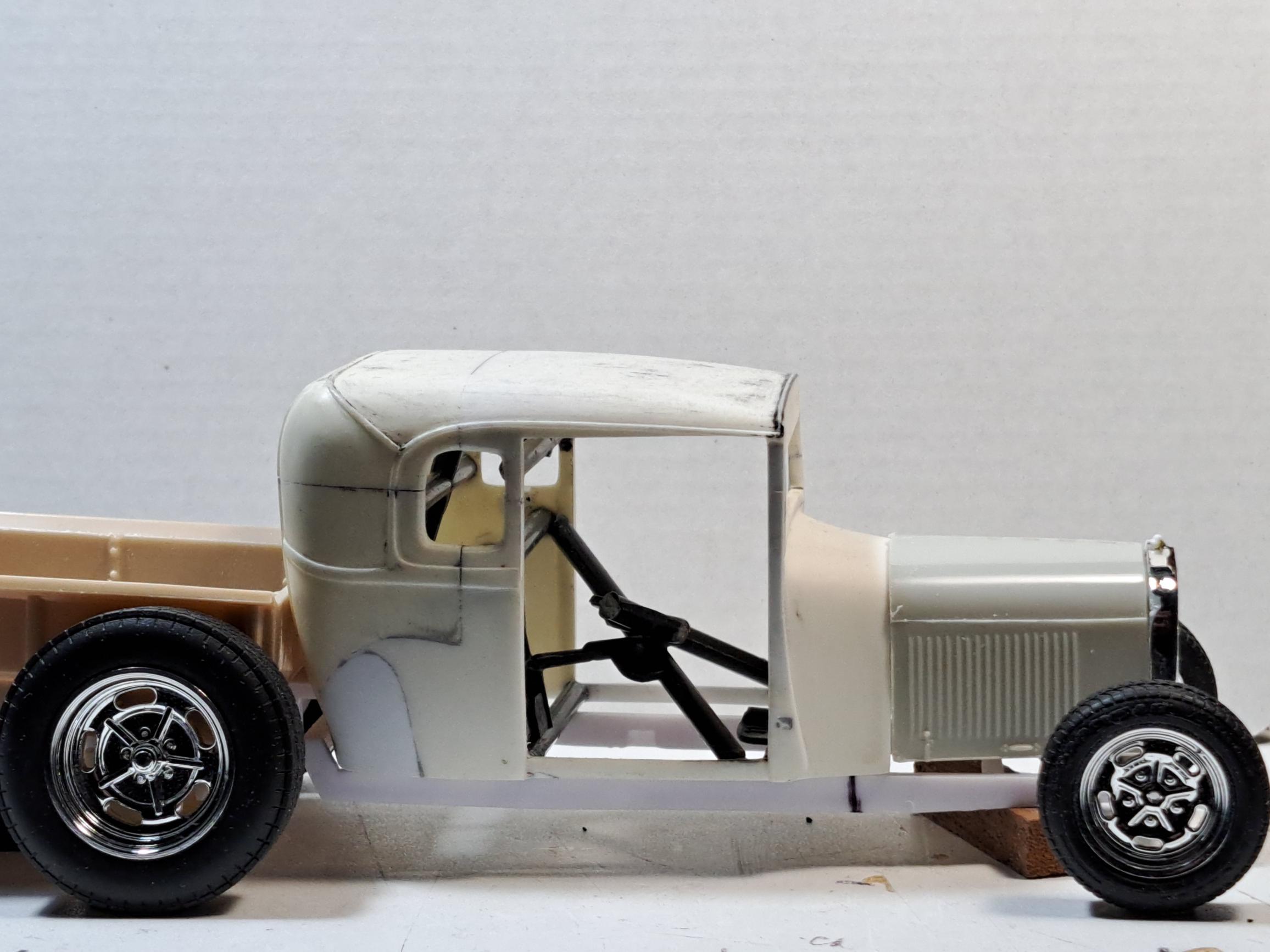

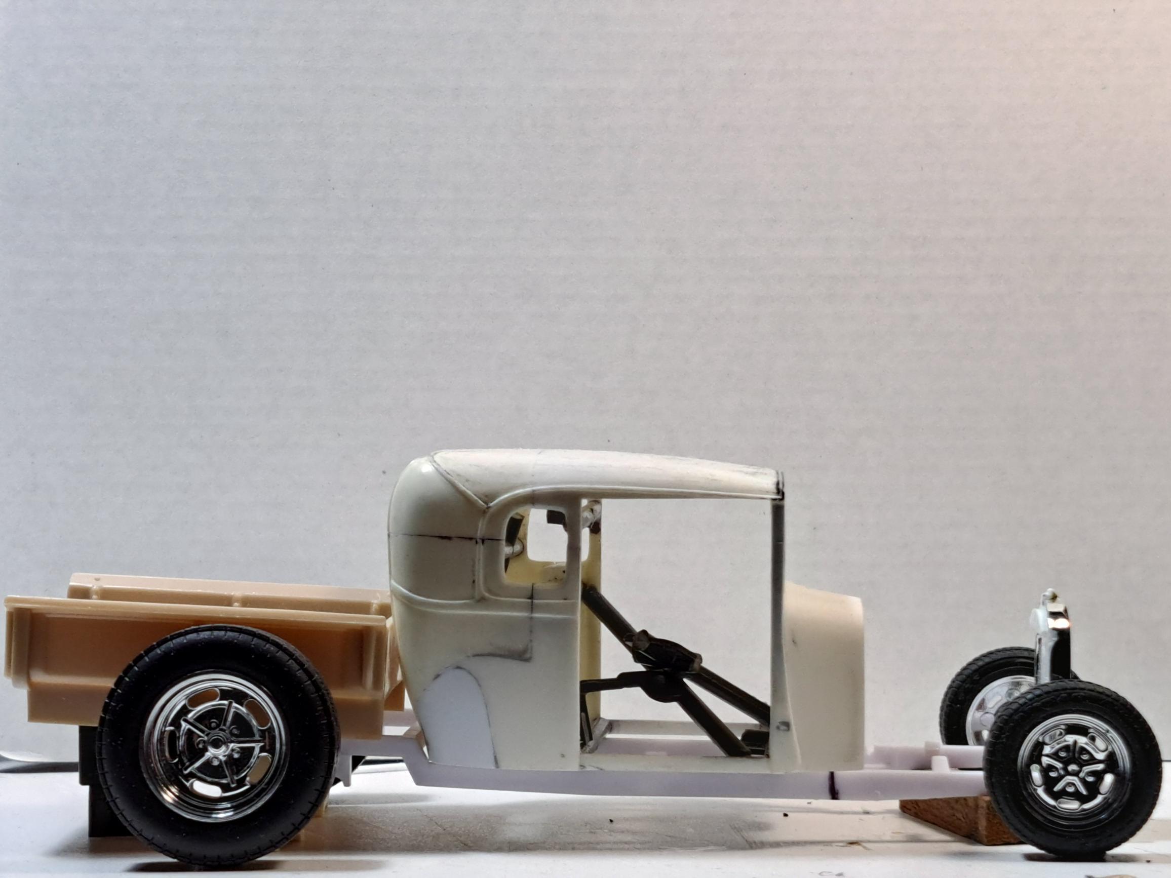

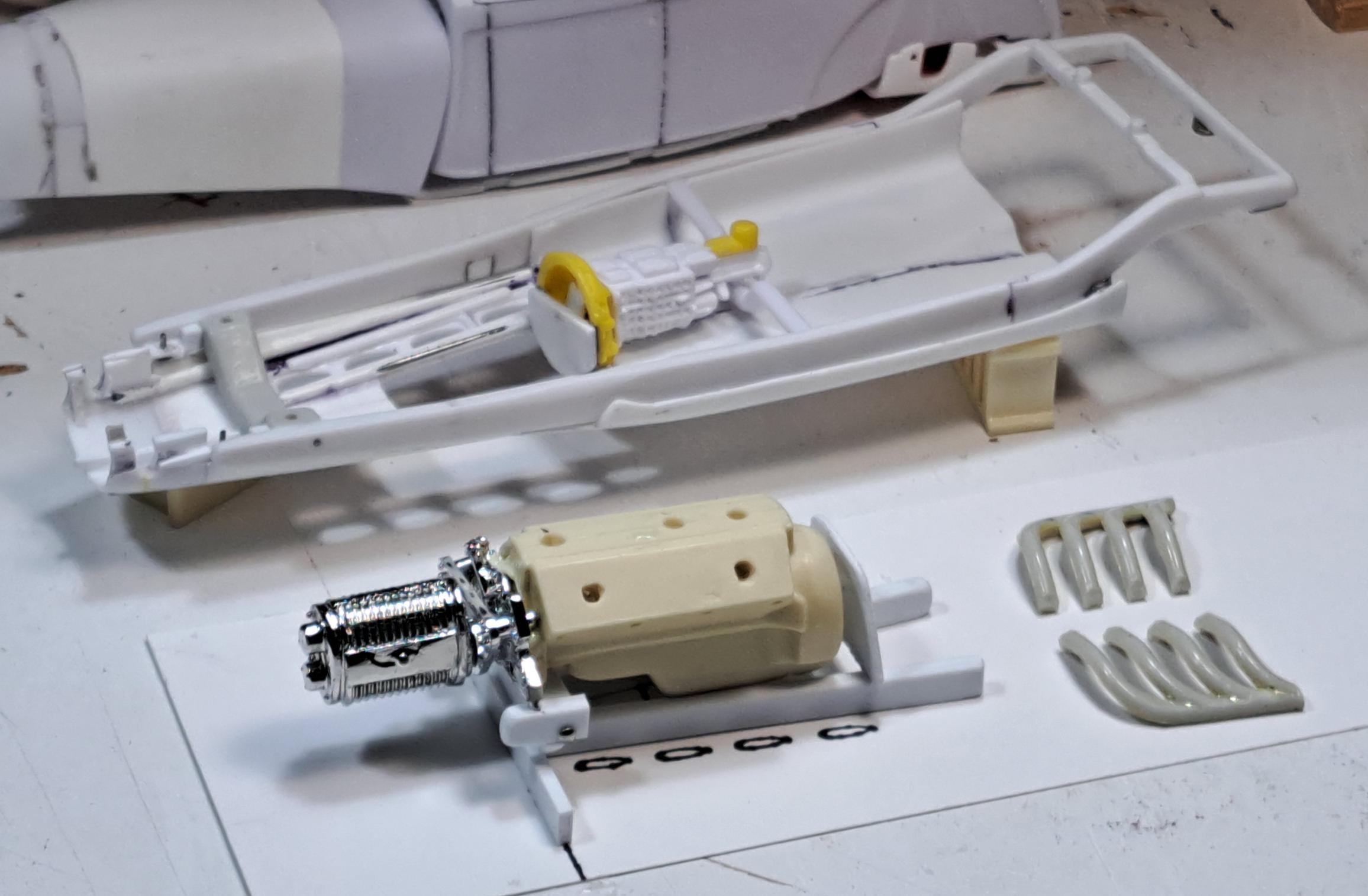

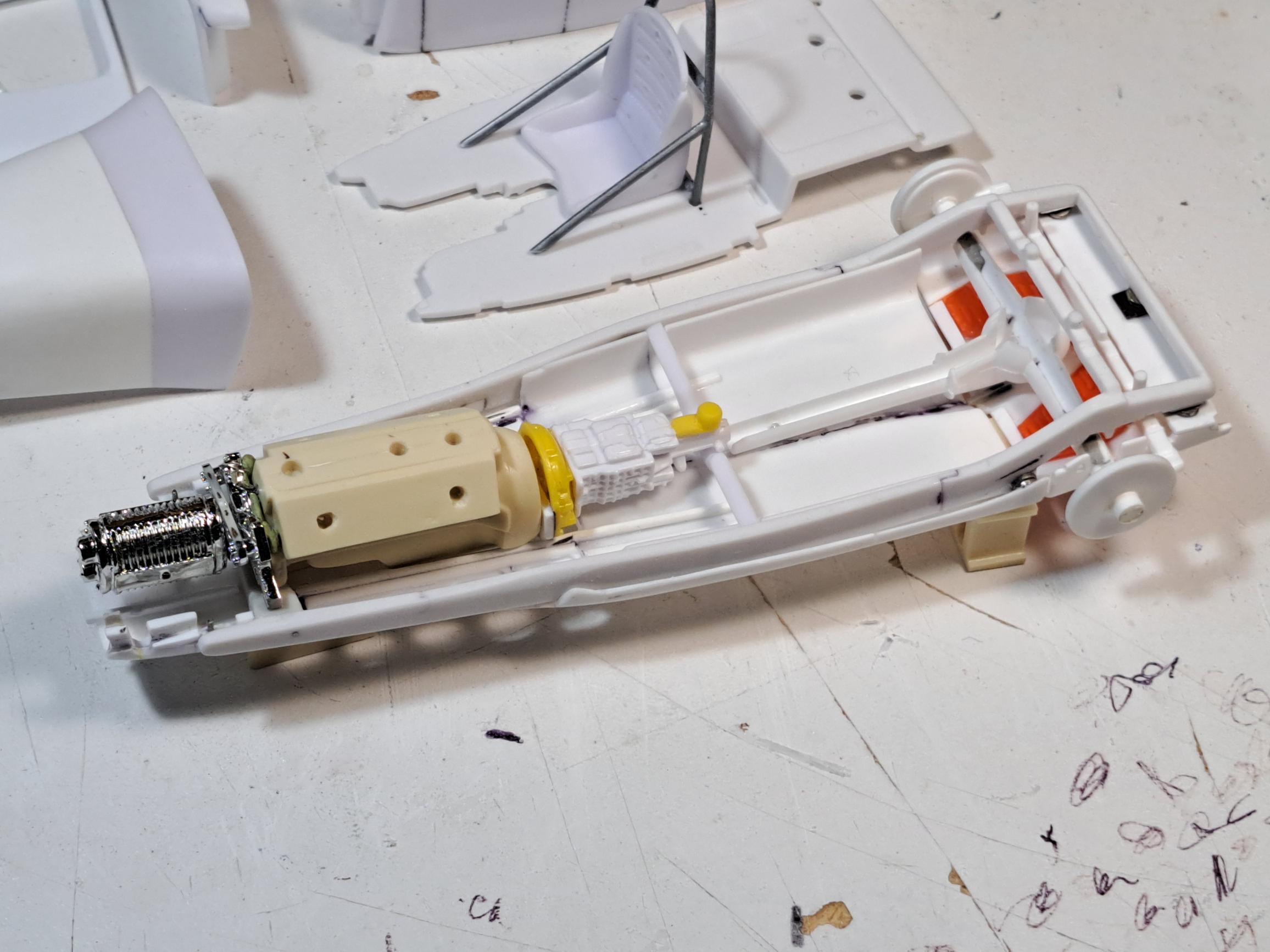

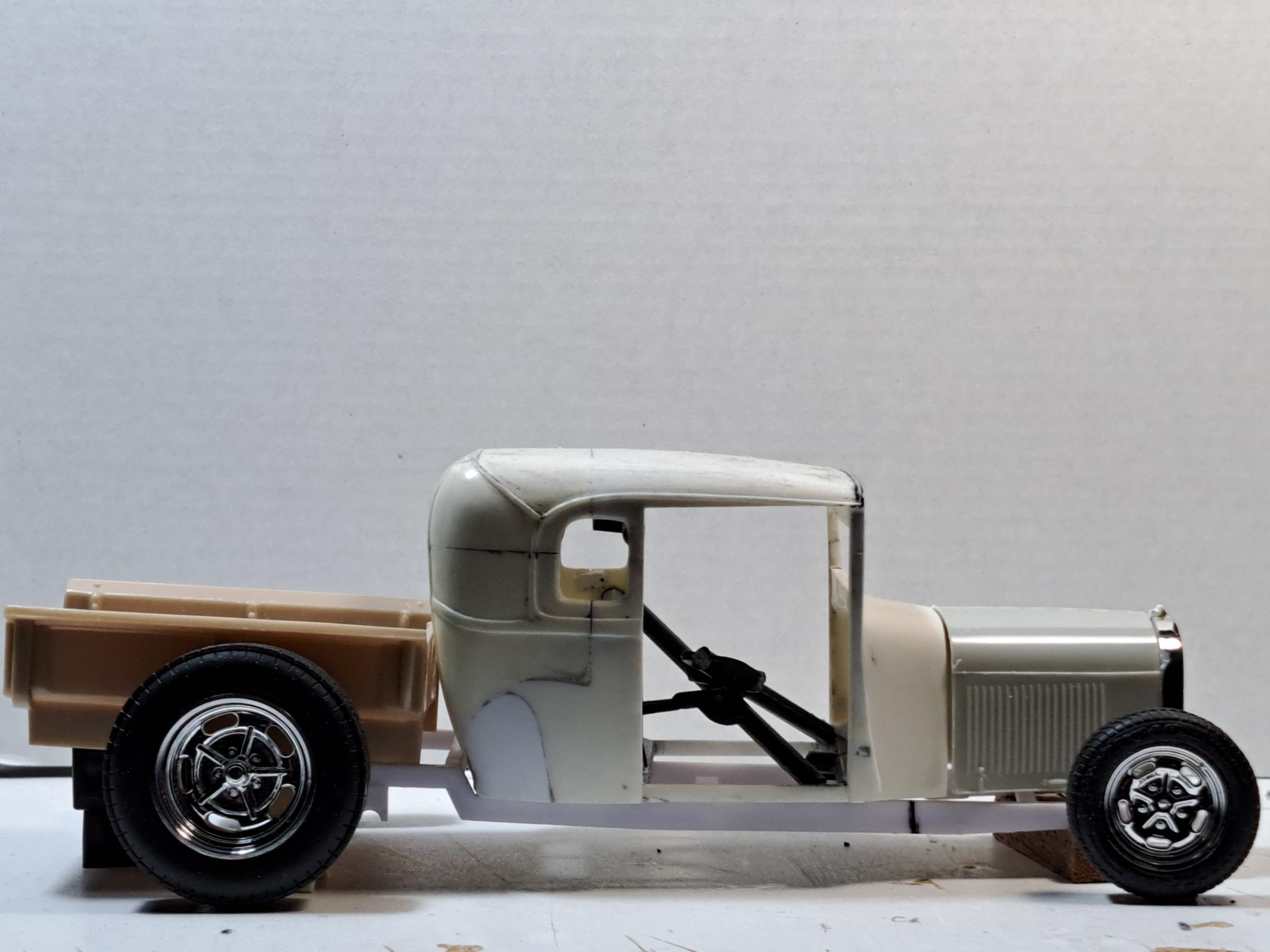

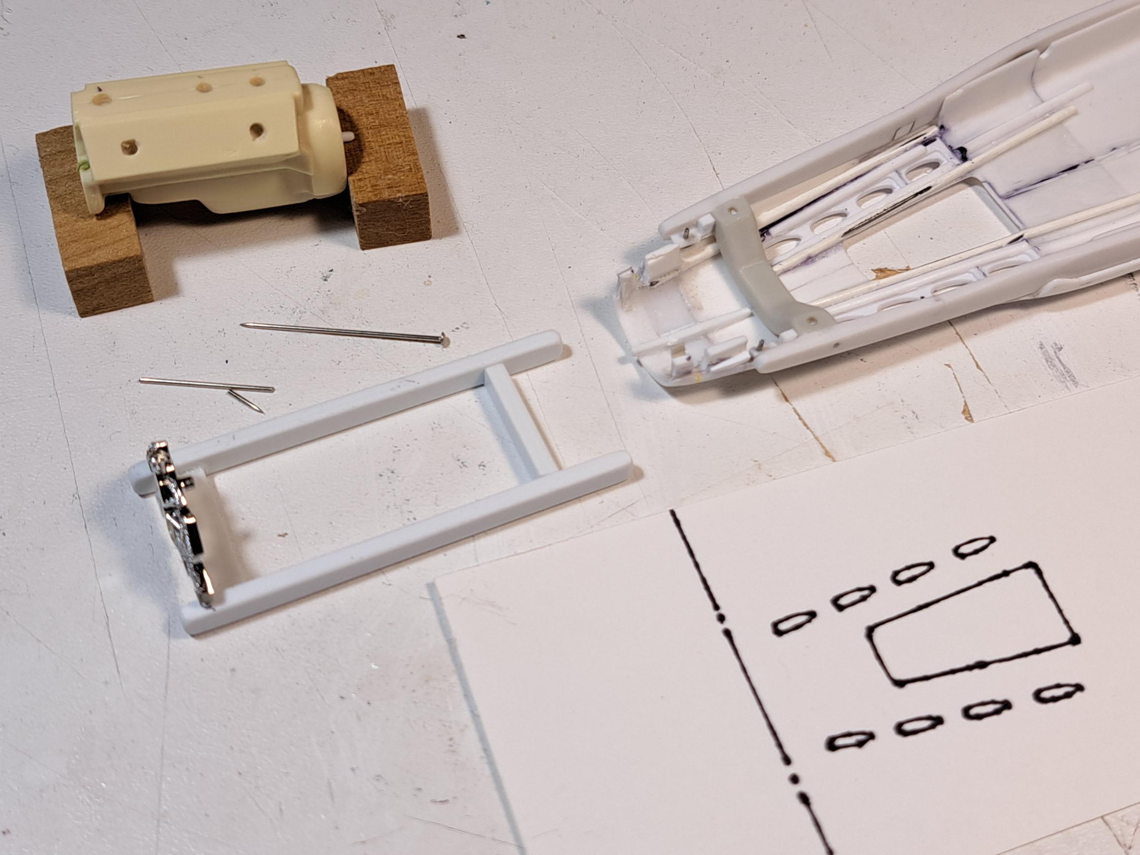

  5. @Speedprojust asked me if I knew what I was doing! Let's see... Adding a second cross member while extending the '29 XPU wheelbase: Step kuts add both alignment and more glue surface over straight seams... Notice anything a bit amiss? Frame addition is a scale 20 inches... Stacking the Z'd section adds another 4 scale inches the length of the '29 XPU... Here's the plan: Drill, Pin, AC & Repeat! Studying the joint before drilling allows one to find the angle of the bit to find the most meat to pin through... Back to pinning the frame extension into place... The predrilled floorboard makes a great gig for joining the extension as a unit... An hour and a half the set the first pin... Ten maybe twelve minutes to set the second pin... Back to stacking the Z's... Predrilling the base makes finishing with a guide/pilot hole... Let's see what the result of measure twice... kut once has to show for itself: Sometimes you just have to let it all hang out!!! -KK

  9. The '29 XPU needed to have the bottom edge evened up all the way around... Rough kut... -KK

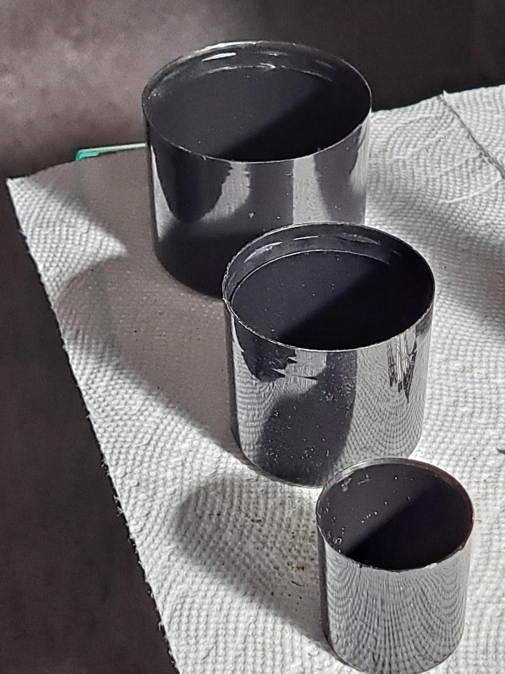

  12. Hair Spray Caps Oh! And old 35mm film cans, too! -KK

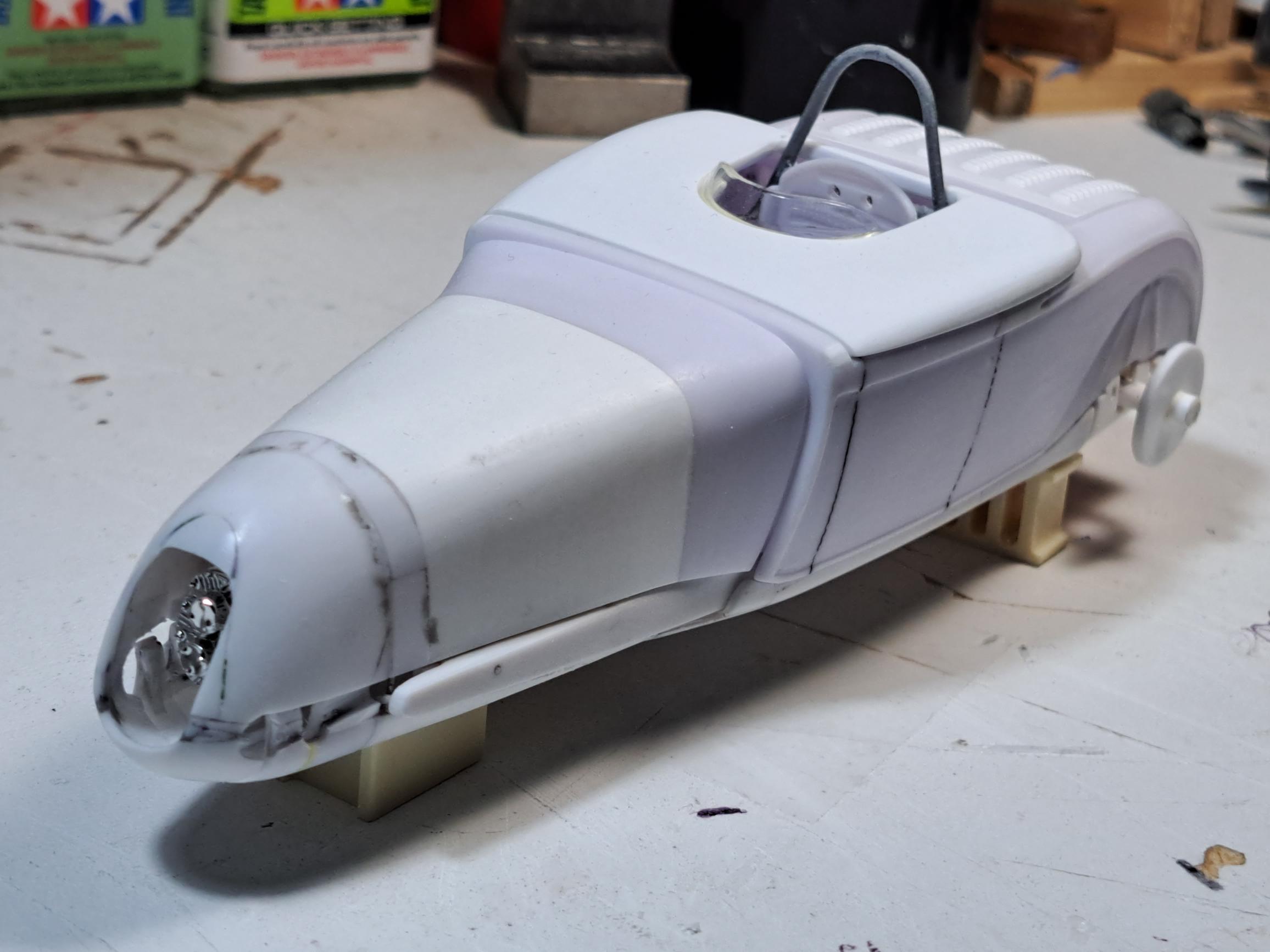

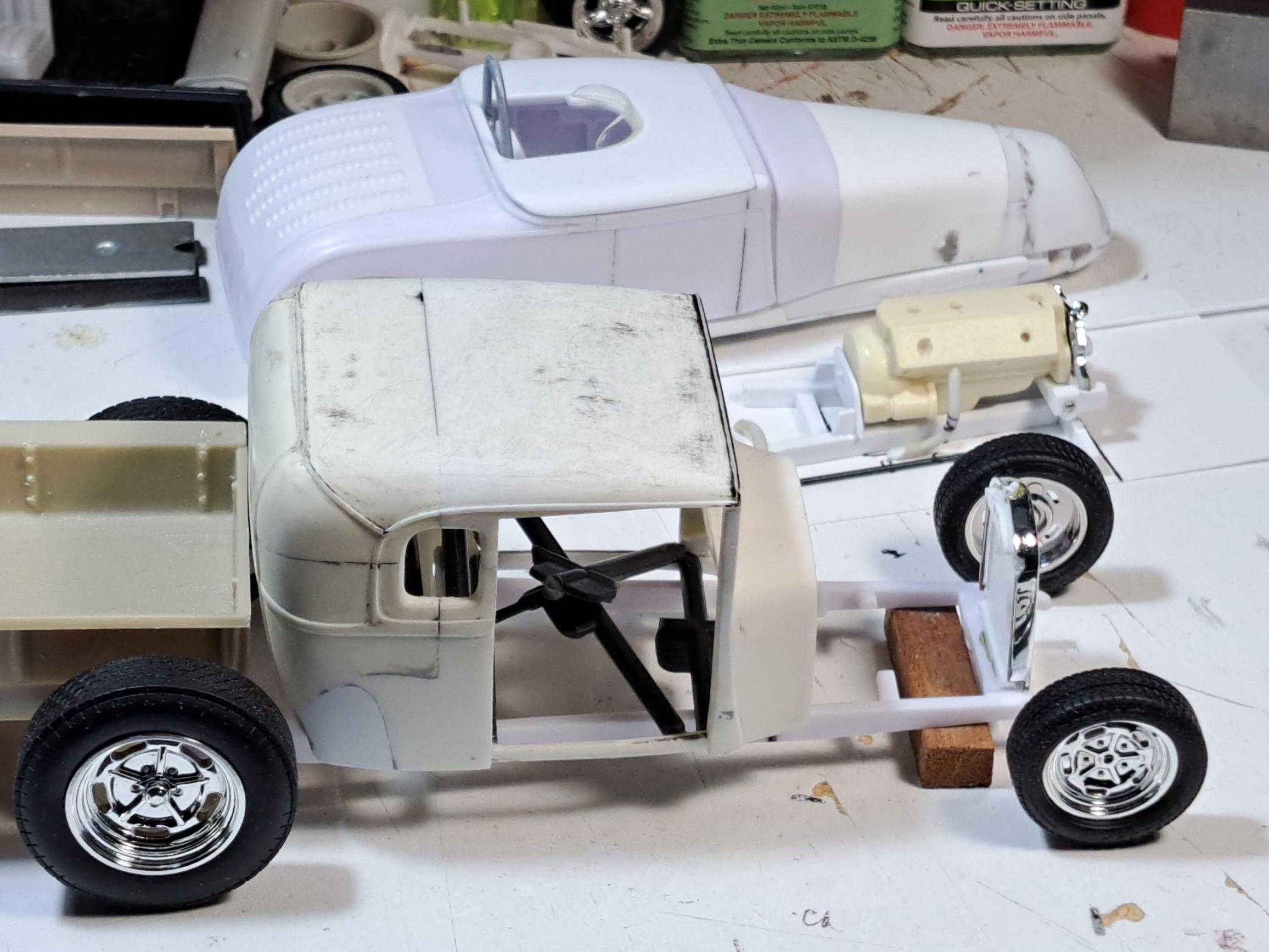

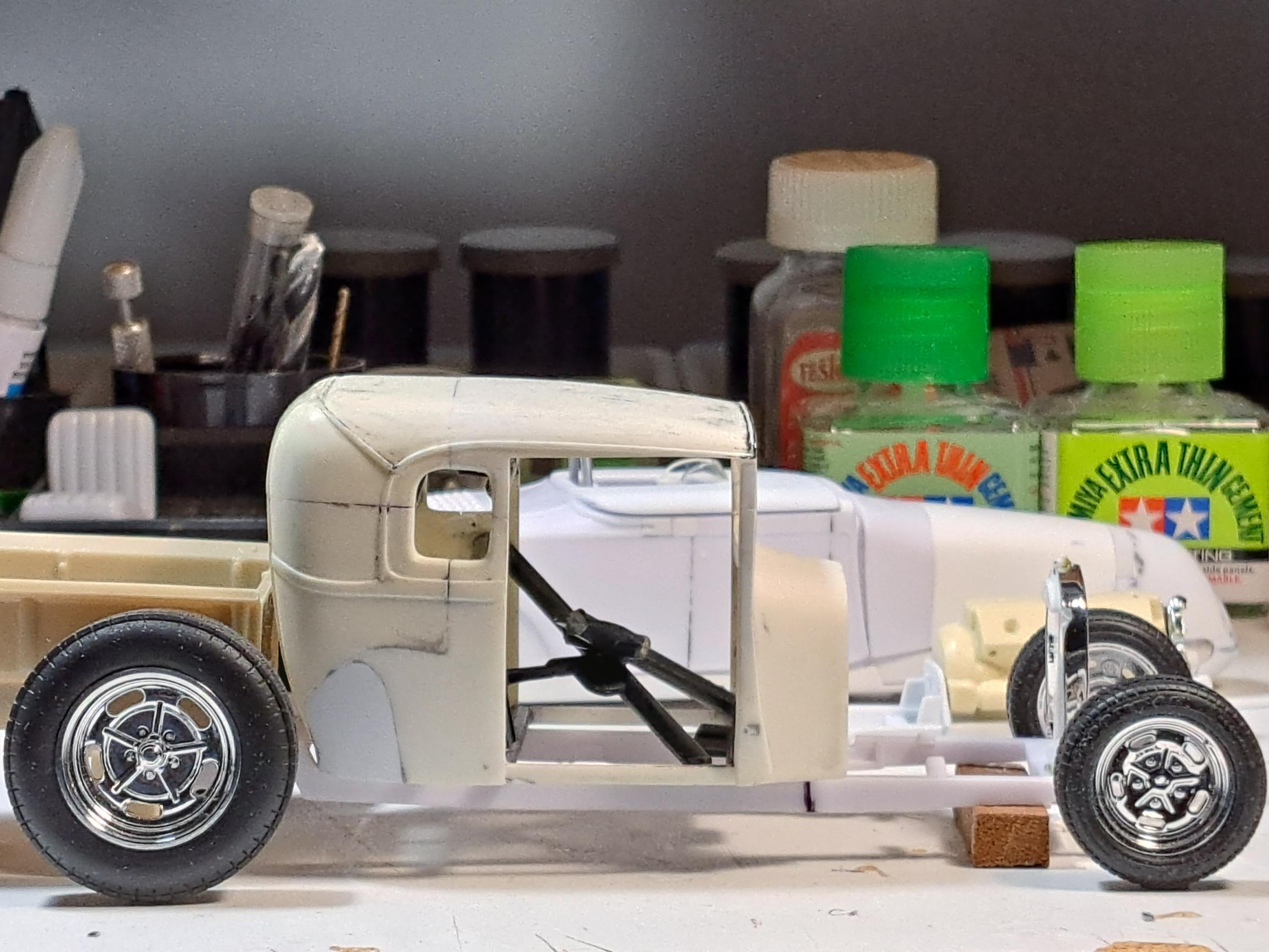

  13. Got to thinking about the old AMT '28 Sedan Doors wondered how different they were from the Revell '29 Pickup... so close: Only the window frames are going to be sliced up to fit the opening between the beltline and the top of the door openings. Saving the original doors for someone that might need them. Moving the beltline back and under the opera window adds a bit of detail copied from the '29 TNR... -KK

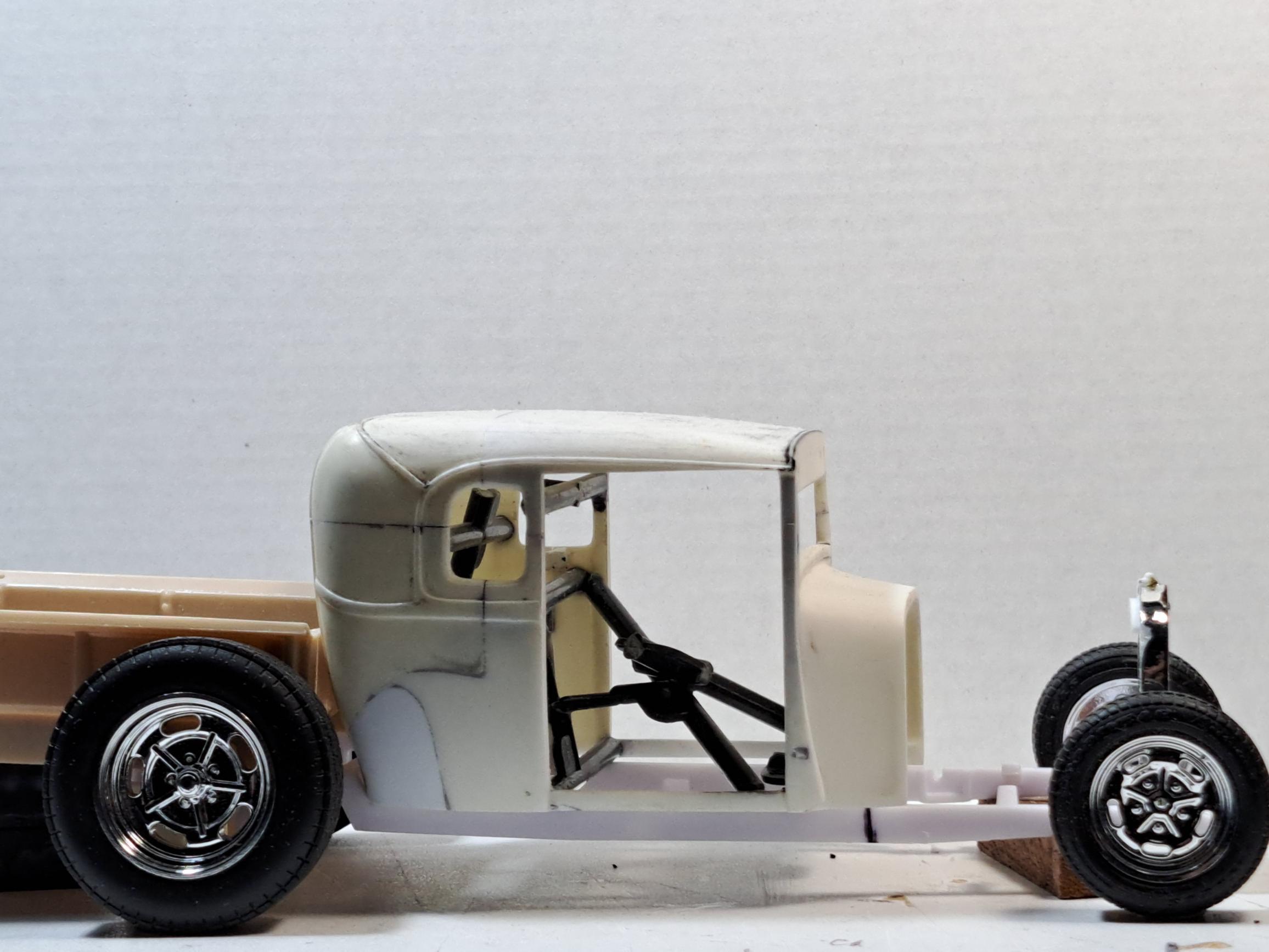

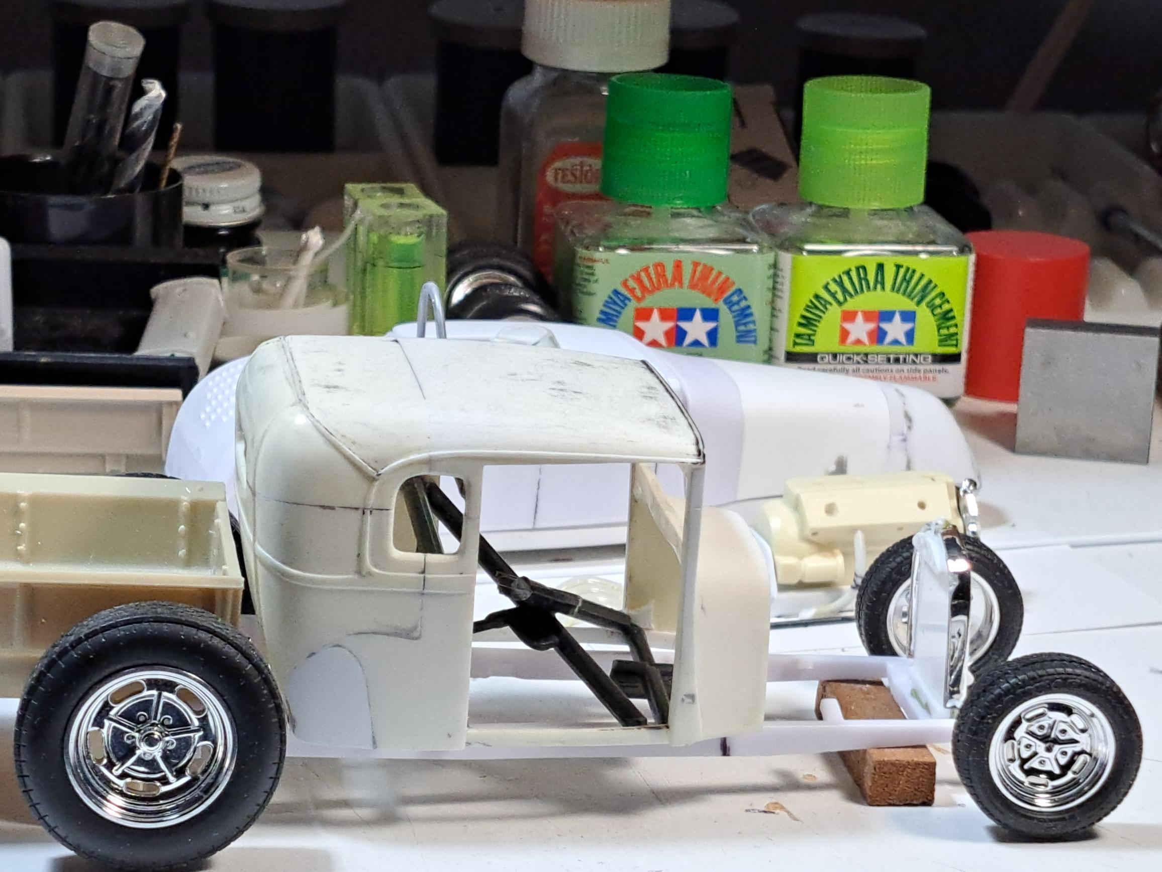

  15. Planning ahead has been a major part of the sedan conversion and construction, oh and reconstruction, into the '29 Ford extended cab configuration. Squaring everything up for the door windows, relocating the beltlines and looking forward to incorporating the roadster windshield frame under the soon to be narrowed AMT '29 Ford Woody/Pickup visor is in the offing... -KK

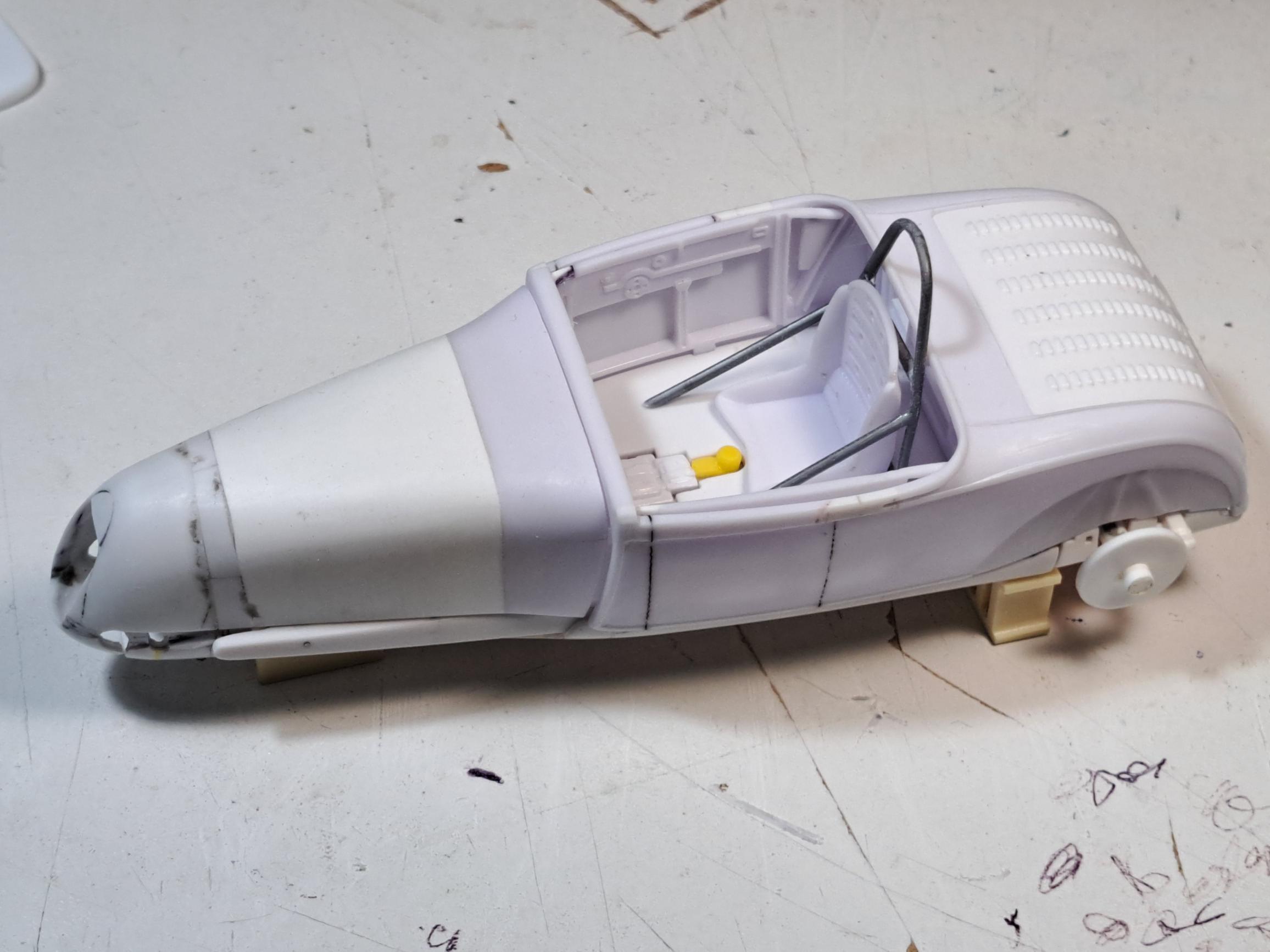

  16. Quick update... moving the beltline back as was done on the roadster:
  17. That's why we call it modeling! Not something they make plans for and even harder for some to wrap their heads around. Good work on both accounts, Brother!! -KK

  20. Post Reconstruction... Work continues on the Build Back Better '29 Extended Cab Project dubbed XPU! -KK
