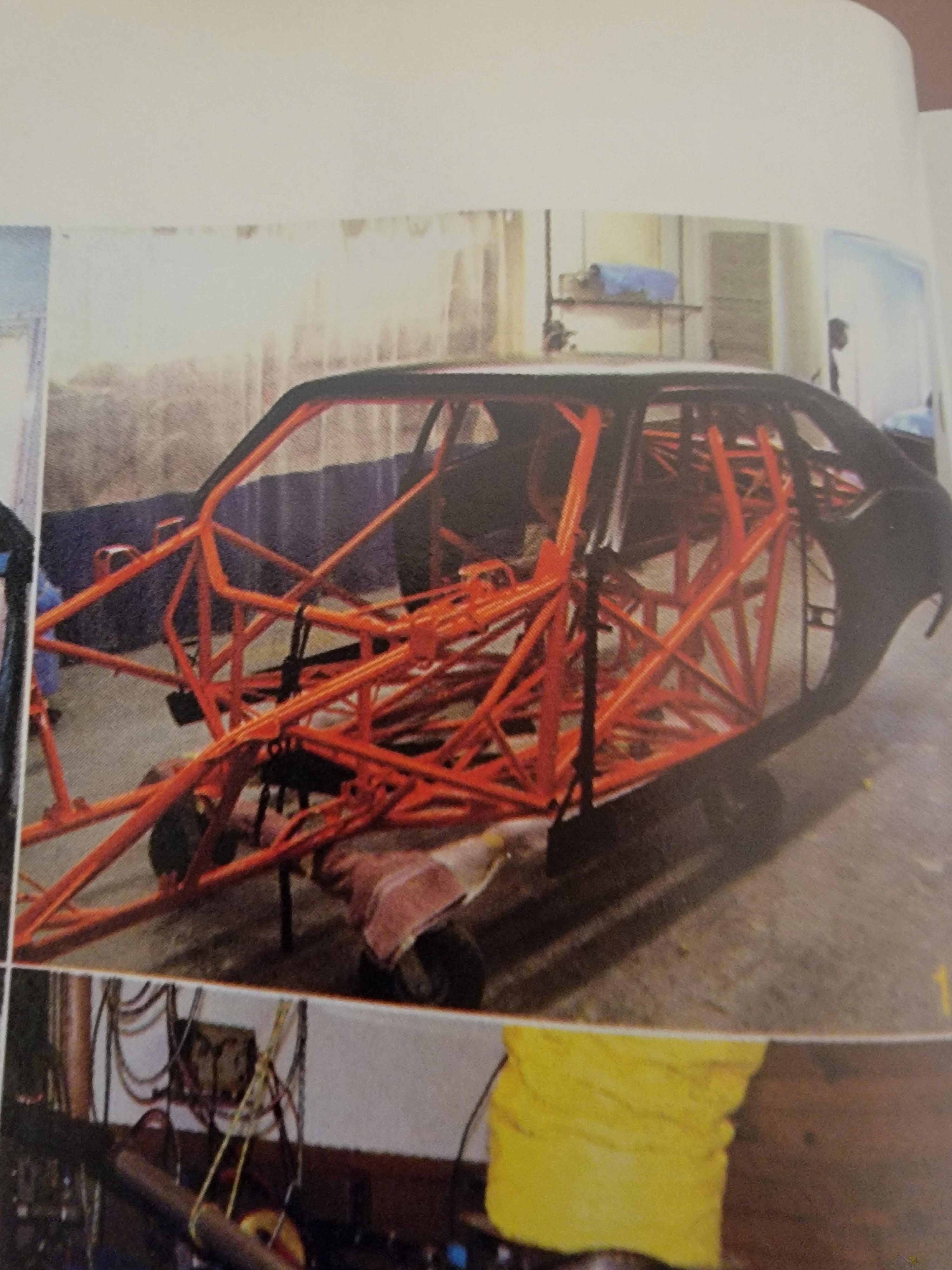

To fix the short foot well, I cut the firewall off, added almost 1/8 inch of styrene and glued the firewall back on. I am not re-attaching the tranny hump to the firewall because in my 1:1 example the forward portion of the tranny hump is missing to expose the Lenco tranny. I like the look of it, so I am going with that in my build. Both problems fixed. I'll remove the extra bit of styrene in the floor in the morning once everything has firmed up good. I'm off to bed. Later- -
