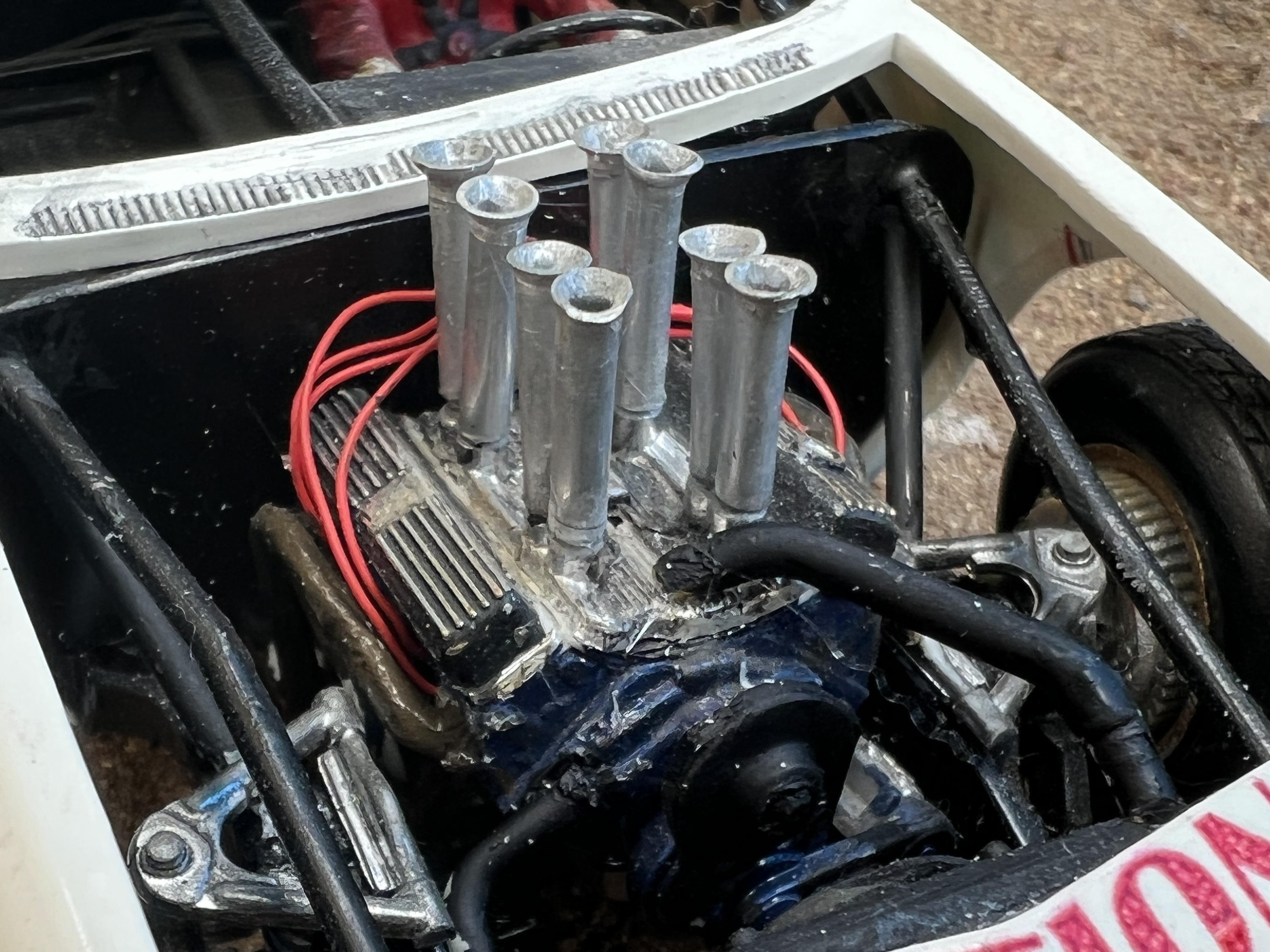

Had a busy weekend but made some more progress on the Torana. Thanks to everyone who has viewed and commented so far - it is greatly appreciated. It turned out that the Citation hood scoop was a little larger but a little flatter than the A9X scoop but otherwise the same shape. I cut it out of the hood instead of off the hood and then glued it to the grey plastic hood from earlier. When it had dried solid I carved out the plastic underneath to allow clearance for the eventual stack injection. I found what I think is a Camaro chassis (Copyright Revell 1990) which was near perfect fit into the revised Citation body. I trimmed a little front he front and from the wheel arches and then added a pair of styrene strips to the side of the floor. Easy peasy. The Torana has a four link coil sprung rear axle so I grafted in one from a Monogram Chevelle. I also removed the stock fuel tank as per the regulations of the time. I found some front and rear bumpers in my parts box, both Japanese I suspect, and with less than a half hour's work they fitted up fine. Here she is ready for primer and then finally the first mockup in one colour. I am REALLY happy with how it looks but there is still a fair bit of finessing to do before she gets her first coat of white. One thing that is very obvious now is that the front flares in particular are too wide. Luckily, if I take a few mm off the outside edges, it will also open up the arches and give me better clearance on the tyres - win, win! Cheers Alan

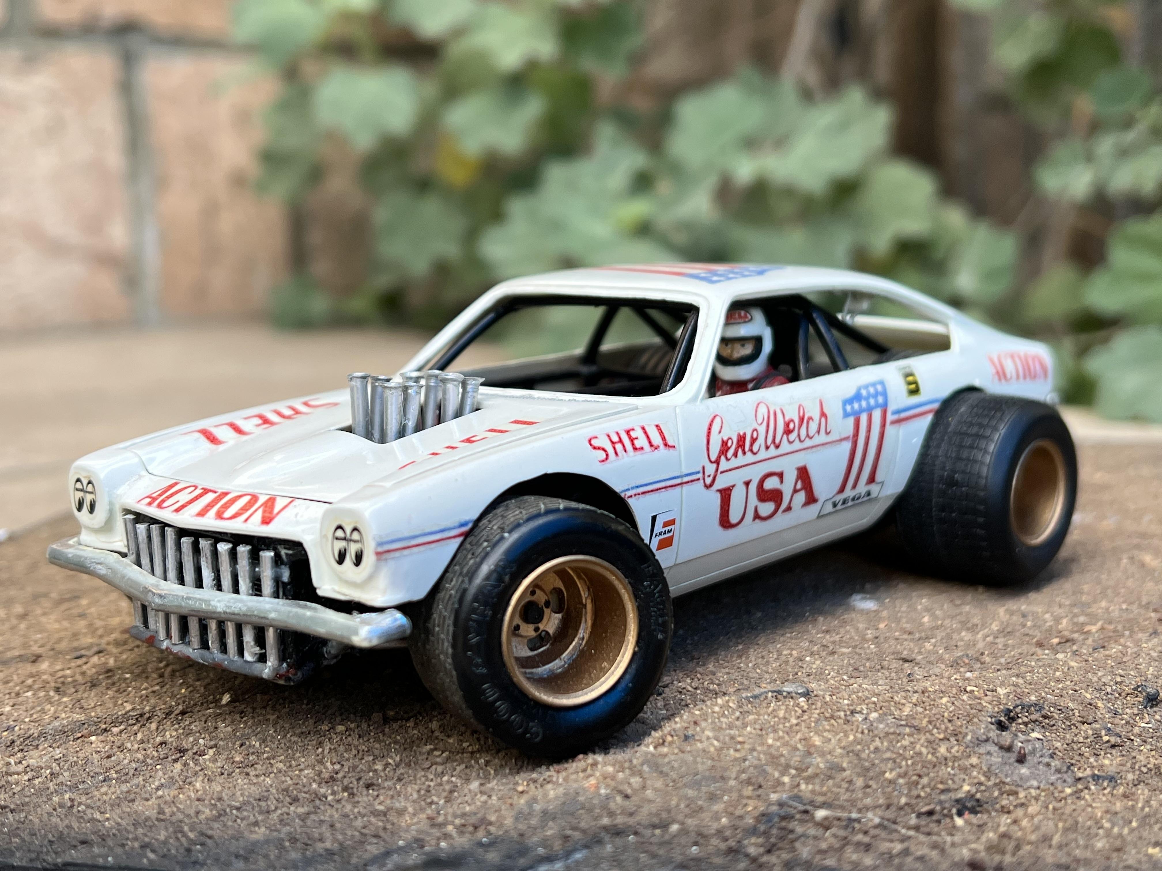

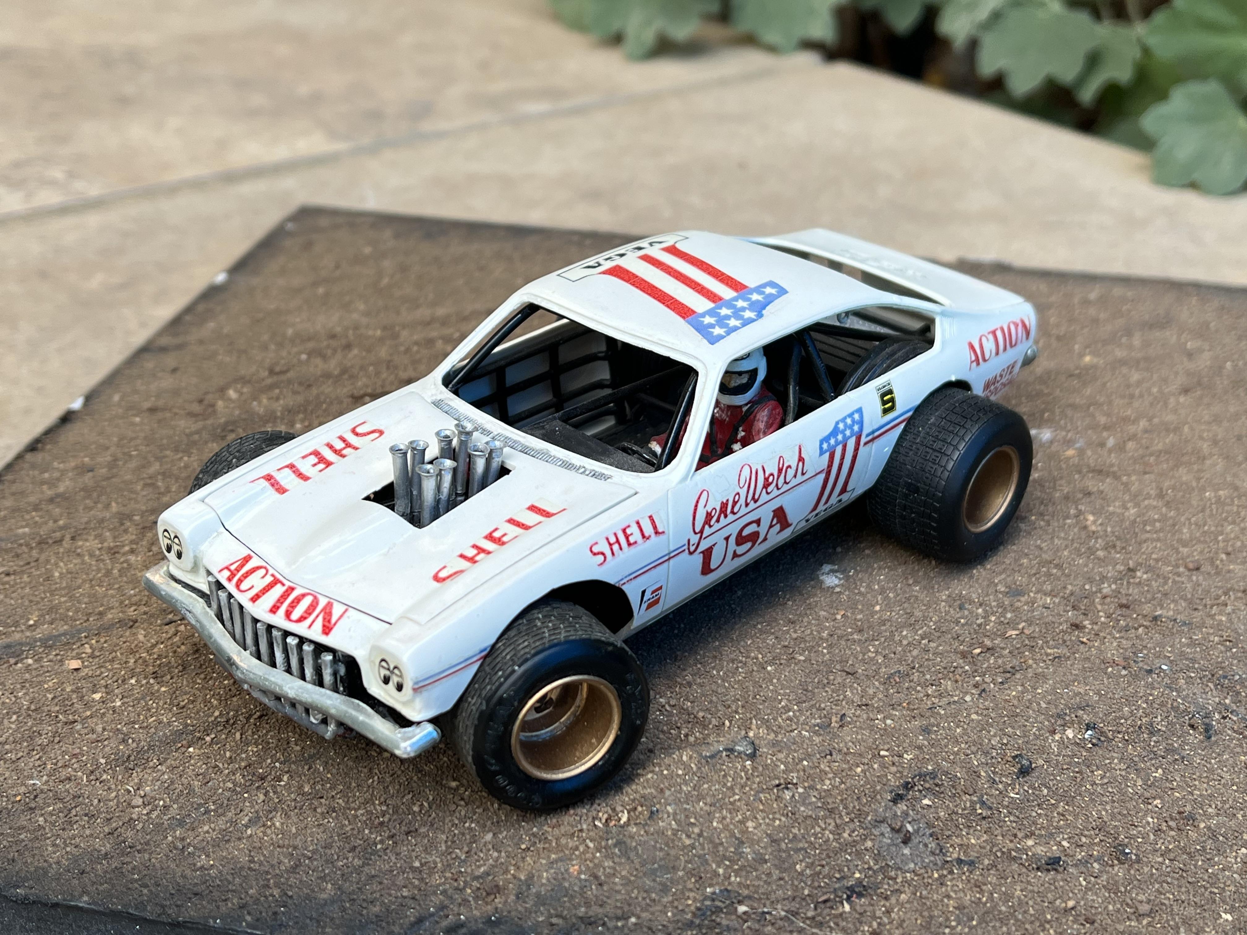

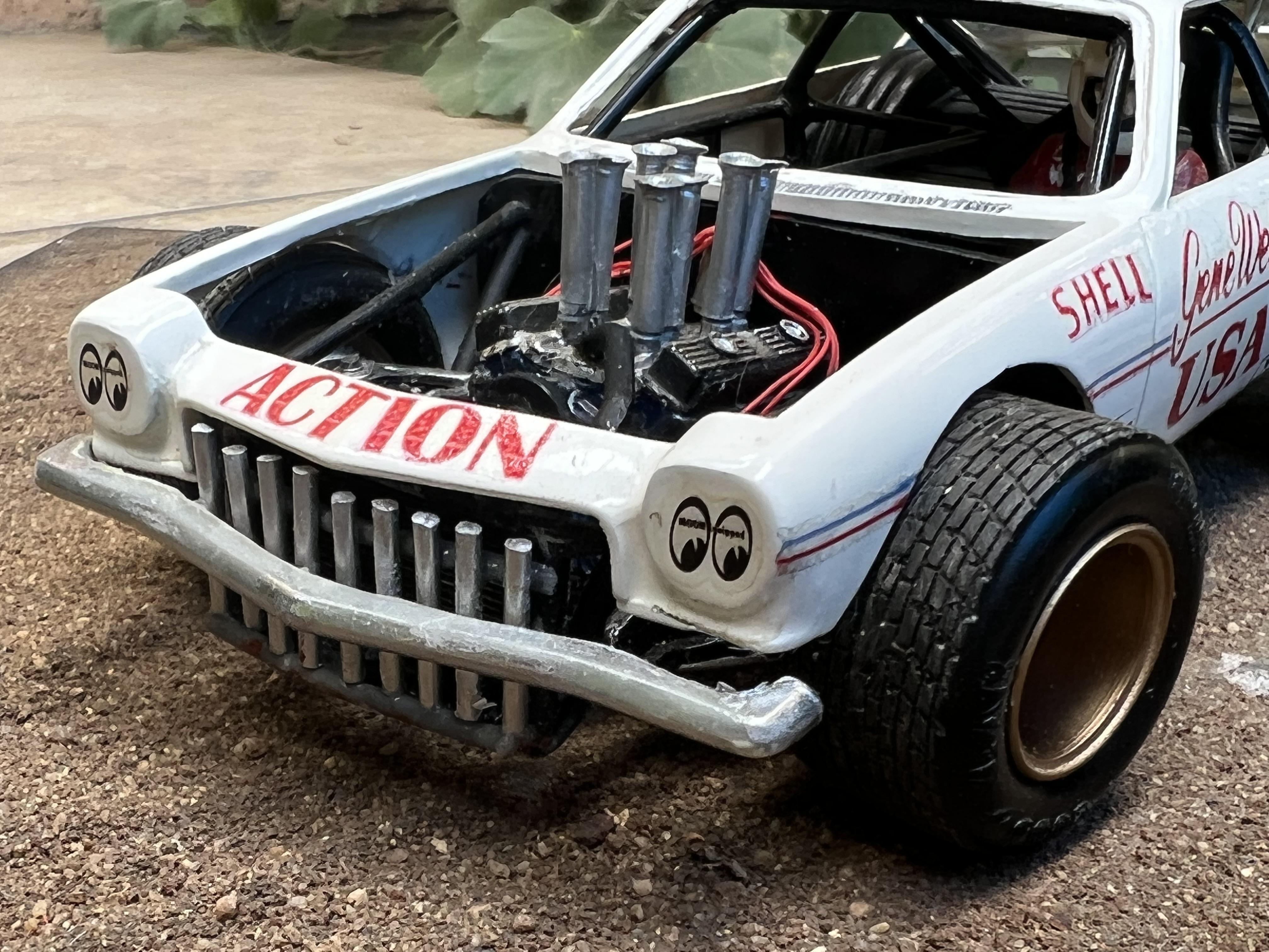

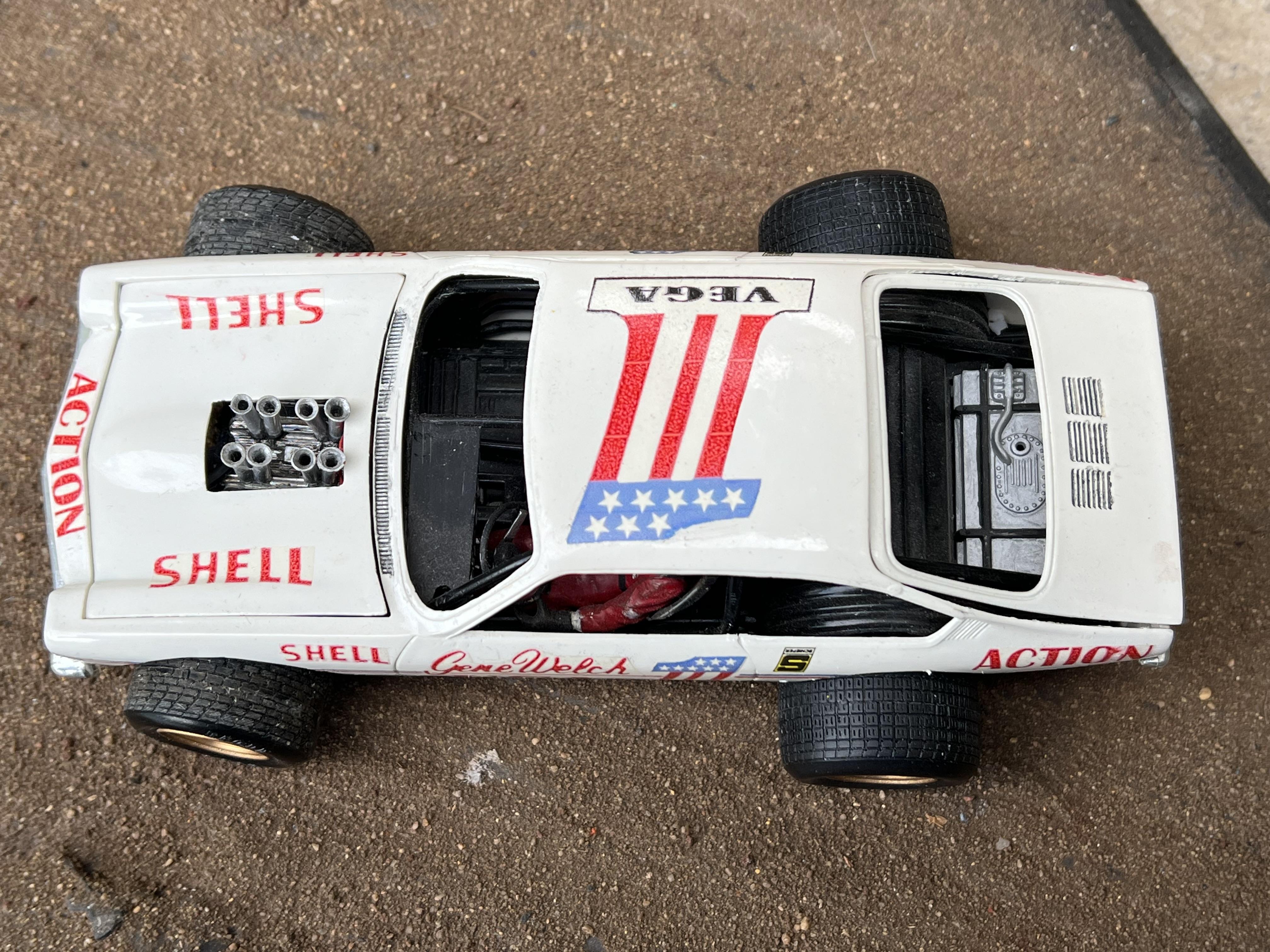

Here's a puzzler for you - can you think of an American race car built from an American sedan by an American racer to compete as part of an American team - but practically no American knows about? Still waiting.......... O.K. The car you see here is one of a four car team of Chevy Vegas brought to Australia for the summer of 74/75 by Gene Welch. But first, a little history. Speedway sedan racing, what you guys call late models, only really took off in Australia in the late sixties. By the early seventies it had taken top billing from the midgets, super mods and solo bikes that were fan favourites in the sixties. Around 1971/72, Californian Gene Welch came out to Australia to race over the summer season, your winter, on the eastern seaboard. He brought with him his 65 Chevelle and had a pretty successful season, enough to make him want to come back the next year. This time he brought a 69 Camaro, and like the Chevelle, it was a pretty typical short track racer from the era. Things took a twist the next year, however, when Gene returned with a purpose built weapon in the form of a shortened 71 or so fibreglass Camaro on basically a modified sprintcar frame. Reputed to have cost a mind blowing $12.000 back in the day, it was meant to blow the Aussie competition off the planet. It wasn't as dominant as expected but the seed had been sown. For the next season, Gene returned with a four man team in near identical Vegas. These were no ordinary Vegas. Local speedway magazines stated that Gene chose the Vega because it was the smallest car that GM made with a V8. Heck, those dumb Aussies won't no that GM never made a V8 Vega!!! A magazine article on the build stated that they were a steel bodied car with a NASCAR frame, 3 inch finned drums on all four corners, a quick change rear and injected 350 Chevy powerplants. Oh yeah, and outrageous steamroller rubber, wider than we had ever seen on a dirt track and crazy wide, like Formula One wide, for the pavement ovals that were popular on the East Coast. The drivers were Gene Welch, Big Ed Wilbur, Mike Klein ( "Hash Brown") and Wayne Sue. This American tour was all over the local news and as a seventeen year old I made a point of heading to Claremont Speedway to see them race, and hopefully watch the local hot shoes destroy this bunch of Yankee invaders! it didn't quite work like that as these cars were absolute missiles compared to the heavily re-inforced Aussie muscle cars that our guys were racing but it was a great night and I will never forget it. One thing I remember clearly is that once the locals realised they couldn't beat them, they beat them up instead. Boy did those lightweight Vegas take a beating! I always wanted to build a model of Gene's Vega and about twenty five years ago got into it with my childhood 72 Vega kit, with a heavily modified but unknown AMT NASCAR kit for the frame, narrowed and shortened, and a lot of scratchbuilt and heavily modified parts. Only problem was, I had no idea how to make the decals so it sat in a plain white wrapper ever since. Recently I met Jackson Bull, a very pleasant and knowledgeable young man who wasn't even born when I first built this model. I wondered out loud if he thought he could make the decals I needed. In under 2.5 seconds he had found colour photos of the car on his phone and by the end of the week I had my decals, and they were near perfect! There is nearly a fifty year age difference between myself and Jackson but his knowledge and passion for hot rods and models blows me away and I am eternally grateful for him enabling me to finish this model. So here it is, finally finished after all these years. There is not a lot of info about these cars on the net. Most of my reference photos were from old black and white Aussie speedway magazines from the era. I have no idea what happened to the cars - whether they returned to the USA or not, except that to the best of my knowledge they were never raced here again. (Gene's earlier 69 Camaro was sold to local supermod hero, Alf Barbagallo but it was raced only briefly by him before he returned to supermods). In following years the team returned with Camaros, Monzas, Corvettes and eventually the wedge shaped late models but they were all conventional short track racers of the day - only the Vegas were custom built Aussie killers and that is what has always fascinated me about this team. I hope you enjoy my model and if anyone can tell me anymore about the cars from an American standpoint I would be all ears! Cheers Alan PS When I built the model I honestly believed the wheels had been gold. When I finally found a colour photo, it seems they were blue. On the other hand, Perth seemed to be at the end of the tour and by the time they got here a lot had changed on the cars so maybe I did see gold wheels way back when - who knows?

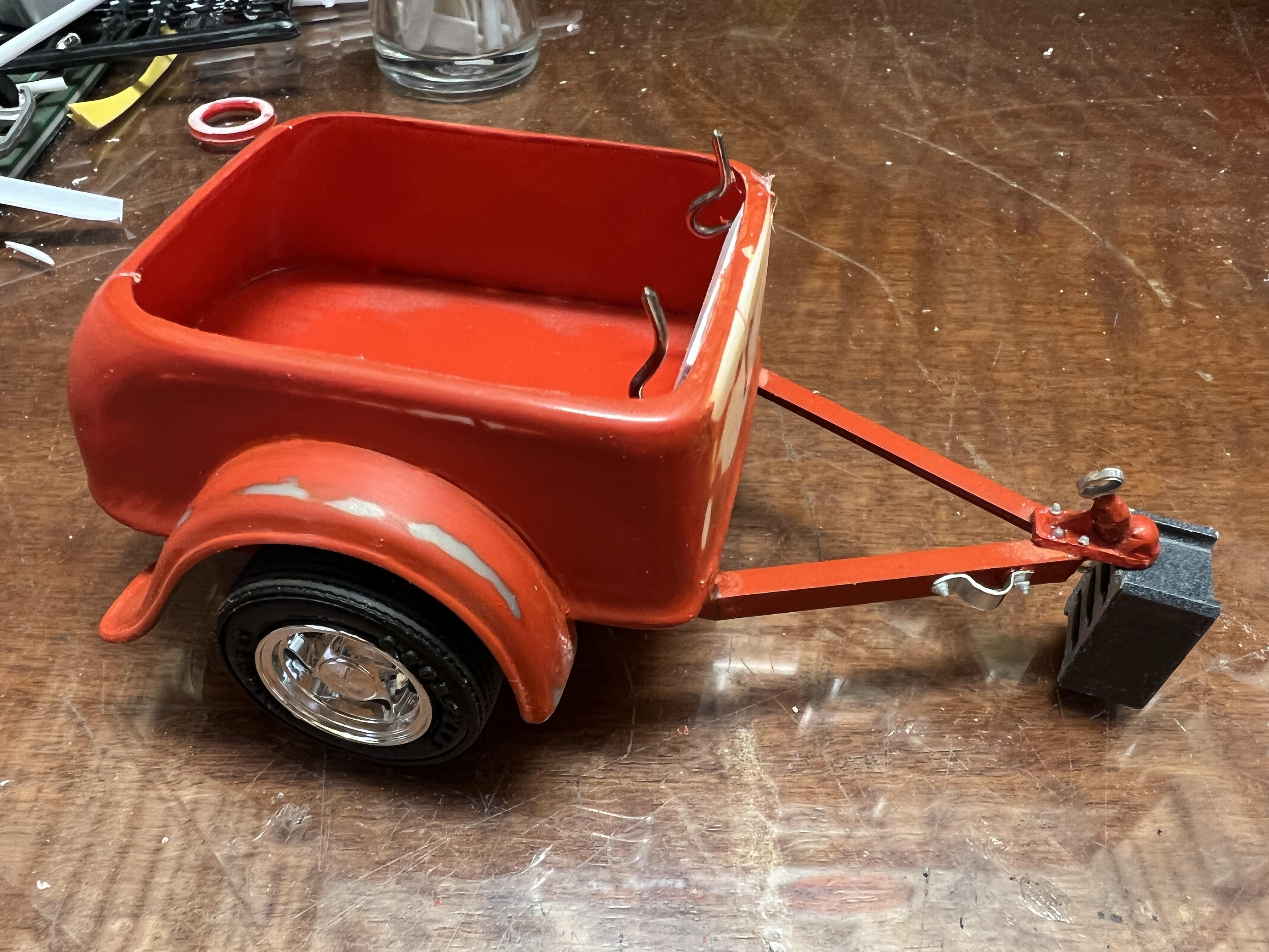

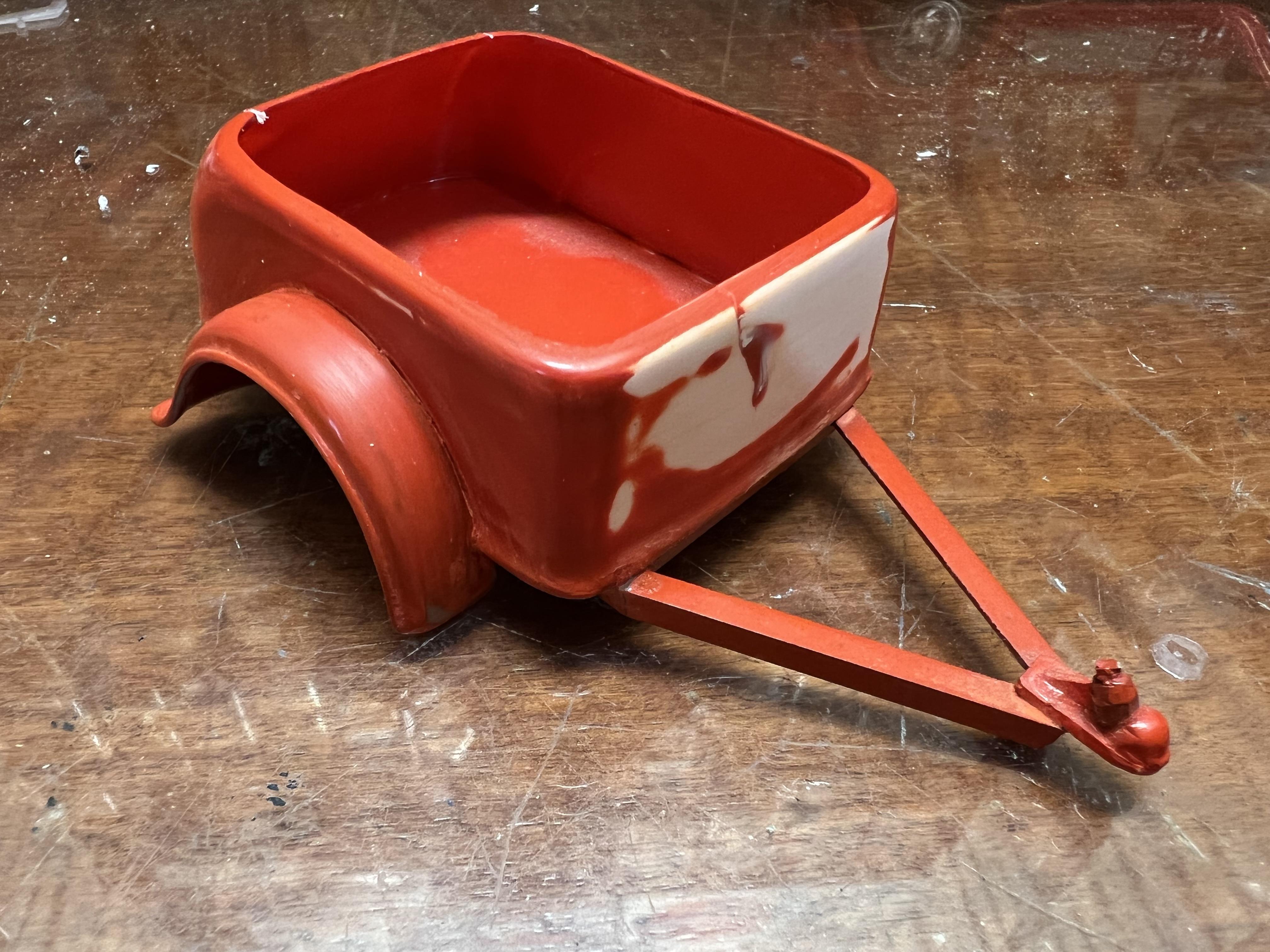

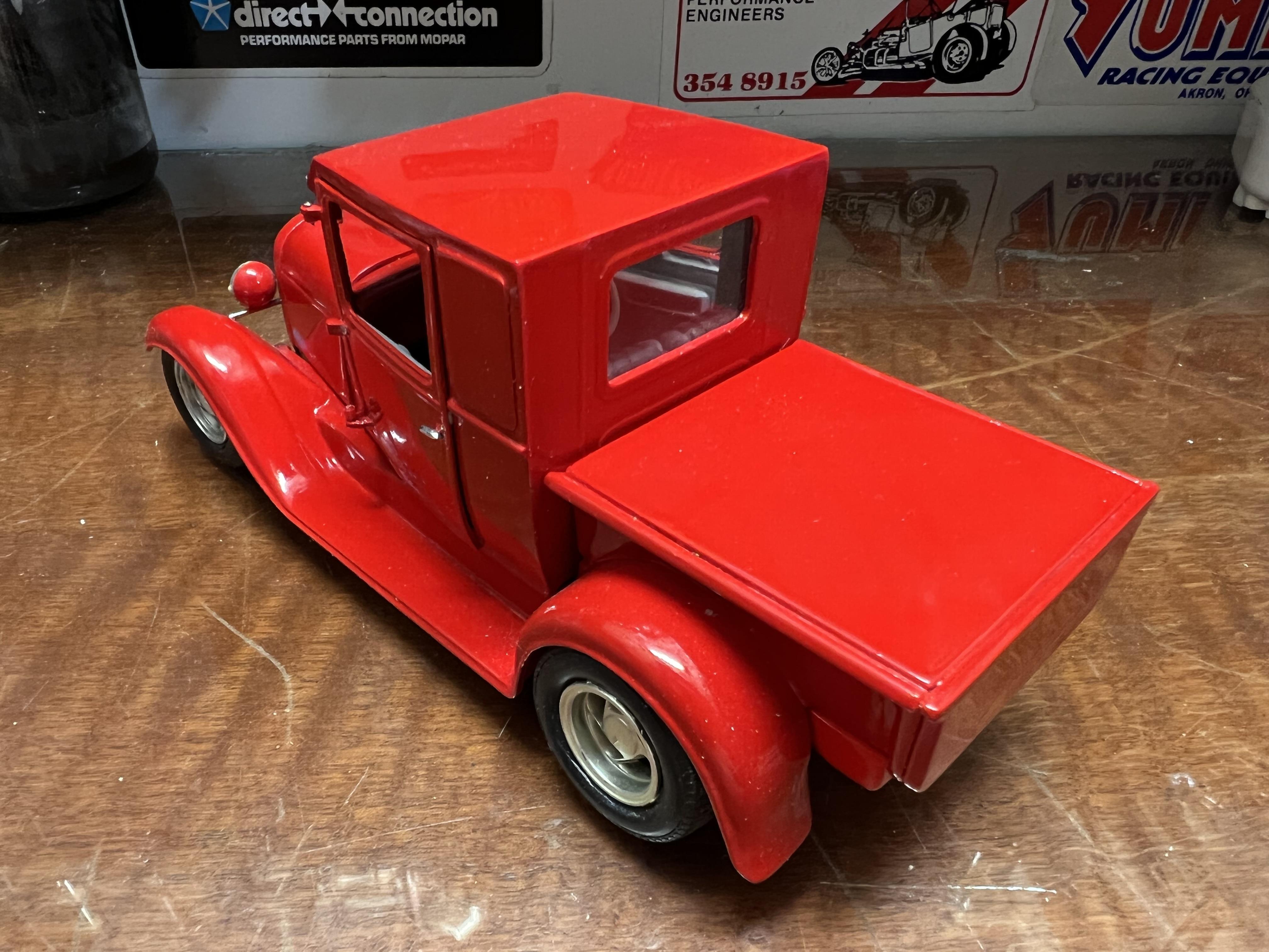

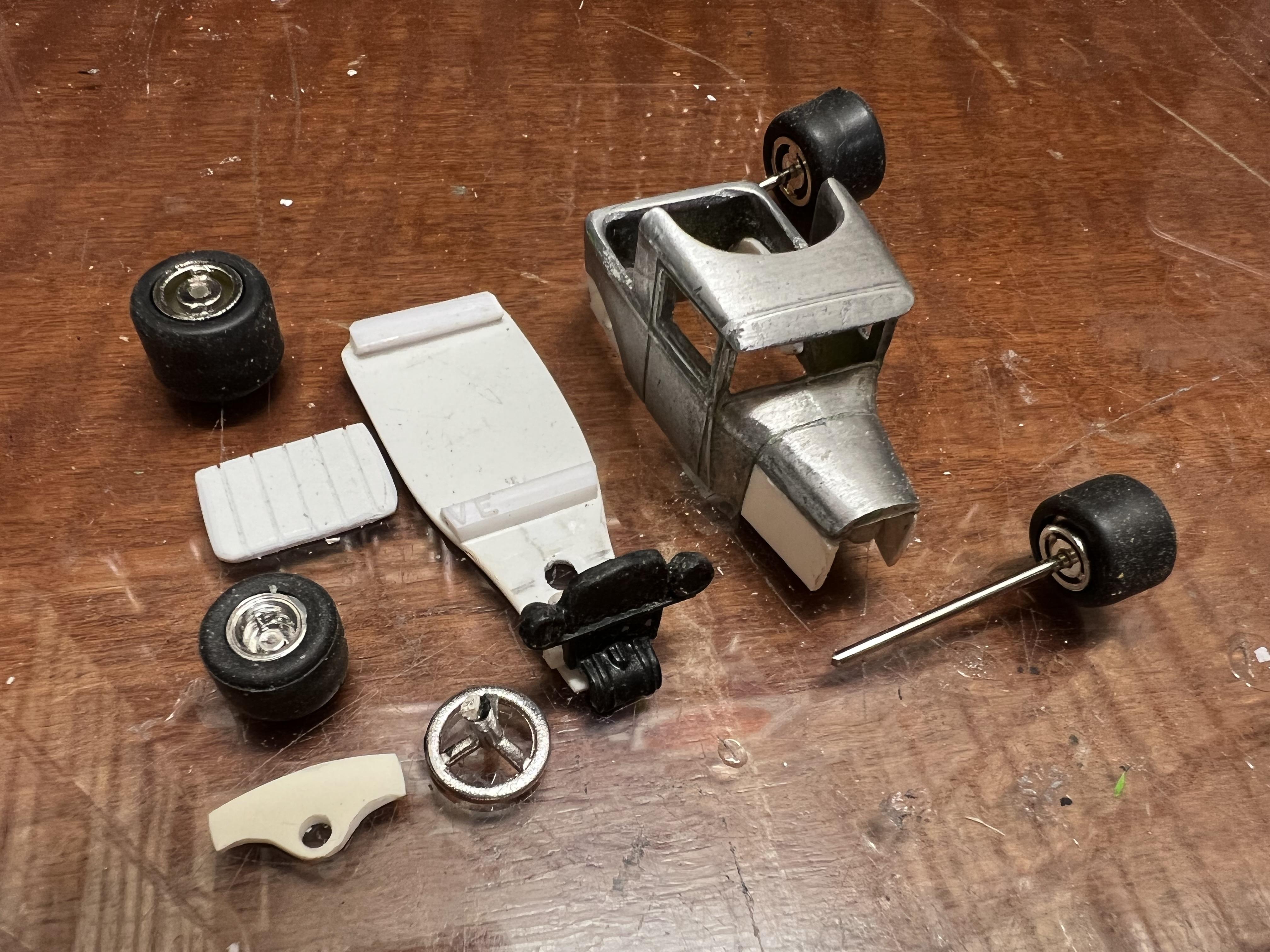

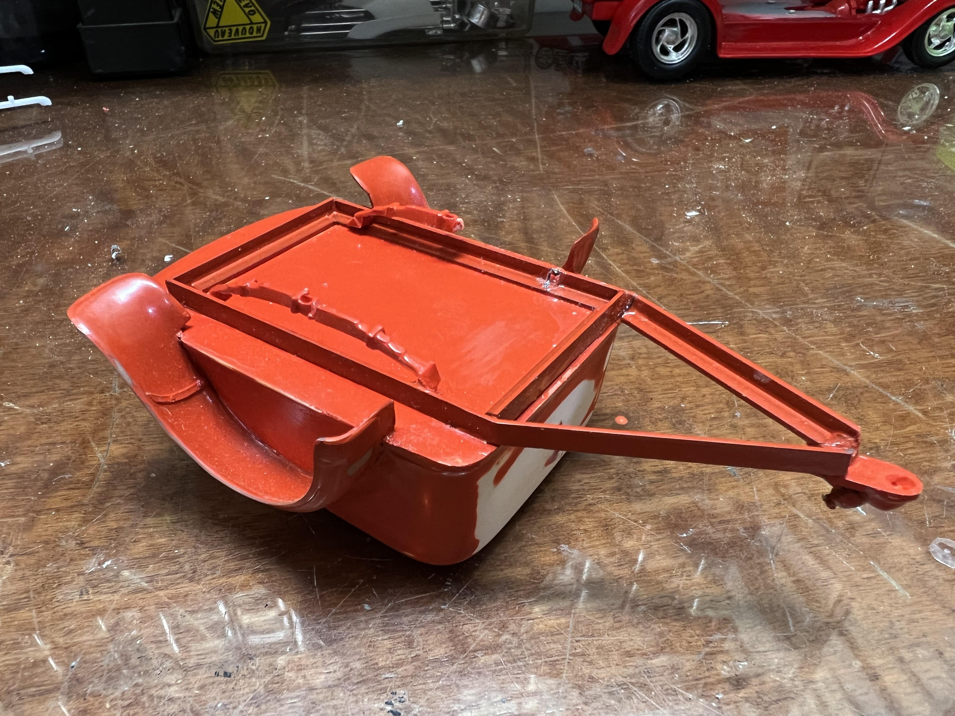

My pleasure Tim, you richly deserve the accolades. it's great to know you like my Model A. I have decided to take this project one step further. Partly because KKK is doing a trailer and partly because while looking for something else I stumbled on a very old project. Back in the early 90's I had aspirations to start up a business making vacformed parts. Alas, I was on the wrong side of the world, the Internet had barely been thought of and I just didn't push it hard enough. Anyhow, of the thirty or so wooden moulds I handcarved, one of them was a Mullins Redcap trailer. Now this was well before Revell released the 37 Cabriolet with a Mullins as an accessory. I took the dimensions from an old article in Rod Action magazine and took it from there. I designed it with flat sides so that appropriate vintage fenders could be attached to match the towcar. I built three of them but this one got damaged and the paint was blaaaaahhh so I put it away for decades until I uncovered it last weekend. I had some restoration to do and decided to hinge the top while I was at it. The top is not removable on the Revell item. Then I thought - what will go in it? After all, if you are driving a pickup, load space is not usually an issue! Bu what if you had a toy that was too big for a pickup bed? Like, a pedal car or push car? Perfect! I am a huge collector of diecast hot rods and toy hot rods and the first thing that came to mind and to hand was a tatty Hot Wheels AOK. This 1978 toy is of a nicely proportioned 29 Sedan Delivery. With less than two hours work I had the makings of a Model A stretch cab toddler rod! I have to go and pick up some pink primer from my LHS before I can go further but I am pretty happy with the results so far. Still gotta fabricate a towbar for the rod. Cheers Alan

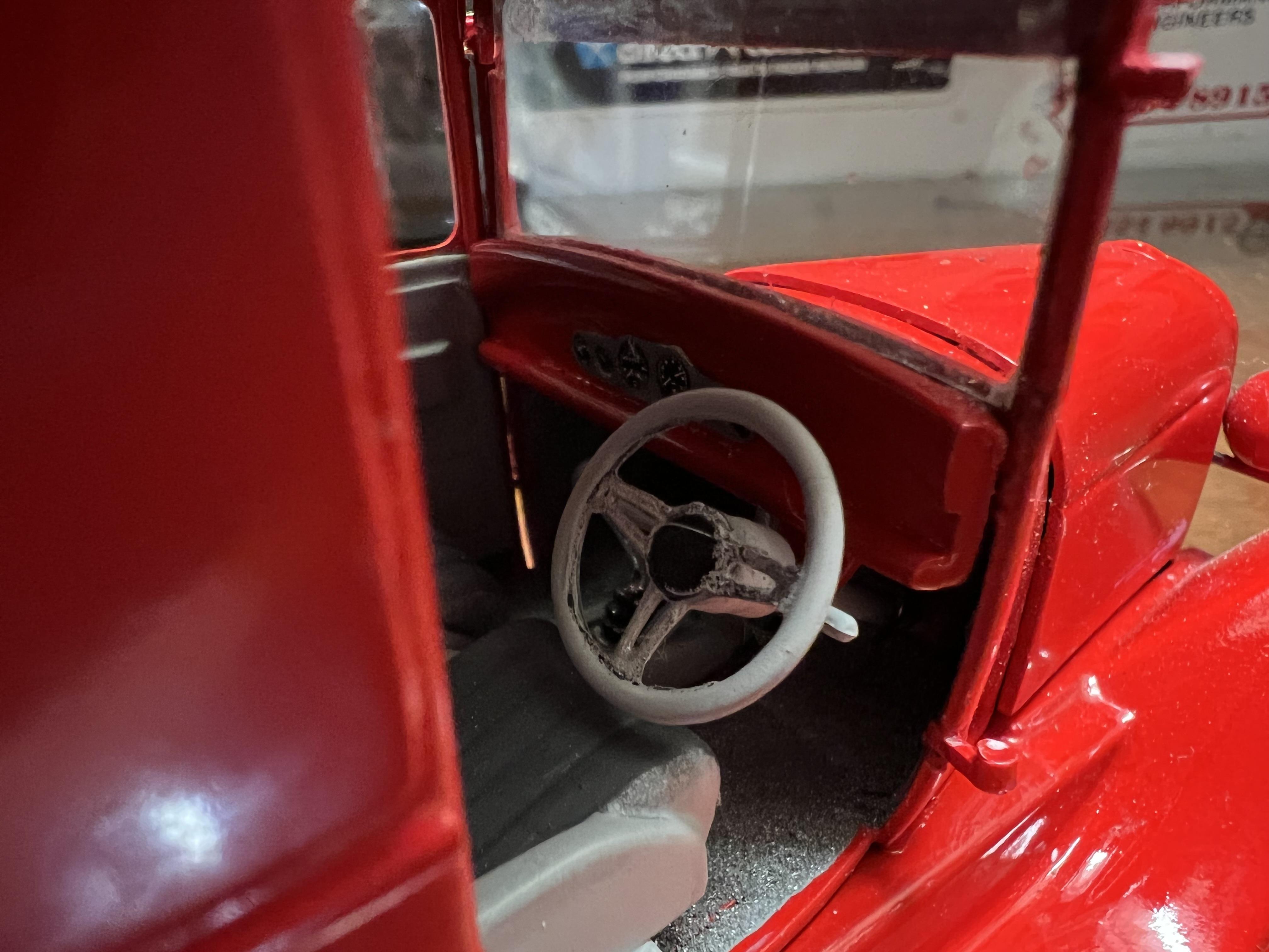

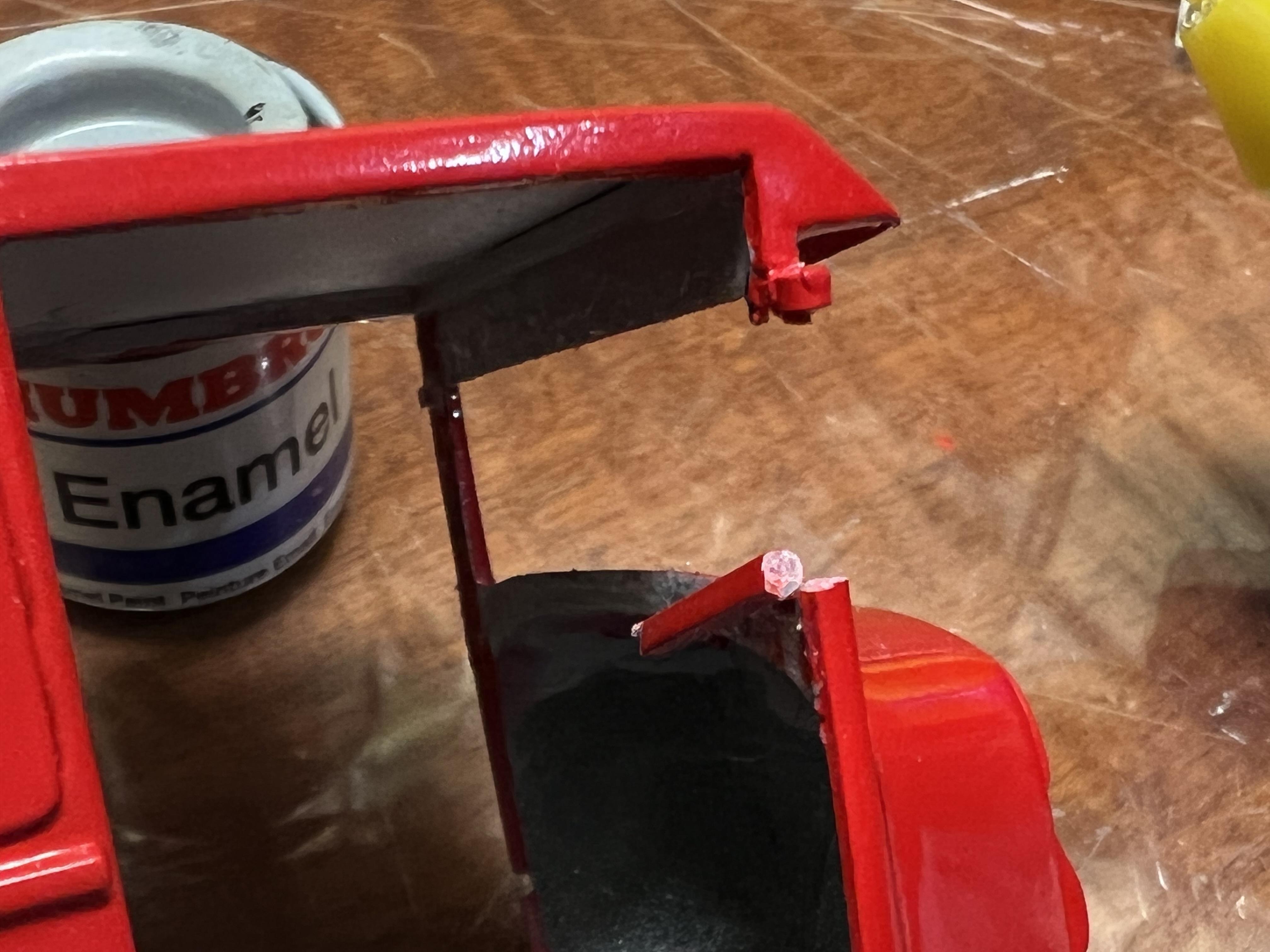

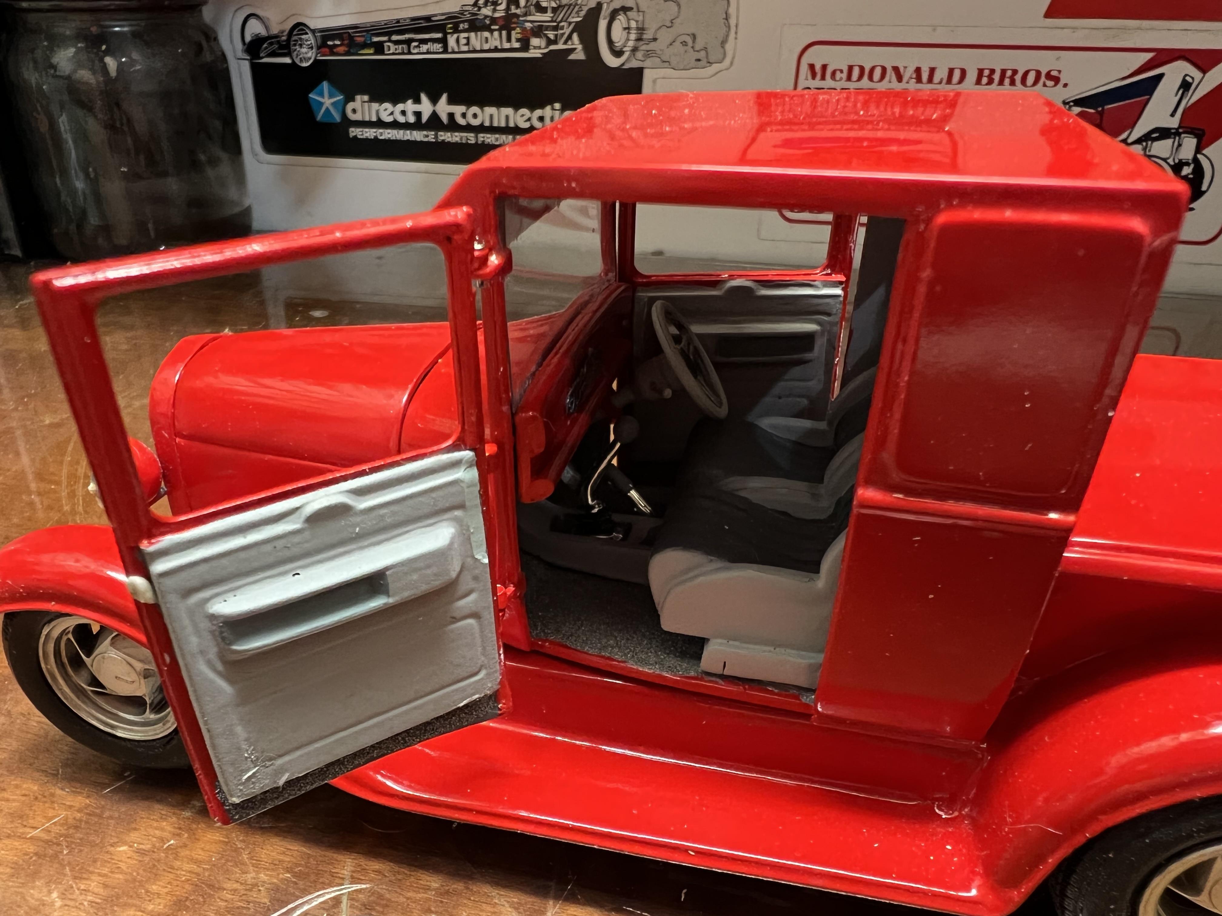

Tadaaaaah! She's done! I will take some outdoor photos tomorrow in Under Glass . And I will be more thorough in dusting when I do! It has been quite the project. A new surprise today was finding that the driver's door wouldn't close because the armrest hit the steering wheel. That involved wrestling the steering column and dashboard out of the car after it was fully assembled - fortunately I had used Mod Plodge to hold the dash in as I wanted time to manoeuvre it and that was the saving grace, believe me. The steering column was superglued to the floor but a lot of gentle jiggling got it to let go without damage. I don't want to embarrass Tim because I have met him and he is a very humble man but his correspondence to me over forty years ago was the spark that got me pursuing models as a serious adult passion rather than just a teenage hobby. At the time I was living in a 10 x 12 single men's quarters room in Paraburdoo, a remote mining town some 1000 miles from my home city of Perth, which in turn is the most remote capital city in the world. Tim put me onto Scale Auto Enthusiast, Automotive Miniatures and Model Empire and from there I was away. I have now travelled the world meeting enthusiasts all over Australia, USA, Canada and New Zealand. With my wife and four friends I was the promoter of our NNL here in Perth for 20 years. It grew to be one of the biggest in the world, with model counts consistently between 800 and a thousand and topping out at 1150 one year. So for me to be able to participate in this challenge through the miracle of the Internet and honour Tim with a model that has embodied as many of his signatures as I can think of has been a very satisfying experience, broken windshield posts notwithstanding! So Tim Boyd, I dedicate these features to you. Stance - ya gotta get it sitting right. Unconventional powerplant - a Ford Motorsports V6 Any powerplant other than a Chevy - see above! Unusual induction - kit-bashed sprintcar fuel injection setup Phantom body style - extended cab Model A phone booth pickup. Fabricated suspension using components from later era kits on a classic era model - Buttera Jag and Revell dropped tube axle with fabricated radius rods front and rear. Minimal engine wiring - just radiator hoses but..... A tan distributor cap -you always told us detail painting an engine would enhance it as much as wiring! A variety of tones and finishes in the interior Chrome headlight lenses painted flat aluminium and coated with white glue. Brian Borden graphics - I know you were a fan back then Michigan number plate with NNL East Showtime plate frame (thanks Tom Geiger!) Lots of mockups! Of course, a huge thanks to Dennis Lacey for getting the wheels in motion and graciously encouraging others to join him, and all the other guys who are participating. Let's see this thread hit 40,000 posts! Cheers Alan

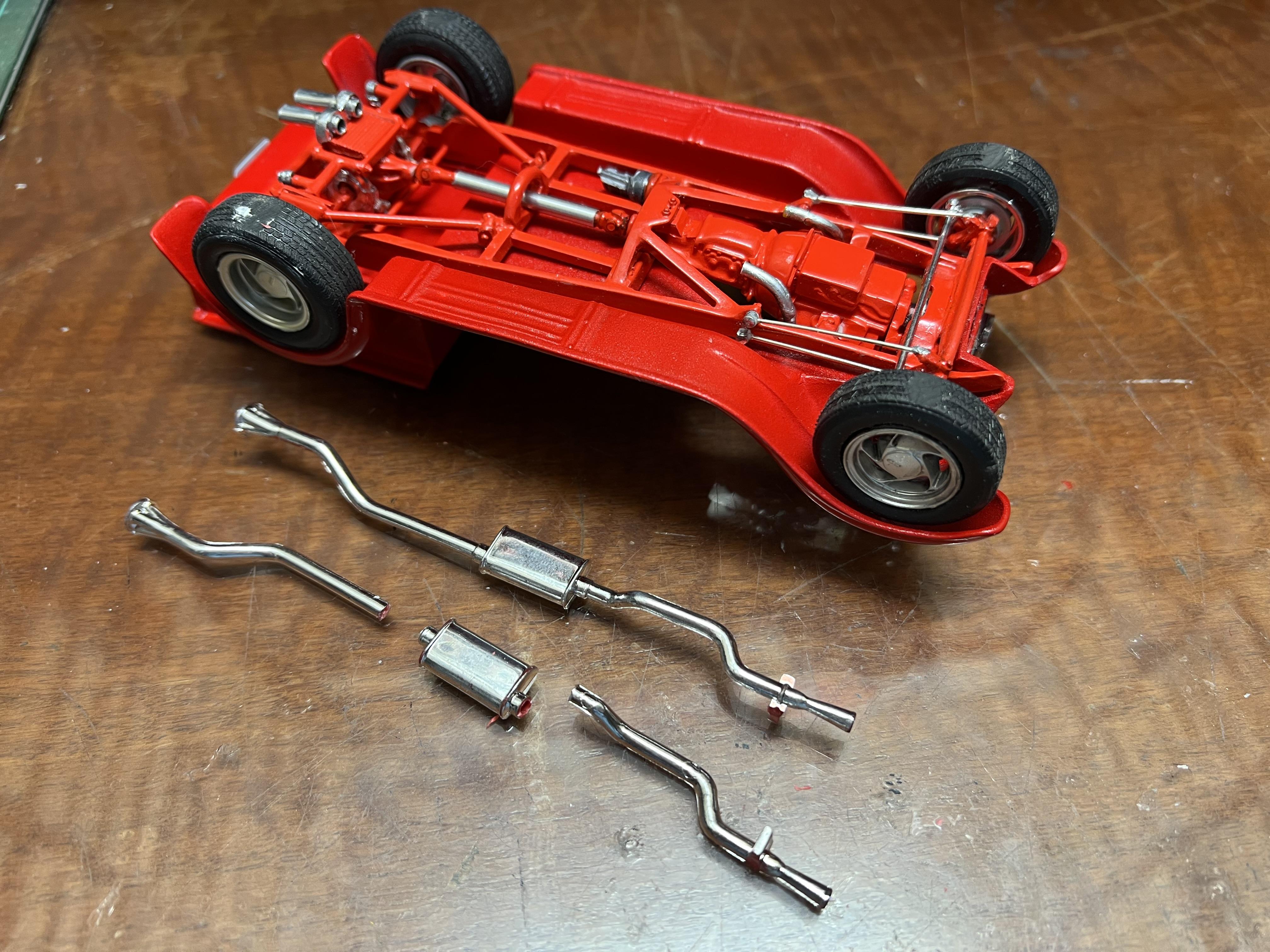

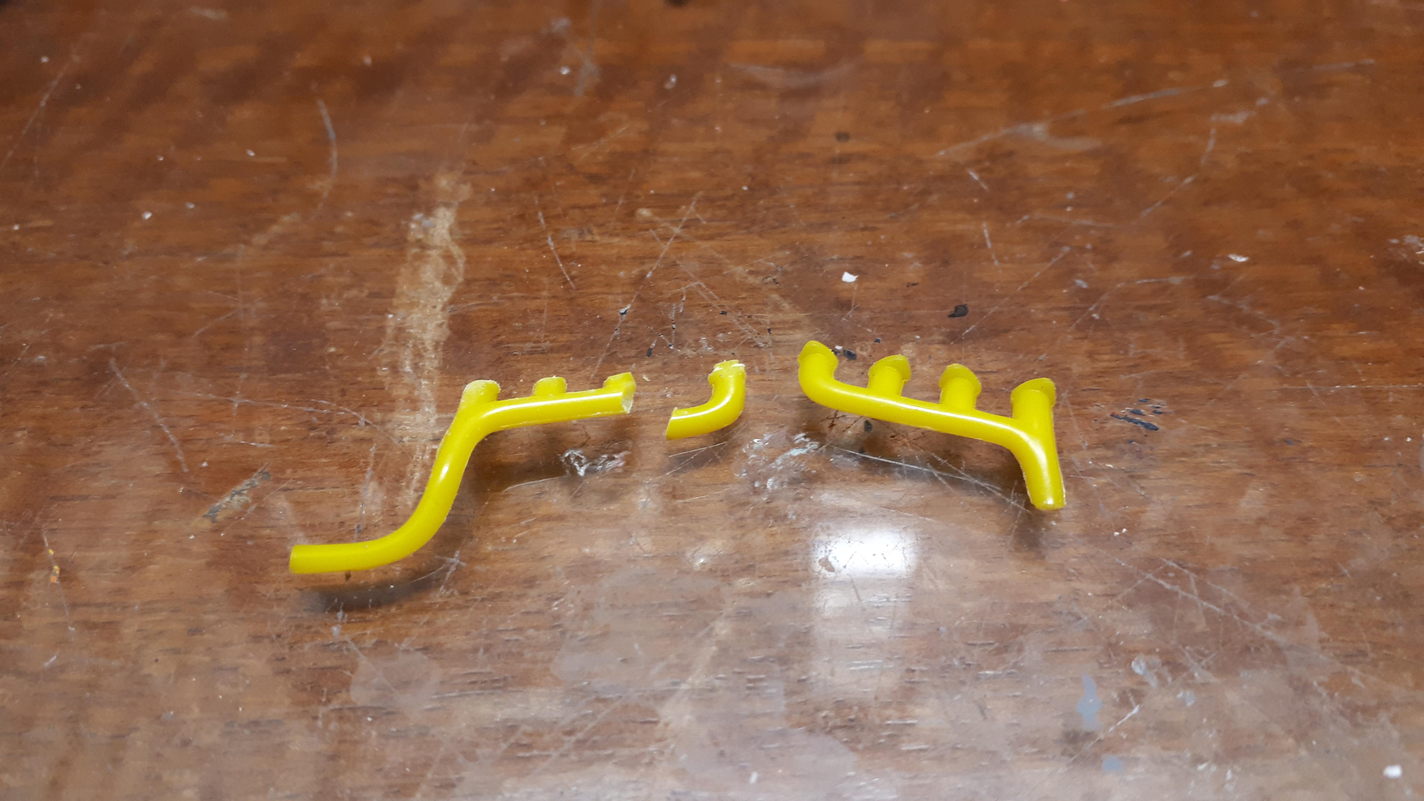

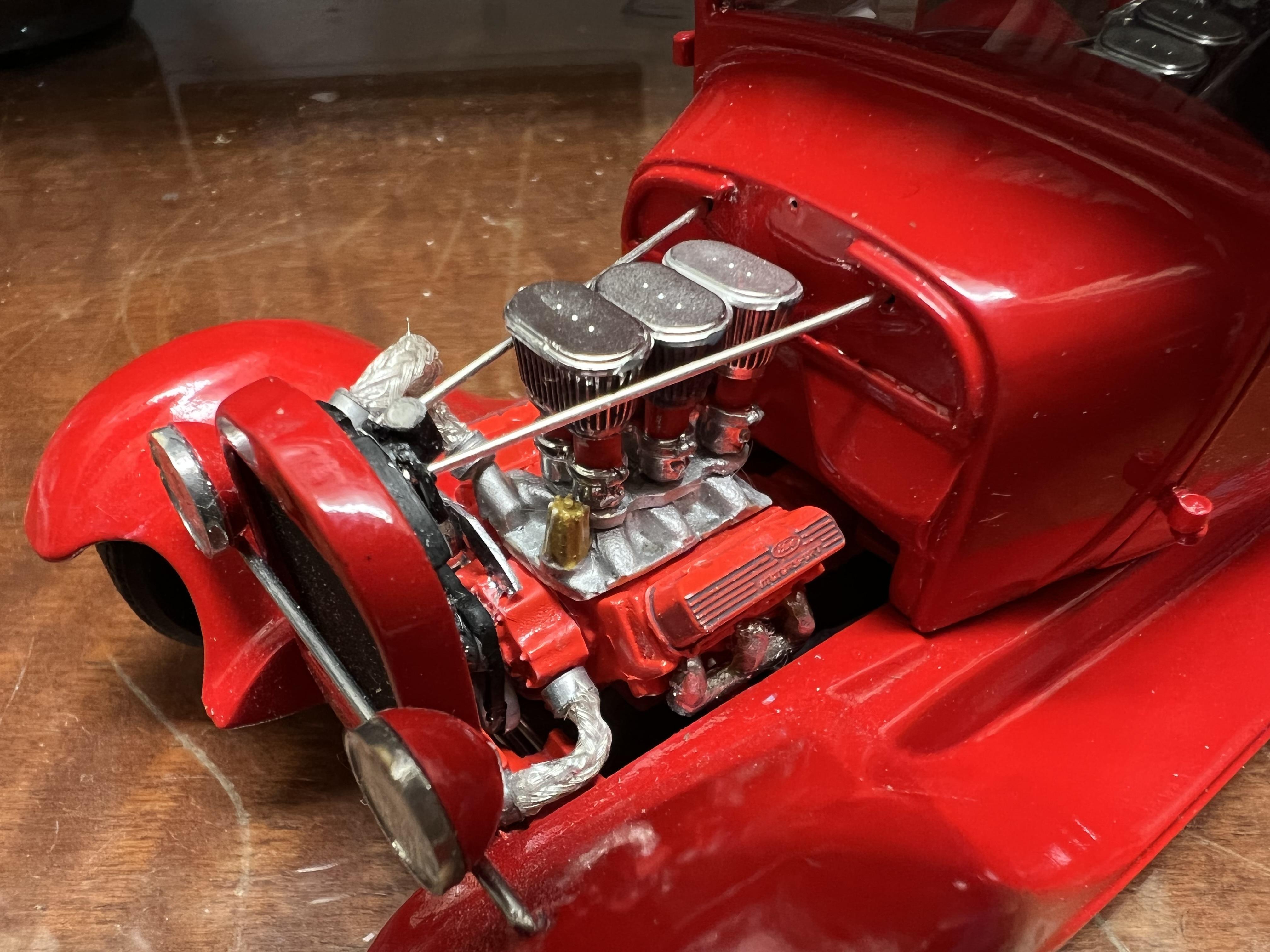

You won't have to wait much longer, Kit. The big reveal could be tomorrow, all things going well! Got a few things done today but the big one was getting the damaged pillars painted. Next I made and chromed the exhaust. I used Evergreen # 222 and bent it between my fingers. I then taped it down and painted the underside of the pipes. When they were reasonably dry, I carefully fitted them onto the car and then painted the top side, thus minimising handling the Molotow chrome. Very happy with the outcome. I also made a radiator support bracket for the top of the radiator, a radiator hose and alternator brackets - can't have floating alternators, can we? Tomorrow just need to install the radiator parts and fit the overhead console and that should be it! See you then. Cheers Alan

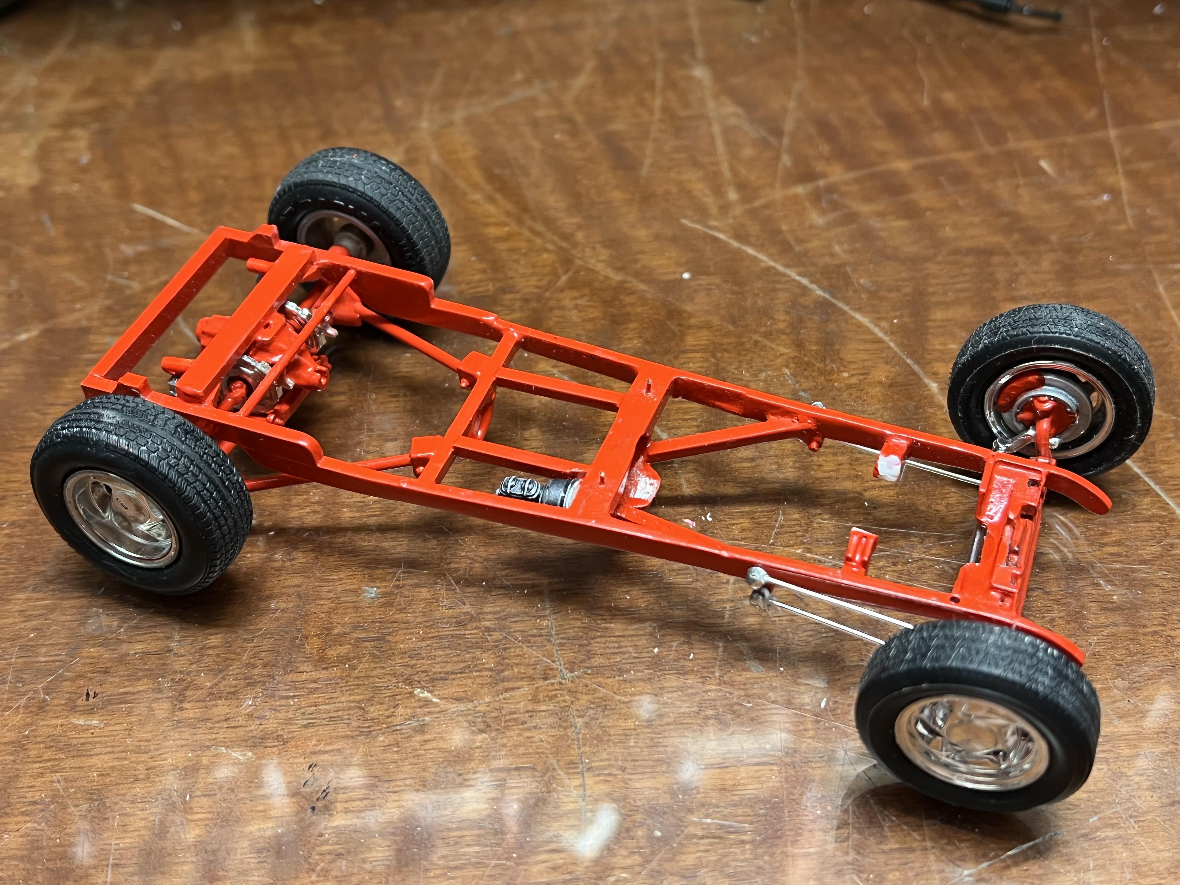

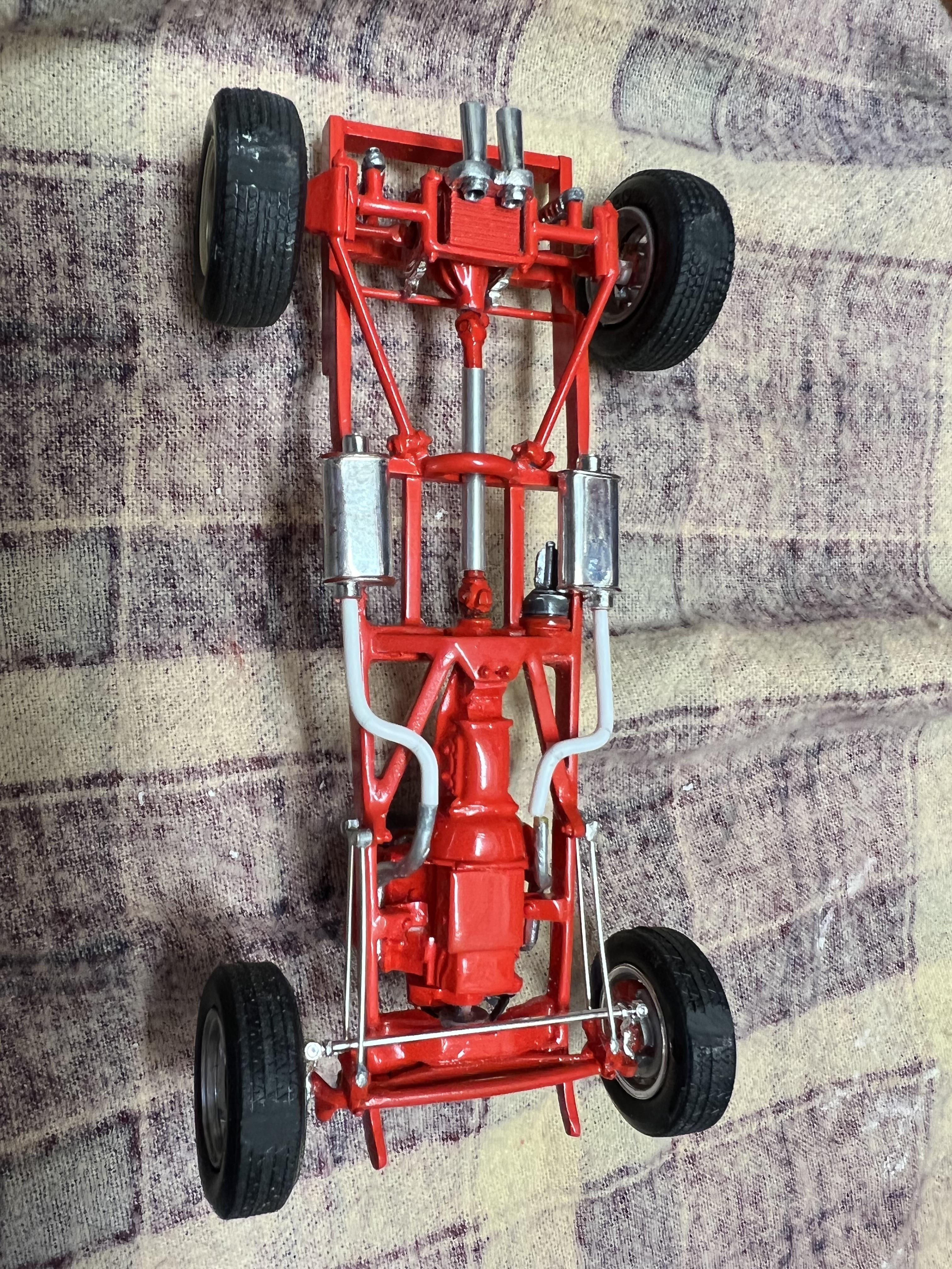

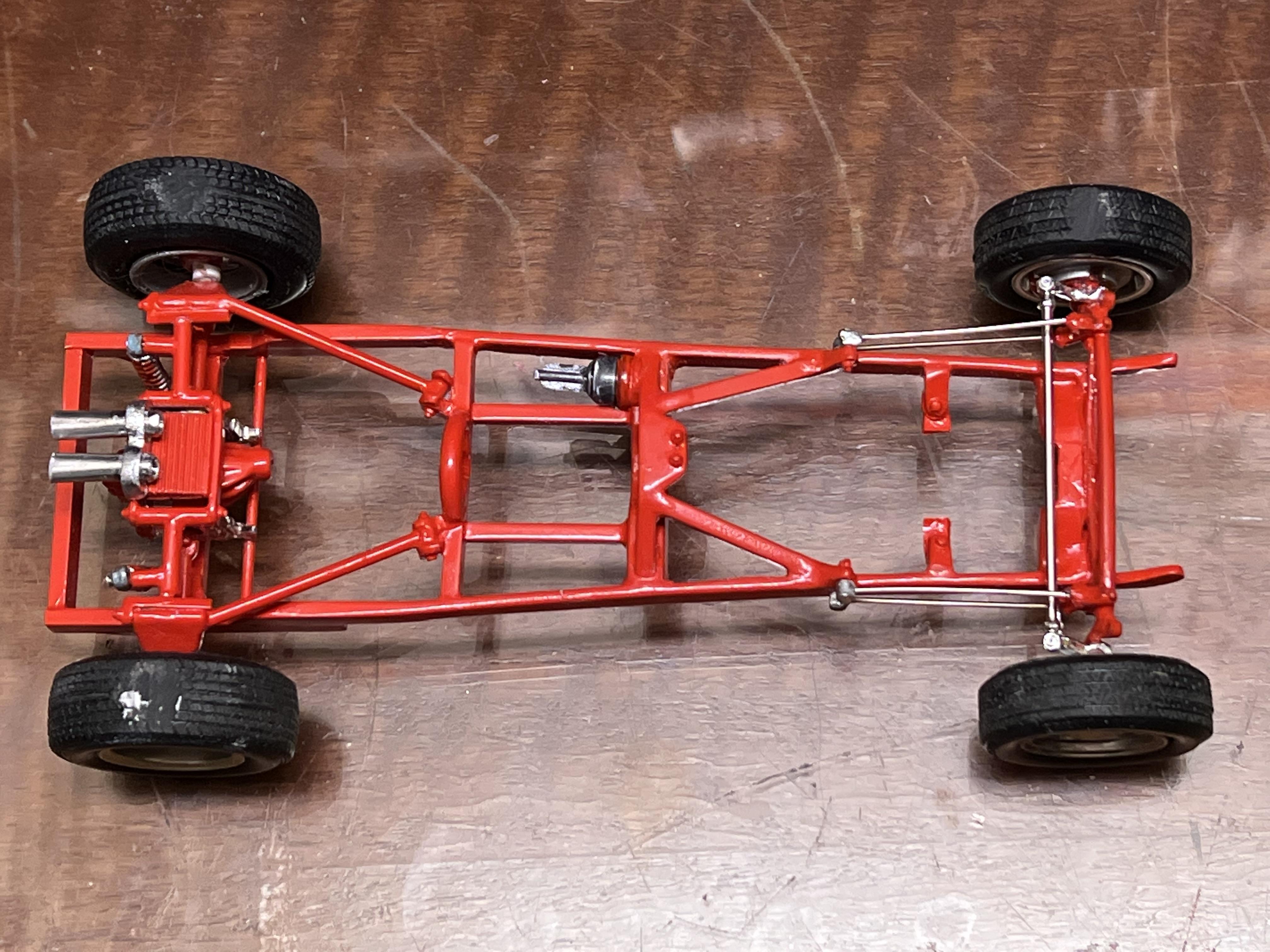

First off, I think Pete's paint job just lifted the bar for all of us! Wow, is that going to look amazing. Had a slow and steady day today. The pillars are repaired and the doors are hung so tomorrow I will get the pillars repainted and put them aside to dry. I dropped the chassis onto the fender unit this evening and spent a long time working out how to run the exhaust. As I did so, I realised how close the layout of the crossmembers is to my own 1:1 in the garage - and the mufflers have ended up in nearly the same spot. The real ones are actually canted slightly so that they tuck up under the valance panels but on the model flat above the frame rails will work fine. Letting them set nice and solid overnight before connecting up the pipes. Those mufflers are off the ZZTop 33 coupe, again, almost identical to my real ones except both my outlets are offset, not one end central like the model. Finally put a decal on one door before I head for bed. It may not stay on the car - it was ultra fragile and started to tear but worse still, had a film underneath. I have been known to wash that film off but it will never happen on these ones. I have used some Micro Set ( but no Microsol afterwards ) and will see if it dries clear in the morning. If not, they come off. Cheers Alan

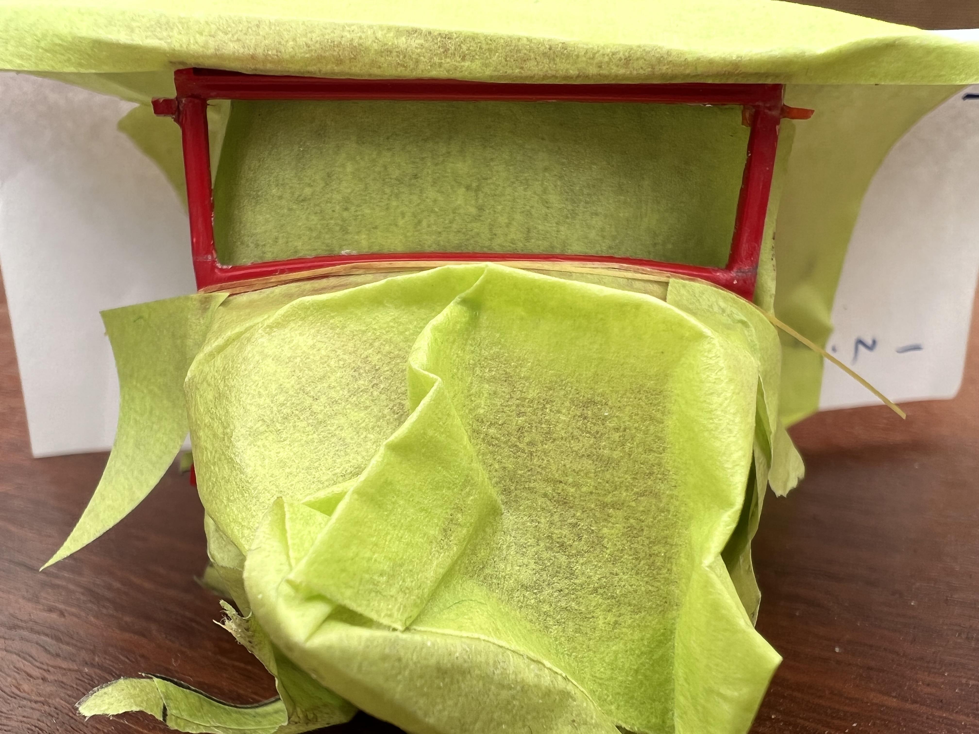

Thanks guys, I am not giving up! Progress today has been OK. The pillars are glued up and I am using sanding pads to bring the muck around the joint back down to level. Then I will mask off all but the windshield area, paint it and quickly (and carefully!) remove the tape so that hopefully the paint edge blends in as it dries. It will be what it will be. I did get one door hung but wouldn't you know it, a plastic pin broke -surprise, surprise - so I drilled out that hinge and put a steel pin in to replace it. Meanwhile I got the exhaust hanger glued in place and the exhaust headers painted and glued to the block. They are modified hemi ones, from the 53 Ford F100 I think. I don't think I showed the underside of the fender unit but I tried something new that I am really happy with. The bottom of that fender unit took a LOT of bodywork and was not very crisp so I thought I would try for a texture like sound deadening or bed liner. First, I sprayed primer on from quite a distance. I then sprayed the Tamiya red on, virtually letting a red cloud float through the air and fall on the plastic. Finally, I did the same with flat clear. I am VERY happy with the results and will probably use it again in future. In the last photos that I posted of the engine I wasn't very happy with my paint detailing of the Ford Motorsports rocker covers so I stripped them, ran Tamiya panel wash on the fins and then lightly sprayed red over the top. Definitely an improvement. So here is where we are now as I wait for some stuff to dry. Cheers Alan

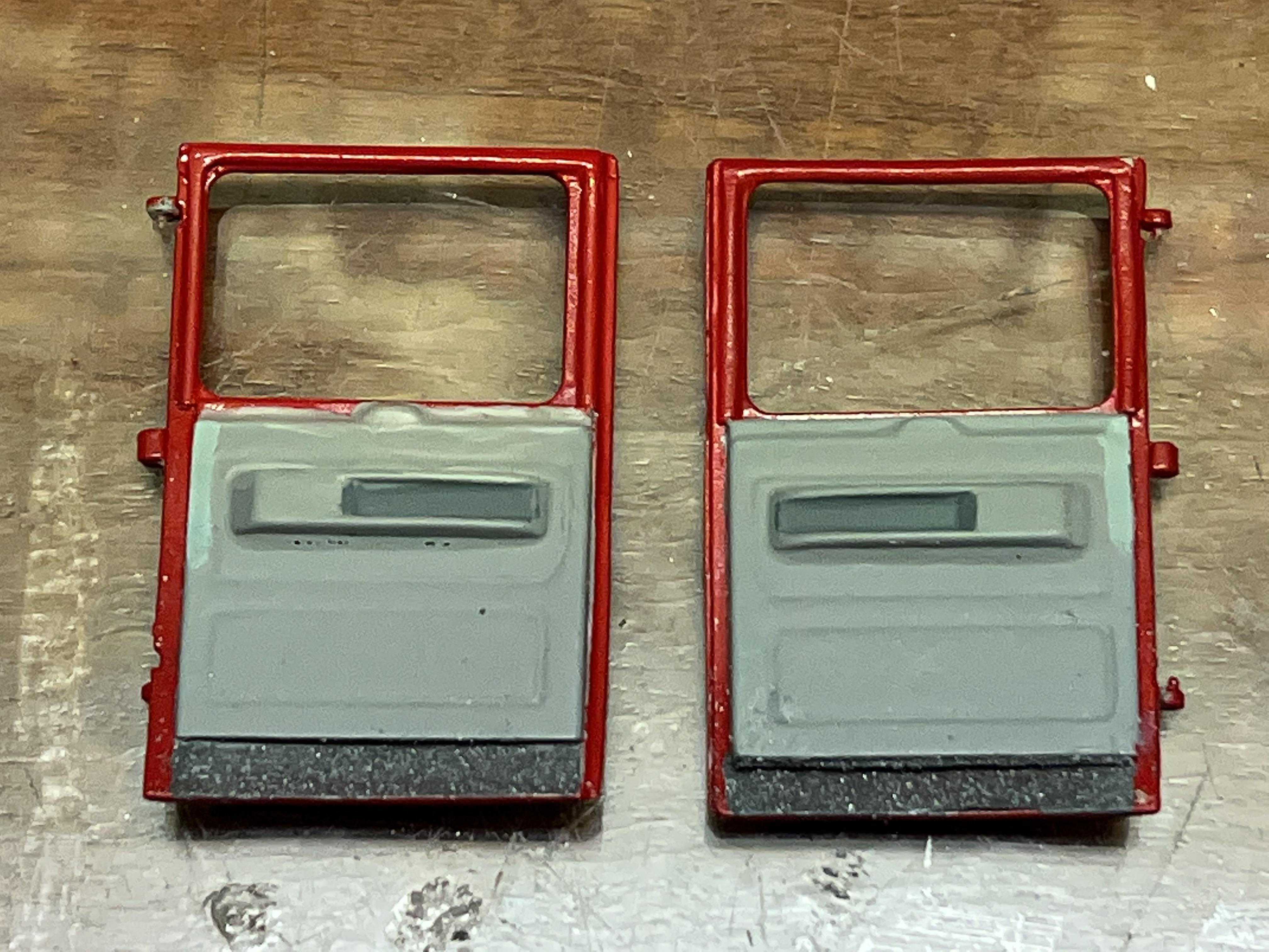

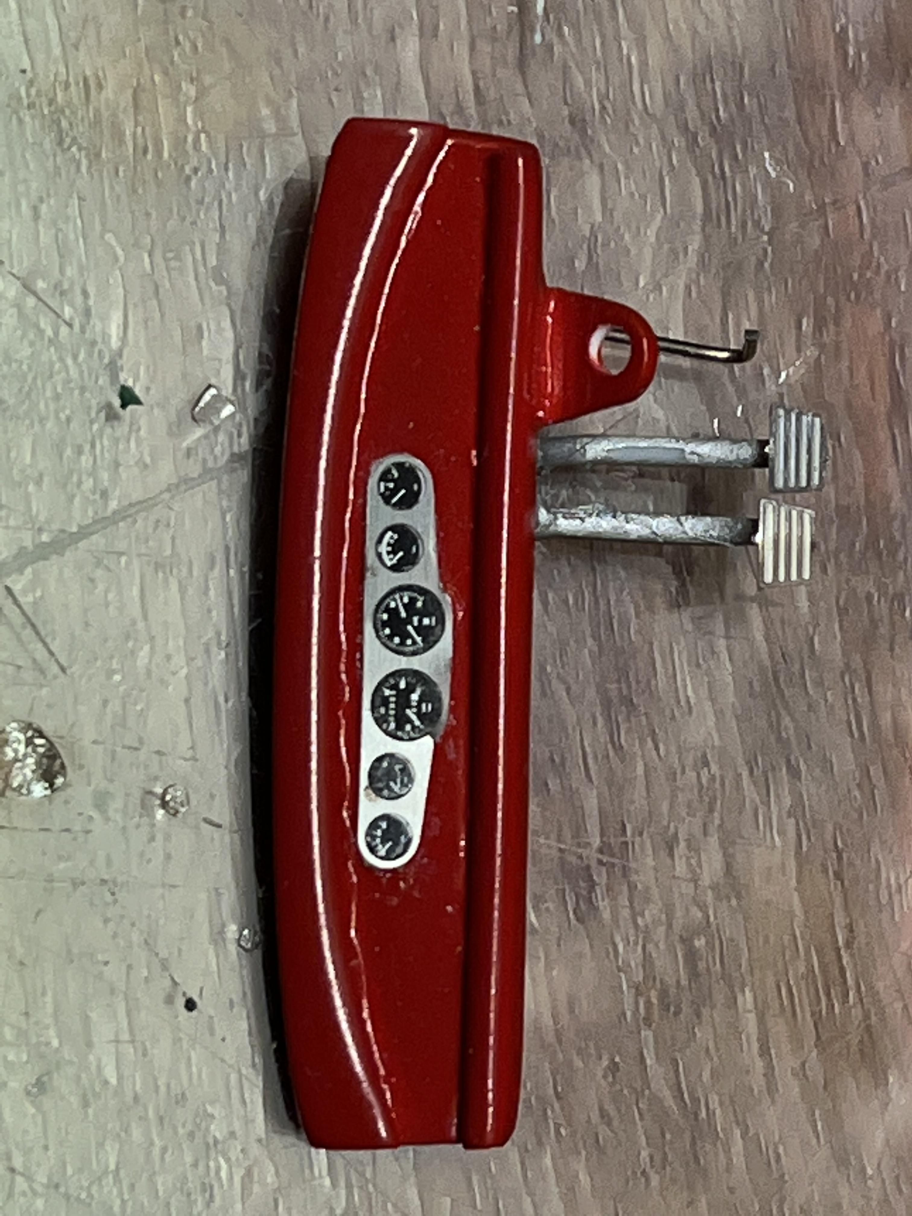

Thanks for your encouragement Tim, it means a lot, even more right now. What a day! I finished touching up the four bars today and then made an exhaust hanger to go under the Jag rear end. Hope there are no speed bumps at the fairgrounds because I reckon it's only got two inches of ground clearance there but hey, ground clearance can be over-rated, right? I then decided that I wanted to get the cab finished. Turns out that with a bit of shaving of the door panels the doors will close without touching the dash. This is a lot nicer solution than trying to cut the dash up. I then added some carpet to the bottom of the doors and got the door handles glued on. There were marks I hadn't noticed before on the windshield so I made a new one and glued it in place. There were some small glue marks on the rear window so all I needed to do prior to final assembly was clean those off and I could hang the doors. And then it happened. The windshield pillars collapsed. Both of them. I had polished the roof earlier today, being ultra careful and my efforts were rewarded. And yet now, with only the tiniest pressure, everything has gone south. For now, I have glued the pillars back together and will leave them overnight. I hope to do some very gentle sanding followed by awkward masking and painting will get the repair as discrete as possible. We used to have a phone company advert here in Oz where a clearly upset lady trying to be calm utters the phrase, "Not happy, JAN!" That's me right now. So here's a happier couple of photos of the interior, a pair of buckets from the Dan Fink Speedwagon and a console cut form the ancient AMT Mustang II interior. The dash is scratchbuilt with photo-etched instruments and pedals - yep, she's a four speed! In the last shot, the left hand pillar is already glued back and the right hand one is hanging on by the thickness of the paint. We will see what I have in the morning. Cheers Alan

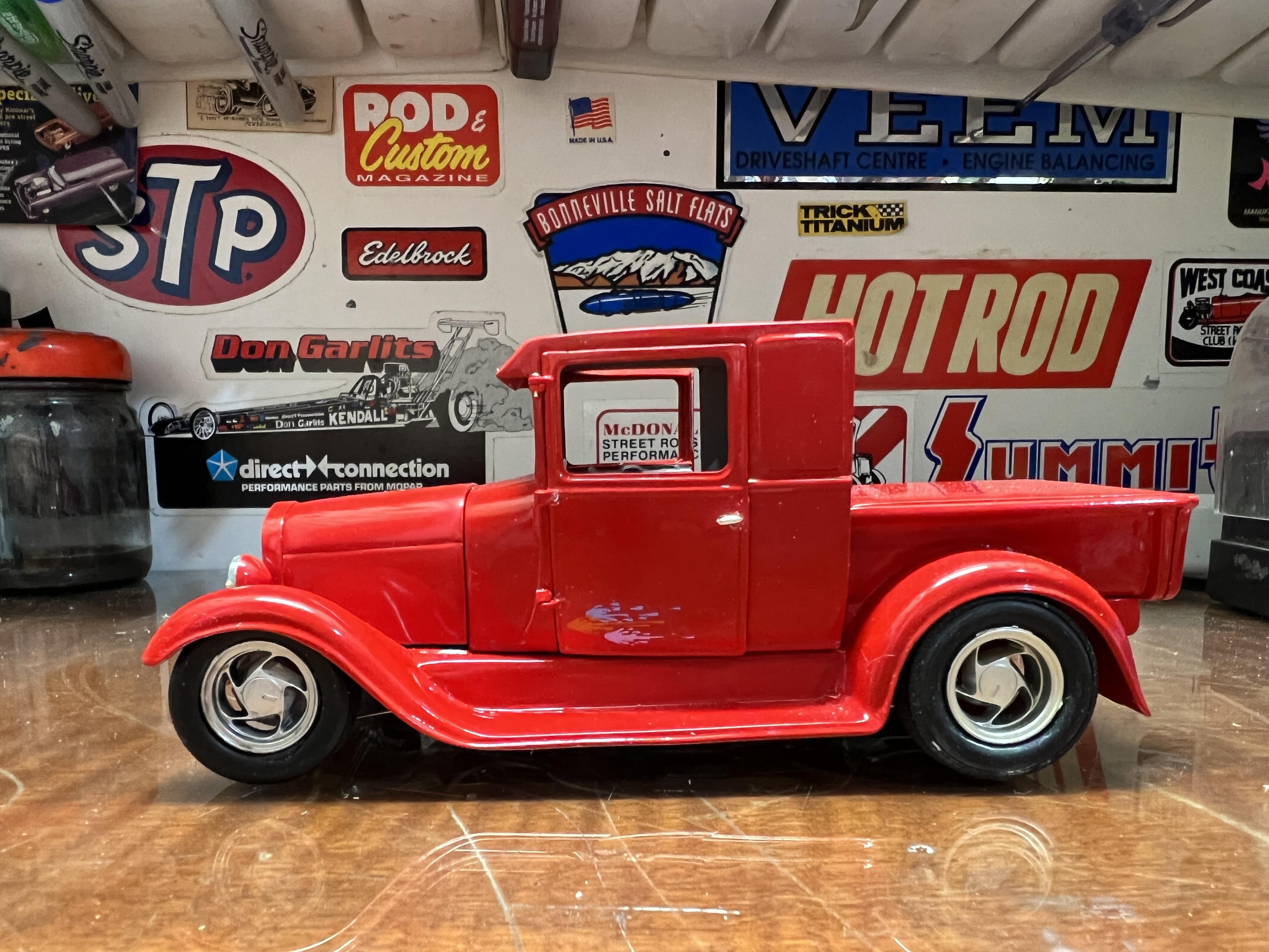

As requested by Tim Hoffman & Others....1931 Model A Closed Cab Pickup
alan barton replied to tim boyd's topic in Model Cars
I remember the article well, Tim and have plans to refer to it later this year to build my own pickup. Looking back, would you see any advantage in cutting off a slice form the back of the sedan delivery kit or would you still do it the way you did back then? I really admire the accuracy of your masking, as kill I am still l trying to master after all these years. Overall this is such a nice, balanced and totally believable pickup. If I build a 27 T, 32, and 35, 37 and 38 to go with my 29, 34, and 40 I will have a nice little time line of early Ford pickups. Re-reading that, it looks ridiculous because only three are built and I need six more to achieve my goal - oh well, that is what retirement is for! Cheers Alan -

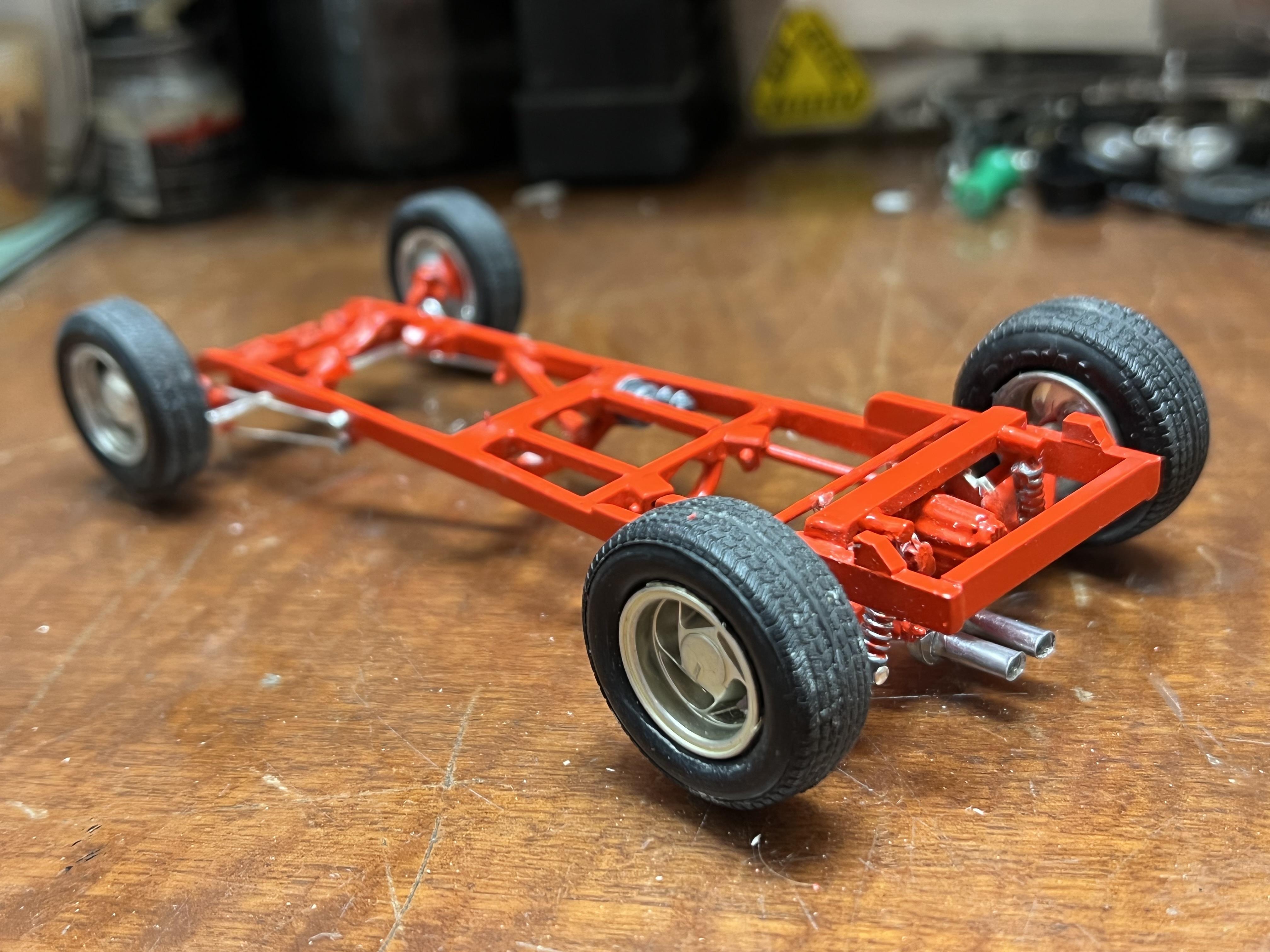

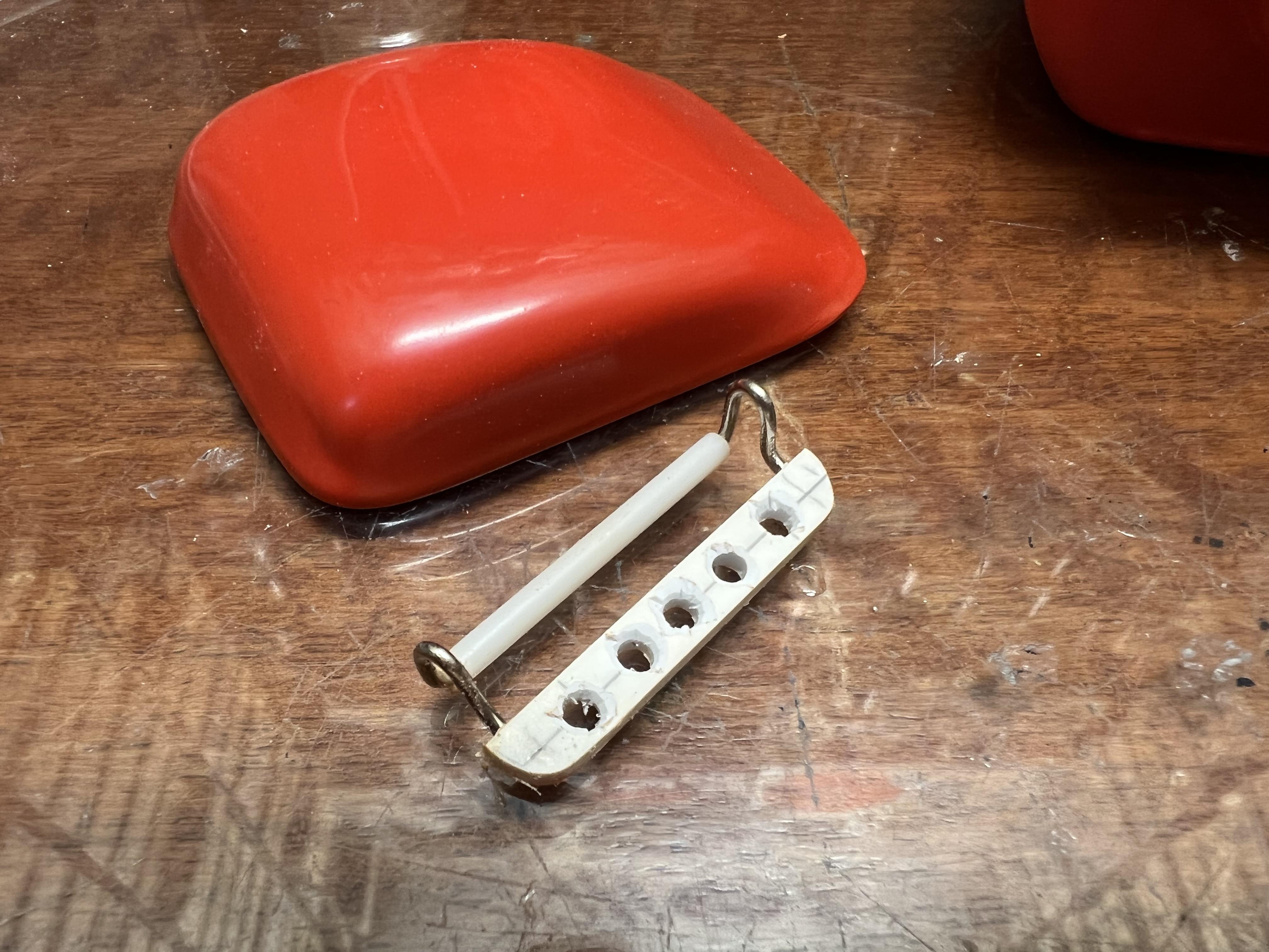

Thanks Carl! Thanks for the re-assurance Bob. It can be a bit overwhelming at times, when you put a lot of heart into a car and it bites you. Anyway, all good now. Got the four bars finished last night. I drilled a small hole into the centre of some Evergreen #222 and then cut small slices off to make bushes. Then drilled another hole at right angles. I found some thin aluminium pins at a craft store. The ends with the heads make the bolt going through the bush while the long shaft obviously makes the four bar. I few drops of superglue and they looked fine. I am going to leave them shiny because although this is a monochromatic car, a little bit of bling never hurt anyone! Exhaust is next. Cheers Alan

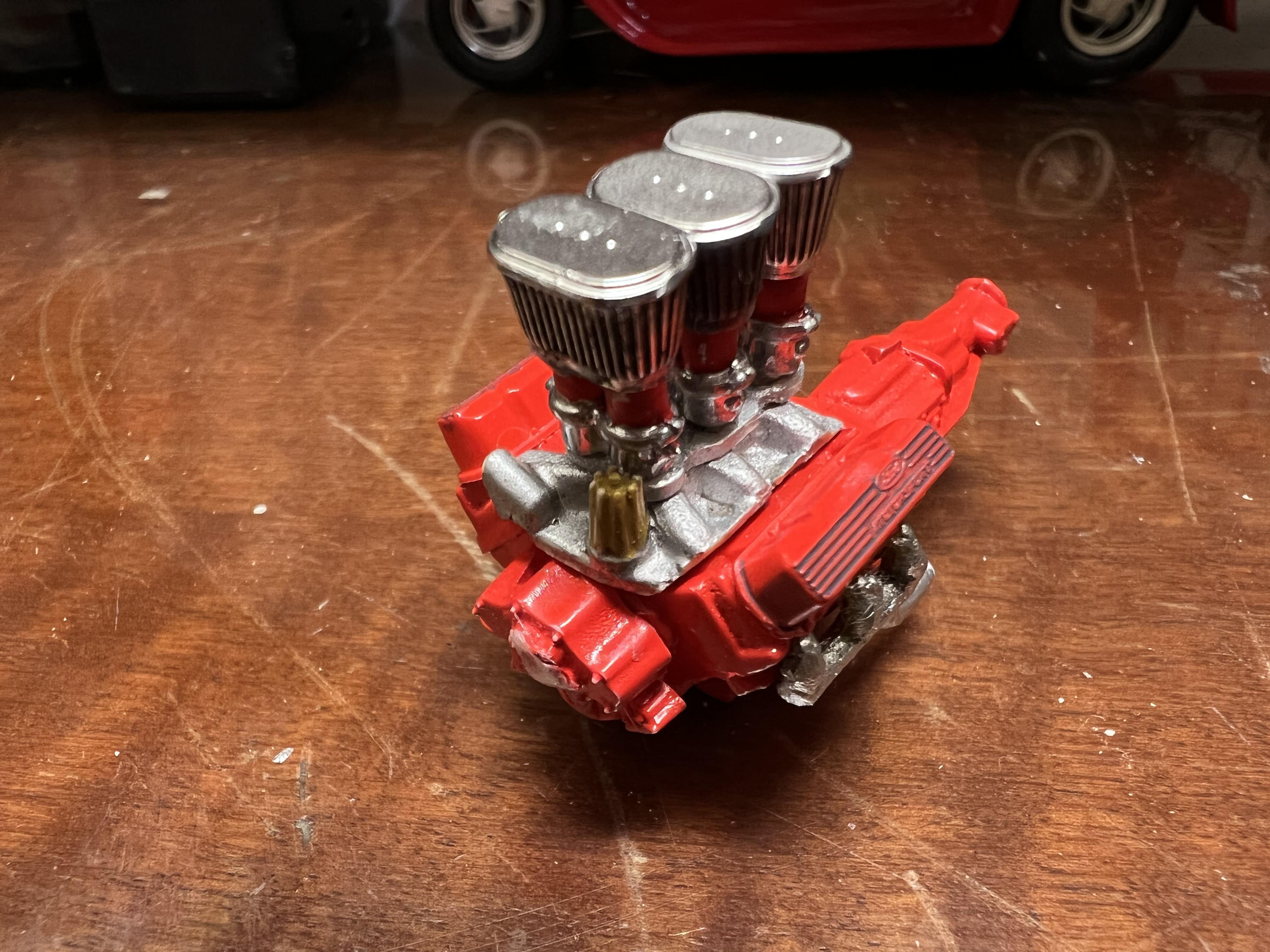

Glad you could join us, Tim! That flathead is righteous - I would never have thought of drilling out all the headbolts - talk about dedication. With that trick flip front hood and cut radiator shell, this could have easily been built in the eighties so it is a perfect fit with the whole theme. The more the merrier! Cheers Alan
