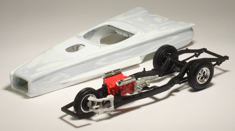

It's starting to look like a car (presuming a 3-wheeler is considered a car). The hood will be cemented in place. So, the model won't have any engine parts that can't be seen from underneath. The block was painted Model Master Ford Engine Red while the trans is Model Master German Silver + Dull Cote. The stock 1960 Ford engine would have been black but that would have been too dull. The front suspension was built using a Beatnik Bandit front wheel and brake plate, a spindle and bits of A-arms from the AMT '60 Ford kit and swingarms made from pieces cut from a Revell '68 Charger kit roll cage. The coil spring source is unknown and the shock is from the AMT '53 Ford pickup. At the rear, the wheels are from an AMT '39/'40 Ford sedan kit and the tires are from an AMT '66 Riviera with the whitewall inserts painted flat black and turned inward.

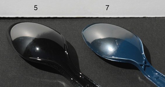

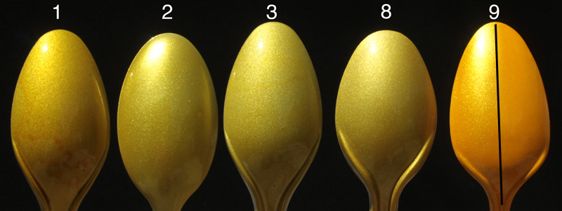

Spoon tests. Scroll down to see the colors that were used. Some close-ups of two: 1. Clear spoon Tamiya Fine Surface Primer (L) White 87044 Model Master German Silver 2914 Tamiya X-24 Clear Yellow, diluted, 30 psi Badger 150 Testors One-Coat Clear Lacquer 1834 2. Clear spoon Tamiya Fine Surface Primer (L) White 87044 Model Master German Silver 2914 Createx Pearl White 5310, from bottle, 40 psi Badger 150 Tamiya X-24 Clear Yellow, diluted, 30 psi Badger 150 Testors One-Coat Clear Lacquer 1834 3. Clear spoon Tamiya Fine Surface Primer (L) White 87044 Model Master German Silver 2914 Silver flake in clear gloss, 40 psi Badger 150 Tamiya X-24 Clear Yellow, diluted, 30 psi Badger 150 Testors One-Coat Clear Lacquer 1834 8. White spoon Testors 1214 Gloss Yellow 1214 Model Master German Silver 2914 Tamiya X-24 Clear Yellow, diluted, 30 psi Badger 150 Testors One-Coat Clear Lacquer 1834 9. Clear spoon Tamiya Fine Surface Primer (L) White 87044 Testors 1214 Gloss Yellow 1214 Left 1/2 of spoon: Createx Pearl White 5310, from bottle, 40 psi Badger 150 Right 1/2 of spoon: Silver flake in clear gloss, 40 psi Badger 150 Tamiya X-24 Clear Yellow, diluted, 30 psi Badger 150 Testors One-Coat Clear Lacquer 1834 Here are some with faux plating. The powder is rubbed into the surface then lightly polished with a cloth pad. Here's a link to the manufacturer: http://www.c1-models.com/c1-metalizer/ . These are my first attempts at using it. It's a nice "black chrome" finish. Their website shows it as a more natural chrome when used over a brighter blue base coat. This photo was shot outdoors at mid-day. The white card in the background is vertical and is reflected in the spoons. 5. Clear spoon Tamiya Fine Surface Primer (L) White 87044 Model Master Gloss Black 1947 Upper 2/3 of spoon: C1 Metalizer 7. White spoon Model Master Blue Angel Blue 1972 Testors One-Coat Clear Lacquer 1834 Upper 2/3 of spoon: C1 Metalizer

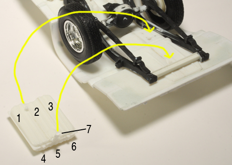

Two-piece fuel tank balloons to seven when minimized! Because of the narrowed frame, the stock tank needed to be modified to fit. The two tank parts were cemented. Since there is detail along the centerline that meant making four parallel cuts and discarding the resulting extra sections. That makes six parts. An extended fuel filler made from .080 styrene rod makes it seven. If I were to add straps, not likely, between the tank and the floor pan the count would be up to eleven.

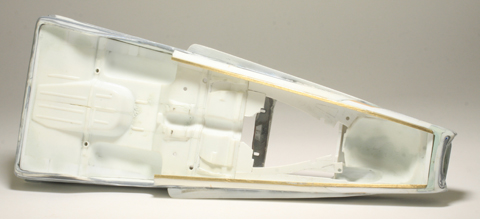

I'm making lots of progress but very little of it shows. Here are the floor pans (front and rear are needed for assembly reasons) test-fitted into the body. Each pan is made of dozens of pieces plus more as reinforcements on the unseen top side. It's really a job to fill and smooth the joints. There is still more to do. Lots of other work has been done, too, but it isn't very interesting at this stage. For example, smoothing the engine* seam and giving it a coat of white primer; spraying under colors on spoons for body colors, smoothing frame joints... and on and on. There's plenty of time to philosophize while doing repetitive tasks: How good is "good enough"? Is "done" with some boo-boos better than nearly perfect, so far, but uncompleted? Why am I doing this? The model was just supposed to be a curbside with a dramatic customized body. It's not an award contender and won't have details like brake lines and hose clamps. Still, it shouldn't look unfinished but I never expected to spend so much time on things that will probably never be seen by 99% of people who will look at the finished model (see philosophy numbers 1 and 2 above — is this circular reasoning?). *and remembering too late that the '60 Ford kit has a manual transmission but to operate with the Beatnik Bandit joystick control (no steering wheel, shift lever or pedals) it would have to be an automatic.

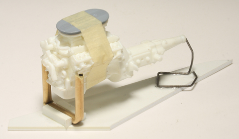

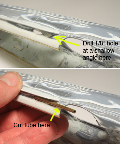

The side wing-fins will have an exhaust pipe exiting from the rear. I've filled in door lines scribed when I thought that I wanted them. Now, the driver and passenger will have to hop in "sports car style" as on the original blue model. Here's an engine stand built from sheet plastic, brass tubing (with notches at the top to fit the engine mount "ears") and some steel wire extending into the rear of the trans. The taped-together engine was needed to locate the frame to the body. Still to be done will be to use the mock-up to locate a hole in the yet-to-be-made hood. There's five weeks left to finish this model. This one is behind because I spent too much time working on a second radical custom I was hoping to finish. I've stopped work on the second one until this one gets close to being completed. Is anybody else building GSL entries? Post what you're doing so we can see and learn.

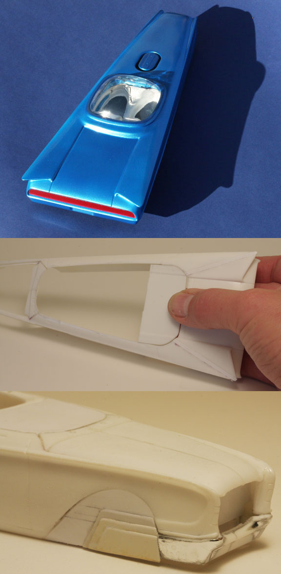

Here's a photo of my first build of it as a curbside in 2011 along with some in-process shots of some of the bodywork. I'm making some styling improvements to the sides but I don't have a mock-up photo to show. Except for color, the photo of the blue car is about how the new yellow version should look from this angle. The interior and bubble top are from Roth's Beatnik Bandit.
