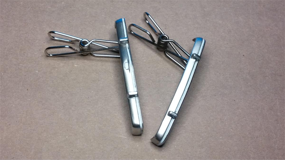

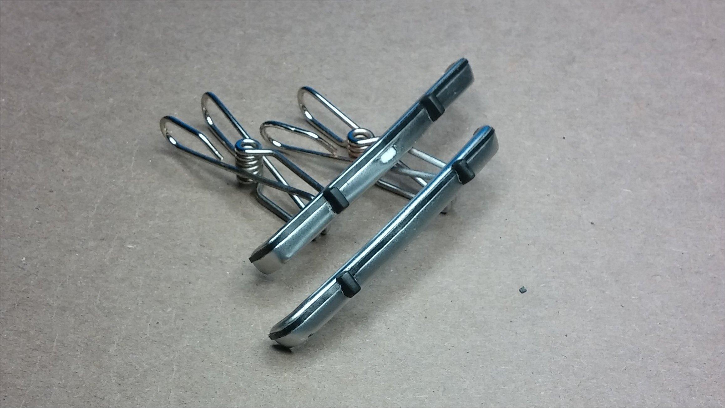

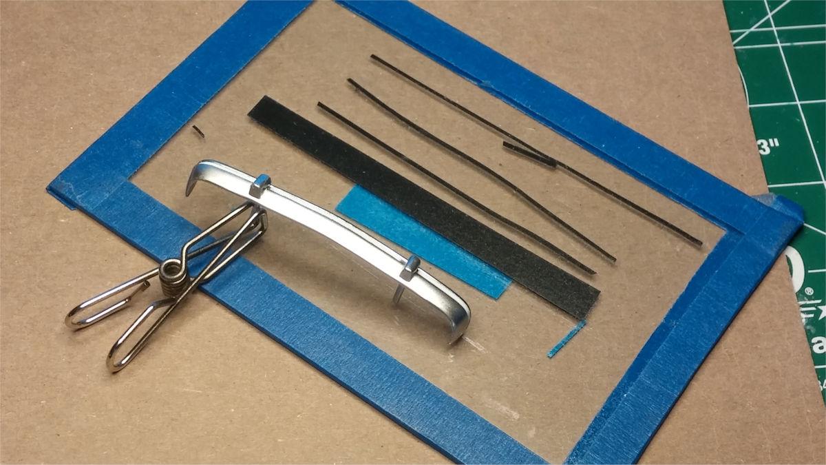

Something is causing problems between Photobucket and the MCM Forum. I've been trying off and on throughout most of today to post a message with four photos and I can only get it to work with two, so here's the rest of the post. OK, minor setback. The clamp (clothespin) slipped while I was setting it marring the chromey paint on the lower panel. I hope to be able to touch it up. At least I can take small comfort in the fact that once the kit is assembled, this area won't be highly visible. I dry brushed some Alclad on to the lower dashboard pieces. Though it's not perfect, I think it'll pass inspection when assembled inside the car. I also added some clear acrylic to the gauges to simulate the face covers. As always, thanks for taking the time to look and feel free to comment. David G.
