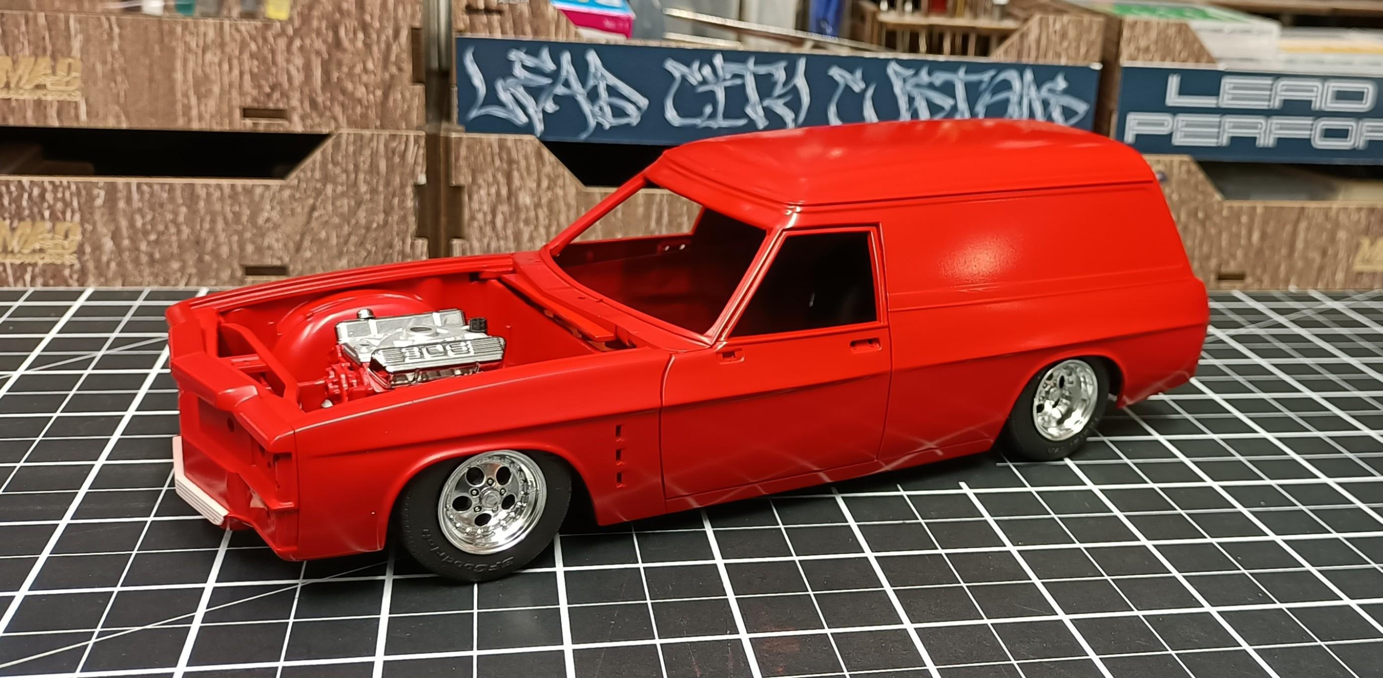

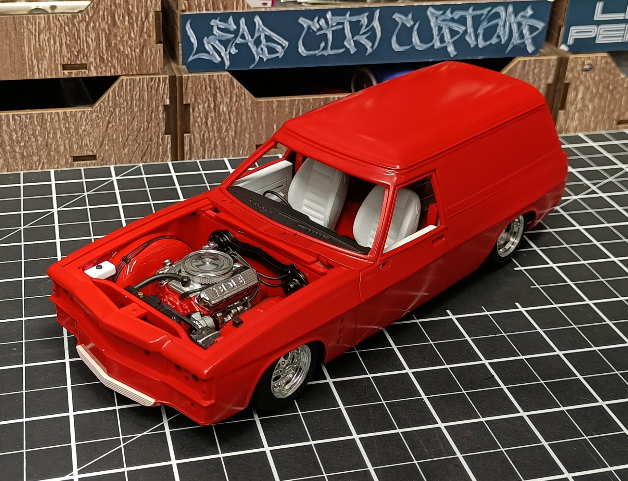

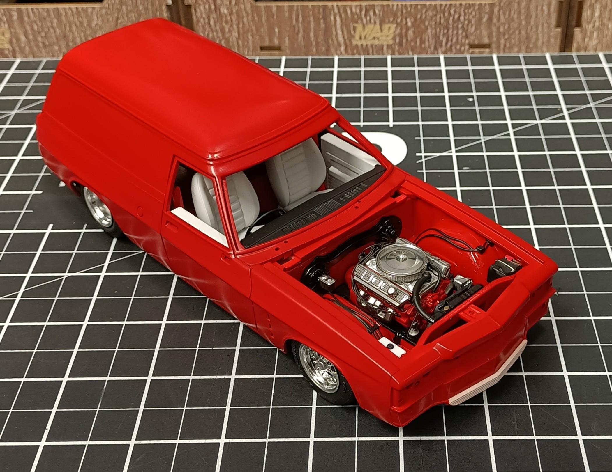

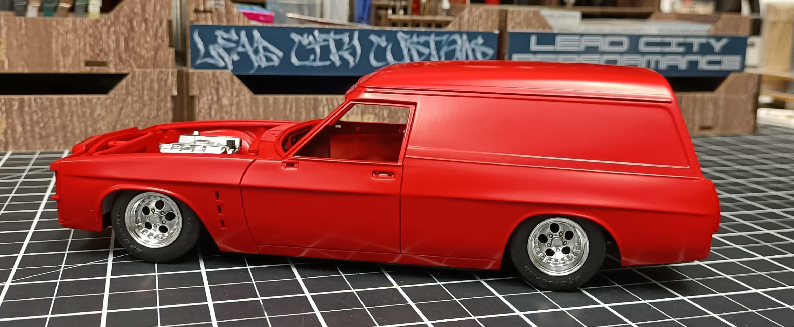

  1. Pano pretty much completed, just needs final once over and clean. And I will install upper tailgate handle after its been cleaned.

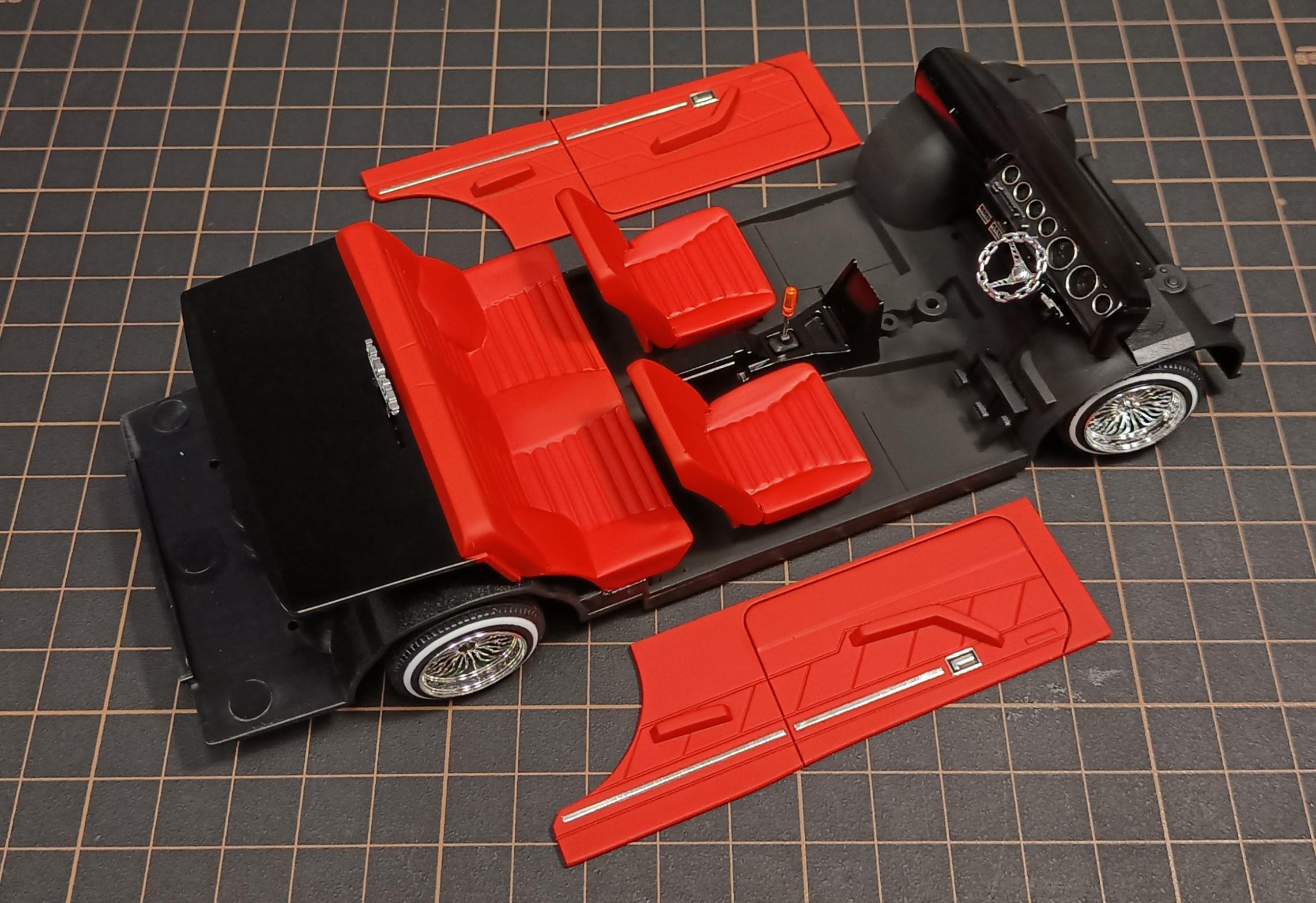

  2. Started some conversion work with the interior for the Custom HQ Holden. Oob. Converted to 2dr and new flat panels to build upon. Thinking some tuck n roll might be the go. And update on the Pano, it has been wet sanded and polished, bmf done, so time for final detail work and assemblies and get it completed.

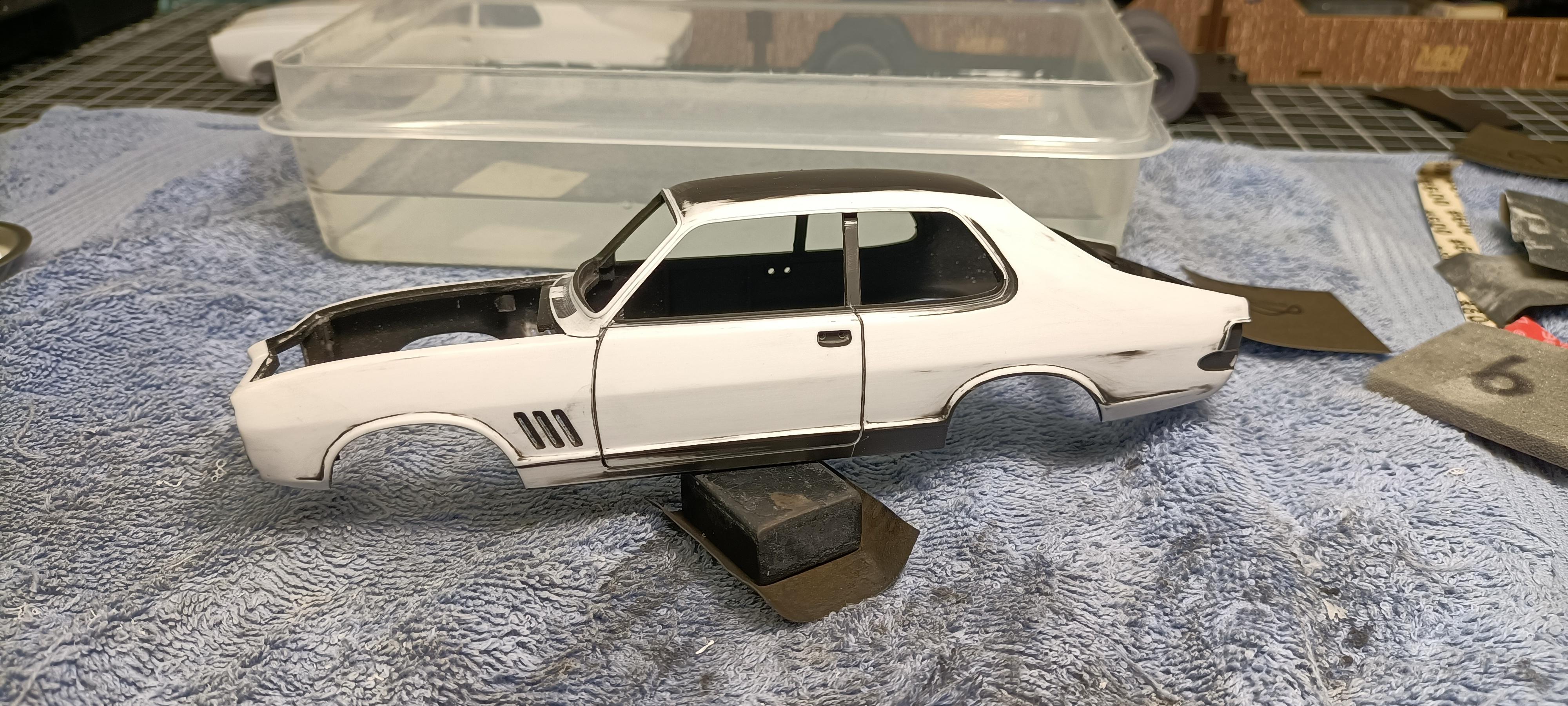

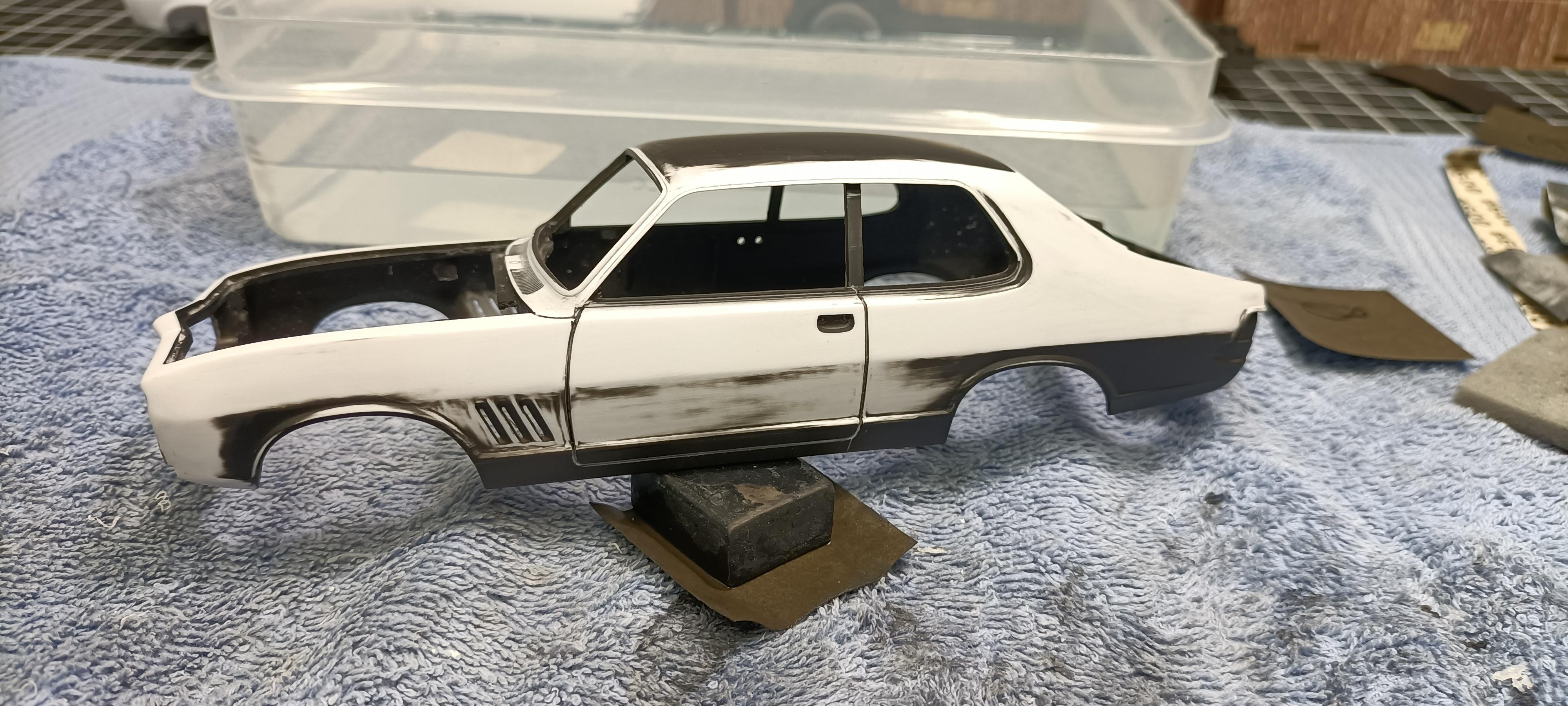

  12. Well thats all the body modifications roughed in, few more rounds of sanding and primer/surfacer 1200.

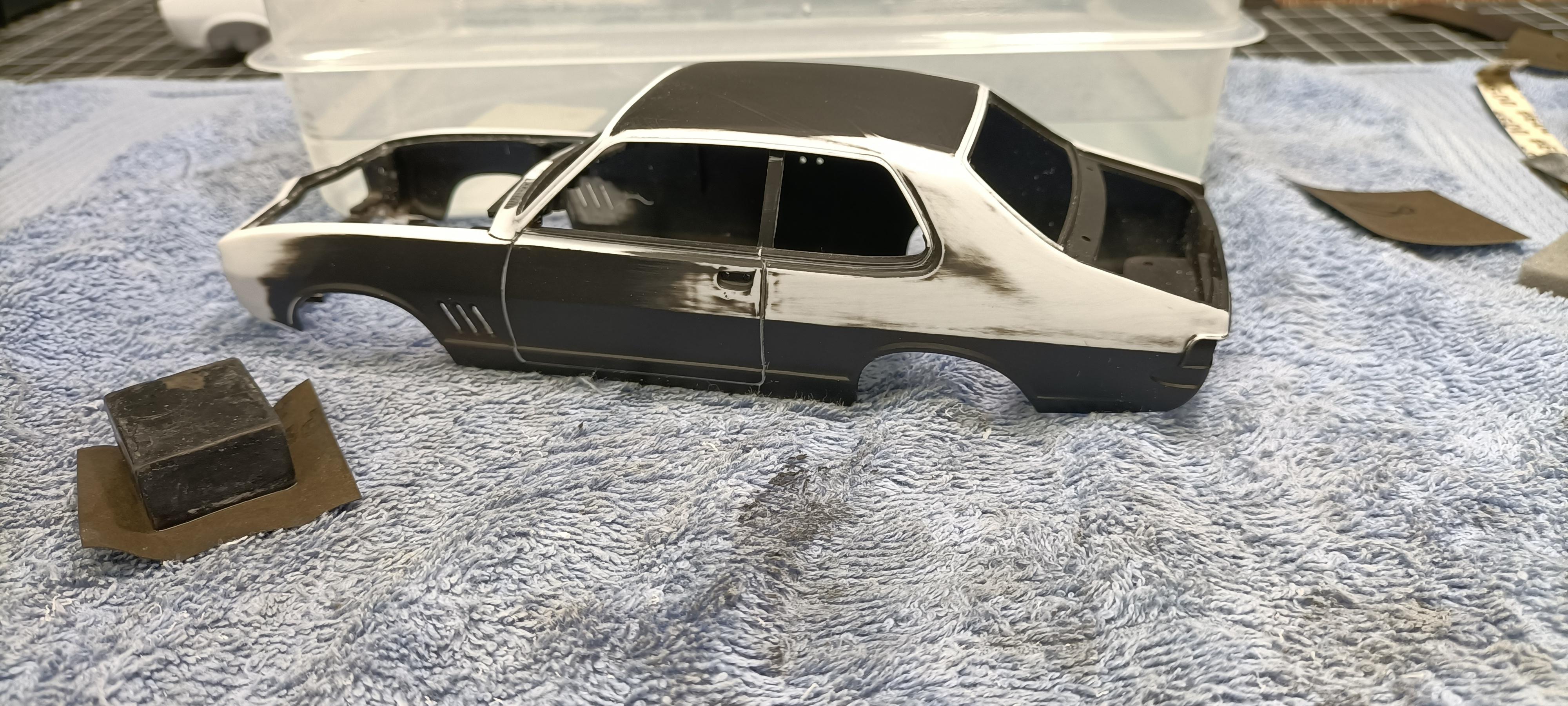

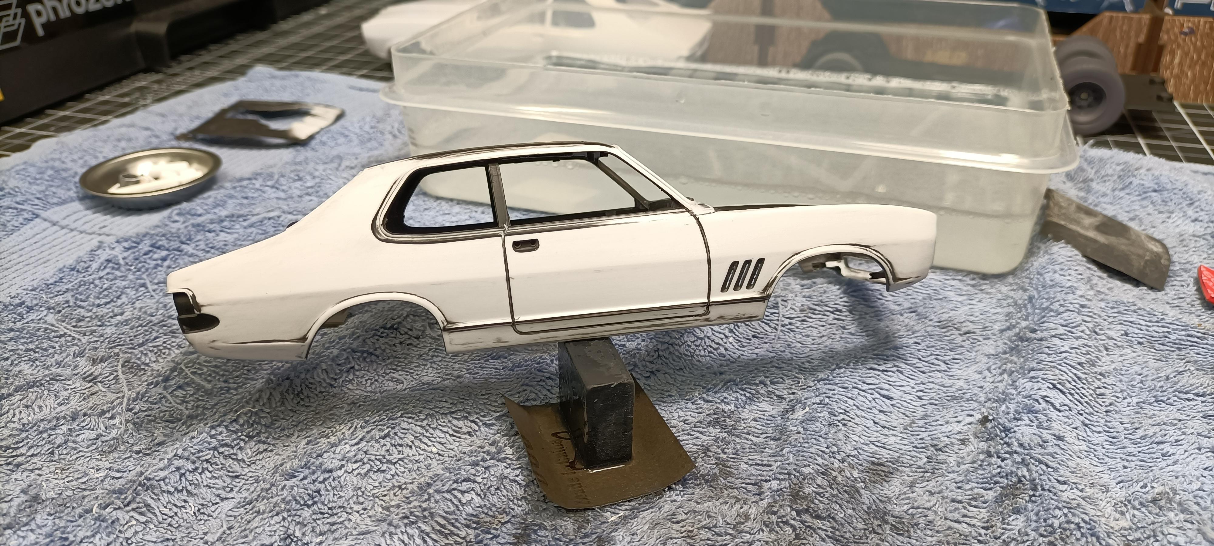

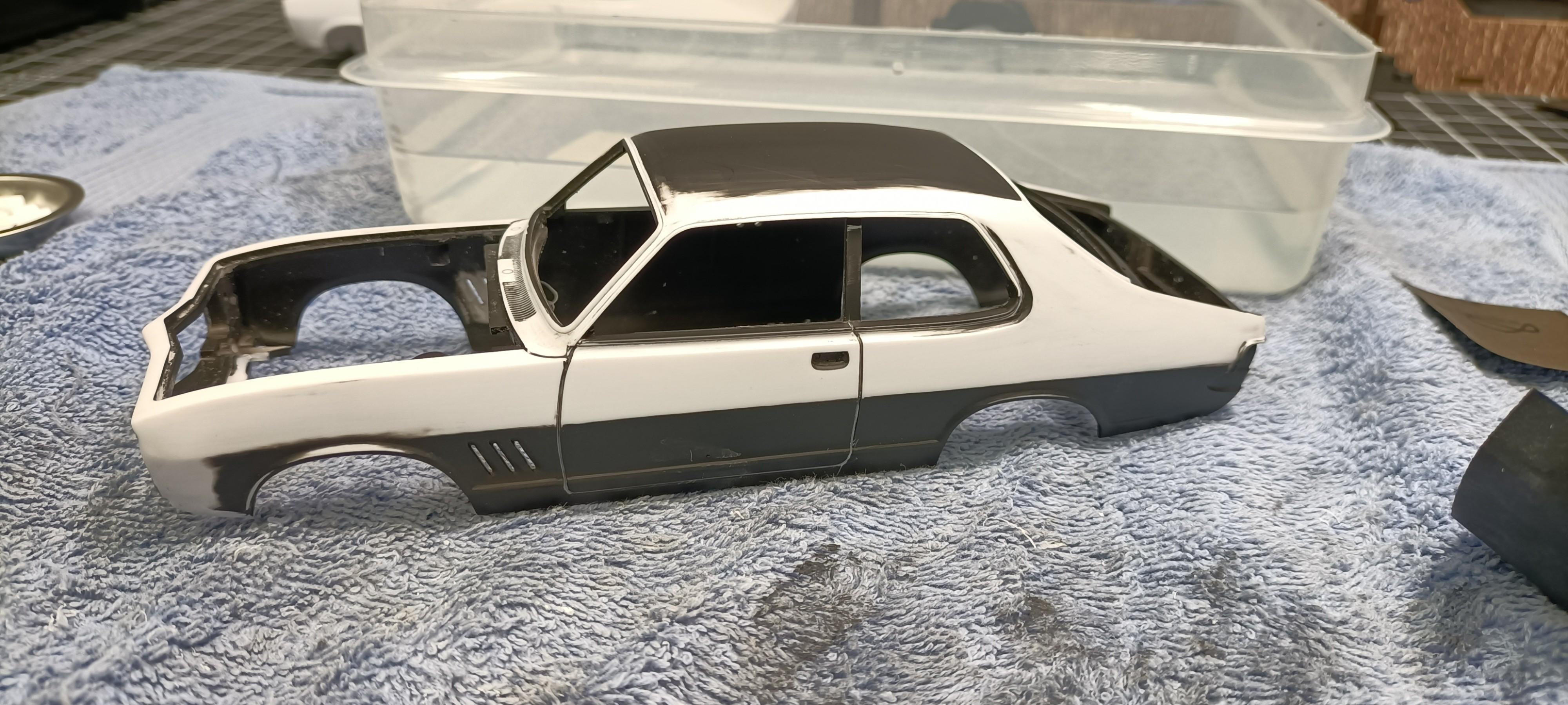

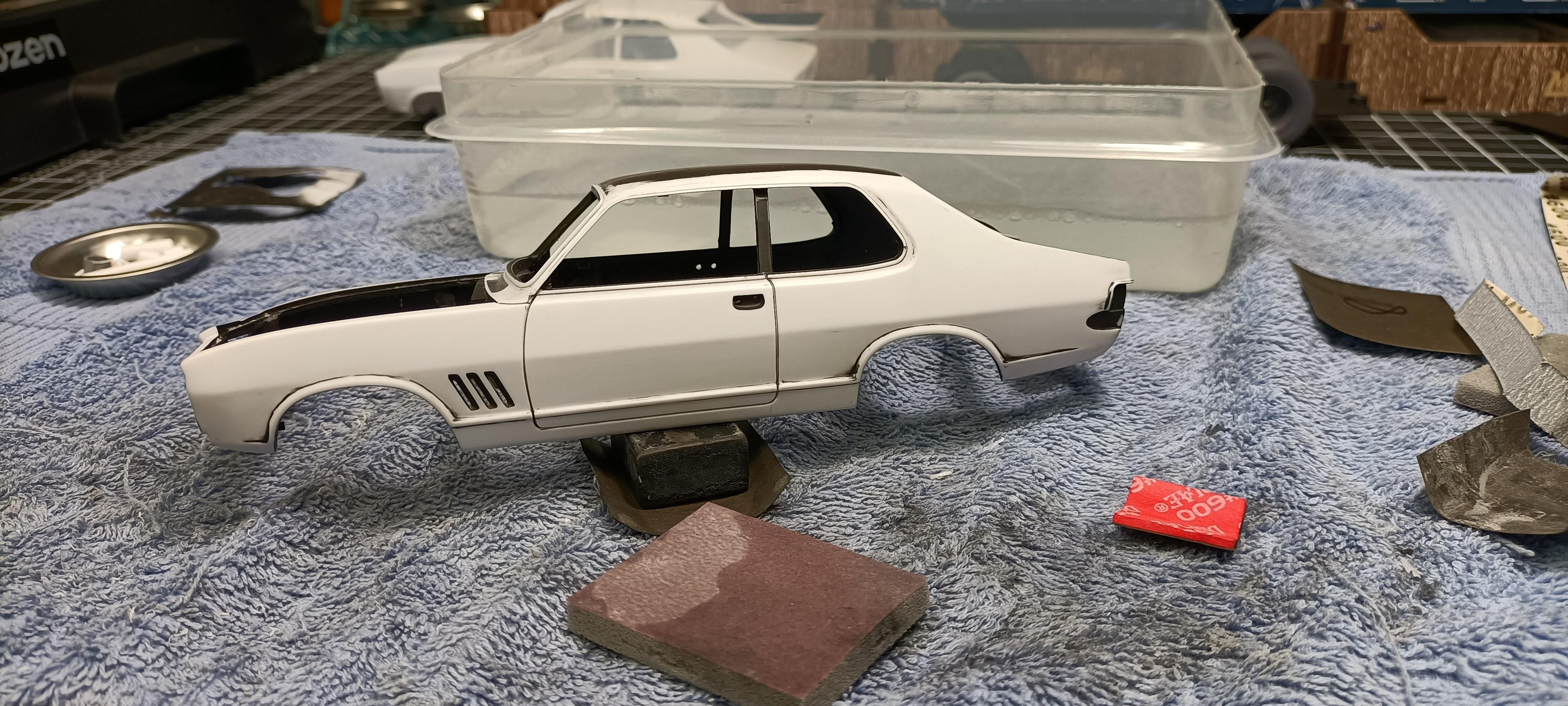

  13. Shaved the trim from around the side windows. Scribed around front window trim, filled the cowl vents, wiper mounting holes and panel lines. Filled front bumper mounting holes, increased the size of the grill opening and grill surround. Now onto rear bumper delete and smooth out the rear.

  16. First idea for the custom HQ done. Before scribing new door lines to make it a 2dr. After. And using same technique I did on the LJ Torana, filled the original door lines with 3D printer resin. Also filled the door handle pockets, side mirror mounting hole and removed the B pillar. DDA collectibles havent manufactured the hard top coupe kit yet, so I made my own 😁 So happy with how it looks so far. Moving onto the the next idea.

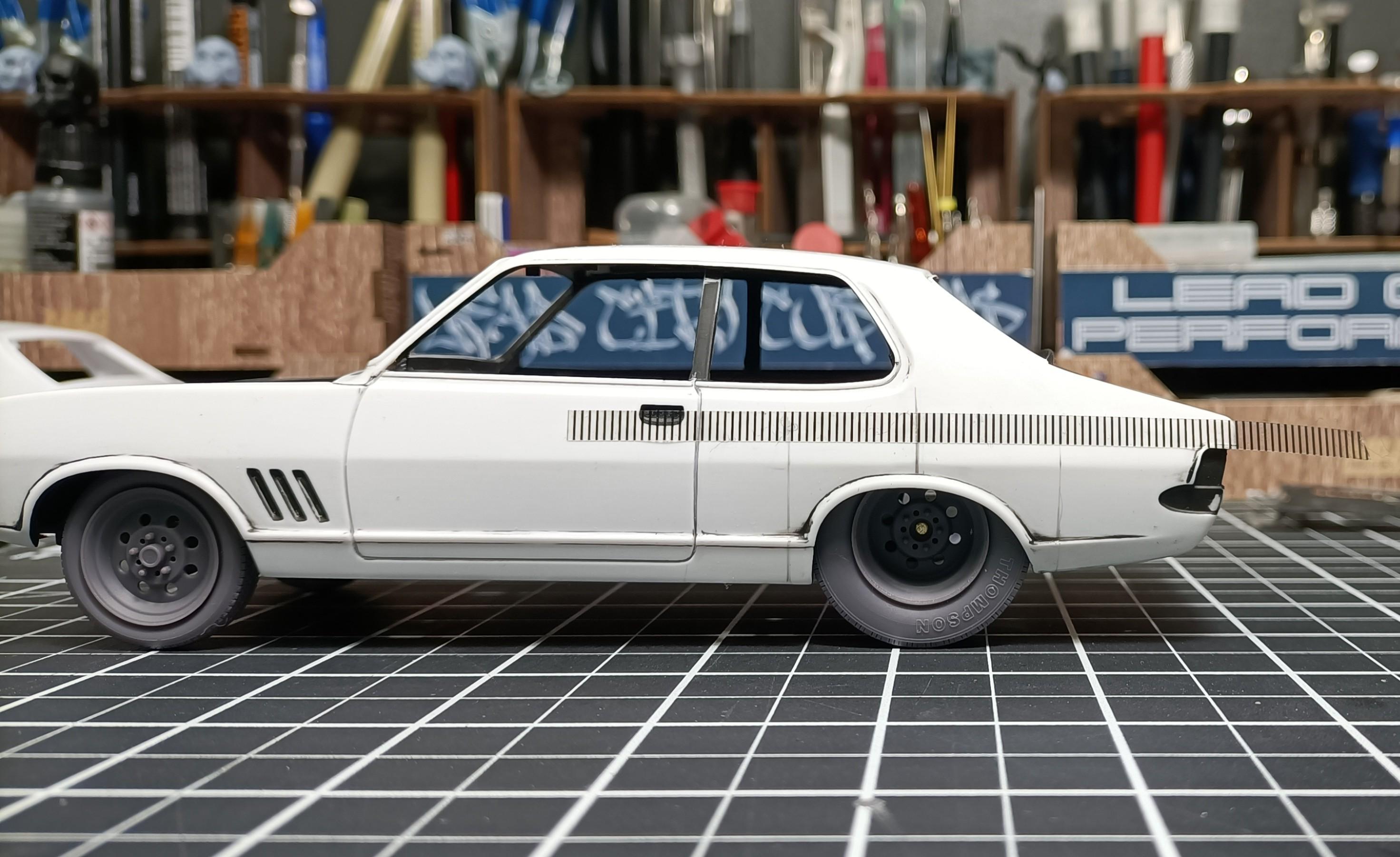

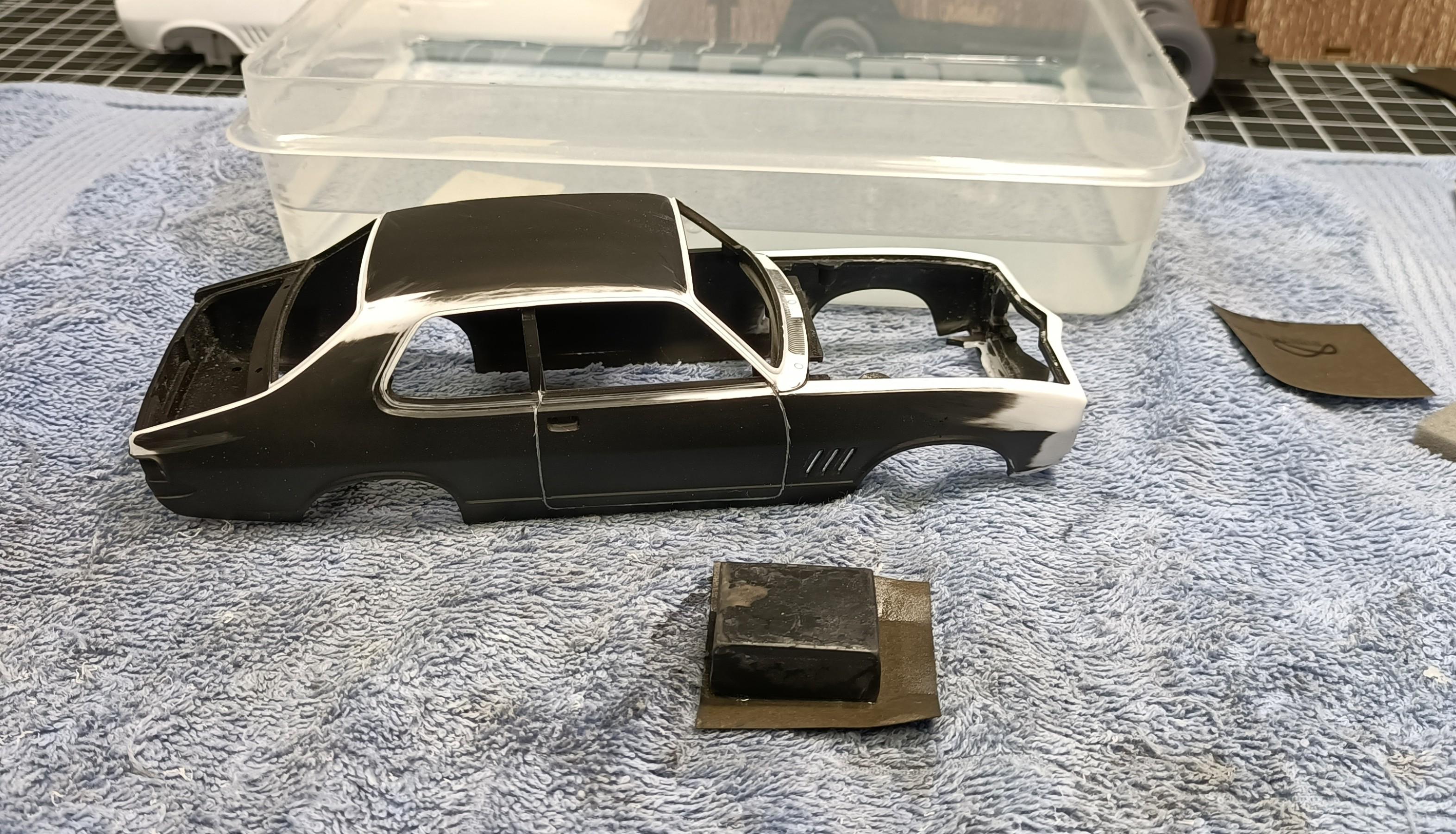

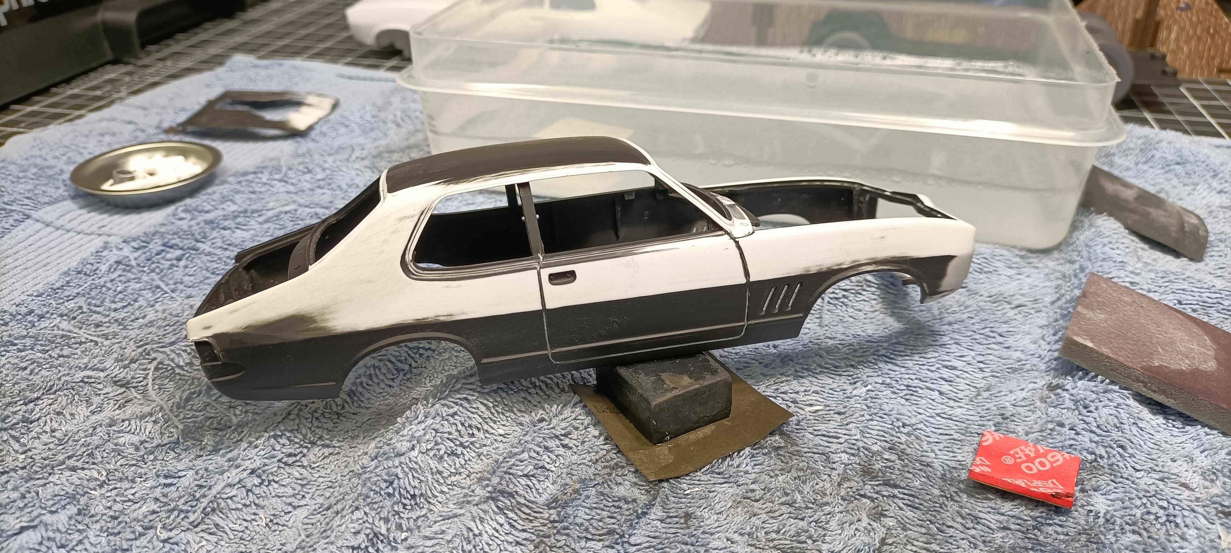

  18. Sanded and applied another full coat of 1200 surfacer. Will set it aside and let it cure for a bit, then come back to it sand again and apply more surfacer.
  19. Thanks Brian. Thanks Mathias, cant take credit for it, I learnt from others. Will see how it holds up I guess Thanks Ken, just copied how they do it on the 1:1's, hardest part was sanding the styrene to shape that was used to fill the gap.

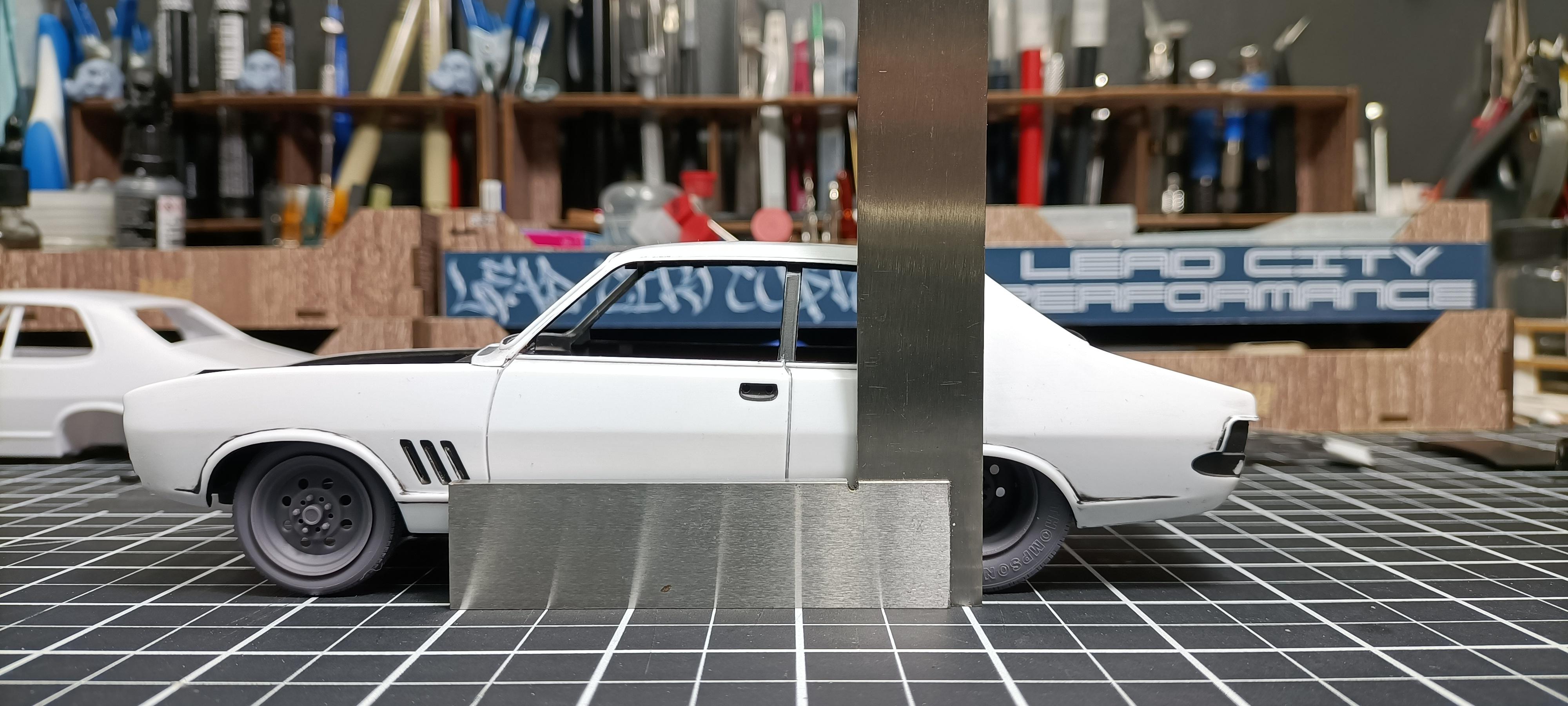

  20. I can totally relate with troubles applying bmf, thats why I always take the time scribe around pretty much all trim. It a tedious task but makes trimming the foil so much easier. Reasons I started doing it, I was having trouble seeing the trim edge after I applied the foil and also after a few layers of primer, paint and clear the trim edge loses its sharpness and makes it hard to guide the blade. And 2K clear is high build which can bury the trim and you lose the edge to guide the blade. I experienced that on a couple builds and its why I prefer not to use 2K clears. Davids recommendation of using the masking is certainly a great technique that works very well too. Soldier on Bob you will get it done like always.
  21. Filled the gap with some 2mm styrene and shaped to match. Opened up the joins and beveled the edges slightly. Then filled the joins with AnyCubic Standard resin I use for my 3D printer, its very thin so it wicks in really good. Cured the resin with a UV torch. Had seen a few car modelers use the technique so thought id try it out Applied another layer to bring the resin just above flush with the surface. And back filled the inside for added strength. The cured resin wet sands easily with 400 grit. Didnt get any pictures was in rush mode and just proceeded to applying 1200 gray surfacer. Overall pretty good for first round of sanding. Another round of sanding and surfacer should be all it needs.

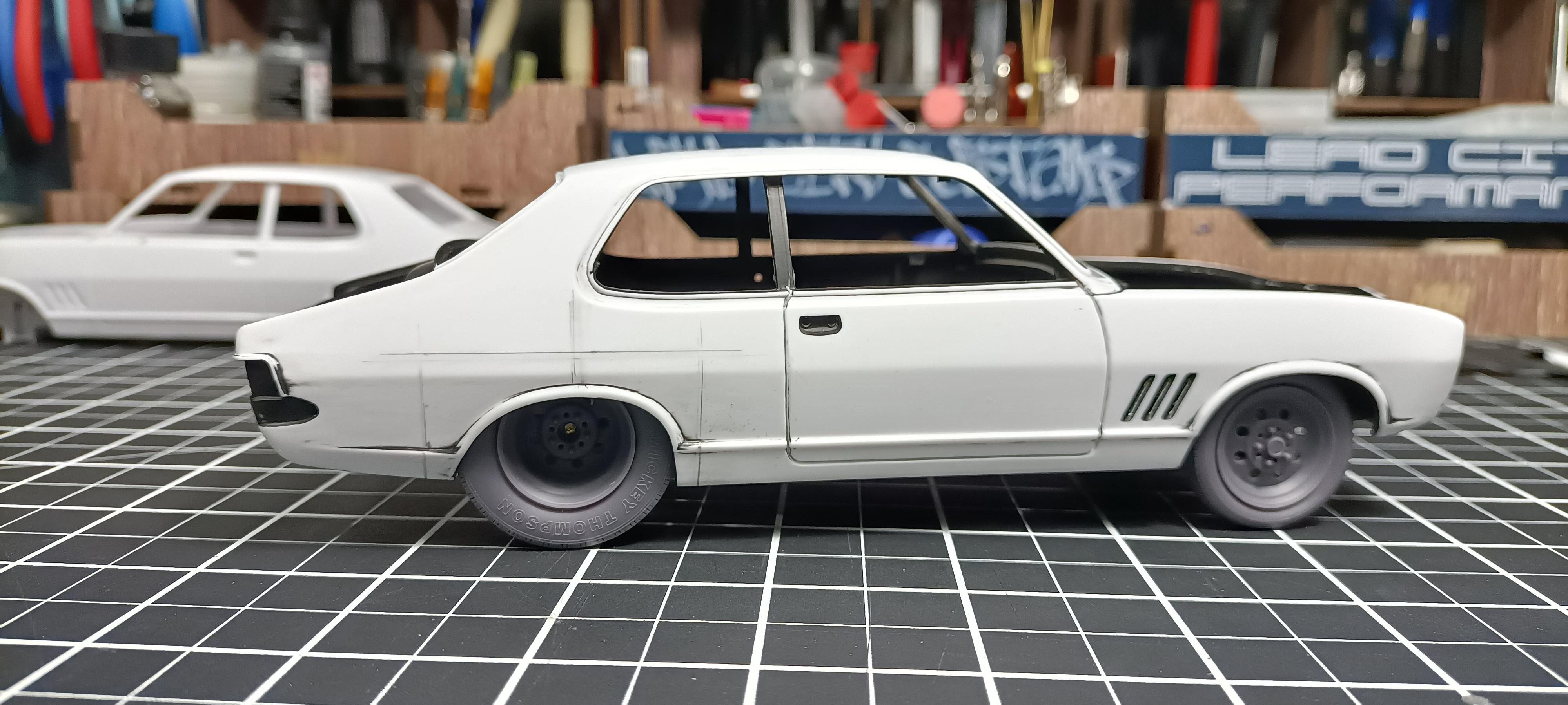

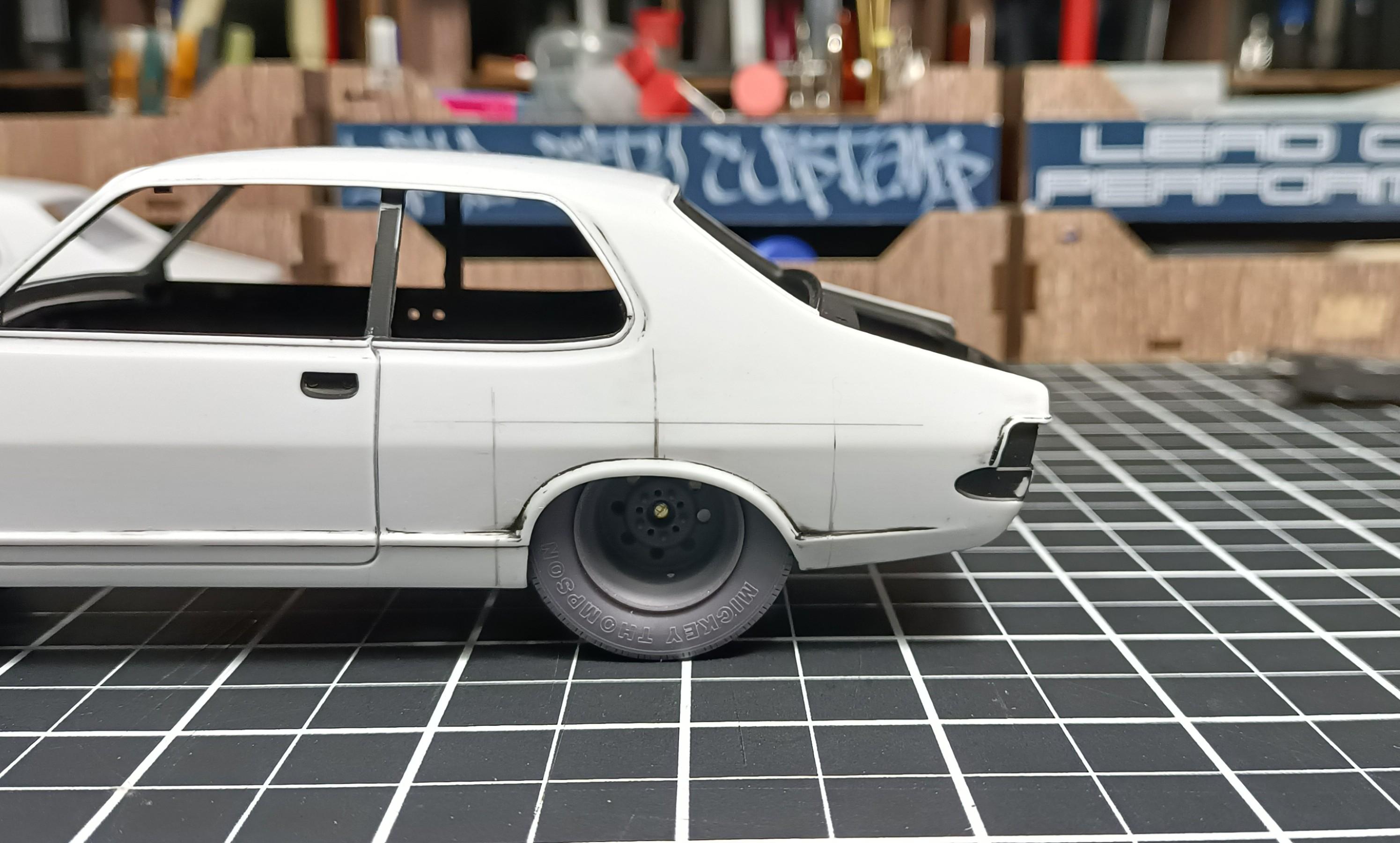

  23. Made a start stretching the rear wheel arch on the LJ Torana. Also adjusted the stance, lowering a bit. Now to fill the gap and blend the joins.
