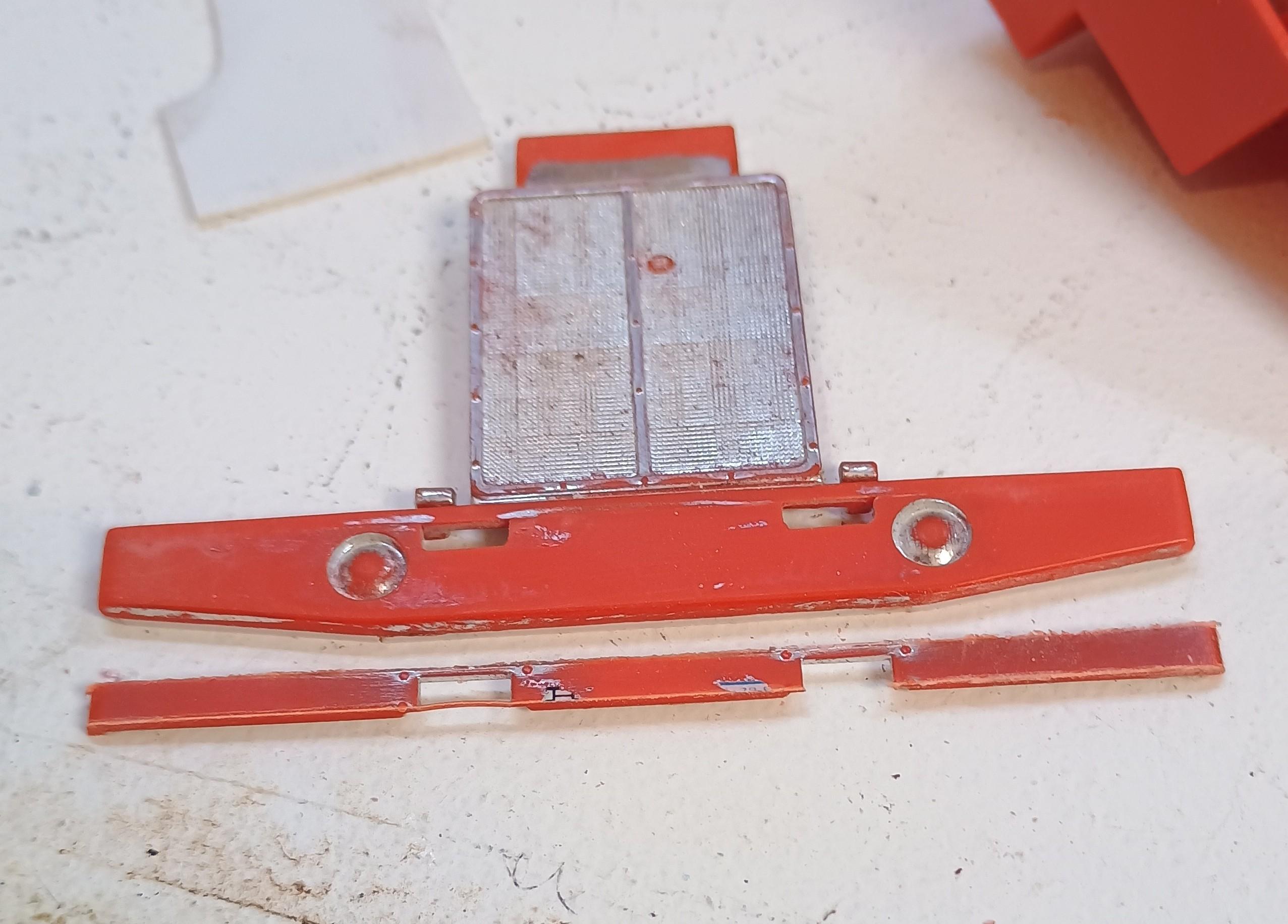

Thanks lads, very kind comments from you all. Thanks for the offer Jürgen but I think I'll do it the painful way. Cut the front mount off the frame and the cab stayed aligned. First fear unfounded. Then cut the grille mount off the front of the doghouse. Rigged up the grille in position and checked the clearance through the arc of of the tilt, the interior clashed at the driver's footwell. You can see the problem in this picture. Looks like Monogram used a bit of artistic licence on the interior. I had to cut a section out of the driver's footwell, slide it across and piece the gap it created at the top. Altered the floor to suit. Scratch built a radiator and attached the grille mounting plate to it. Put the cab back on and adjusted the fit while the glue was still wet. Perfect fit! Great the way I can see daylight around the doghouse and grille. Can't believe I've managed to pull it off!
I've either had a moment of brilliance or been true to my 'stupid' genes. I was thinking about more underhood stuff when i was overtaken by an incredible desire. Whether it's jealousy over 1/25th AMT kits or just modelling masochism i don't know but I decided that I could 'easily' make the cab tilt. If I eyed it correctly the hinge would slot right into place without disturbing the grille and work perfectly. I could even use the original cab mount to keep it in position while it set. I added two brackets to the cab, drilled as required. Then cut a piece of tube to mount to the chassis. Just a little groove filed into the front crossmember put it in the Goldilocks position. It's even hidden behind the grille! The pivot point is just right, so right that I could leave the grille attached to the cab and just make a mount for the bumper. I could, but that wouldn't be right, the grille should stay on the radiator, so I'll have to cut the mounting plate out and build a radiator, which will create a clearance issue with the interior tub. Then I've got to finagle a shift island. My wooden Caterpillar won't cut the mustard now either so that will need restarting. I now have to decide whether I should cut the whole oil pan and transmission out of the chassis so I can build the engine properly and position it at the right angle, sloping backwards to improve the driveshaft angle. Why did I do it?
