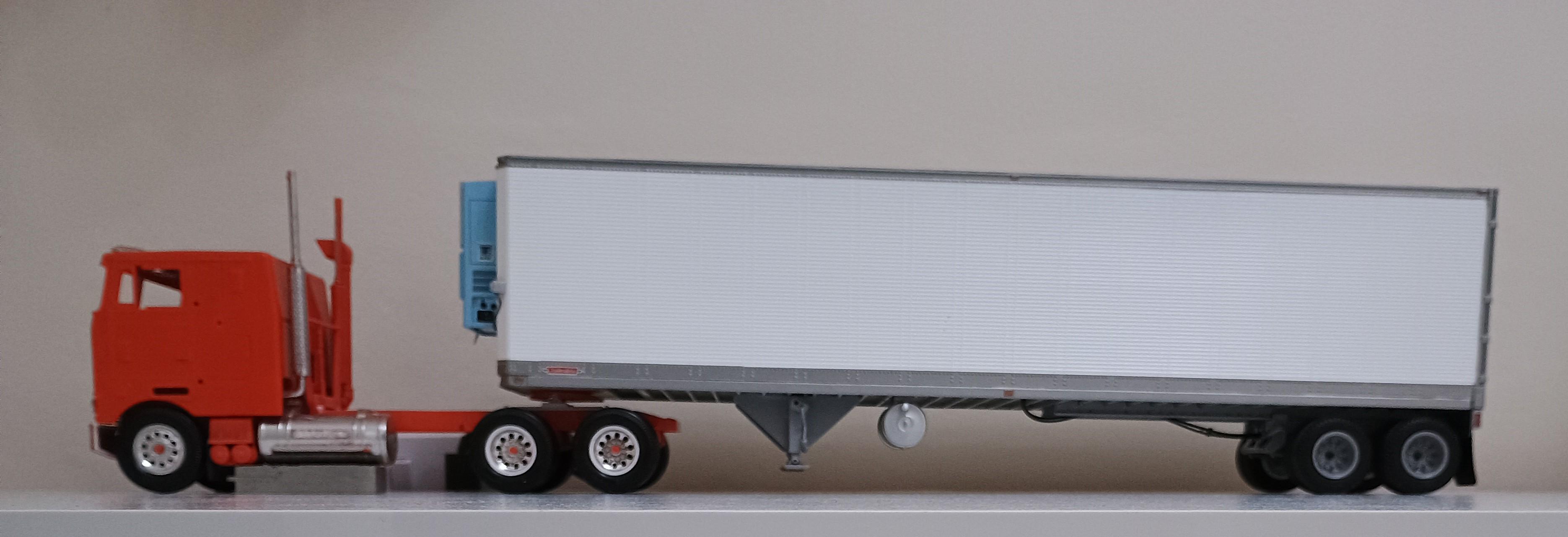

  20. SQUIRREL!!!! 🐿️ Look what I fell over on eBay! Got it for 12.50 Euros from France. It's as complete as I need, trailer is all there and the essentials of the tractor except someone has done a number on the front bumper, the stacks, headlight units and quarter fenders. They're actually bent and snapped, odd. Nothing that can't be sorted. Someone was asking £99 just for the Pete on its own so I didn't do bad getting both. Just shows you, they're still around.
