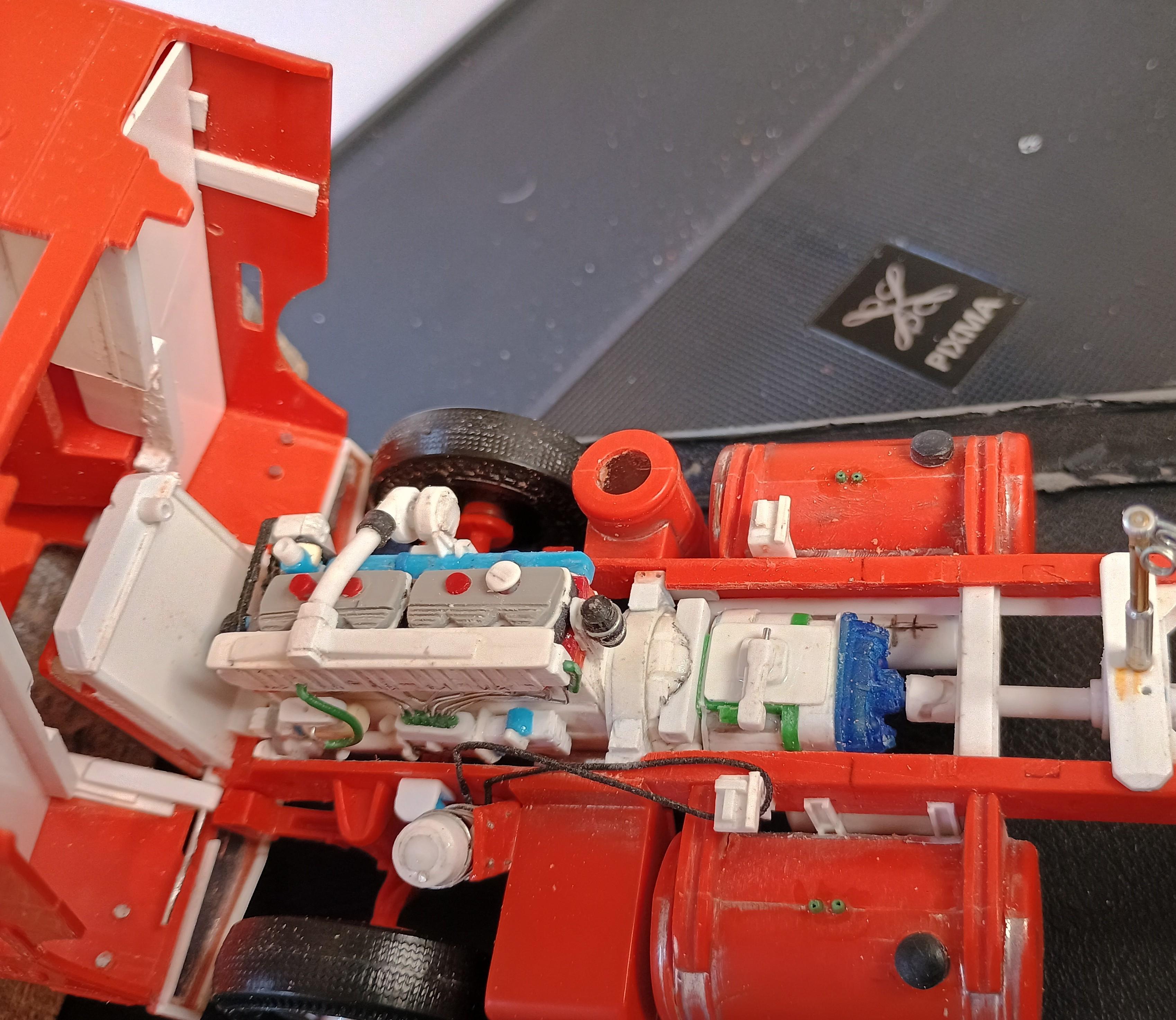

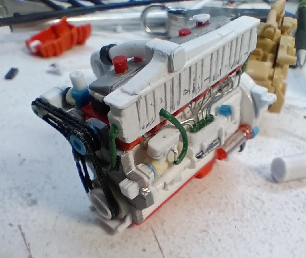

Did extensive research on the shift tower for the 352, there's precious few images of it on the web. Cobbled together a design using varying images and made one up from card etc... Added a shift lever from a paperclip and formed a range change switch from aluminium wire. Very fiddly. Also added strip to the top and bottom of the axle beam to make it look like an "I" beam casting, also the stubaxle bosses for the kingpins. Turned some service brake chambers, brackets and slack adjusters. Shaped two brake backplates to mount them. Still got to build front dampers and a bumper mounting. It's all getting very tight under there.

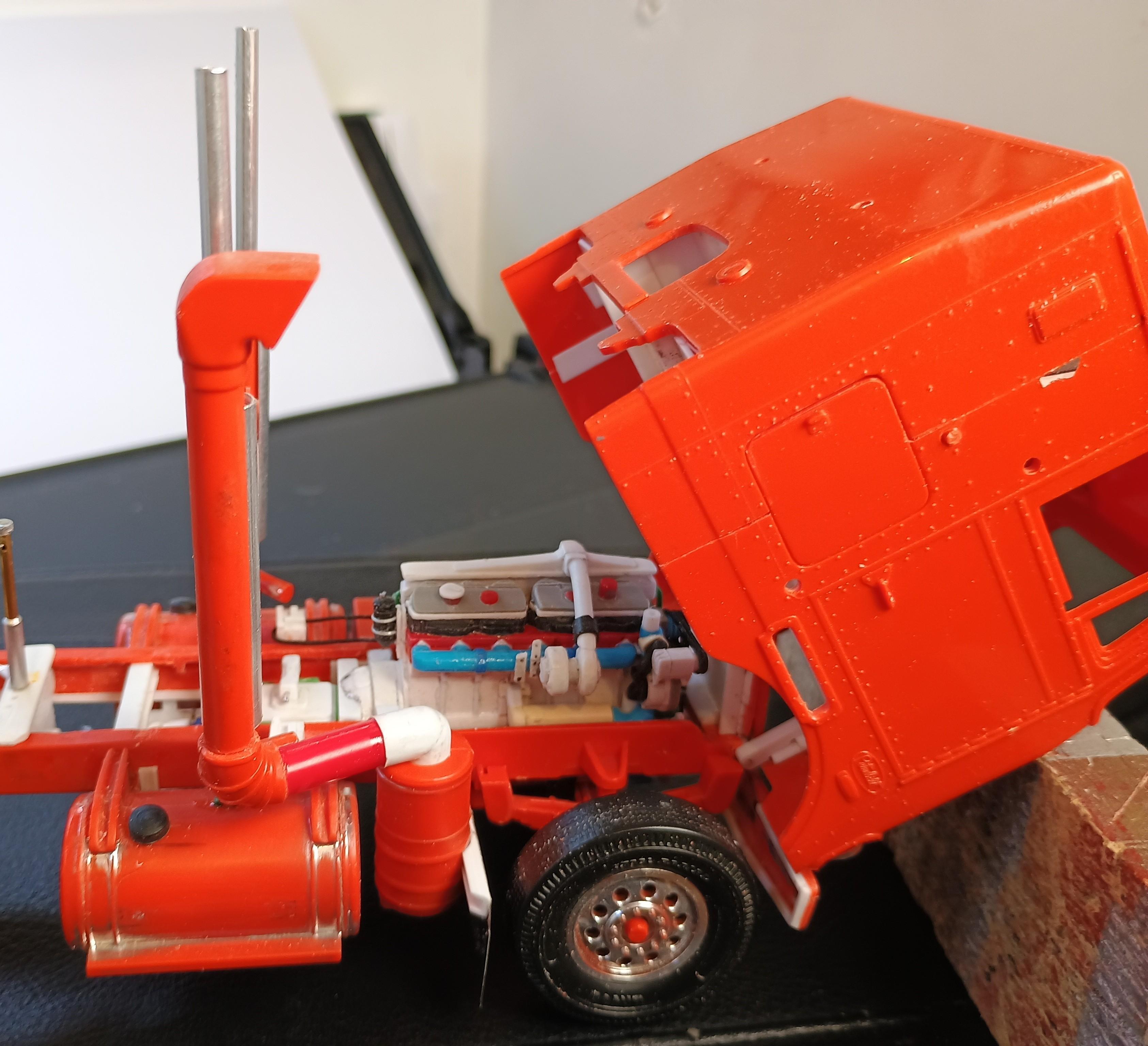

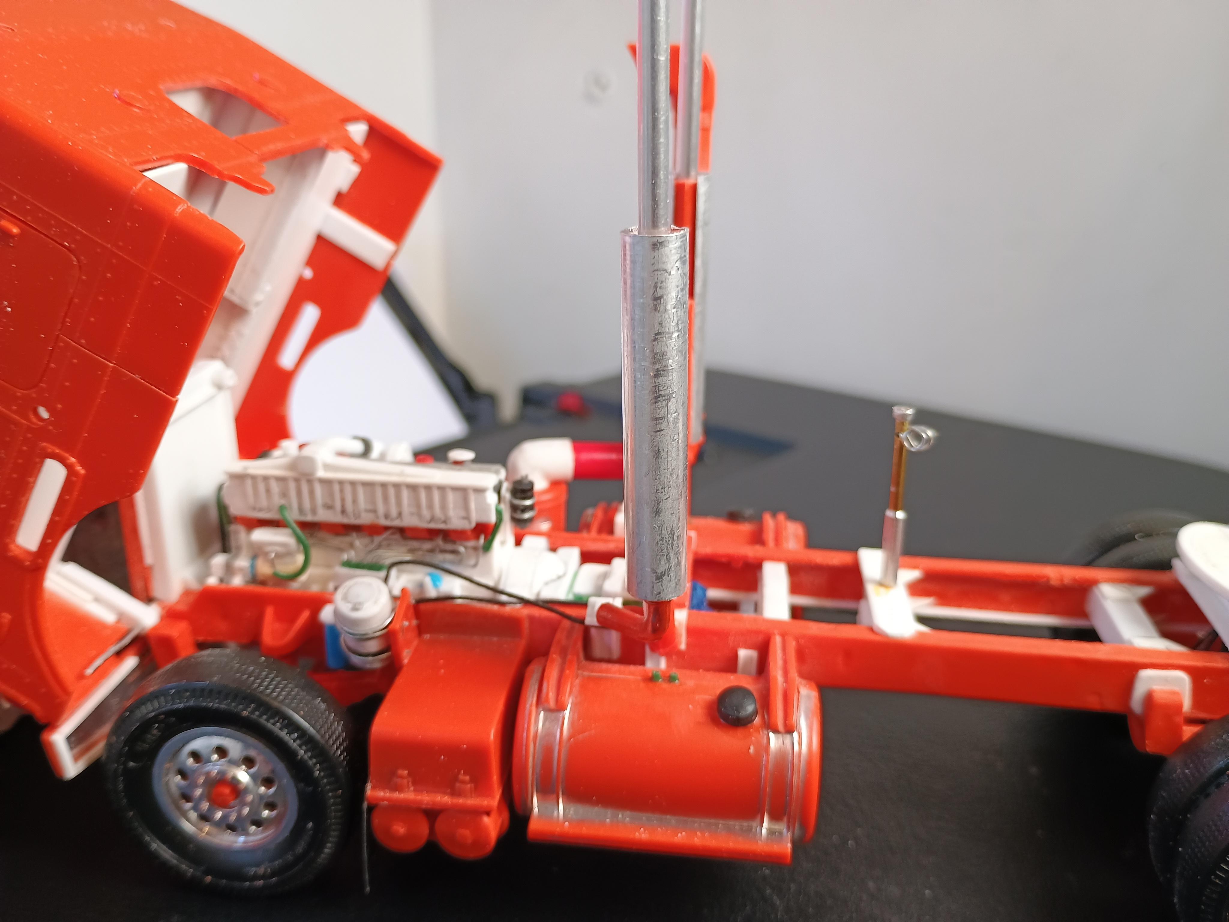

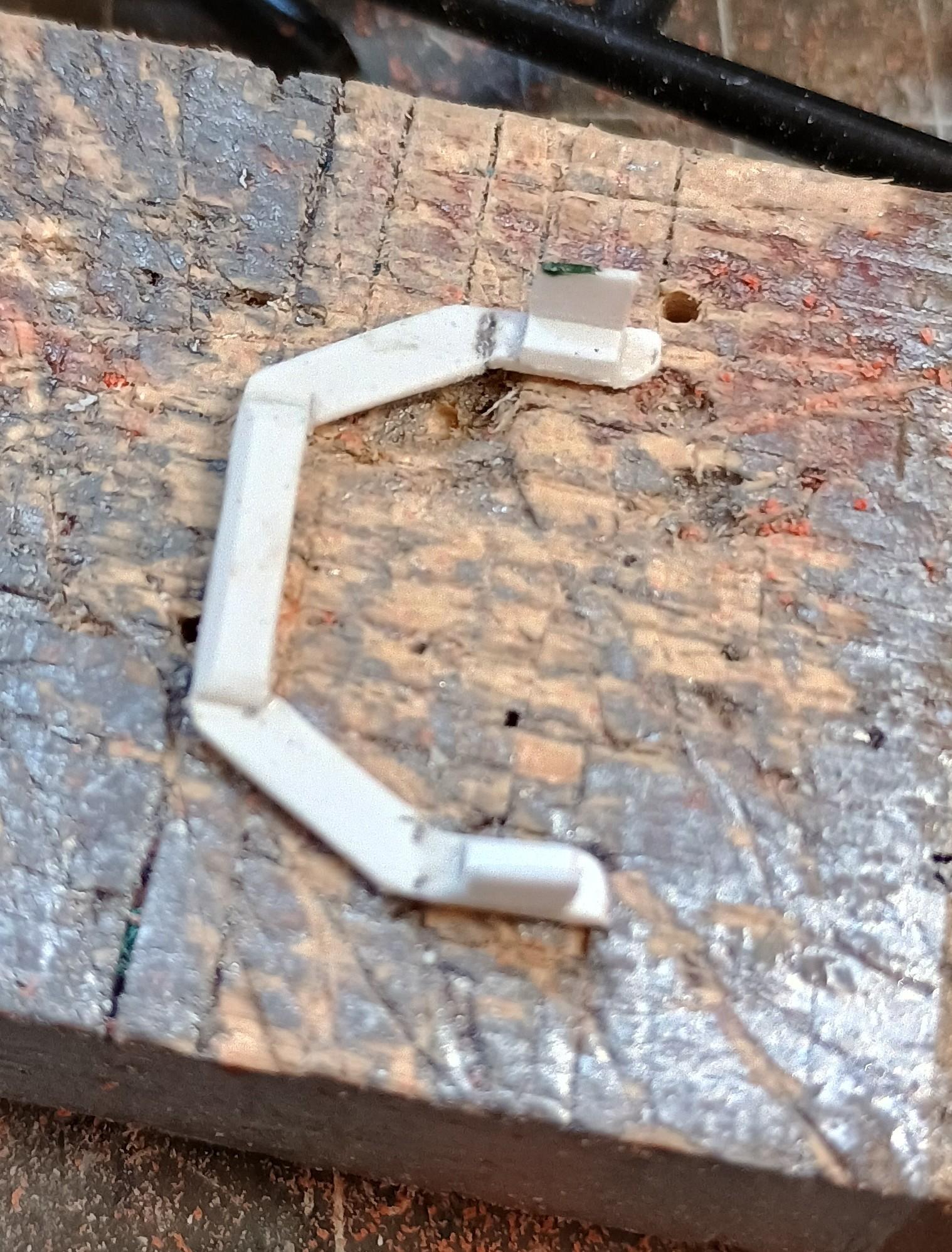

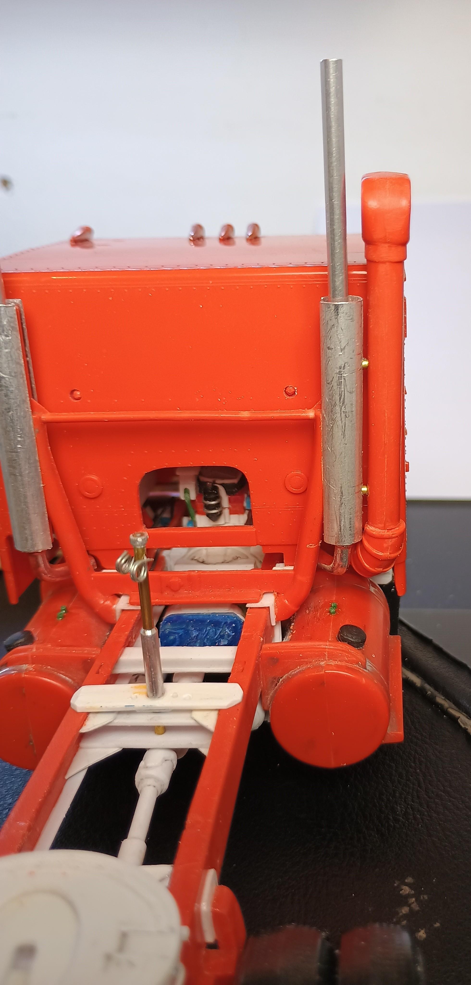

Peterbilt thought of it first 😃
Jürgen asked me about some sort of cab tilt restraint. I pondered the setup over the last few days and then saw the answer staring me in the face, just do what Peterbilt did and fit a lock bar onto the passenger side ram. I cut out a blank piece of ali, scored it at the bend points and formed a C section. I drilled and filed out a locating hole and a hole at the top for clearance of the 2*1mm block I added to the ram. The locking bar shares the same pin as the top of the ram. The principle is that as I lift the cab the lock slides up until the locating hole falls over the block. The cab can the not drop back or fall over onto its face. Most surprising of all... IT WORKS!!! When I want to drop the cab I just lift the lock bar and the cab is free to sit back down.
Finally found this on the web. You can see the length of the ram, it goes all the way back to the rear hangar on the spring, massive!
