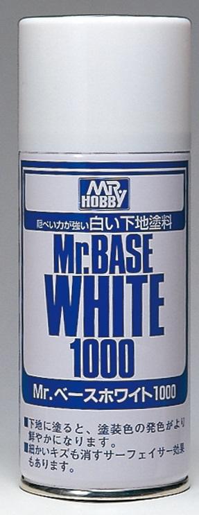

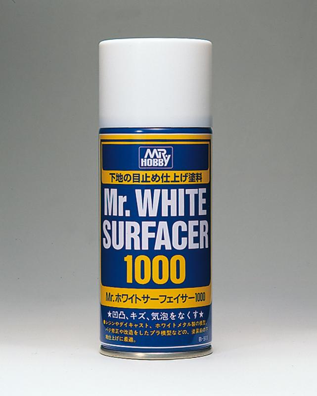

  11. Thanks for the 1st hand account. So you did the base white and then added primer? Or what were your steps? Thank you. So do you recommend spraying primer first, then this, then primer? Or the Mr. White and then primer?
  12. Have any of you ever used this as a barrier with a kit molded in black or another bright color such as red? Is it effective at preventing bleed through? Also, what's the difference between the Base White and this:
