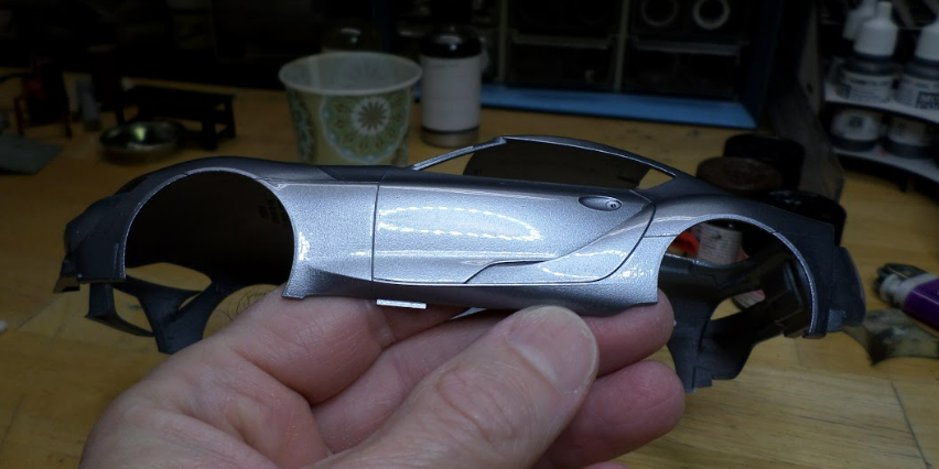

Here is my recent process using Scalefinishes.com factory correct Turbulence Grey basecoat with automotive 2K clear. Shiny is nice, but not at the expense of realism so I try to shoot my 2K clear much thinner than some others I have seen to maintain as much of a scale fidelity as possible. This still went on a smidge thicker than I would have liked, but the 1:1 also has a very deep/wet look so I am OK with what I have here. This was only wet sanded where there was some muck in the paint and a fish eye. I started with 3,000 grit foam pad, followed by 4,000 grit through 8,000 grit polishing clothes. I then buffed the entire model starting with the mild cutting Turtle Wax T-415 Premium Grade Rubbing Compound, followed by Meguiar's M0916 Mirror Glaze Swirl Remover, then Meguiar's M0716 Mirror Glaze Show Car Glaze. After I complete final assembly, I will top top it off with Wizard's Mist N shine for that final wet look and to help prevent dust/fingerprints. (I also use this on the inside glass before mating to frame) The main thing look for here are products that do not contain silicone as to not mess up my hobby room/paint area causing future painting problems. There are still a few places in this finish I would go back and redo if I wanted a show winning finish, but for a curbside I am pleased. While there are several products listed here, this process described was maybe an hour one evening, after the body sat for nearly a month after clear coat. -
