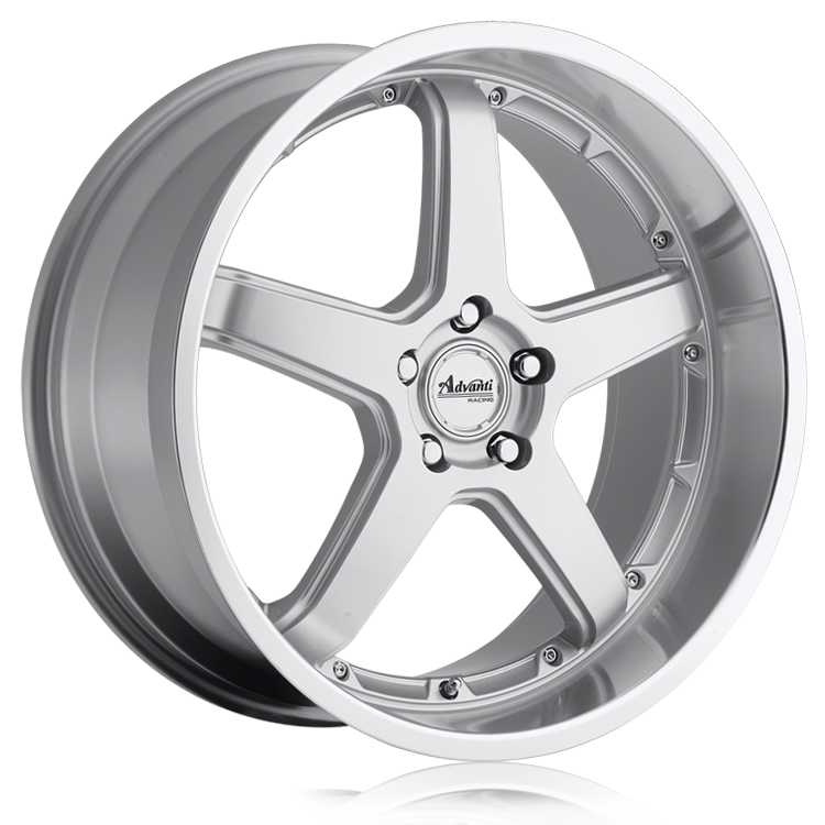

  12. I haven't started the real car project yet, I'm going to paint the centers of my new wheels to match the body of my car. I've just never gotten good results from Duplicolor so I wanted to master the paint before messing up my rims. I shot two wet coats of my body color over Duplicolor primer on a test body last night and the finish is much more uniform but it's still just as flat as it can be. I'm going to put clear on the wheels so flat for the color is fine. The wheel lips are machined finish with some kind of clear coat, I'm leaving them as is but want to paint the spokes which are painted. The plan is to sand the spokes with 2000 grit to knock the shine off them, mask off the lips then prime and paint the spokes and the area with the faux bolts.
  13. I'm trying the Duplicolor primer now. I usually go without primer since rattle cans put such heavy coats on, it works with Testors and Krylon but evidently not Duplicolor.
