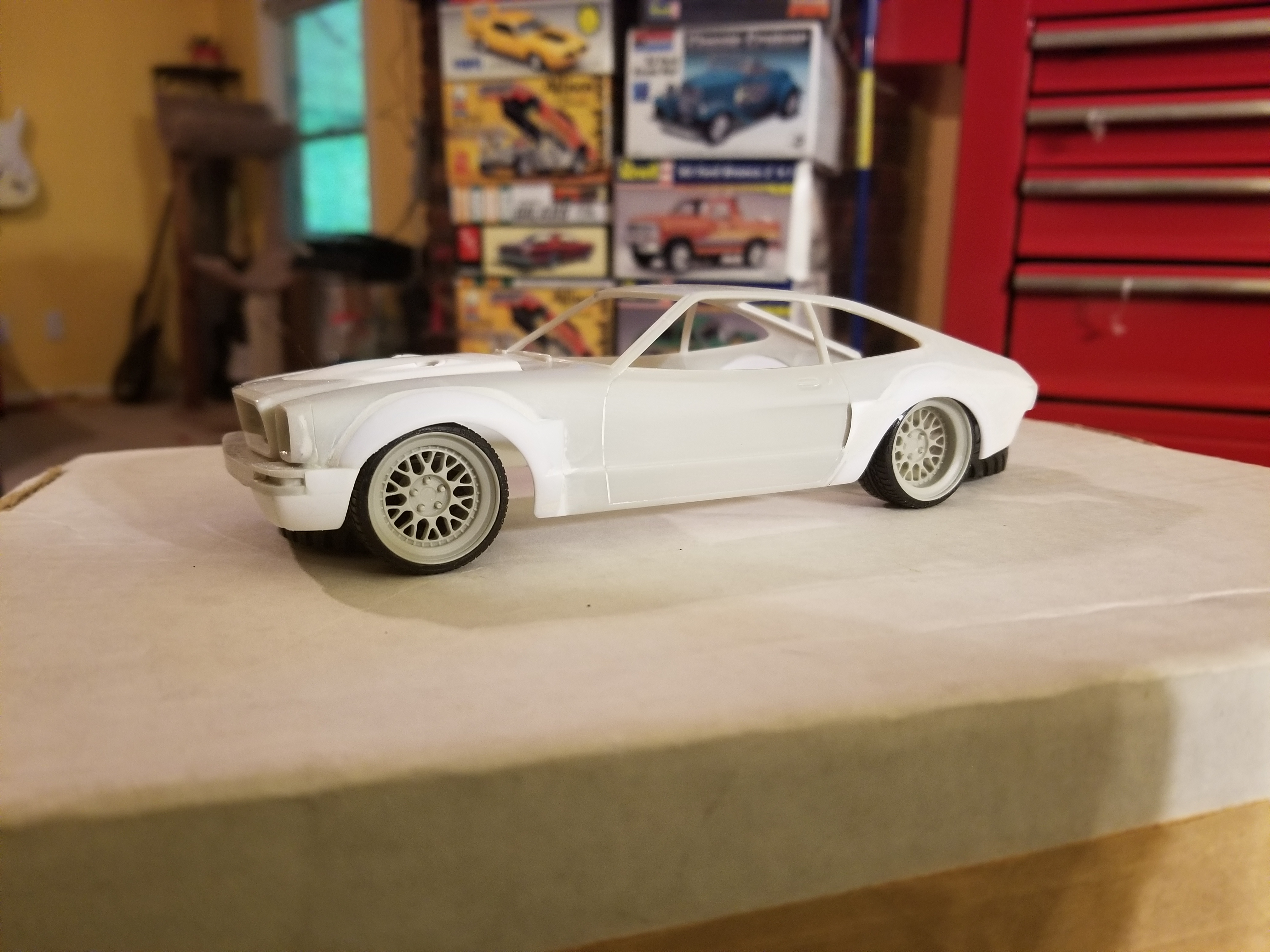

I just wanted to post a progress pic. Most stuff is in paint, doing assembly and detailing stuff now.

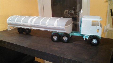

Freight liner COE questions
Fat Brian replied to dad vader's topic in General Automotive Talk (Trucks and Cars)
You need to take at least 1/8" out of the front axle. I just left the front drums off to not mess up my spring mounting points. -
