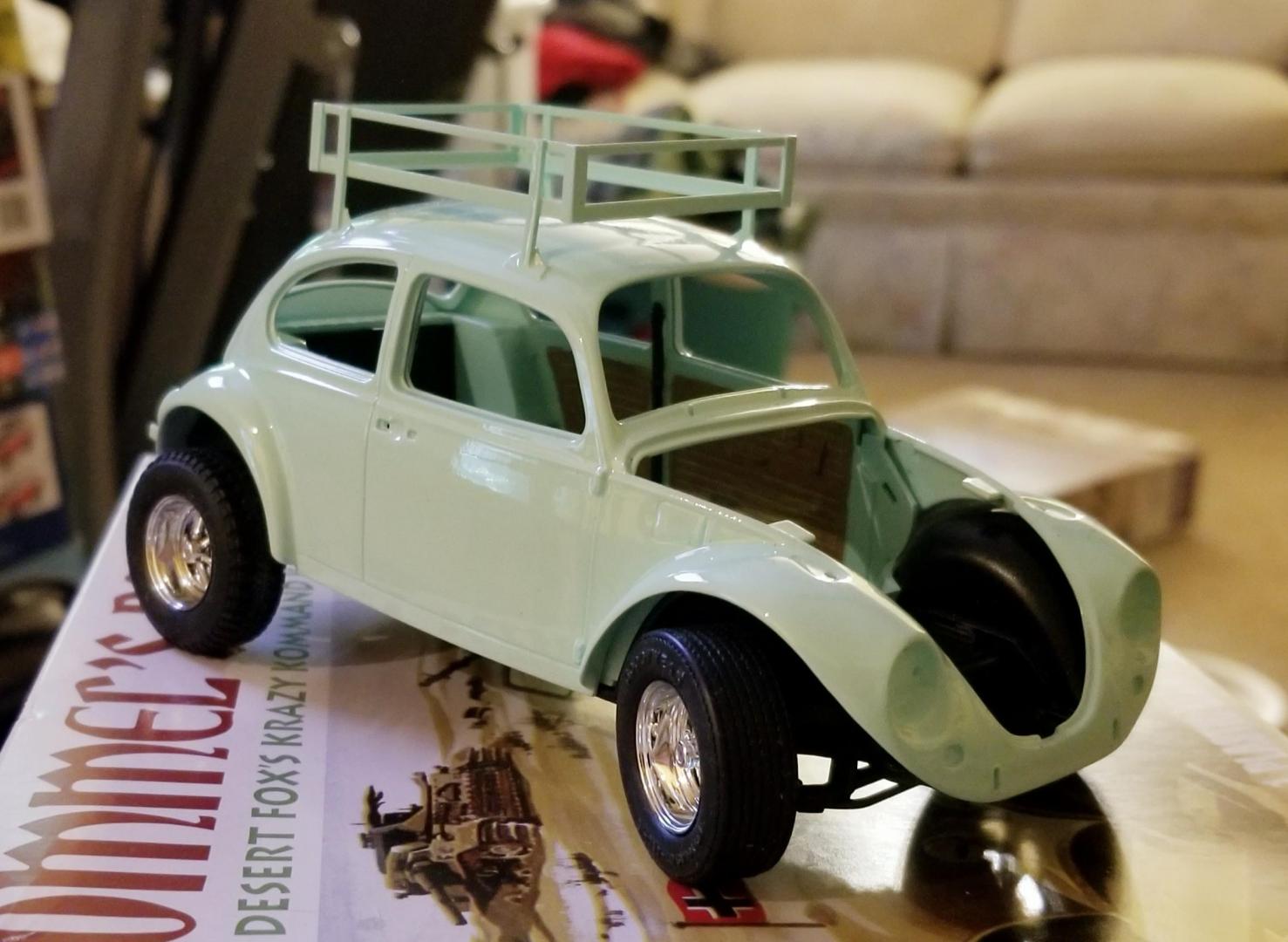

  25. Finally found a set of the MRC Goodyear tires I'd been looking for so I bit the bullet and got them. I didn't really like the all terrain tires on the front of the beetle, these street tires give it much more of a pre-runner look.
