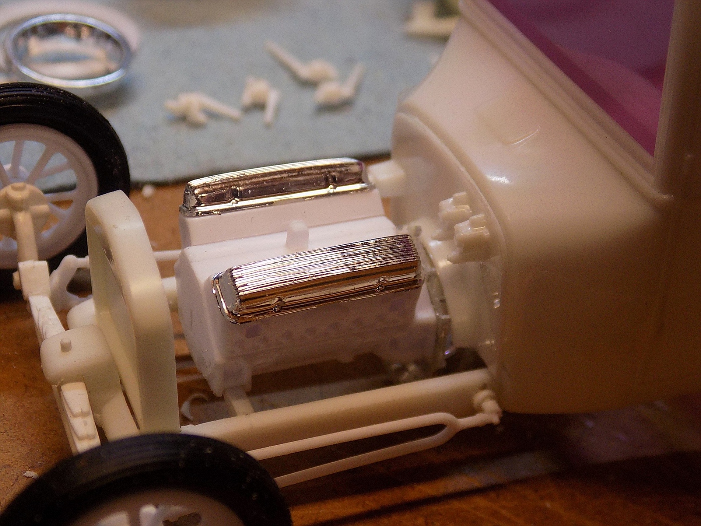

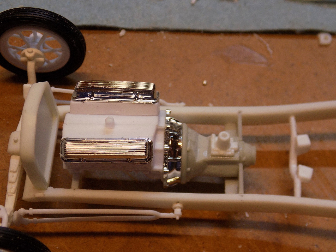

The Chevy engine block is from the new(ish) Monogram Slingster dragster kit. I cut off the molded on clutch housing and oil pan. The chrome bell housing/trans adapter is from the recently reissued AMT Chevy parts pack engine. The early flat head Ford 3-speed trans was cut off of the optional Dodge Red Ram hemi in AMT's '29 Roadster and the trans cross member is the corresponding part, also from the AMT '29 and cut down to fit the T frame. The tubular member behind that with the trailing arm mounts is cut down from Revell's '40 Ford street rods (coupe/convertible.) The front engine mounts are shaped from rectangle plastic rod.

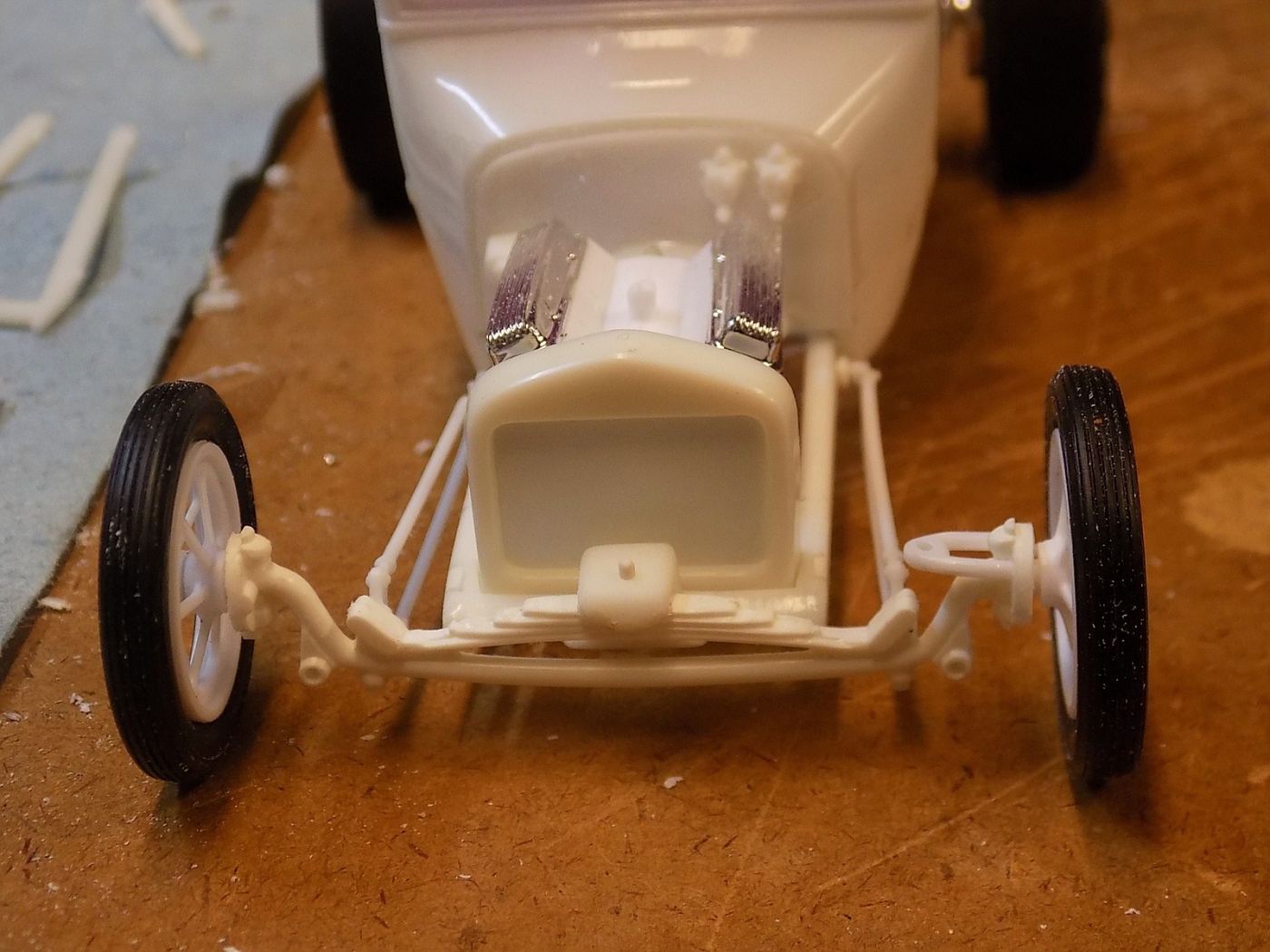

The front axle is from the Revell '32 Fords with new end pins to mount the spindle-mount 12-spokes, also from the Slingster dragster. I added an upper steering link hoop made out of a cut down A arm for a future side steering link coming off of the cowl. The hairpin radius rods are from Revell's '32 5-Window pinned to the frame rails. The plain, chopped radiator shell is out of AMT's recently reissued Competition T Roadster parts pack body and I made a filler panel from .040" sheet plastic since the car will have no cooling system.

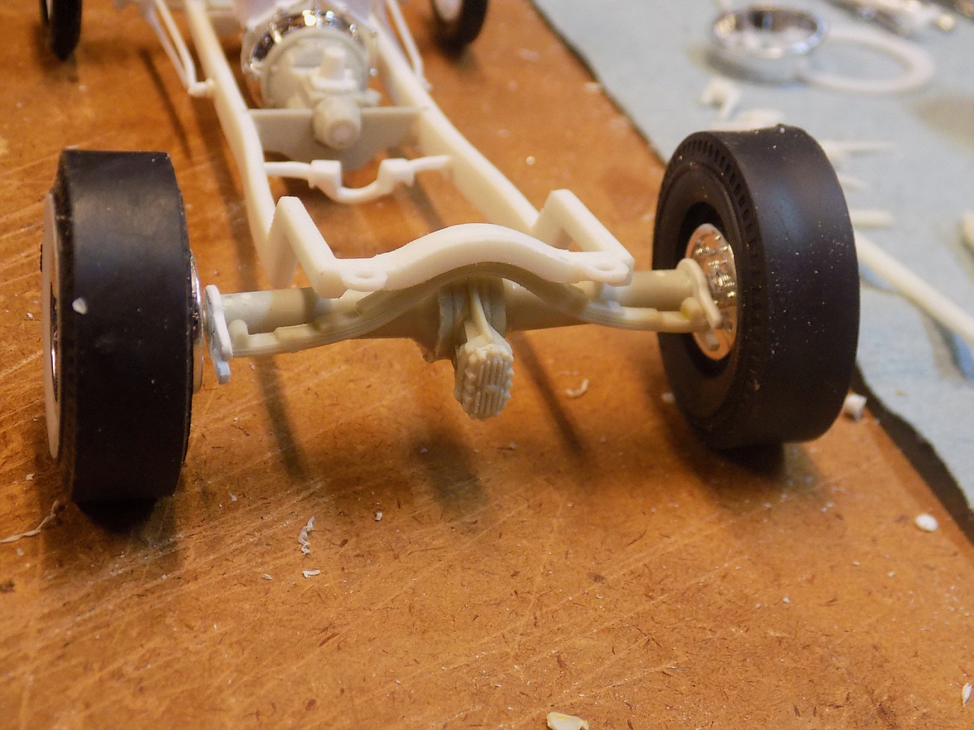

The Halibrand quick change center section and axle tubes are from the '25 double T kits with the end cover plate from AMT's '41 Woody street rod. I made the spring hangers from .040" sheet plastic and the 25 T kit spring and shocks mount to it as they would out of the box. I did this because the kit spring mounts are part of the puny drum brakes and split wishbones that are all one piece. This will have ladder bars mounted to the axle tubes inside the frame and I wanted better brake detail. The '39-'48 Ford brake plates, wheels and slicks are all from Monograms "Blue Bandito" '29 Roadster Pickup kit.

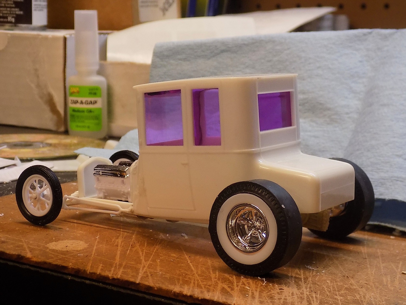

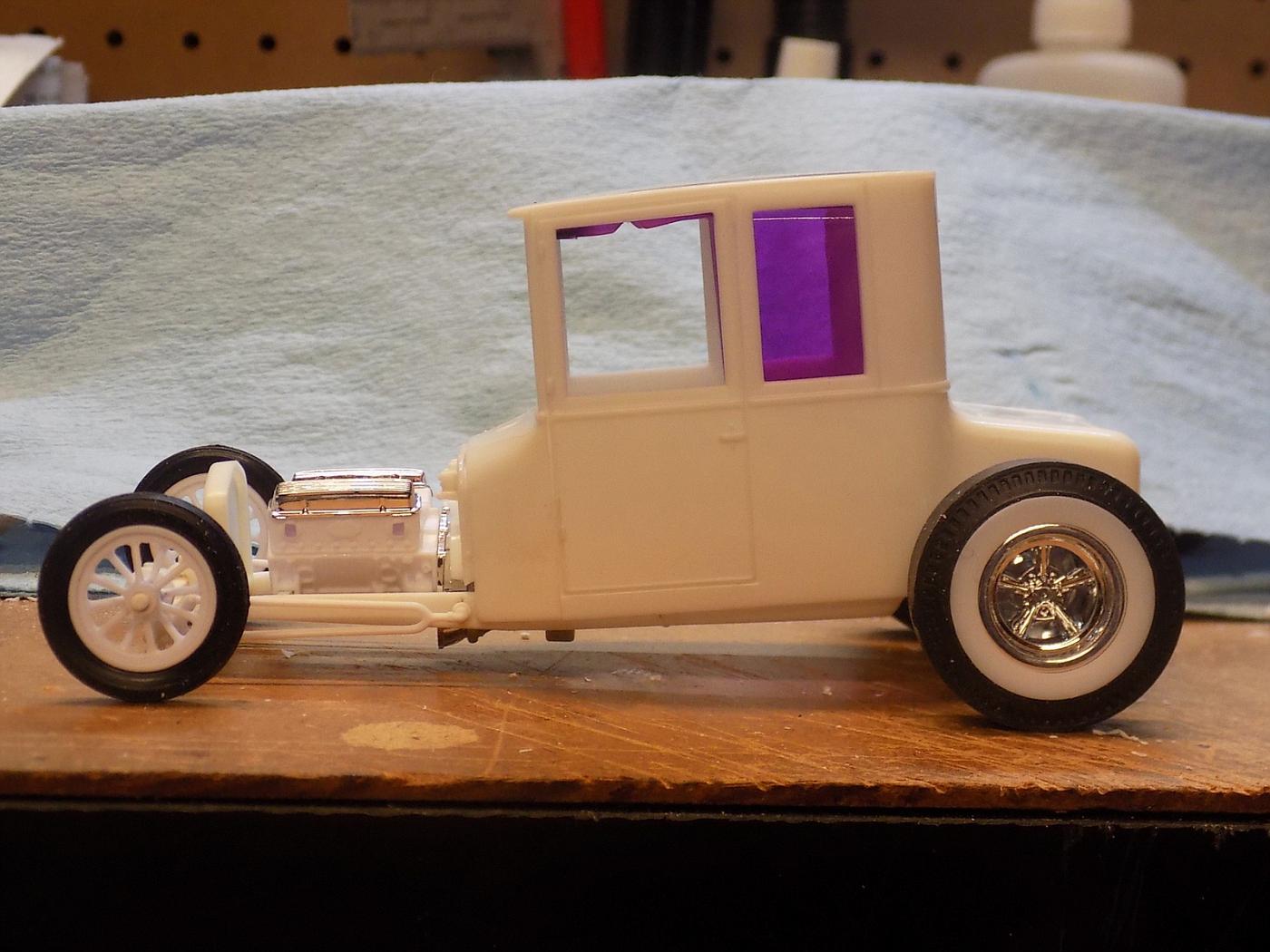

The body still needs to be trimmed around the axle in the back and a little shave around the engine on the firewall then it will come down channeled the thickness of the frame. I just love that purple glass! The car will be finished in a pearl white and lavender theme.

The un-chopped roof is like nails on a chalkboard for me...but at the same time, it's unique and unusual.
In order to keep the windows in a pleasing "golden ratio" proportion, there are really only 2 ways to do these: stock height and hard chopped (oh, and maybe angle chopped. So 3 ways): Anything else leaves the windows a displeasing square shape. So with that in mind, I'd keep it stock height.
