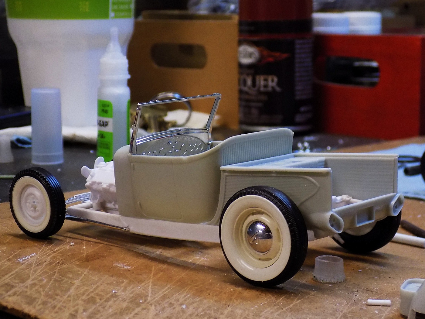

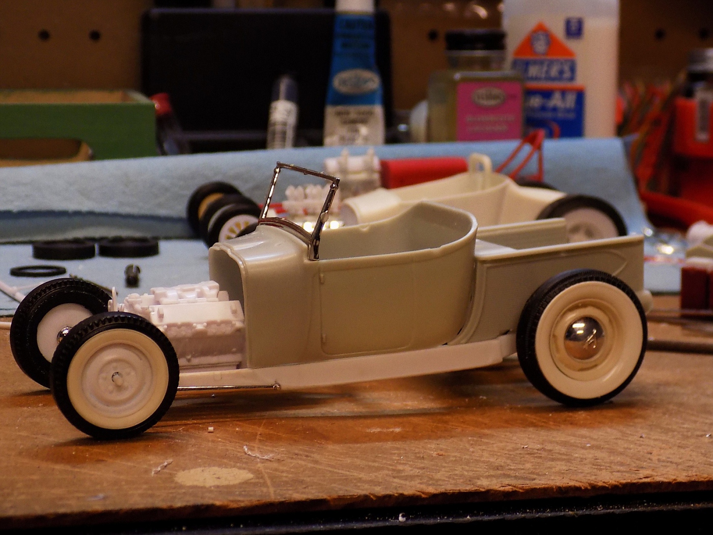

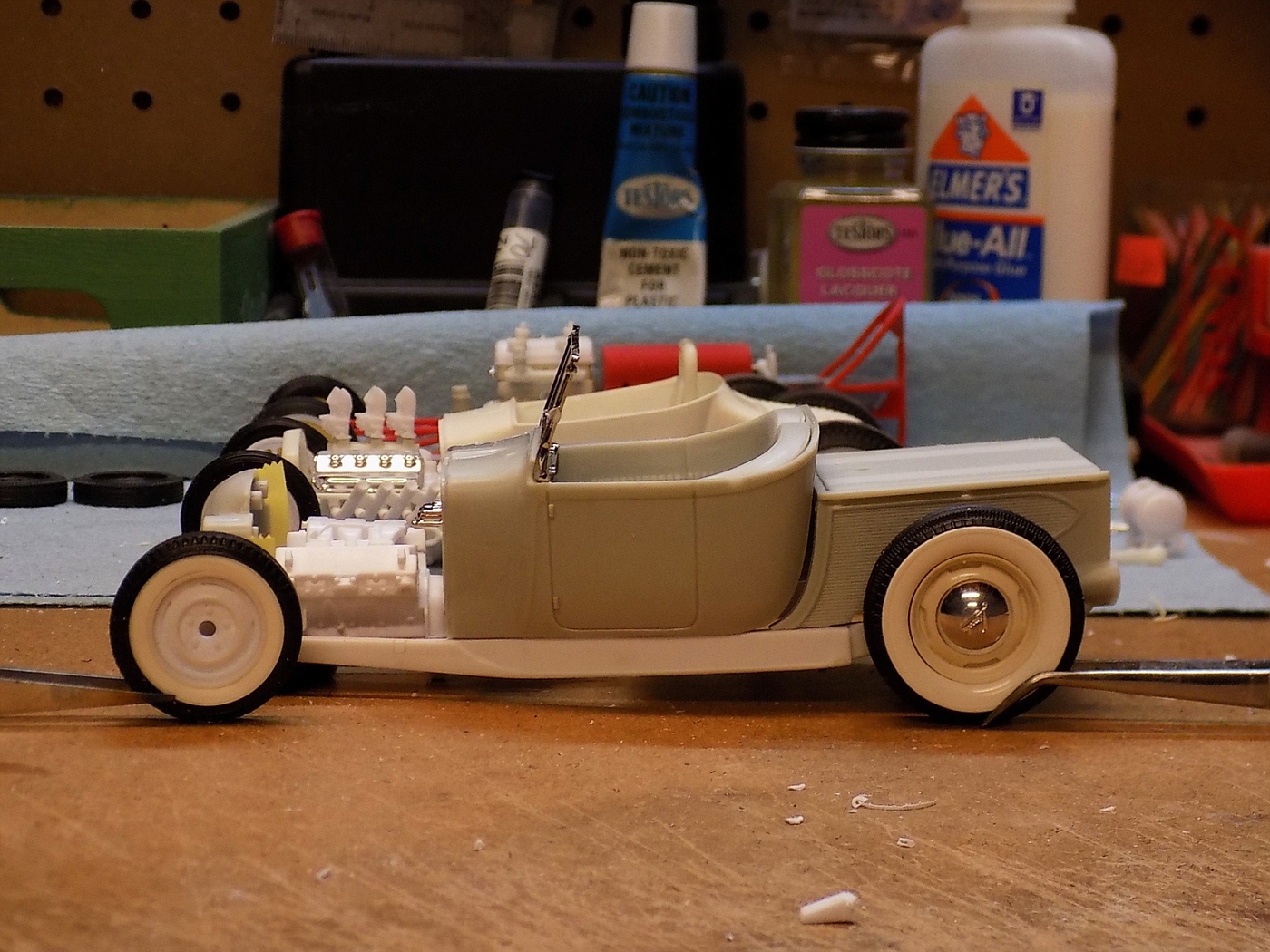

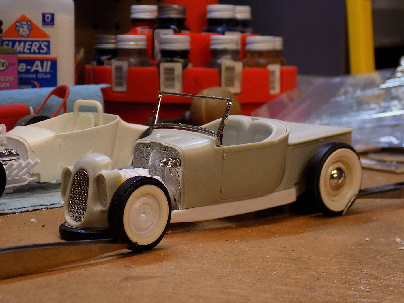

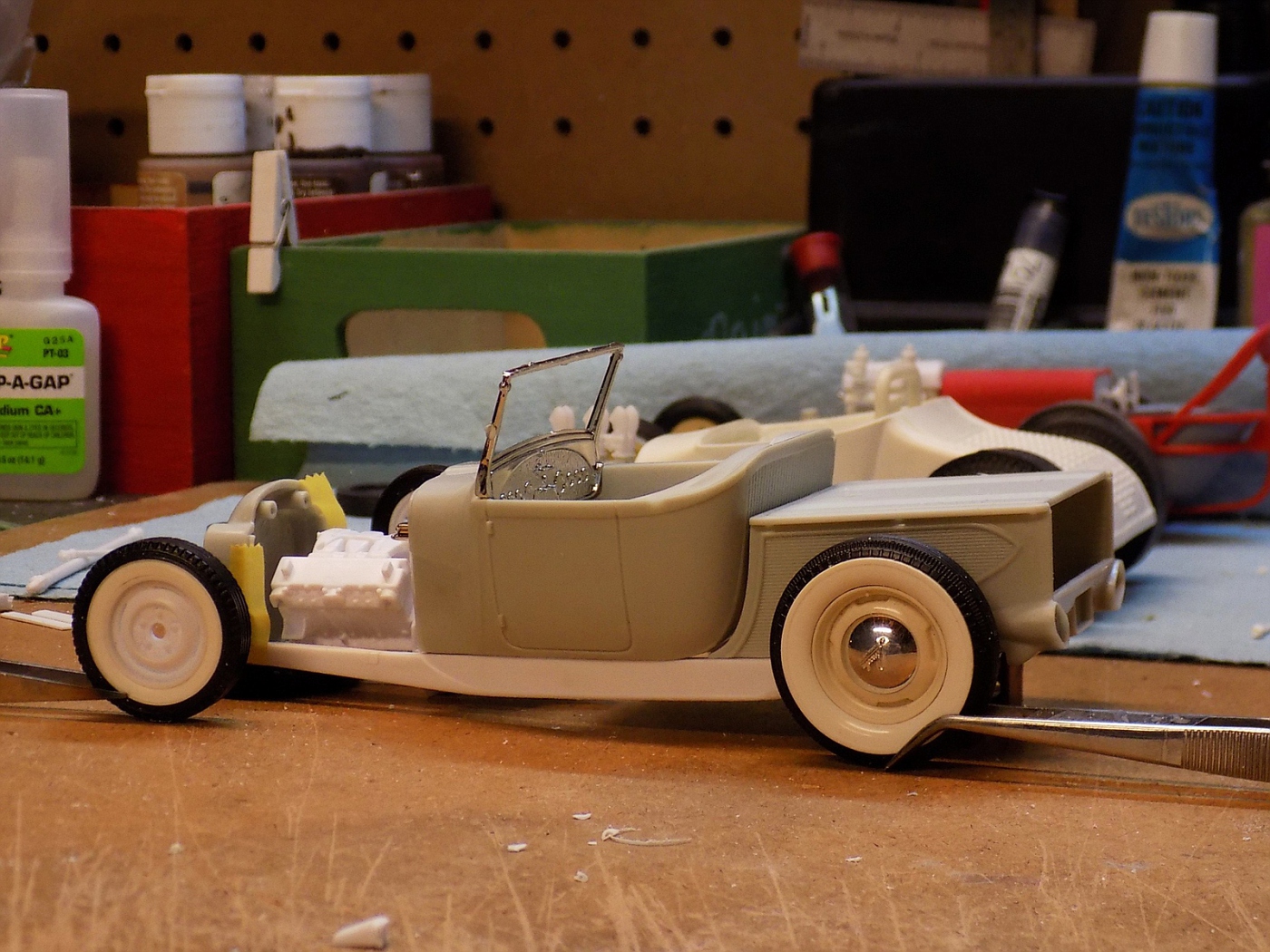

Dennis Lacy Posted November 23, 2015 Posted November 23, 2015 (edited) I had some bench time today but didn't find myself particularly motivated to work on any current projects so I decided to play a game called "How many different old hot rod bodies will fit onto the '32 frame from Revell's new '29 Roadster kit." As it turned out, the one I would have assumed to be the least likely candidate turned out to be a stand-out. So much so that it got the creative juices flowing and a new project was born. Most of my time was spend holding up wheels, tires and engines to the taped together body and frame until I landed on a formula that spoke to me. Overall, the Ala Kart is a pretty neat hot rod and certainly has some serious provenance being a 2-time back-to-back World's Most Beautiful Roadster winner and having had the legendary hands of George Barris and Blackie Gejeian be instrumental in it's construction. Even so, the one thing I think is a major fail about the Ala Kart is the custom nose. It's awkward. It goes against instinct. It looks like it's upside down. What I've done is taken the '32 frame from Revell's new '29 Roadster kit and set the Ala Kart body work on it. Remarkably, the frame fits up into the bed like a glove thanks to it being pinched in the rear as it comes. With the wheels centered in the bed the front edge of the cowl lines up exactly with the start of the frame rail reveal, like it was planned that way. For the nose, it did to it what I've always thought the real truck needed, I turned it right-side-up. I cut off the frame horns and took a notch out of the rear lower edge of the nose so that it would fit over the end of the frame and line up height-wise with the body cowl. The stance shown is what it will be. The front wheels are modified from Revell's '32 Ford 5-Window coupe in Modelhaus T120 tires. The rear wheels and tires are from Monogram's '41 Lincoln. The engine is the early Cadillac from Revell's '49 Custom Merc. Still in the earliest stages, here's the basic plan mocked up. Hosted on Fotki Hosted on Fotki Hosted on Fotki Hosted on Fotki Hosted on Fotki Opinions welcome. Edited April 11, 2016 by Dennis Lacy

Spex84 Posted November 26, 2015 Posted November 26, 2015 Very cool! The new-tool Ala kart has some great parts. Aside from some parts that seem very under-scale (engine, exhaust pipe diameter), the other thing that bothers the heck out of me is the nose piece--I like the original 1:1 car, and the 60s AMT kit nose looks OK, but the new tool nose just looks like a urinal to me. Something is off in the way it curves/projects/tapers... http://www.esnarf.com/5705.jpg

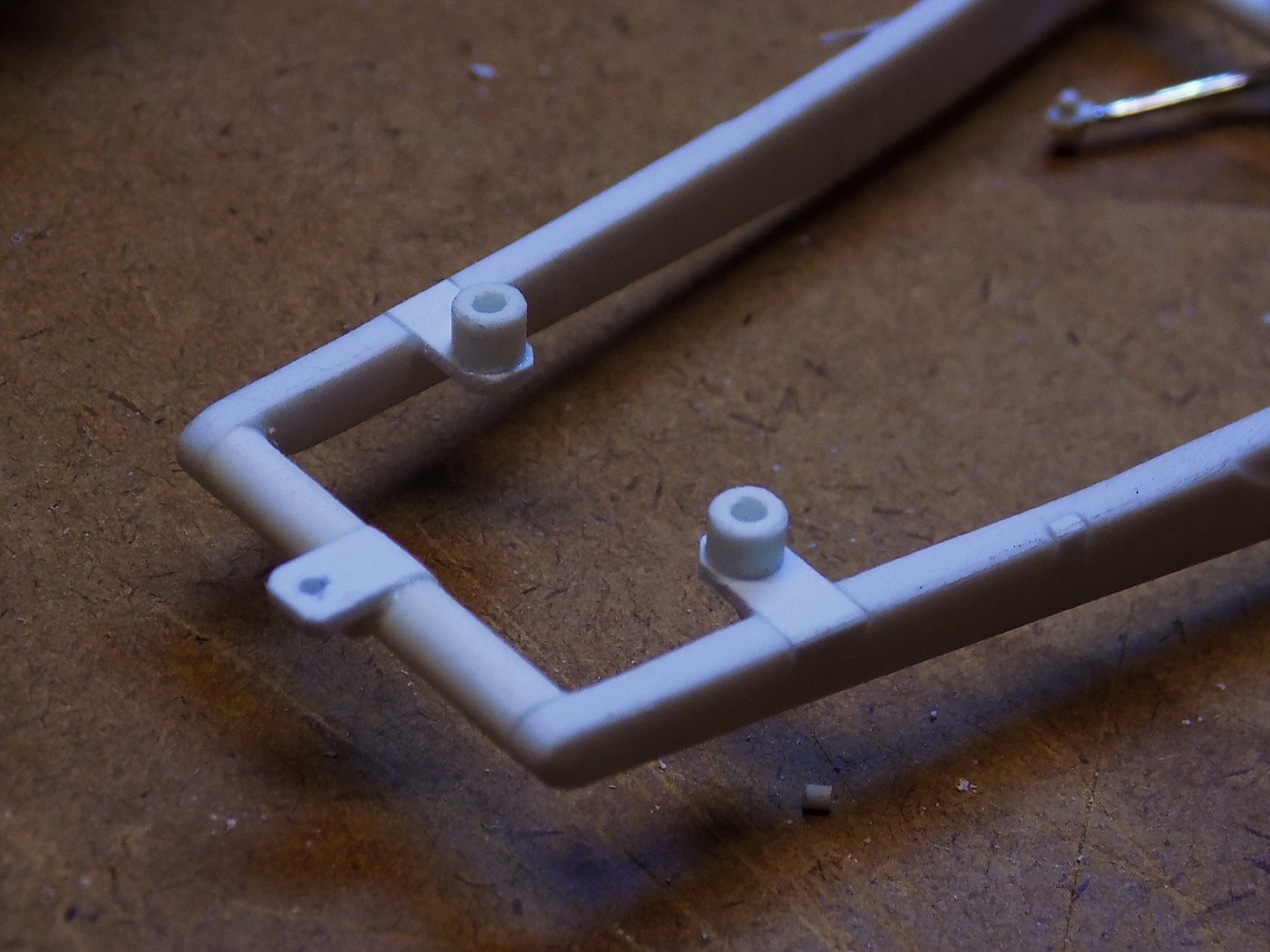

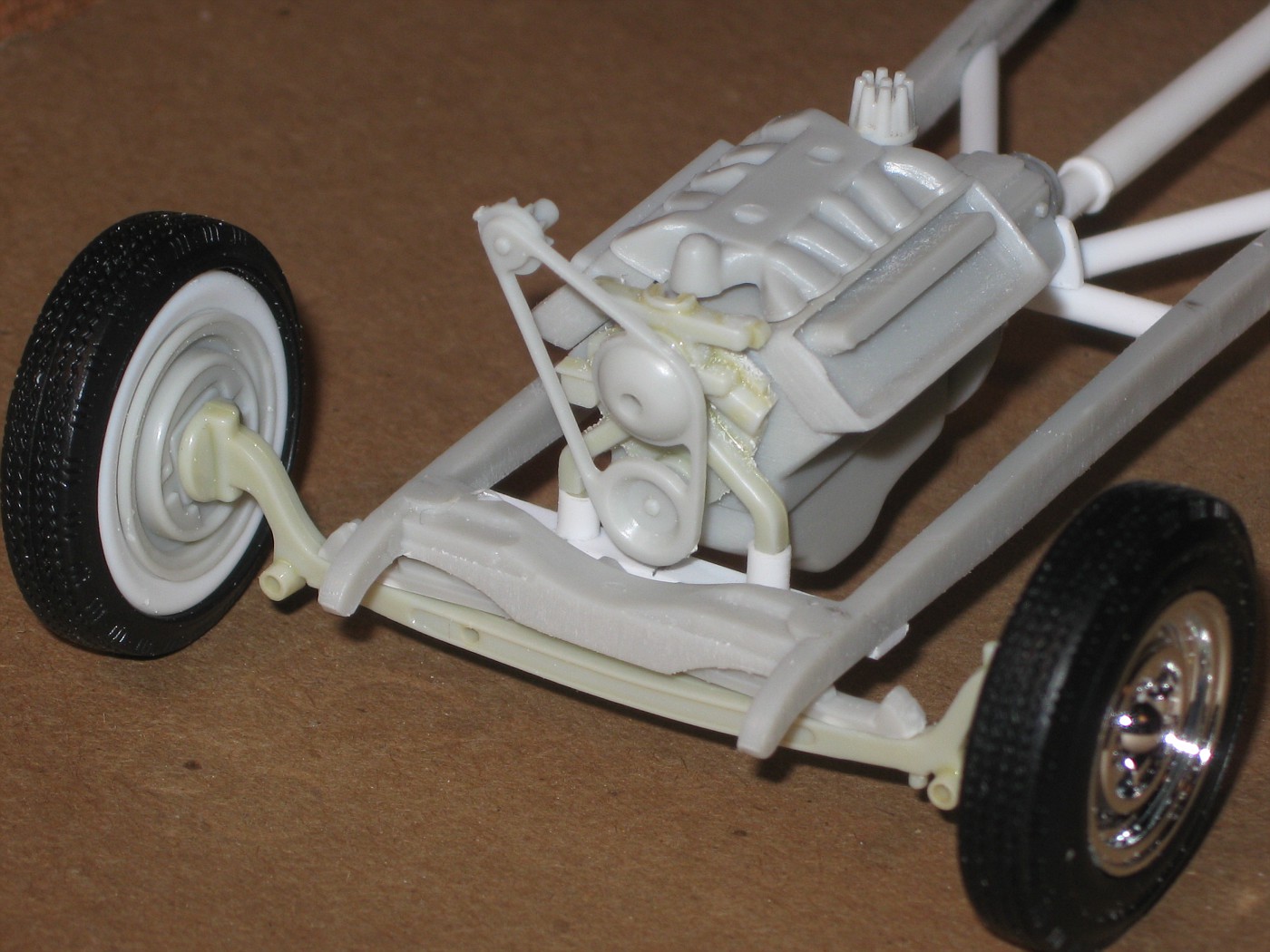

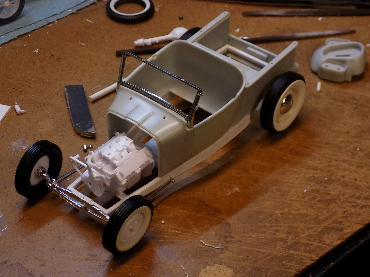

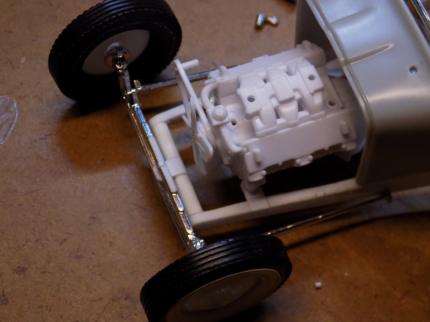

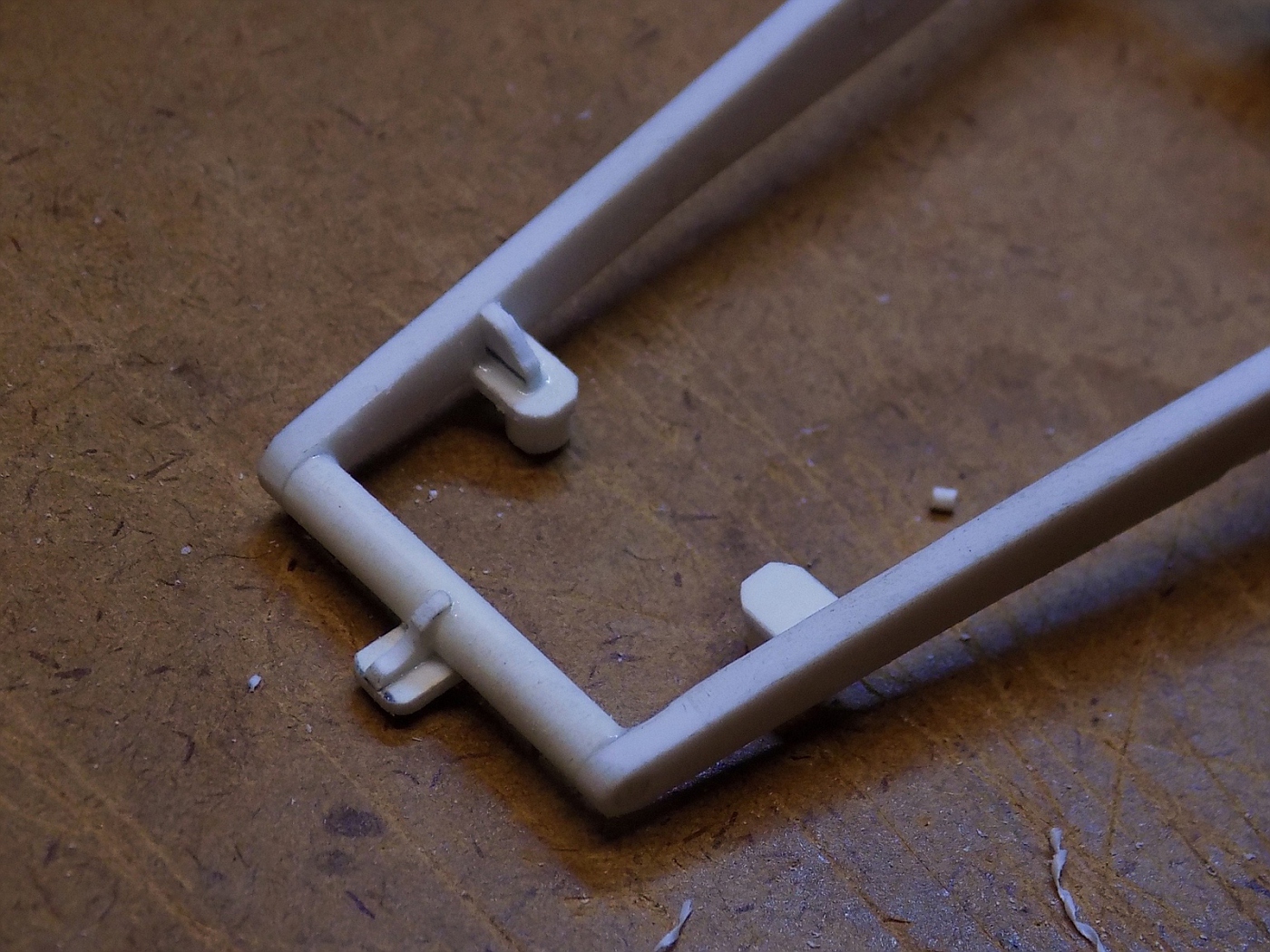

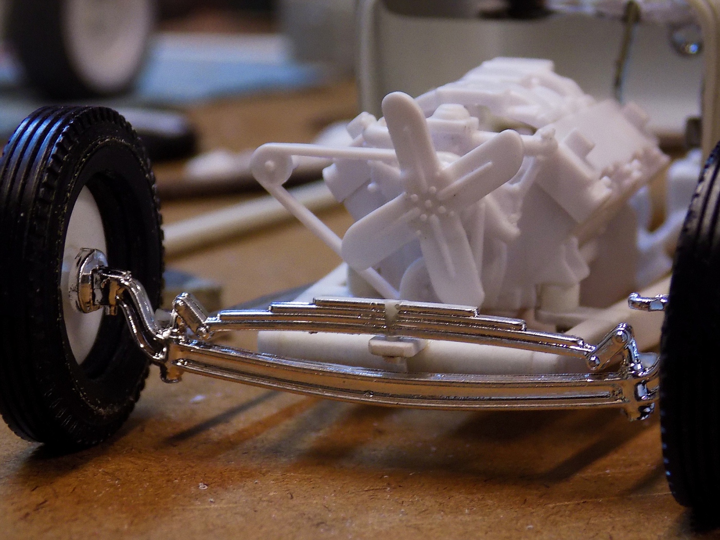

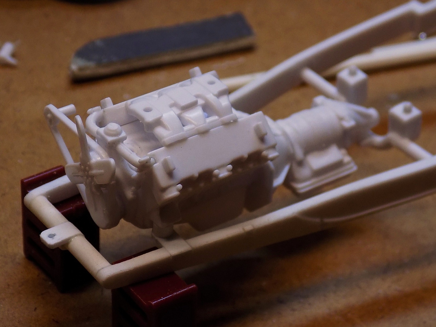

Dennis Lacy Posted November 30, 2015 Author Posted November 30, 2015 (edited) UPDATE After spending some time to consider my approach I got started altering the front of the frame to mount the axle and Cadillac engine. The front cross member was replaced with a section of Evergreen 1/8" round tube. The frame rails were both drilled with .060" holes and a piece of rod of the same size runs through both frame rails and through the 1/8" tube. Doing so positively located the tube so I didn't have to rely on hand/eye coordination to put it in place. It also adds a great deal more support than simply butt-gluing the tube to the frame rails. I Then filed a .030" deep x 1/8" wide flat spot in the top of the tube and constructed a spring perch out of .040" x 1/8" wide strip. I finished up by rounding the ends of the frame rails to blend in with the tube. The tube is in the same location as the original front cross member that was removed so with the the axle mounted ahead of it the wheelbase has been stretched. Doing so will get the front wheel center line more towards the front of the custom front shell and will make it look less nose-heavy. The front engine mounts were made from .040" x 1/8" wide strip. I filed corresponding notches into the tops of the frame rails, installed a strip all of the way across then removed the center as needed leaving behind two engine brackets. Doing it this way gives, again, a far stronger joint for the mounts than simply butt-gluing the brackets to the inside of the frame rails. It also ensured that they were level and square. Lastly, I made two 3/16" tall spacer cushions out of 1/8" tubing and some gussets to triangulate the underside of the mounts to the frame rails. The transmission sits on the unmodified mount cross member in its original location. I also filled all of the various mounting notches in the frame rails as they won't be used. Hosted on Fotki Hosted on Fotki Hosted on Fotki Here is the front axle (from the new '29 Roadster) installed. I drilled through the center of the spring and inserted an .040" mounting/alignment pin that sticks out of the bottom of the spring. I opted to have the spring sit on top of the perch (which would work fine in full scale) to keep the perch low profile so the radiator can eventually sit on top of the front frame tube. I also removed the molded mounts from the frame ends of the split wishbones (also from the new '29 Roadster), installed .040" mounting pins and drilled corresponding holes in the frame rails. Hosted on Fotki Hosted on Fotki Hosted on Fotki And a couple of really crude mock ups to check the stance. Right now I just stuck some plastic pins in the ends of the front axle and in the ends of the '29 Roadster kit rear axle. They're a sloppy fit in the wheels but I just wanted something to hold the frame up real quick. Since the Cadillac engine has an auto trans attached to it I will probably just use the '29 Roadsters 9" Ford rear axle (which was first used in 1957) but it will need to sit lower out back and maybe get some back-dating on the suspension design. Hosted on Fotki Hosted on Fotki Edited November 30, 2015 by Dennis Lacy 1
