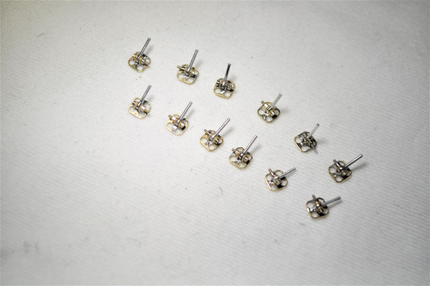

Codi Posted March 15, 2017 Author Posted March 15, 2017 (edited) Thanks guys, I've not had much bench time as we had over 20" of snow here. I'm going to quickly re-do the rotors as I forgot to add some of the detail to the "backside" of them & I've started the Lenco trans. In the meantime, I've been going back & forth with John Teresi and he shared some great ideas for a diamond pattern quilted seat pad that I want to do for this car. More on John's ideas after I get some materials to test with but John has had some great success with his attempts at this. Today i stumbled across a common material that I spent just a couple bucks for. What you see in the pics is a quick cut out pad and colored with a Sharpie permanent black marker. 5 minutes. The pad is not glued to the seat as I have to re-do it with a few tweaks and cut-out for the seat belts. The material has a proper thickness and it's flexible so it will take the shape of the seat beautifully if I use it. The material is from a common dish washing glove with a diamond pattern print on the palm side for gripping wet dishes etc. The R & D continues.............cheers, tim Edited January 14, 2019 by Codi

Codi Posted March 17, 2017 Author Posted March 17, 2017 (edited) John, yeah I read that acrylic is the way to go if I decide to paint it. It actually looks pretty close as is just with the marker. Already thinking about how to add the "snap" rivets to secure it to the seat. Fake ones of course. Thanks also Brad & Eric for your comments AND continued interest in this one. Today spent a lot of time getting most of the Lenco ready for paint & then final detailing / assembly. I used a couple PE pieces that I drilled & modified from Futurattraction. The Lenco is the 3D piece that Paul Mendoza re-scaled per my request. I had to sand down the one flange that meets the reverse and 2nd gear case as I wanted bolts in it but I couldn't get them drilled out it's so tight. So I machined & drilled on in Renshape. Drilled out the many sundry other holes in both cases for detailing later. I really wanted to replicate some of the connecting rods & shift levers so I spent the better part of the day drilling etc. The first pic I have a pencil pointing at the connector for the shift tower to the shifter. I took stainless steel tube, drilled # 79 bit holes in them and then used .20mm jewelers slit slaw to cut them down the middle. The pic explains what I'm attempting to replicate. Here's what I was able to replicate. I had to fab 3 of those brackets in total and drill out the L-shaped lever (cam?) that the rod attaches to. The curvy looking lever that is drilled repeatedly is for reverse. I wanted something of a different color so I made that one by hand out of titanium sheet. The pistol grip looking piece is for 2nd gear. The brass bracket was fabricated to attach the lever to. The pink looking flange that joins the 2 cases is the Renshape piece I noted above. Nothing has been glued together yet as an fyi. Paint first. Cheers, tim Edited January 14, 2019 by Codi

Codi Posted March 20, 2017 Author Posted March 20, 2017 (edited) Thanks Dave (GoatGuy) I won't be putting a trans blanket on it. I'll have too much time & effort into it that I don't want to cover it up. Gotta get a break in this weather so I can do some painting. Chris, thanks too. Joe, making gears (?) you have my thread confused with Daves(comp1839)......that's the kind of stuff he can / does do.....me..........not so much. Paul, thanks again for making that trans in 3D print for me........ Dave, thanks for all the insights & information to assist with this build. You guys should have seen the weekend emails going back between us over caster / camber & other "fun" suspension geometry "stuff"...............appreciate your patience with me Dave for bugging you on all that!! John, Dave is most certainly in another league. Think major leagues while I'm playing on the farm squad. Thanks though all the same. Today I started the front suspension. Took me the entire morning to get the front axle done but it was the first piece that I needed to get started. A LOT of brass rod was sacrificed to get one that was correct. The shocks I assembled are from RB Motion btw. My hope is to replicate the set-up used on the Super Thief Altered back in the day. Cheers, Tim Edited January 14, 2019 by Codi

Codi Posted March 20, 2017 Author Posted March 20, 2017 Thank you fellas..........I wanted to address Pete & Brad's question. Pete, I drilled holes in a piece of wood & put 2 pieces of stainless tube in them. They were my anchors. I slipped twin pieces of brass tube over them and checked them for vertical. Next I put the axle between the two, used tape and 2 small machinist angles to keep them aligned. Soldered and done.....well, sorta, the one side I had to fuss with 3 times till it was correct. Brad, my intent is to machine the spindle bracket and solder the spindle into them. I'll probably not bother to go to the trouble that I did on the Henry front spindle struts of having them be threaded on. I'll probably just glue the wheels onto the spindle and secure the wheel cap over it. The steering will turn. I'll draw up the spindles and figure out a thing or so before I start. I want to get the axle & spindles done so I can come up with a practical way to secure the axle at it's proper angle before going onto all the other bracketry etc. The list of pieces to fabricate kind of surprised me when I put it together to be honest. There's more to it than what you might think although I know you guys are well aware of that. I remember Dave saying that he likes this part of his builds, I'll reserve judgement till I see how I do with this. Appreciate the question(s). Cheers
